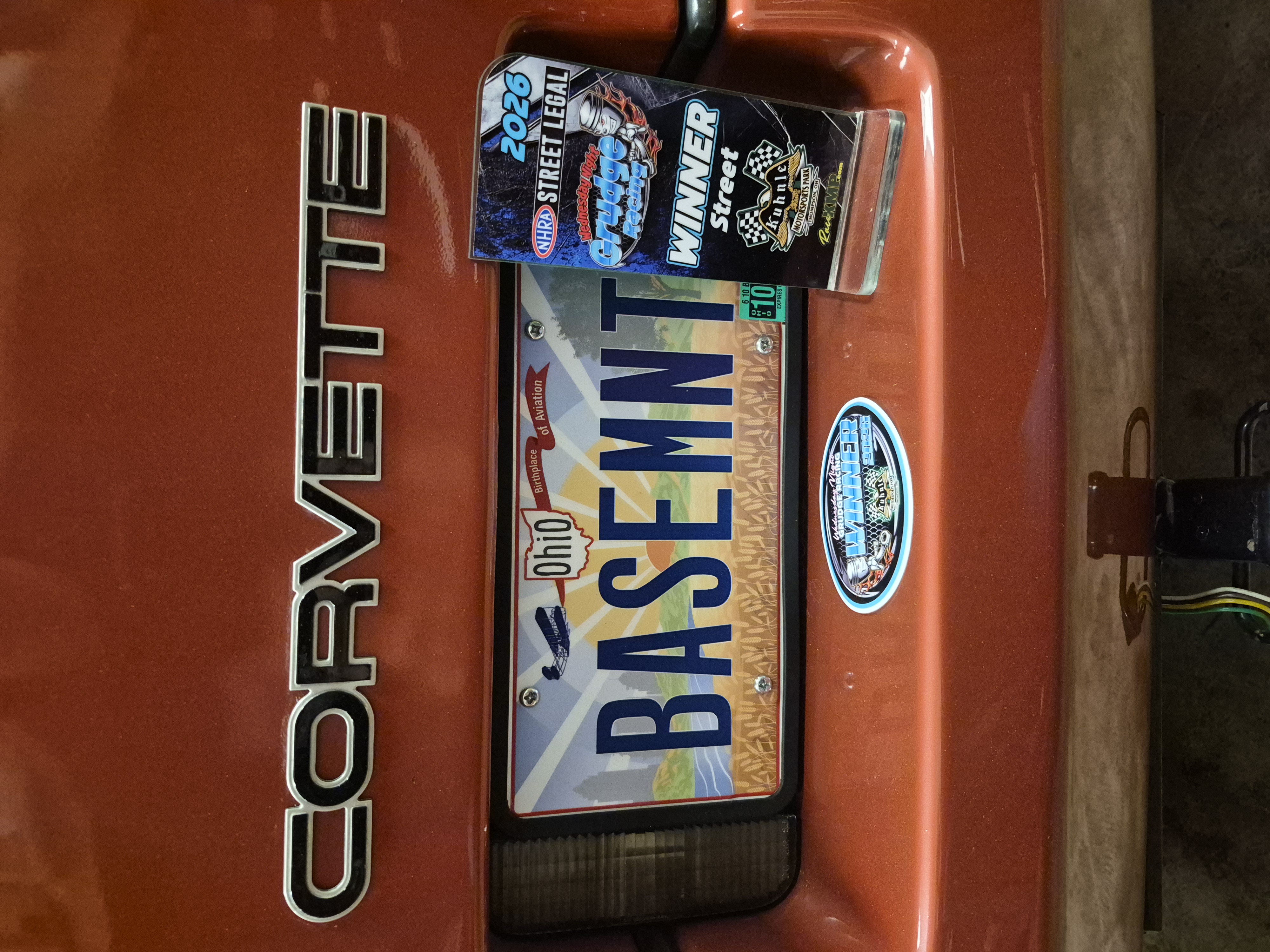

So after all that effort the car didn't get any faster.
My trip to the track wasn't a total waste as the car is super consistent and I think the gearing makes it launch more consistently too. It took me a couple passes to trust the track but it was really sticky all night for me. Once I trusted it, I went back to letting the car shift on it's own. I made four runs in eliminations: 12.24 on the brakes (would have likely been a .22), 12.24, 12.24, and a 12.227 in the finals on a 12.22 dial which had a slight tap of the brakes at the stripe and would have been a .21. I ended up victorious in the Street class. The weather was really nice and the track ran without any hiccups. It was fun hanging out with Dave and everyone else we haven't seen since last year (or more).
The car does have a small vibration at speed, so I'm going to chase that after vacation. I really think it's the driveshaft. I'm going to do some very careful measuring and try to have the longer one that came out of the car shortened slightly. I would really like the current driveshaft 1/2" in my mind, and balanced. The shaft that is in there now came with the rearend and really is a question mark as far as it's balance goes.
I really do think there is an 11 second pass here with some good weather. The tune from Hutter's should yield a few HP too. That's coming in mid-July.
Definitely a good start to the racing year.
