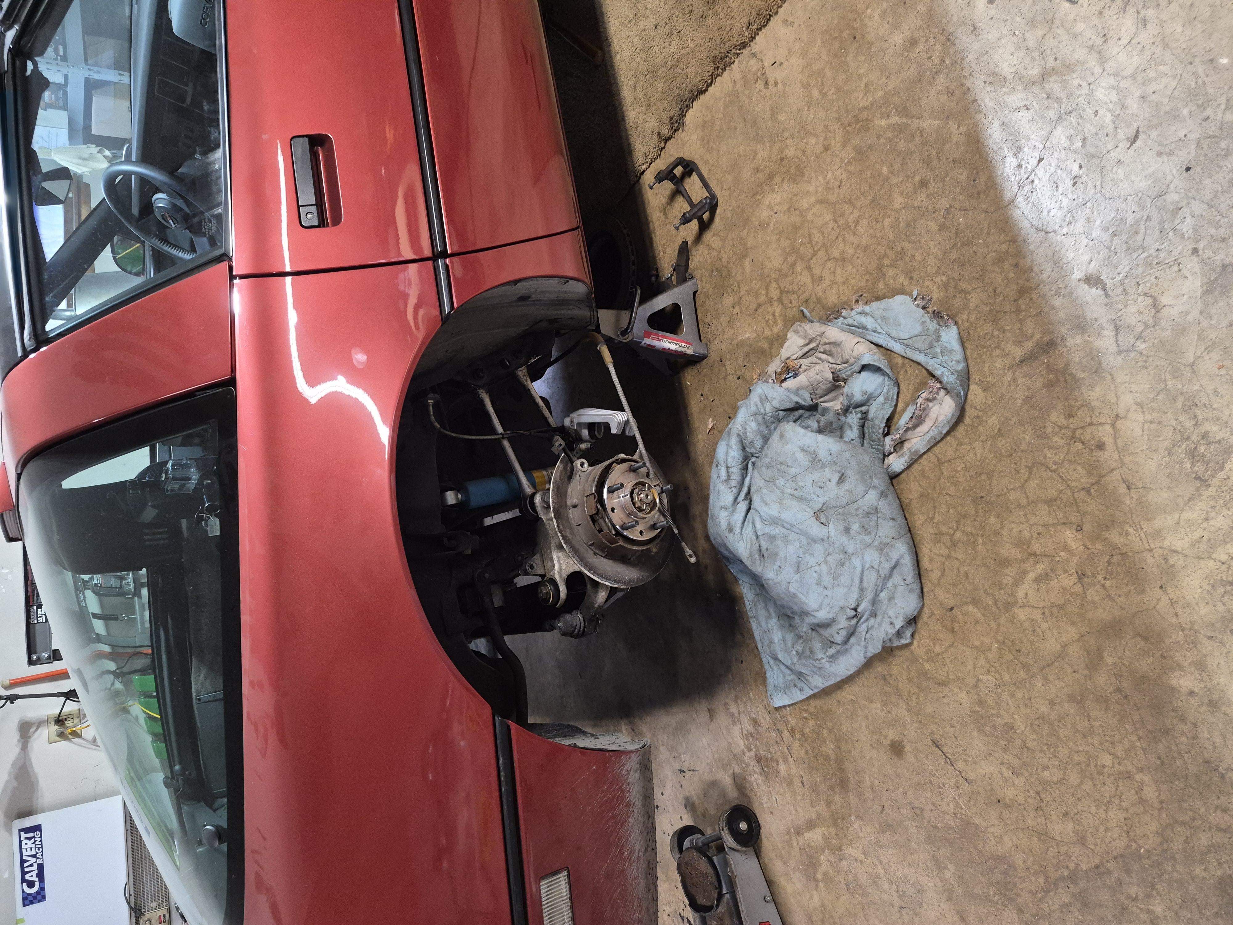

Yesterday the rest of the things to be done outside of the car got finished and the rearend made it's way back into the car. It's not completely bolted in as the new stiffer bushings make it hard to wiggle mounting brackets. So next week we'll have to loosen a few bolts up so we can get it aligned and into place.
