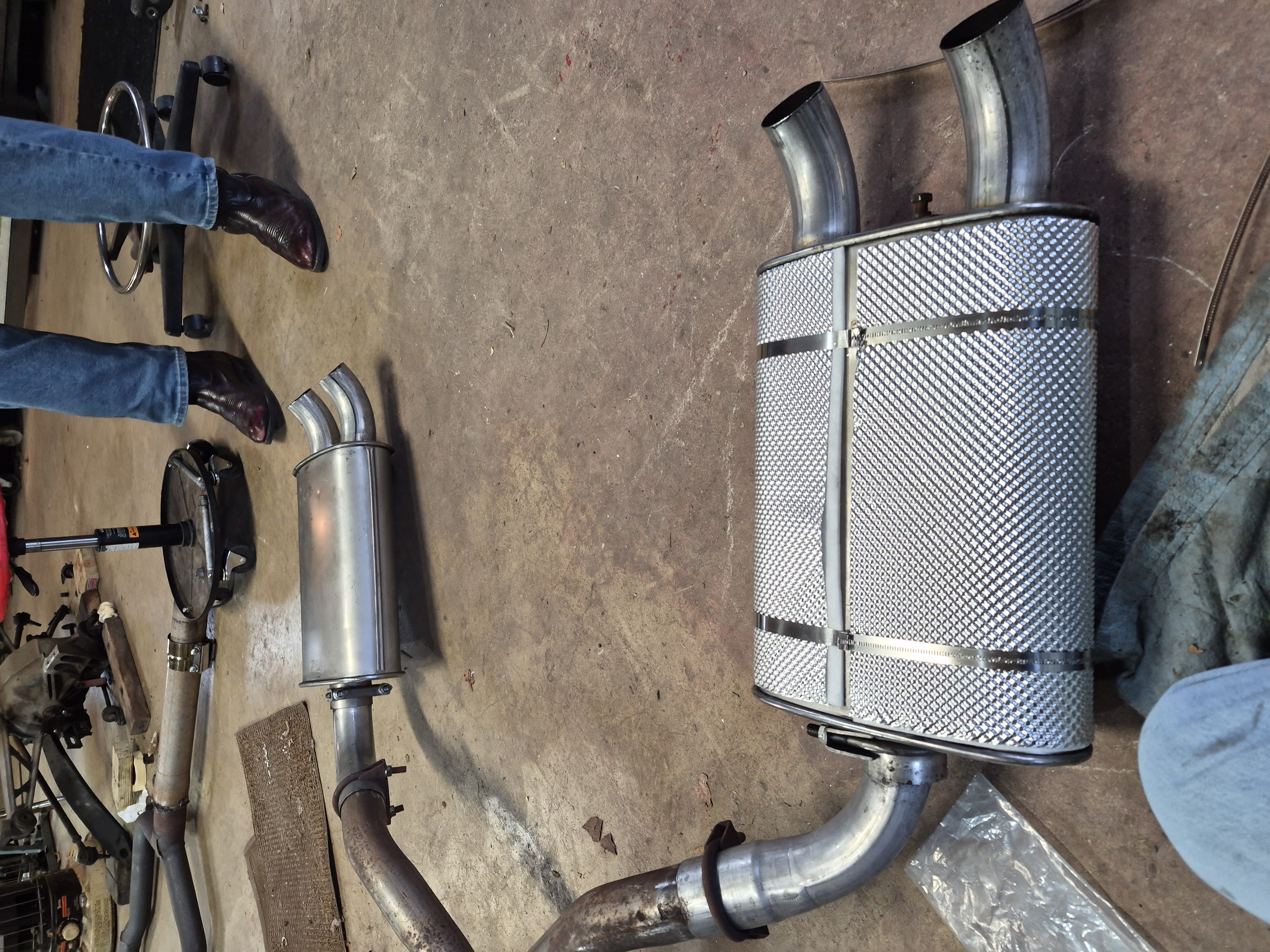

Also got the mufflers wrapped with some DEI sound deadening material. More to come.

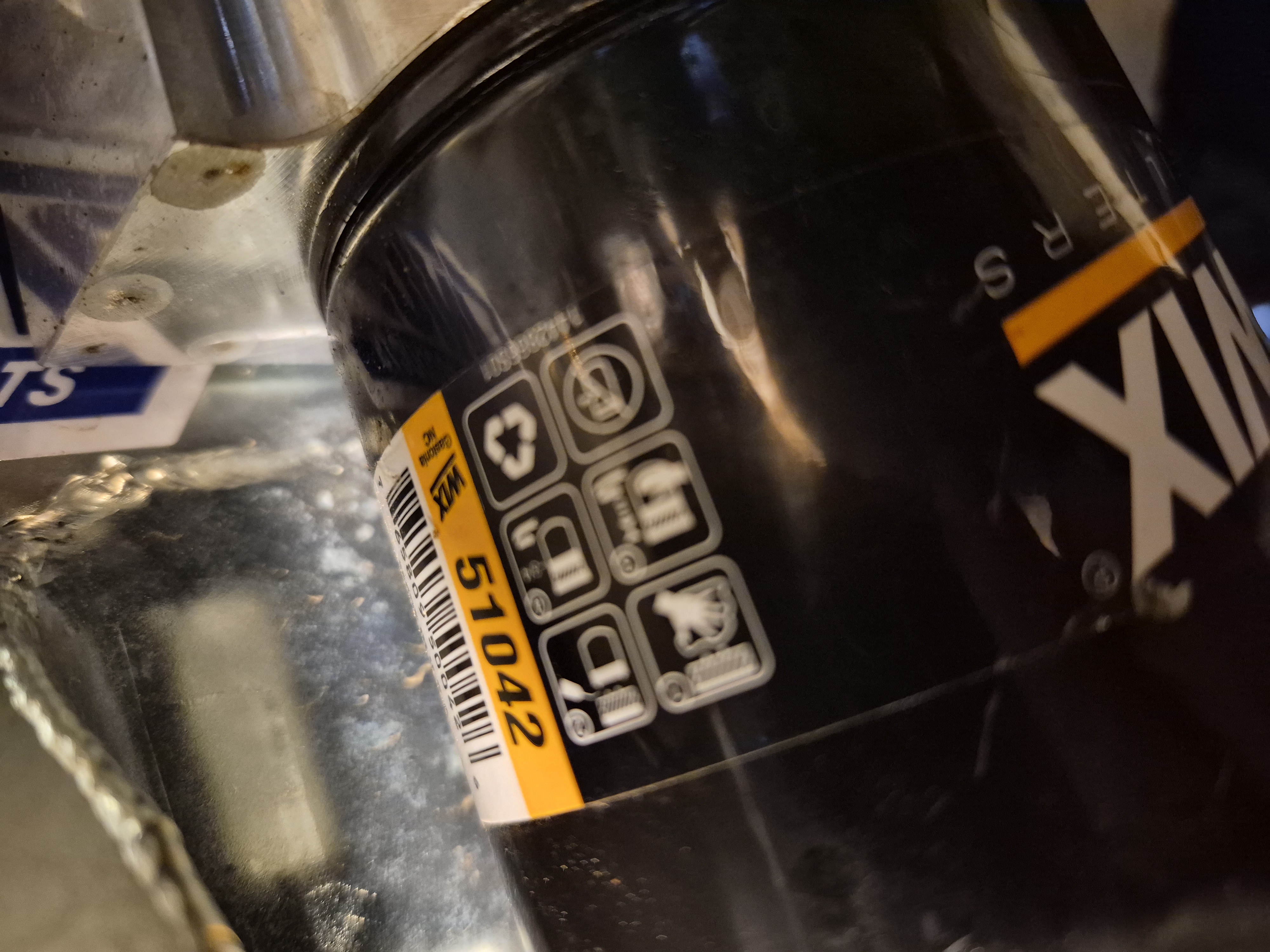

Since the mileage counter does not function anymore, we're just going to change the oil once a year at this point. It hasn't been probably 1000 miles since we put the Mobile 1 in with the motor swap, but since the motor was opened up, I thought it could use a fresh filter and oil. This time it got seven quarts of Driven LS30 oil, which is what I use in the S10.
Then I got to reinstalling the rest of the exhaust. It didn't go as smoothly as I hoped, but it's on there now. Eventually I'll have to cut and reweld a hanger bracket on the tailpipe itself, but for now it's secure.
