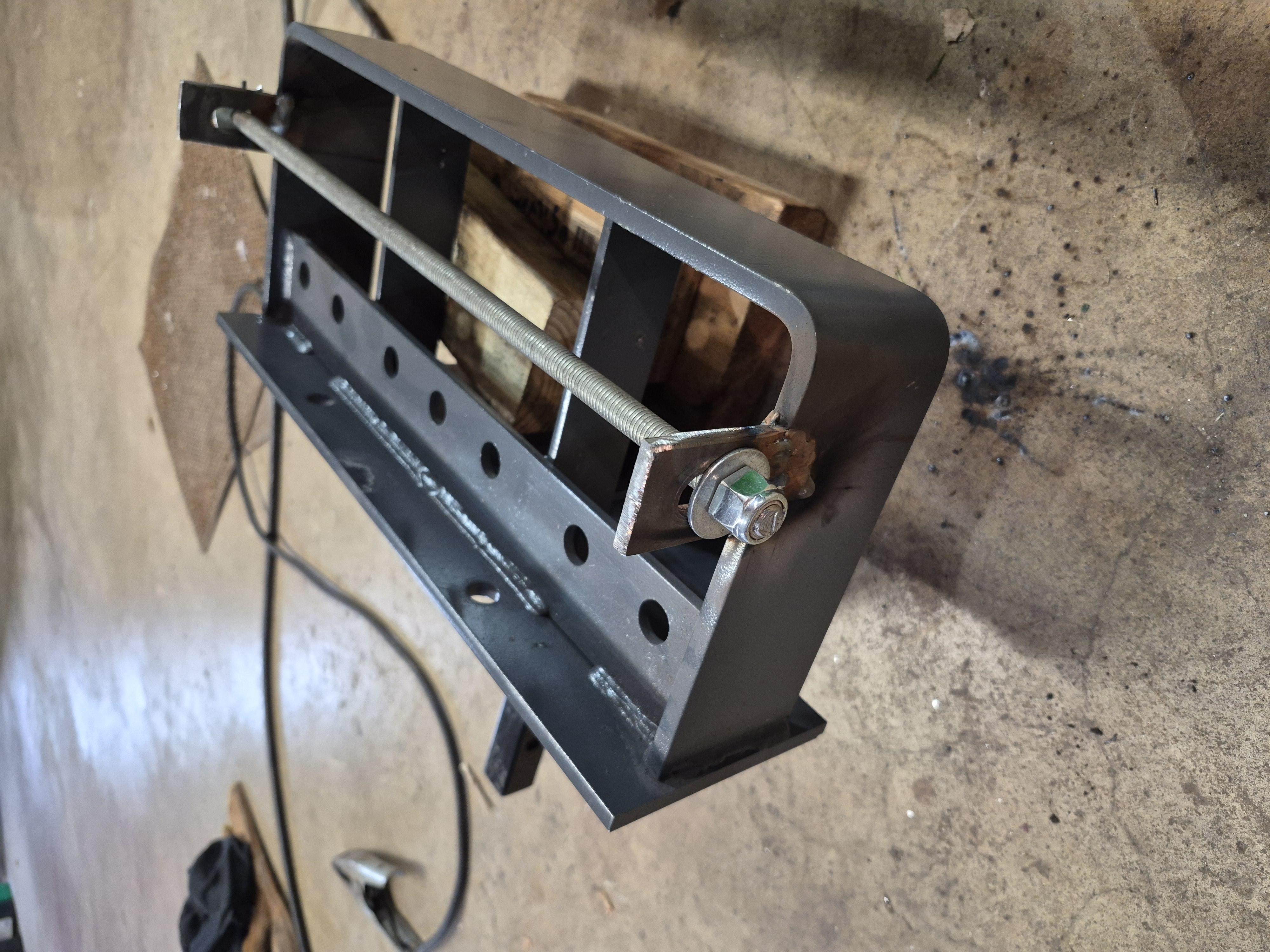

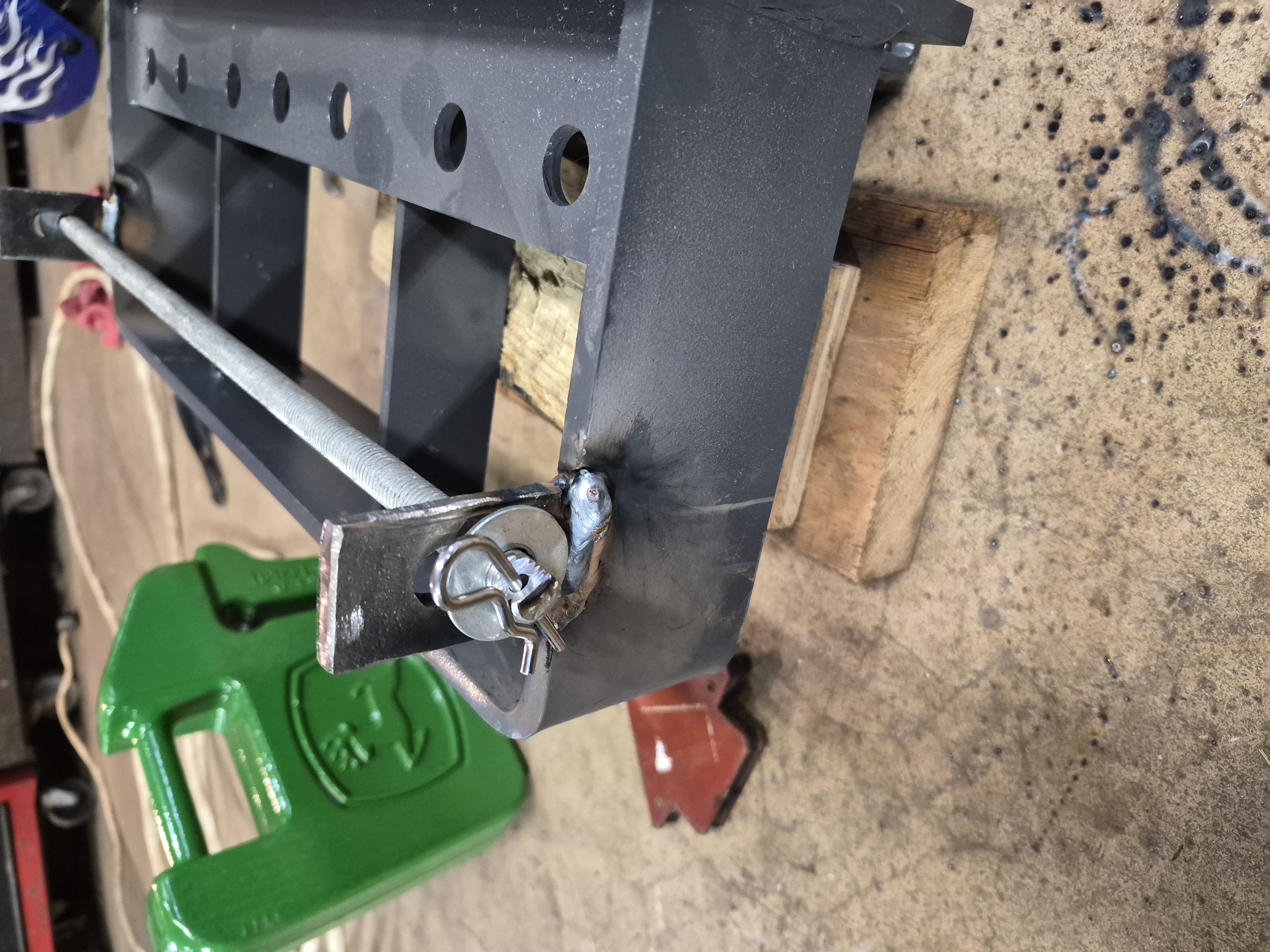

We took the weight bracket off the shelf so we could make a securing rod to keep the weights in place over rough terrain. Since it was originally for a garden tractor, this was not a real concern. Using some old piece of steel off the shelf and a piece of threaded rod, we did some cutting, welding, and drilling and it looks like it belongs there. We just need to paint it and it will be done.

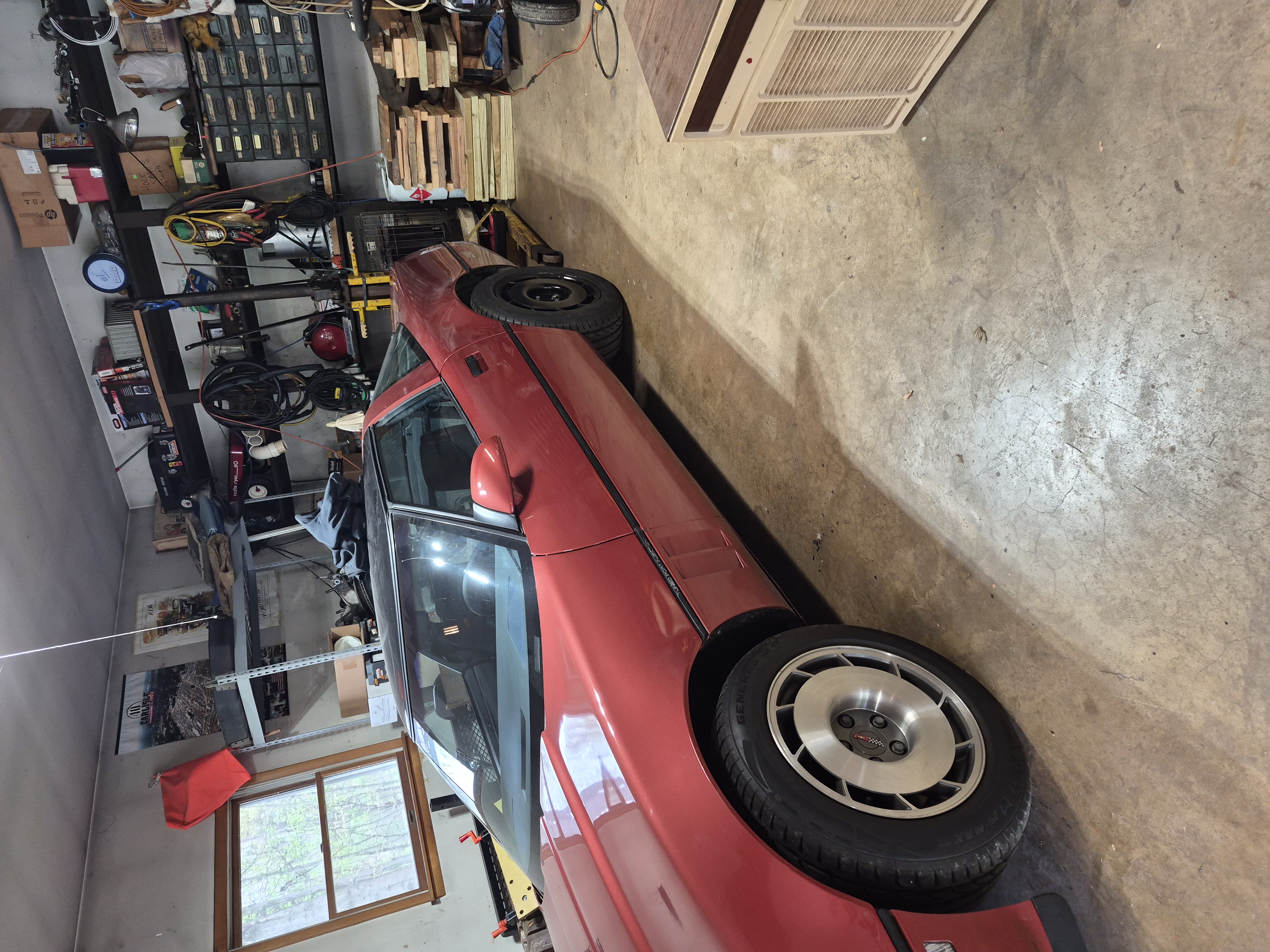

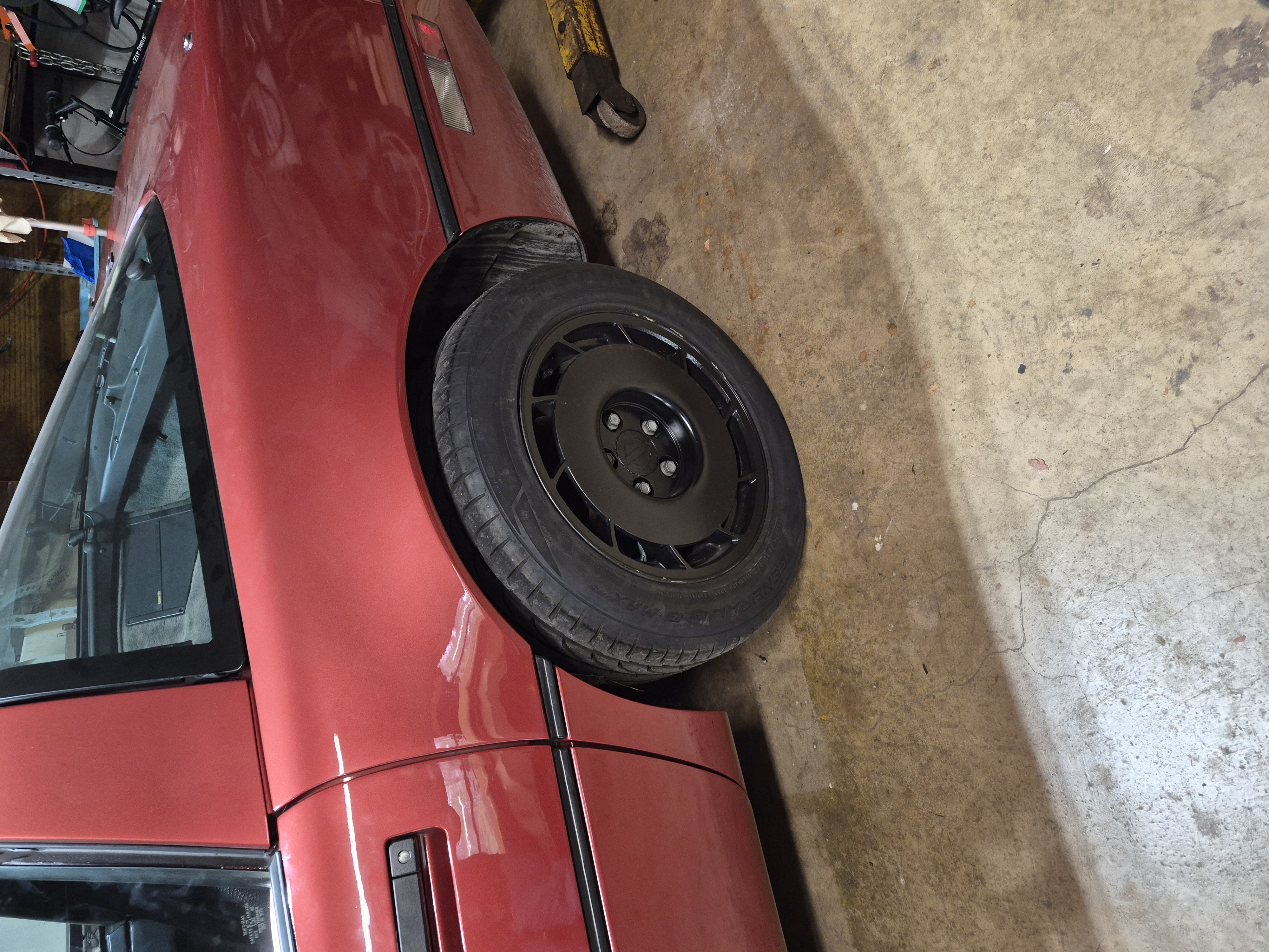

After my alignment I was driving the car and unsure if I felt a vibration from the heavily weighted and easily flatspotted from sitting tires, or if it was coming from my recent driveline work. We dug some good tires off the pile and put them on the rear for a test drive. While driving in Mexico, we were able to get to the top of 3rd gear without any noticeable vibration, so I'll just blame what I felt on the crappy Mickey Thompson tires and the firmly bushed rearend.
Next thing I think I'll do is take the drag tires on the car which are mounted to 16 X 9.5" wheels, and mount them on the 16 X 8.5" wheels for some weight savings.
