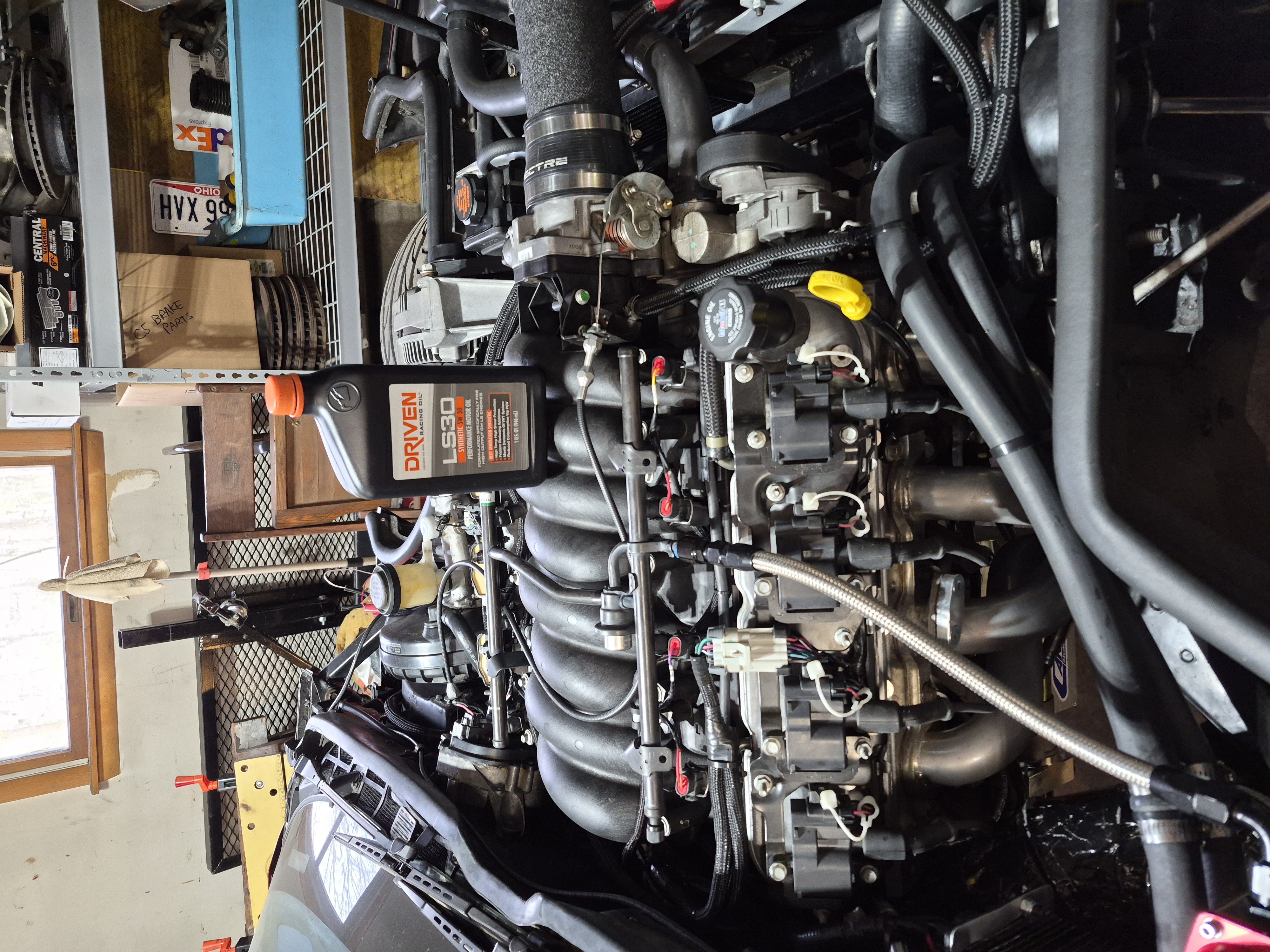

Since the mileage counter does not function anymore, we're just going to change the oil once a year at this point. It hasn't been probably 1000 miles since we put the Mobile 1 in with the motor swap, but since the motor was opened up, I thought it could use a fresh filter and oil. This time it got seven quarts of Driven LS30 oil, which is what I use in the S10.

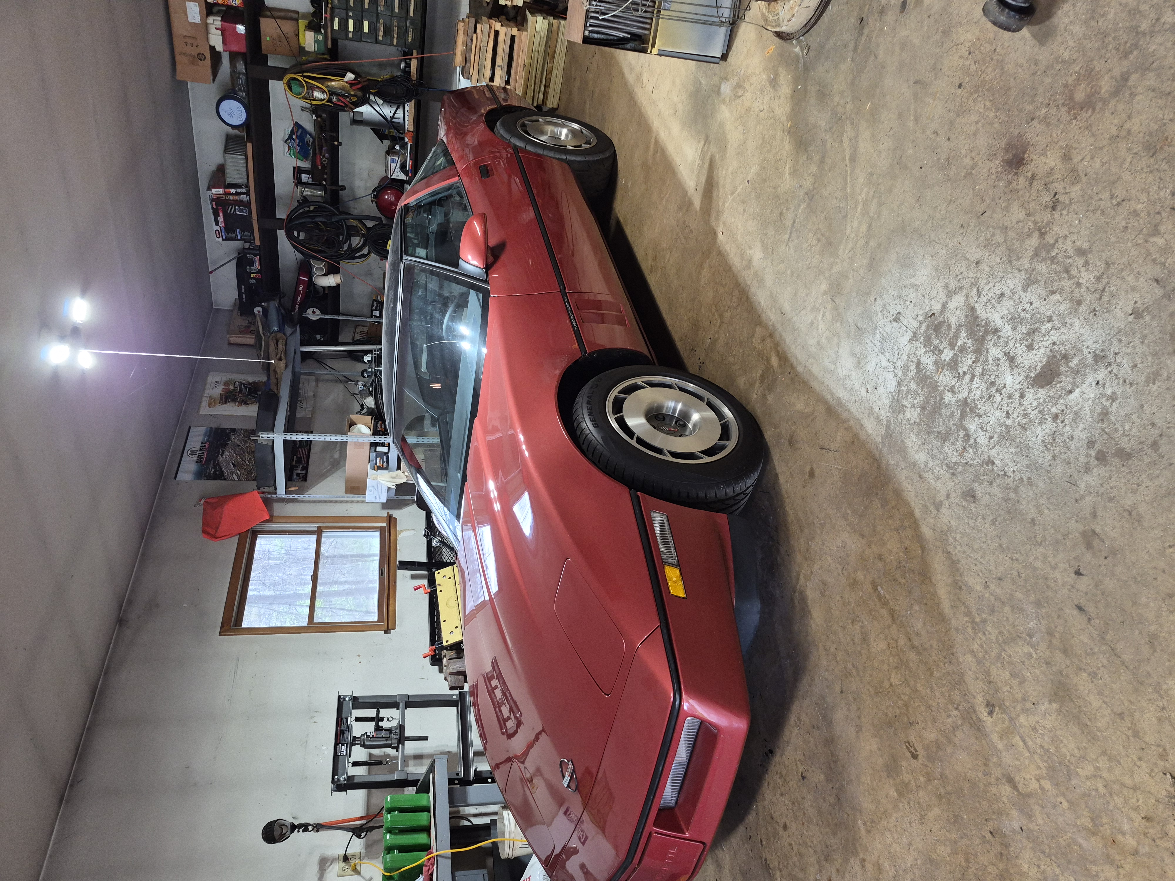

Then come the test drive, which was full of questions for me, but after a quick trip through the development and a run around the Bass Lake Loop, it seems like all is well in the mechanical department. We gave it one full throttle blast into 3rd too, no problem.
So now it needs an alignment as the rear wheels are clearly cambered in the wrong direction. I will try to get that done this coming week. I also plan to get it booked in at Hutters for a final tune to get the HP maxed out, the shift points locked in, and the speedo corrected on the Holley screen.
I'm looking forward to putting this thing in the dirt and on the dragstrip at least.
