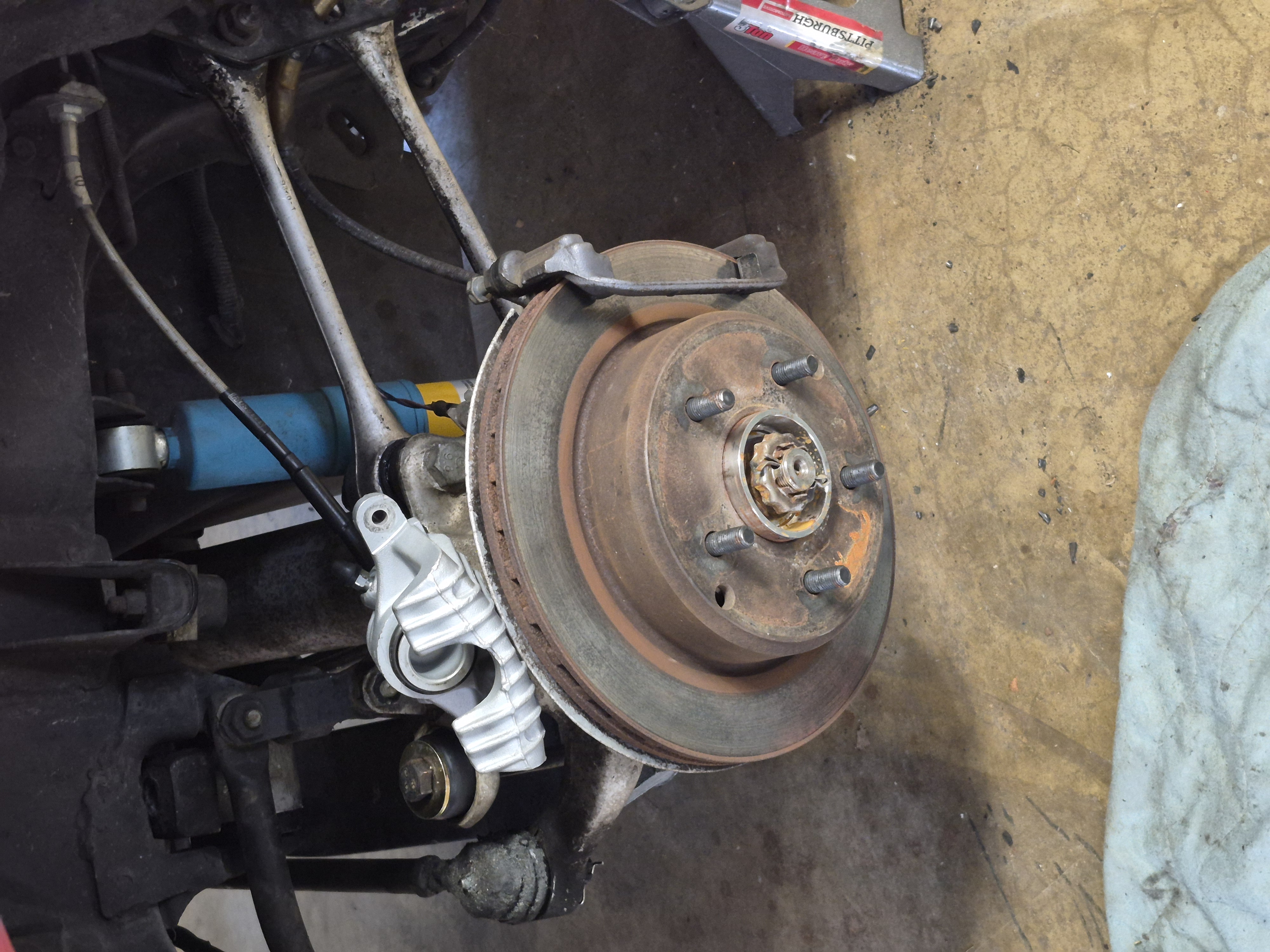

Yesterday the rest of the things to be done outside of the car got finished and the rearend made it's way back into the car. It's not completely bolted in as the new stiffer bushings make it hard to wiggle mounting brackets. So next week we'll have to loosen a few bolts up so we can get it aligned and into place.

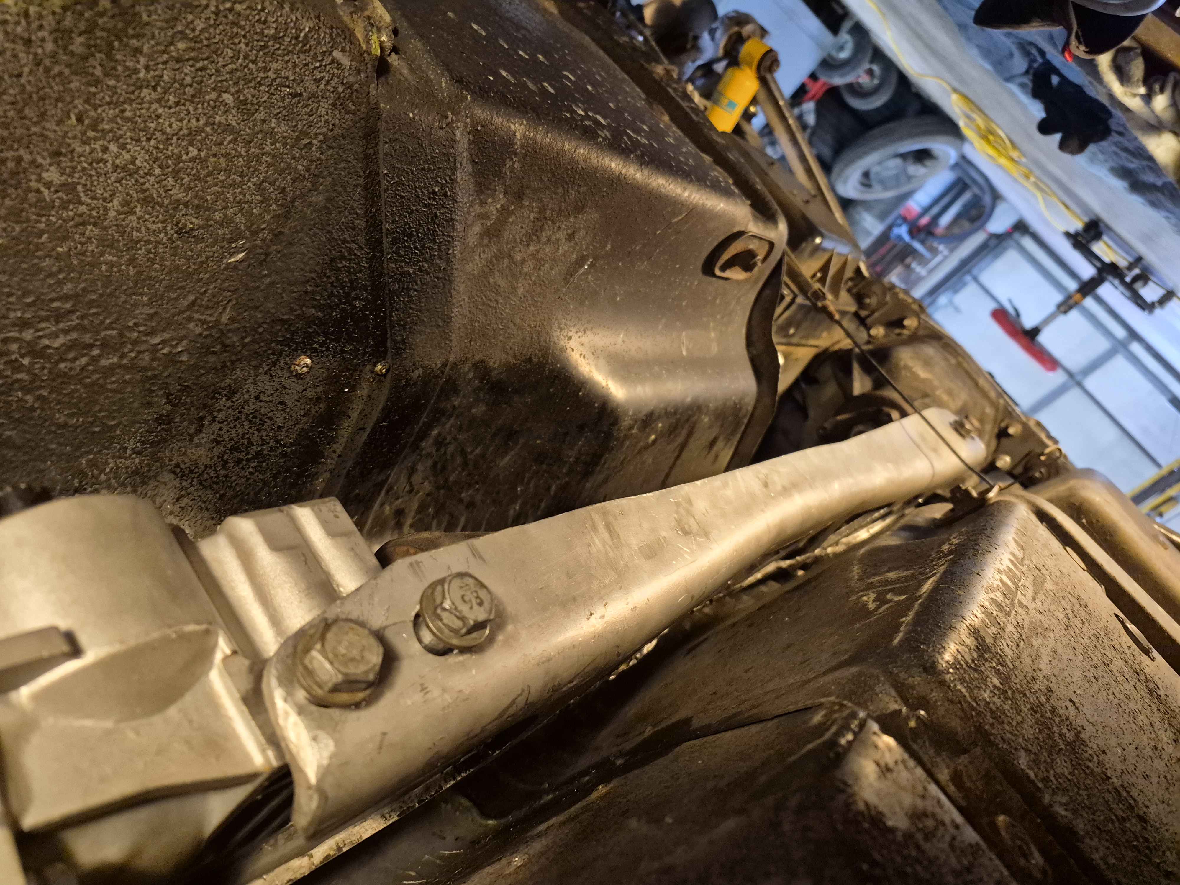

On Saturday we spent three hours or so before we realized the C-beam was not going to fall into place and connect the trans and pumpkin together without modification. Somewhere between the aftermarket engine mounts and urethane bushings, the holes will not line up. Yes there was swearing.
Sunday morning I couldn't take losing and went back. I was luckily able to get the beam out of the car without having to remove the rearend again. I spent a bunch of time elongating all eight holes in the beam. On the first try it almost fit, but had to pull it out again for a little finish work.
The beam is now resting in the car, with loose bolts. Next week I should be able to start tightening bolts for good hopefully, and clean up my large mess in the garage.

So all the suspension and beam bolts are tight. The parking brake cables are back in place along with the caliper brackets and also the driveshaft. I also spent a half hour cleaning up tools and an aluminum grinding mess. I would go back tomorrow but Easter festivities are consuming the day.

Now unfortunately my c-beam modifications have created contact between the c-beam and the driveshaft just at the u-joint area. I did some grinding and loosening, and realigning, and it looks like I now have a little more than 1/16" of clearance. I'm not sure how much I really need here, but a slow test drive will likely tell me if there is a problem.

My gut tells me I'm not through with this stupid beam...
