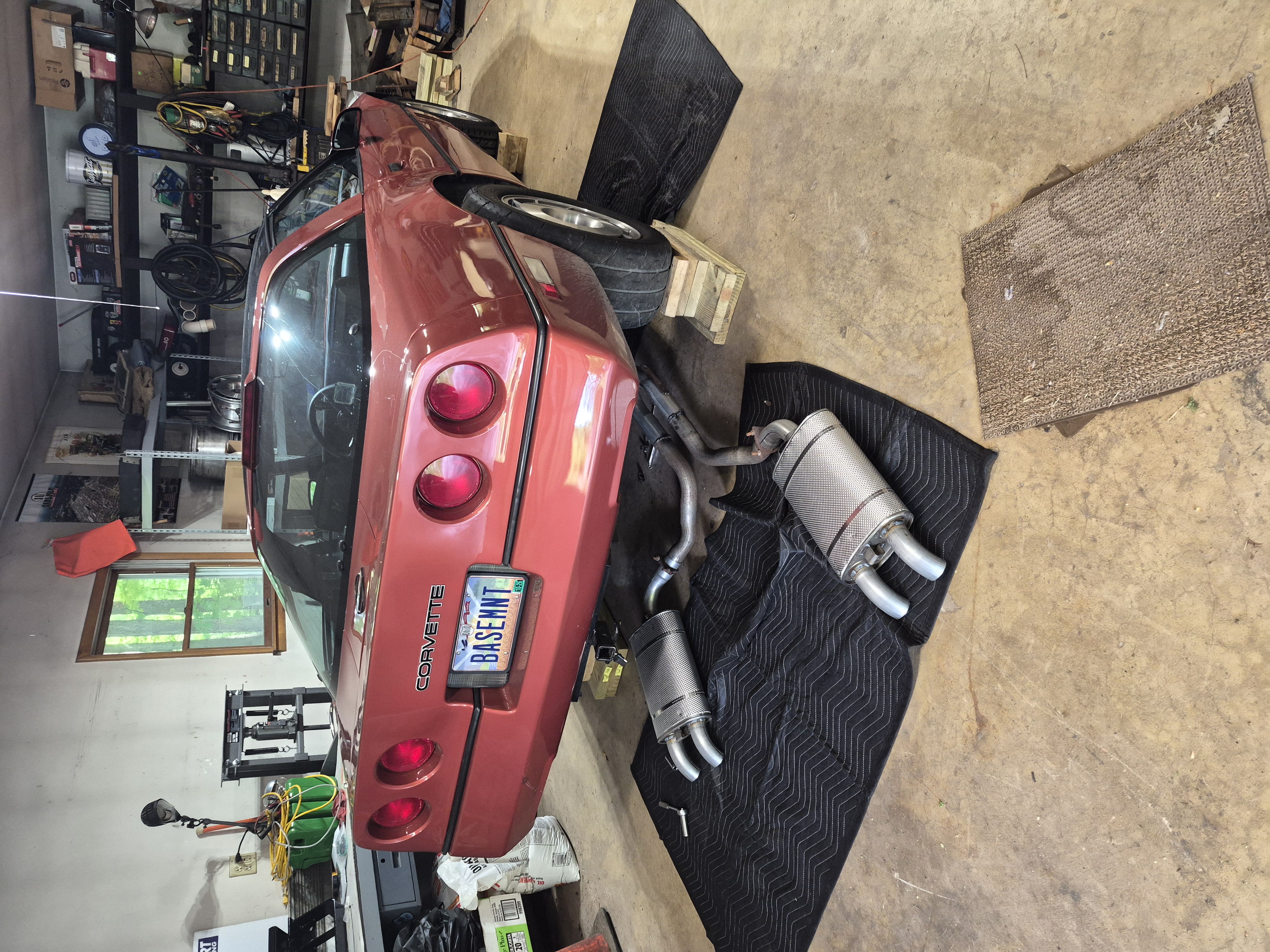

The brakes are done and the front half of the exhaust installed.
My gut tells me I'm not through with this stupid beam...
Also got the mufflers wrapped with some DEI sound deadening material. More to come.

Since the mileage counter does not function anymore, we're just going to change the oil once a year at this point. It hasn't been probably 1000 miles since we put the Mobile 1 in with the motor swap, but since the motor was opened up, I thought it could use a fresh filter and oil. This time it got seven quarts of Driven LS30 oil, which is what I use in the S10.
Then I got to reinstalling the rest of the exhaust. It didn't go as smoothly as I hoped, but it's on there now. Eventually I'll have to cut and reweld a hanger bracket on the tailpipe itself, but for now it's secure.
Then come the test drive, which was full of questions for me, but after a quick trip through the development and a run around the Bass Lake Loop, it seems like all is well in the mechanical department. We gave it one full throttle blast into 3rd too, no problem.

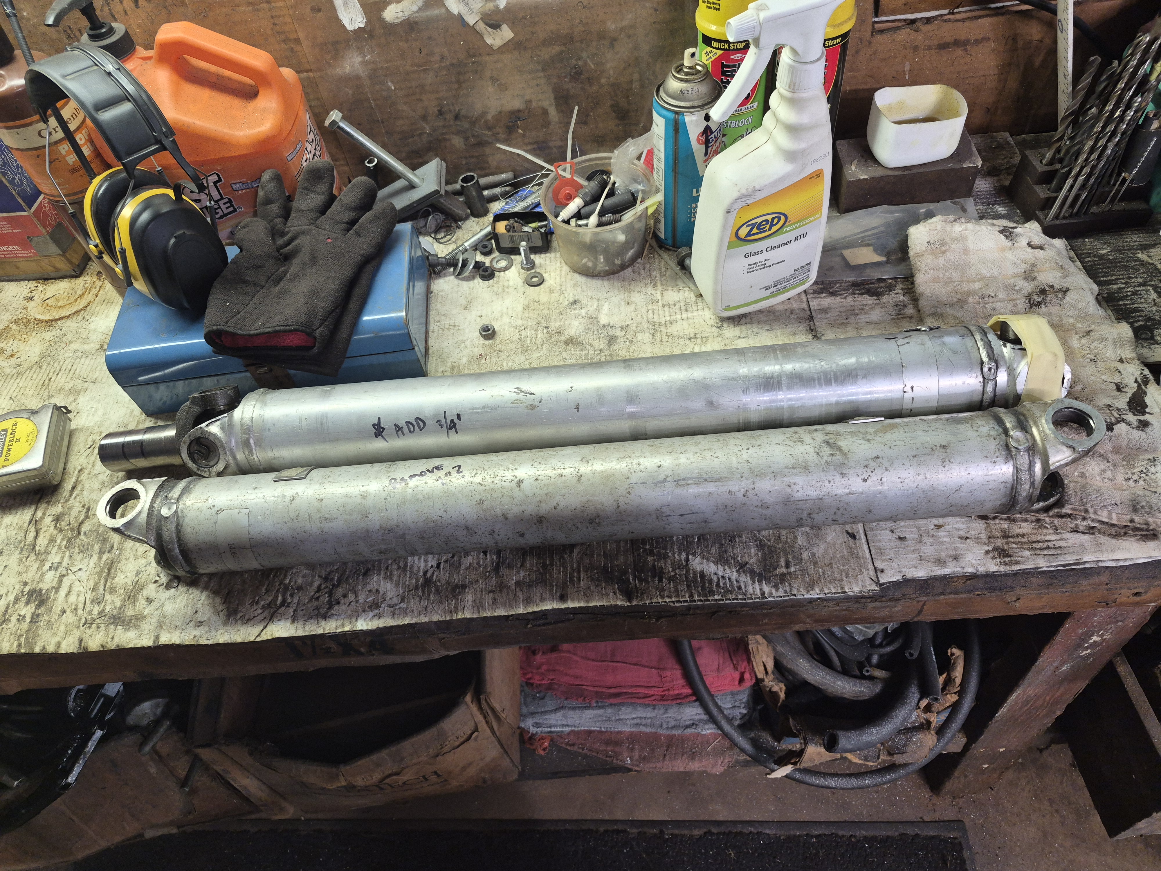

The car does have a small vibration at speed, so I'm going to chase that after vacation. I really think it's the driveshaft. I'm going to do some very careful measuring and try to have the longer one that came out of the car shortened slightly. I would really like the current driveshaft 1/2" in my mind, and balanced. The shaft that is in there now came with the rearend and really is a question mark as far as it's balance goes.

The driveshaft that was in the car came with the Dana 44 and can be another 3/4" longer than it currently is. And it appears that the front weight was removed for some reason. So im going to have the longer original driveshaft from the Dana 36 shortened to that length and rebalanced. This will give me more confidence that my yoke is in the trans far enough, and should make it smooth as a boob at speed again.
I plan to go to Henderson Driveline on Monday morning after making contact with them.

what is the advantage of having one shortened vs finding a good used one?
Posts: 3678
Re: 1987 Corvette Z52
Finding the right size would be near impossible IMO. Having it shortened and balanced would insure i have the exact correct length for my customish application, and having it balanced would guarantee that I have a smooth one. Any used one at this point would be a question mark.
