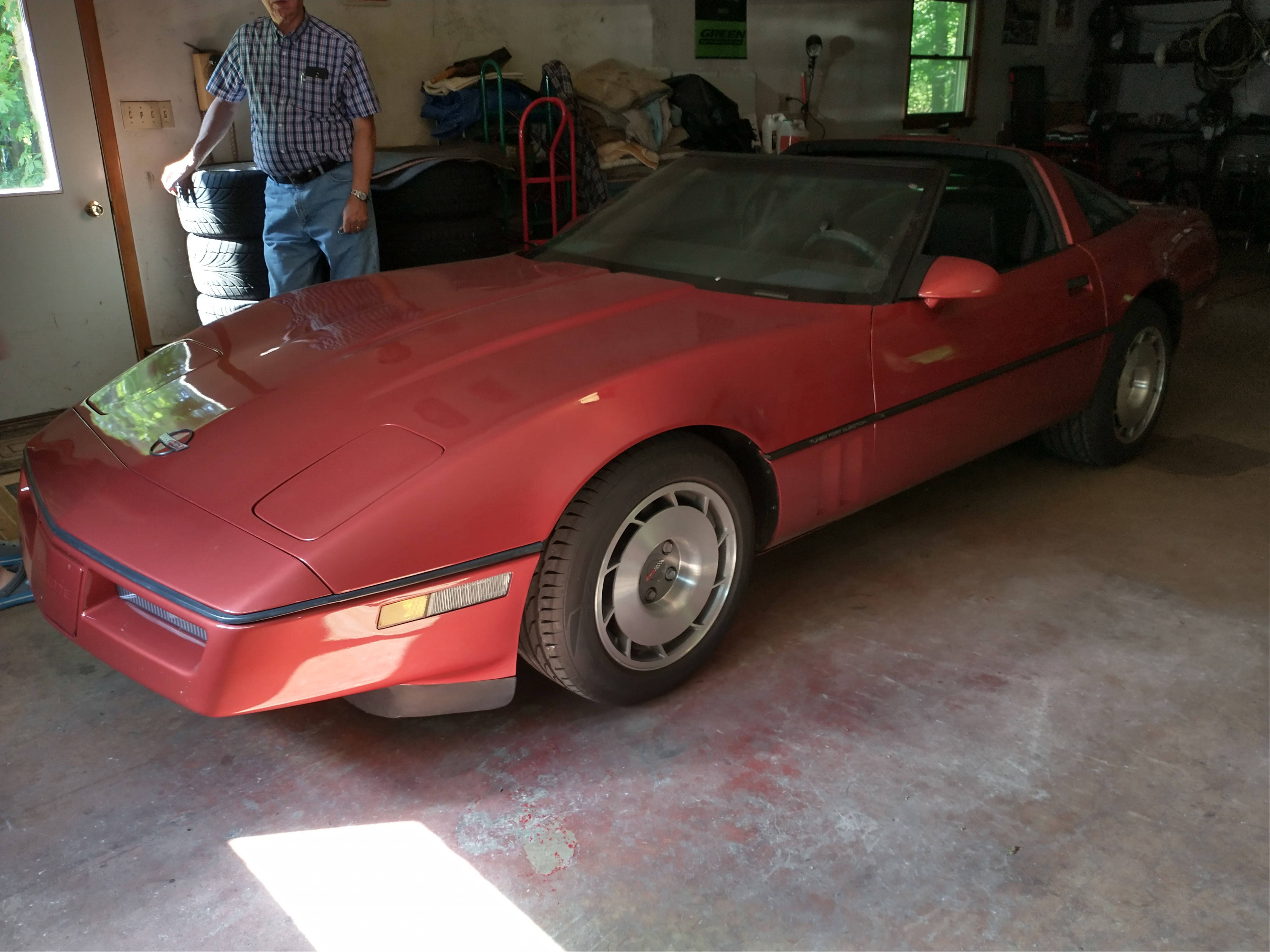

With the Trackbird gone, and knowing eventually we were looking for something faster and with an auto trans, we began our search for the next track car. Our search ended yesterday in Norton with a 1987 Corvette with the Z52 suspension and automatic transmission.
It's a nice, solid car with only 69k miles and mechanically is stock. It has new tires, and the paint is new in the original color, but don't look too close. It puts up a nice appearance and after we buff it out and wax it, it will shine bright on all track surfaces, but when rubber chunks bounce off of it, I won't lose any sleep.
Amazingly, the car runs and drives real nice, with no rattles or squeaks, even with the top out. The extra bracing from the Z52 package helps this I'm sure.
Our goal was to buy it and get it home in one piece, and that happened successfully, and even my nephew Drew rode home for the inaugural trip. It goes 90 no problem and seems to be at least as quick as 32Vs Colorado as it sits.
This week we'll give it a better once over and start a list of things that we need to buy or do to it to make it track worthy.
More to come, but so far it's been a good start!

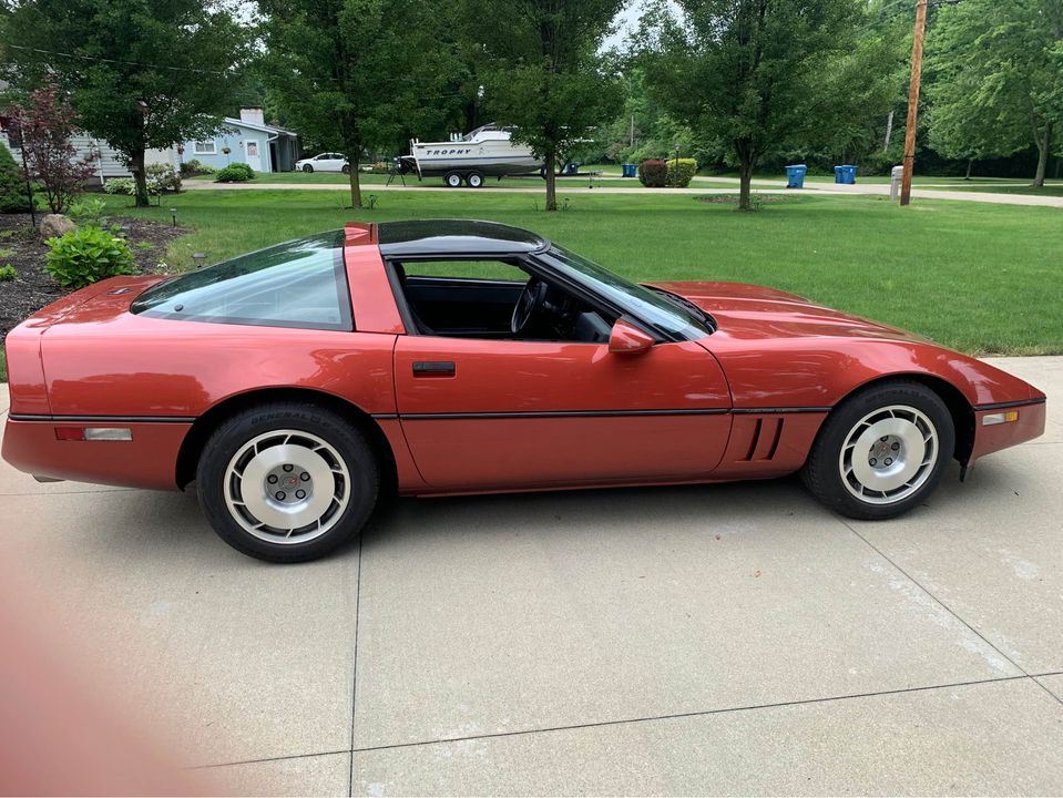

Here's the original listing for as long as it lasts:
https://www.facebook.com/marketplace/it ... 340877246/

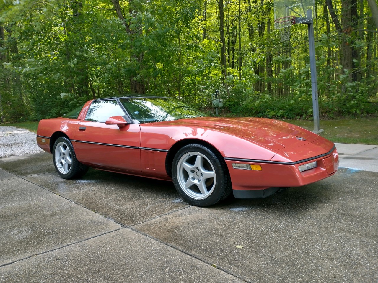

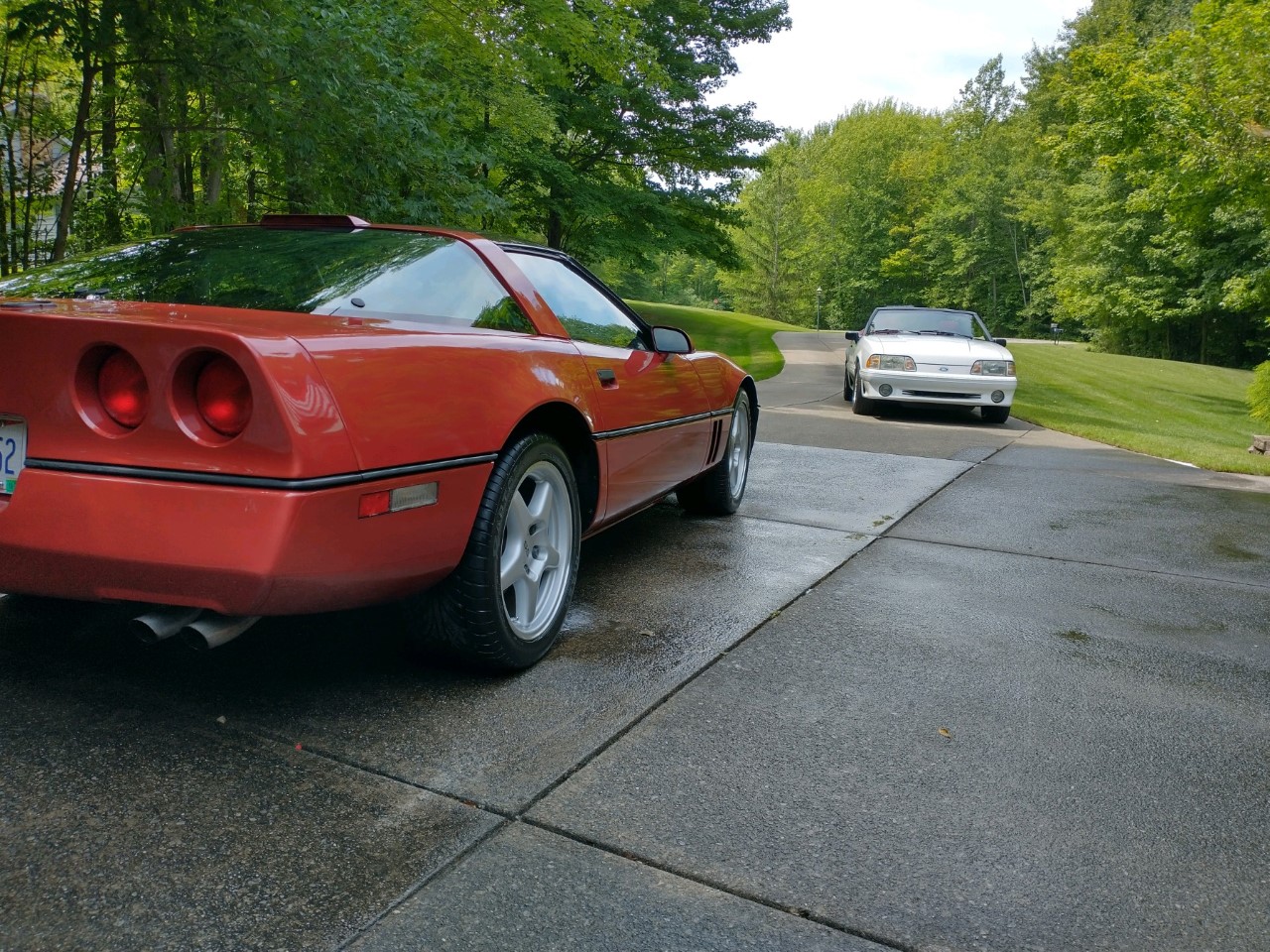

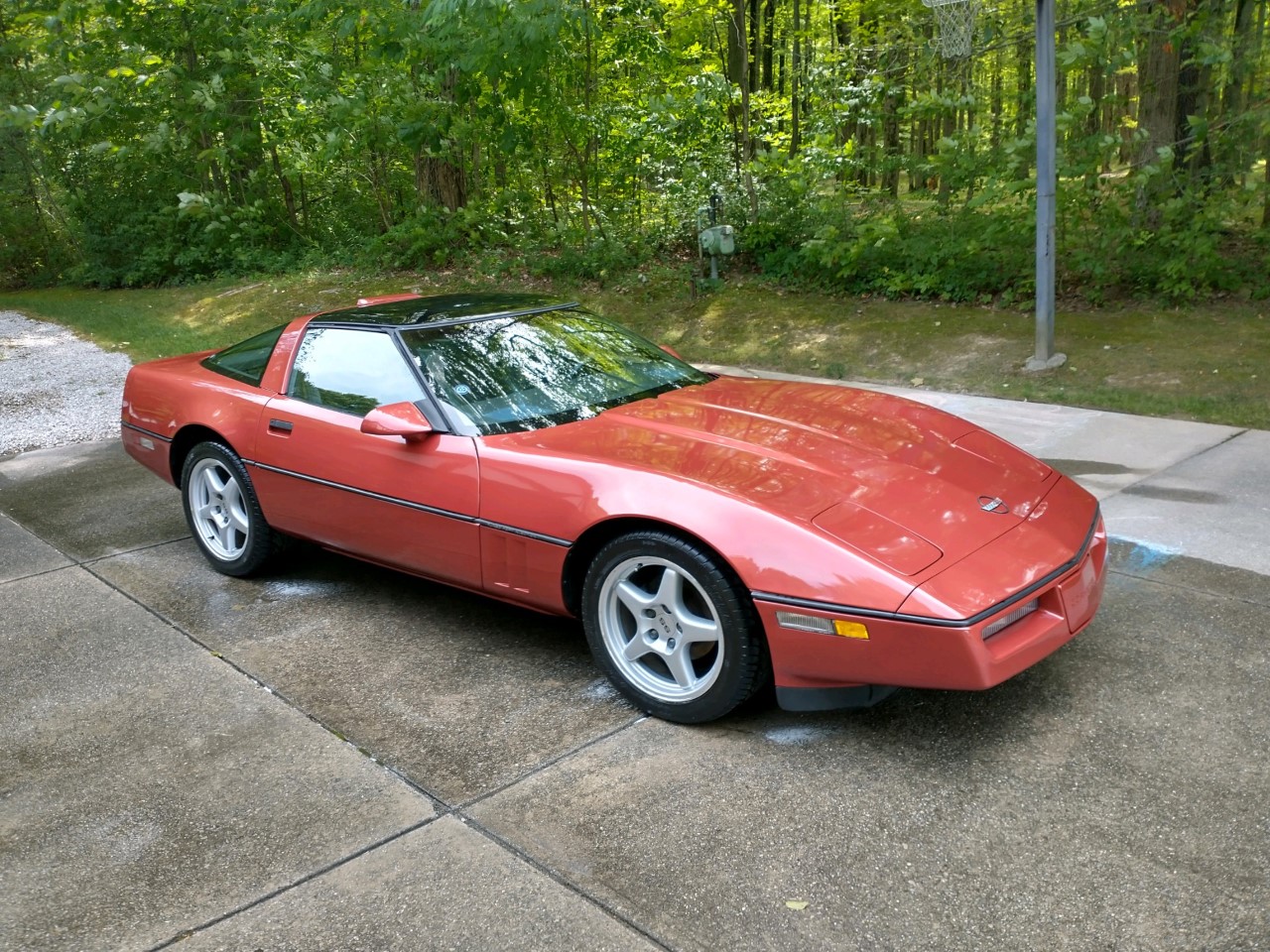

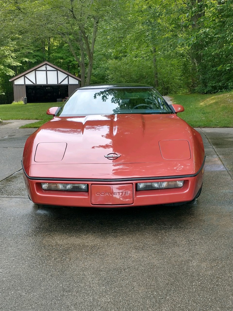

Today we got the Camaro SS / 1996 Corvette 17" wheels installed. While doing this we greased up all the fittings we could find on the front and rear (they NEEDED it) and gave the car a real solid safety inspection. As of right now I think it would easily handle the dragstrip and probably an autocross. But we're going to check the timing before we drag it, and at least put new performance pads on before we autocross it.
Then it got a much needed bath. It looks pretty good, and will like being buffed out and waxed next week. But the car is titled, insured, and plated, so we can drive it anywhere we want.
We also made a big list of things that we want to do to it as we move on and start thinking about road racing. That list is much longer and will require quite a bit of time and some expense. It was good to find NO drops of anything on the floor when we moved it out of the garage. Not too many 35 year old small blocks can say that. How long that will last after the abuse is tough to say...

Your new Vette appears in the pictures to be a watermelon color. Is that accurate? I like those wheels, too. Same as the ones on Silvia.
Re: 1987 Corvette Z52
The factory color is code 74 - dark red metallic. The car was repainted recently to what I believe is the same color. There is so much green around it might be affecting the perception, or who knows if the guy got the right paint. Doorjambs were not repainted and it seems to match reasonably well there.

I think the color is pretty accurate despite it's quality. Dark red metallic is just a terrible description of it. In person its more copper / orange as I see it at least. Pretty unique if nothing else, and puts up a nice appearance.
The wheels are the same as yours WXO, except mine are from a Camaro and have SS centers. They were leftovers from the TrackBird era.
