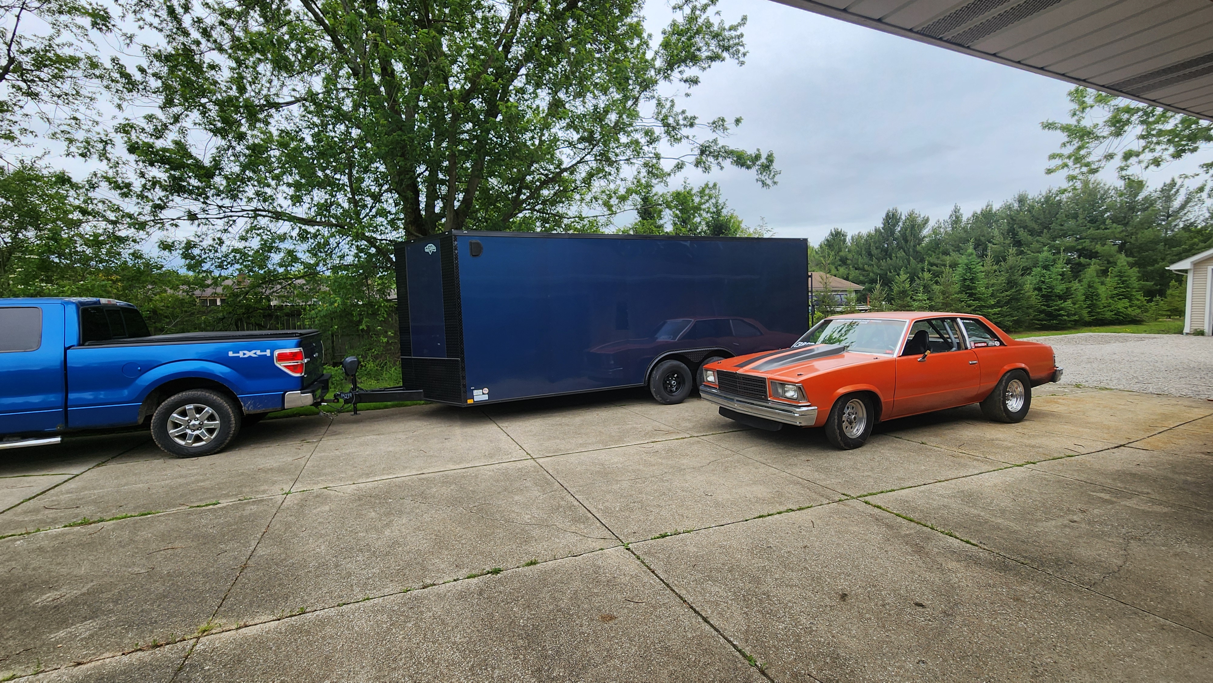

Dang, I'm way behind on my updates here..
Oct 2025, I put 4 new tires on it. I went with the same Cooper Discoverer AT3 tires on it after I found out they were 10 ply tires and should be decent for towing. I had no complaints with the old ones.
June 2026, 97,500 Oil Change. Did this one at home. Also had to repair a stuck caliper slider on the right front after coming back from the track one day. I thought it was going to be a hung caliper, but I was relieved to find just a stuck slider pin. I should've done a tire rotation, but I didn't. I'll do that at 100k.
I've used it many times now for pulling the Tiresmoke Turbo Trailer to Thompson and it's really good at it. When I first bought this truck years ago, I wanted something that towed better than my two previous Chevys and this has checked all the boxes so far.
Only recent pic.. sort of..
