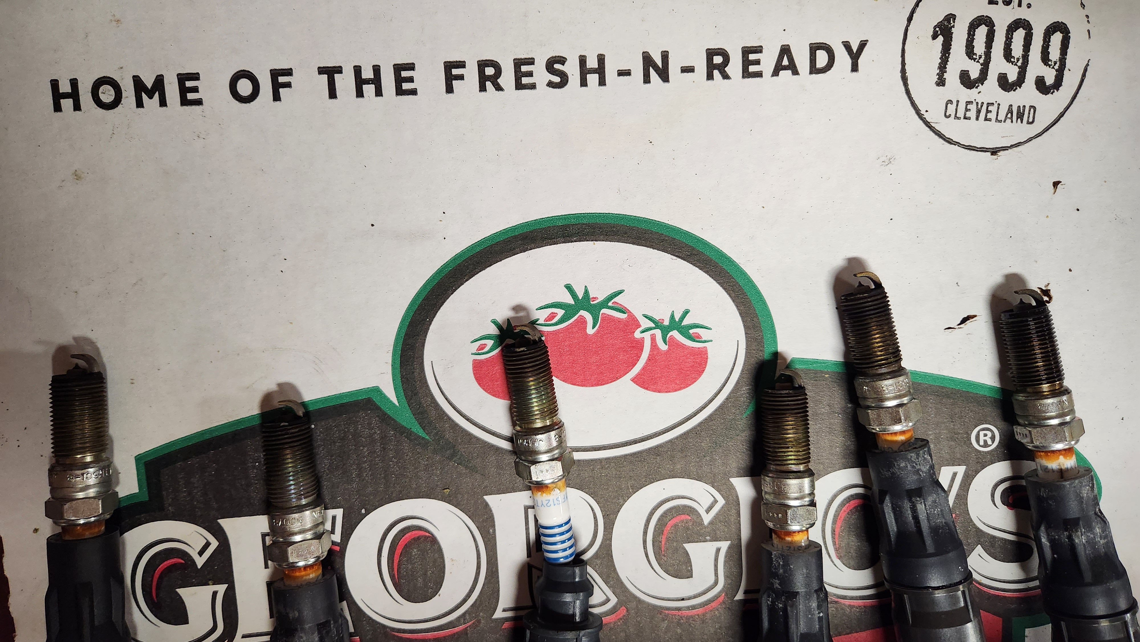

I also bought a set of coils and spark plugs. This thing has a mis-fire/stutter under heavier load. Surprisingly, no engine codes. I've read some people are replacing plugs/coils every 40k miles.

80,067. Plugs and coils are done. All said, it was a pretty painless job. It would've been easier with a spark plug socket that has the rubber insert, but I just used a short piece of fuel hose to retrieve the plugs out of the hole, and a piece of vacuum hose over the tip to re-install.
The old plugs have a Ford logo on them, so they are likely original. New NGK LTR6IX 94374 plugs with Delphi GN 10638-11B1 coils. A short test drive confirmed that it no longer misfires under heavy load.

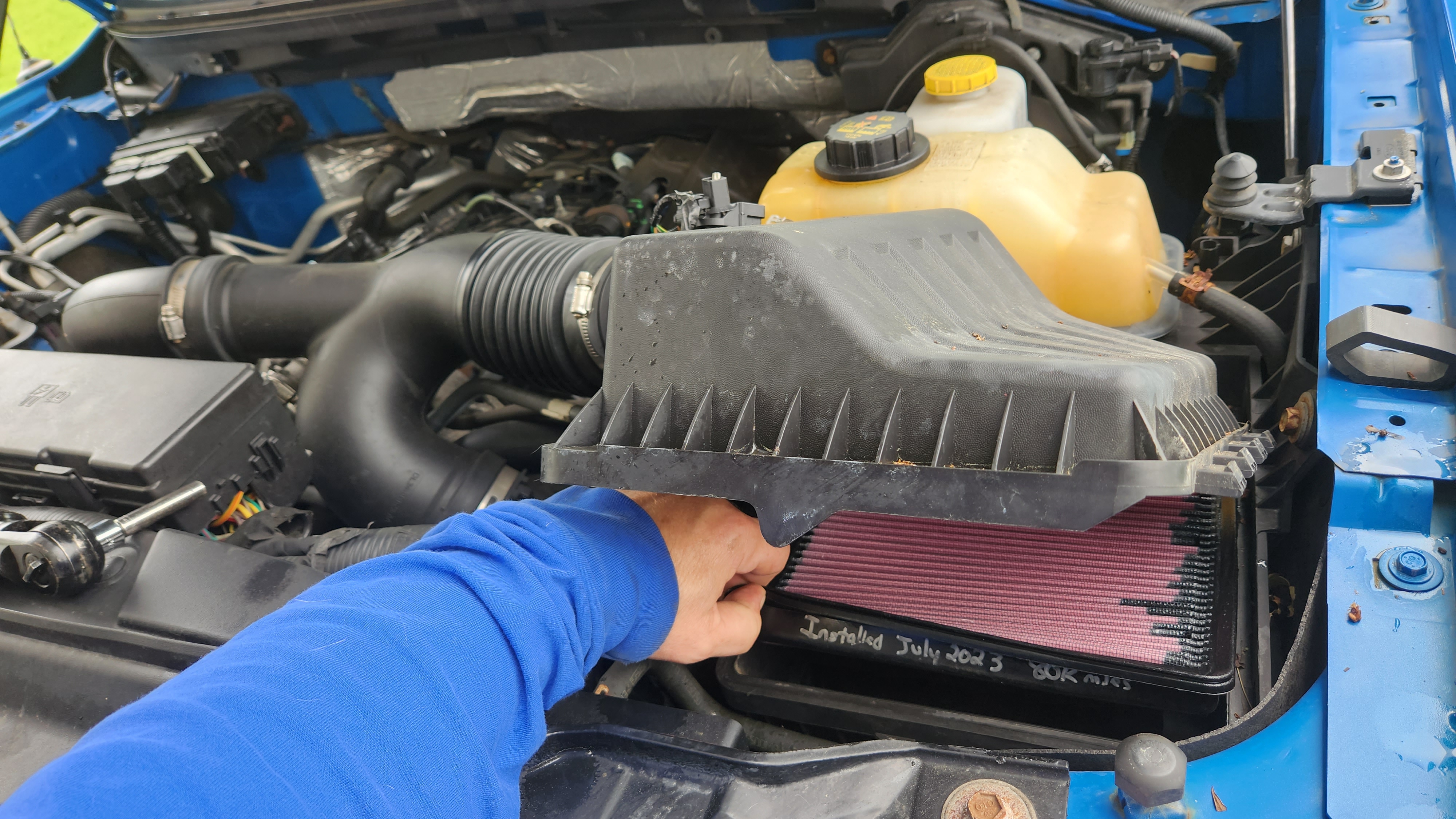

The K&N arrived this weekend and I installed it this morning. The previous filter was from June 2020, 63K miles.
In the 150+ miles I've put on it since the plugs/coils, the mileage has definitely improved. In all around driving, I'd struggle to get 14.7-15mpg, now I'm at 16.5. I haven't done any freeway yet.

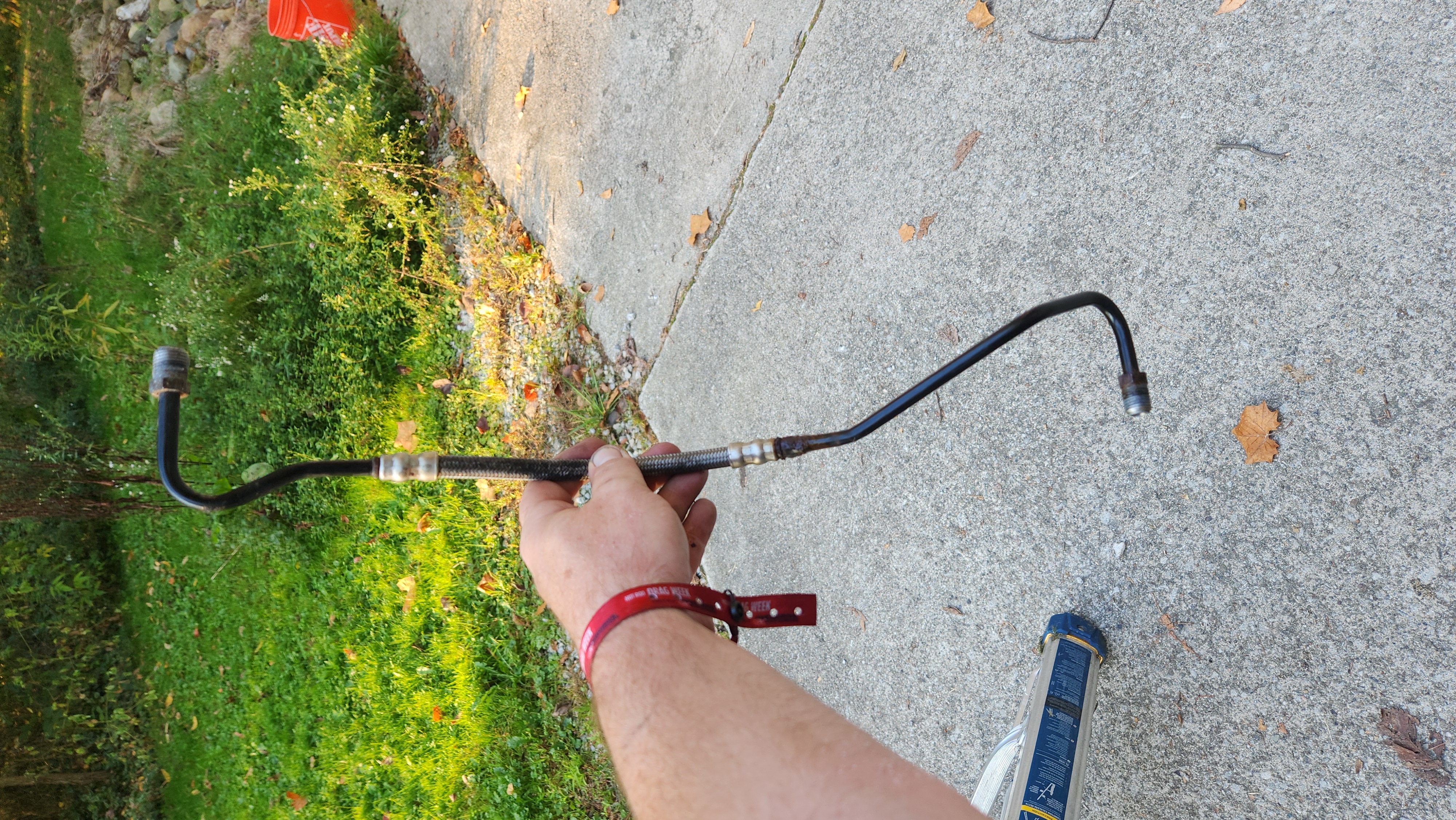

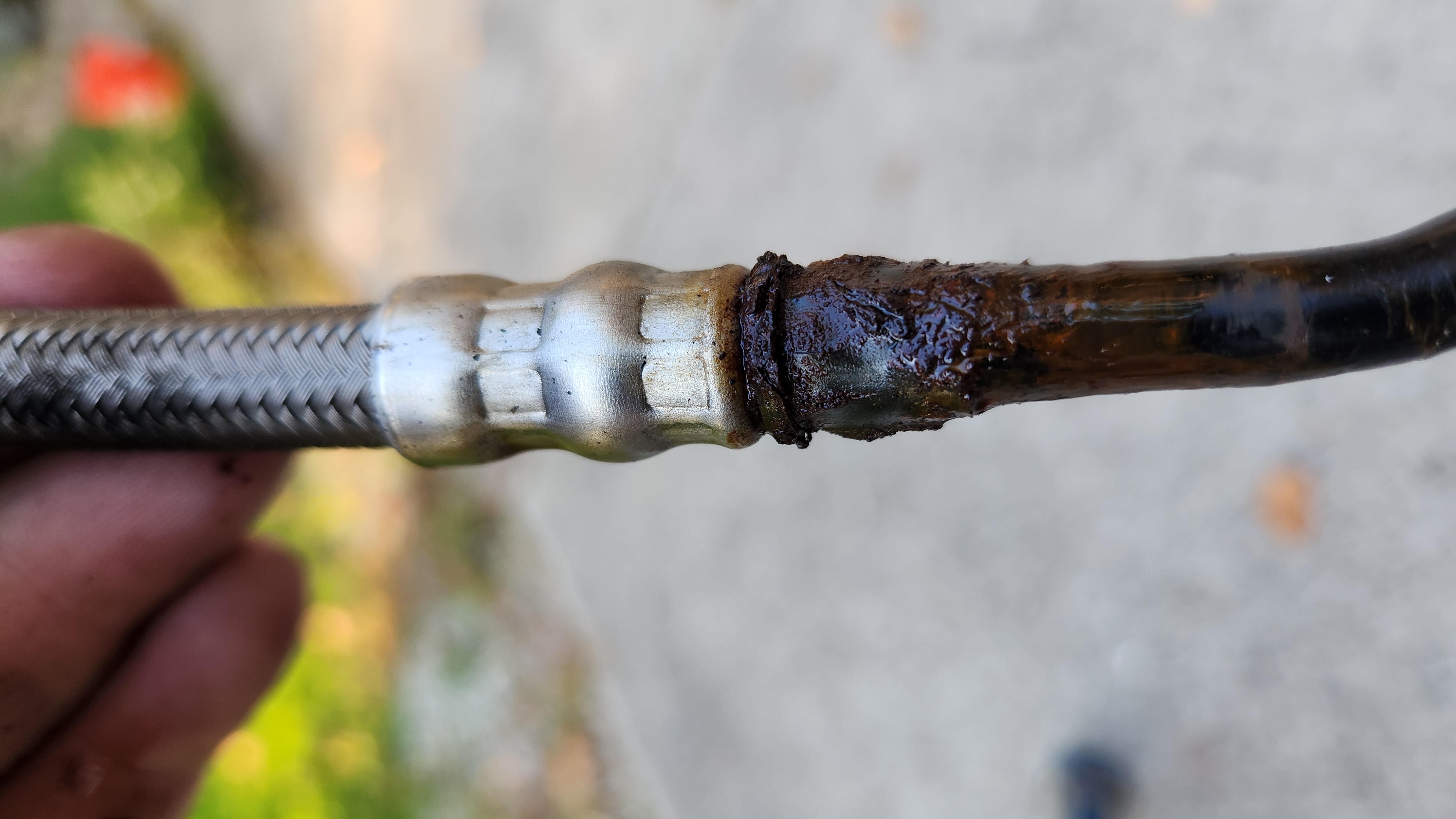

Another brake issue with the (usually) trusty turbo truck. As we got to Scott's house on the way home from Hot Rod Drag Week, he said the pedal felt really bad. I had been in the driver's seat 2 hrs earlier and it had seemed fine then. Sure enough, it was leaking.
It ended up being the line for the rear brakes from the master cylinder to the ABS block. Dealer part ($60ish) because it has a steel-braided flex section, that was fortunately in stock at Ken Ganley in Norton, where I bought the truck years earlier. I wasn't even too mad about the part or the price, since it was relatively easy to fix.
Seeing as it still had the trailer with Maliboost on it, things couldve turned out a lot worse.
