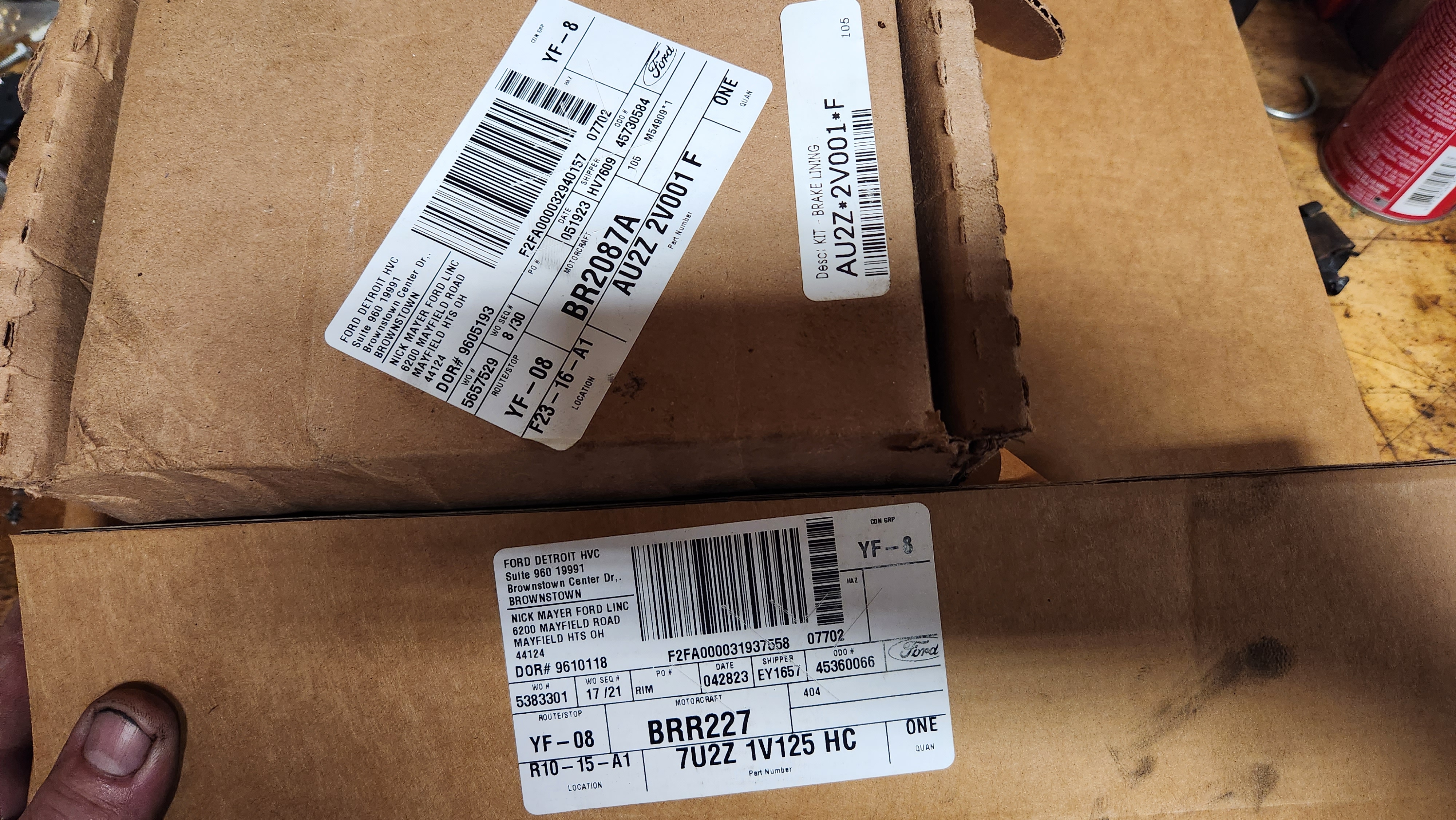

80,059 miles. Front brakes are done. For basically the same money as Autozone parts, I was able to get Motorcraft Rotors & Pads from Nick Mayer Ford in Mayfield Hts. Still need to install my plugs and coils.
