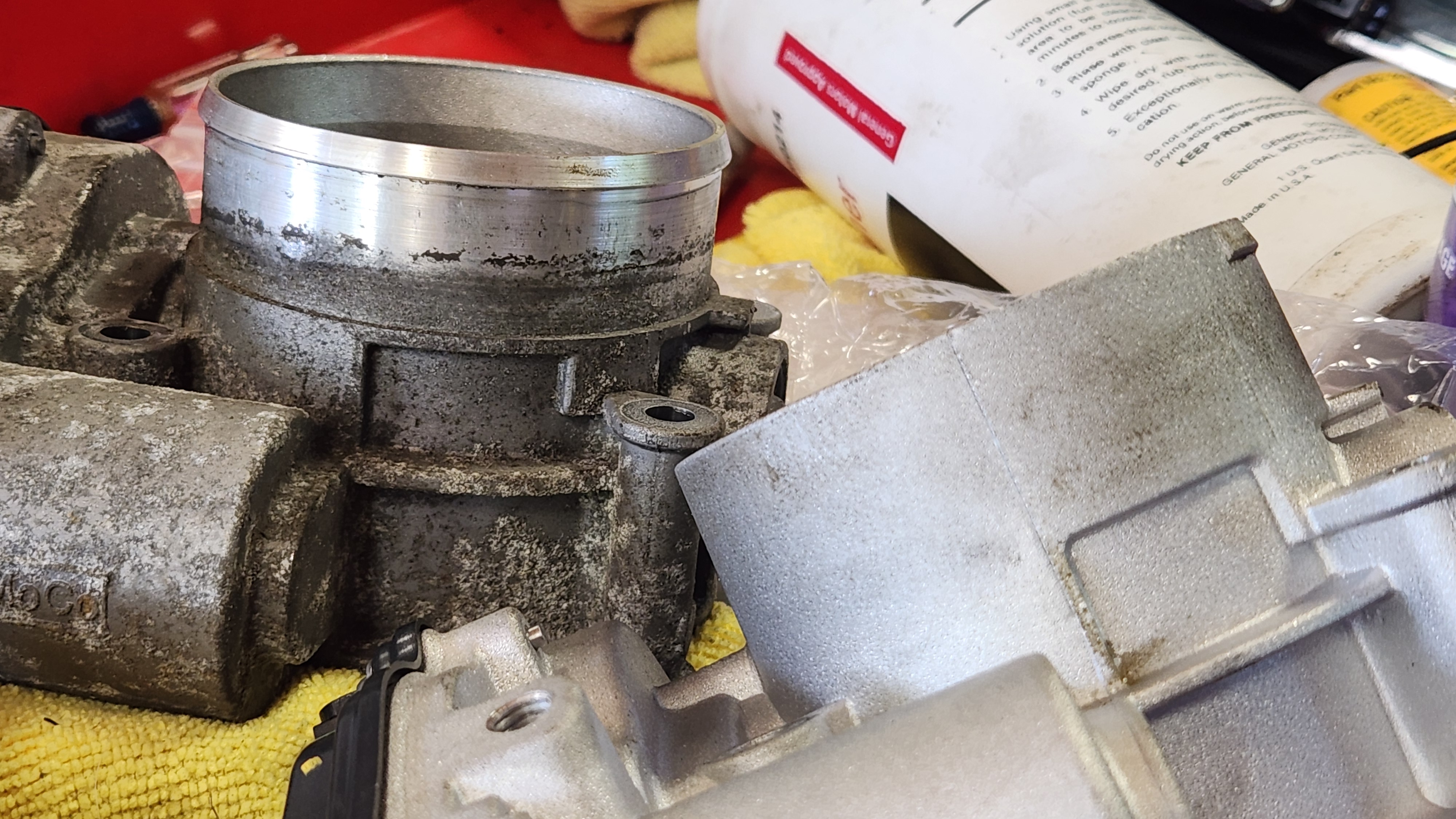

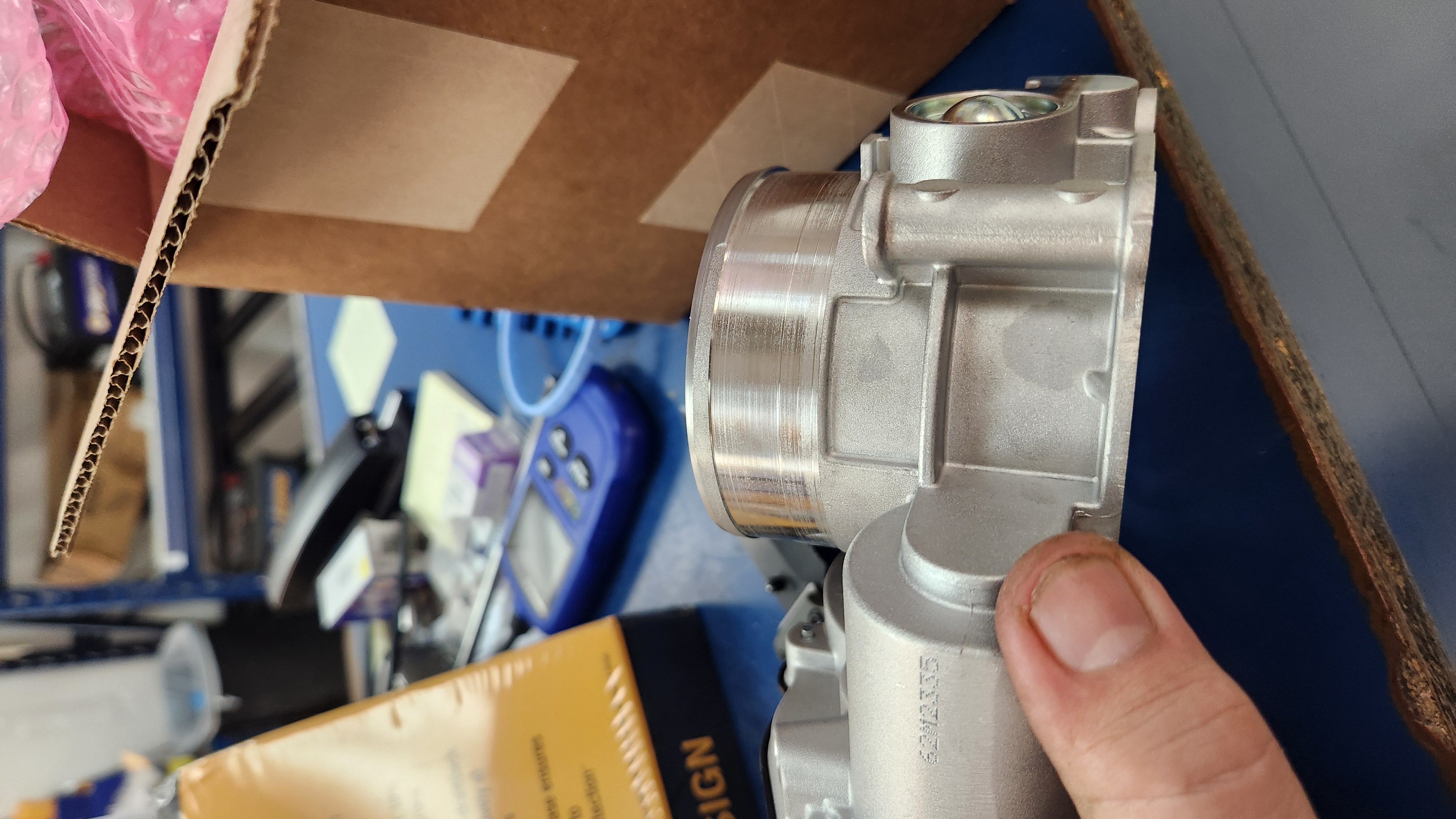

I was on my way to Thompson on Friday night with Maliboost in tow, when I got the dreaded 'wrench icon' on my dash. I hadn't even made it to route 306. When that wrench comes on, the truck is still running, but you have no throttle at all. You have to turn it off and restart the vehicle to reset it. It's very dangerous, IMO. I put it in neutral, turned it off, restarted and all was well again. I really don't want to get stranded with my trailer. It happened twice more before I got to Chardon, so I turned around, and it did it one last time before I got home.
Youtube said if theres a code P1112 or P2112, its likely the driive-by-wire throttle body. Looked them up, about $130. I went to Autozone in Chardon, picked one up and took it home. For a modern car, this is a pretty easy job. Two hose clamps, 4 bolts, 1 electrical plug, all very easy to access. I had the old one out and new one in probably under 15 minutes. Sweet..
But shitty Autozone parts strike again. The original one in the background, with a full 360* lip. Autozone piece has no lip, just a couple nubs on one side. As soon as I got on the throttle, I heard a pop, and very little power. The intake tube would pop off the moment you make any boost. I tried re-attaching and really tightening it 3 times. After that, I took it back. I went to Napa across the street and they had two different throttle bodies in stock, and both had a full 360* lip. New throttle body works as expected and I was able to tow on Saturday.
- Posts: 3690
Re: 2014 Ford F-150
Wow, that's completely terrible! I don't spend much time at AutoZone anymore. And after seeing this, will spend even less time there. C'mon man!
