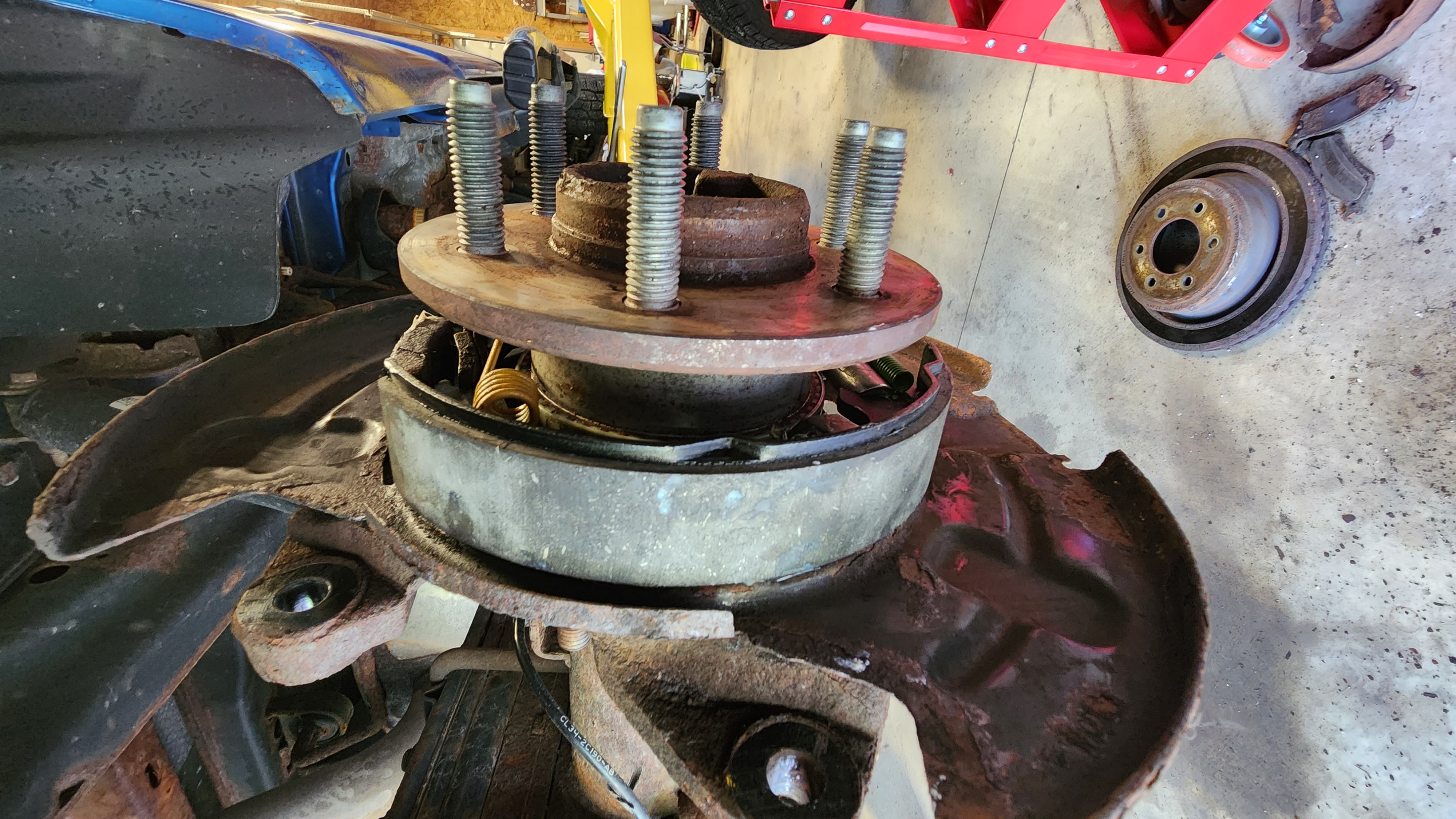

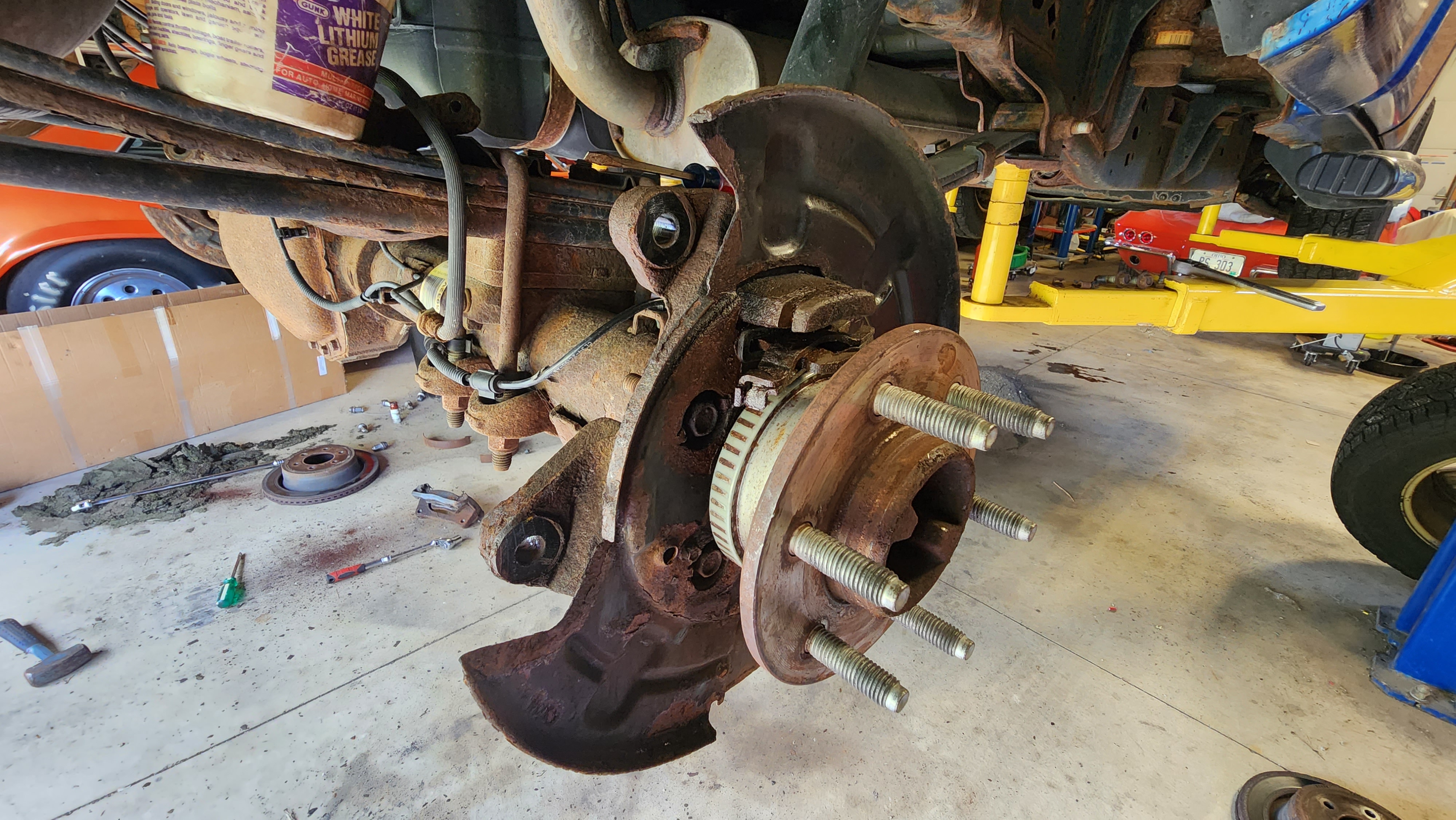

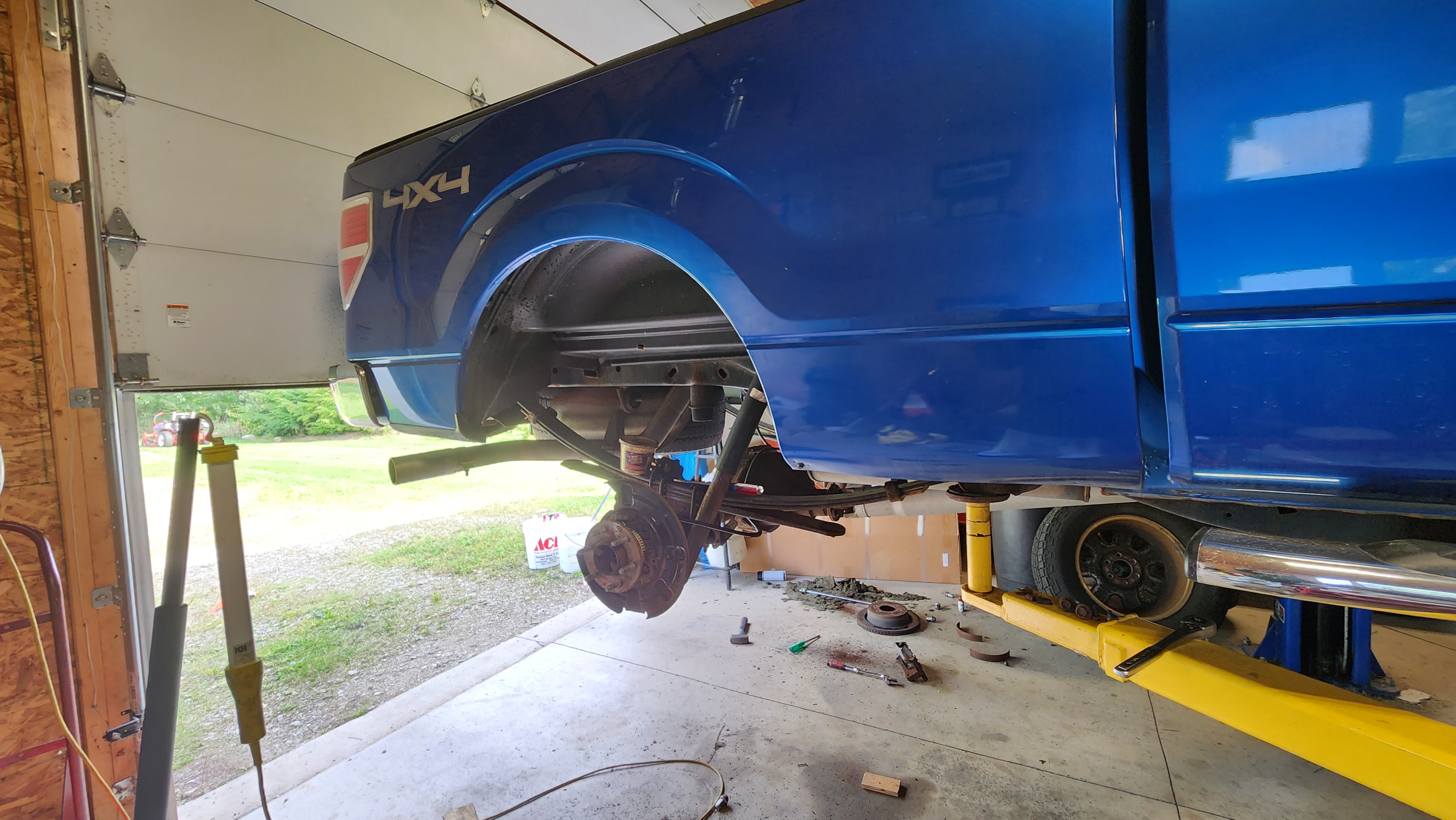

76,800 -- new rear brakes, new parking brakes (ugh) , oil change, new wipers.
This job just kinda sucked from start to finish. All the lug nuts came right off, which should've been my sign it wasn't going to go well, because right after that I couldn't get the wheels off the truck. After lots of donkey kicking to no avail, I spayed some WD40 into the lugs holes, tried dropping it from the floorjack, tried dropping onto a piece of wood on the inside edge of the tire, DROVE up and down the driveway with the lugs loose.. A few days later, I crawled under it and kicked the tires from the inside with both feet at once. Only took a couple kicks that way.
The brake calipers came right off on both sides, without any issue. The first rotor took a lot of beating, sorta damaging the parking brake drum hardware. After finally loosening the star wheel (which moved easily, surprisingly), it came off. I got smart on the 2nd side and tried loosening it first. It worked great, the rotor basically came right off -- and the shoe material for the parking brake fell right to the ground from both shoes. So now I get to do 4 brakes, including a pair of drums, instead of just an easy pair of discs. I hate drum brakes.
Some of the youtube videos for doing this job talk about popping open the diff and pulling an axle. Doing that would make this whole thing easier, but NO way I was gonna pop that open for a parking brake. 1 of the 4 pins that hold the drum brake shoes (the last one, of course) fought me tooth and nail. The first 3 were relatively easy. The last one, I dunno, just fought me forever.

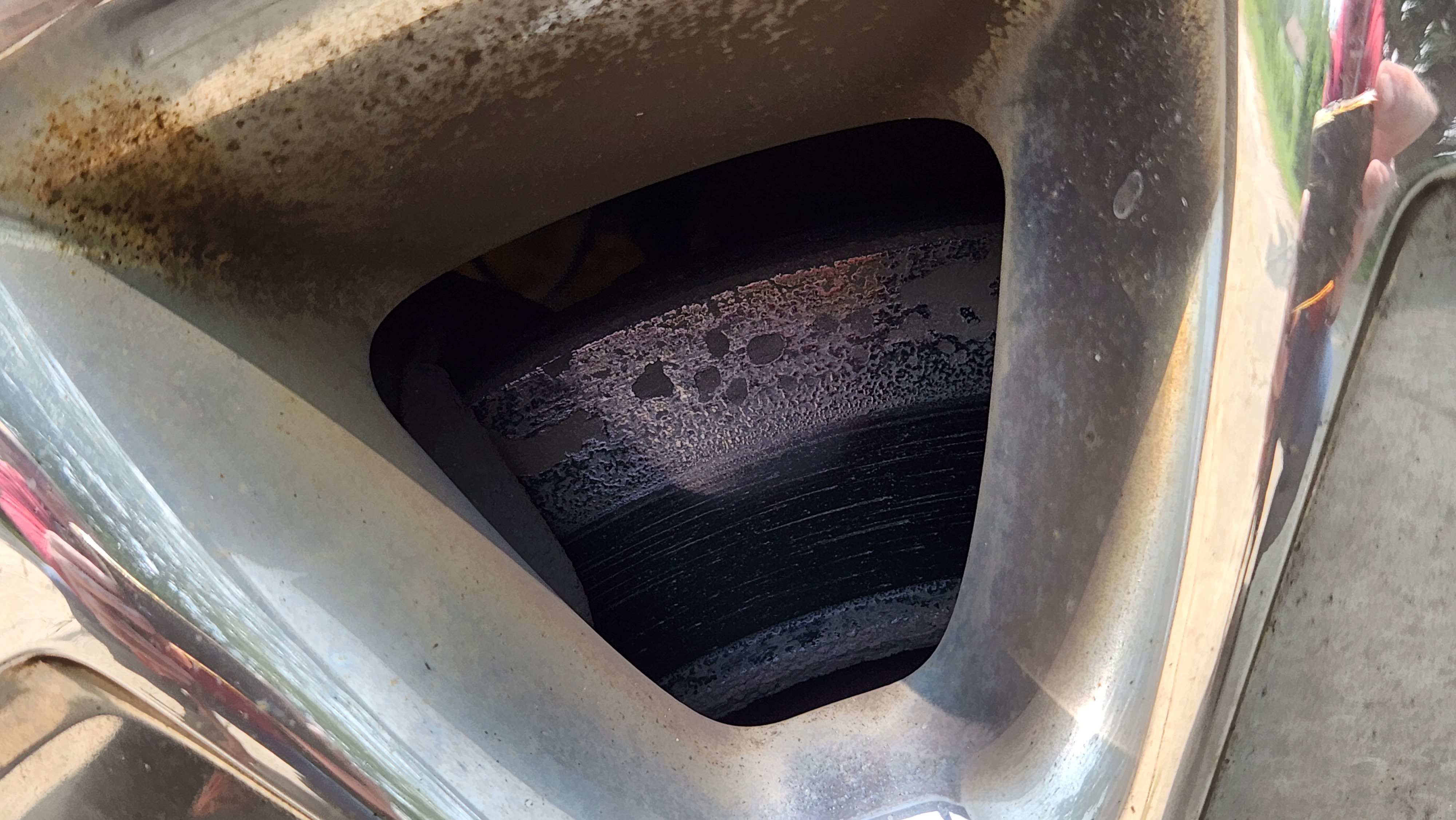

I started hearing a grinding noise up front and looking into the wheels, I saw this..after barely 18 months and 9k miles, my front brake rotor is junk:
These are Napa 'premium' brake rotors. And they won't do anything for it.- TireSmoker

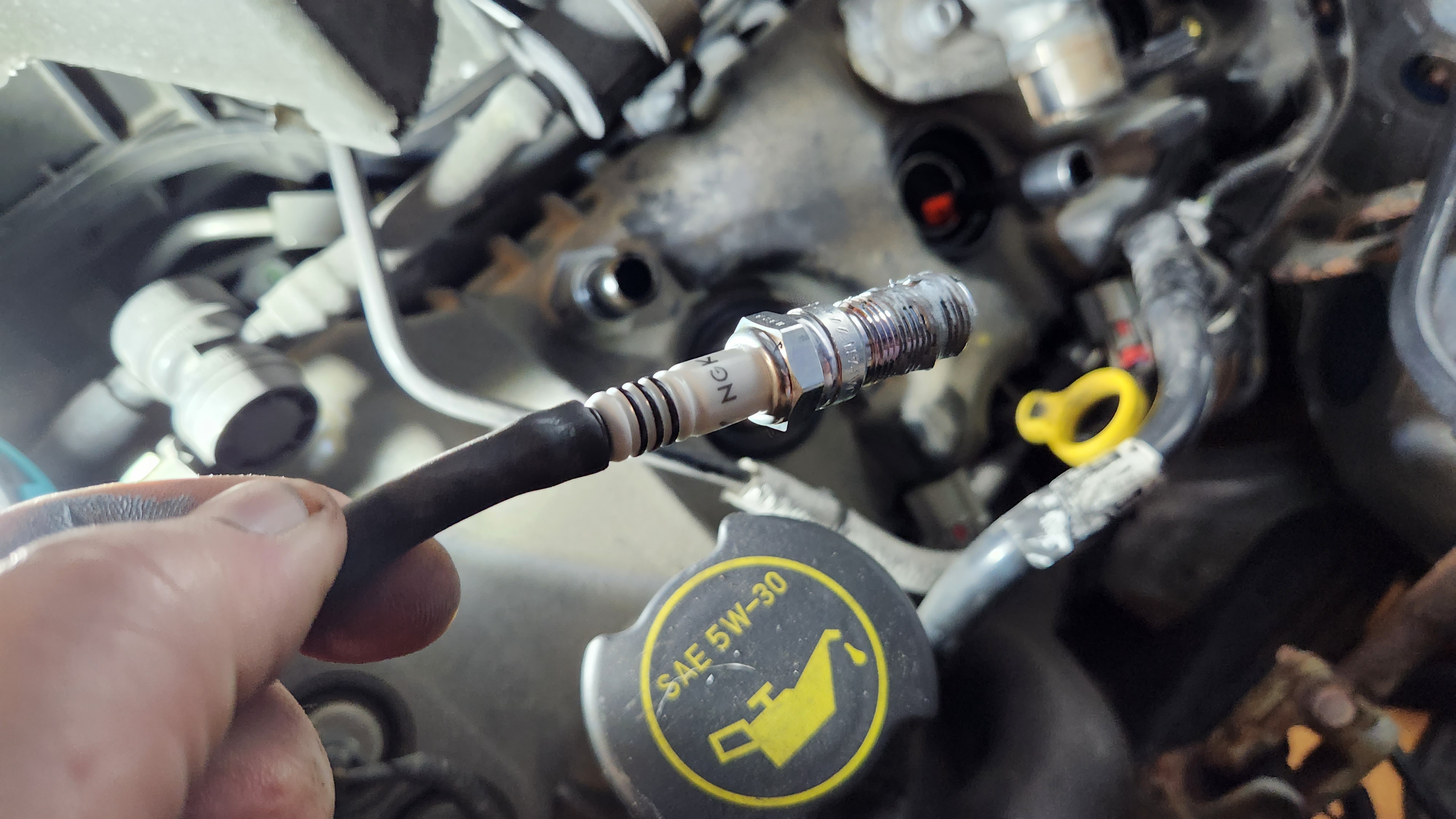

80,067. Plugs and coils are done. All said, it was a pretty painless job. It would've been easier with a spark plug socket that has the rubber insert, but I just used a short piece of fuel hose to retrieve the plugs out of the hole, and a piece of vacuum hose over the tip to re-install.
The old plugs have a Ford logo on them, so they are likely original. New NGK LTR6IX 94374 plugs with Delphi GN 10638-11B1 coils. A short test drive confirmed that it no longer misfires under heavy load.

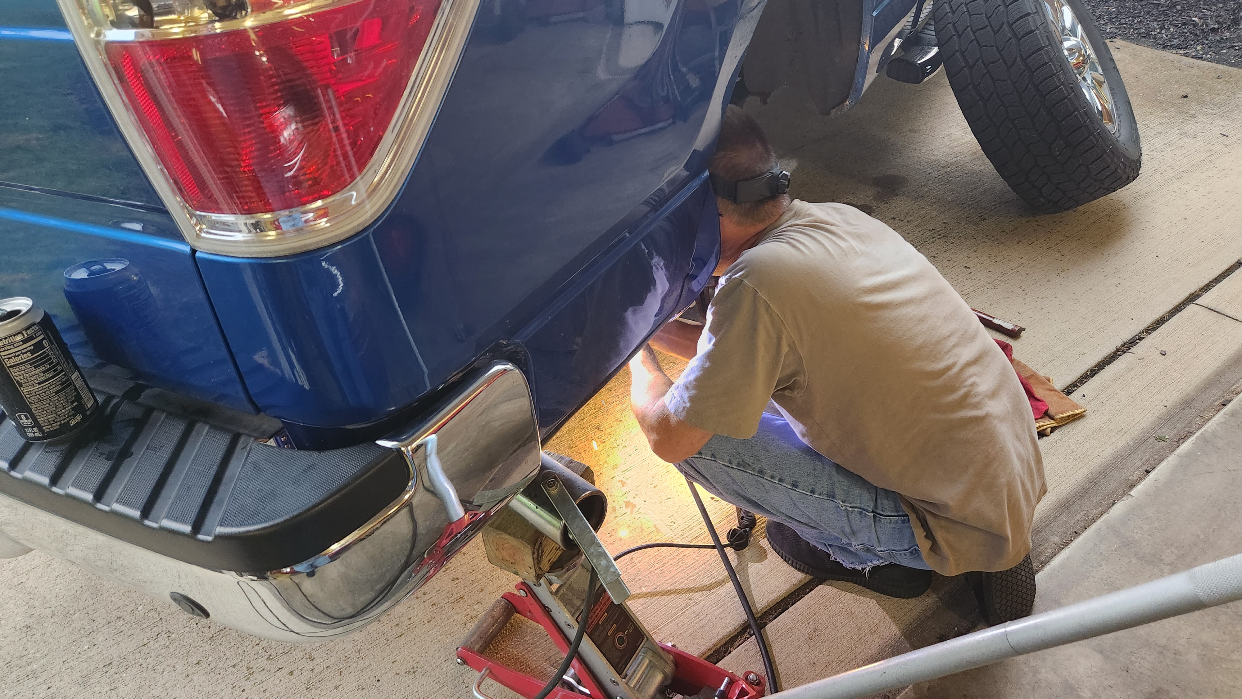

A couple weeks ago, I started getting a bad/weird vibration in the Tiresmoke TurboTruck while taking the dog to the vet. It was bad enough that I pulled over to see if there was a big stone stuck in the treads or something. Didn't find anything. I made it home with only minor vibration. I went for a drive later that evening and it was completely fine. ???
The next morning, I came out and saw the tailpipe hanging. It wasn't rubbing anything, it couldn't have caused the vibration. But still needed to be fixed -- the factory hanger's weld corroded/failed. Paul said he could weld it up for me. Last Wednesday 9/6, I drove up to his house and the vibration came back. We could just feel heat radiating from the LR wheel that didn't exist on the RR wheel. Probably a hung caliper.
Paul was able to get my tailpipe hanger all welded up and solid. On the way home, I stopped at Autozone to pickup a caliper. By the time I got home, it was around 9pm and I was pooped.
