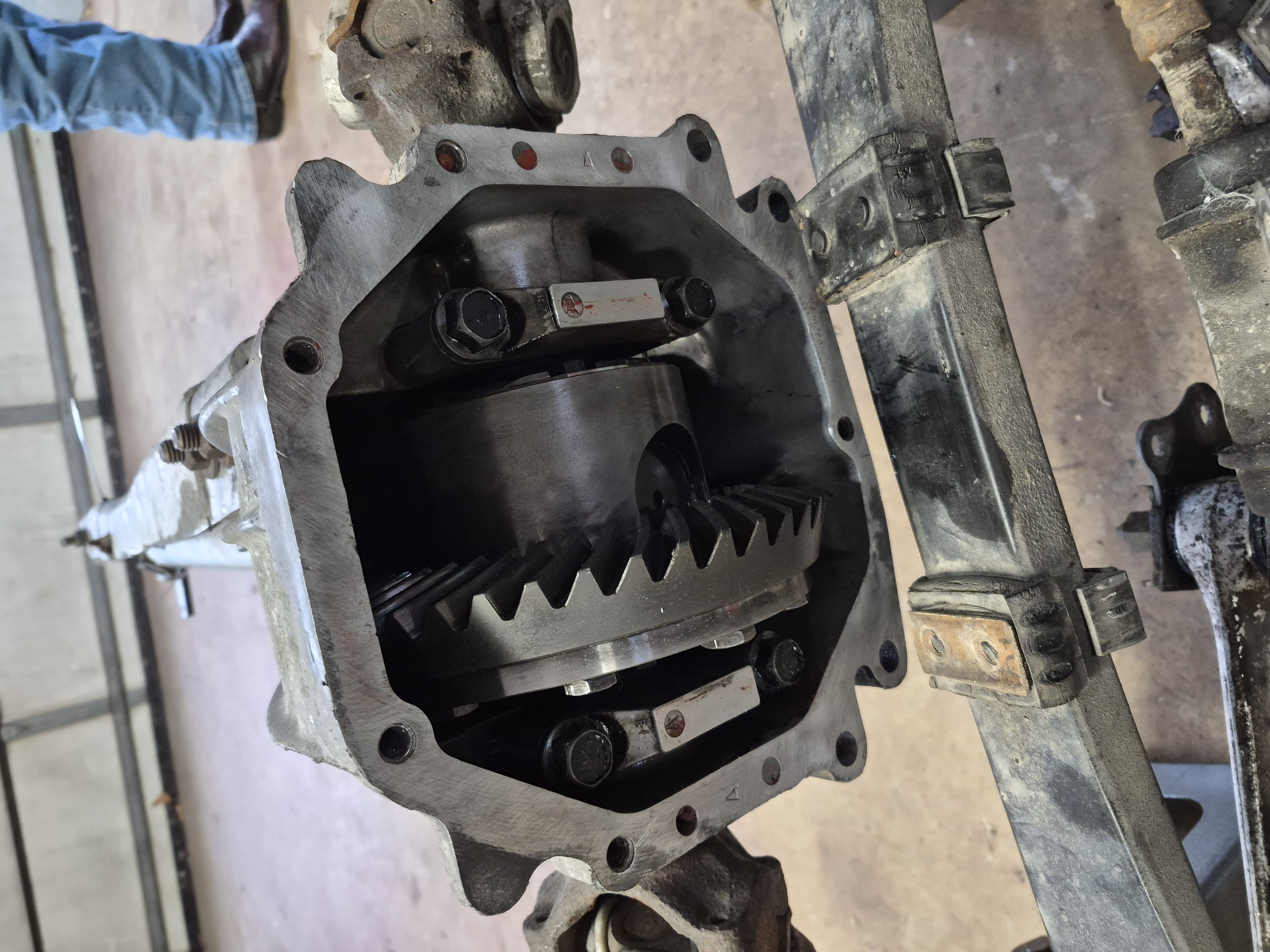

Today we finished with the bushing replacement on the rearend, and it got close to two quarts of fresh synthetic 75-90 rear diff oil and a tube of posi additive. Next week we'll make a plan and start getting after taking the old Dana 36 out.

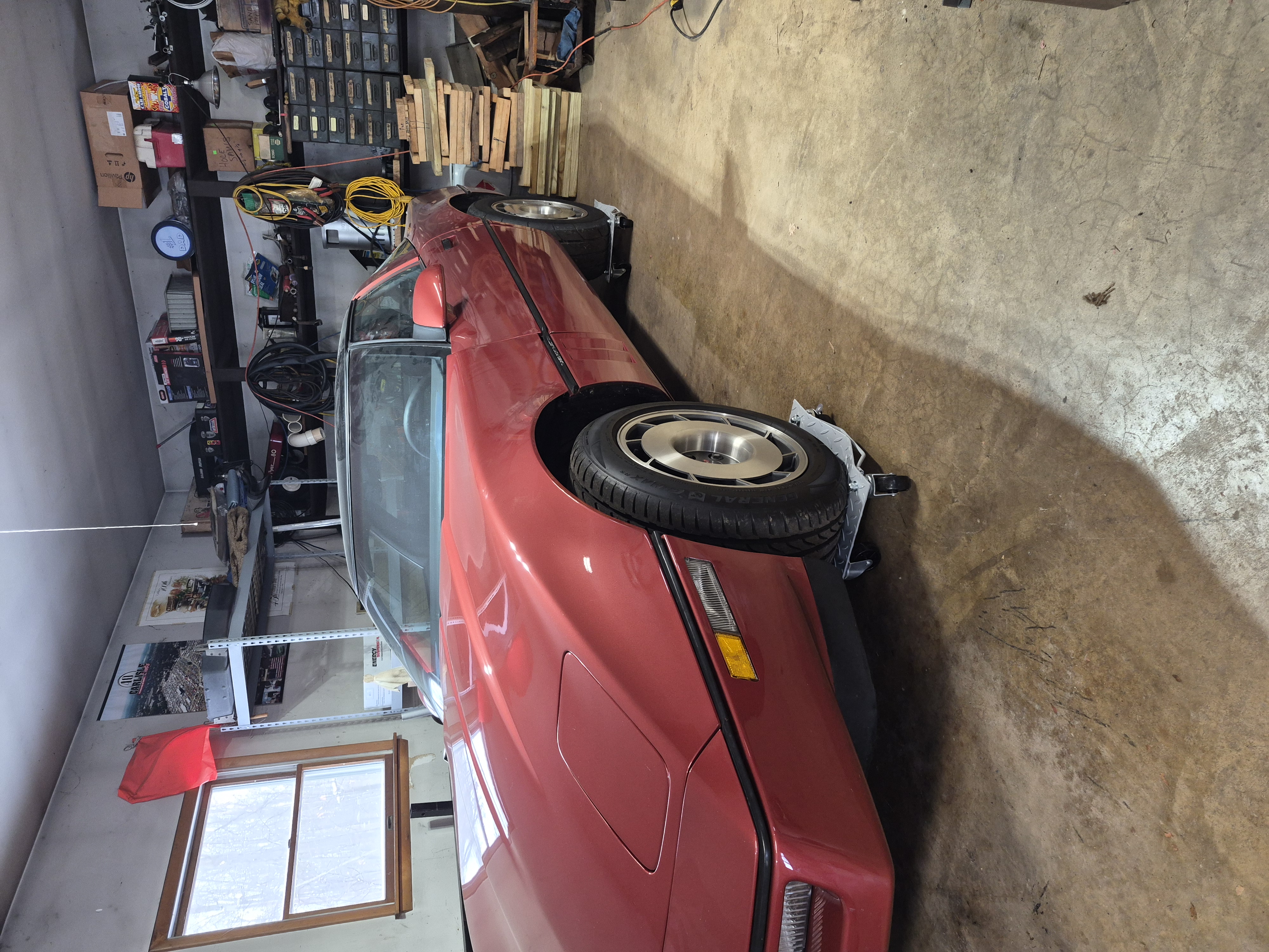

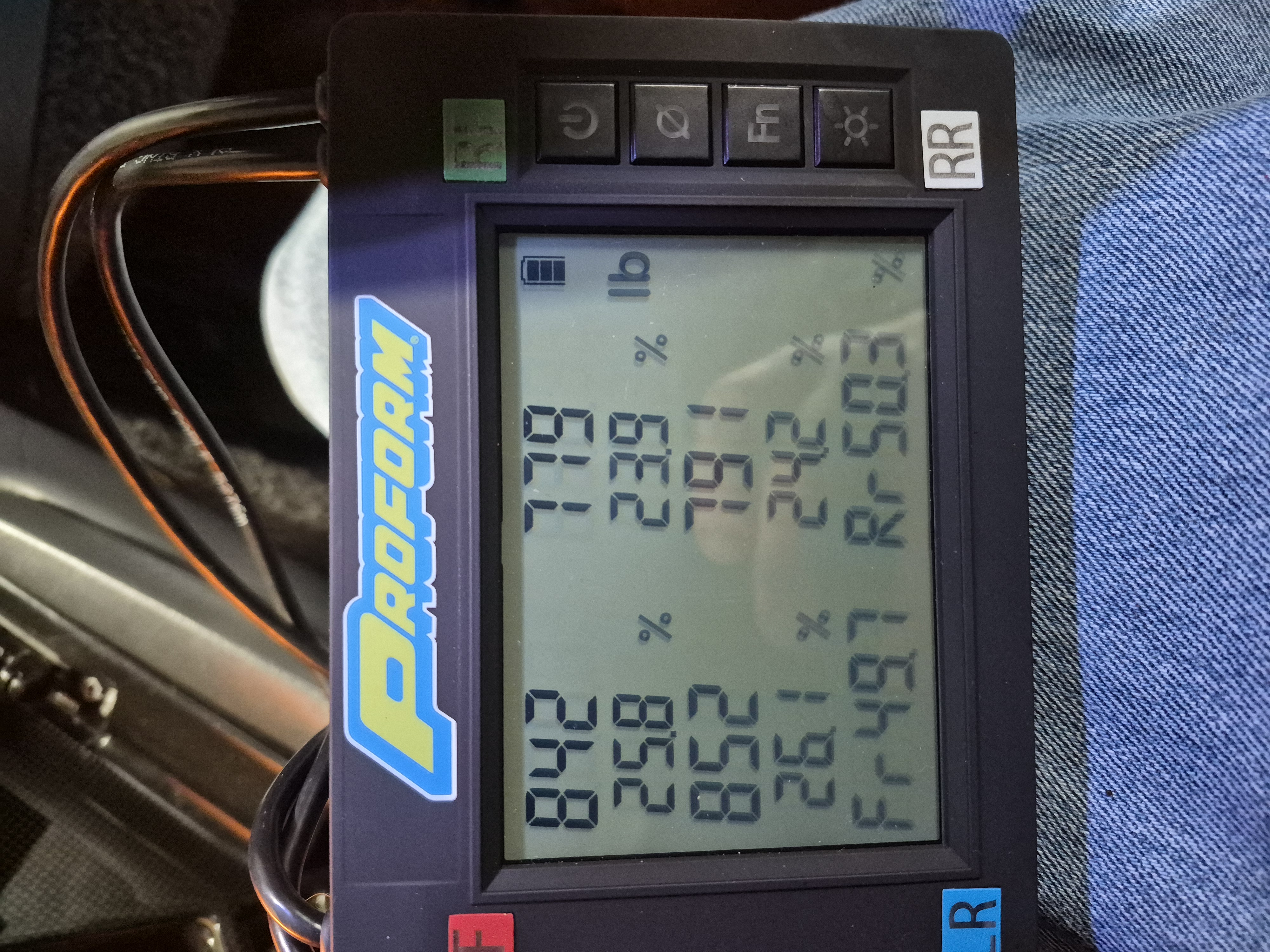

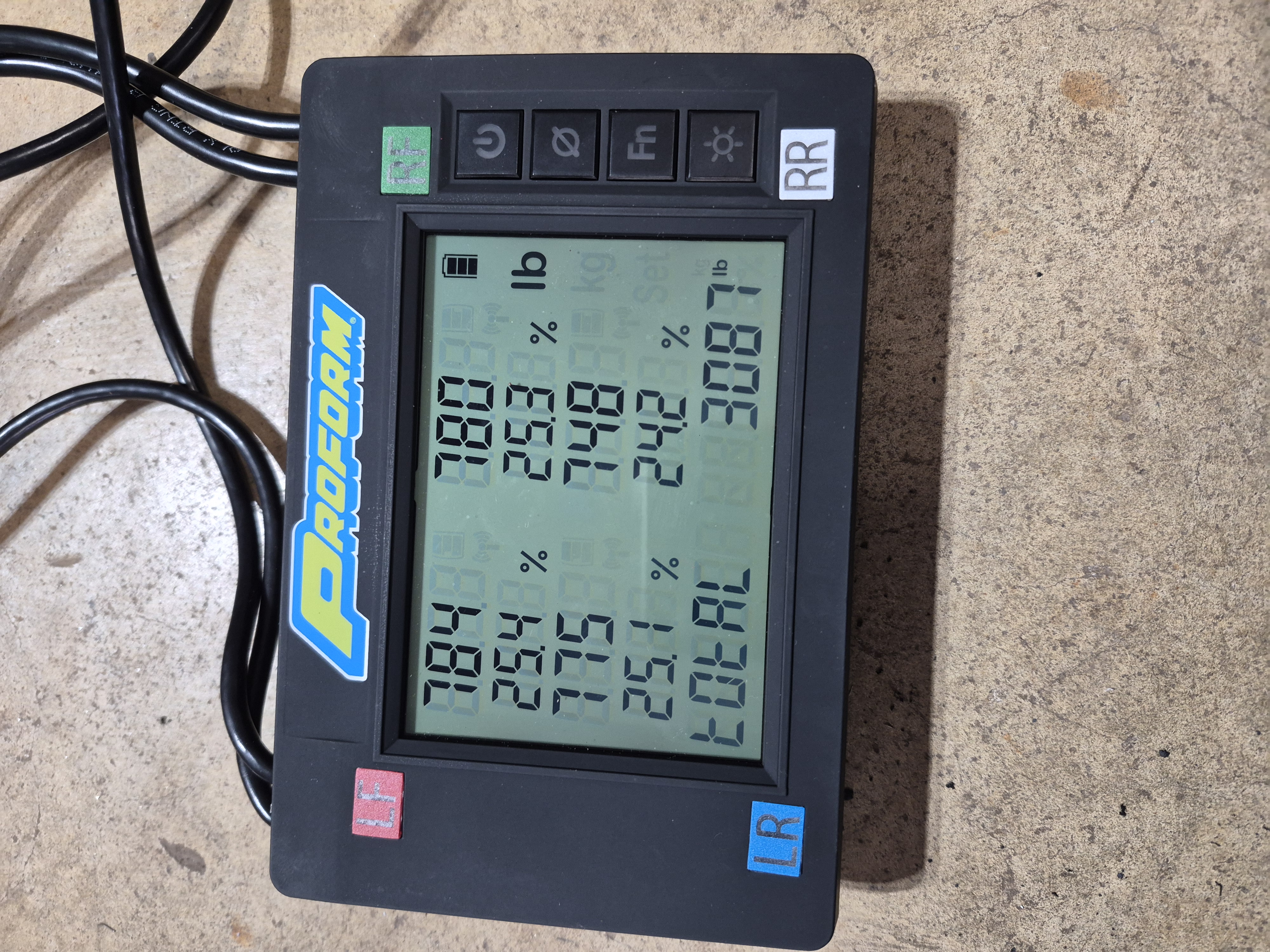

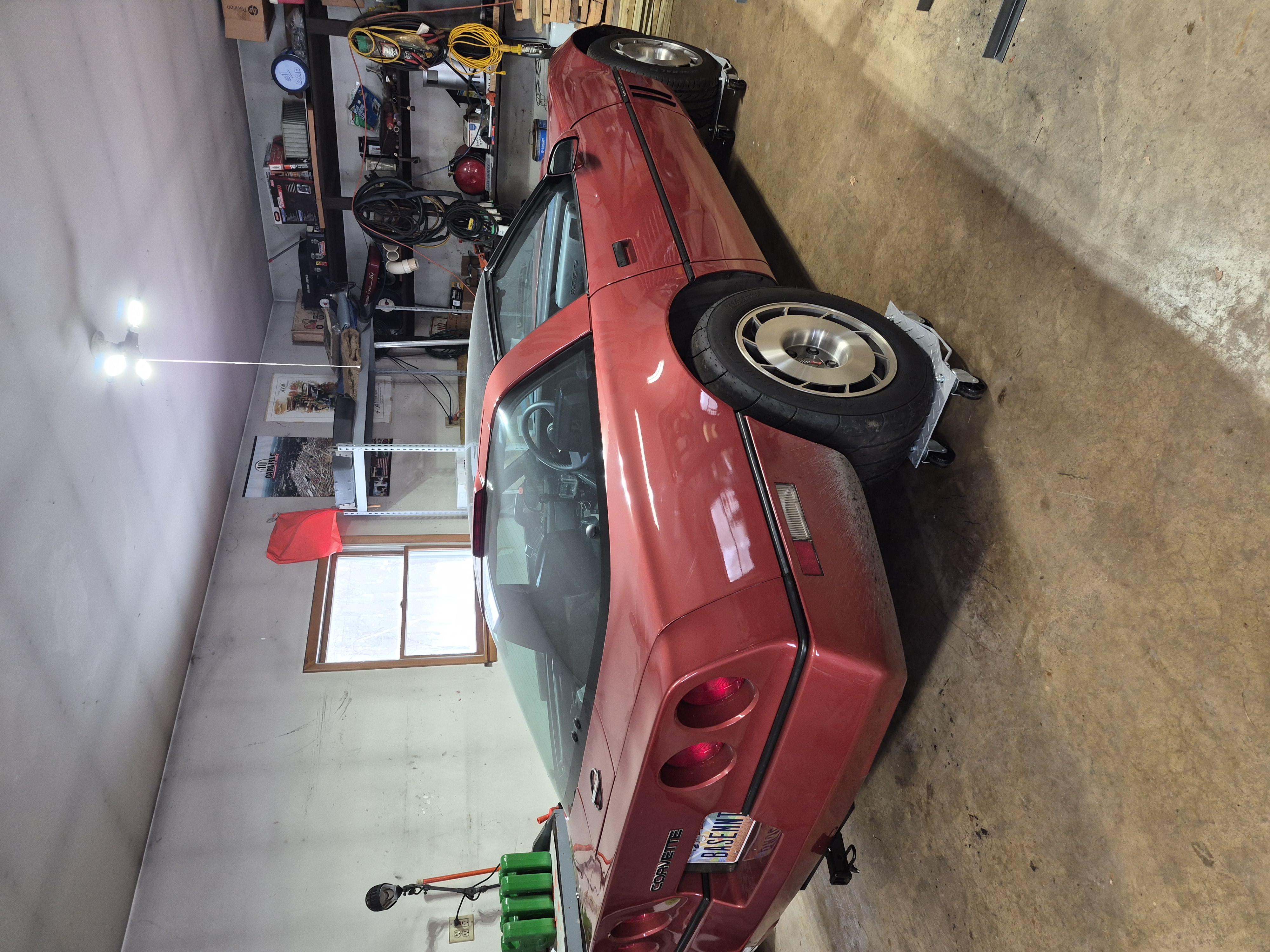

I bought some Harbor Freight wheel dollies to help up spin this thing around in the garage. They worked pretty well with no issues.

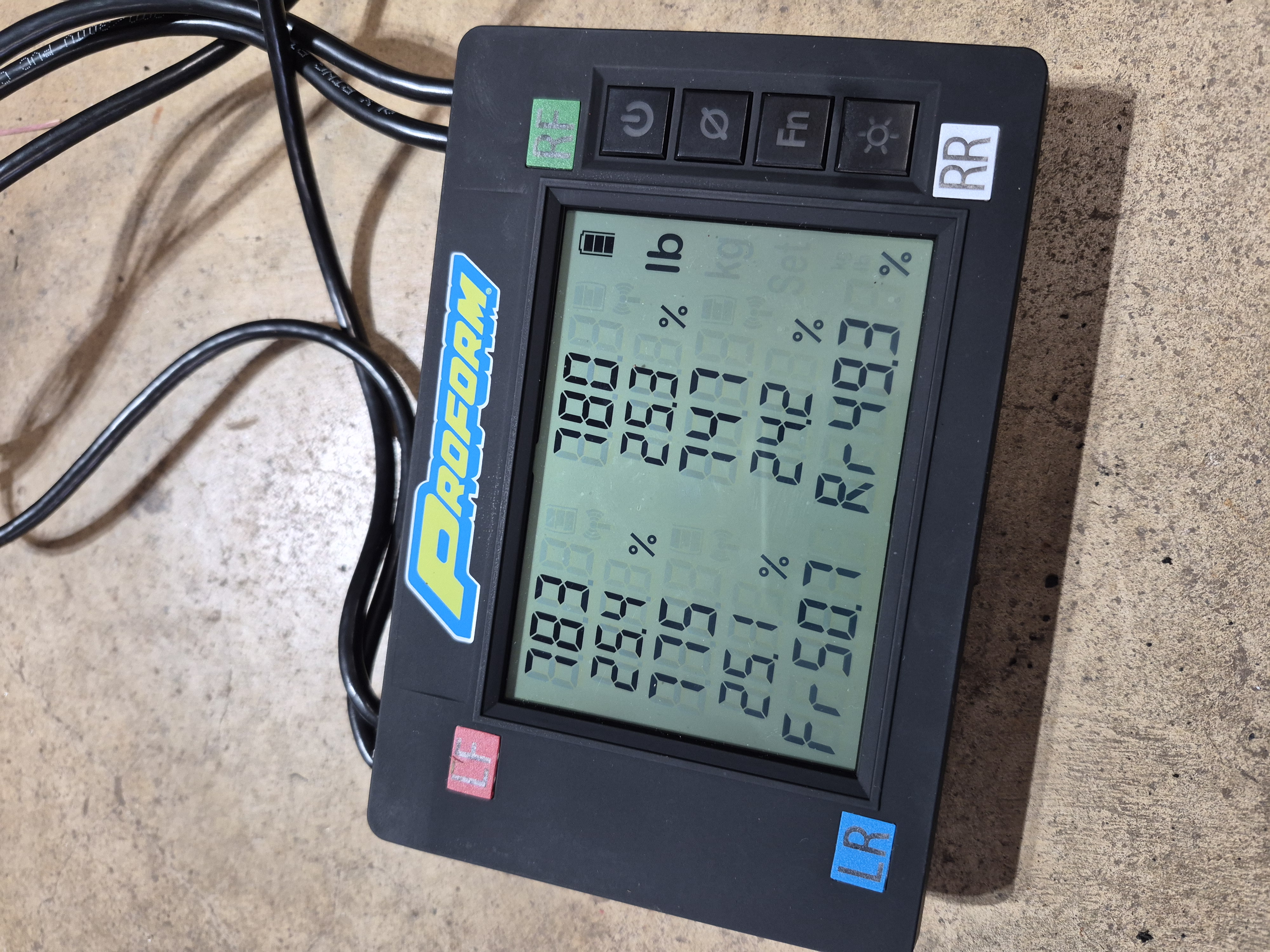

Before we put the car on the dollies we put it on the scales for the first time since the engine swap. In this scenario it had a full tank of gas too. The pictures with my legs in them are with me sitting in the driver's seat. The balance is pretty amazing. I can see me moving the battery from the LF to the RR eventually, but probably not until next winter.

It was 3124lbs before with almost a full tank also...
Posts: 3020
Re: 1987 Corvette Z52
There’s a nice compartment on the right side behind the seat where the battery could fit. Interesting after the changes you made how well balanced it is. Like no A/C and the LS have to be taking weight off the front. The 44 adds a little to the back also

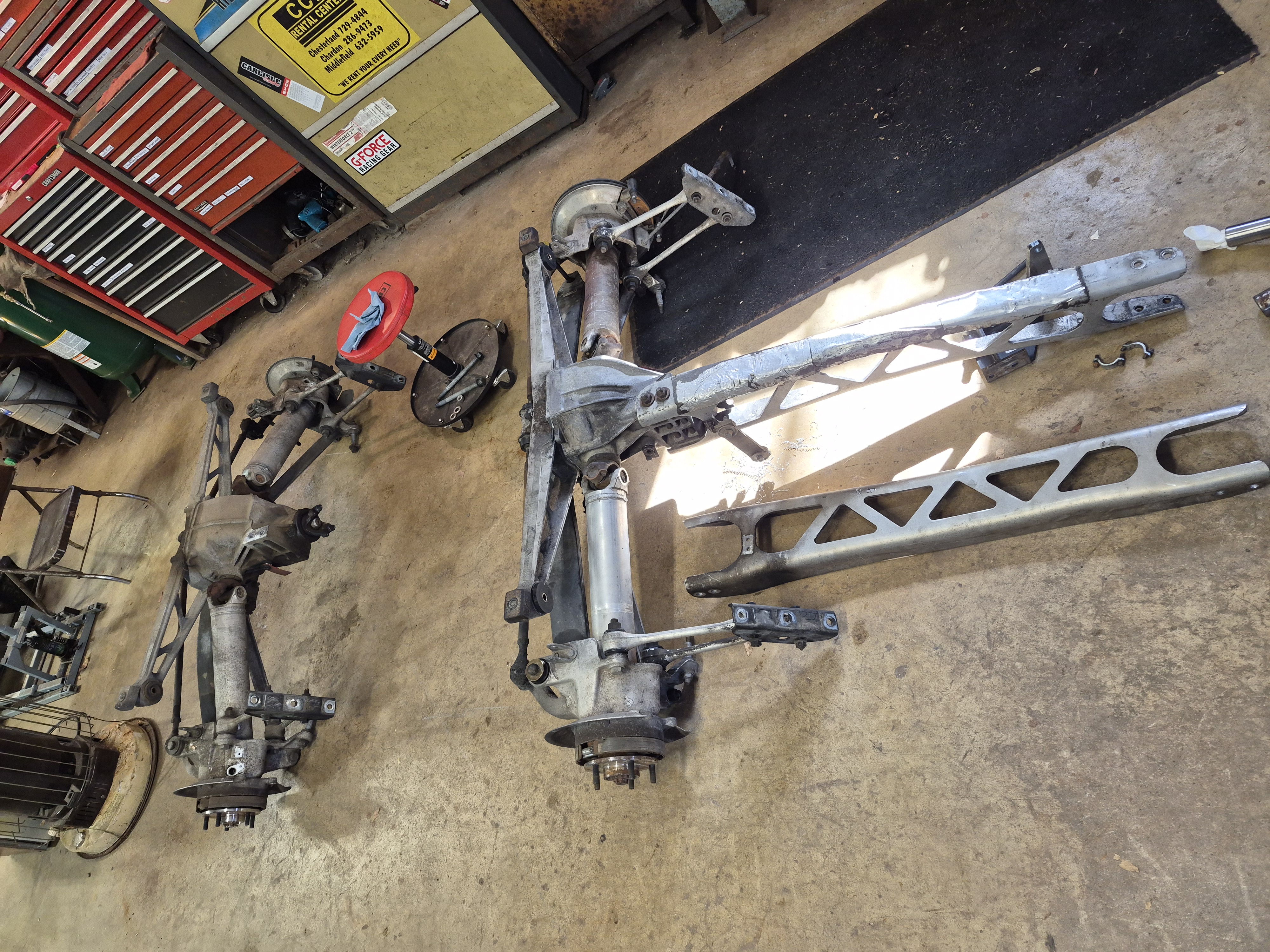

At this point there is only the two batwing bolts holding the assembly in the car, and they are loose. Next weekend it will come out and we can swap anything we're going to swap before we put it back in. The Dana 44 assembly does not have ABS provisions, so whatever the piece is that holds the hubs in place is called, will likely get swapped, along with all the brake parts. We put new hubs in those too, so we know they're good to go.
Posts: 3640

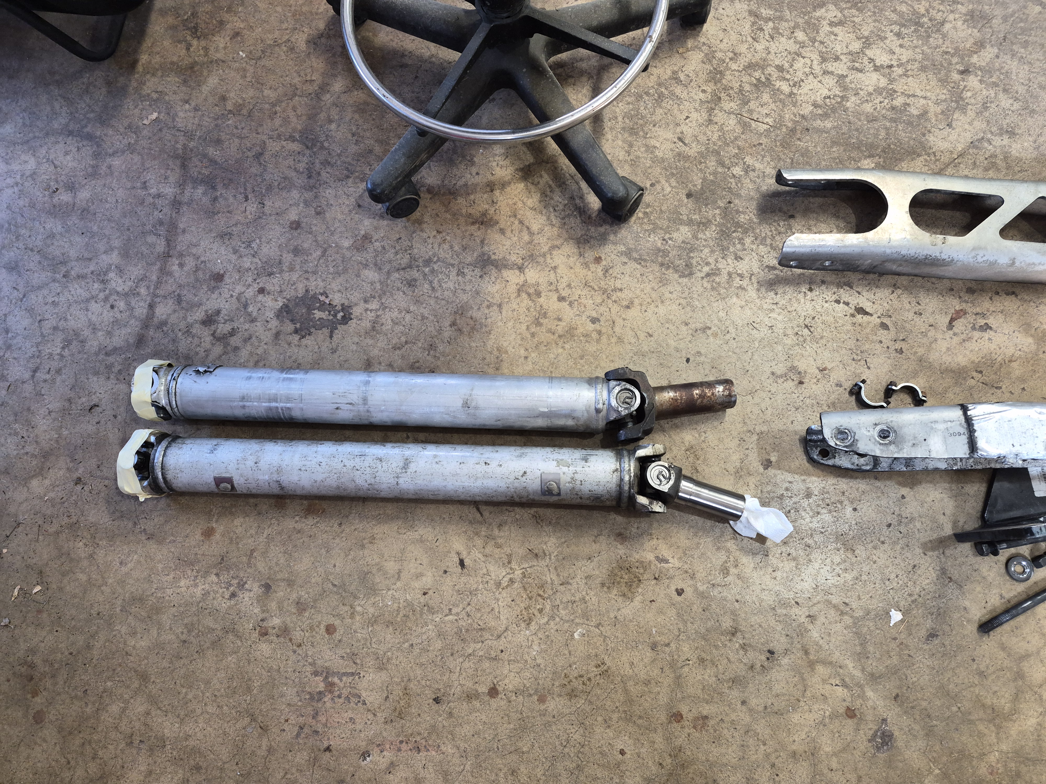

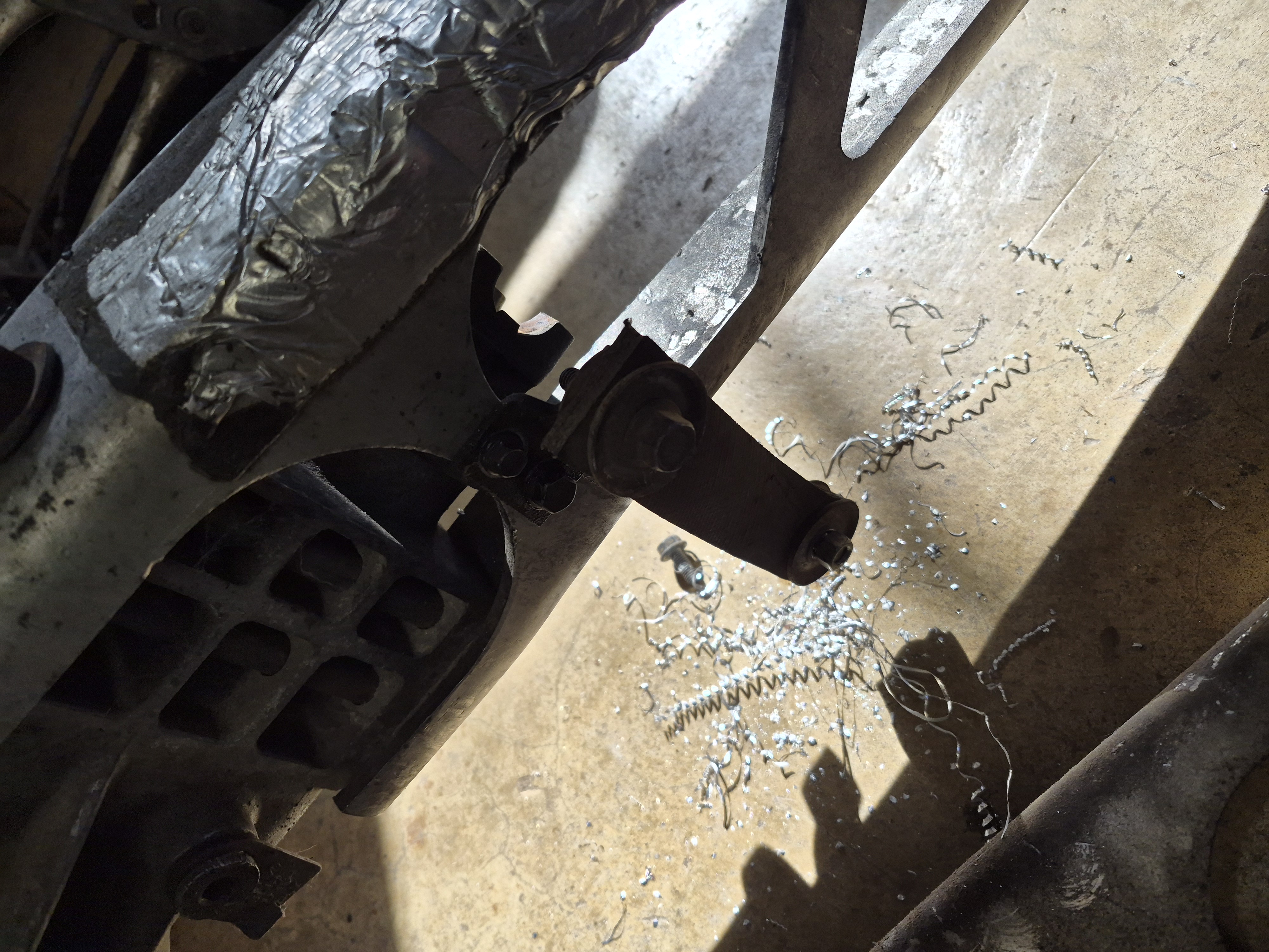

The assembly is now out and on the floor. Definitely going to need the shorter driveshaft and a yoke swap. We also got the exhaust bracket moved from the old torque arm to the new shorter one that never had one.
Next will be swapping the hub mounts from the old assembly to the new one, and likely new ujoints for the current half shafts.
