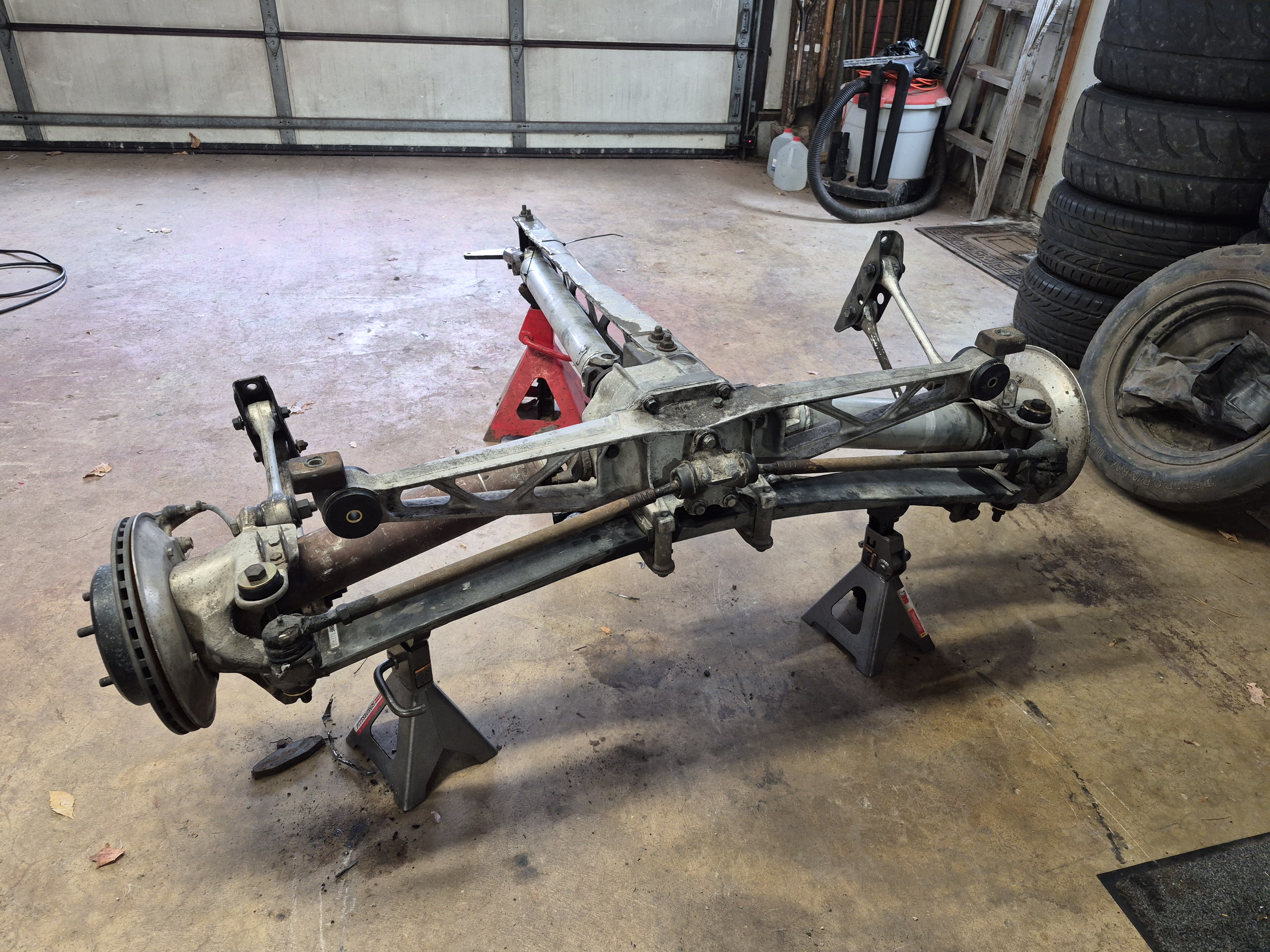

Today got the car up on blocks and stands. We pulled the complete exhaust off, my favorite front two bolts from the torque arm, the rear shocks, brake calipers, and sway bar end links. I think next week will likely be able to get the rest of the assembly out of the car in one unit.
- Posts: 3665
Re: 1987 Corvette Z52
At this point there is only the two batwing bolts holding the assembly in the car, and they are loose. Next weekend it will come out and we can swap anything we're going to swap before we put it back in. The Dana 44 assembly does not have ABS provisions, so whatever the piece is that holds the hubs in place is called, will likely get swapped, along with all the brake parts. We put new hubs in those too, so we know they're good to go.

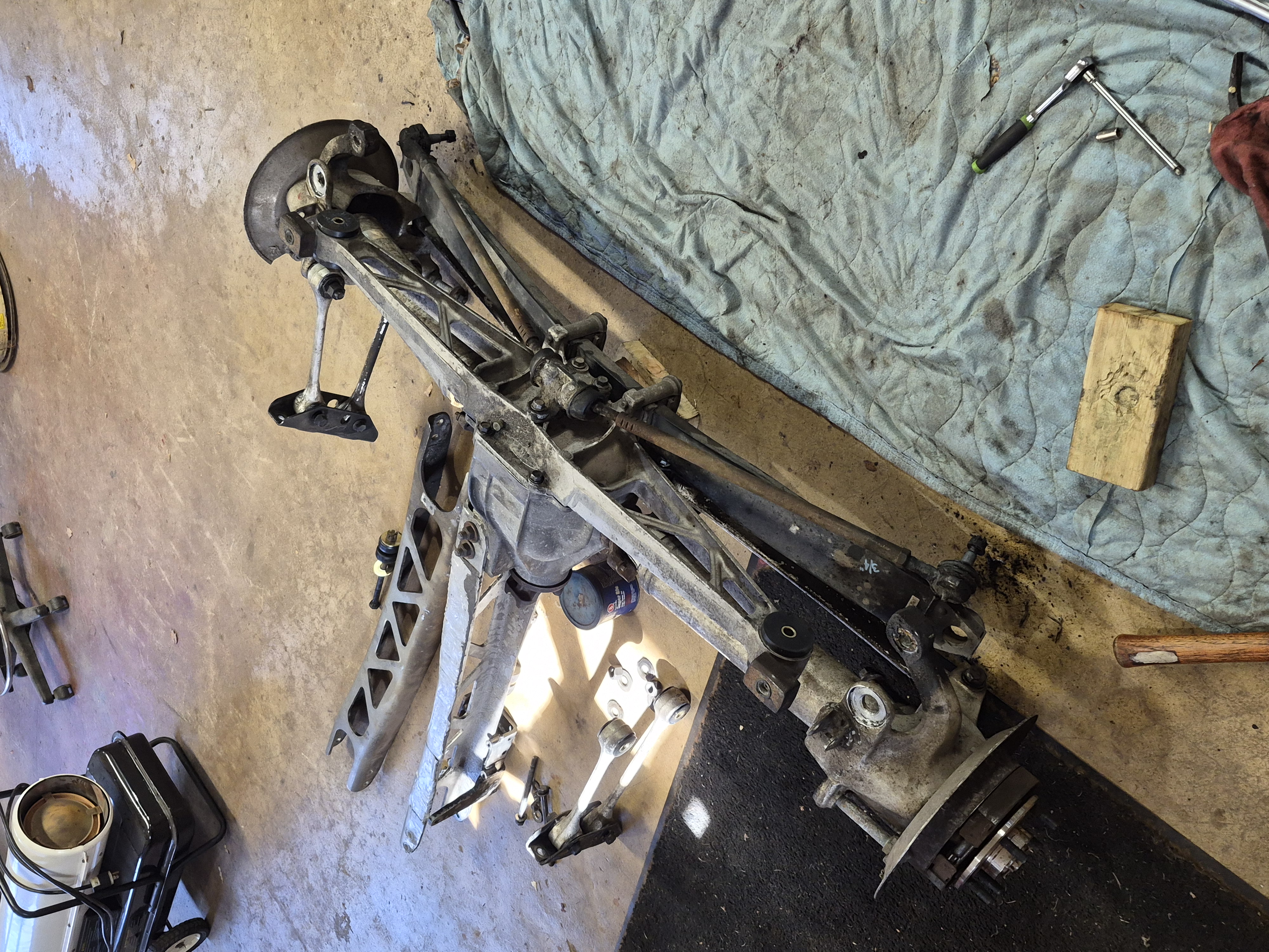

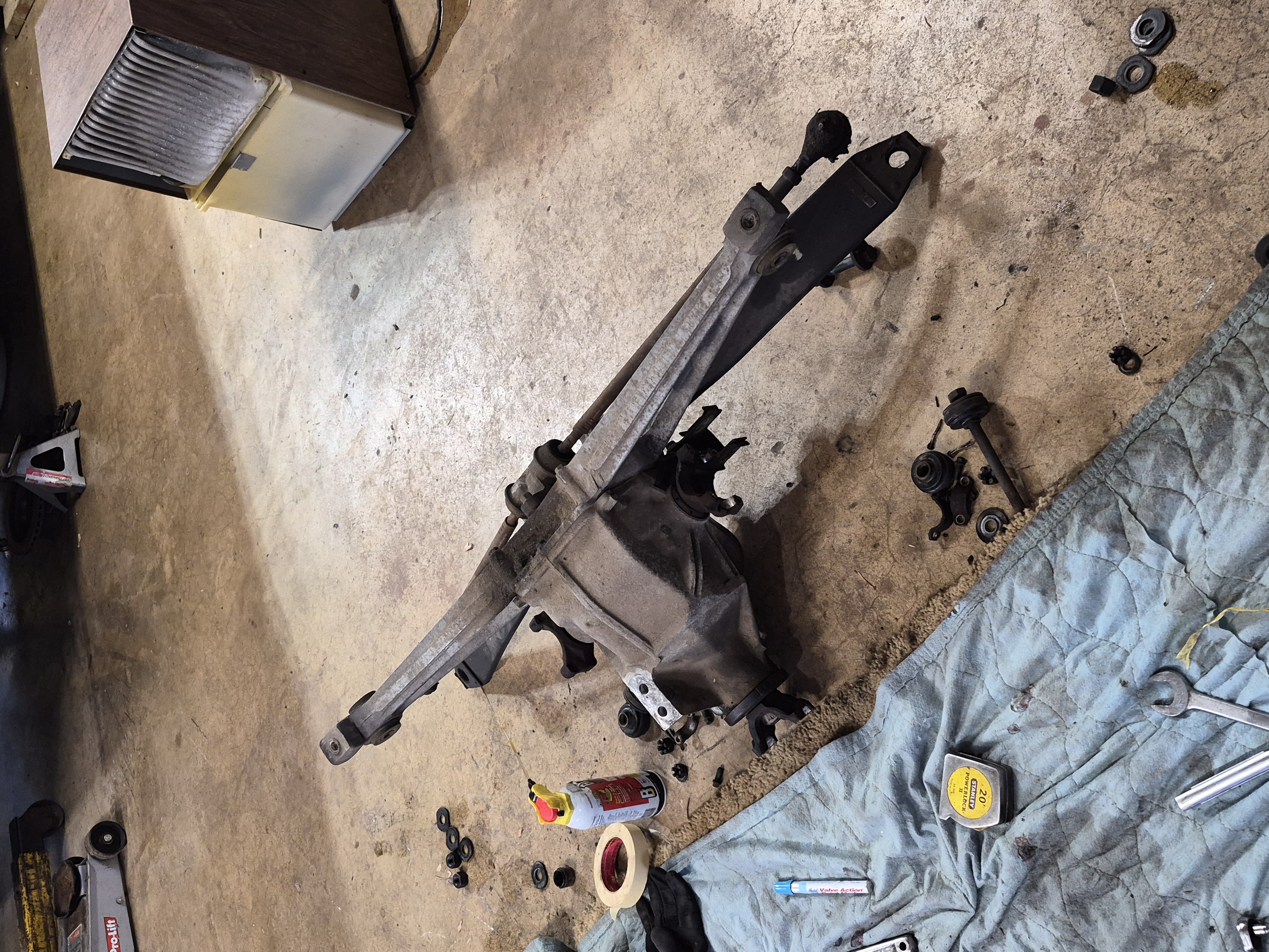

The assembly is now out and on the floor. Definitely going to need the shorter driveshaft and a yoke swap. We also got the exhaust bracket moved from the old torque arm to the new shorter one that never had one.
Next will be swapping the hub mounts from the old assembly to the new one, and likely new ujoints for the current half shafts.

- Posts: 3665
Newbury Auto Parts swapped in four new u-joints into the original '87 half shafts, and moved the yoke and u-joint from the longer shaft to the Dana 44s shorter one. We were able to move the parts from the '87s rearend assembly over to the Dana44 to make it up to '87 specs as far as the ABS is concerned too. Basically the hub mounts. Next week will be just a couple minor tasks before we try to get it at least mounted up under the car again. A couple more sessions should get it on the road again.
