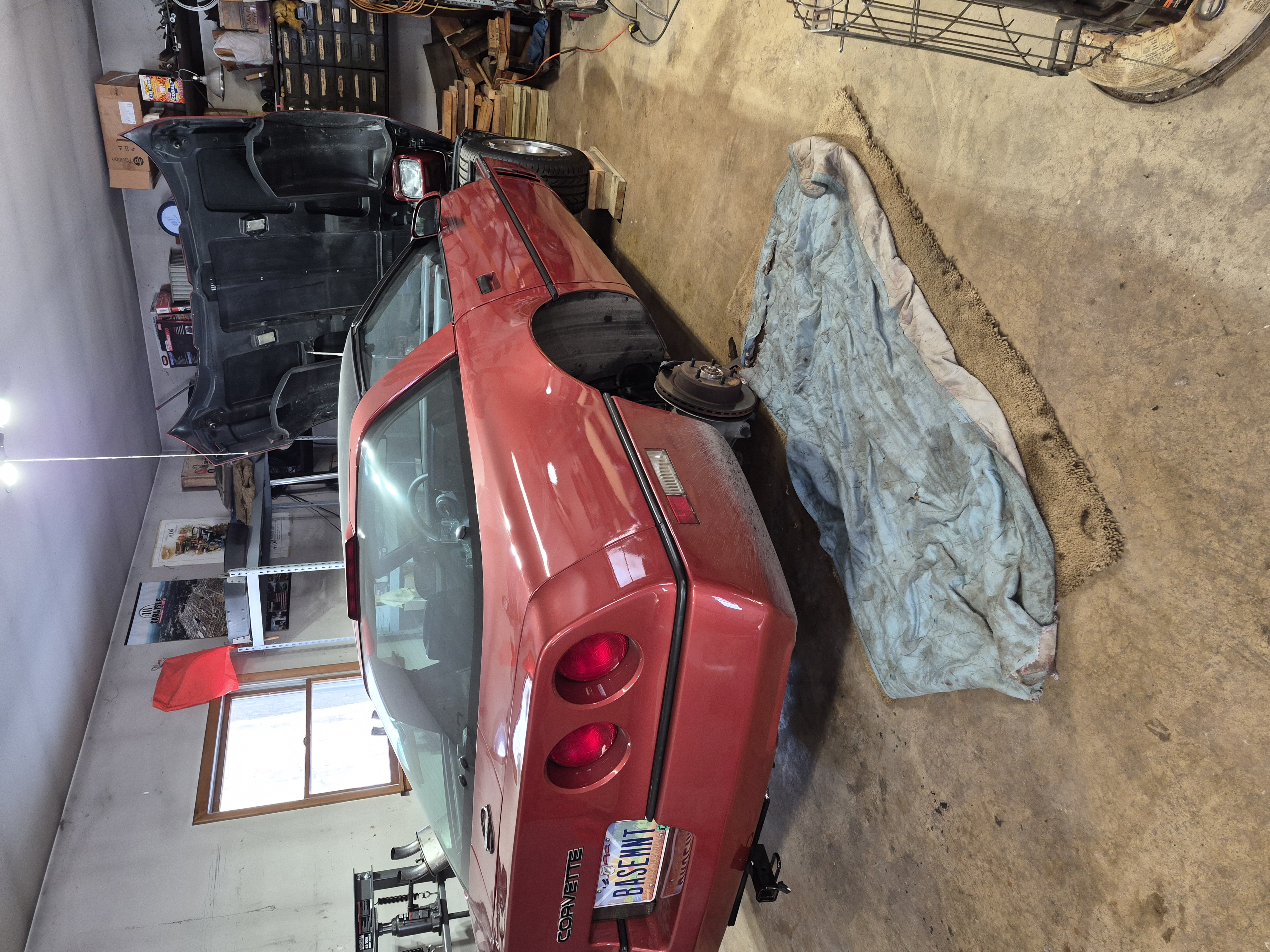

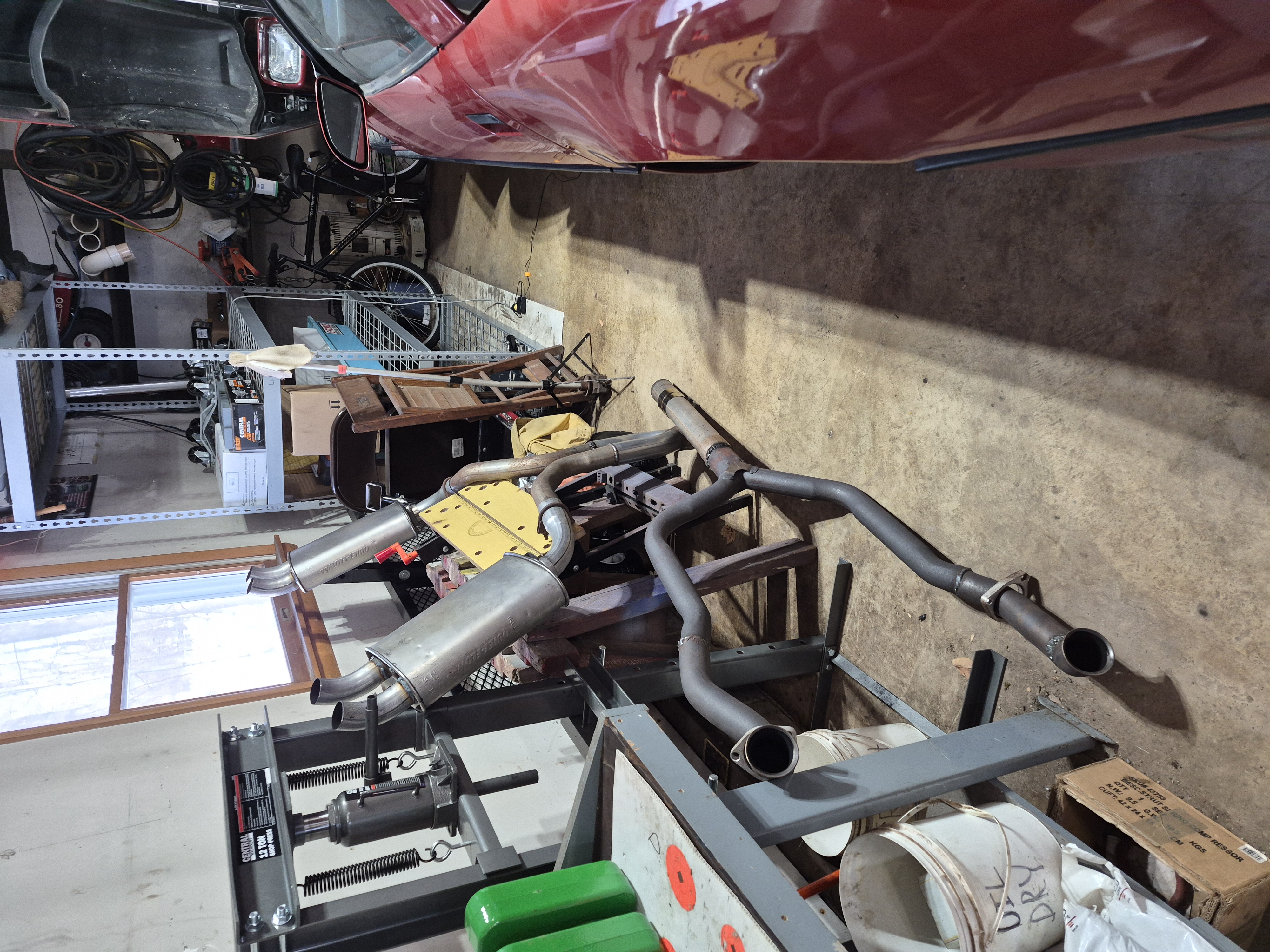

Posts: 3635
Re: 1987 Corvette Z52
Today got the car up on blocks and stands. We pulled the complete exhaust off, my favorite front two bolts from the torque arm, the rear shocks, brake calipers, and sway bar end links. I think next week will likely be able to get the rest of the assembly out of the car in one unit.
