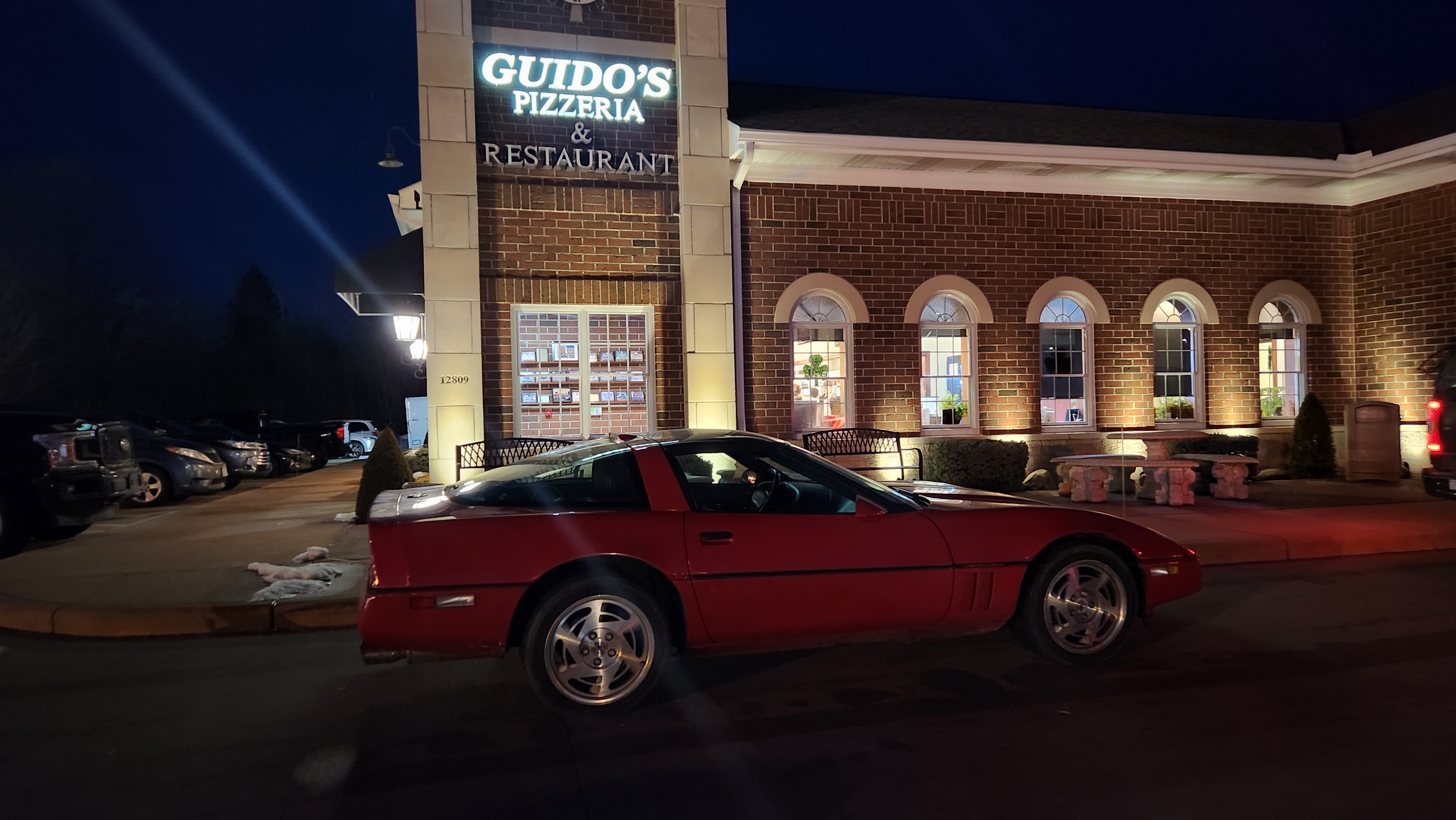

I put my new license plate sticker on and drove it into town to pick up dinner tonight. It's running well, headlights work good, both low/high beam. I'm pretty happy at the moment.

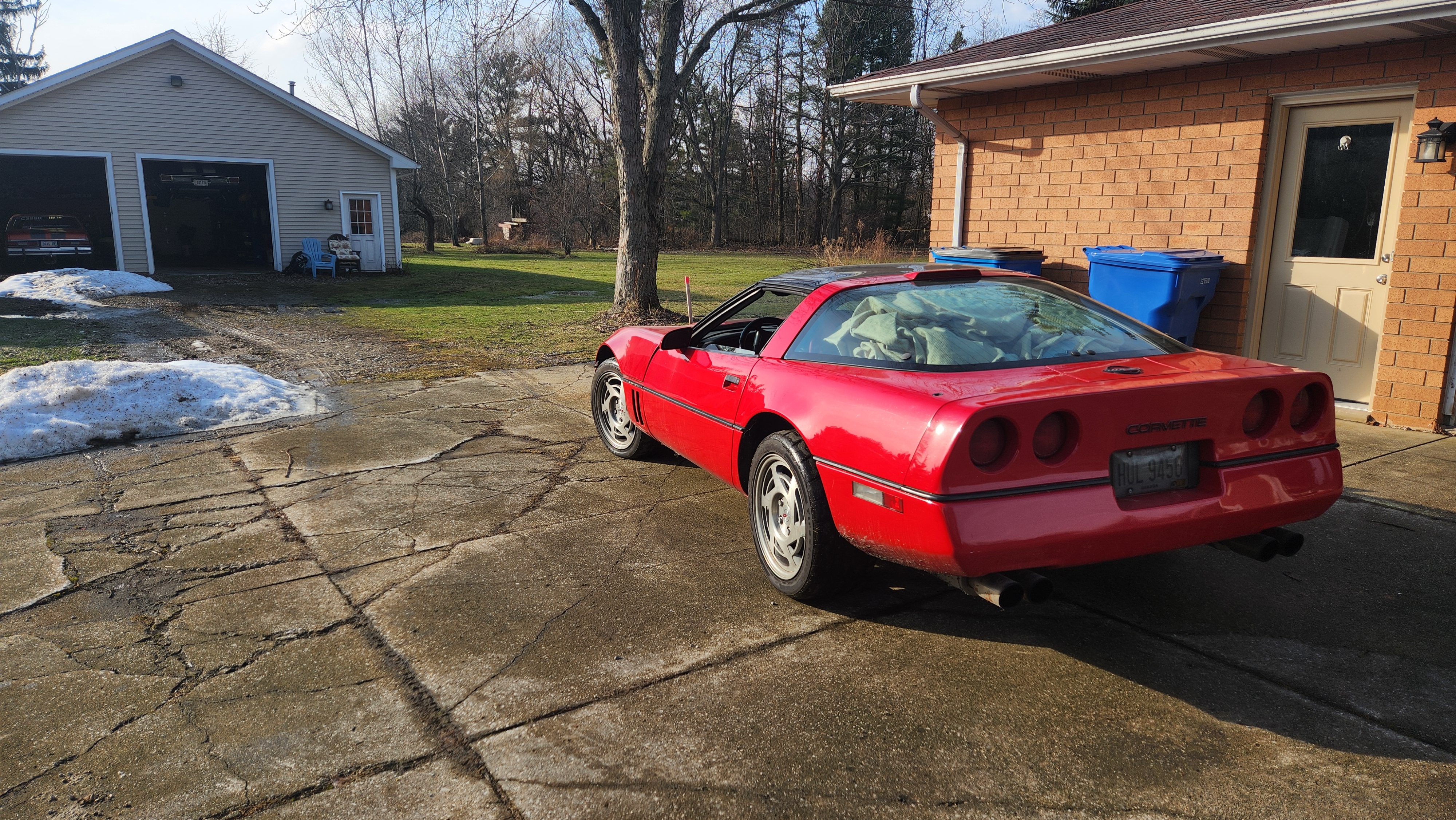

So I'm really happy to report that I've been driving this car a bunch and its been running pretty good. Its the car in the garage I can drive on just about any day. I drove it to Tony's office on Wed night for dinner with him and Paul, and work on Thursday.
