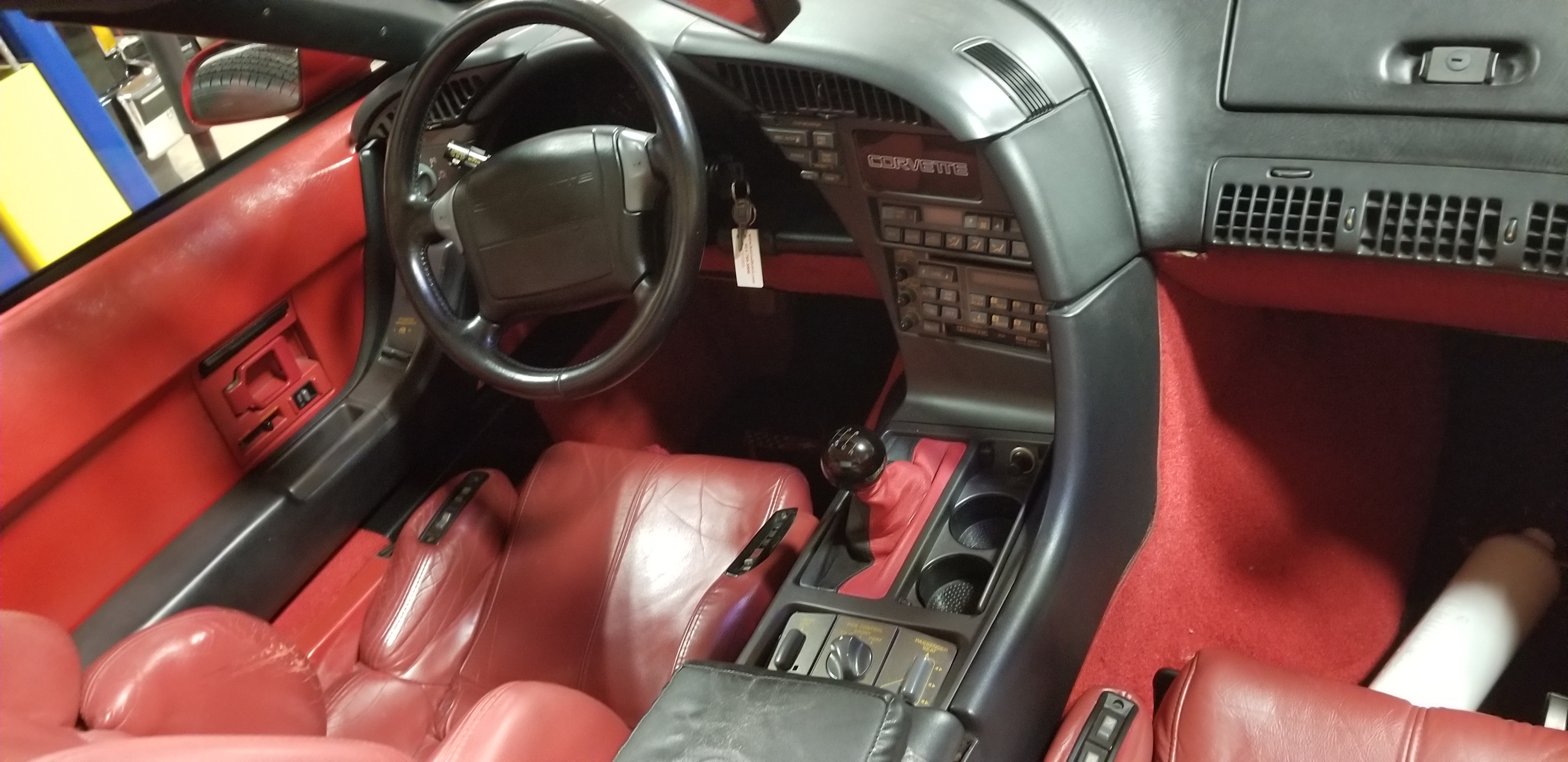

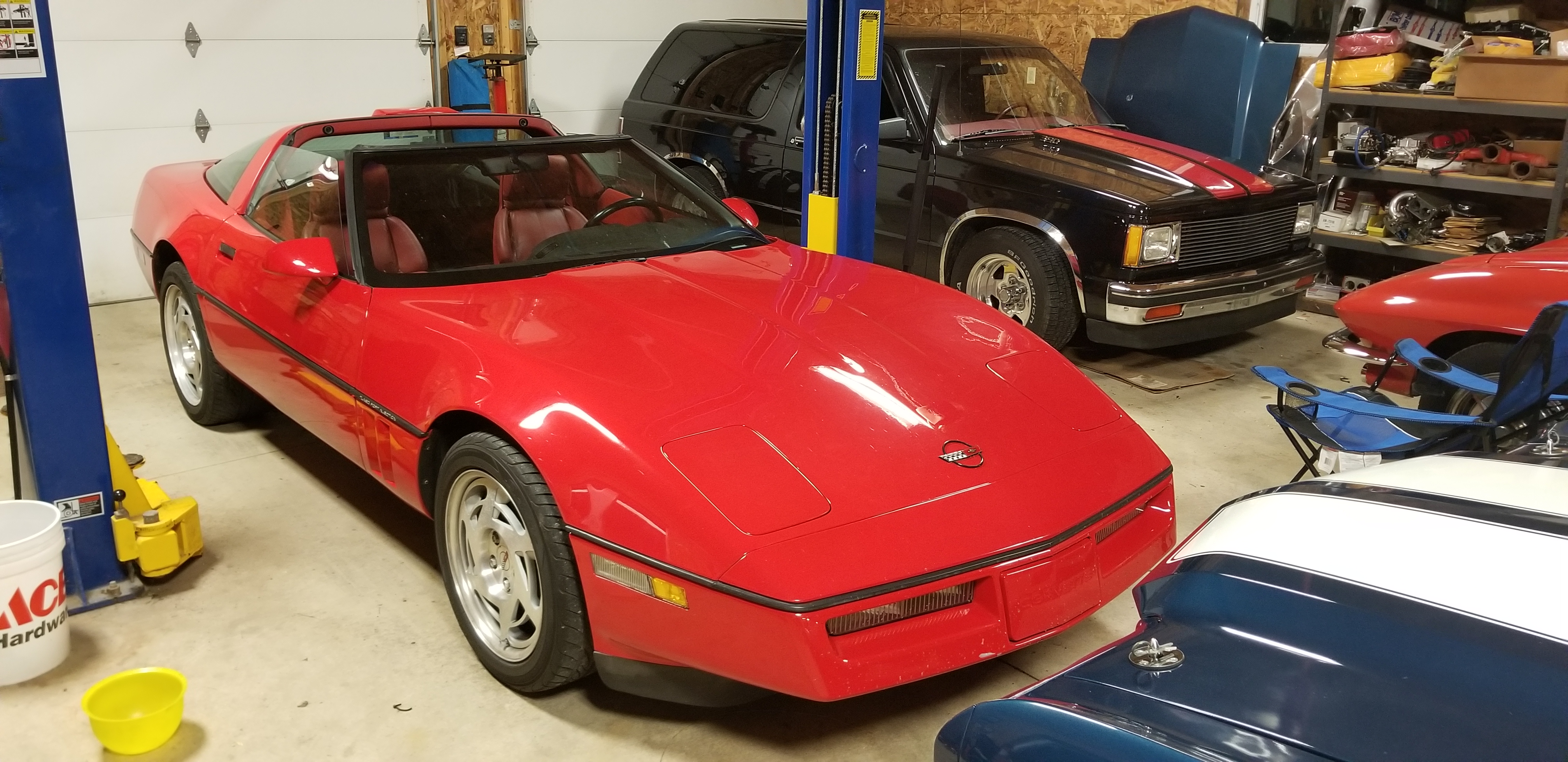

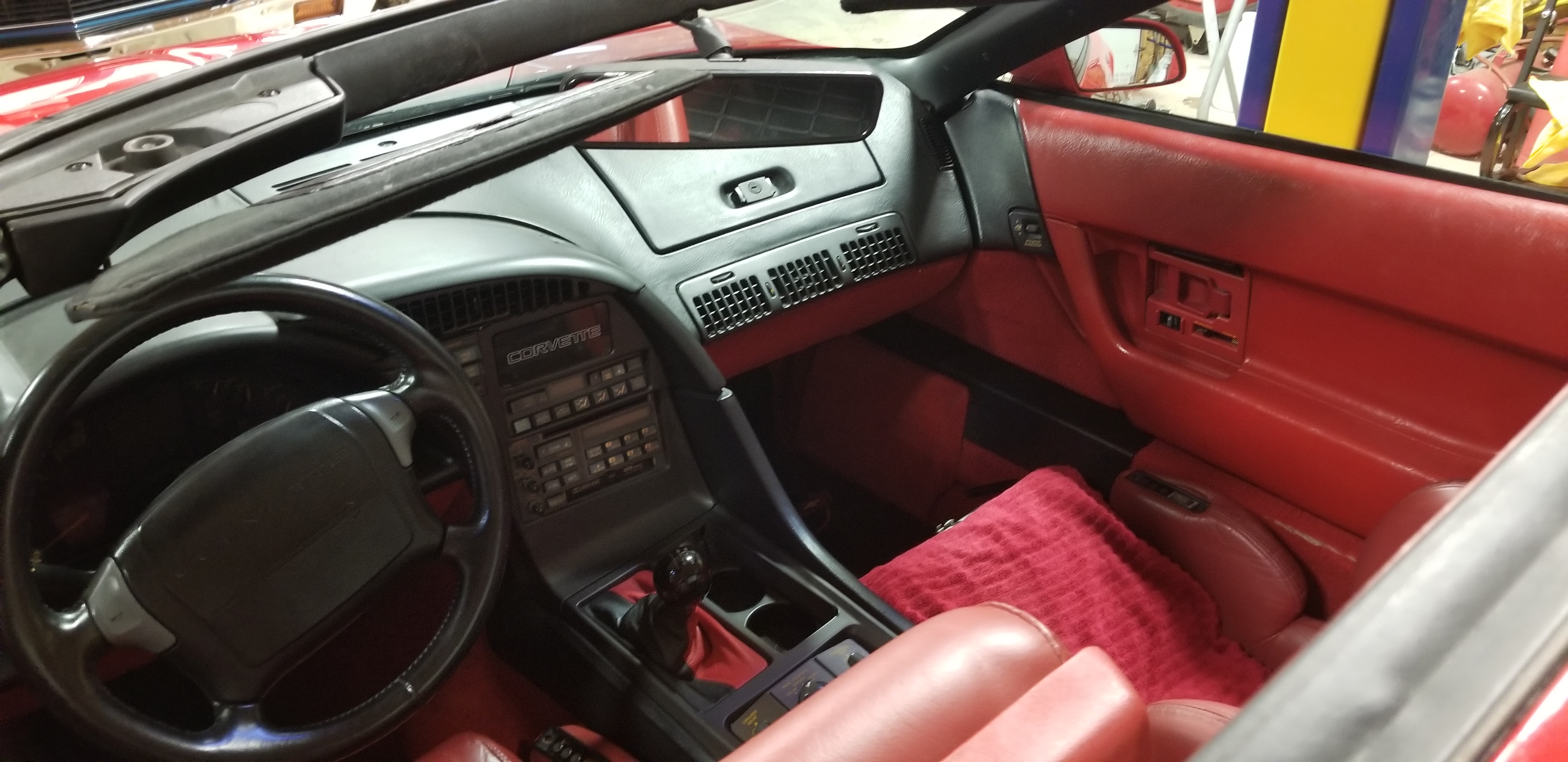

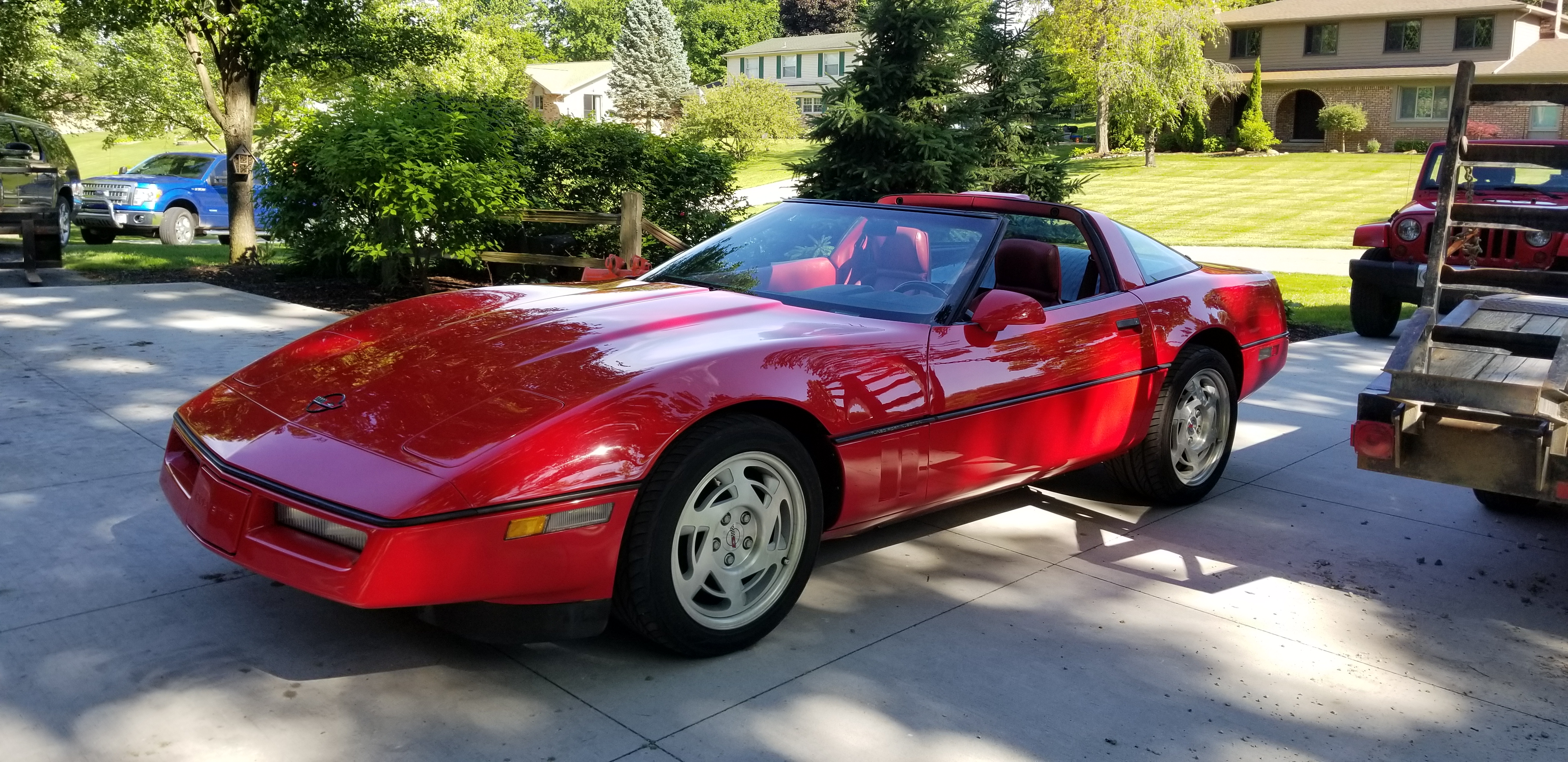

I bought a car today! This is the first car that I was able to see via live video call before I went up there. We used Google Duo. What a great way to check out a car before heading out.

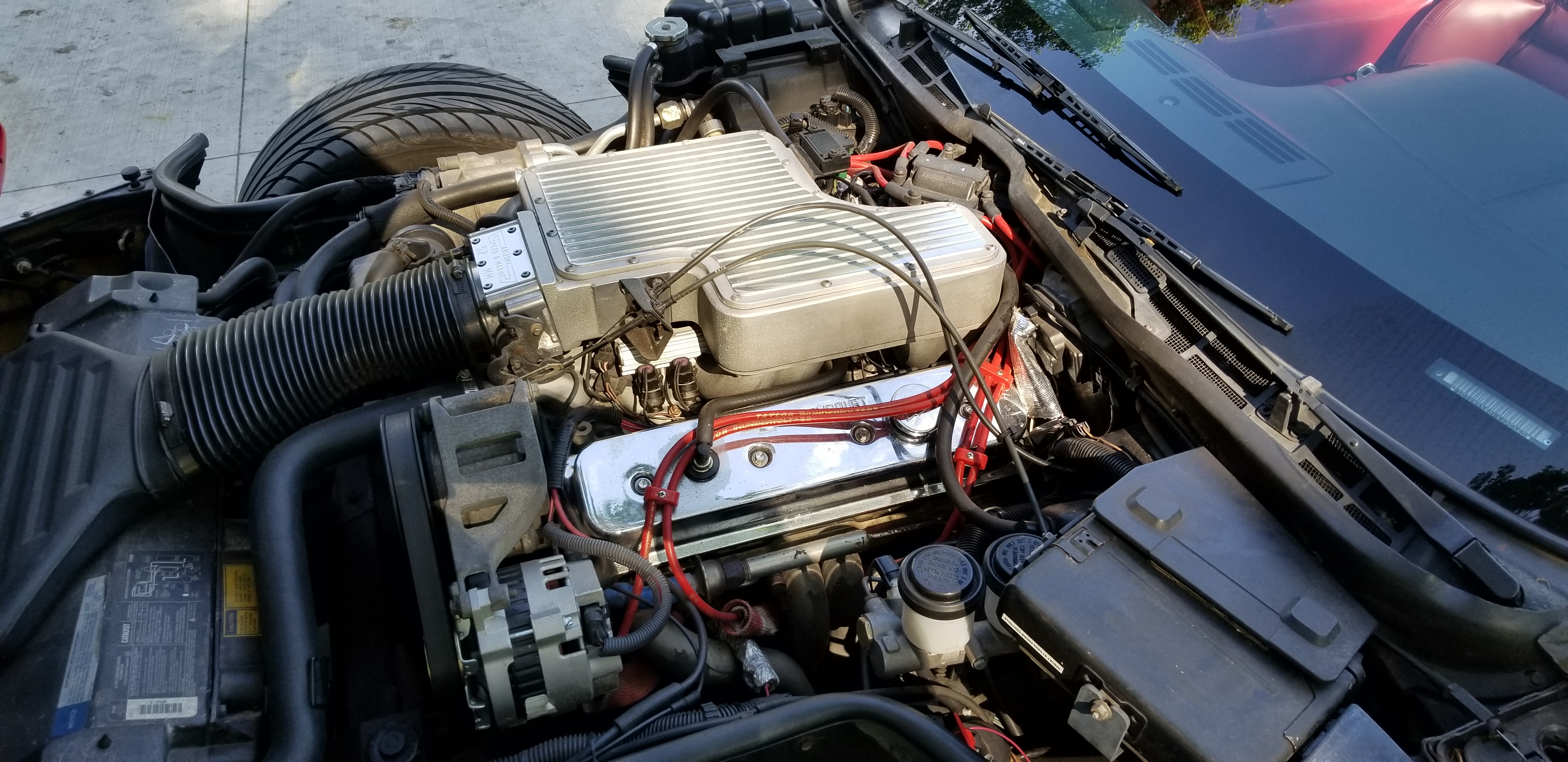

It's a 1990 Corvette, L98/6sp, with the Z51 & FX3 suspension options. 90k miles. It's been upgraded with AFR heads, an Accel Superram intake, some sort of Comp roller cam, Hooker headers, Magnaflow mufflers, and various DUI ignition components. The interior is in really good shape overall, although there are a few items that will need immediate attention. It's been repainted, and except for a couple minor areas, looks excellent overall.
BP originally found the ad on craigslist, it was up in Warren, MI (north of Detroit). I saw it, and we talked about it, really cool looking car, lots of good parts, good price, etc. It had already been listed for several weeks. I waited another 7-10 days, and when it was still there I decided to give the guy, Brad, a call. Brad seemed like super-good dude, someone we'd all enjoy hanging around with. He also had a '69 Vette in the garage (yours for $20k) and some sort of LS1 Firebird out in the driveway. Brad said he bought it 4 years prior in New York from some guy who had mega-money and this Corvette was the 'crappy' car in that collection. It's believed that the heads/cam/intake were all done in the early-mid 90s.
My good friend Jered Baumert lives in Washington, MI, maybe 20 miles further north, so we made it up to his place for dinner. Him, his boys Charlie & Andrew, and their friend Zach joined us for dinner at a local BBQ place. Jered rode with me to the restarant, on the ride back to his house, Andrew got a ride, and afterwards, Charlie too. Much full-throttle was had!
Drove it home successfully without any issues. Gwen drove it from the Ohio turnpike/I-280 to the west side of Cleveland. Initially skeptical, as she likes the looks of the C3's better, she's now a fan.
It has some issues that will need to be addressed-- the tach doesnt work, the lumbar controls for the seats don't work, cruise doesn't work, the rearview mirror is loose where it mounts to the roof. Some weather stripping is in good condition, a couple other pieces need to be replaced. It is leaking some oil somewhere, I can smell it. The brakes work, and that was one of the things Brad had to really repair during his ownership, but the pedal feels really loose/sloppy until the brakes actually engage.
But it's a hoot to drive! More to come..

L98, 245hp 350ci TPI
ML9,MN6 = ZF 6 speed manual
GT6 = 3.33 rear
J55 = Heavy Duty Brakes
Z51 = Heavy Duty Suspension
FX3 = driver adjustable shocks
This is a well-optioned performance car.

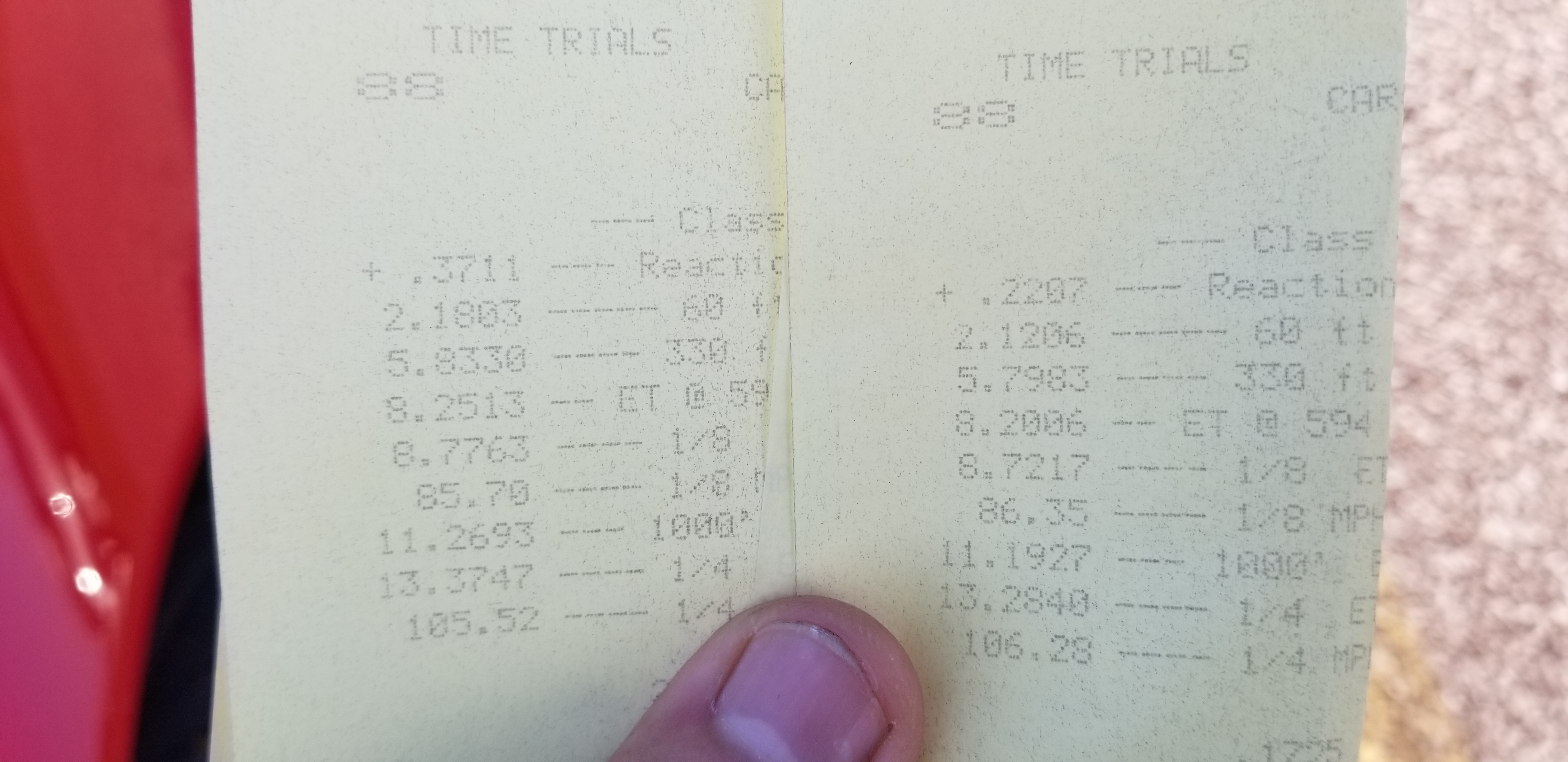

I did get it out to the dragstrip on 7/24 and managed to run a best of 13.28 @ 106. I wasn't launching aggressively, because hey, it's still July. But I was *very* happy with those numbers. New tires will be a necessity sooner rather than later, but then I'll be able to try a track day!

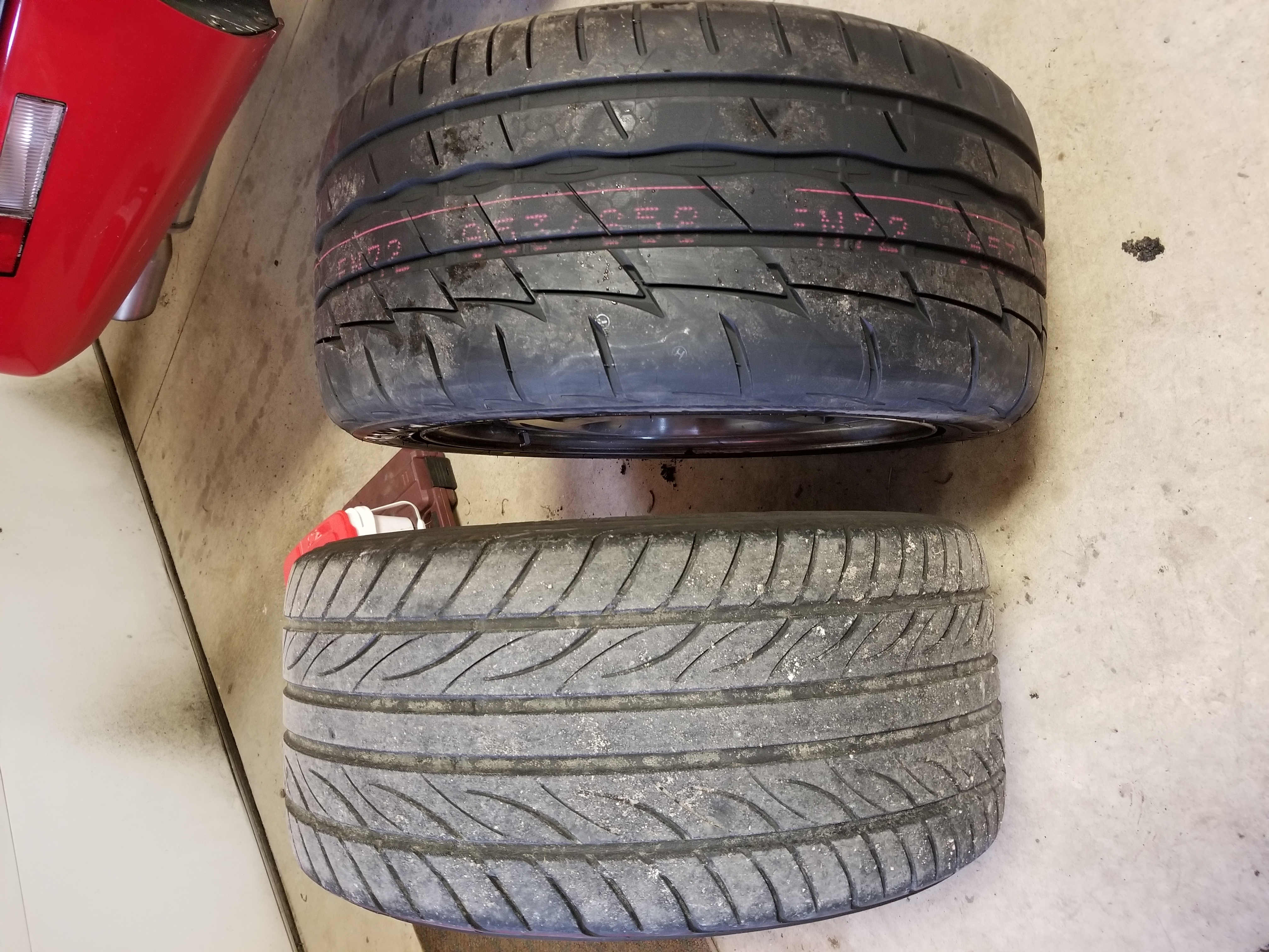

Picking up right where I left off....

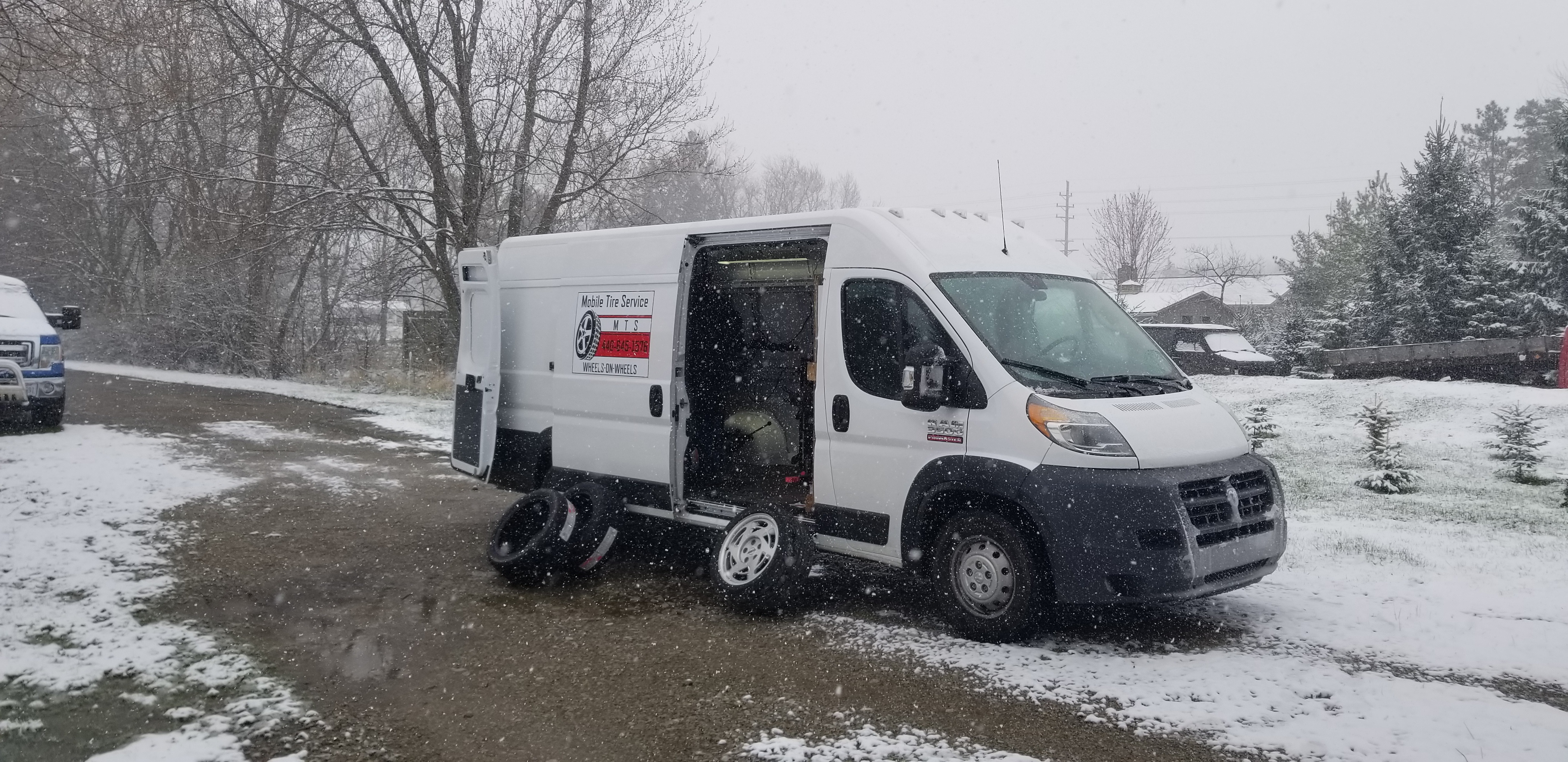

I got new tires today! I was planning on getting new tires anyway, but when I got my Kung Flu stimulus funds, and with the upcoming autocross, figured there was no better time. I did some poking around on tirerack.com 275-40-17 is a really common size, which means lots of choices. I wanted something than leaned more towards high-performance vs high-mileage. Plenty of 4-star rated tires down in the ~$100 range, but the Firestone Firehawk Indy 500s had an even better rating 4 1/2 star with almost 500 reviews, but they were $150. $660 shipped. Slightly disappointed they're not US manufactured.
I've ordered from Tire Rack in the past, but never used their recommended installer, usually just opting for a local place near my house. This time, however, its recommended installer was Mobile Tire Service out of Madison. The owner, Joe, has a Sprinter 3500 van with a compressor, tire machine, balancer, etc. Tire shop comes to me? I dont have to make 2 trips to the store? Sign me up! Along with my 4 Corvette tires, Joe also took care of the 2 new rear tires for the Chevelle last fall that never got mounted. So, 6 tires mounted/balanced, new valve stems, old tires taken away, $160. Very happy how it worked out.
While the wheels were off, I decided to take a look into the brakes. I've never been happy with how the pedal felt, so I decided to bleed/flush the brake fluid a bit. I found on Corvette forum that you're suppose to start at RF, RR, LR, LF, going around the car in a circle. By now, Gwen is a Tiresmoke-certified expert assistant at bleeding brake, and after finishing LF, she said it was totally better. I haven't sat in it yet.
Oil change / lube (ball joints/tie rods) with Mobil 1 5W-30 and PF454 filter, 92,247 miles.

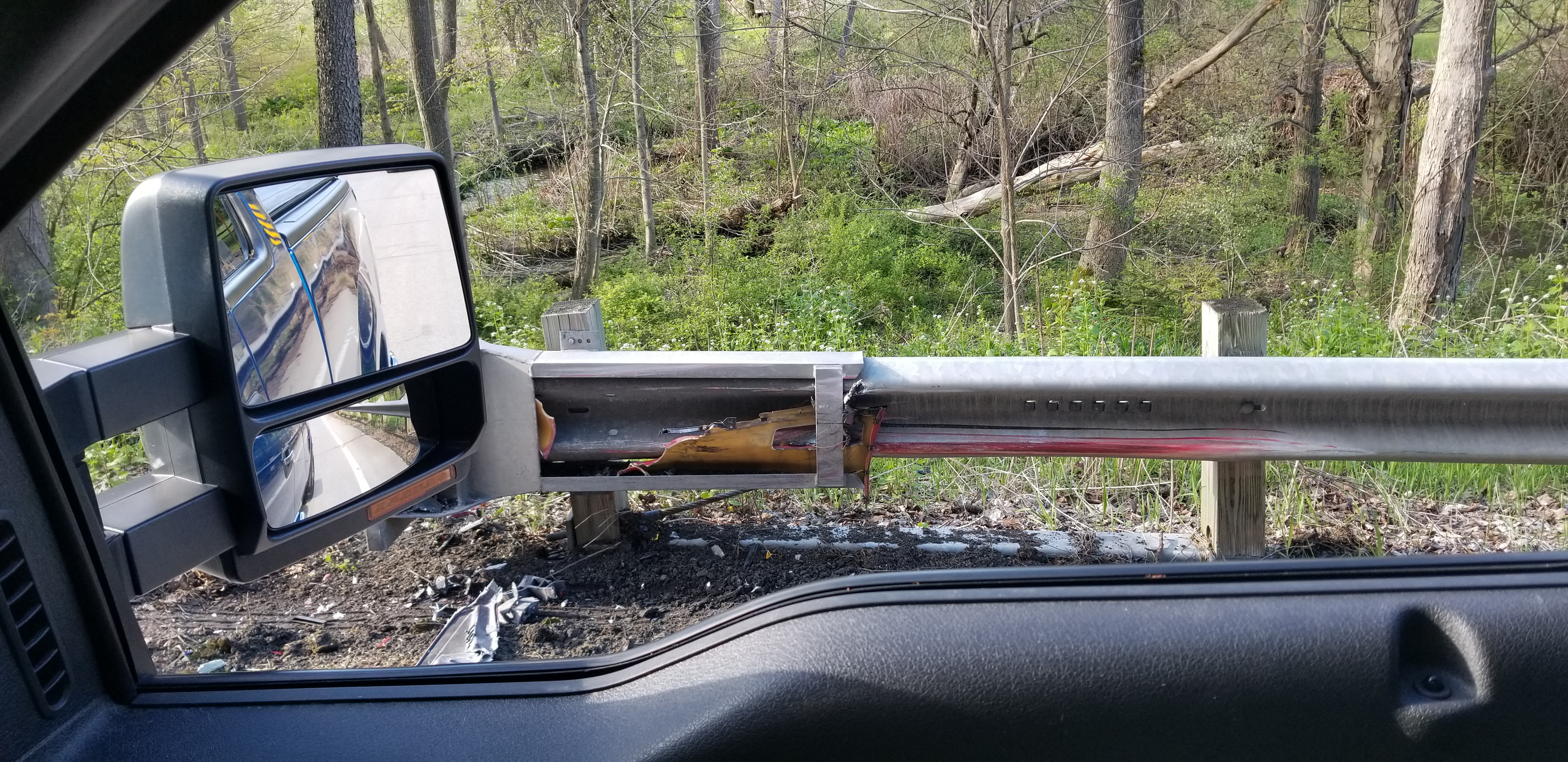

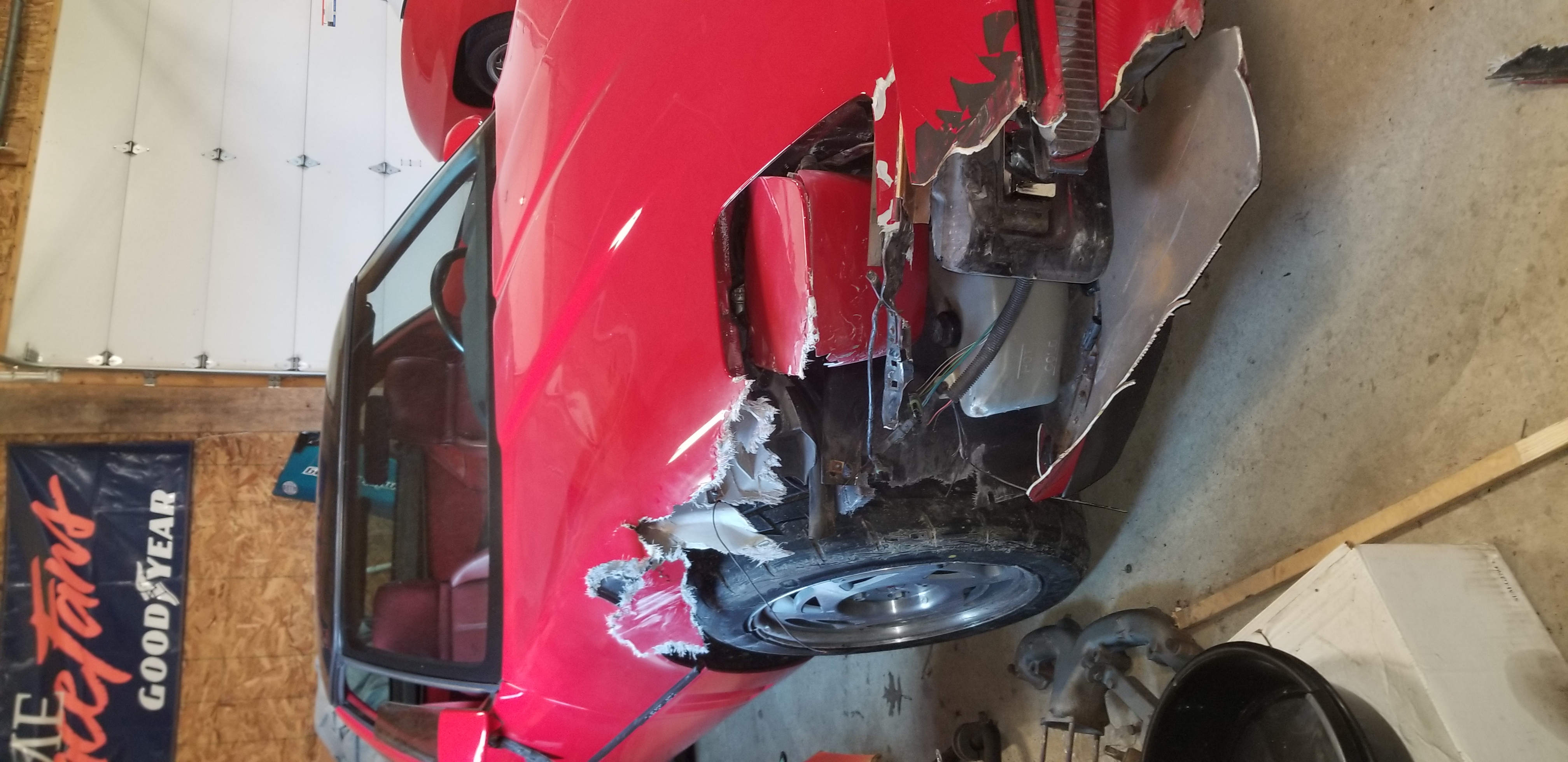

Sad news today.. Gwen took the Corvette to Bainbridge today, and this happened on the way home. She's ok, no one else involved.
She was turning onto Fairmont from 306, said the back end came around on her, over corrected and hit the guardrail. She drove it home, but there's a good amount of damage. RF wheel took a good shot.. And we're leaving for Florida tomorrow.

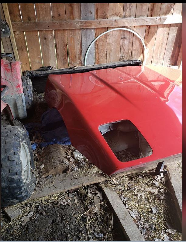

So I've had a couple days to think about whats happened.. I'm leary about trying to fix it, because this kind of stuff is definitely not my wheel house.
But within 15 minutes on Facebook marketplace, I've found:
Red 1990 Hood in Rome, OH for $200, https://www.facebook.com/marketplace/it ... 1836894061

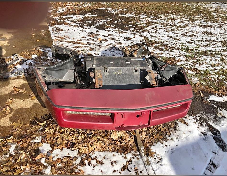

Maroon 1990 front fascia,near Louisville, OH for $200, https://www.facebook.com/marketplace/it ... 9888352187

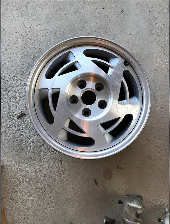

and a correct wheel for $20, up in Howell, MI. https://www.facebook.com/marketplace/it ... 1179291713
I found another ad with a passenger door, red, from an 86. I assume it'd work for me, although I think its only the mirror that is actually damaged.

There are so many C4s you can get the parts relatively cheap. I would look at the suspension too just to make sure something did not bend. Also check Mirrock Corvette site for interchangeability of the parts as they made minor changes over the years

The wheel and possibly the suspension are easy enough fixes.
The problem with all of the body parts/panels/etc. will be paint. Even the same factory color will have a different patina and luster after 30 years. Odds of everything matching are almost zero.
That said, sometimes insurance companies will let you buy the car back from them....although you'll end up with a salvage title, I believe. Motor is probably worth something though, with those nice heads.
Something to ponder: Try to get as close to what you paid for this car from the insurance company, sell the blazer, and then buy a C6 with the combined $$$?
