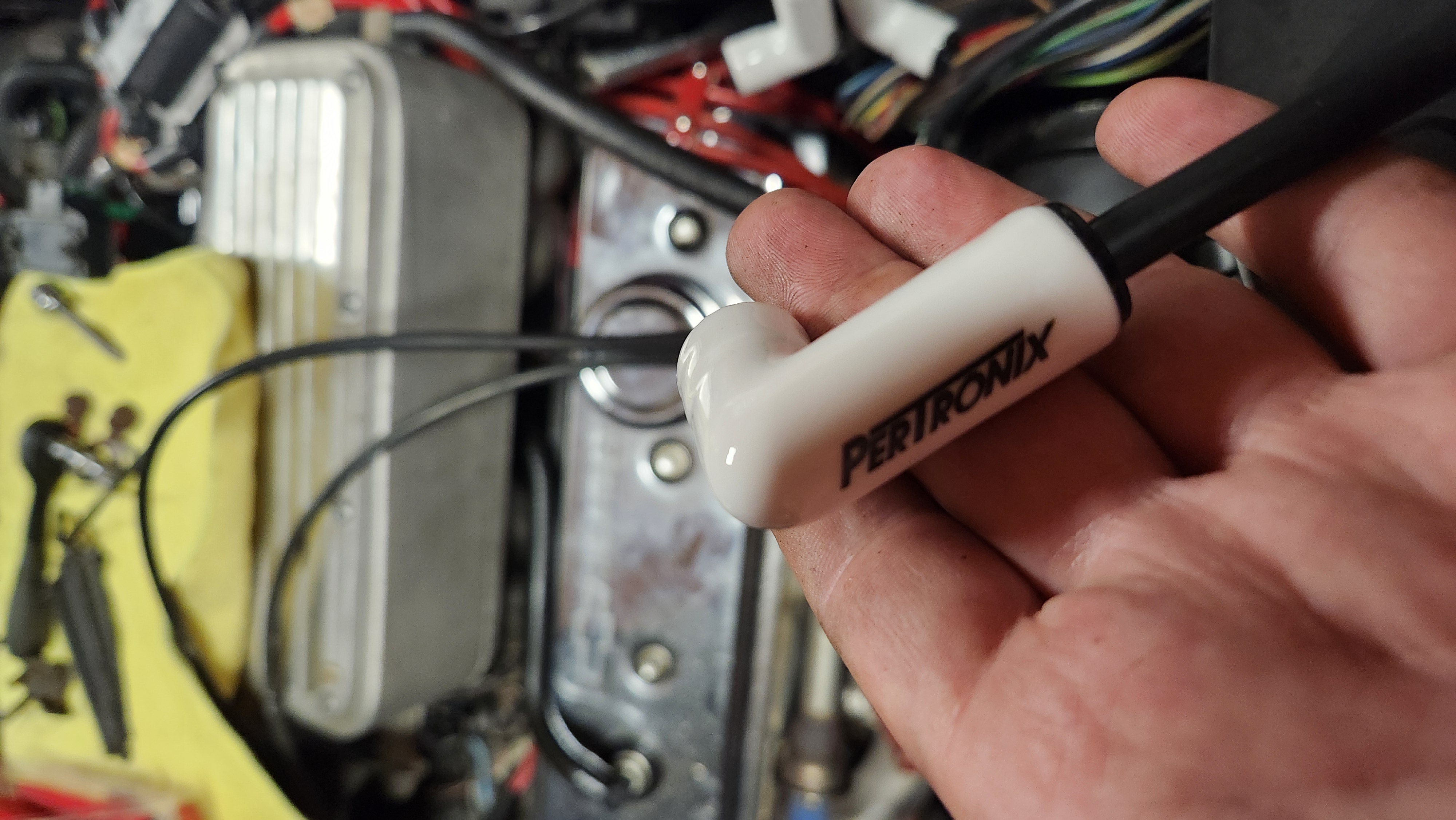

I made up a new set of plug wires since I saw the old ones arcing to the headers. They didn't look awful visually, though. I bought a set of Pertronix Ceramic boot plugs. As the name says, they have a ceramic boot at the plug wire end. That should make them pretty heat resistant.

This is one of the ceramic boot plug wires. I think I'm going to like these.
