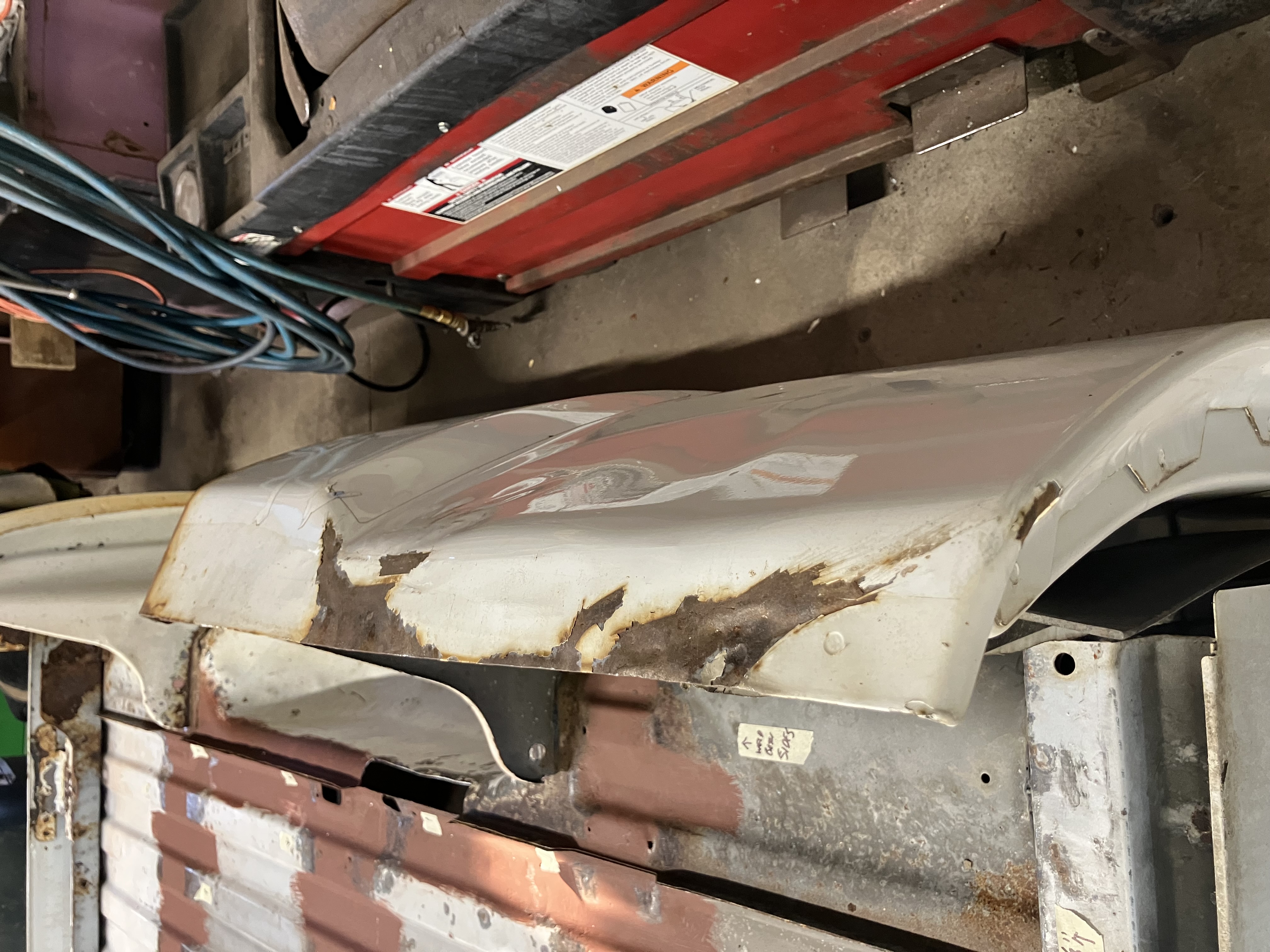

The bed

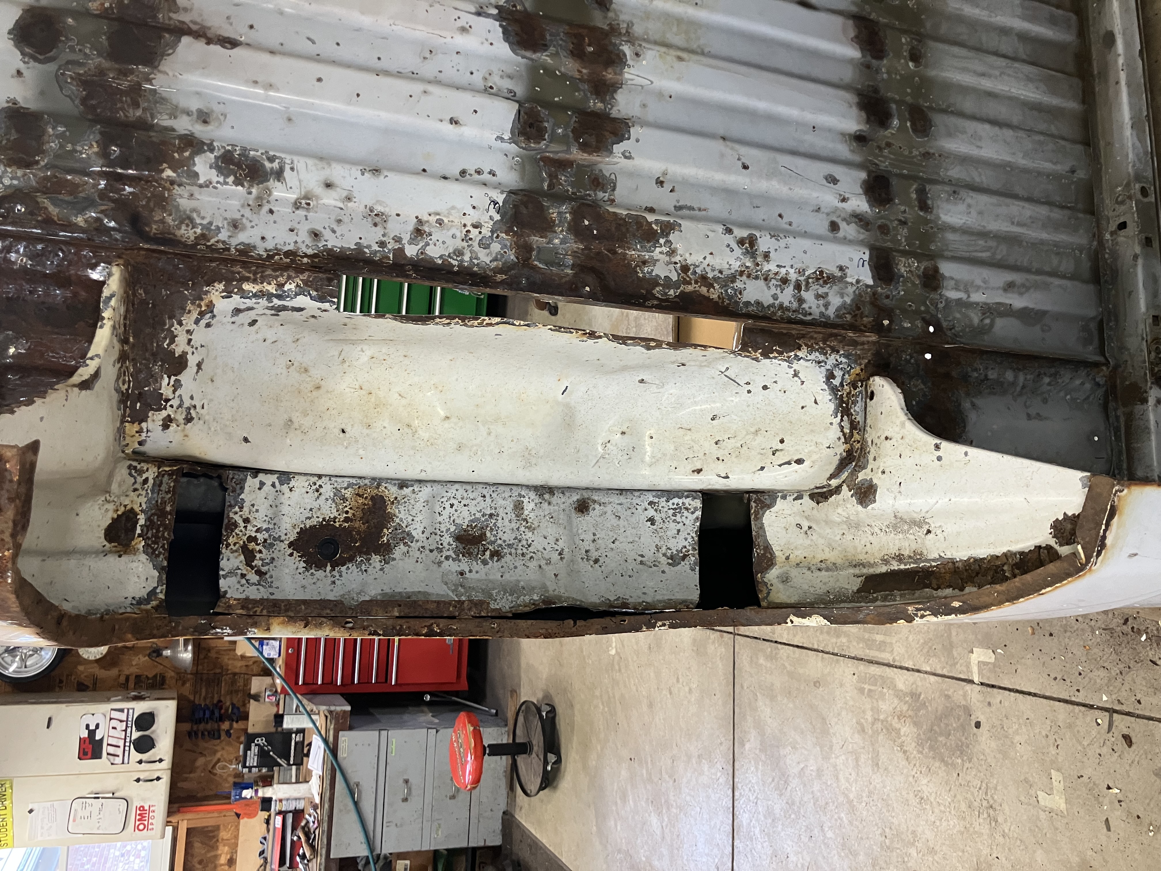

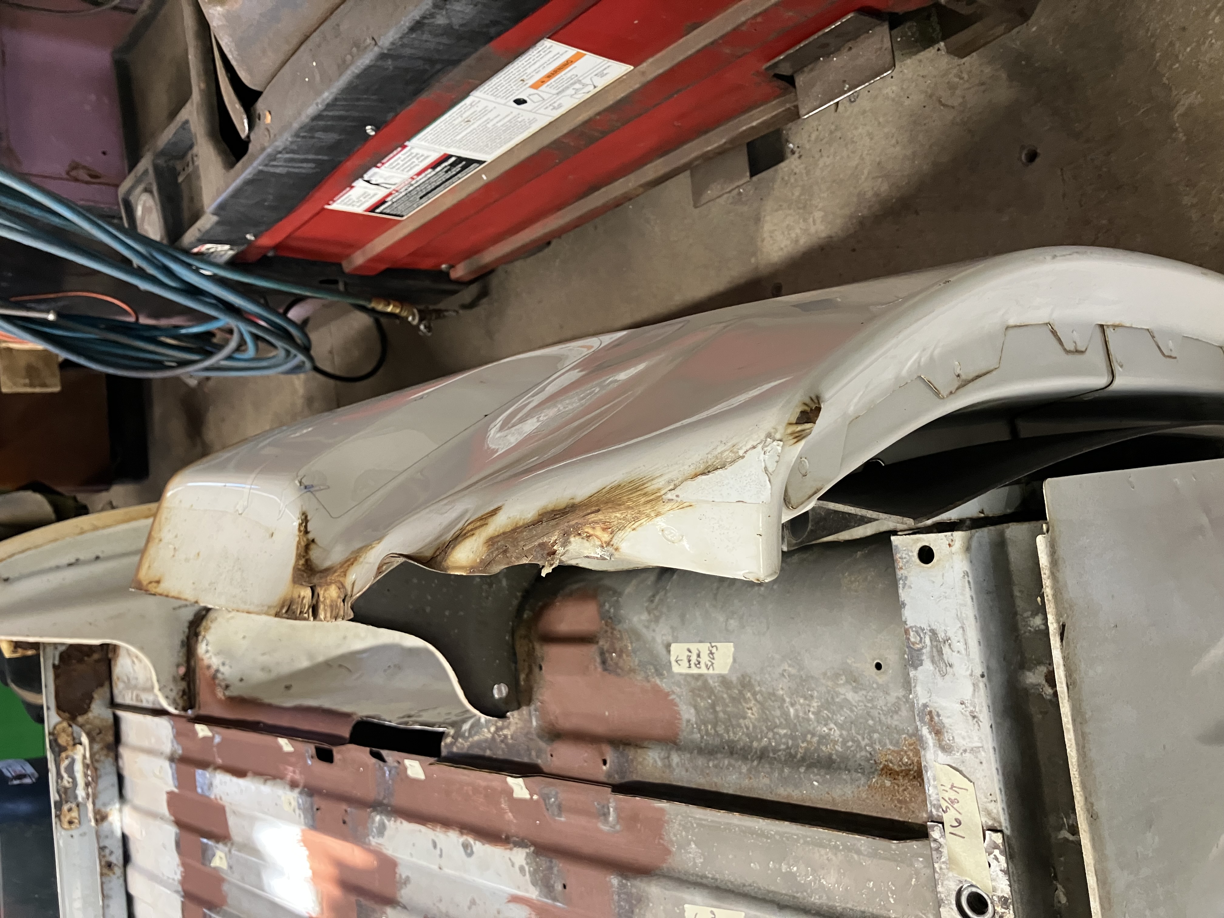

When buying this truck we could see the cross braces under the bed were rusted. Walking in the bed I could hear them crunching under there. It also had rust at the tops of the wheel wells but looked pretty salvageable.

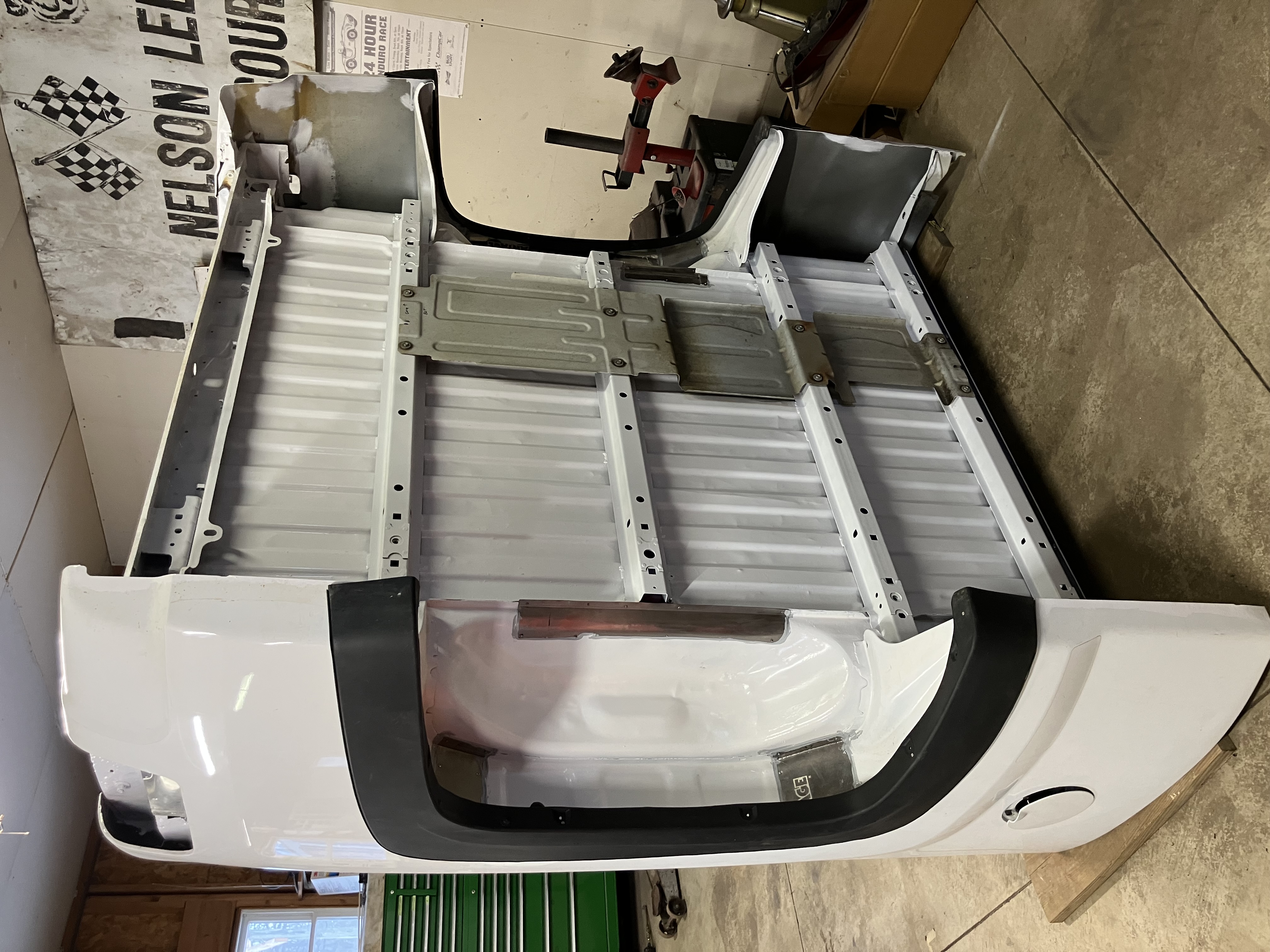

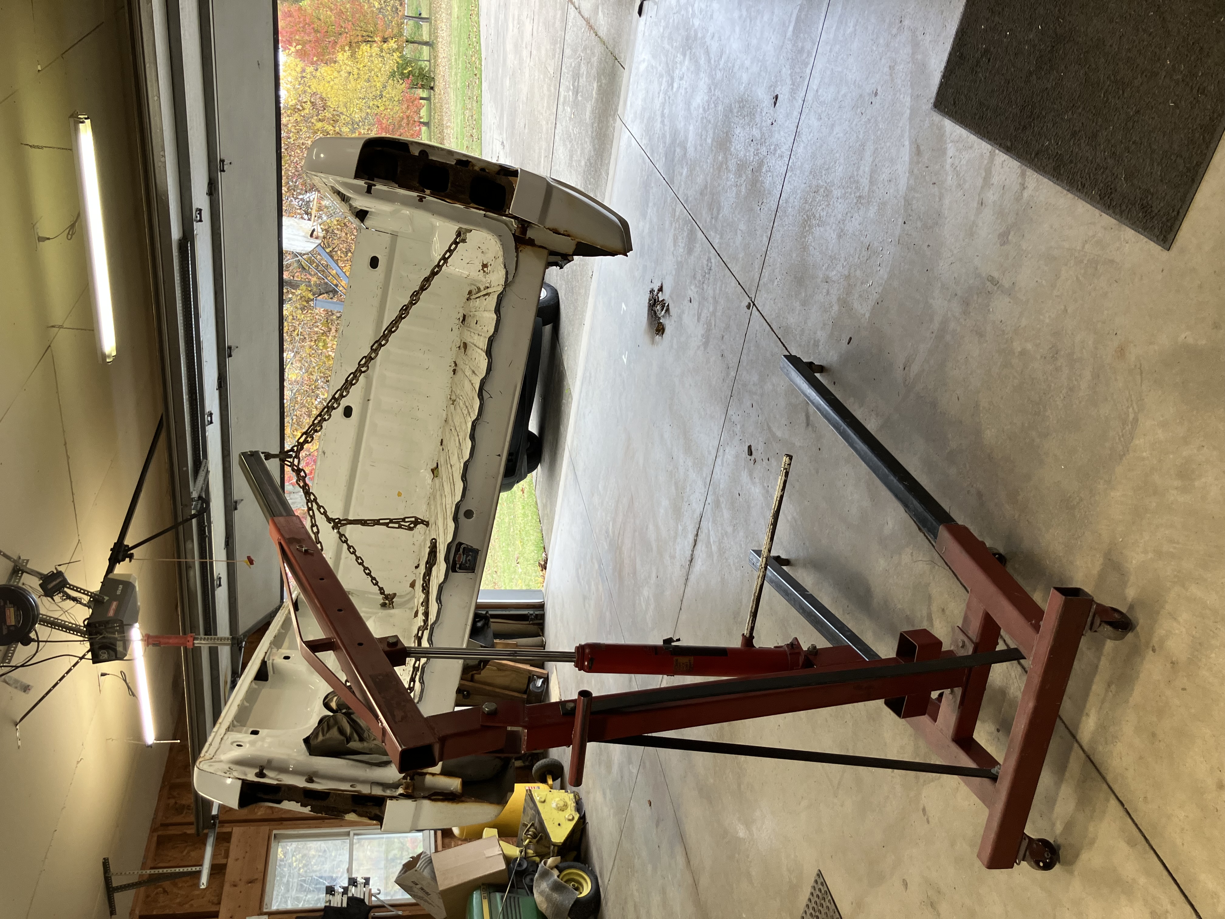

To fix this the bed had to come off. This was not a very complicated process. Disconnect the filler neck, remove tailgate, rear bumper, taillight wiring and 8 bolts and its ready to come off. With a little help from the engine hoist it was off. This made working on the bed much easier. I stood it on the cab side or laid it upside down depending on what was best for the task.

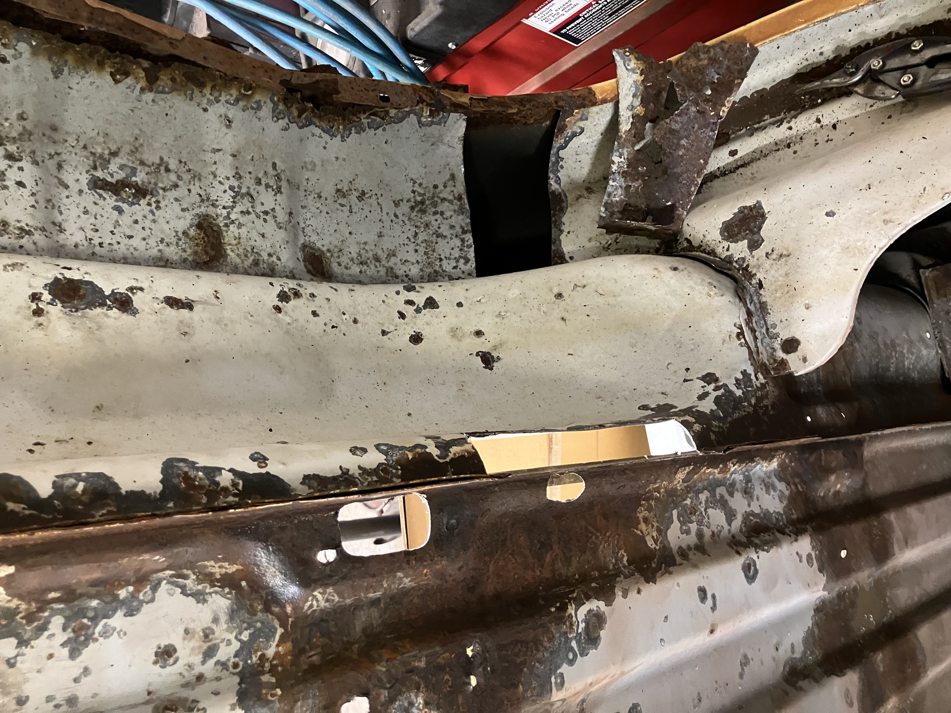

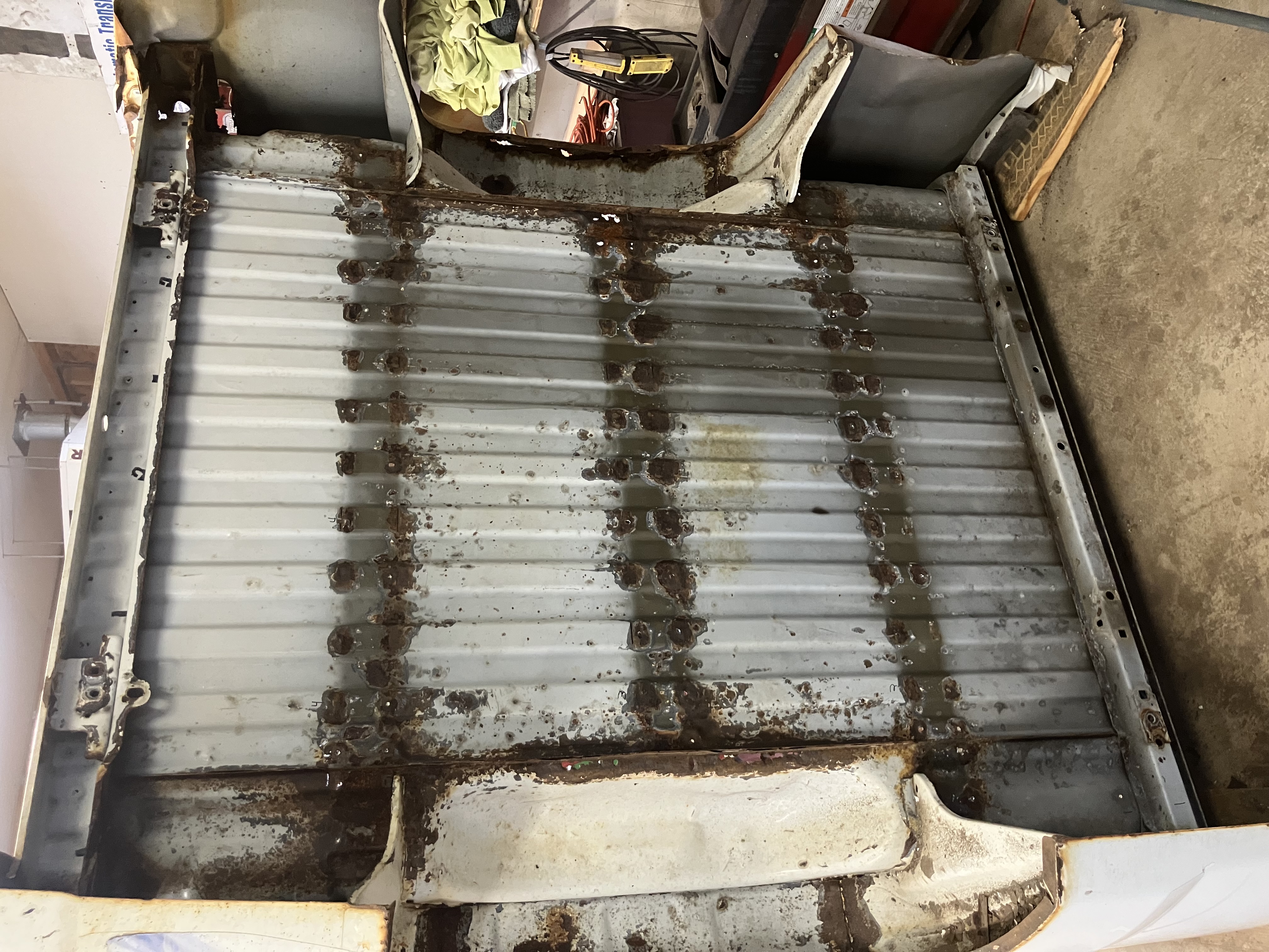

The bed has 5 cross braces, only middle three were bad. They came off fairly easily by grinding out the remaining holding spot welds. I located brand new replacement cross braces from Dorman. There were other cheaper ones but these had weldable primer and I’m thinking they are probably a bit thicker metal. They should outlast the rest of the truck.

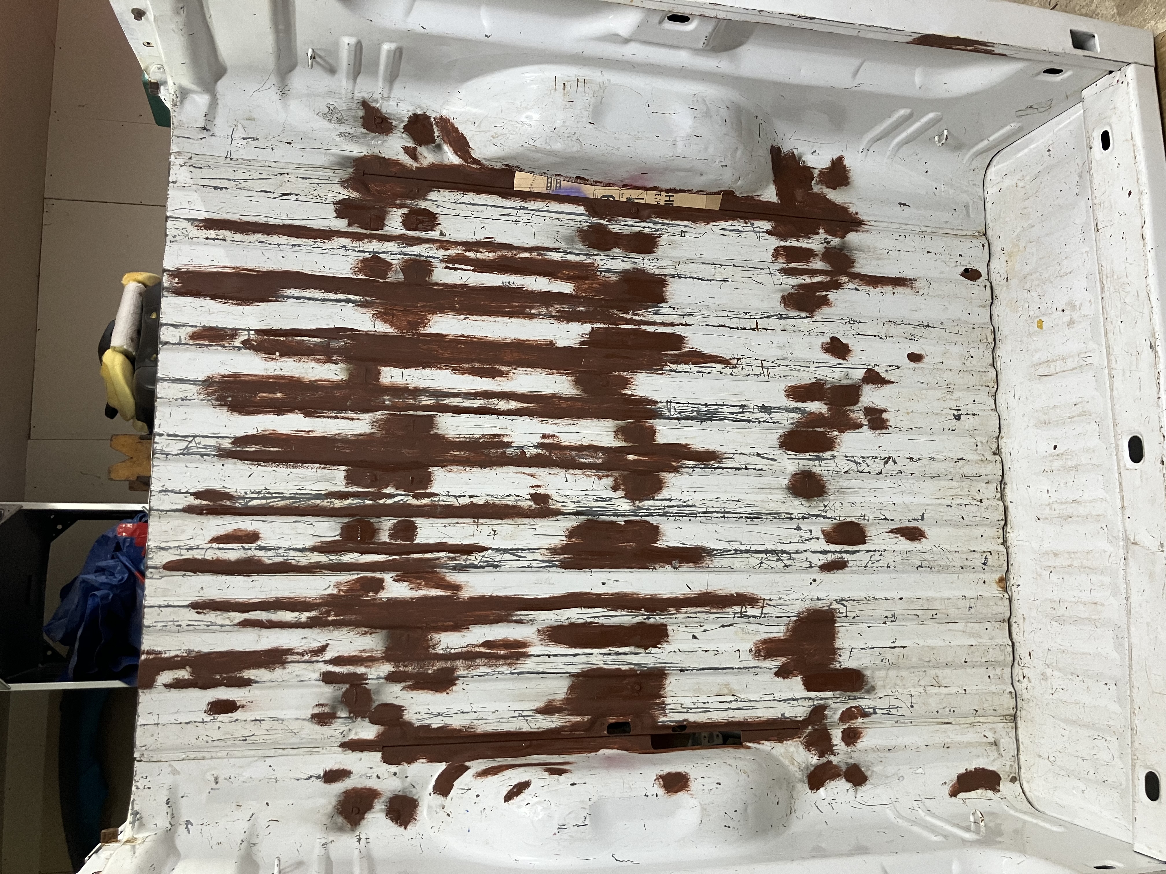

After that spent a lot of time cleaning rust off the bed. It had a lot more rust than I thought. Knocked off all the loose rust – the worst of it was the supports behind the tail lights, then cut out a lot of paper thin metal. After that I used the wire wheel and the grinder to knock off all the rust and clean up the metal in the areas where the new cross braces are to be welded. Since its cold weather I had to run a fan to exhaust out all the rust dust. This helped a ton keeping the air breathable and limiting dust on everything in the garage.

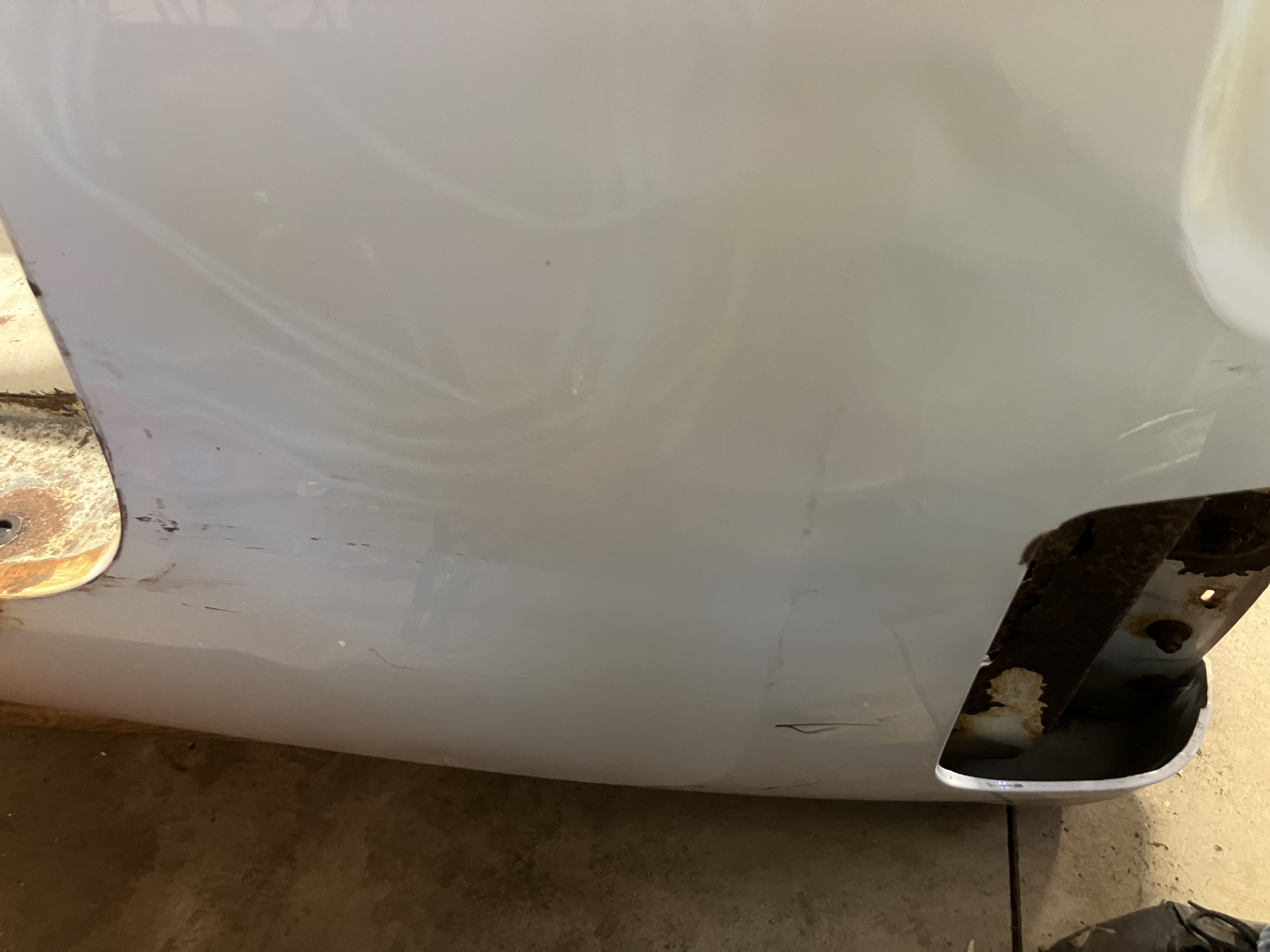

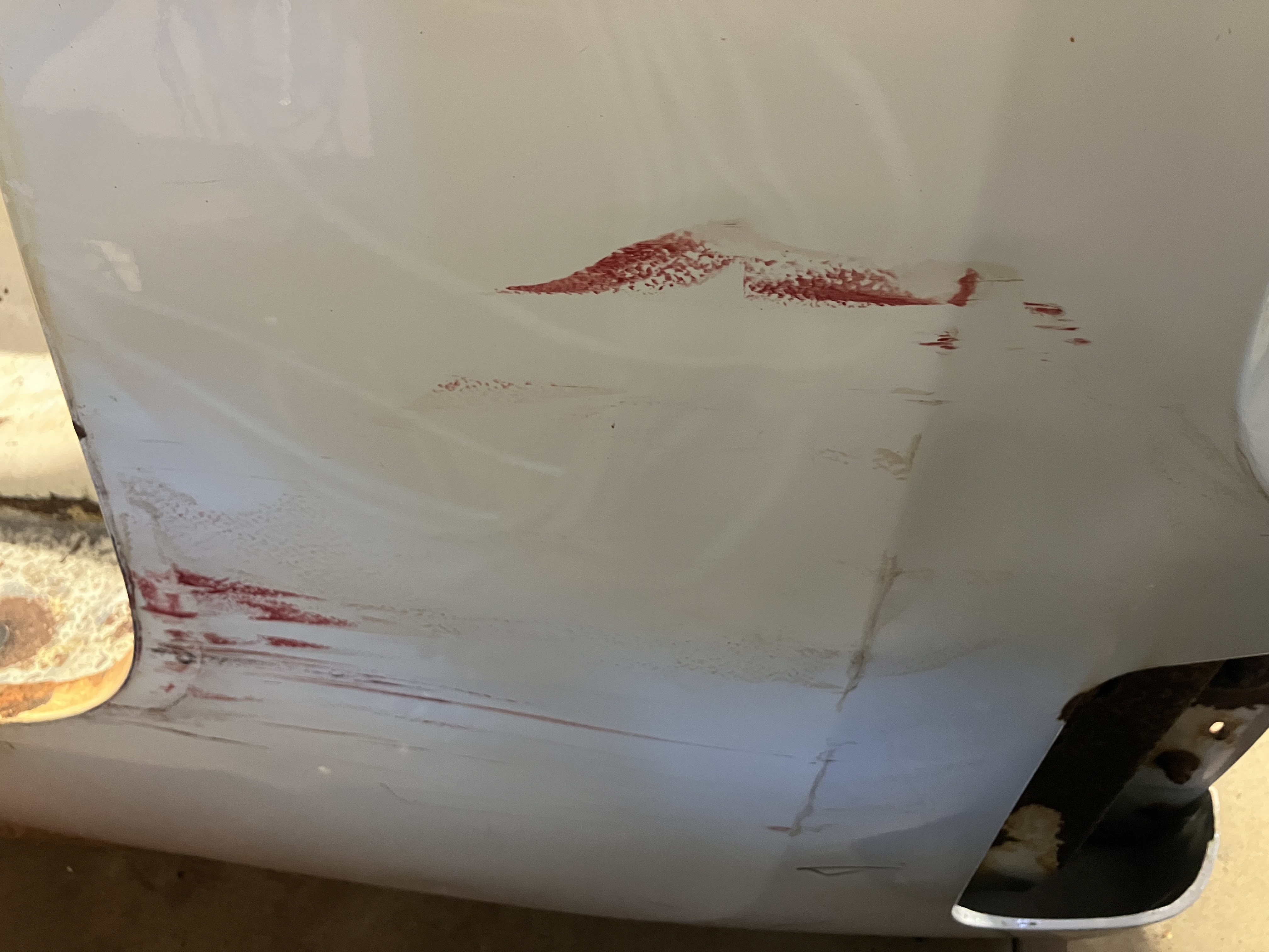

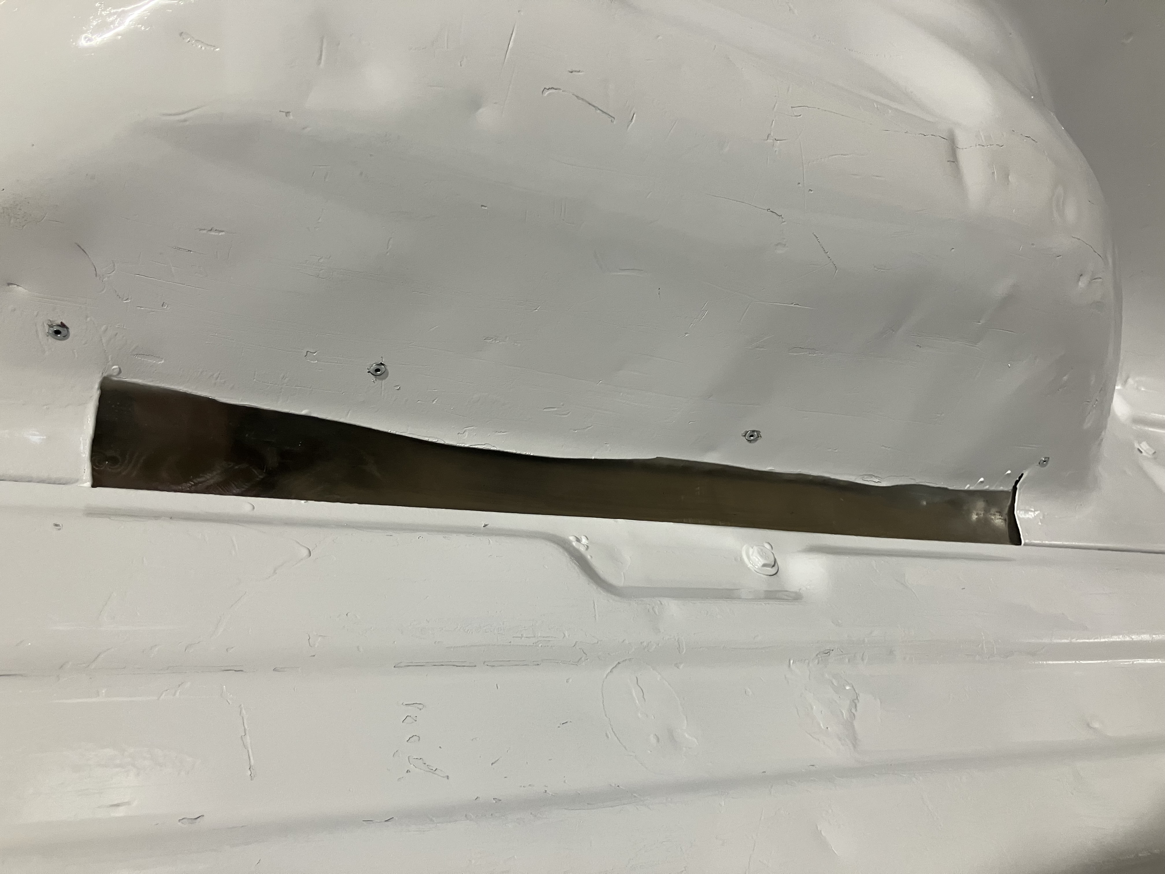

There were several dents in the passenger side quarter panel which I took the time to straighten. They are by no means straight but way better and probably good for the 20’ test.

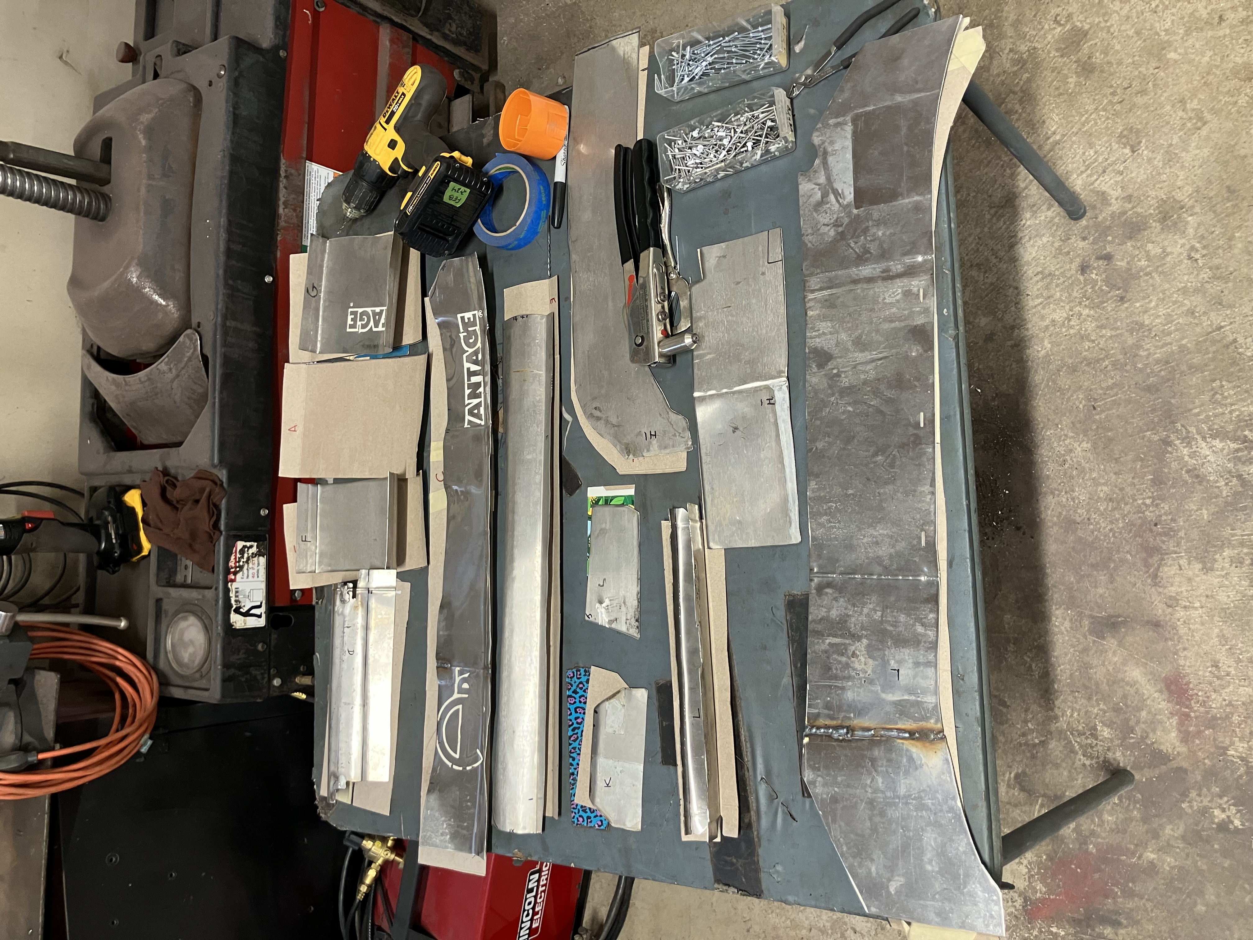

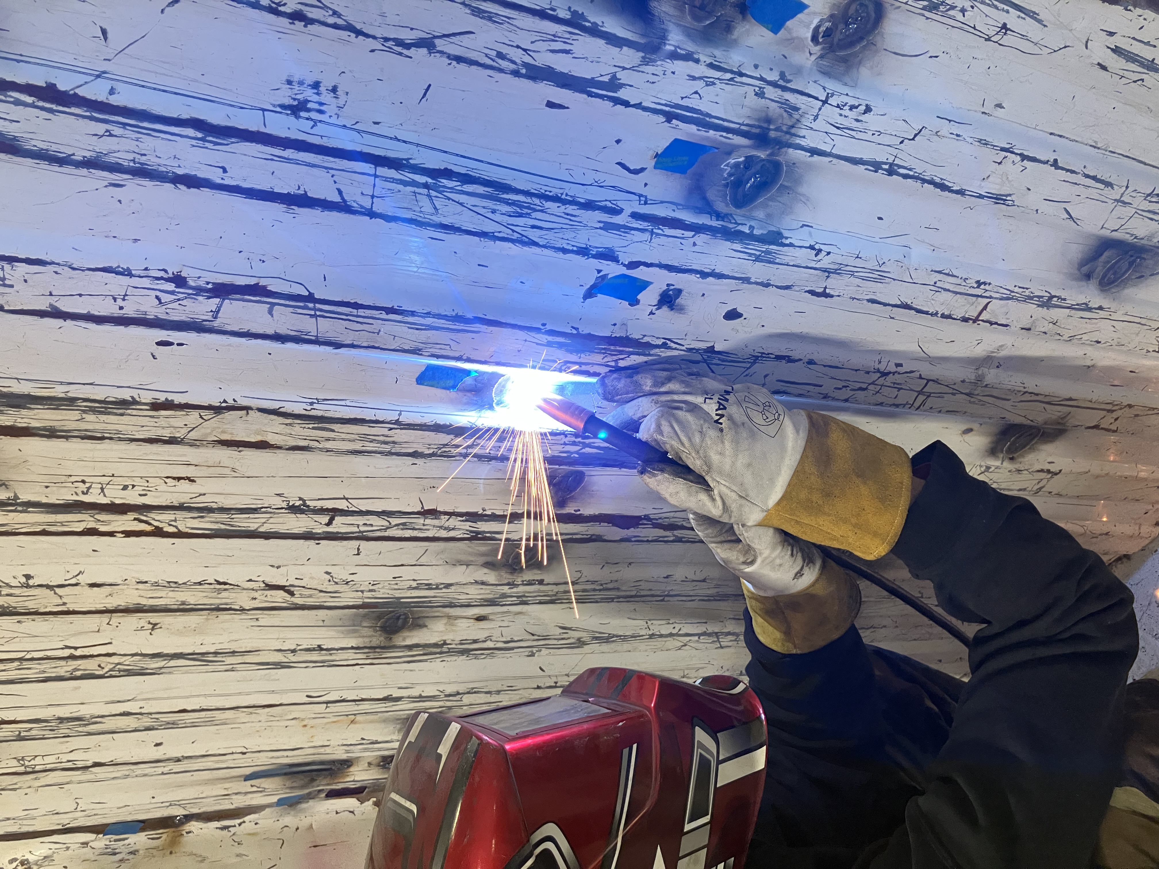

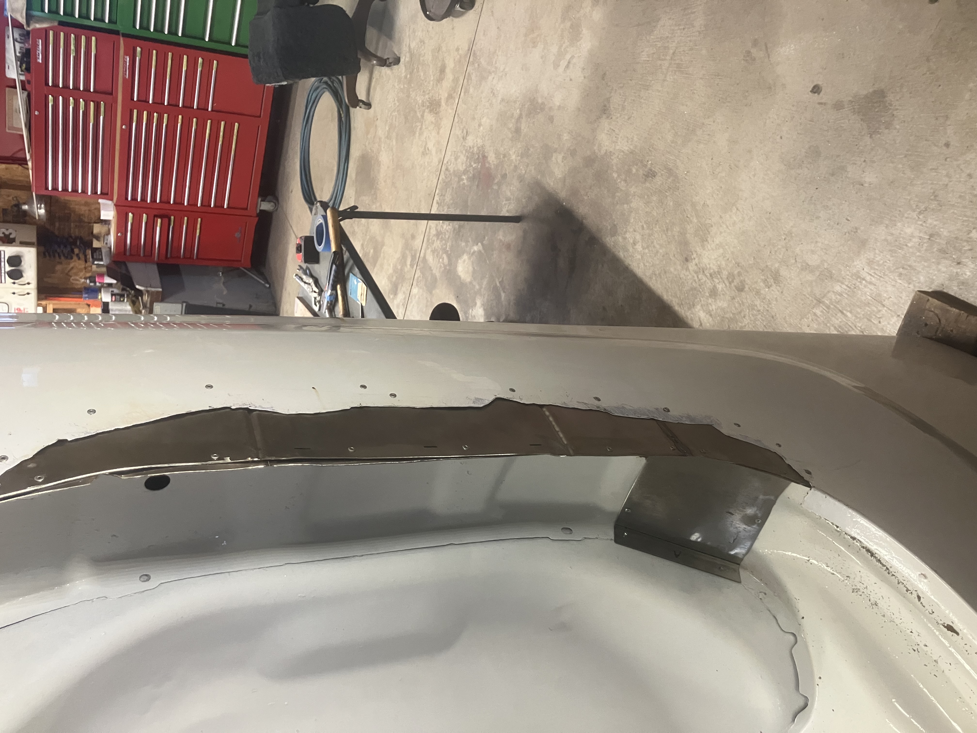

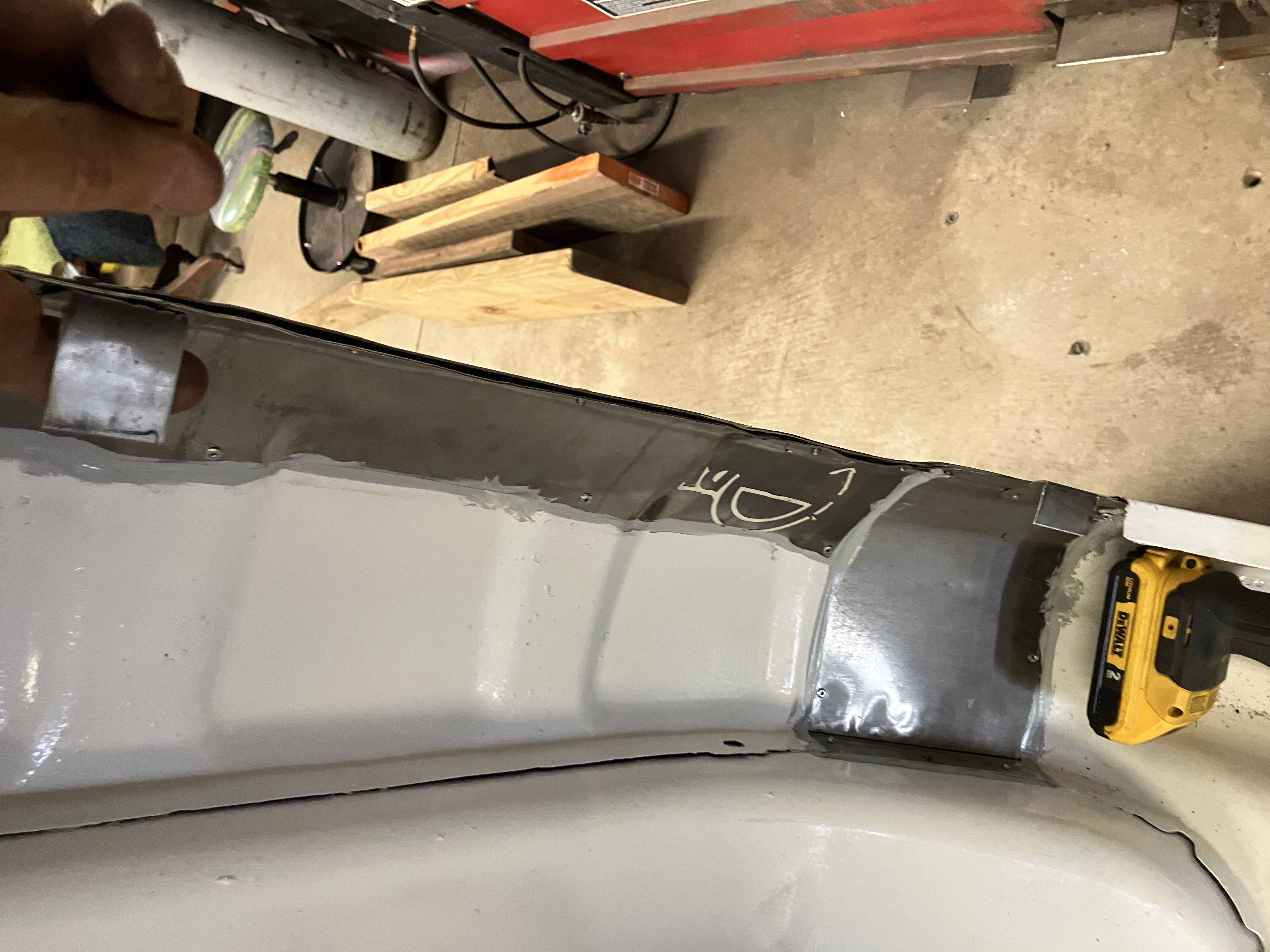

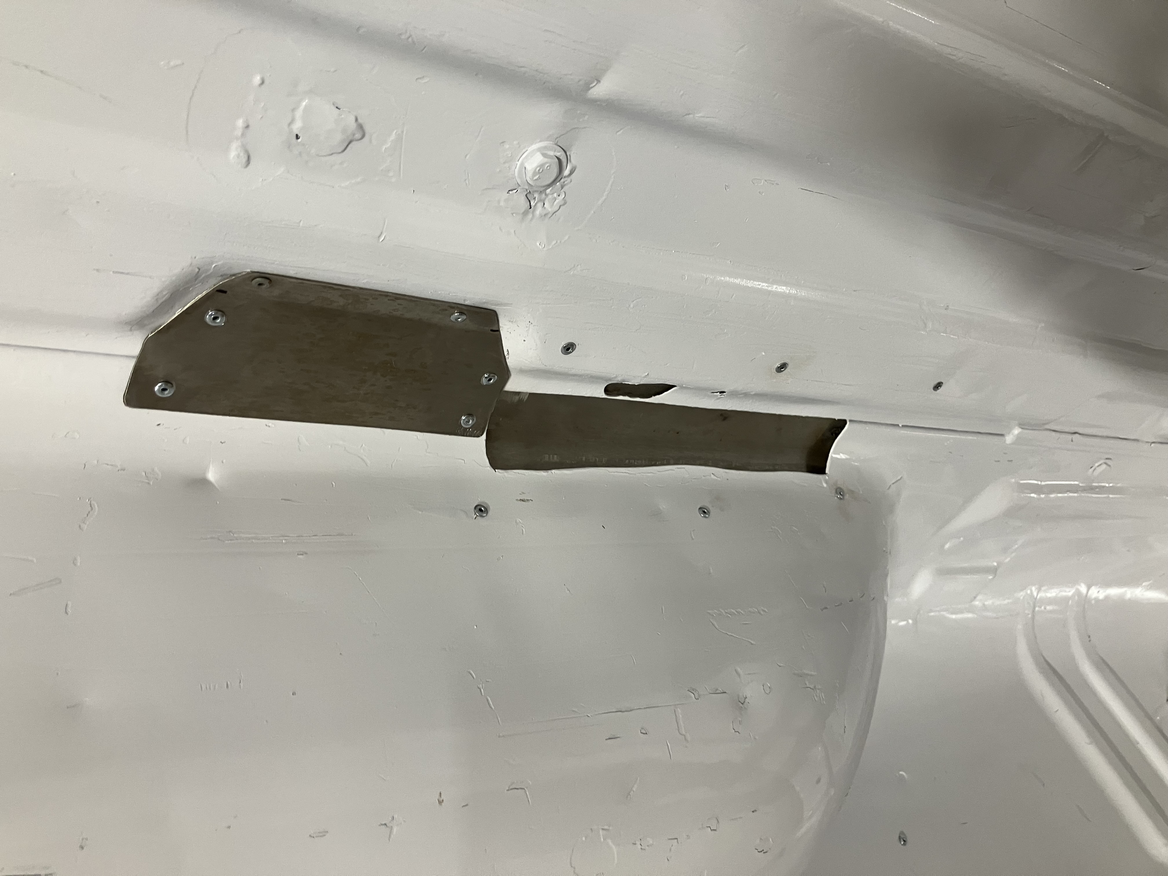

Kurt provided some stainless steel scrap for patches. In total there are sixteen patches. I decided to replace the metal on the fenders too even though I had procured some rear fender flares to cover the rust on them. Those patches were fairly easy to make though since they are flat with the fender. There was some decent amount of forming required for a few of them – but this metal was reasonably malleable so this was not a bad task.

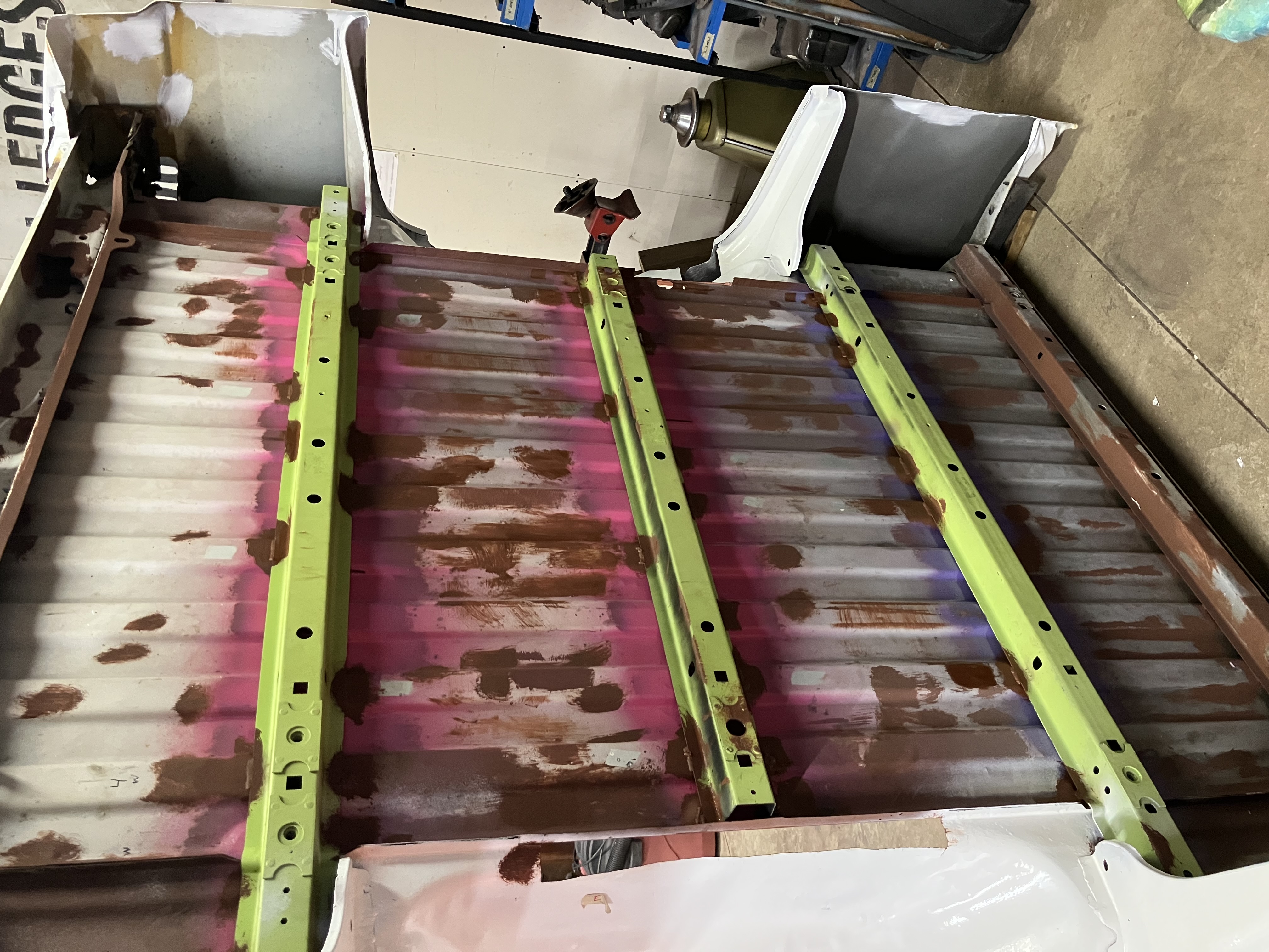

Once the metal was prepped I painted under where the cross braces are headed – using Rustoleum rusty metal primer and some misc spray can paint. Definitely left a rainbow of colors on the bottom of the bed. I also primed all the surface rust on the exterior part of the fenders. I brush painted Rustoleum white on these surfaces, and also used the spray can I had to paint the bottom of the inner fender wells white.

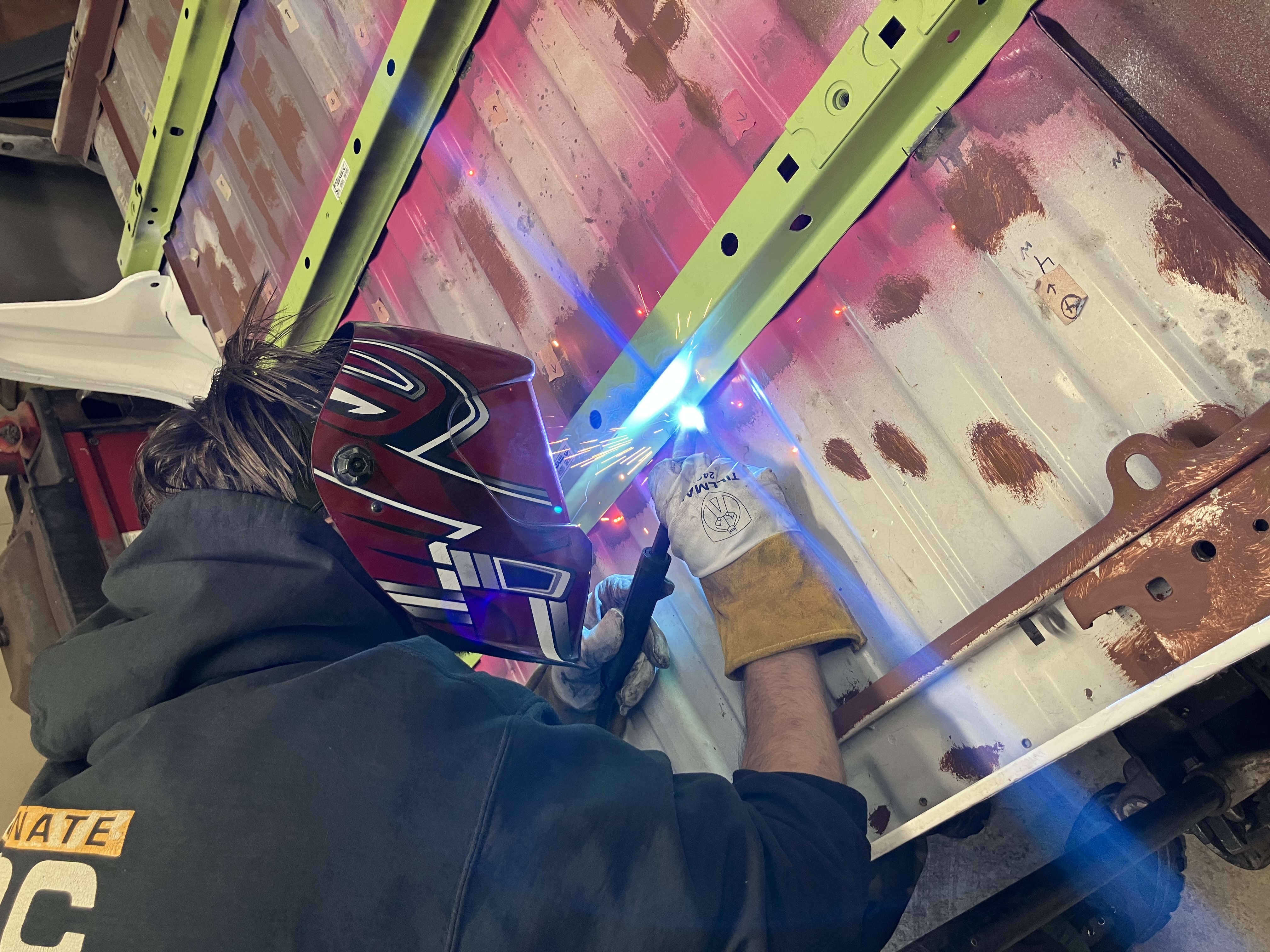

I then did final alignment on the cross braces, bolted them down and then had Kurt weld them in place. Those welds laid down real nice. He also filled some small holes in the bed – some of them not the best due to trying to weld thinner metal.
From there I cleaned up the welds, and primed them as well as the surface rust on the top of the bed.

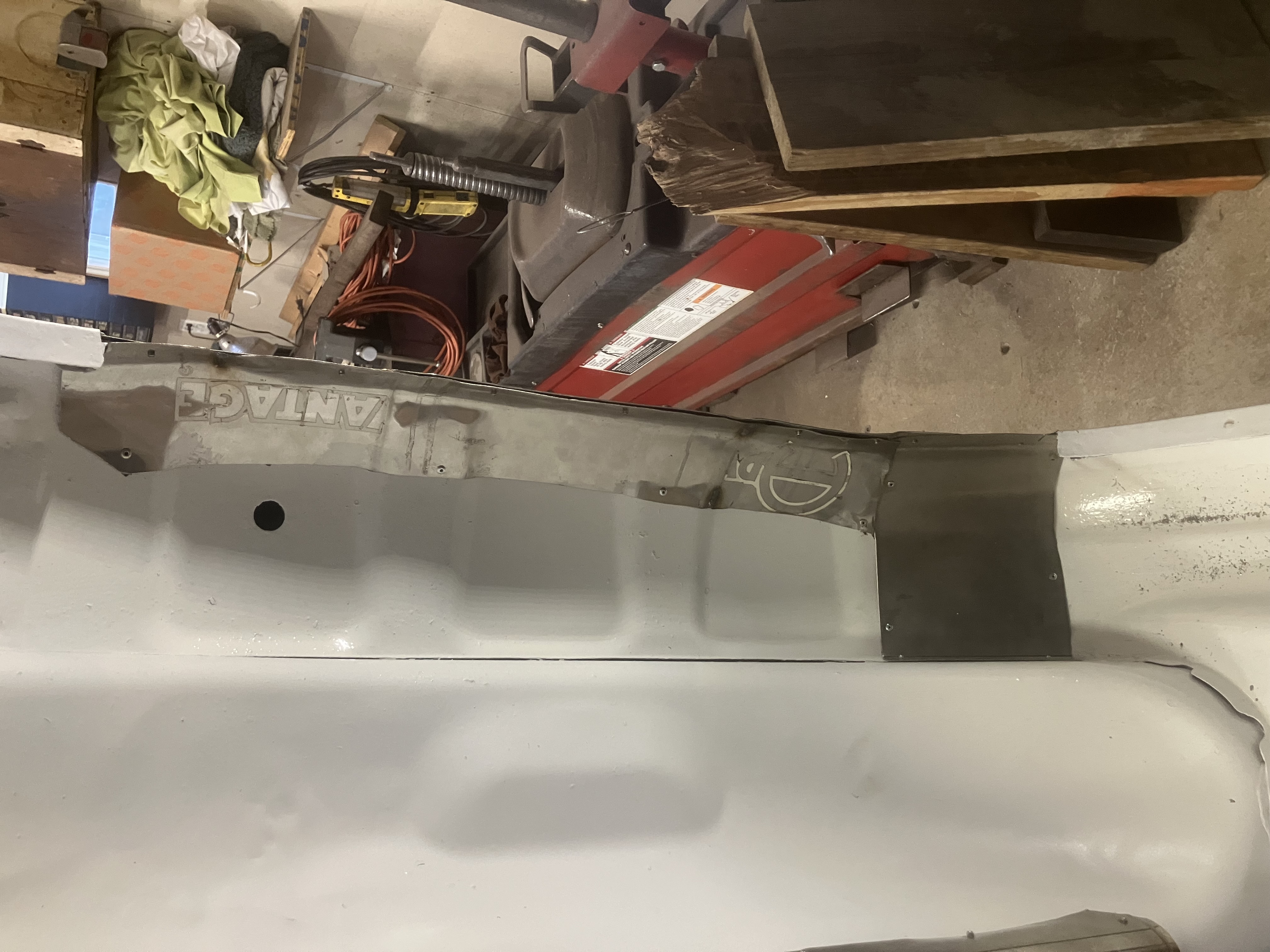

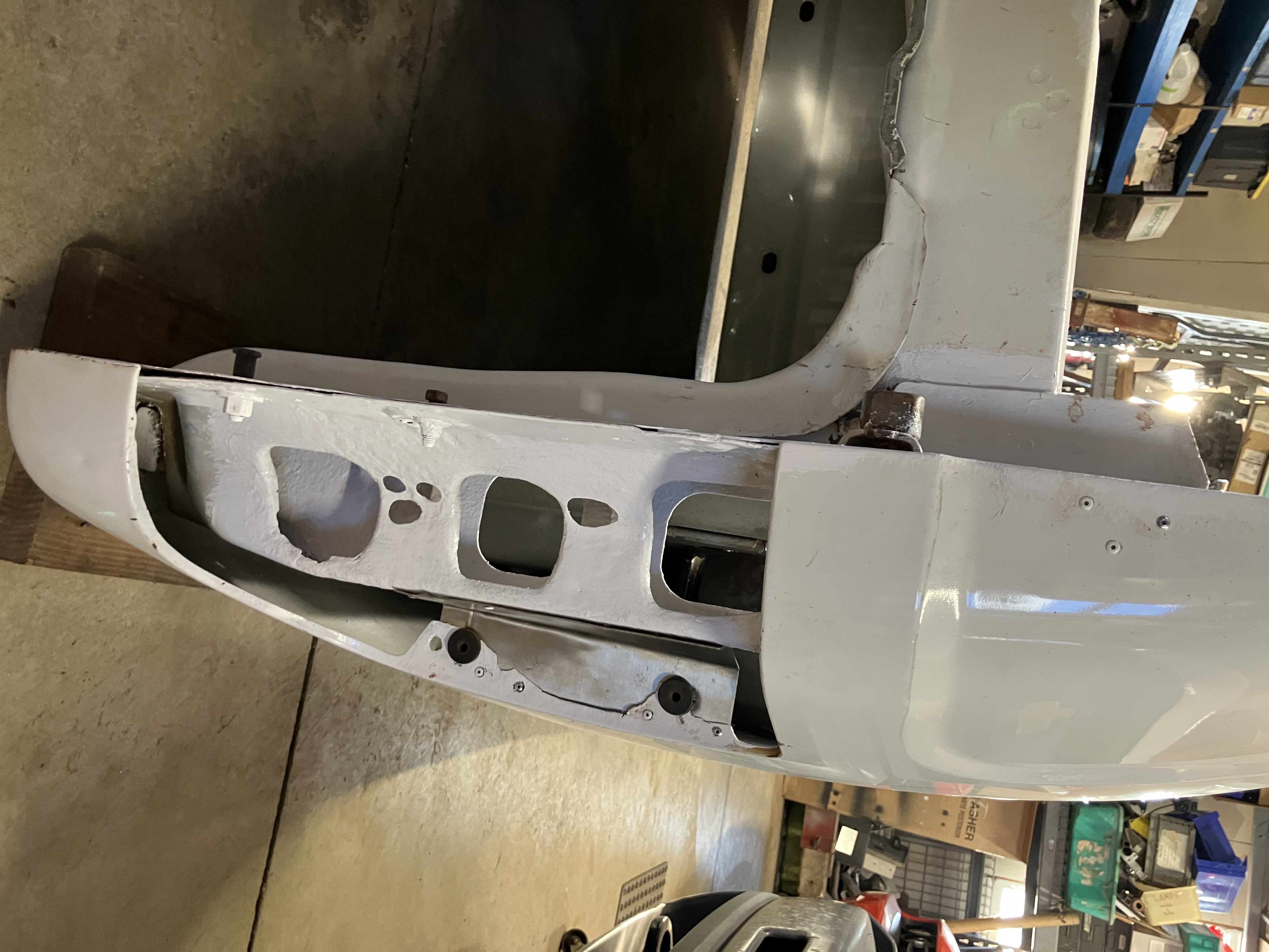

Up next was addressing the taillight wells and the underlying supports. They were quite rusty, to the point where the fender was barely attached on both sides where it should have been attached in two places. I fabricated two patches for each side out of the stainless. Then finished rust removal, brush primed and painted these areas, then riveted in the patches. There was some measuring required, since the fenders were so weakly attached they had moved closer to the gate.

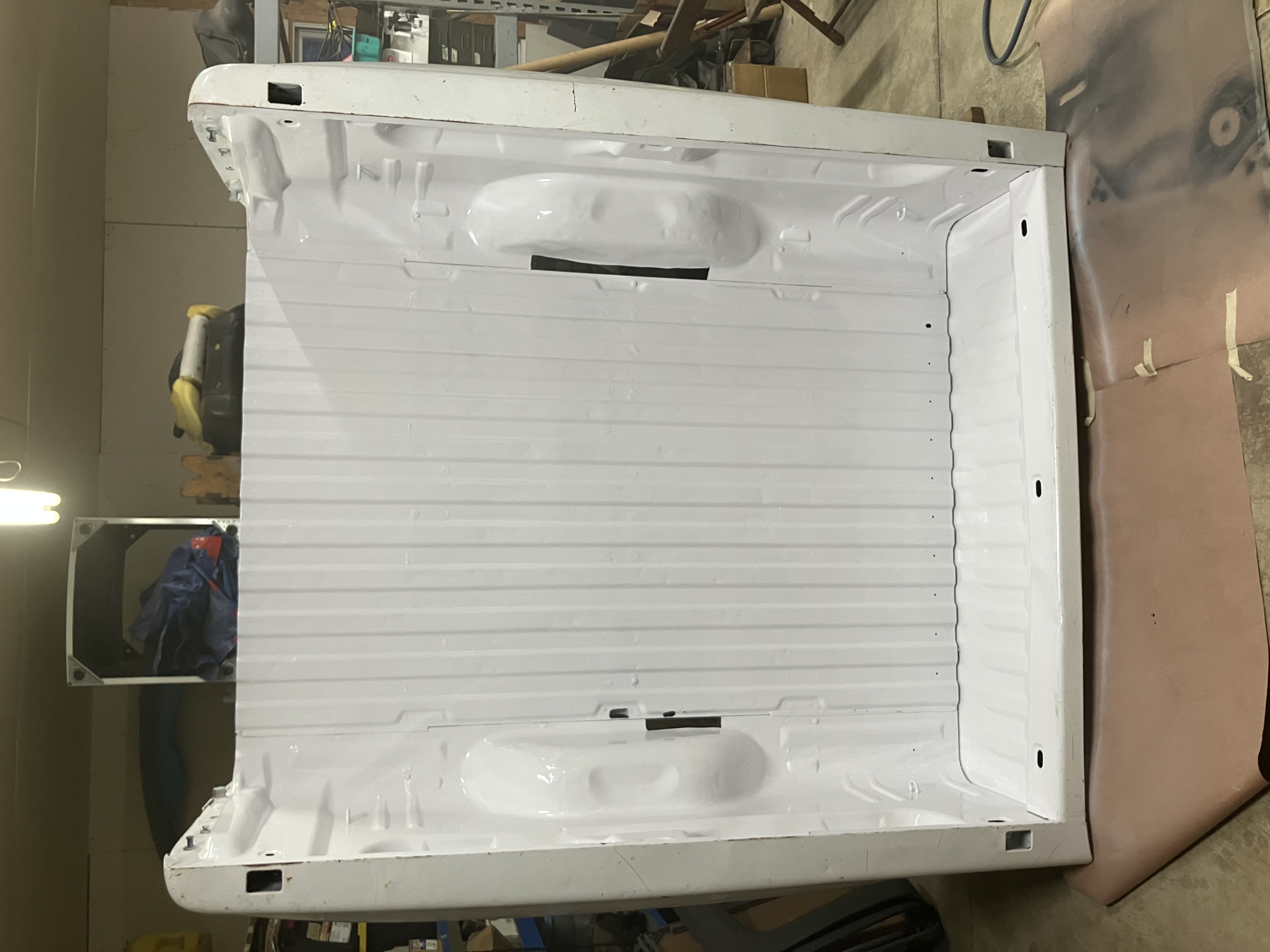

Once that was done I applied seam sealer around all the patches in the bed and in the wheel wells. Also found some correct bolts in my M6-1.0 hardware bin and installed the heat shield.
Finishing touches included touching up the seam sealer, rivets on white, and a few other blemishes, followed up by installing the fender flares.
