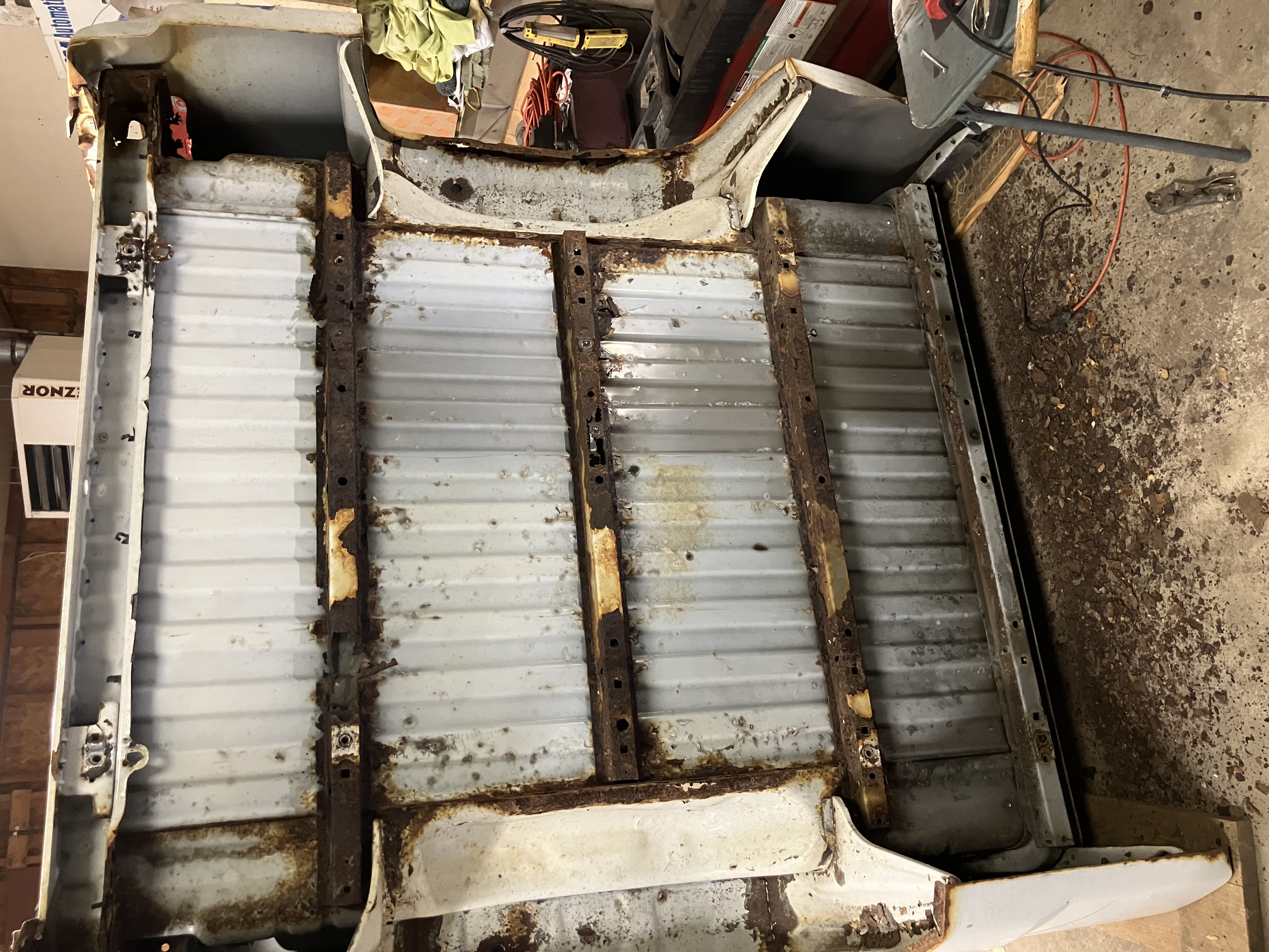

The bed
When buying this truck we could see the cross braces under the bed were rusted. Walking in the bed I could hear them crunching under there. It also had rust at the tops of the wheel wells but looked pretty salvageable.

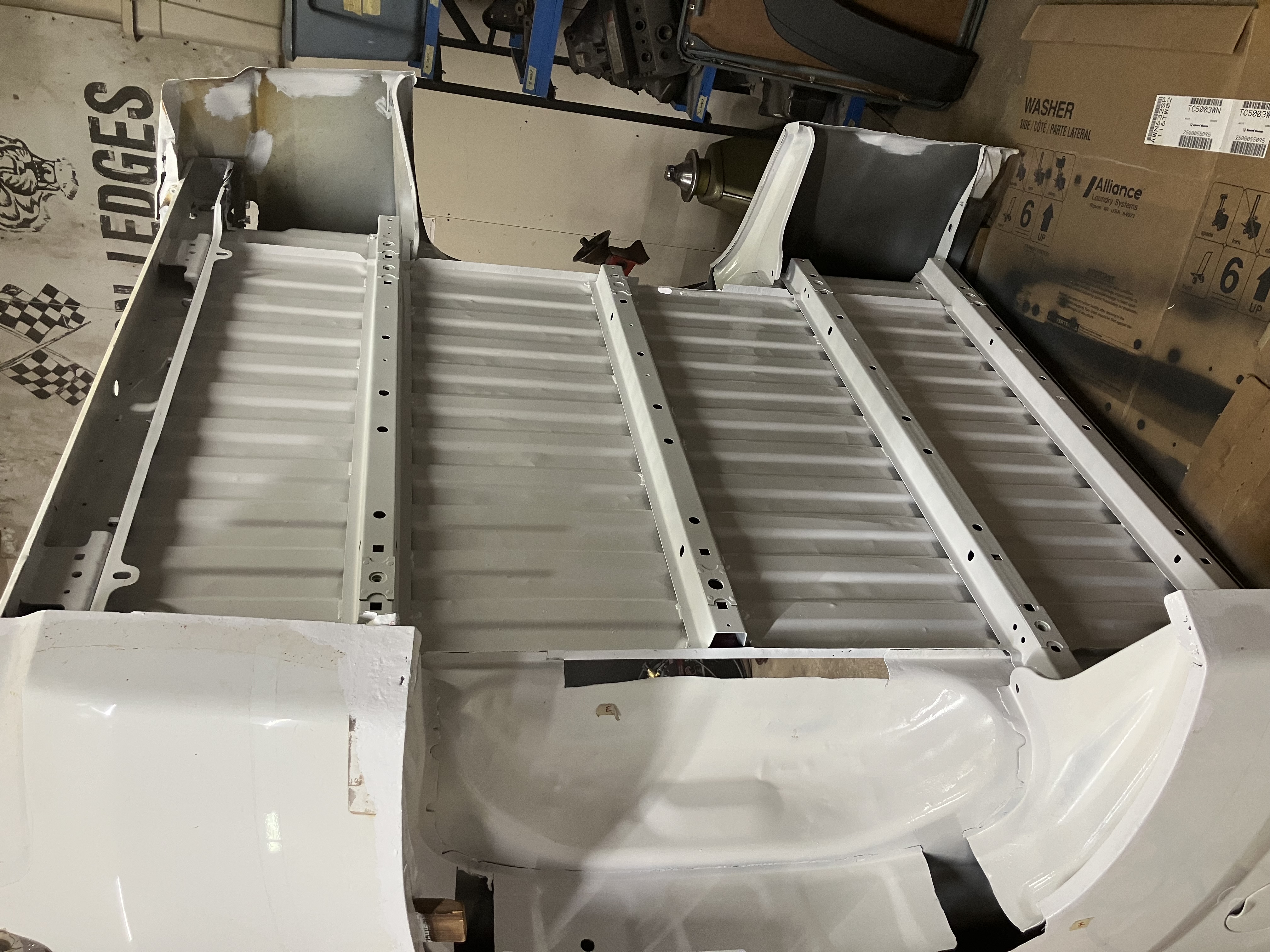

To fix this the bed had to come off. This was not a very complicated process. Disconnect the filler neck, remove tailgate, rear bumper, taillight wiring and 8 bolts and its ready to come off. With a little help from the engine hoist it was off. This made working on the bed much easier. I stood it on the cab side or laid it upside down depending on what was best for the task.
The bed has 5 cross braces, only middle three were bad. They came off fairly easily by grinding out the remaining holding spot welds. I located brand new replacement cross braces from Dorman. There were other cheaper ones but these had weldable primer and I’m thinking they are probably a bit thicker metal. They should outlast the rest of the truck.
After that spent a lot of time cleaning rust off the bed. It had a lot more rust than I thought. Knocked off all the loose rust – the worst of it was the supports behind the tail lights, then cut out a lot of paper thin metal. After that I used the wire wheel and the grinder to knock off all the rust and clean up the metal in the areas where the new cross braces are to be welded. Since its cold weather I had to run a fan to exhaust out all the rust dust. This helped a ton keeping the air breathable and limiting dust on everything in the garage.

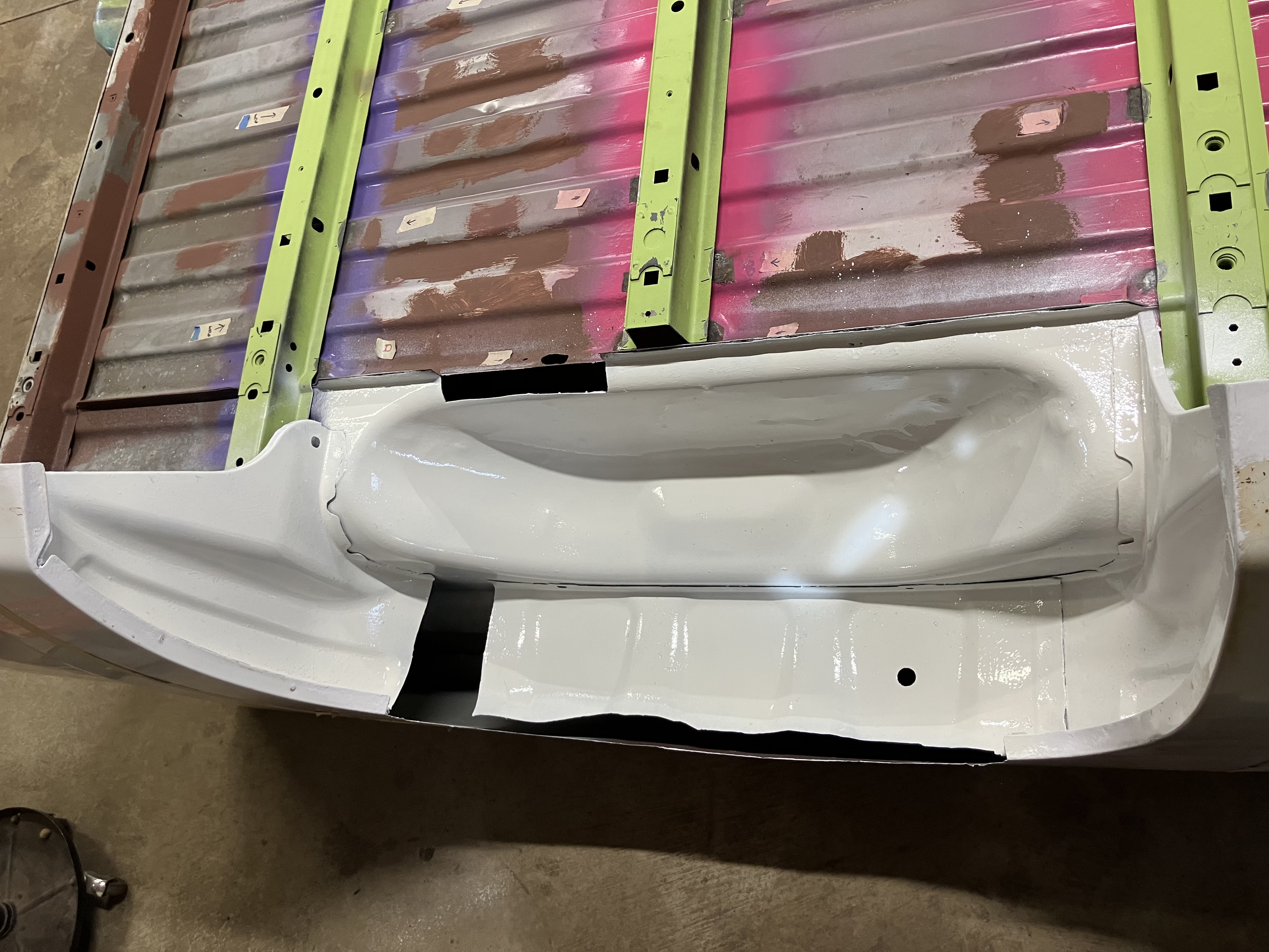

There were several dents in the passenger side quarter panel which I took the time to straighten. They are by no means straight but way better and probably good for the 20’ test.
Kurt provided some stainless steel scrap for patches. In total there are sixteen patches. I decided to replace the metal on the fenders too even though I had procured some rear fender flares to cover the rust on them. Those patches were fairly easy to make though since they are flat with the fender. There was some decent amount of forming required for a few of them – but this metal was reasonably malleable so this was not a bad task.
Once the metal was prepped I painted under where the cross braces are headed – using Rustoleum rusty metal primer and some misc spray can paint. Definitely left a rainbow of colors on the bottom of the bed. I also primed all the surface rust on the exterior part of the fenders. I brush painted Rustoleum white on these surfaces, and also used the spray can I had to paint the bottom of the inner fender wells white.
I then did final alignment on the cross braces, bolted them down and then had Kurt weld them in place. Those welds laid down real nice. He also filled some small holes in the bed – some of them not the best due to trying to weld thinner metal.
From there I cleaned up the welds, and primed them as well as the surface rust on the top of the bed.
I had originally planned to use up random spray cans on the underside of the bed, and getting some spray can white to do inside of the bed. Kinda didn’t like that approach and decided to see if I could use the spray gun to apply Rustoleum. With the help of a YouTube video I learned you can do this, and to use acetone to cut the paint.
This worked well. I didn’t go crazy with prep – it had been <24 hrs since I applied primer so it should adhere to that reasonably well. I didn’t even sand it. I just wanted that layer of protection and color coordination. After that the patches needed installed. Did all that with pop rivets.

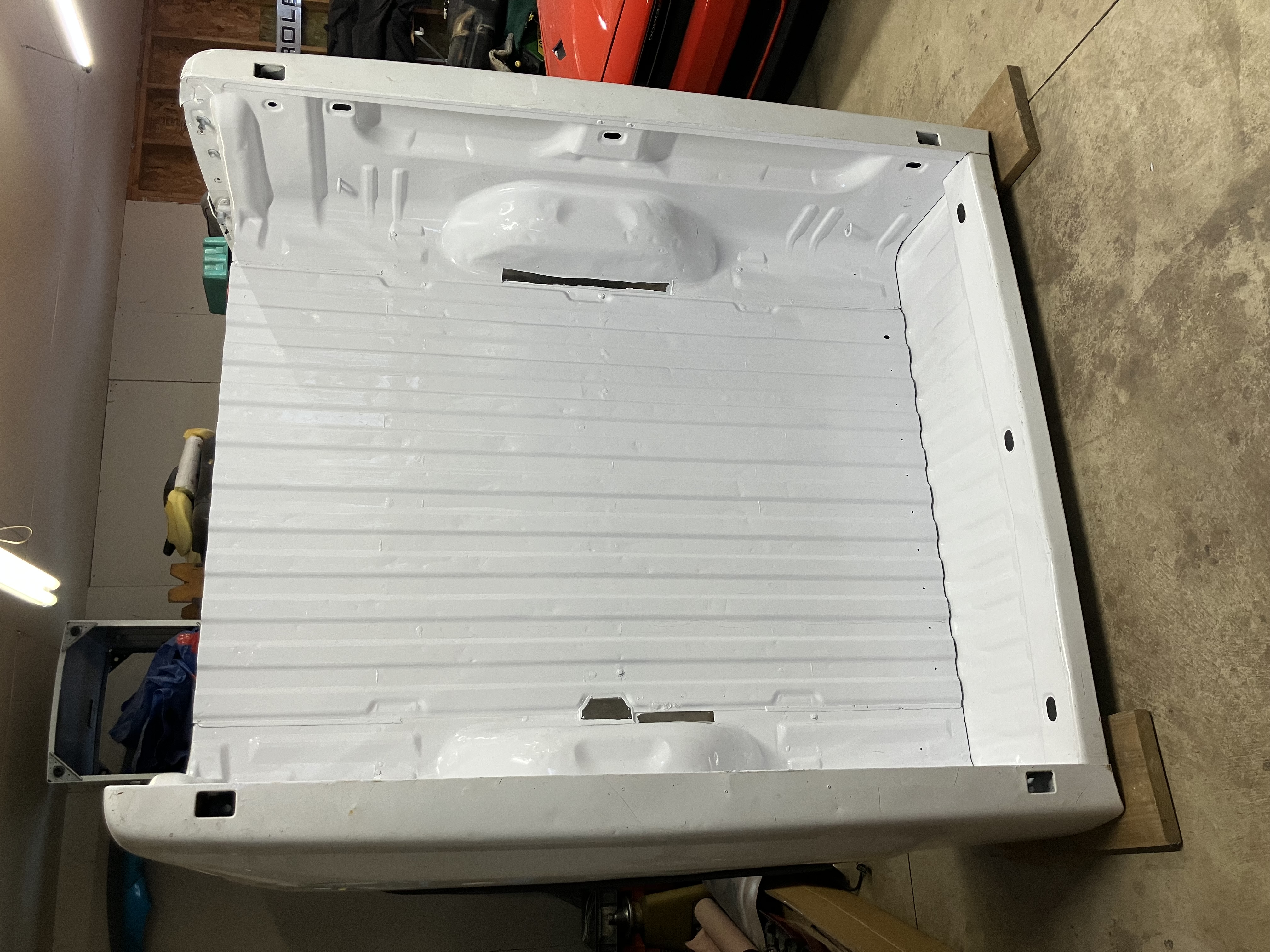

Up next was addressing the taillight wells and the underlying supports. They were quite rusty, to the point where the fender was barely attached on both sides where it should have been attached in two places. I fabricated two patches for each side out of the stainless. Then finished rust removal, brush primed and painted these areas, then riveted in the patches. There was some measuring required, since the fenders were so weakly attached they had moved closer to the gate.
Once that was done I applied seam sealer around all the patches in the bed and in the wheel wells. Also found some correct bolts in my M6-1.0 hardware bin and installed the heat shield.
Finishing touches included touching up the seam sealer, rivets on white, and a few other blemishes, followed up by installing the fender flares.
Pretty sure this is the biggest single task in this project

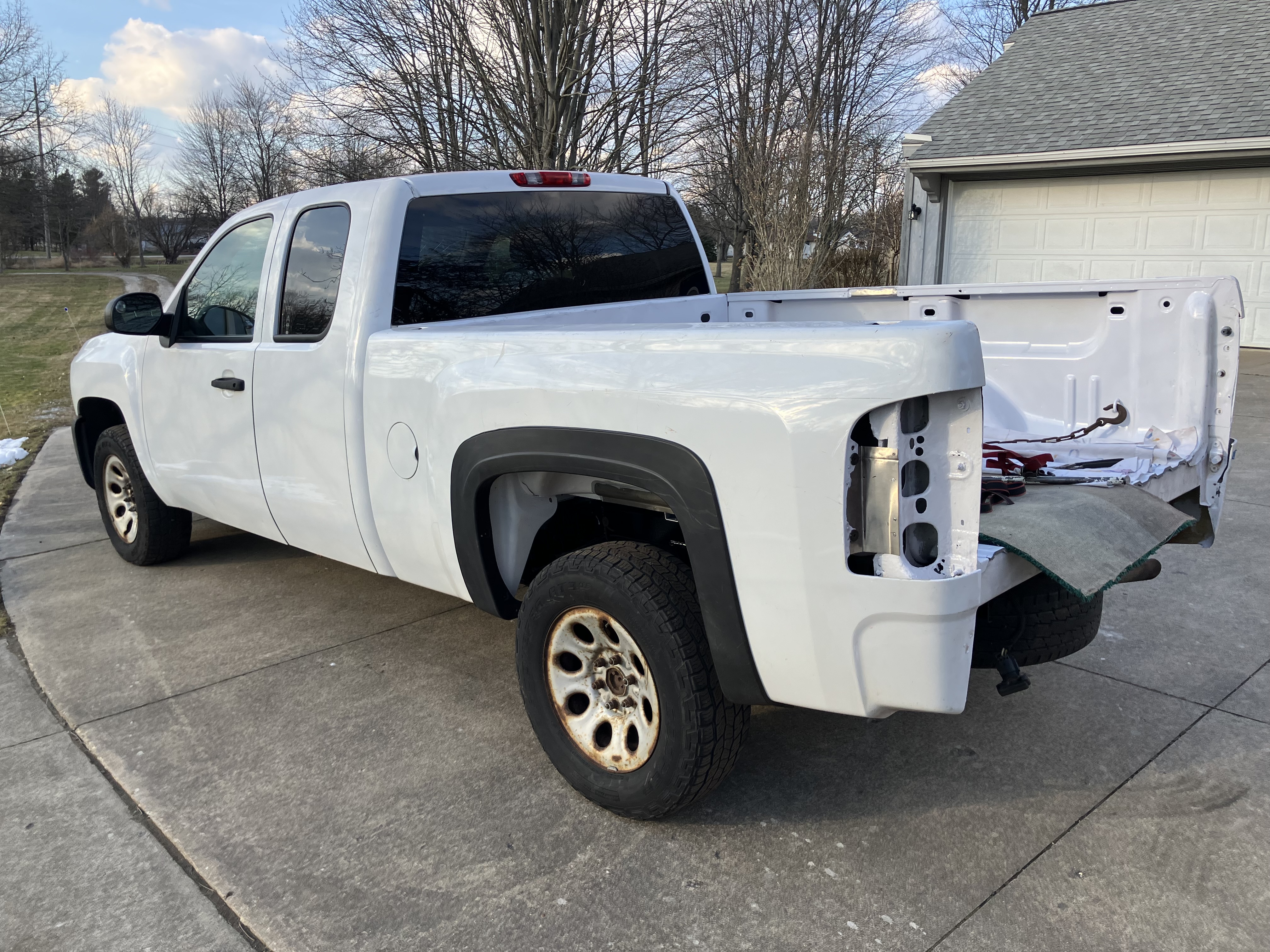

I'm way behind on updates - here's a big chunk of what happened after the bed repair was completed:
Rear frame
The biggest surprise on this truck was that there was rust damage on the frame. Before buying I specifically crawled underneath and looked at it, but I could not see above the gas tank. One cross bar that runs between the frame rails and over the gas tank was quite rusted at the bottom. Literally the bottom of this bar was completely gone just rust. There was one spot where the top of the driver side frame rail was rusted and needed a patch. Also the first cross bar under the bed on the driver side had a couple small spots that needed patched. All of this was due to basically the same thing – debris spills over the front of the bed and accumulates in the first cross bar, between the frame rail and the gas tank, and under the second cross bar.
The fix involved removing the wiring harness behind the bed, the spare tire and the gas tank, buying a pre-fabricated cross bar ($65), cutting out the old one, cutting out the rusted spots, fabricating some patches and welding it all back in. the replacement had side plates which allowed me to cut the frame a little big to get the new bar in. I measured to ensure the bar would go back in the same place. This prefit kit had the right dimensions on the bar, but the side plate that was pre-welded was not perpendicular to the bar and caused clearance issue with the tank, the side plates were too big and had to be trimmed quite a bit, and the gas tank strap bracket was a bit crooked.
Also cleaned the rust off the rest of the frame behind the cab. I used a combo of body grinder, pneumatic descaler, wire wheels. The last prep task was getting the spare down. The hoist mechanism has a secondary latch that will keep the tire from falling off if the primary fails. The problem with the secondary system is it gets rusty and will not release. I figured out how to release it and then spent a bit of time freeing up the mechanism.
After that it was time for paint. I used my air spray gun to apply Rustoleum primer followed up by gloss black. The primer left brown dust everywhere but cleaned up easily. The weather was nice when I put the color on so I had the garage door open, but that stuff is a lot stickier for longer and it made kind of a mess. I used old bed sheets on the hood and roof and I still found a bit of residue under them. It’s minor but it’ll take a bit of work to clean off.
For good measure I made some shields to keep stuff from accumulating in the frame.

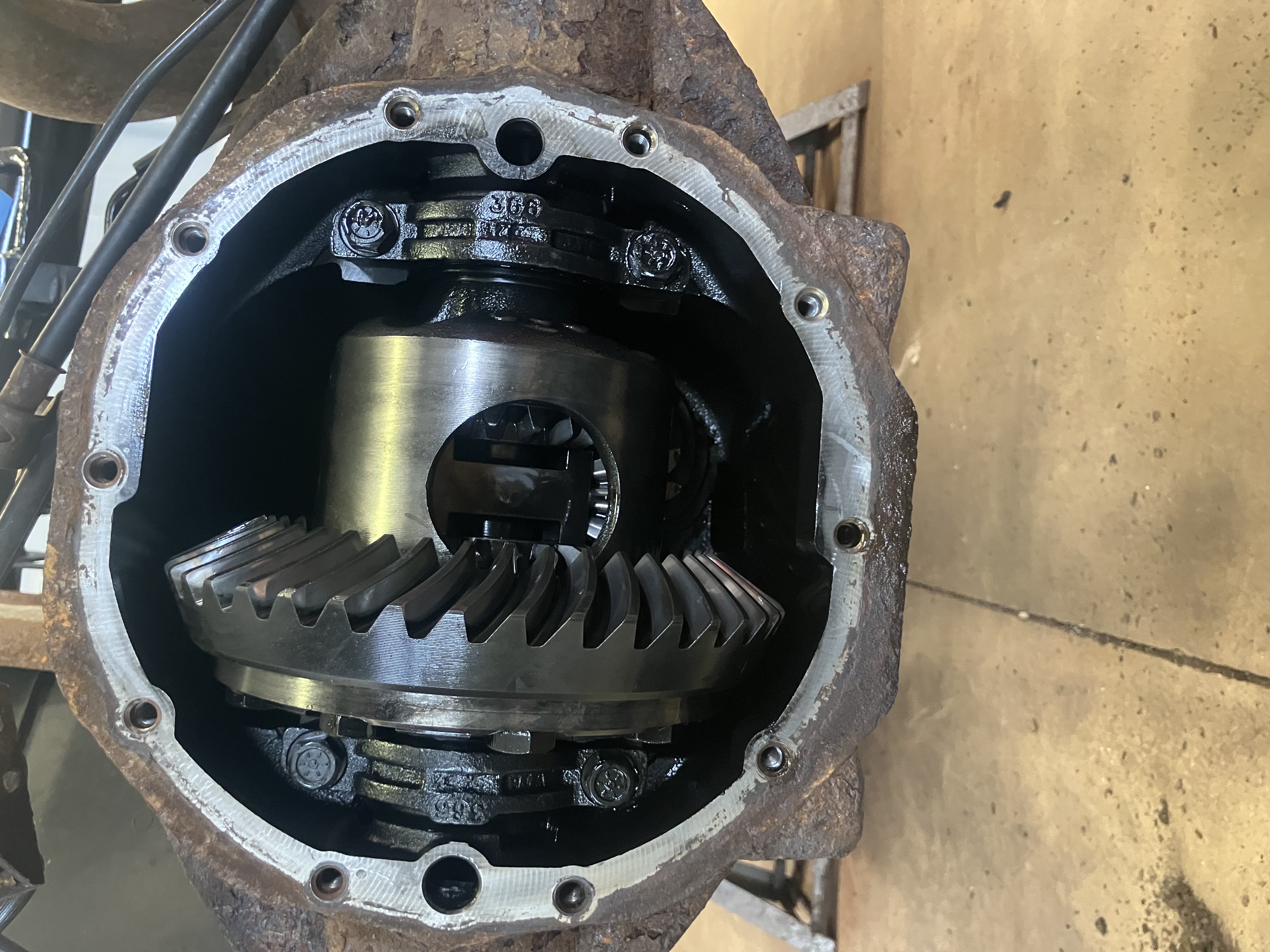

Having the bed off makes working on the back half of the truck super easy. I took advantage of this to address several things

Rear differential cover
This thing was rusted so badly I was afraid to knock the scale off for fear it would leak, so I bought a new one with a gasket and bolt kit. The old bolts were rusted quite badly. Originally 13 mm, most came off with a 12 mm and one required a bit of grinding to make flat surfaces and that required a 7/16

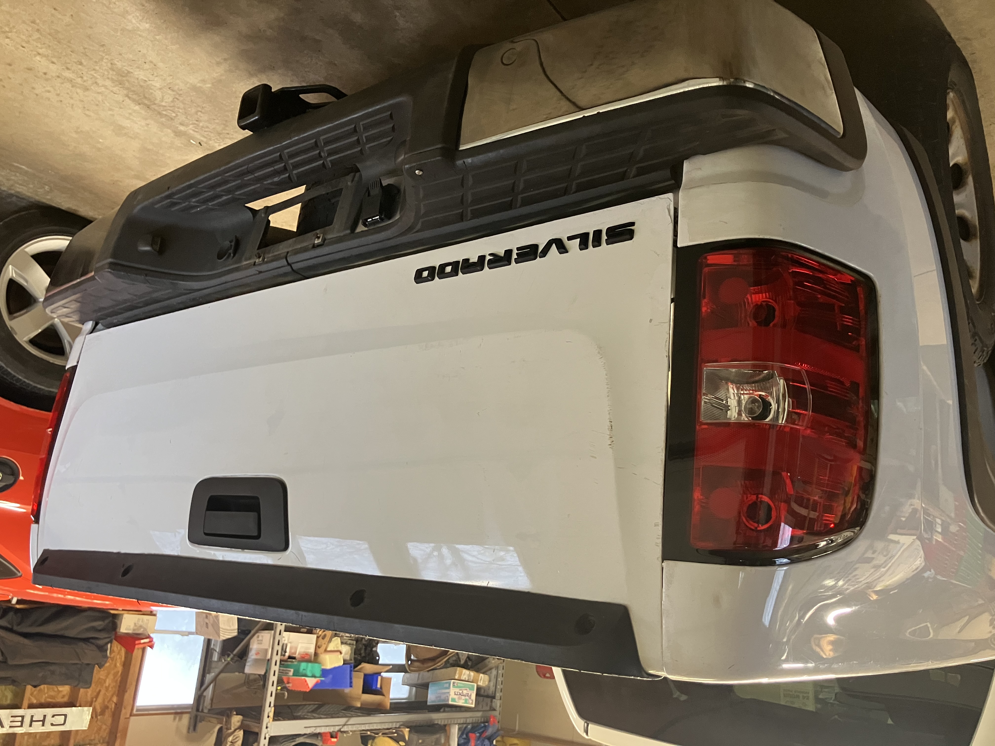

Putting it together
To install the bed I employed the hoist again, though this time I was careful in the bed not to scratch it up with the chains. I was able to set the bed on myself, just putting the two bolts closest to the cab in a little ways, then lift the back of the bed up just a bit to fit the bumper into the frame. It took a bit of adjusting to get the frame and the back of the bed to line up OK. It’s not perfect but the casual observer will not notice. Then 8 bolts and the fuel filler neck were attached, and the taillights went in. I made some minor adjustments to the rear post where the light attaches on one side to get it to sit in there decent.
For the gate, I had to adjust the lower hinge point on the bed since they were 1/8” too close. Can’t recall if the game was hard to remove, or if I moved something as I was fixing things. This truck had been hit on the left side (can see 1/4 panel was replaced long ago, and there was a bit of bondo on the lower left corner of the gate that has since cracked). It is possible this was leftover from the accident. Also the tops of gate opening is slightly smaller than the bottom of the gate opening. I don’t care the gate works fine.
The finishing touch is a black Silverado emblem on the gate. I bought a pair for $16 and they came with a template to align the letters. After I installed the first one I saw the template was actually crooked. I ended up peeling off the letters and using emblem adhesive to get them installed in a straight line.
