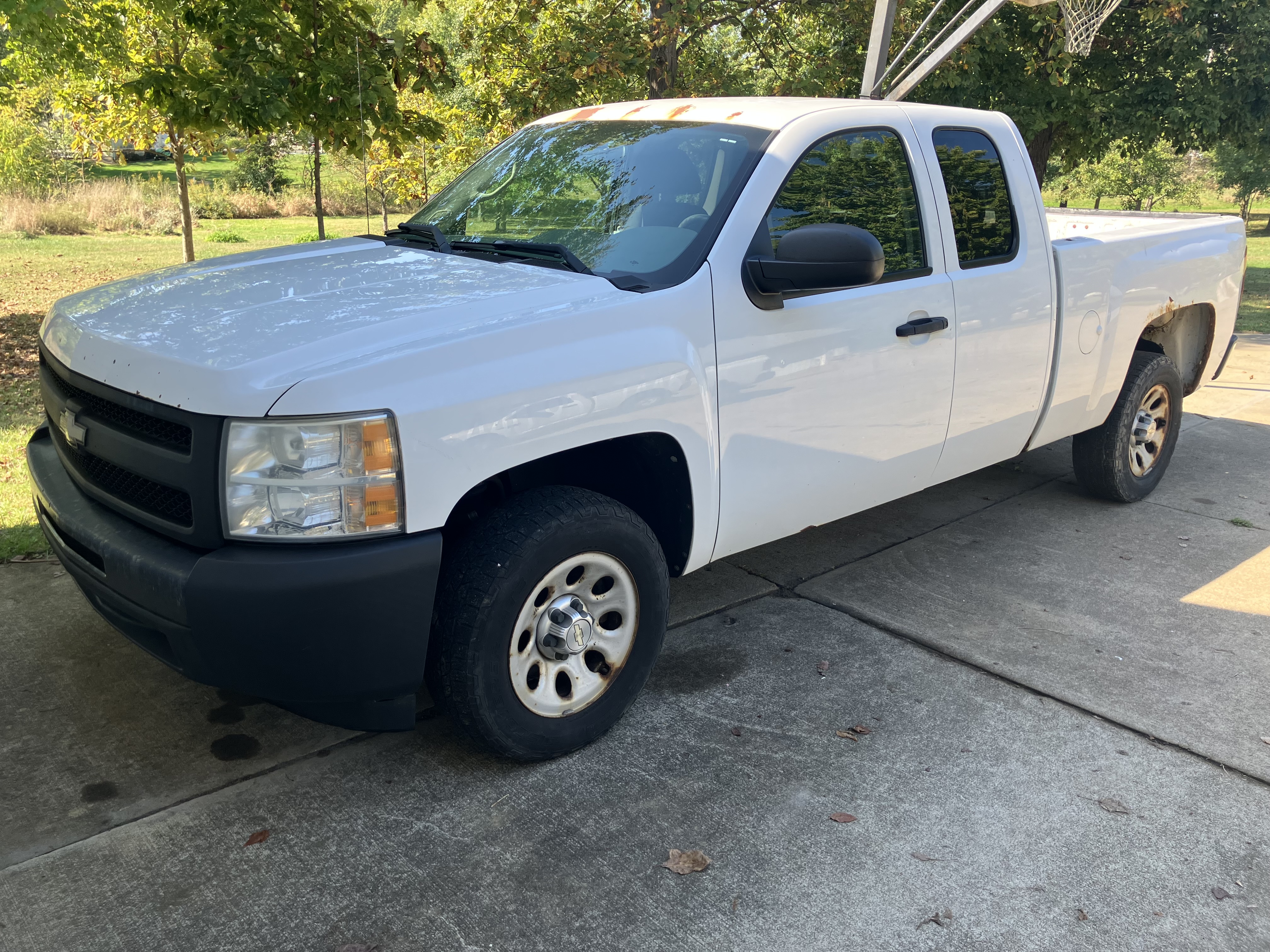

A week ago Monday at my suggestion, Kurt bought a 2010 Silverado for $2300. It’s a 2WD Work Truck with 170k miles and the 4.3 V6. This truck had been for sale for 11 weeks and he was asking $2900.
This truck needs work: broken windshield, slight coolant leak, blown out driver seat airbag, TPMS light on, driver door inside handle broken, tail gate not latching, broken headlight, both taillights broken, A/C not working, the support beams between the bed floor and the frame are quite rusted. We did a field repair after negotiating a price to bypass the power steering cooler which had failed earlier that day.
I have a long list of stuff to fix. For this thread though I’ll focus on what is getting done. With some effort and money this can be a good work truck for Kurt.

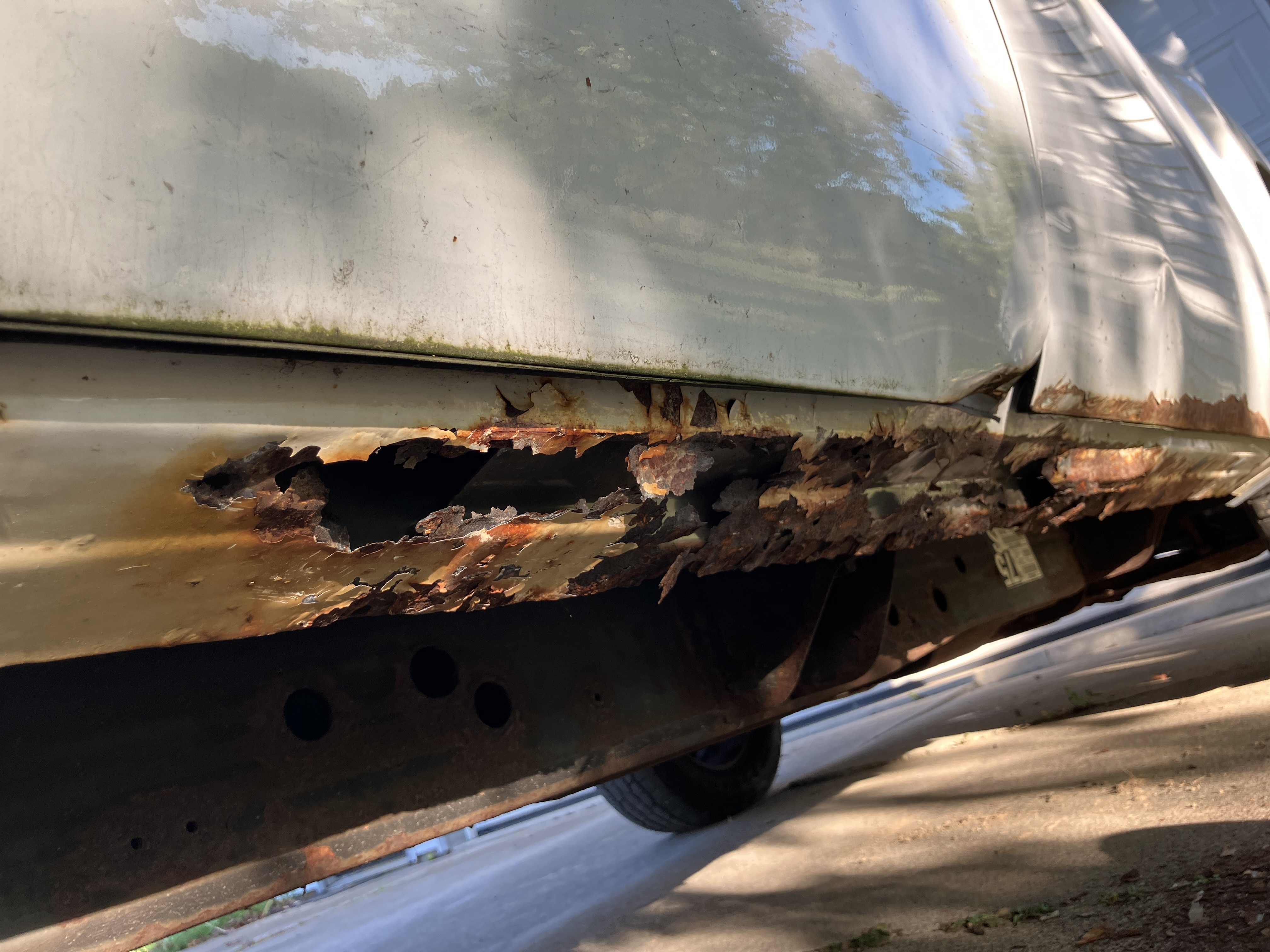

The rocker panels were all there when I looked at it but rusty. I was easily able to poke holes in them with my fingers. The hammer brought down a lot more rust.
Frame has some rust but looks solid. Cab looks solid except for the rocker panels. Engine runs good.

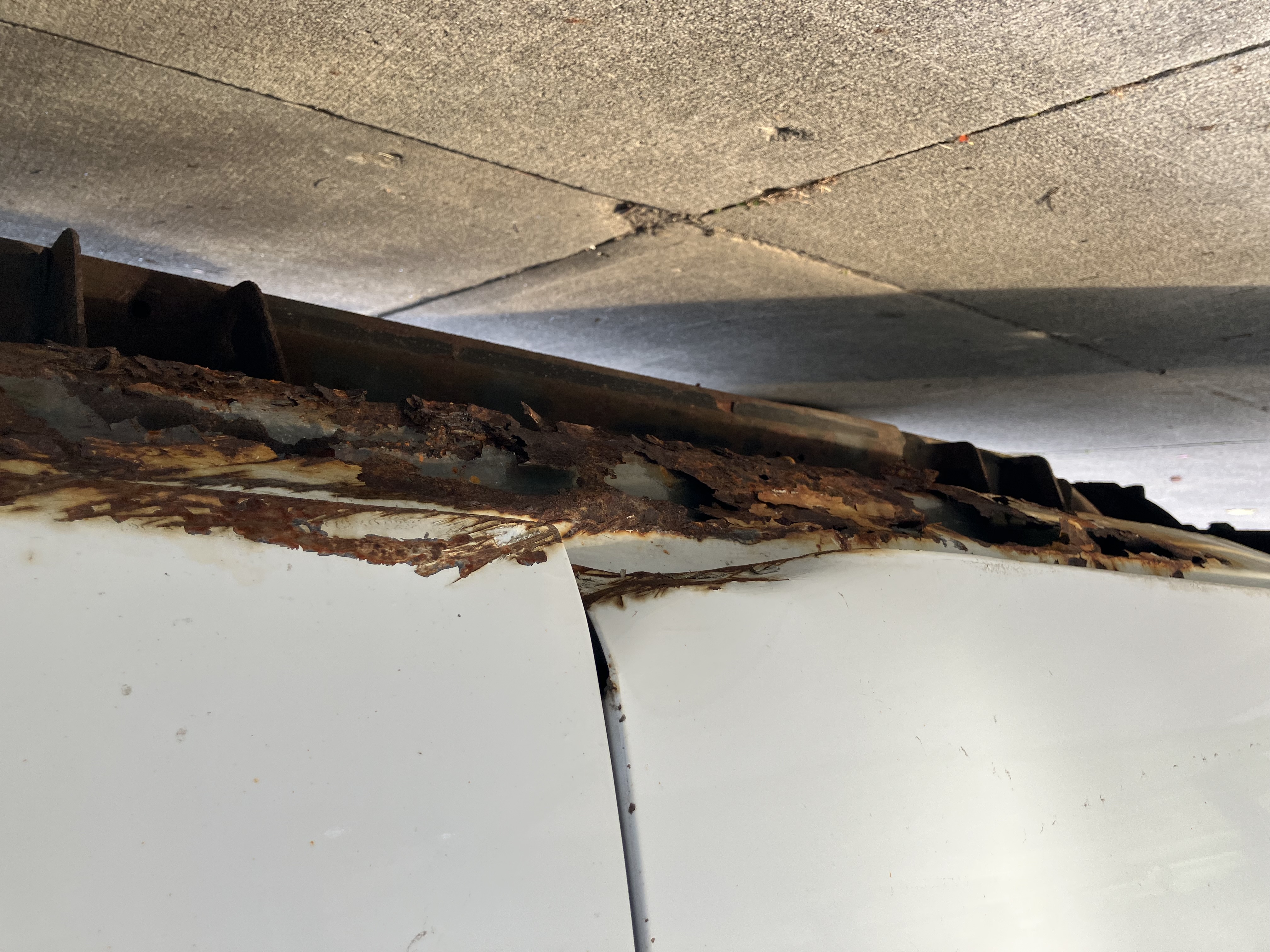

Fix the rust on the roof – item #7
Wanted to address the rust on the roof to open the possibility of getting the windshield replaced at any time. The rust spots on the front of the roof ran right up to the edge of the windshield. I removed all the trim at the top of the windshield (rubber pieces that are replaced when windshield is replaced) and was able to sand out the rust in the channel, as well as the rest of the rusted spots on the roof.
The factory paint on this truck is having problems with adhesion. There are places scattered all over this truck where the paint is flaking off: roof, door jambs, under the floor mat, bottom of the hood, bottom of the cab, inside the front fenders, under the bed. Current plan is knock off as much of the loose paint as is reasonable (with the right pressure washer it would probably all come off) and touch it up mostly to prevent rust and a little to help it look a little more presentable.
paint just flaking off
I’m taking BP’s recommendation and putting Rustoleum rusty metal primer on these areas, following that up with Rustoleum gloss white. It’s not an exact match but it passes the 20’ test pretty good. Prep includes cleaning out dirt, removing rust with wire wheel followed by a sander, removing loose paint with compressed air, then applying paint by brush. This oil base paint lays down nice and with the right amount of paint it does not leave brush marks. It’ll be fine for this truck’s purpose – probably more than I should bother with.

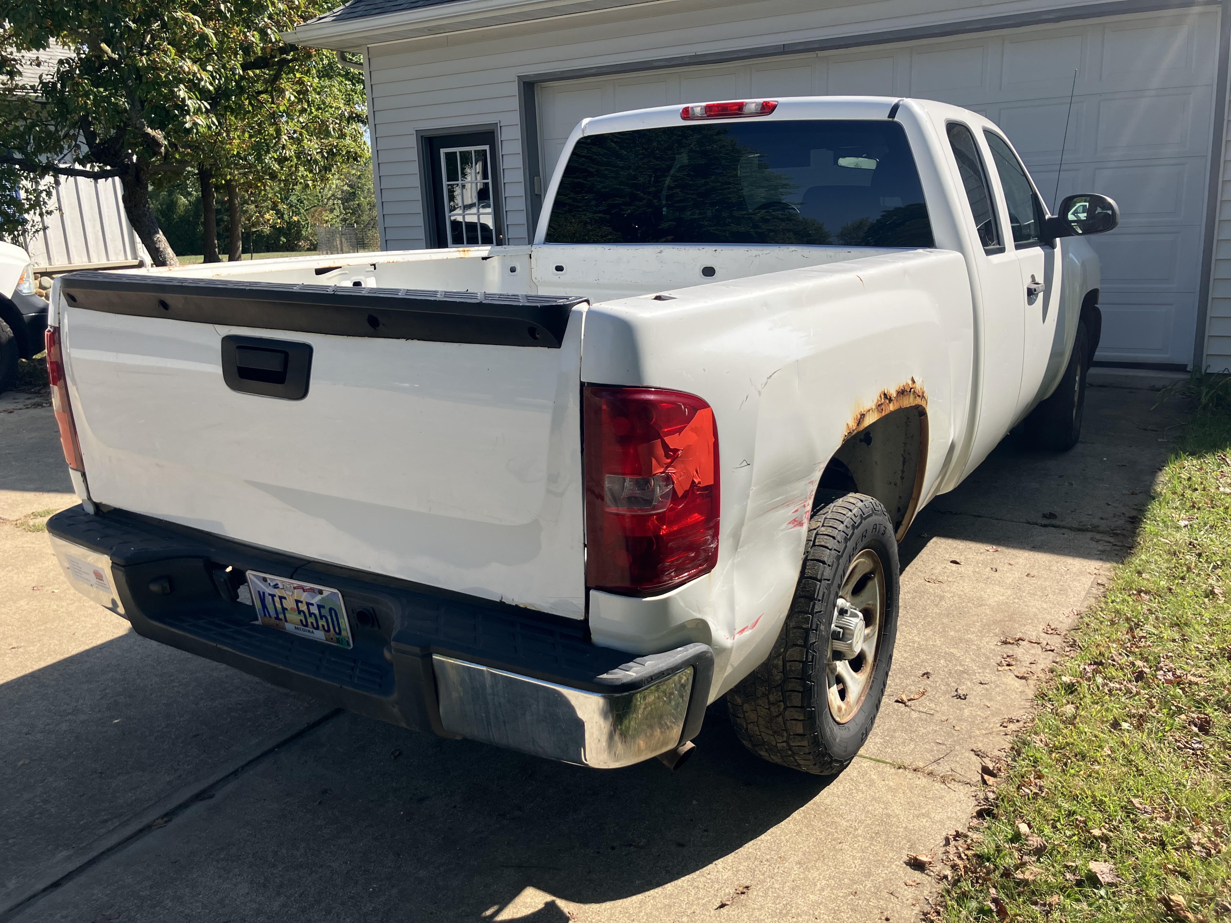

The bed
When buying this truck we could see the cross braces under the bed were rusted. Walking in the bed I could hear them crunching under there. It also had rust at the tops of the wheel wells but looked pretty salvageable.
To fix this the bed had to come off. This was not a very complicated process. Disconnect the filler neck, remove tailgate, rear bumper, taillight wiring and 8 bolts and its ready to come off. With a little help from the engine hoist it was off. This made working on the bed much easier. I stood it on the cab side or laid it upside down depending on what was best for the task.
The bed has 5 cross braces, only middle three were bad. They came off fairly easily by grinding out the remaining holding spot welds. I located brand new replacement cross braces from Dorman. There were other cheaper ones but these had weldable primer and I’m thinking they are probably a bit thicker metal. They should outlast the rest of the truck.
After that spent a lot of time cleaning rust off the bed. It had a lot more rust than I thought. Knocked off all the loose rust – the worst of it was the supports behind the tail lights, then cut out a lot of paper thin metal. After that I used the wire wheel and the grinder to knock off all the rust and clean up the metal in the areas where the new cross braces are to be welded. Since its cold weather I had to run a fan to exhaust out all the rust dust. This helped a ton keeping the air breathable and limiting dust on everything in the garage.
There were several dents in the passenger side quarter panel which I took the time to straighten. They are by no means straight but way better and probably good for the 20’ test.
one of the dents
one of the dents
Kurt provided some stainless steel scrap for patches. In total there are sixteen patches. I decided to replace the metal on the fenders too even though I had procured some rear fender flares to cover the rust on them. Those patches were fairly easy to make though since they are flat with the fender. There was some decent amount of forming required for a few of them – but this metal was reasonably malleable so this was not a bad task.
11 of the patches
11 of the patches
Once the metal was prepped I painted under where the cross braces are headed – using Rustoleum rusty metal primer and some misc spray can paint. Definitely left a rainbow of colors on the bottom of the bed. I also primed all the surface rust on the exterior part of the fenders. I brush painted Rustoleum white on these surfaces, and also used the spray can I had to paint the bottom of the inner fender wells white.
I then did final alignment on the cross braces, bolted them down and then had Kurt weld them in place. Those welds laid down real nice. He also filled some small holes in the bed – some of them not the best due to trying to weld thinner metal.
From there I cleaned up the welds, and primed them as well as the surface rust on the top of the bed.
I had originally planned to use up random spray cans on the underside of the bed, and getting some spray can white to do inside of the bed. Kinda didn’t like that approach and decided to see if I could use the spray gun to apply Rustoleum. With the help of a YouTube video I learned you can do this, and to use acetone to cut the paint.
This worked well. I didn’t go crazy with prep – it had been <24 hrs since I applied primer so it should adhere to that reasonably well. I didn’t even sand it. I just wanted that layer of protection and color coordination.
After that the patches needed installed. Did all that with pop rivets.
Up next was addressing the taillight wells and the underlying supports. They were quite rusty, to the point where the fender was barely attached on both sides where it should have been attached in two places. I fabricated two patches for each side out of the stainless. Then finished rust removal, brush primed and painted these areas, then riveted in the patches. There was some measuring required, since the fenders were so weakly attached they had moved closer to the gate.
Once that was done I applied seam sealer around all the patches in the bed and in the wheel wells. Also found some correct bolts in my M6-1.0 hardware bin and installed the heat shield.
Finishing touches included touching up the seam sealer, rivets on white, and a few other blemishes, followed up by installing the fender flares.
Pretty sure this is the biggest single task in this project

Rocker panel patching
Original plan was to remove rust, paint the rest. Th back section of the rocker panels are still intact so I was going to fill the front section with expanding foam to keep the crap out of what’s left. However, once I was done prepping the metal I realized patching these would be fairly easy since there are very few bends to make. I had some sheet galvanized metal around and so that is what happened. I riveted these pieces on, painted them, and followed that up with some seam sealer. The rocker panels are very hard to see on this truck so the pop rivet look should not be noticed.
There was a small hole in the rocker panel a little ways below the door hinge on the driver side. Unfortunately, there was quite a bit more rust here than expected. Pulling back the door sill I found the floor to be rusted through. Also learned that the insulation under the floor mat was soaking wet. This truck has been sitting inside for over 6 months. I figure that at some point the rubber floor mat was hosed off (work truck has this not carpet) but the thing is not designed to drain so the water found its way under the mat and just never dried. I cut the insulation in order to remove/facilitate drying. After that I cleaned up the remaining metal, made a couple patches, painted and reassembled.
