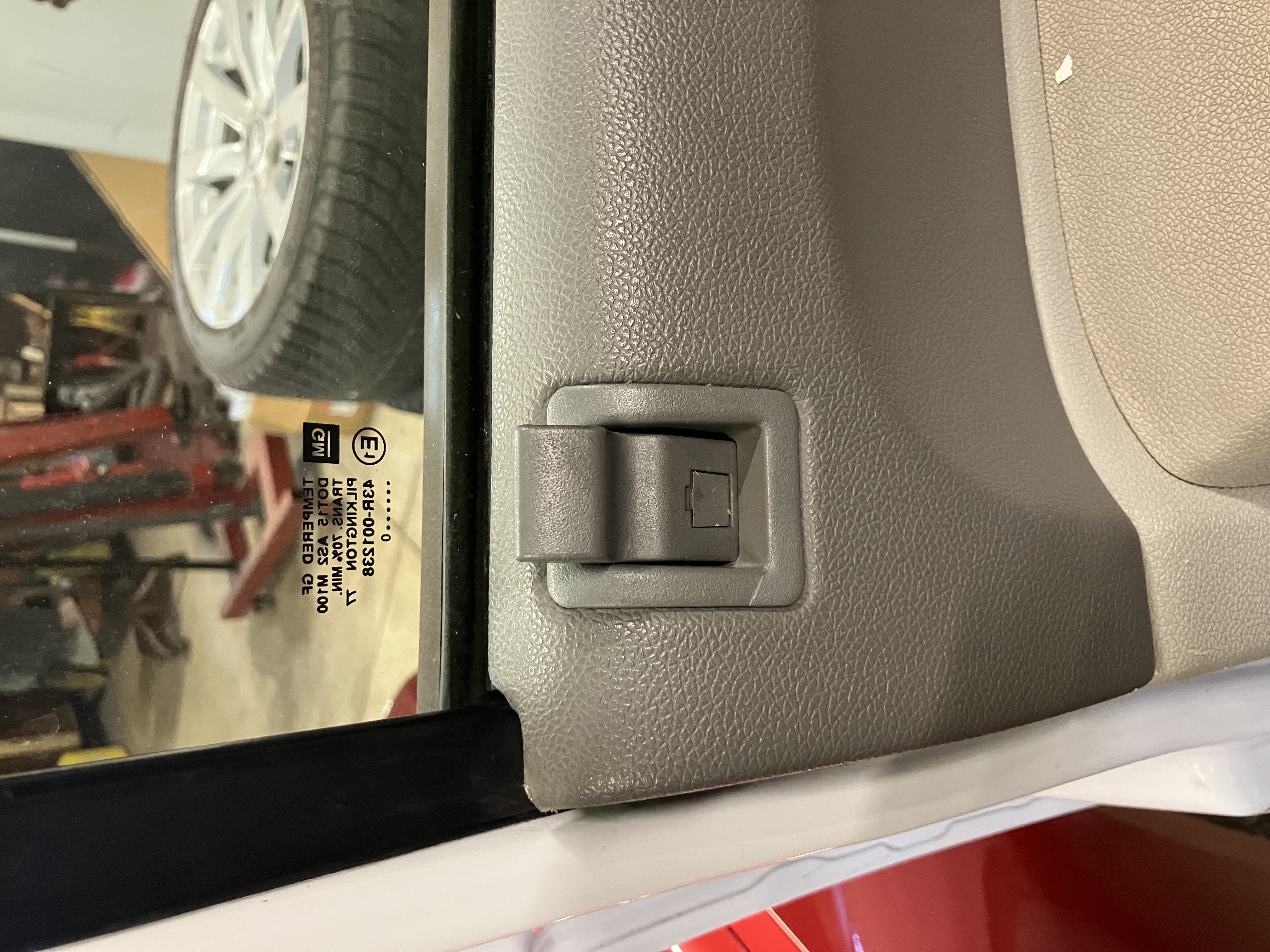

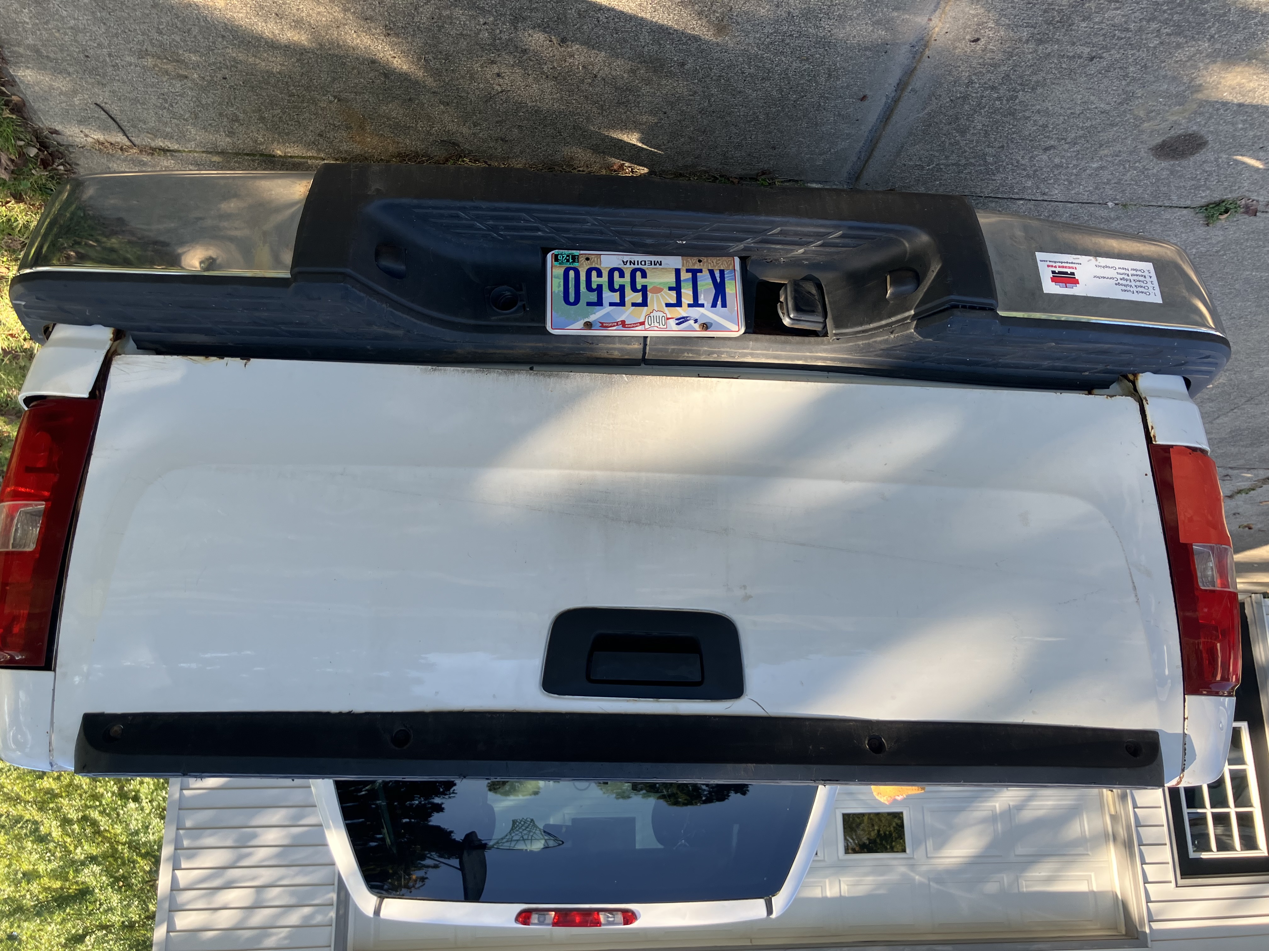

Fix the Gate – item #1

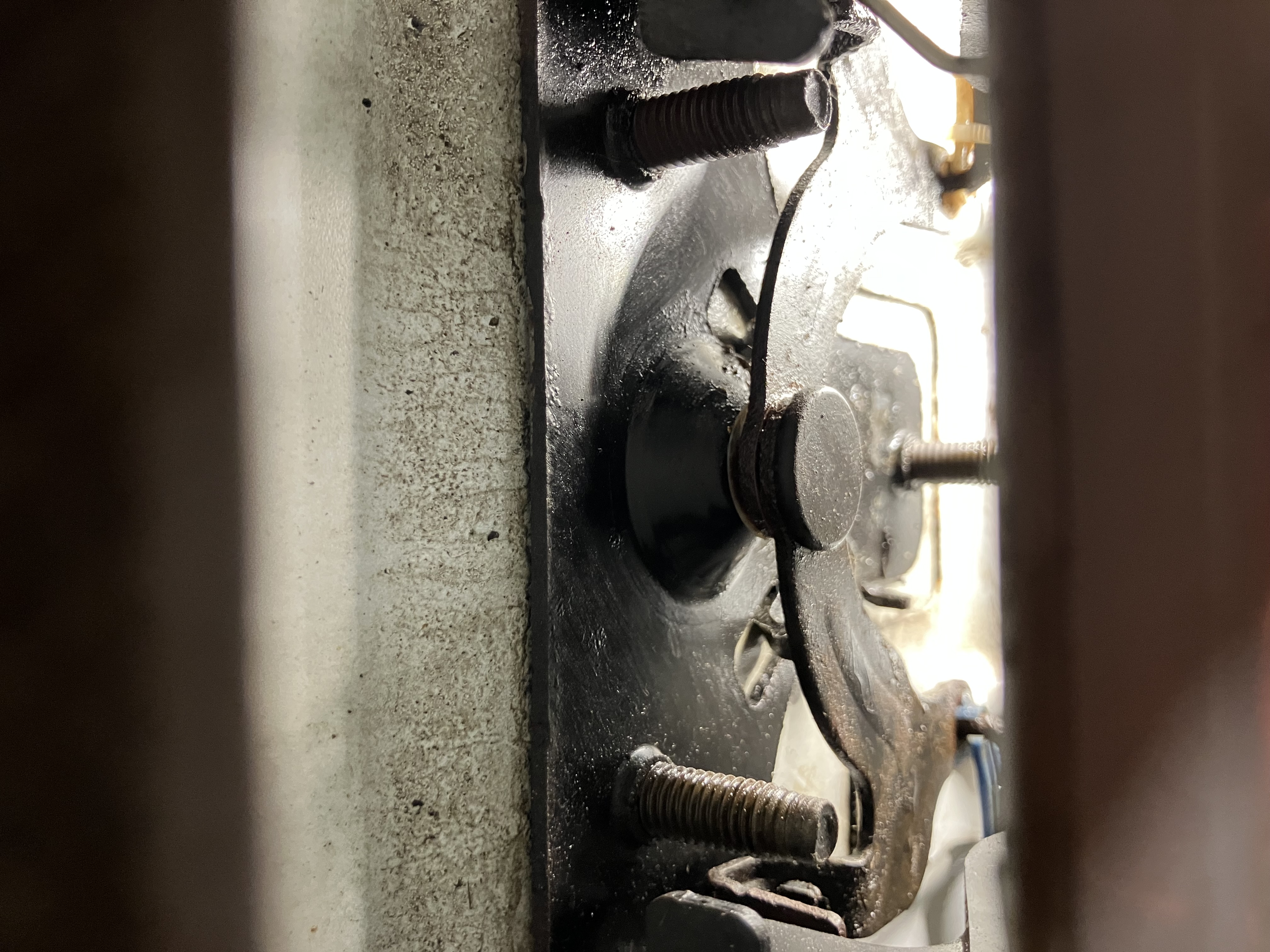

The gate would not latch, so it was held up with a ratchet strap. With a little bit of effort I was able to determine the center latch was rusted – with some PB Blaster and some patience I freed it up.

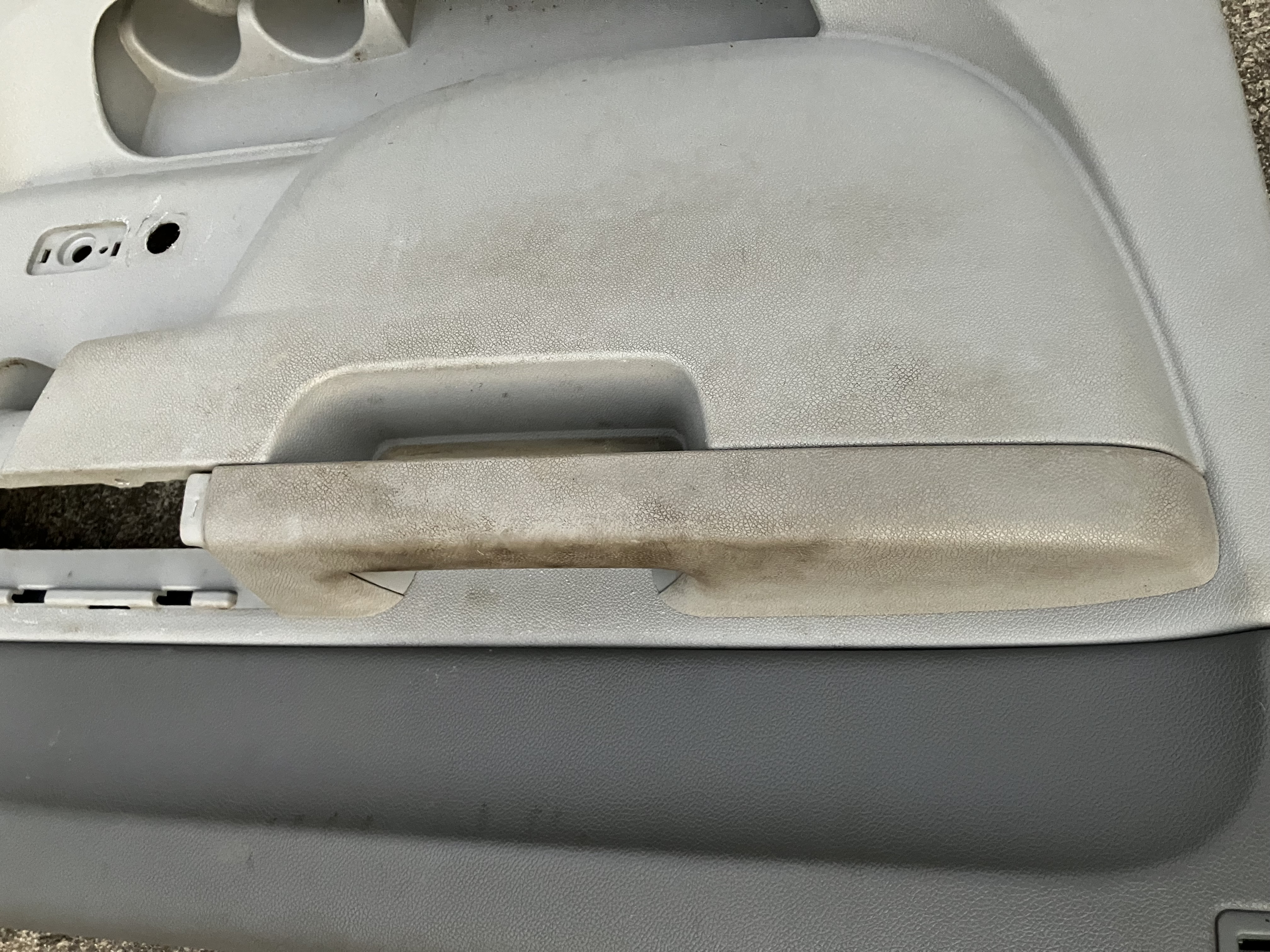

Fix the inside driver door handle – item #2

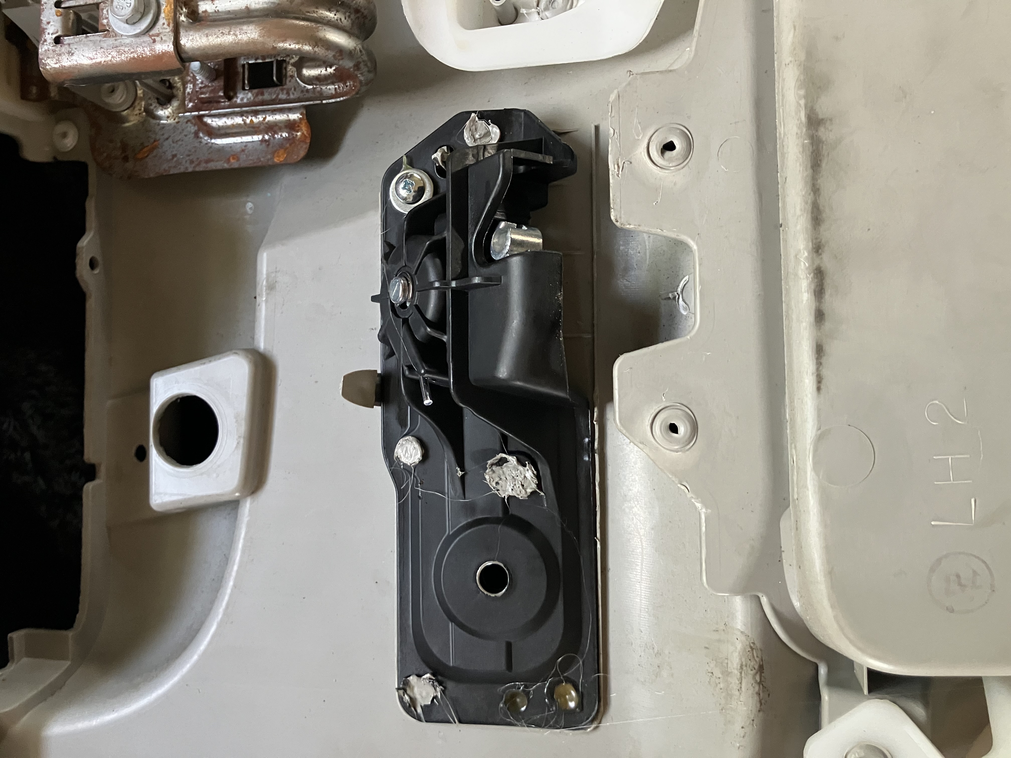

The handle assembly is permanently attached to the inside of the interior door panel. I ordered a replacement. Upon removal of the panel I could see the assembly was already replace once, and shoddily attached. There are plastic pins that retain the assembly when the ends of the pins are melted. I was able to melt the ends of these to get it to hold, used hot glue to replace pins that had been broken out by prior installer.

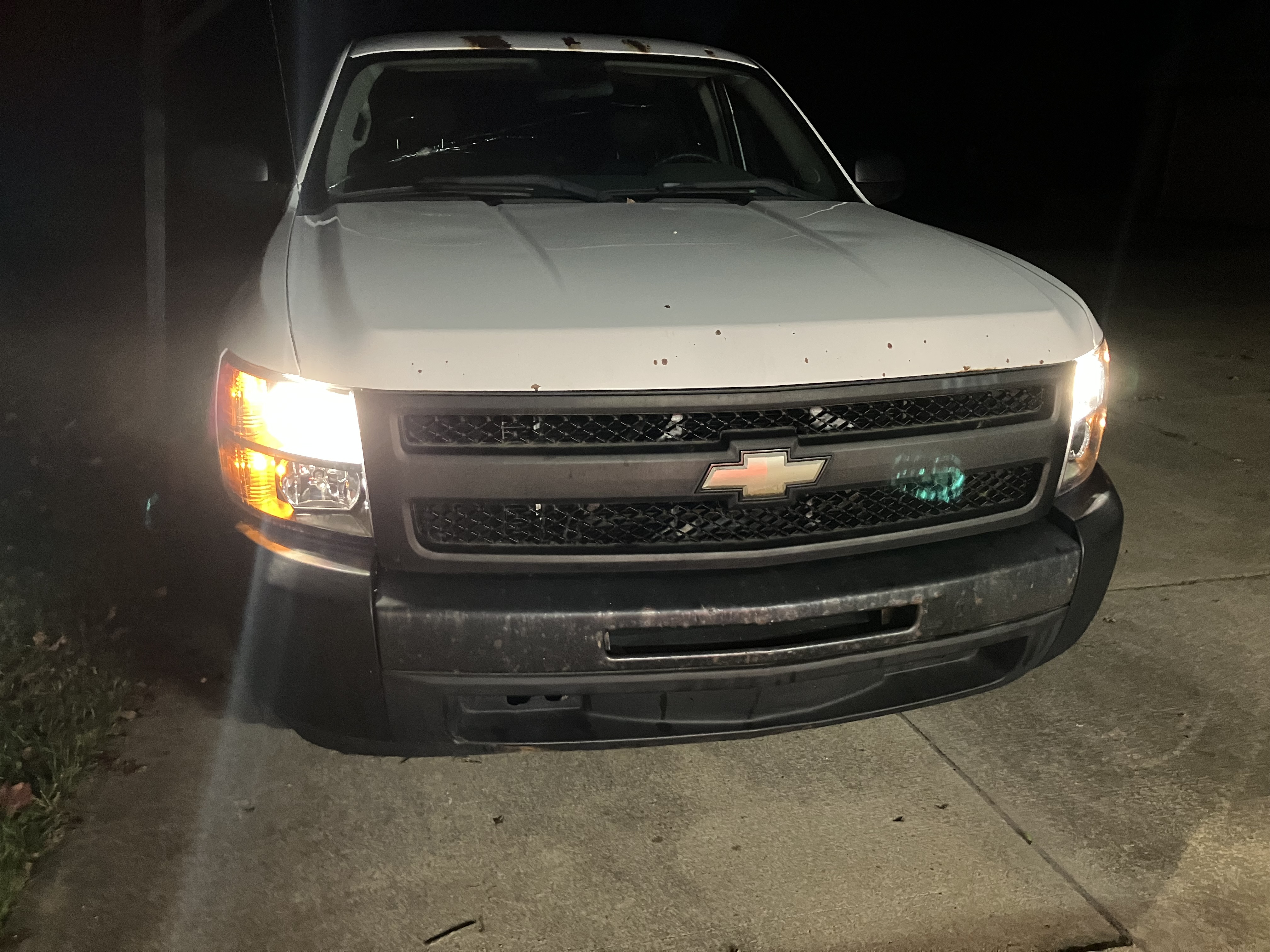

Fix the headlight – item #3

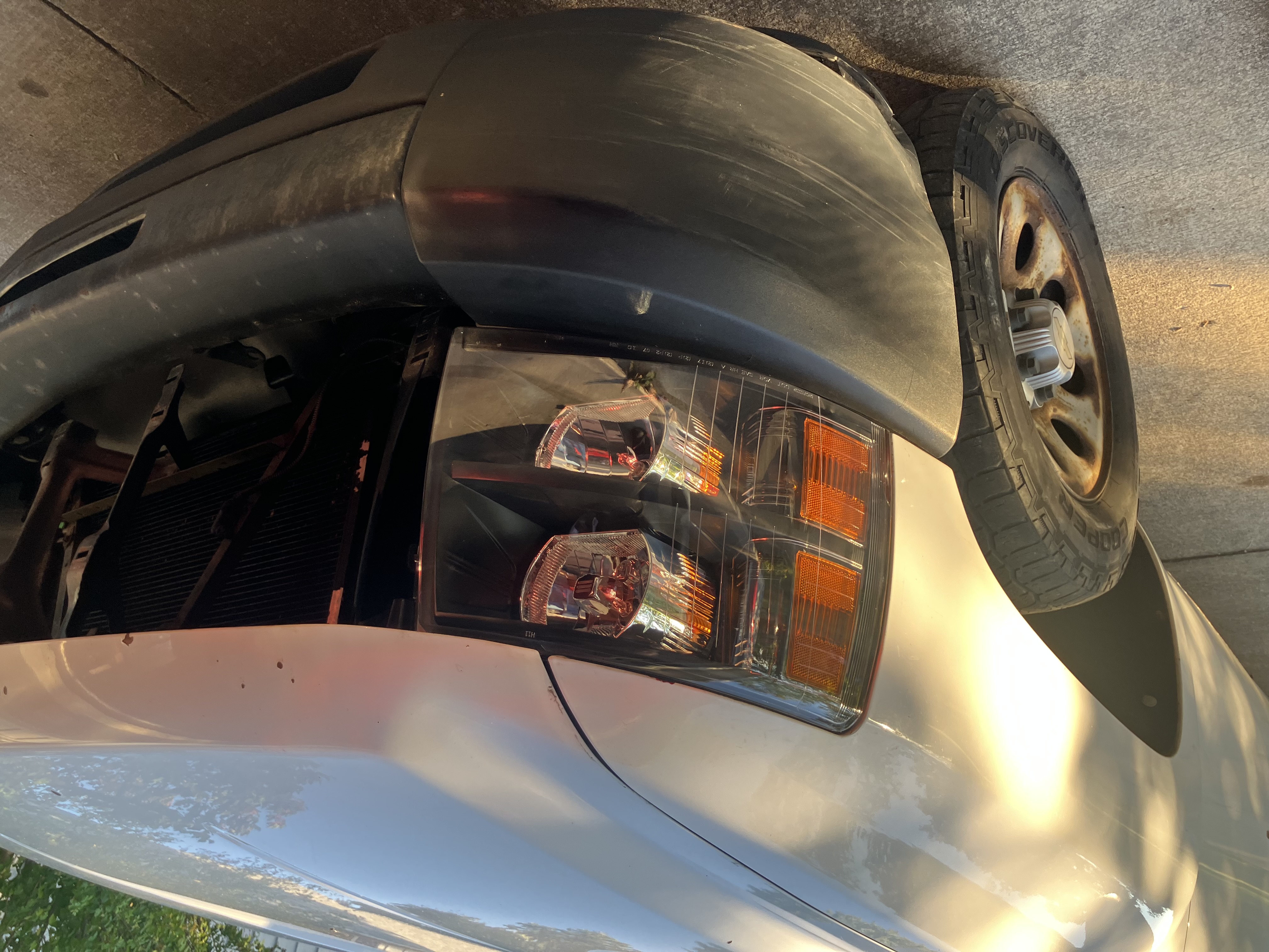

The passenger headlight works but it was all broken up. For $80 two new headlights were ordered. Changed out both of them. The black structure behind the lens should look good with the black work truck front trim.

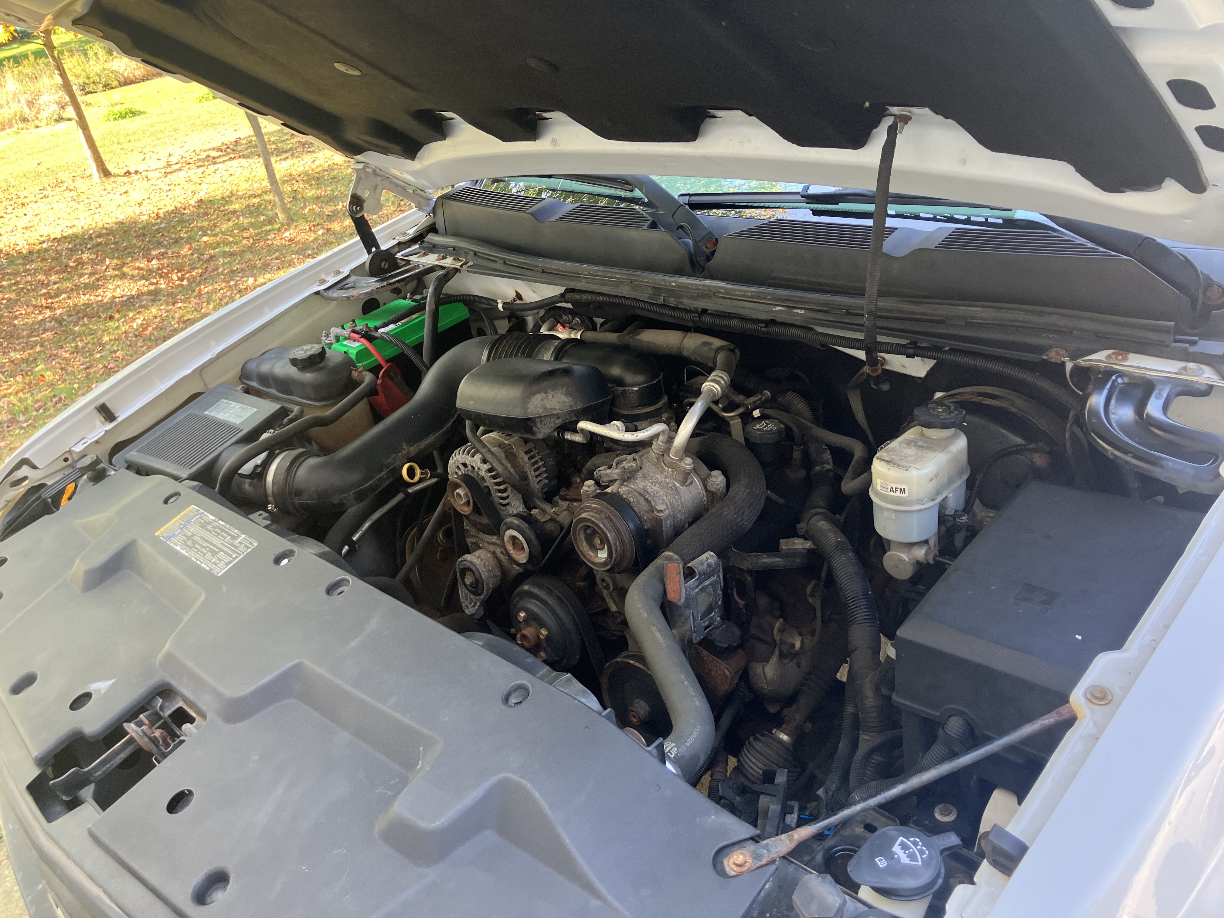

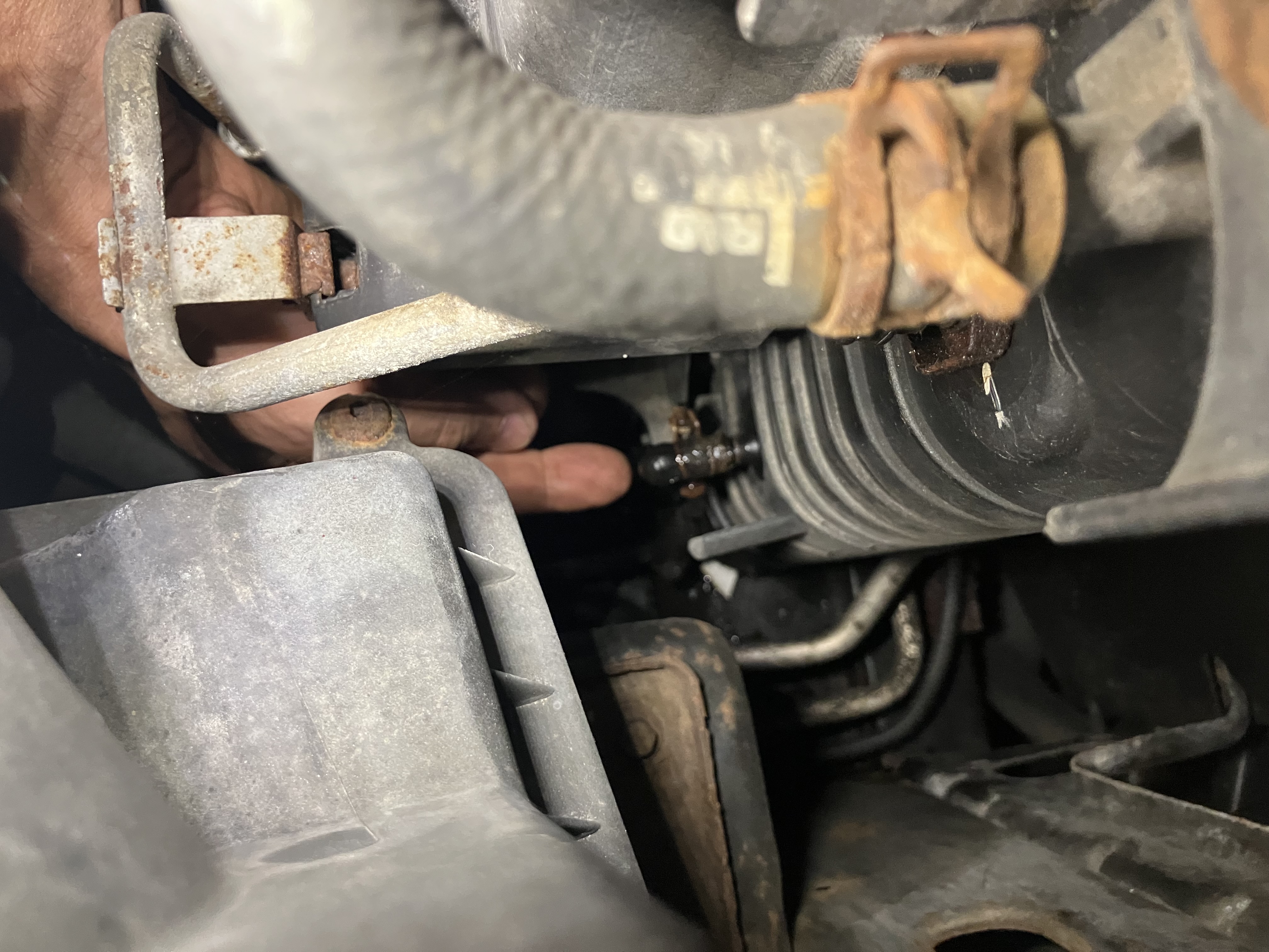

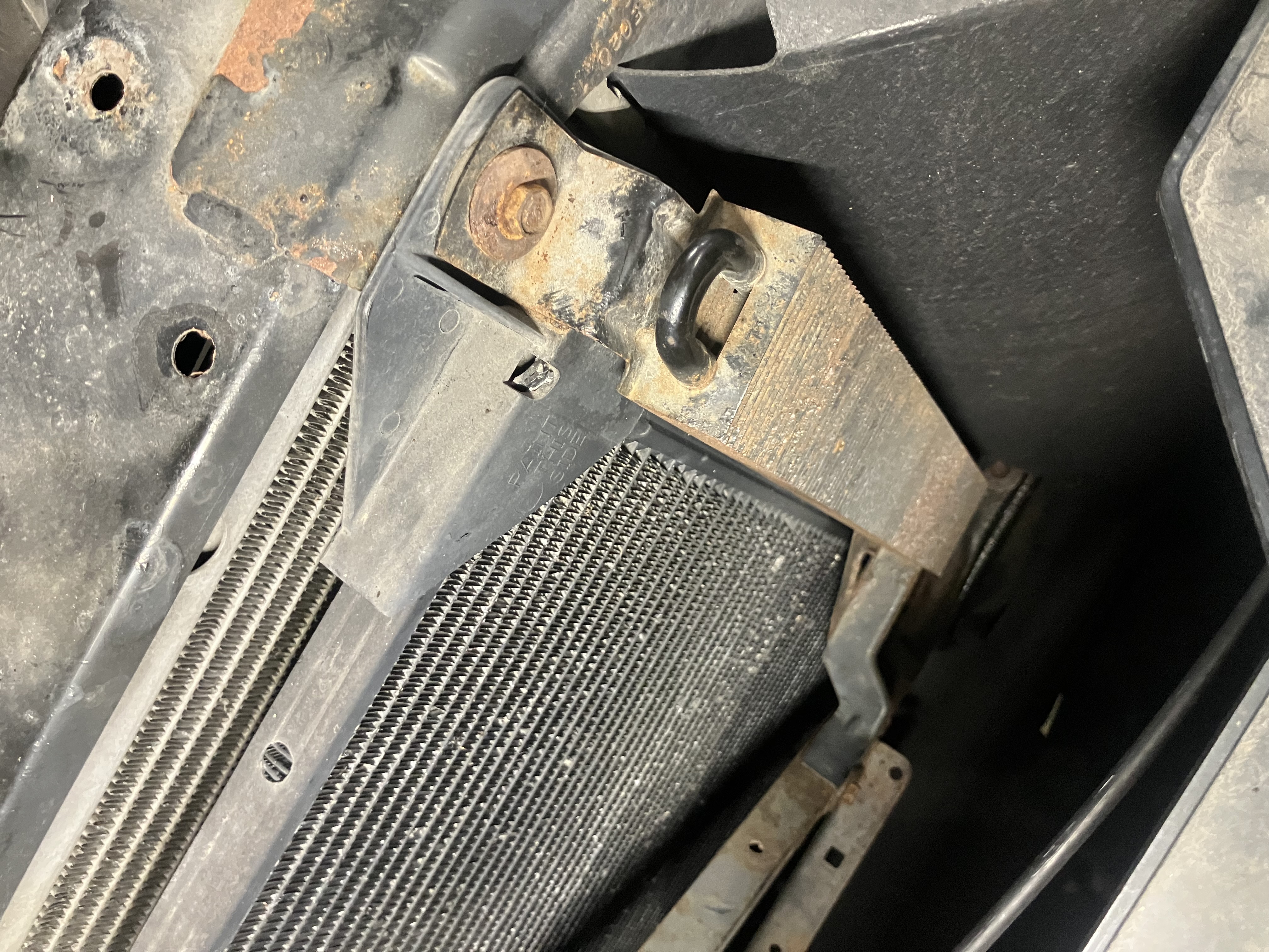

Fix the coolant leak – item #4
There is an auxiliary port on the radiator that is not needed for the 4.3 V6 which had been plugged with a vacuum line plug and a hose clamp. This plug had cracks in it. When we were looking to buy it I noticed it was low on water, he put in a gallon to get it full.

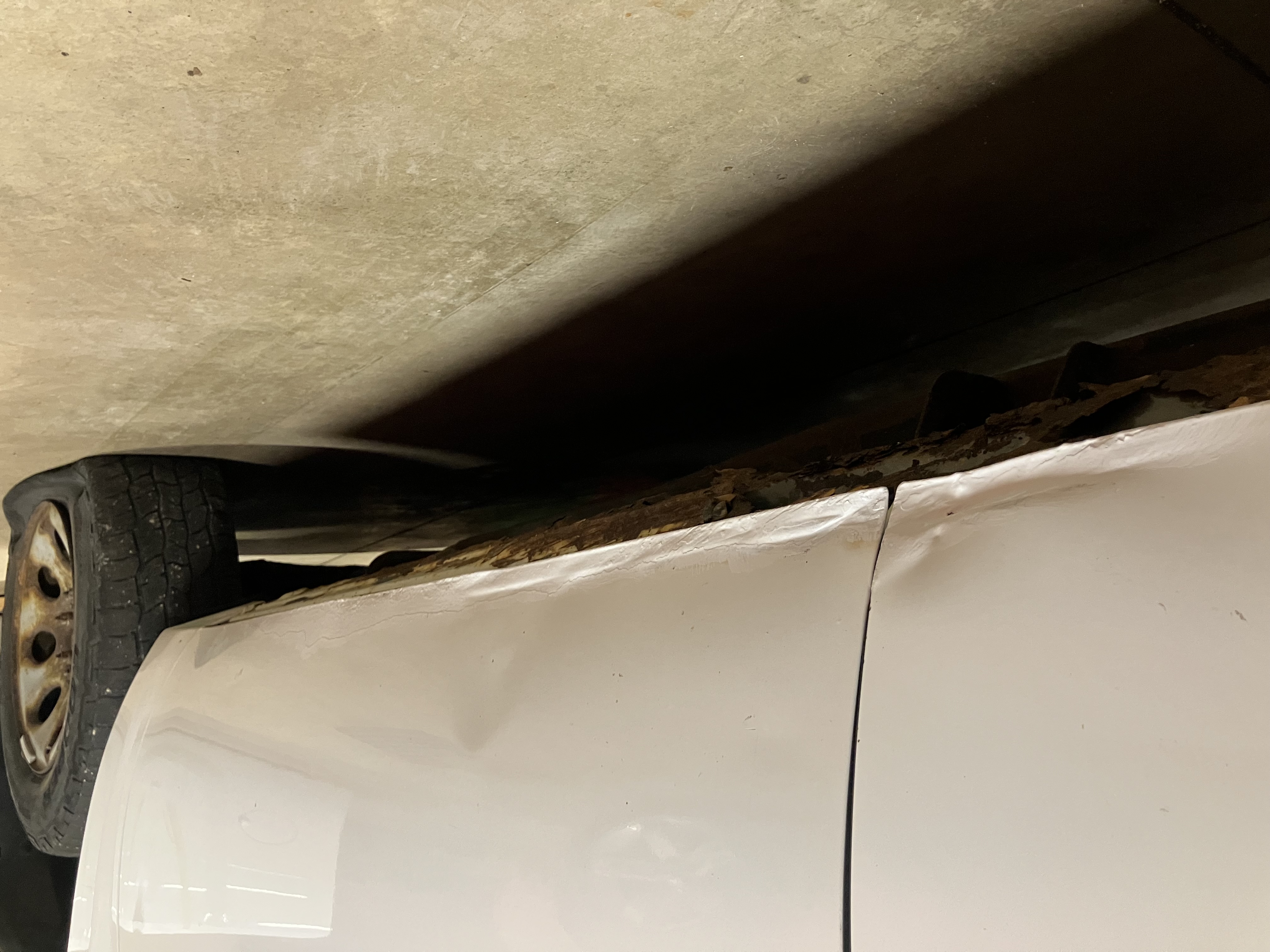

The rocker panels were all there when I looked at it but rusty. I was easily able to poke holes in them with my fingers. The hammer brought down a lot more rust.
Frame has some rust but looks solid. Cab looks solid except for the rocker panels. Engine runs good.

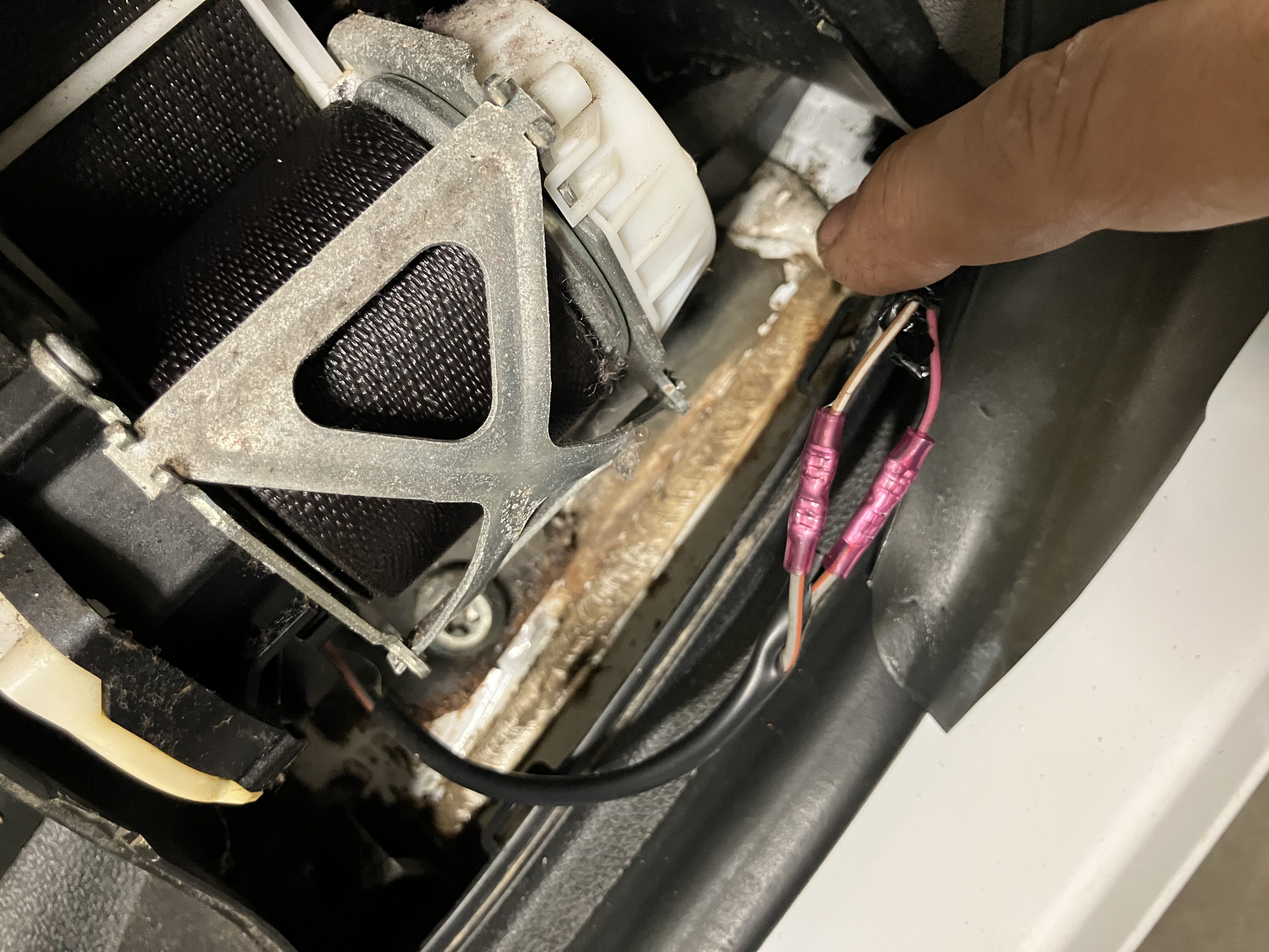

Airbag system – item #5

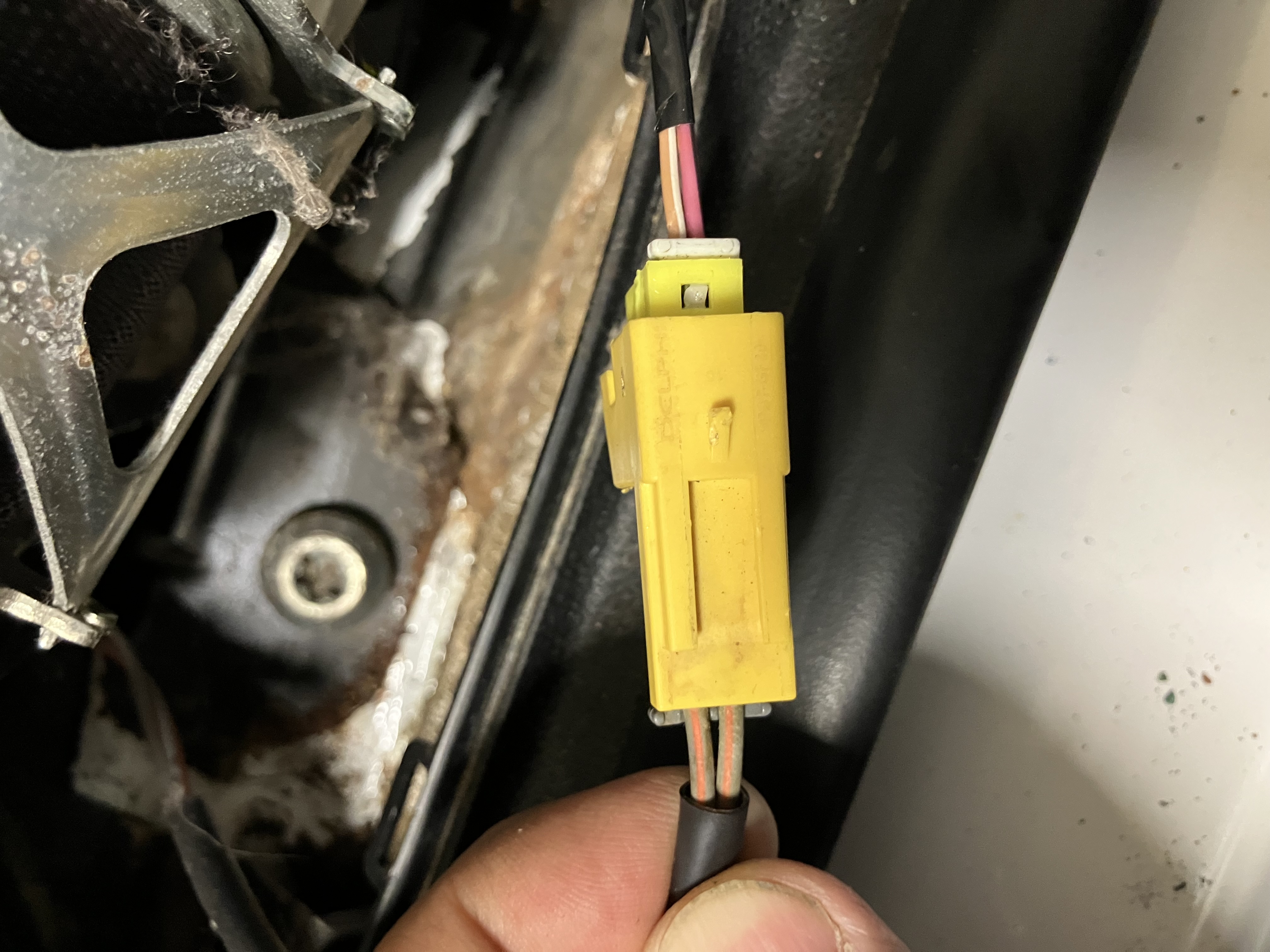

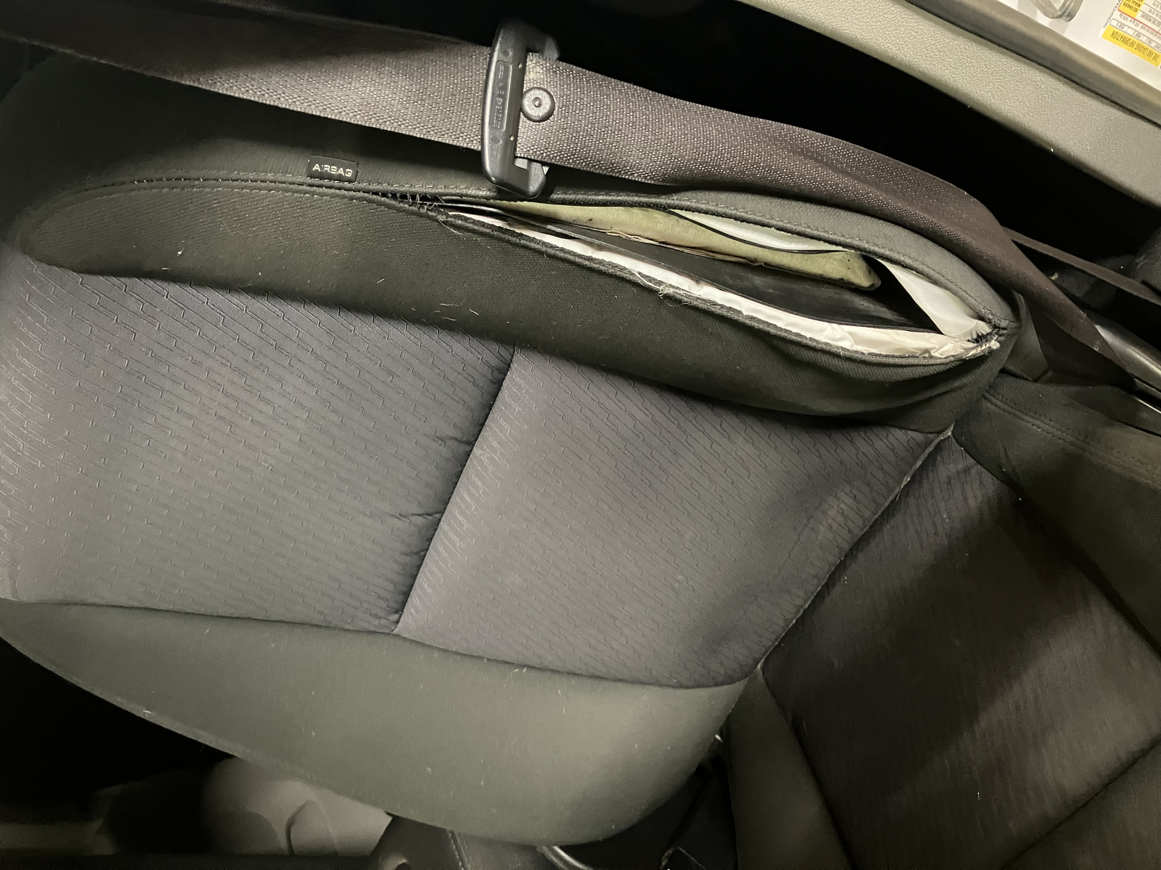

The airbag light was on, and the driver side seat was split open where the seat airbag is located. I didn’t see any damage on that side of the truck but assumed these were related. As it turns out the connection to the driver seat belt retractor was corroded, and as far as the seat it appears the stitching on the left side of the seat back has just failed. I’m still deciding how to handle the seat cover split, but the system is operational.

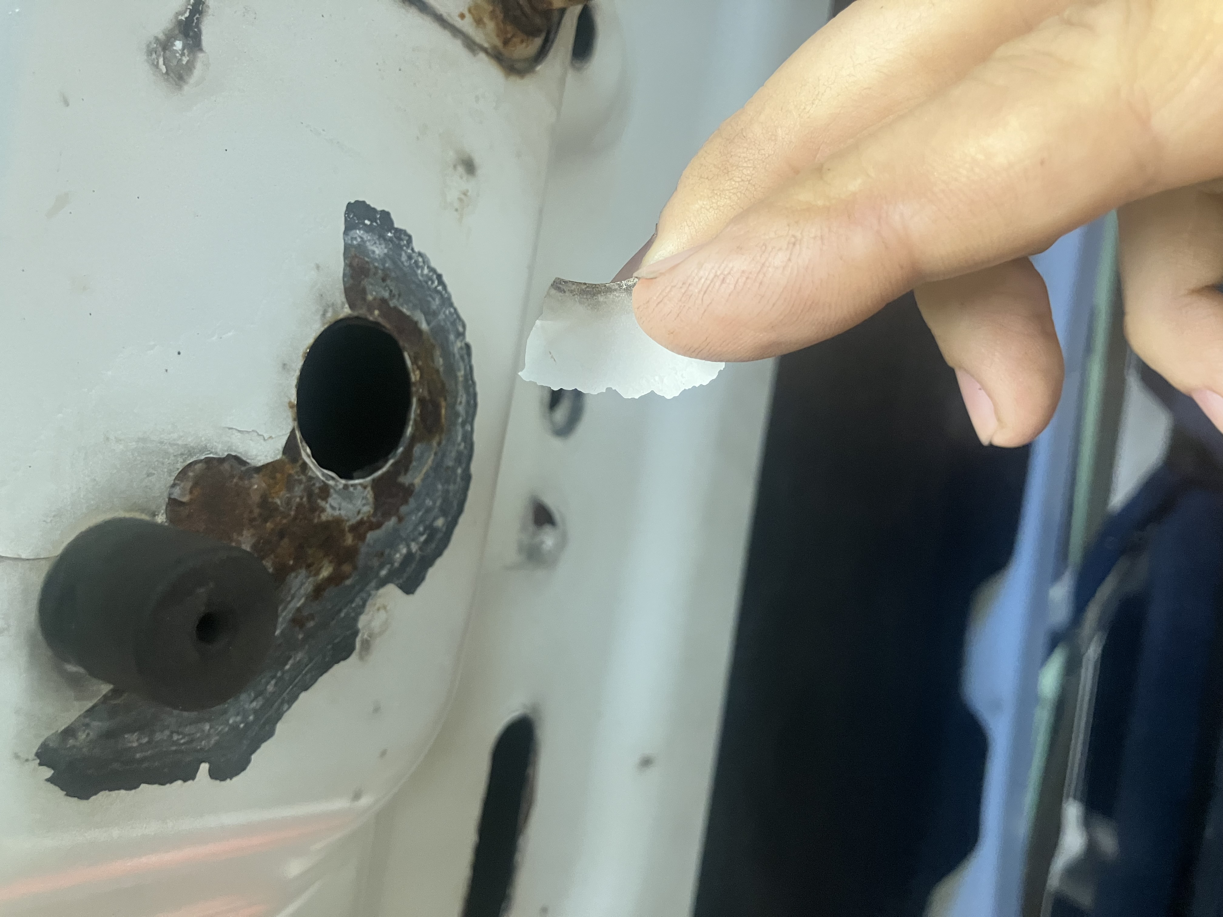

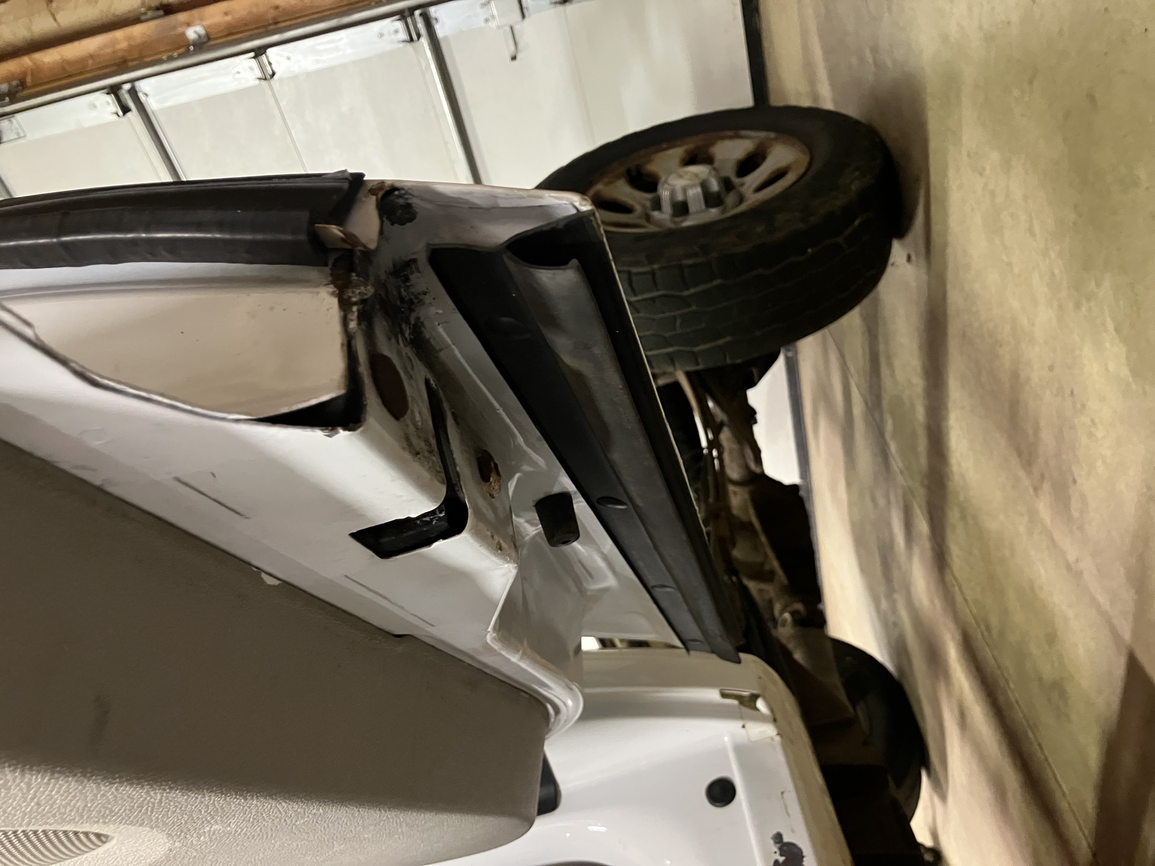

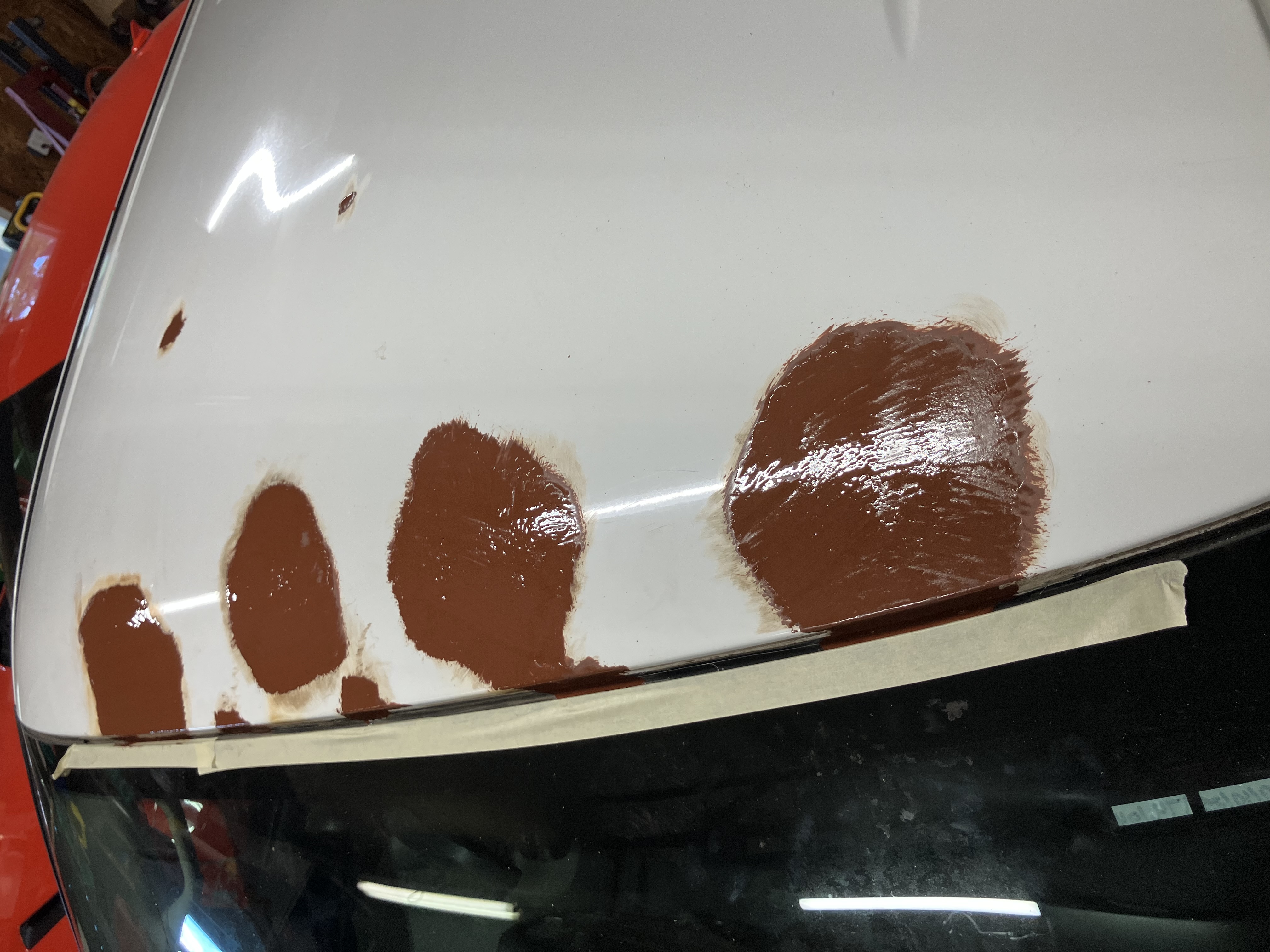

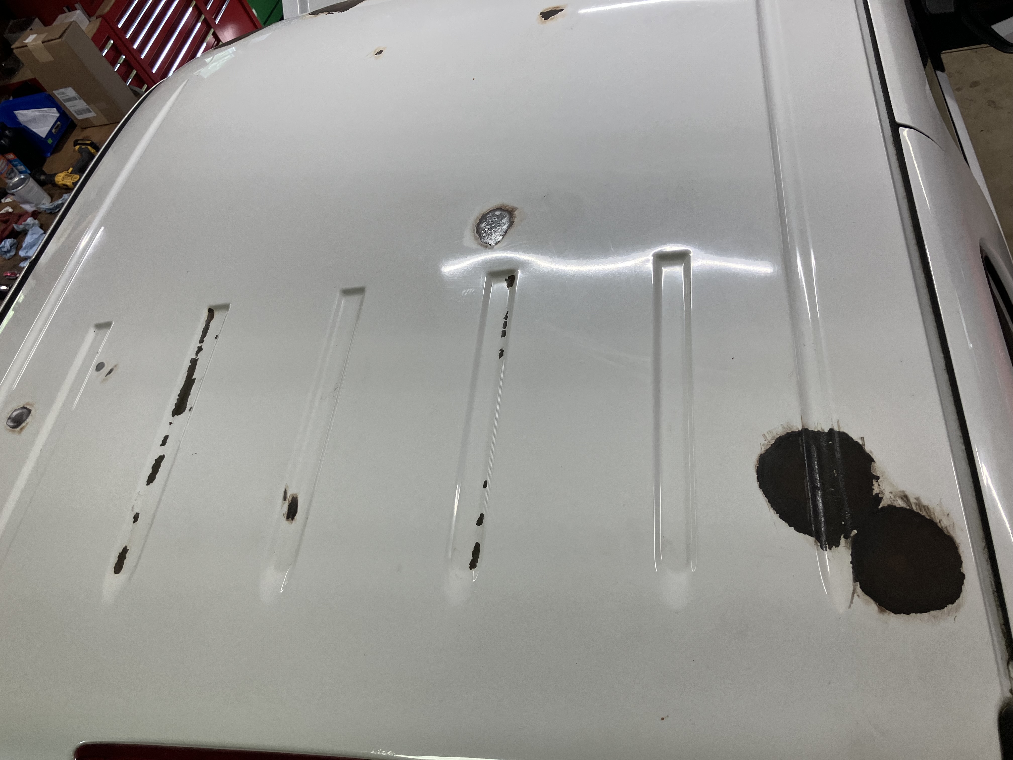

Fix the rust on the roof – item #7

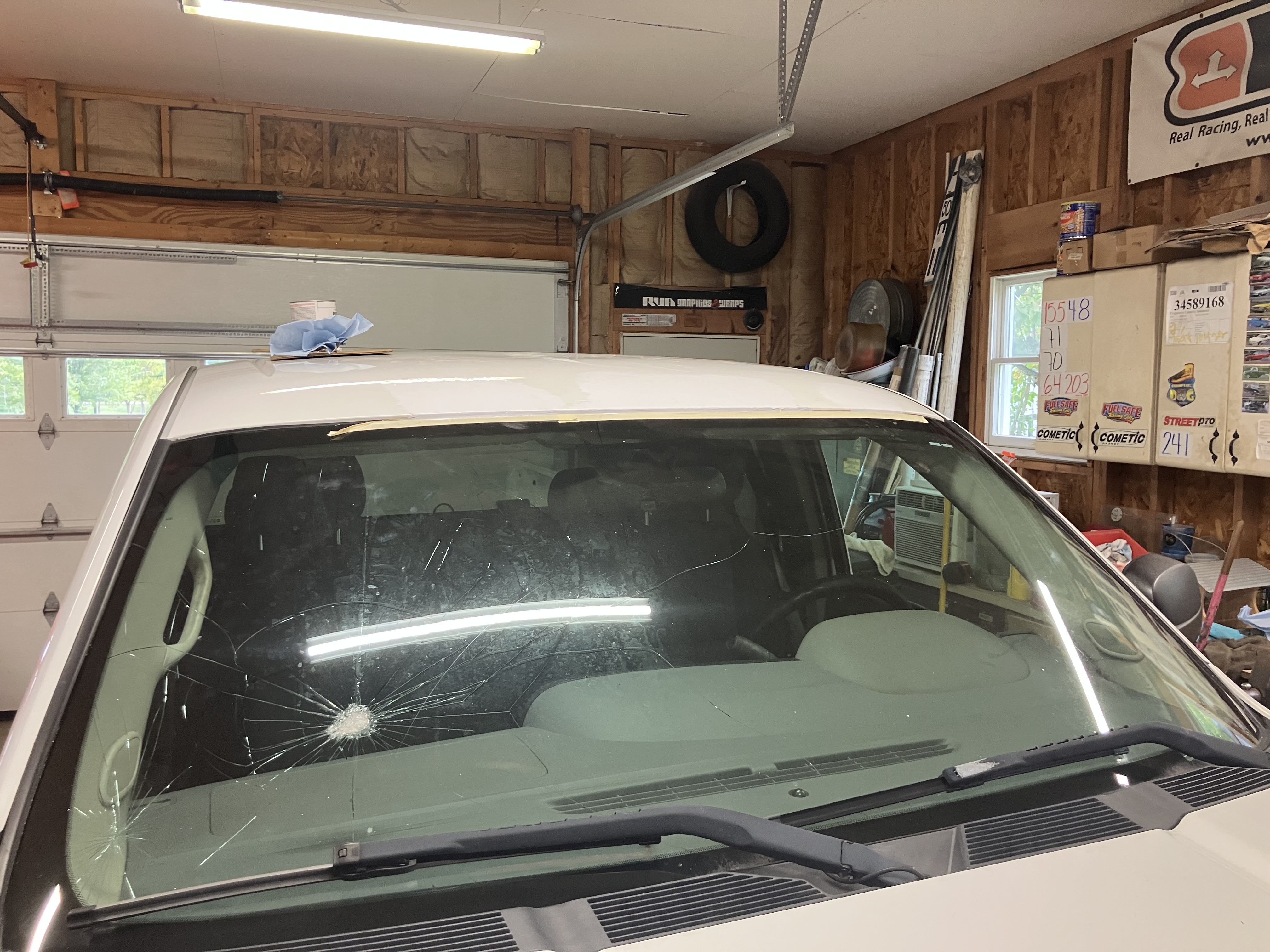

Wanted to address the rust on the roof to open the possibility of getting the windshield replaced at any time. The rust spots on the front of the roof ran right up to the edge of the windshield. I removed all the trim at the top of the windshield (rubber pieces that are replaced when windshield is replaced) and was able to sand out the rust in the channel, as well as the rest of the rusted spots on the roof. The factory paint on this truck is having problems with adhesion. There are places scattered all over this truck where the paint is flaking off: roof, door jambs, under the floor mat, bottom of the hood, bottom of the cab, inside the front fenders, under the bed. Current plan is knock off as much of the loose paint as is reasonable (with the right pressure washer it would probably all come off) and touch it up mostly to prevent rust and a little to help it look a little more presentable. I’m taking BP’s recommendation and putting Rustoleum rusty metal primer on these areas, following that up with Rustoleum gloss white. It’s not an exact match but it passes the 20’ test pretty good. Prep includes cleaning out dirt, removing rust with wire wheel followed by a sander, removing loose paint with compressed air, then applying paint by brush. This oil base paint lays down nice and with the right amount of paint it does not leave brush marks. It’ll be fine for this truck’s purpose – probably more than I should bother with.

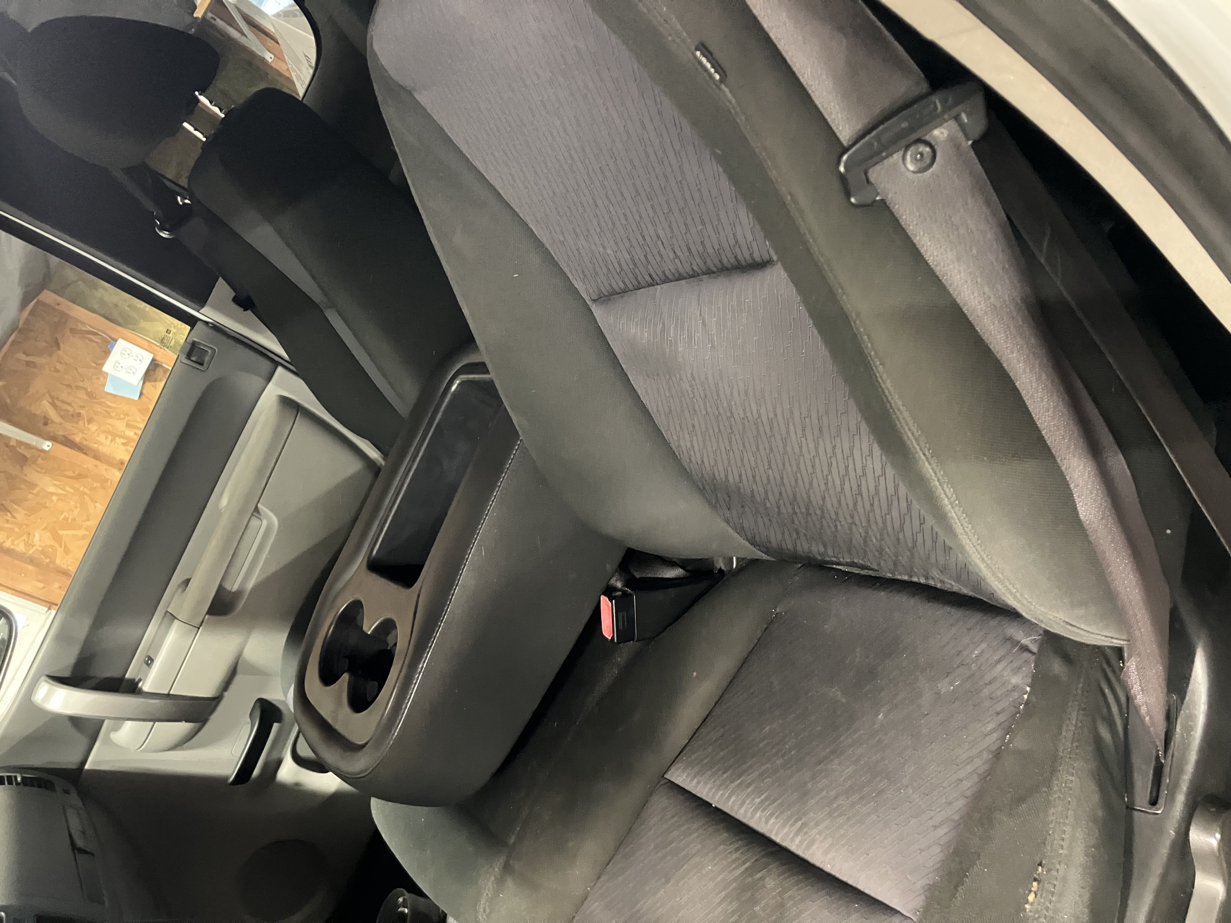

Fix the seat cover - item # 8
This turned out to be an inexpensive fix. There are plenty of Silverados at pull a part. After a YouTube video on how to remove the cover, and about $7 I had a replacement. The seat back seems to wear well and the odd split of the airbag seam is not common on Silverados.

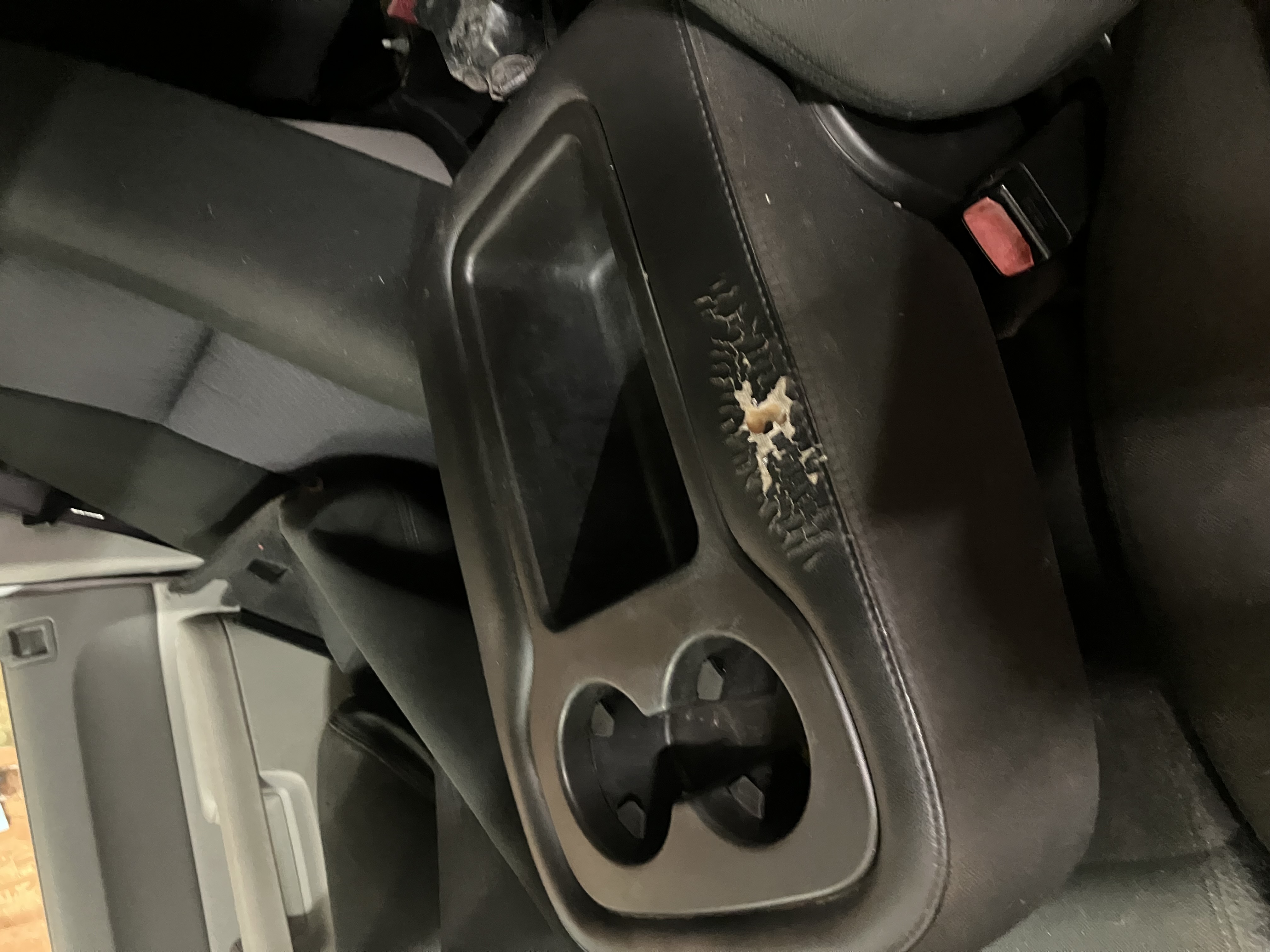

I also located a center console that was in good shape - which is not common - most of them are worn through on the driver side.

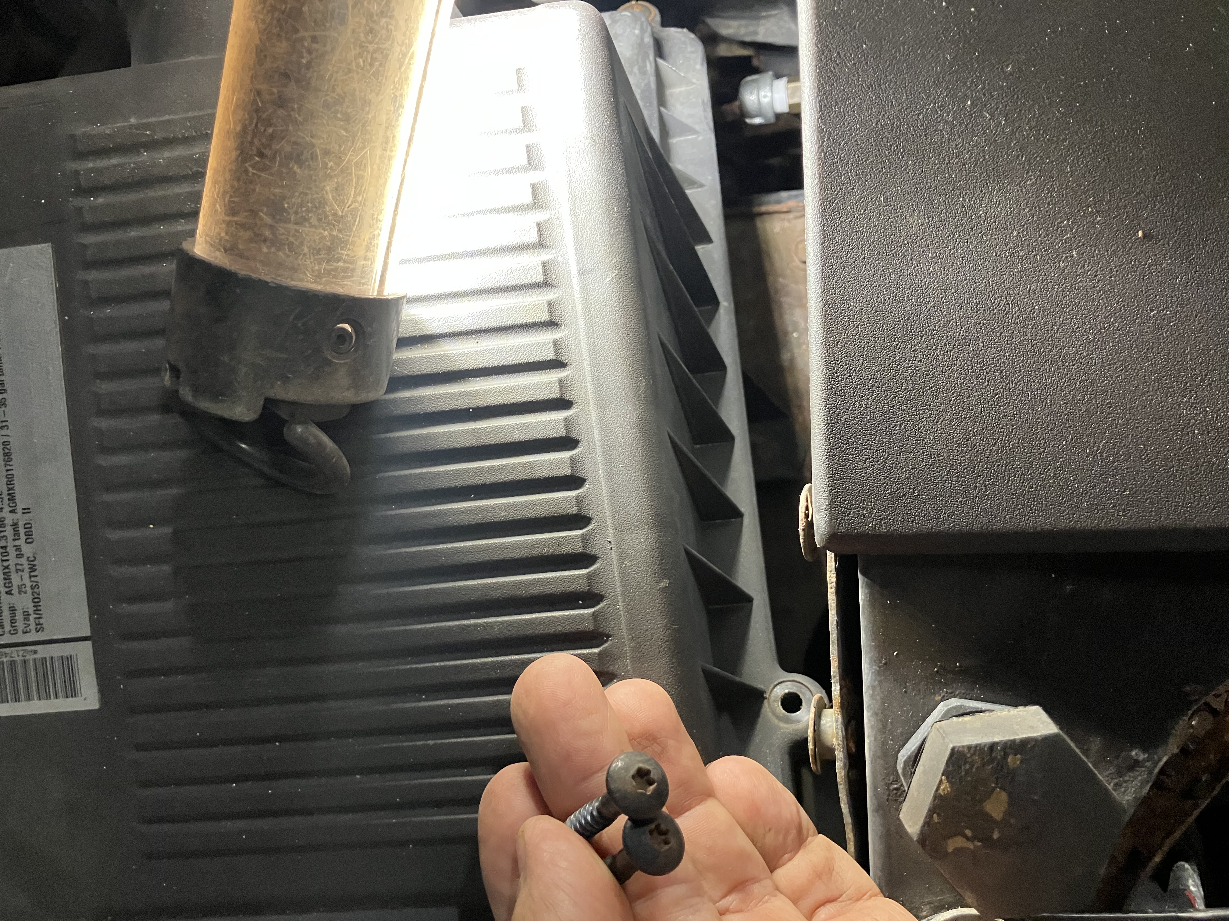

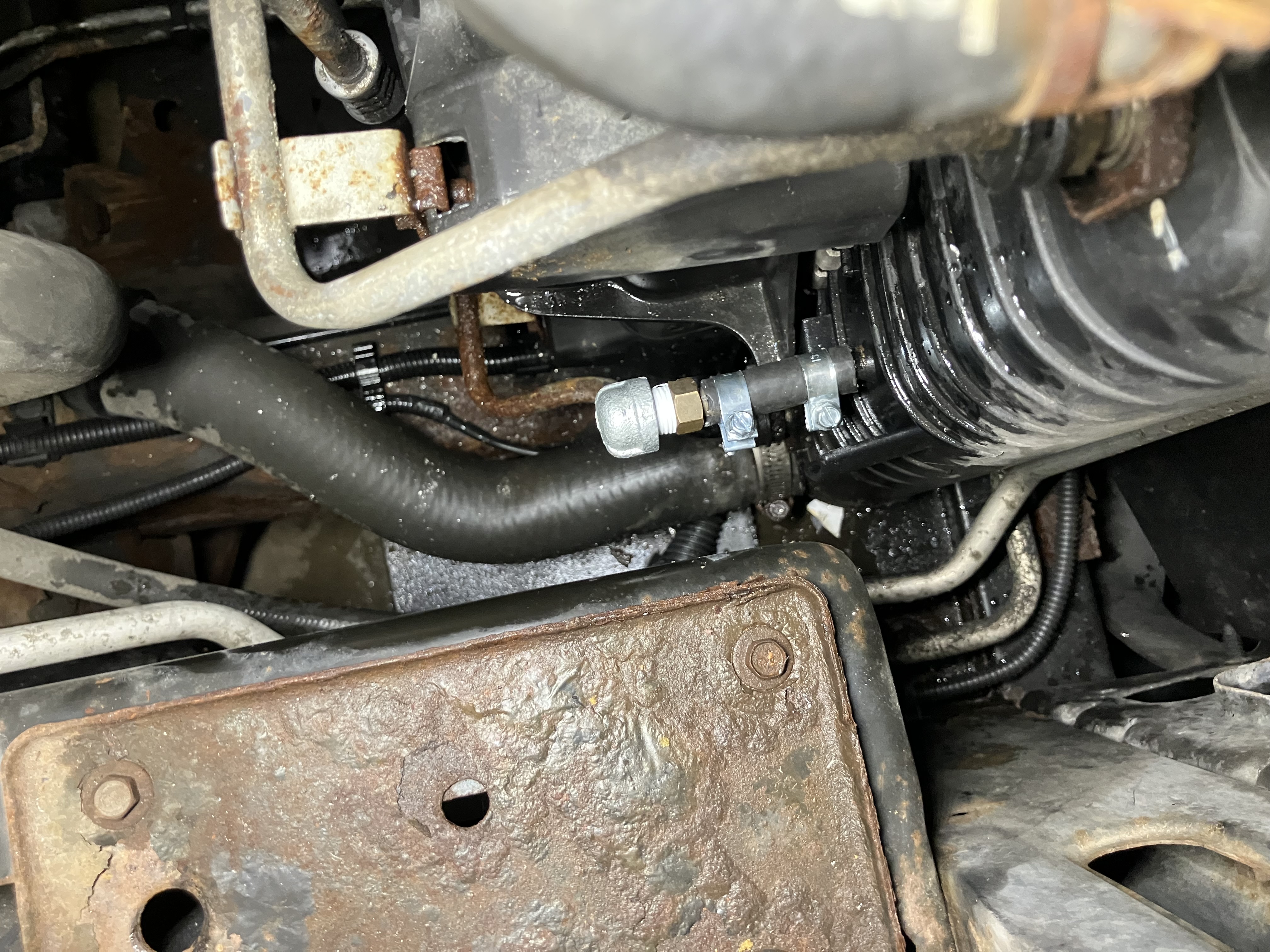

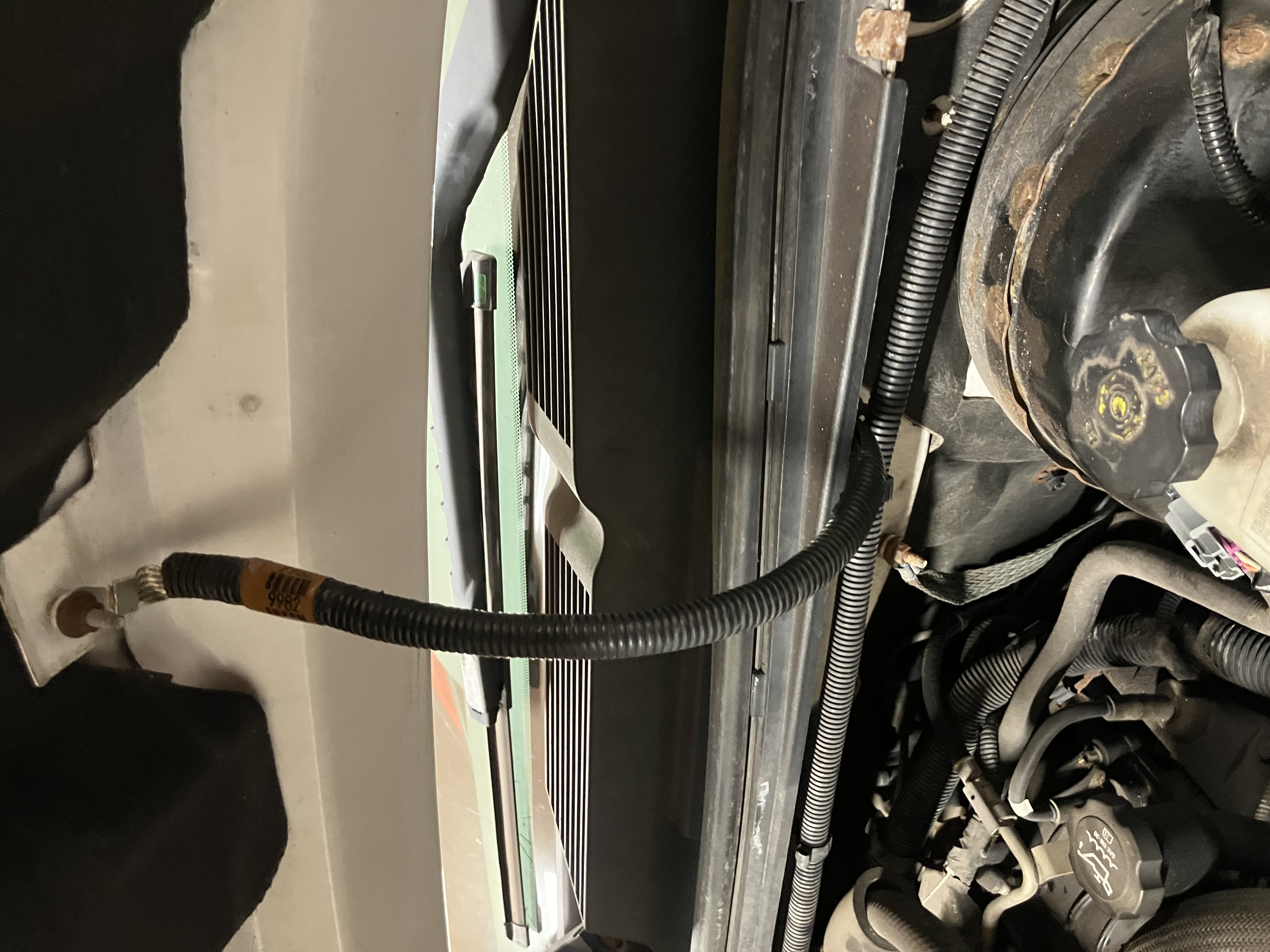

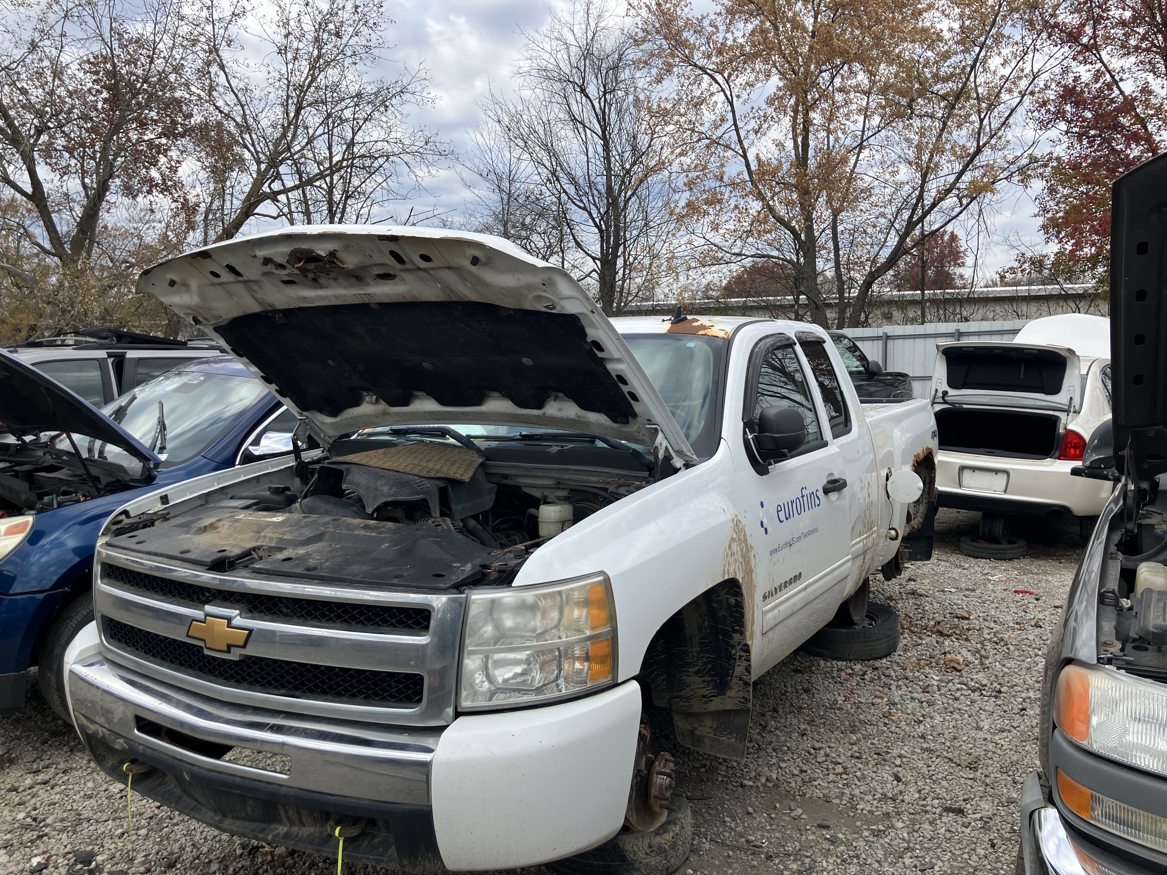

Fix the power steering cooler - item # 9
The first trip to pull a part I found a nice one, but somehow managed to leave it behind. I was juggling a full seat I ended up not needing and was trying to manage the wheelbarrow. On the second visit I went looking for the first one, but it was not in the place where I was loading the wheelbarrow. So I found another in good shape from a 2013 and removed it. While I was looking for other parts I ended up finding the first one on the ground between a couple SUVs.
Installation was pretty straight forward. I was able to install it without removing the grille. Used syringe to pull out the power steering fluid to minimize spill when connecting it.

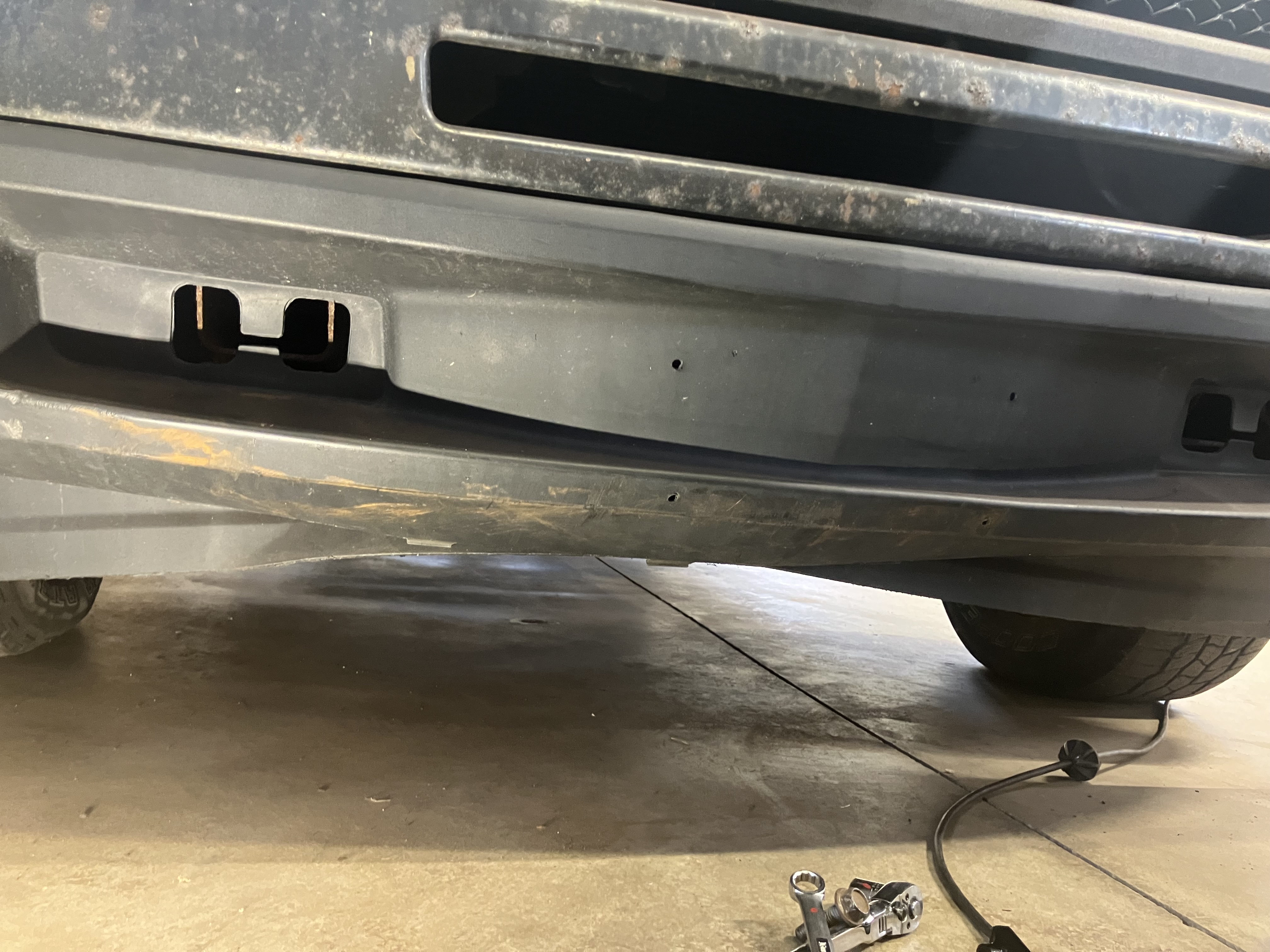

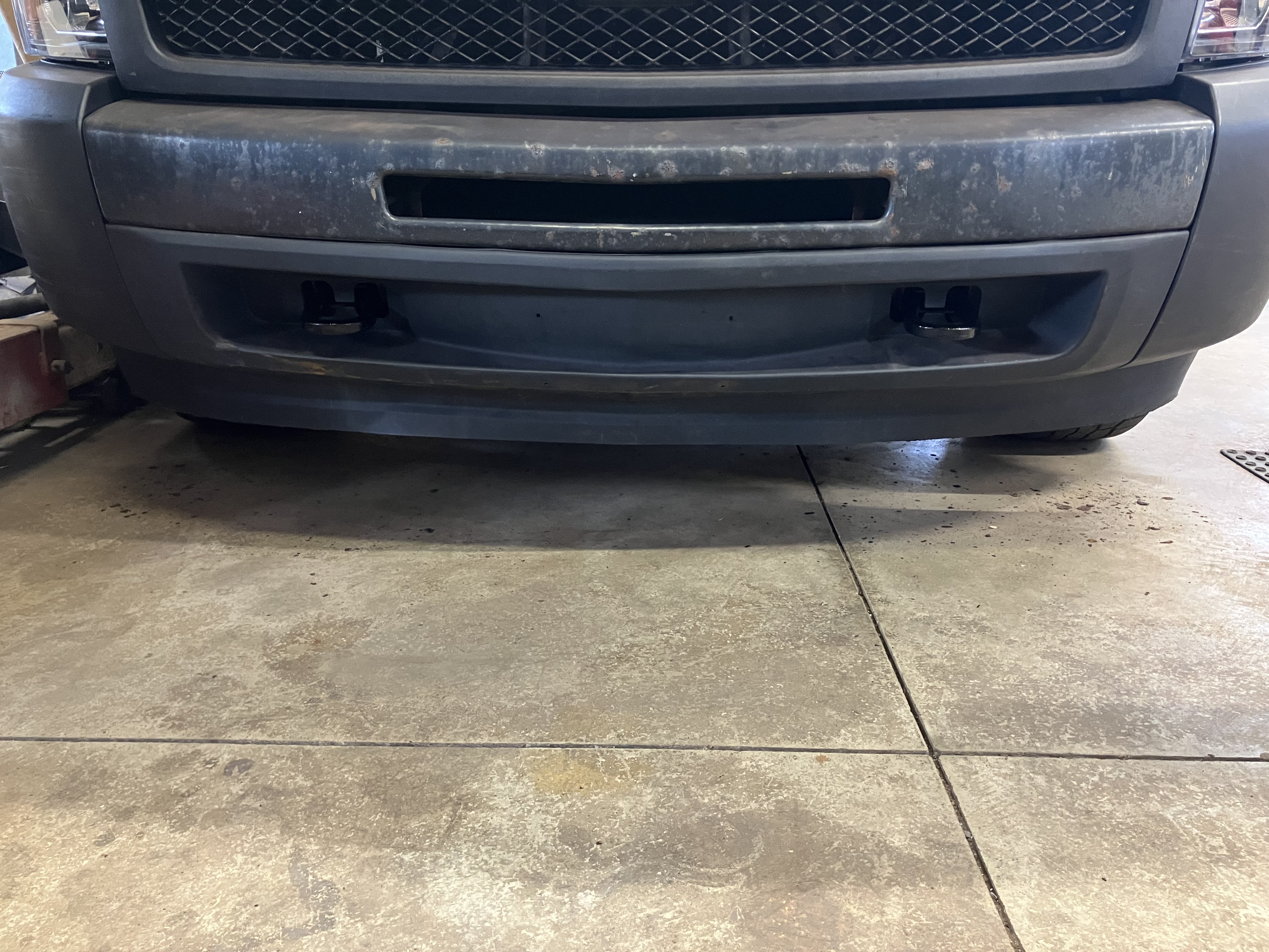

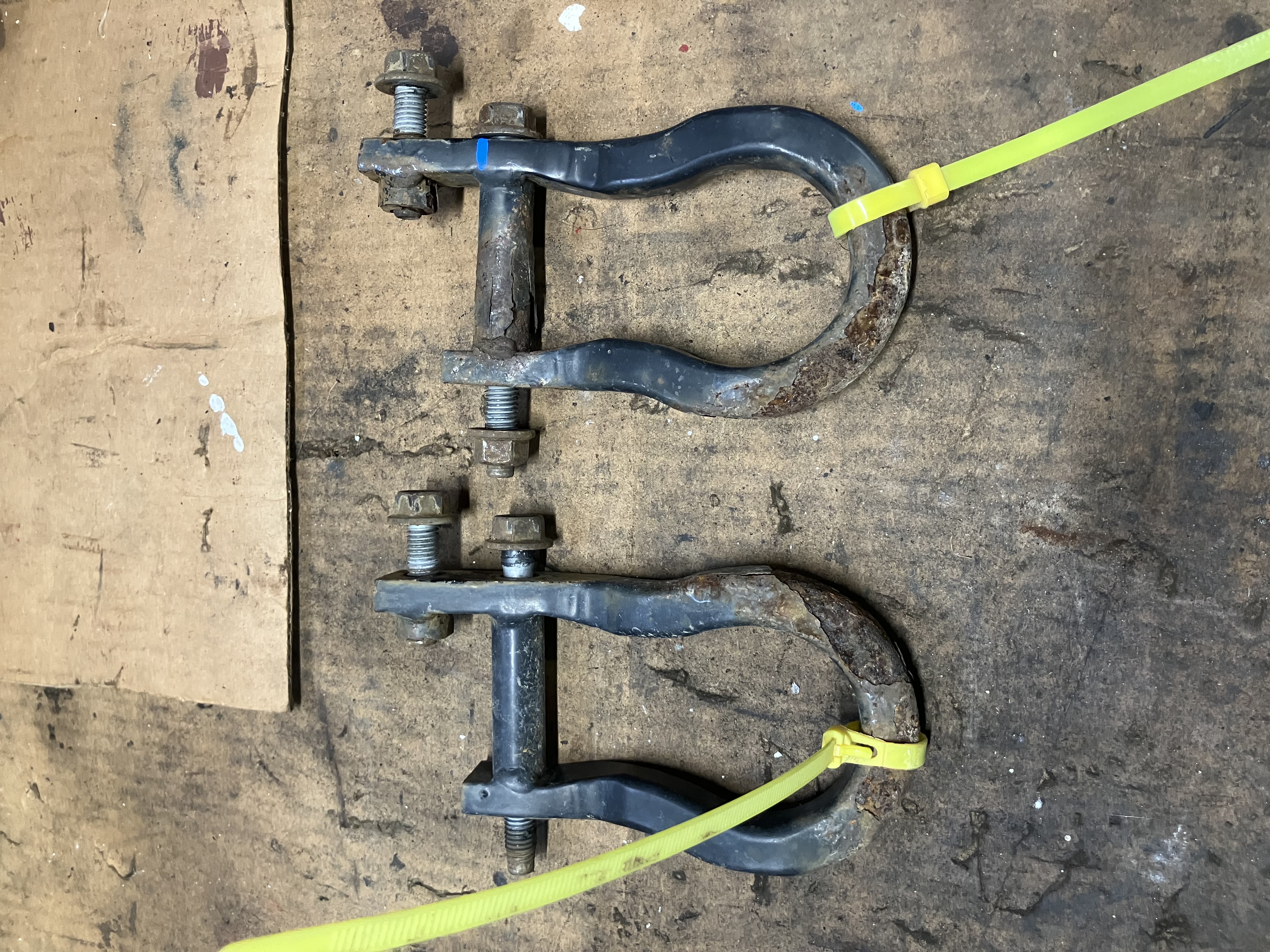

Tow hooks
Acquired some at pull a part, which were cleaned, painted and installed. While I was under the front I noticed the air dam was disheveled so I reconnected it properly. More white paint and a little body straightening

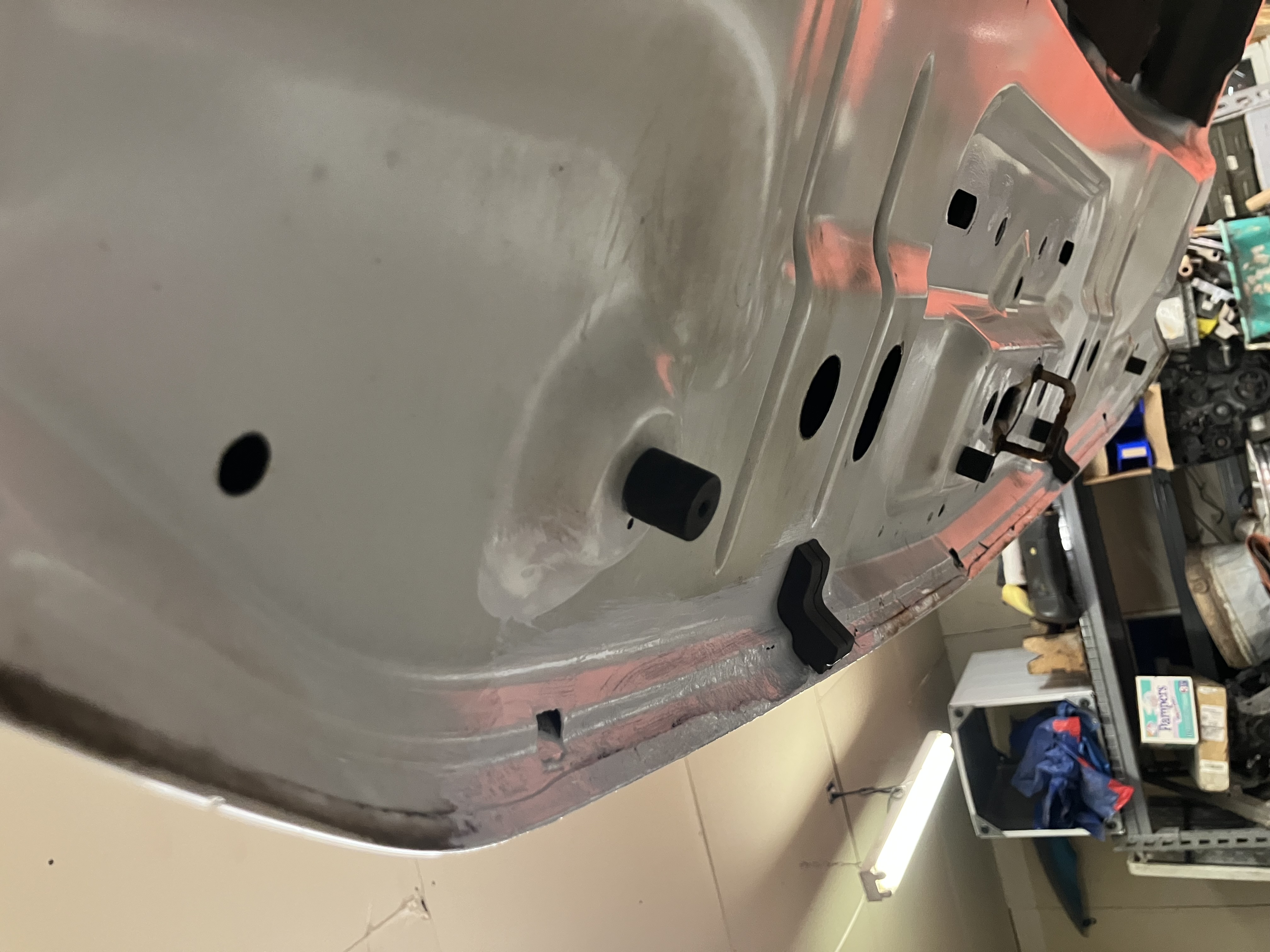

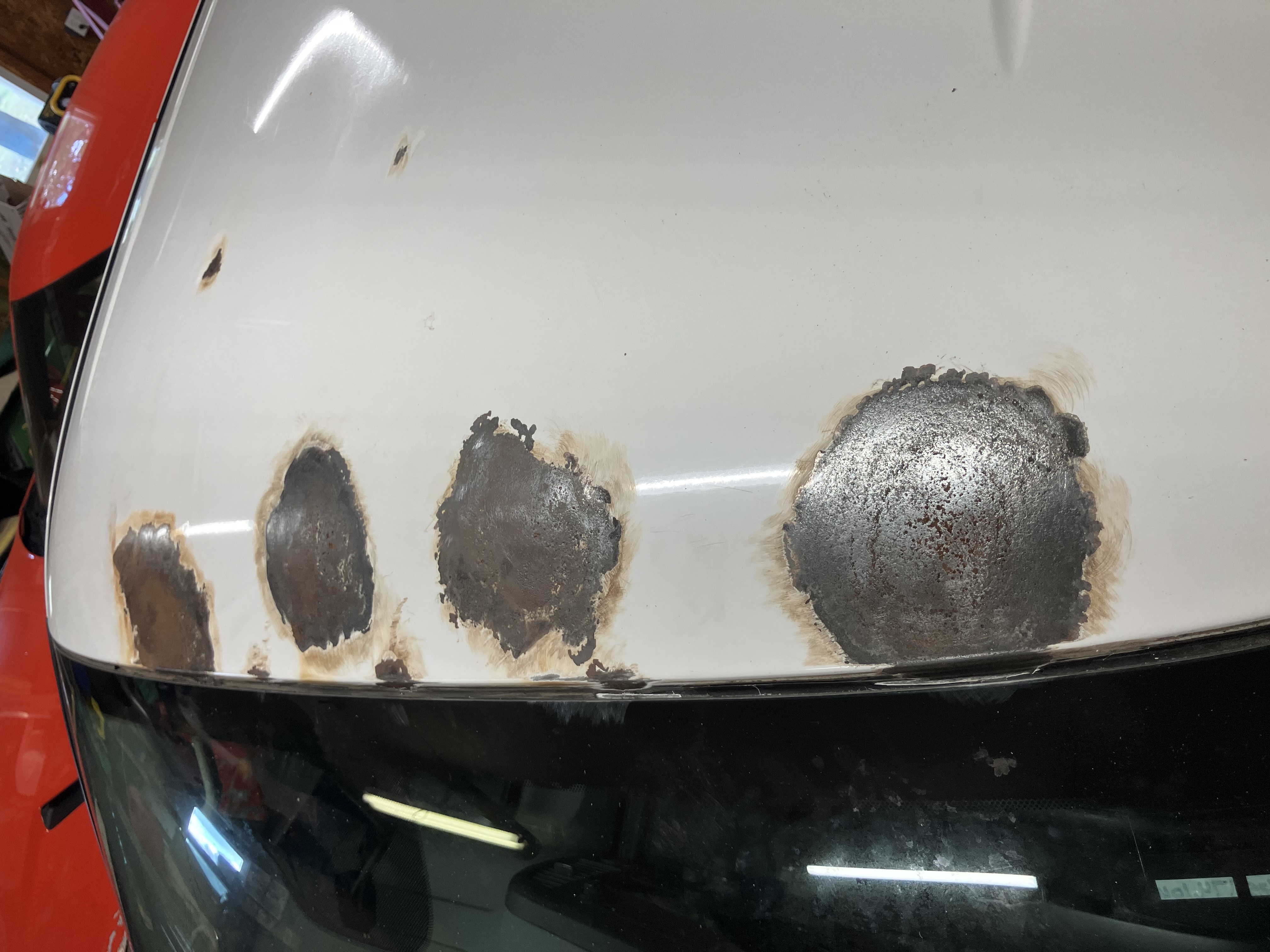

Prepped the bottom of the hood including applying Rustoleum rusty primer - only addressing the rusted areas. Did a bit of metal straightening on the bottom of the passenger doors. Prepped rusty areas on hood and doors by cleaning off rust, applying Rustoleum rusty metal primer followed by Rustoleum white on bottoms of doors and affected areas on the hood.

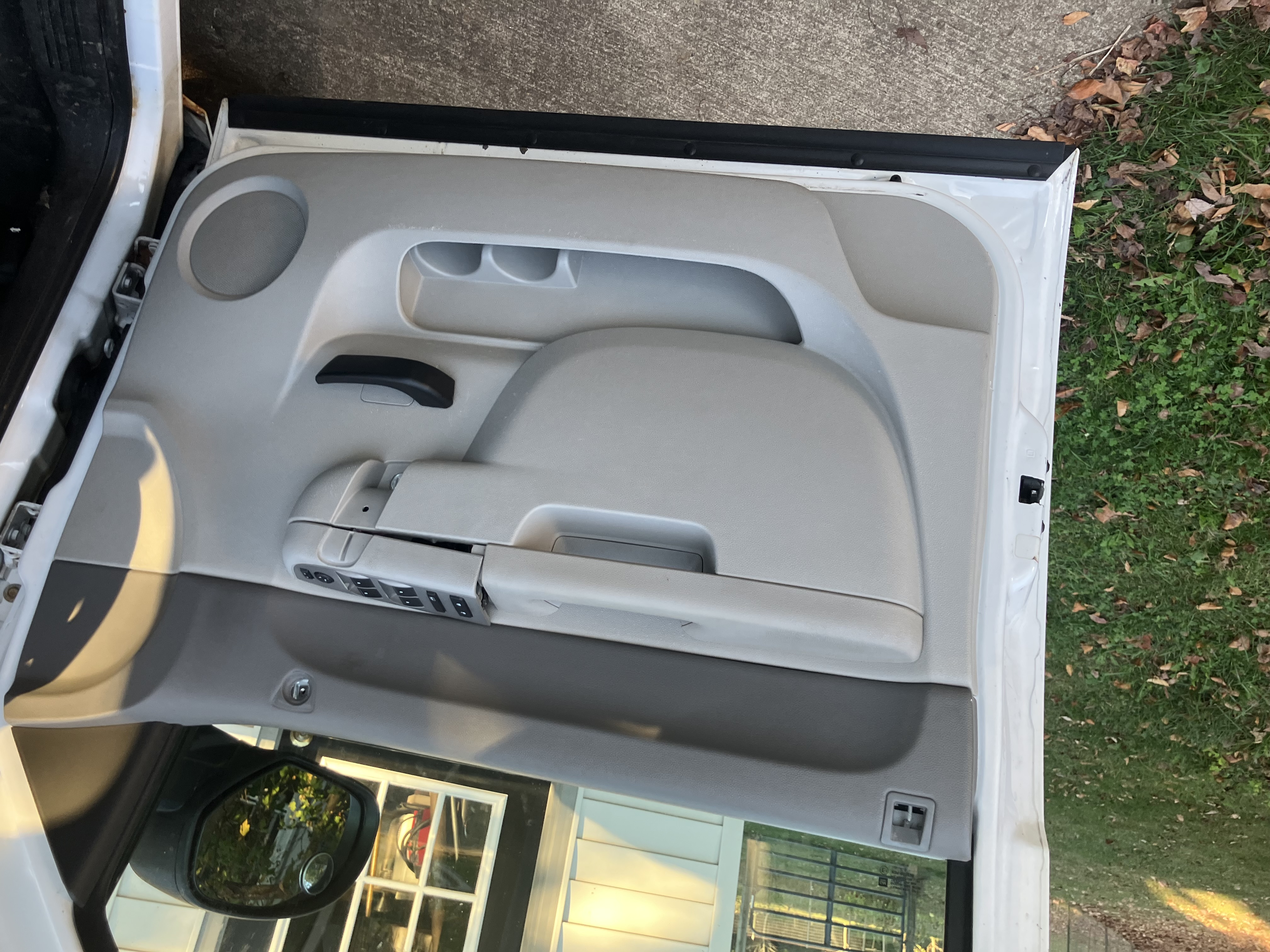

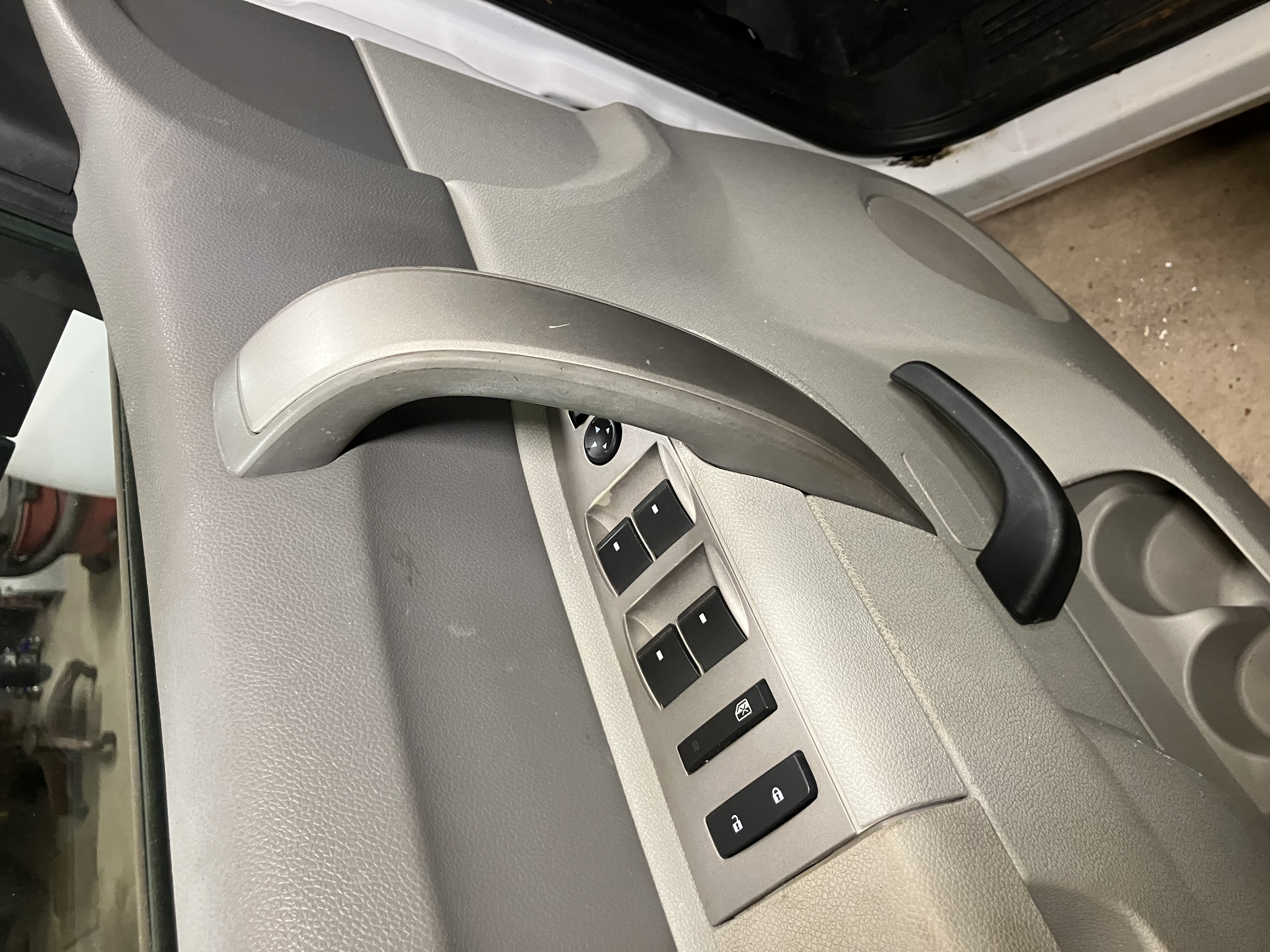

<4832> - (pic was too big) Door lock and window controls driver side
Installed these and finished reassembly of the door. Passenger power mirror still not working so there is more work to do there, maybe a bad connection at the mirror? Hood ground strap

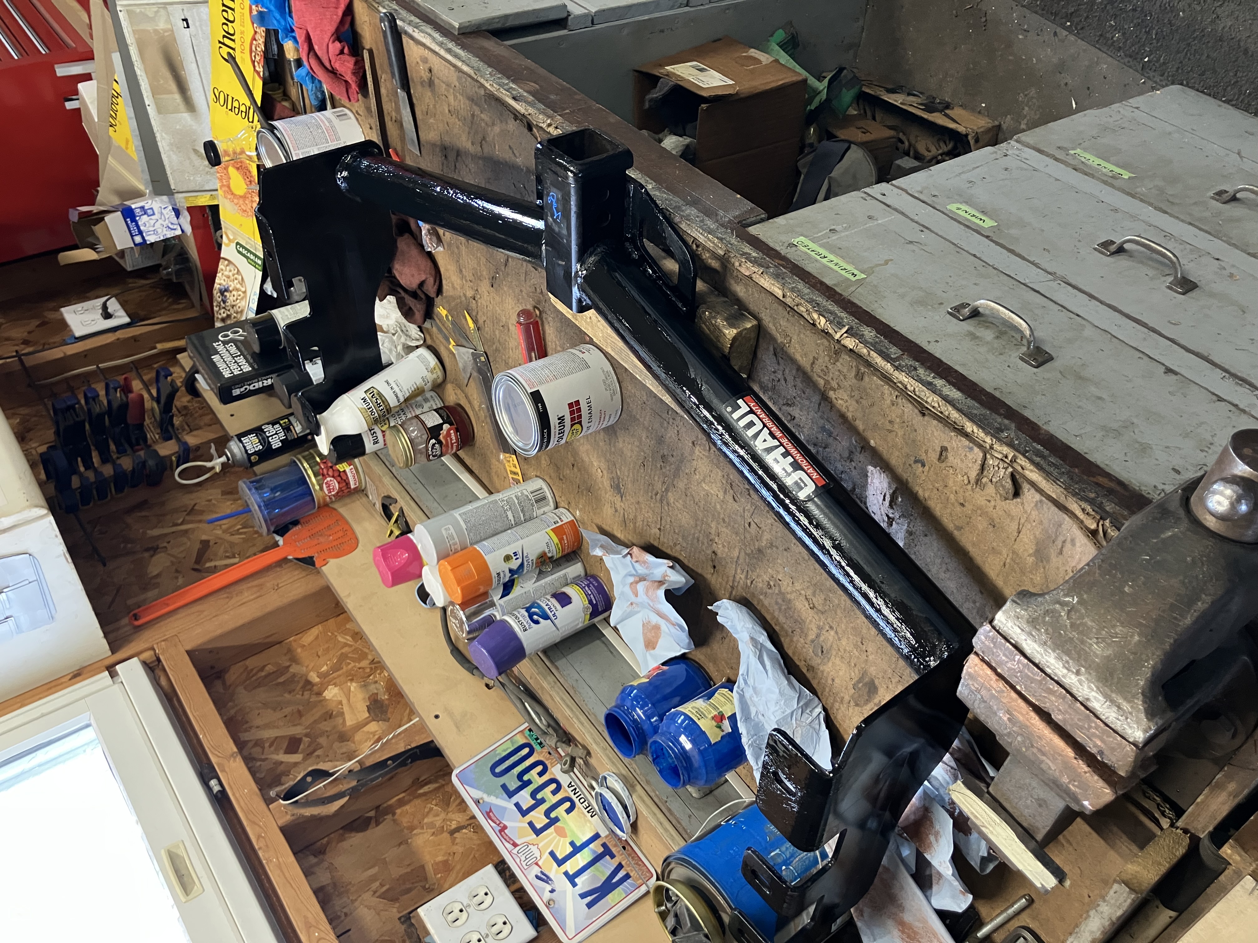

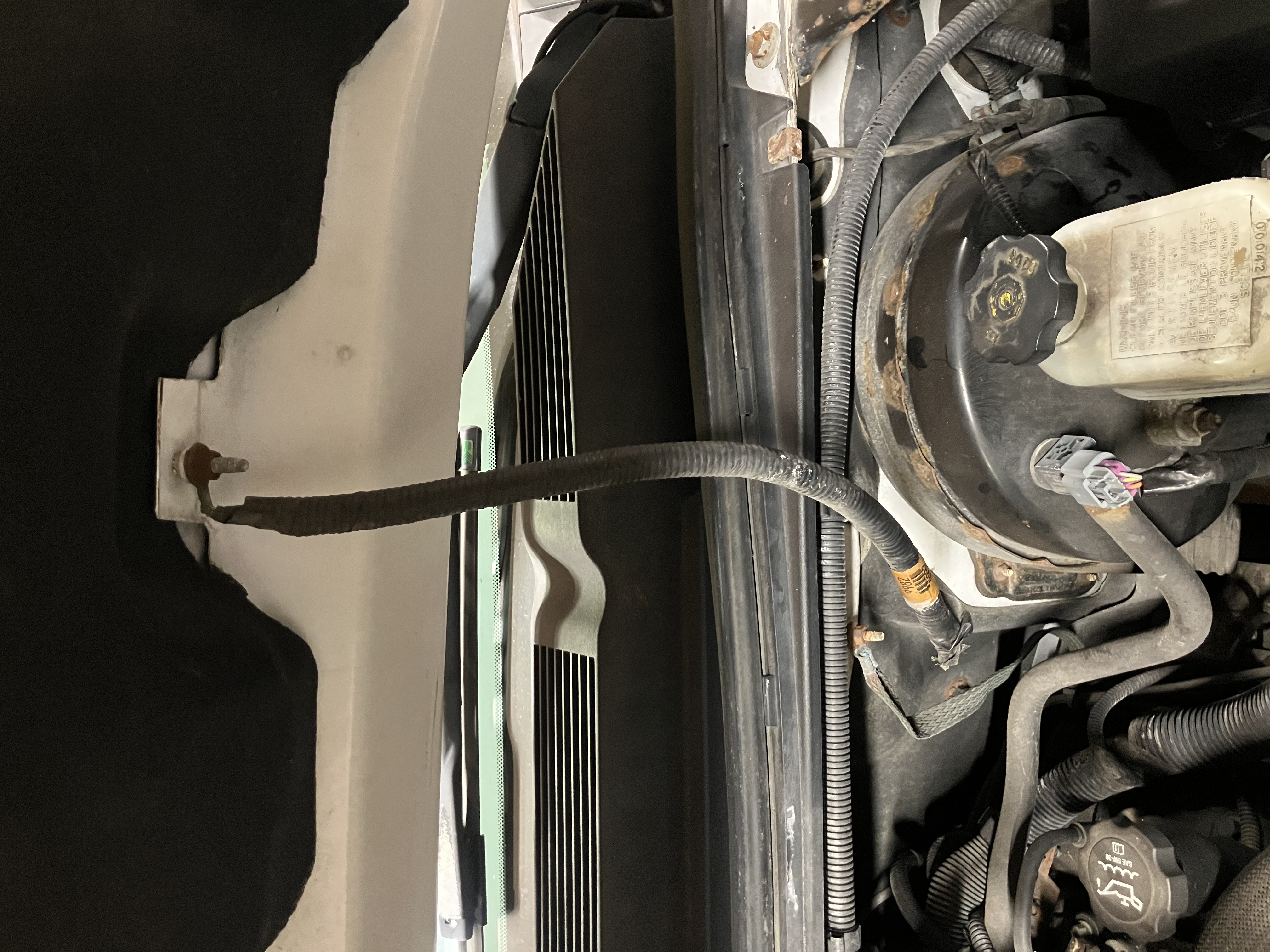

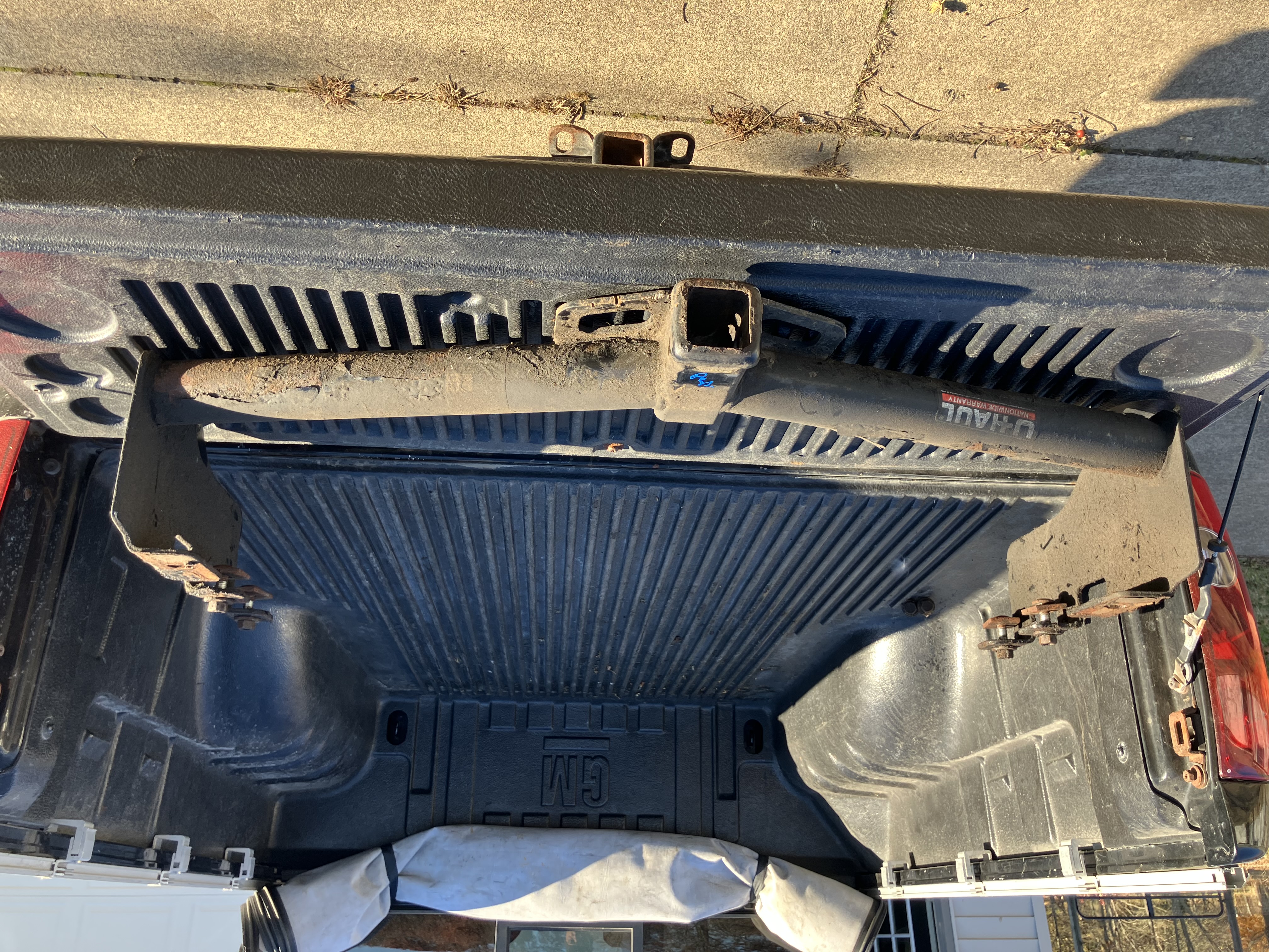

Every one of these at pull-a-part was broken, but a new replacement was cheap so I got one. Tow hitch receiver
This UHaul unit came from Pull-a-Part. It was under a truck that had been sprayed down with oil to prevent rust, so it was grimy and rusty. It was under $40 and it has all the hardware . I knocked off most of the rust, applied the rusty metal primer and covered the affected areas with black Rustoleum.

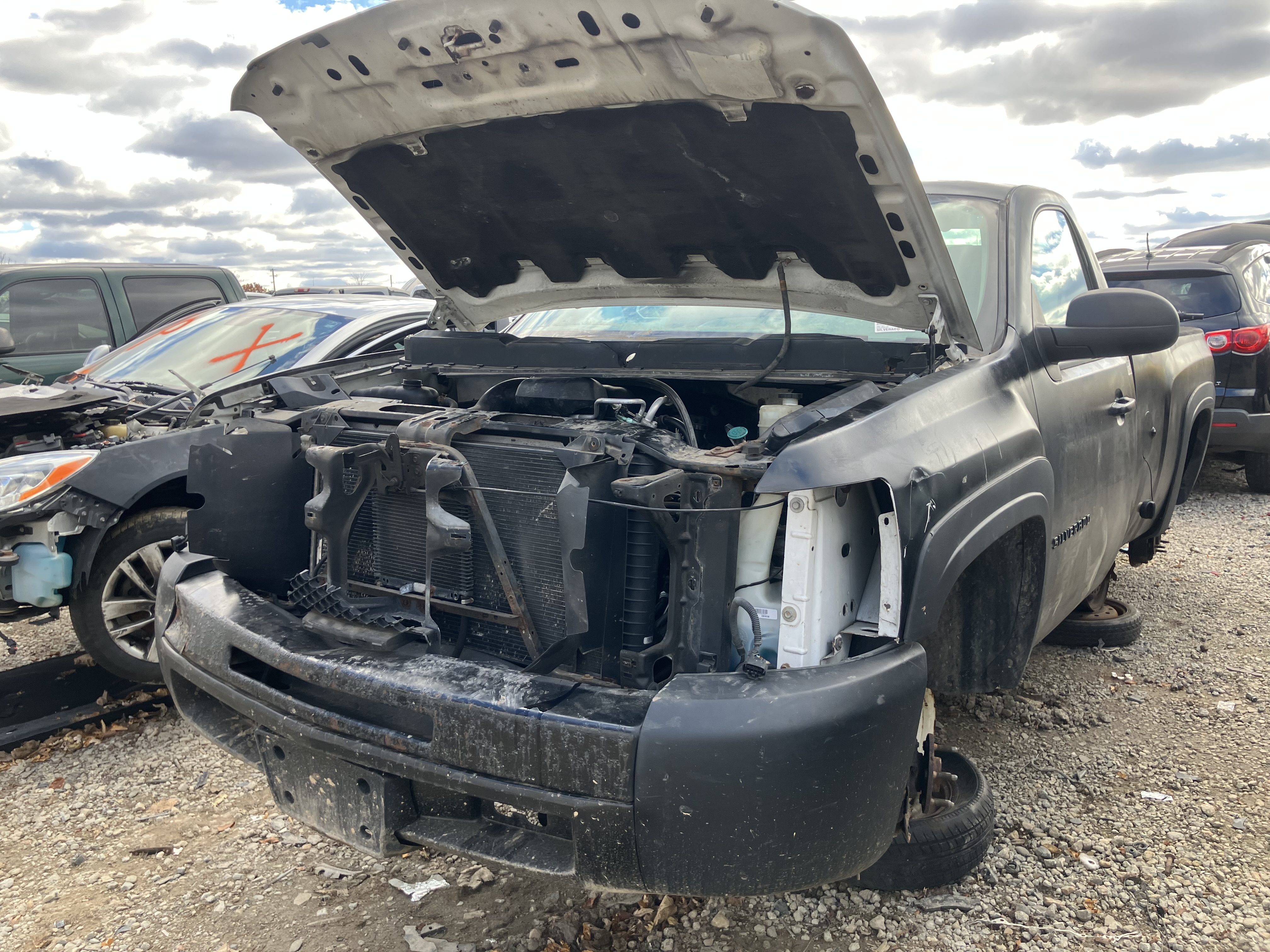

Tow hooks
