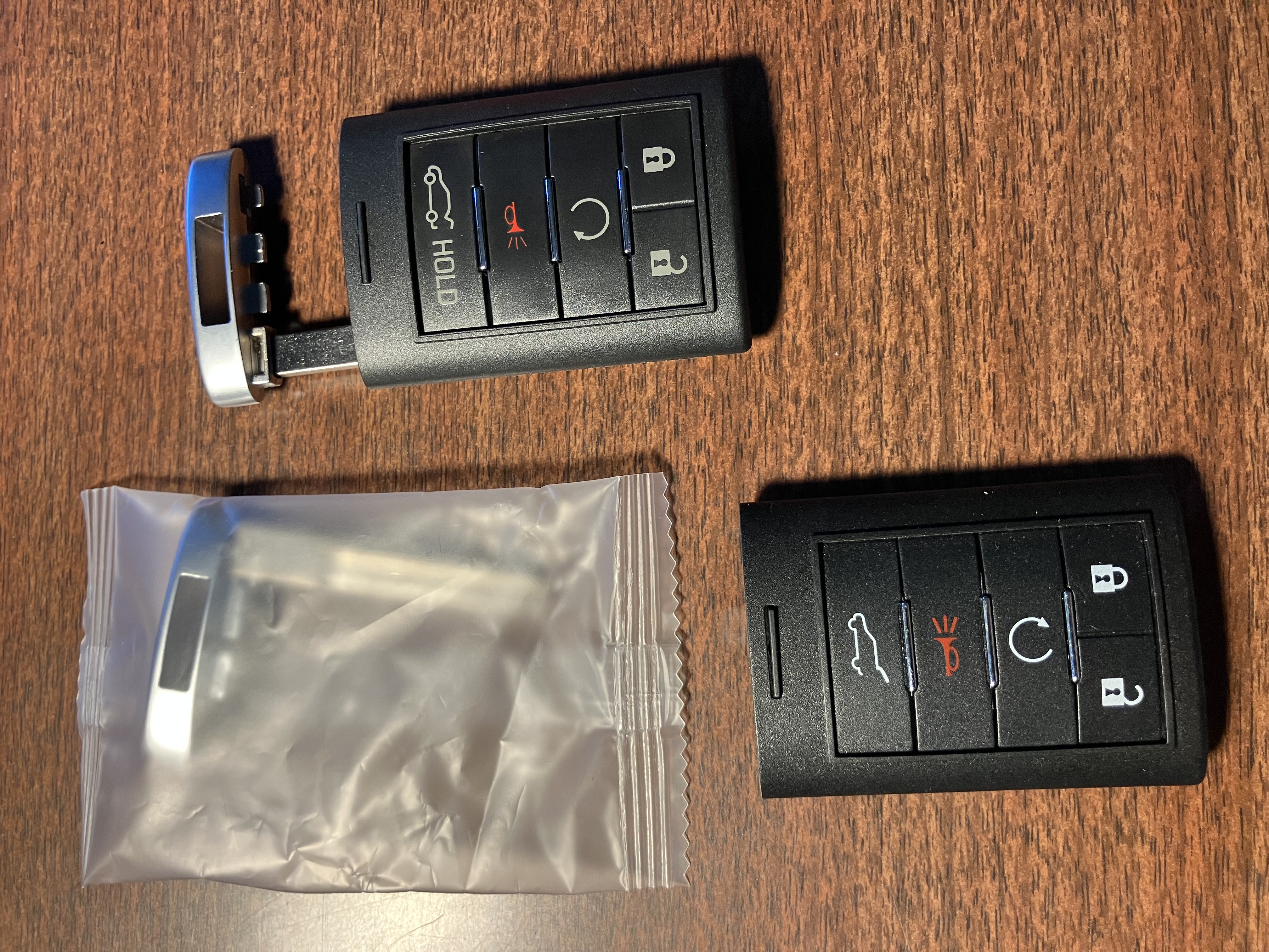

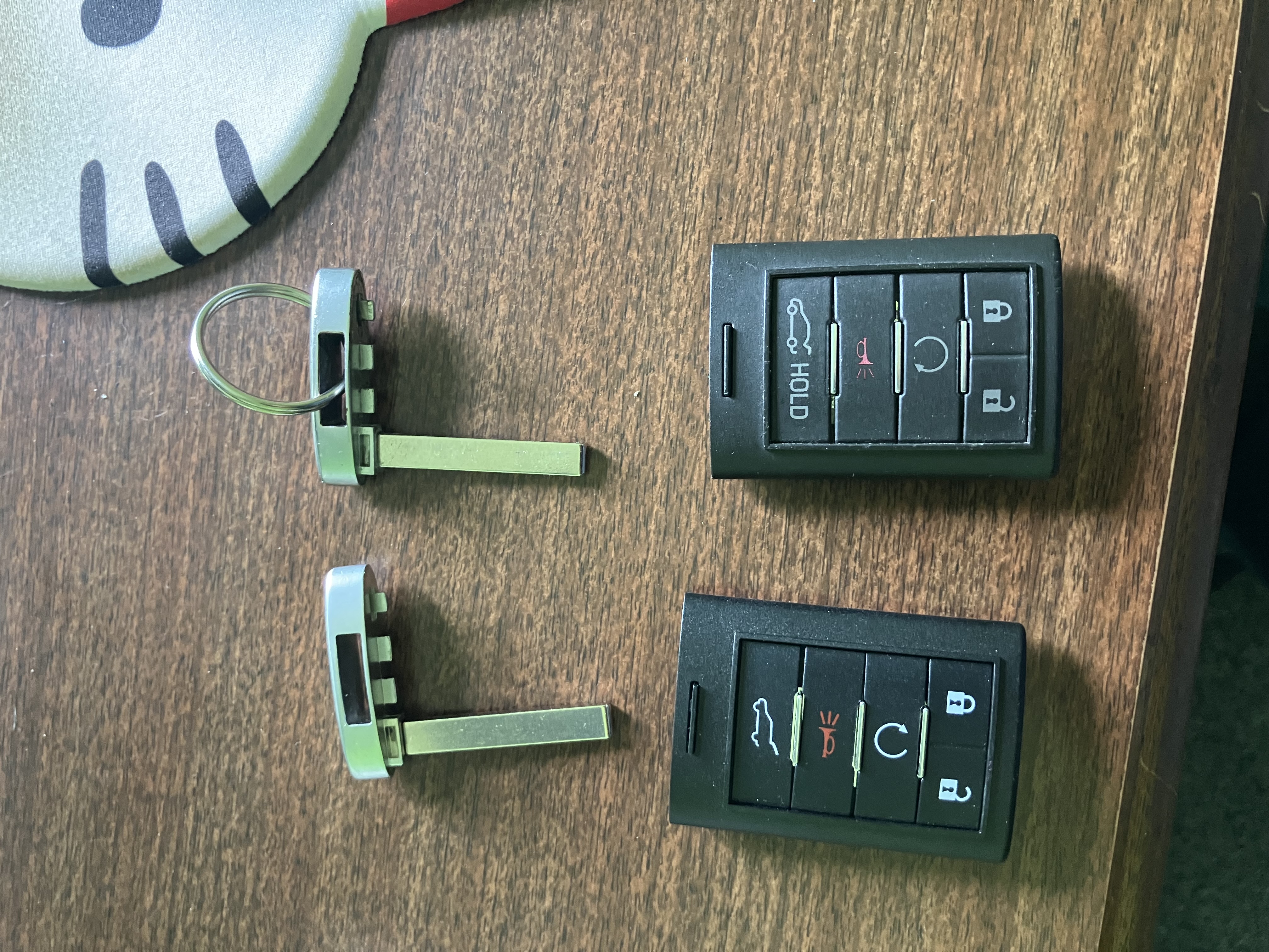

Another small upgrade is getting a spare key for the car.
I ordered a cheap one on eBay. When I went to install it I learned the sequence to program the remote requires me to put the physical key in the door and turn it counter clockwise five times. The instructions are actually in the owner manual.
It was at this point I learned that the physical key in my remote was not cut to the car, so I have no physical key. To fix this I had to go to the dealer with ID and registration to get a code, then to a locksmith with the code to cut a key. I had them cut both physical keys.
With this I made an attempt to program the new key. Well it didn't work. After some debate I decided the best path was to order another key fob and try it. When that fob showed up the physical key had a groove in it meaning its not compatible with this model. Fortunately the fob worked this time.
This monkey business cost me $135 and the time to figure it all out.

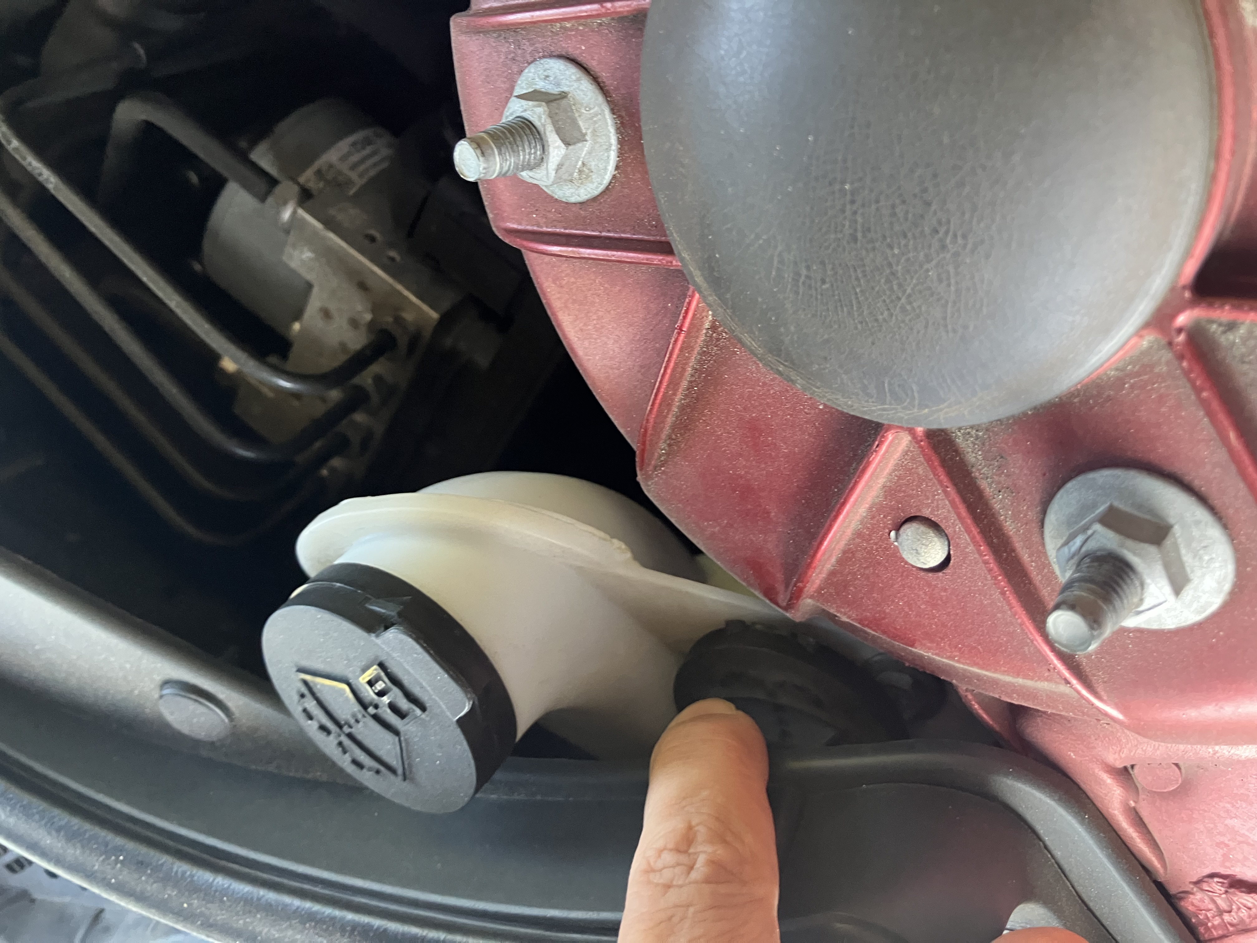

Bonus item: Thought the windshield washer fluid bottle had no cap when I bought it - but recently found the original
