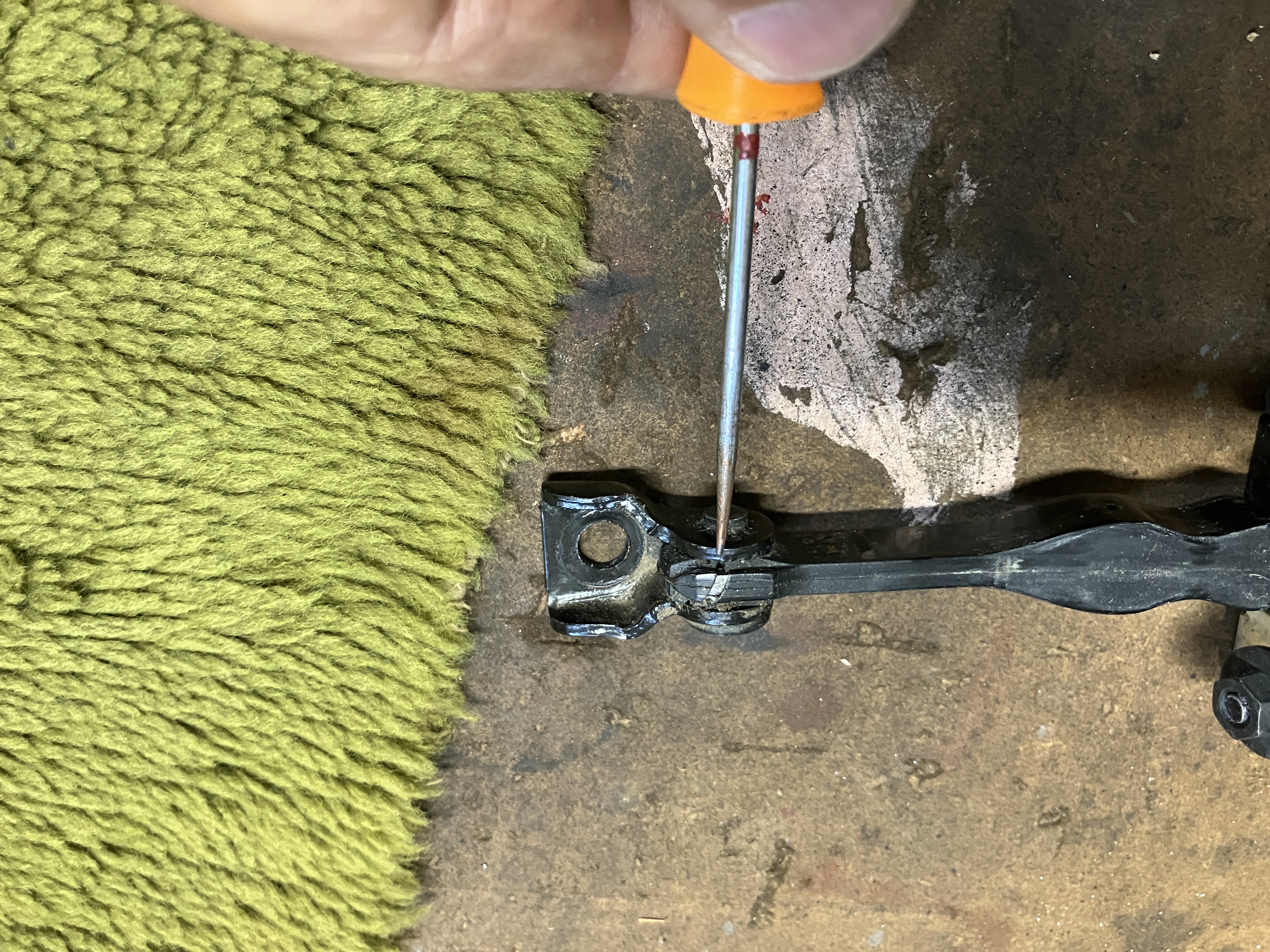

The door stop mechanism in the driver door has been clicking since I got this car. There is a crack in the rod where it attaches to the A pillar. I waited a while for one to show up at pull a part. when one finally showed at Cleveland West I was busy and didn't want to spend the 1 hr each way to get it, so I got a used one off eBay for like $22. Finally took the time yesterday to install it. IT was pretty straightforward though it did require removing the door
