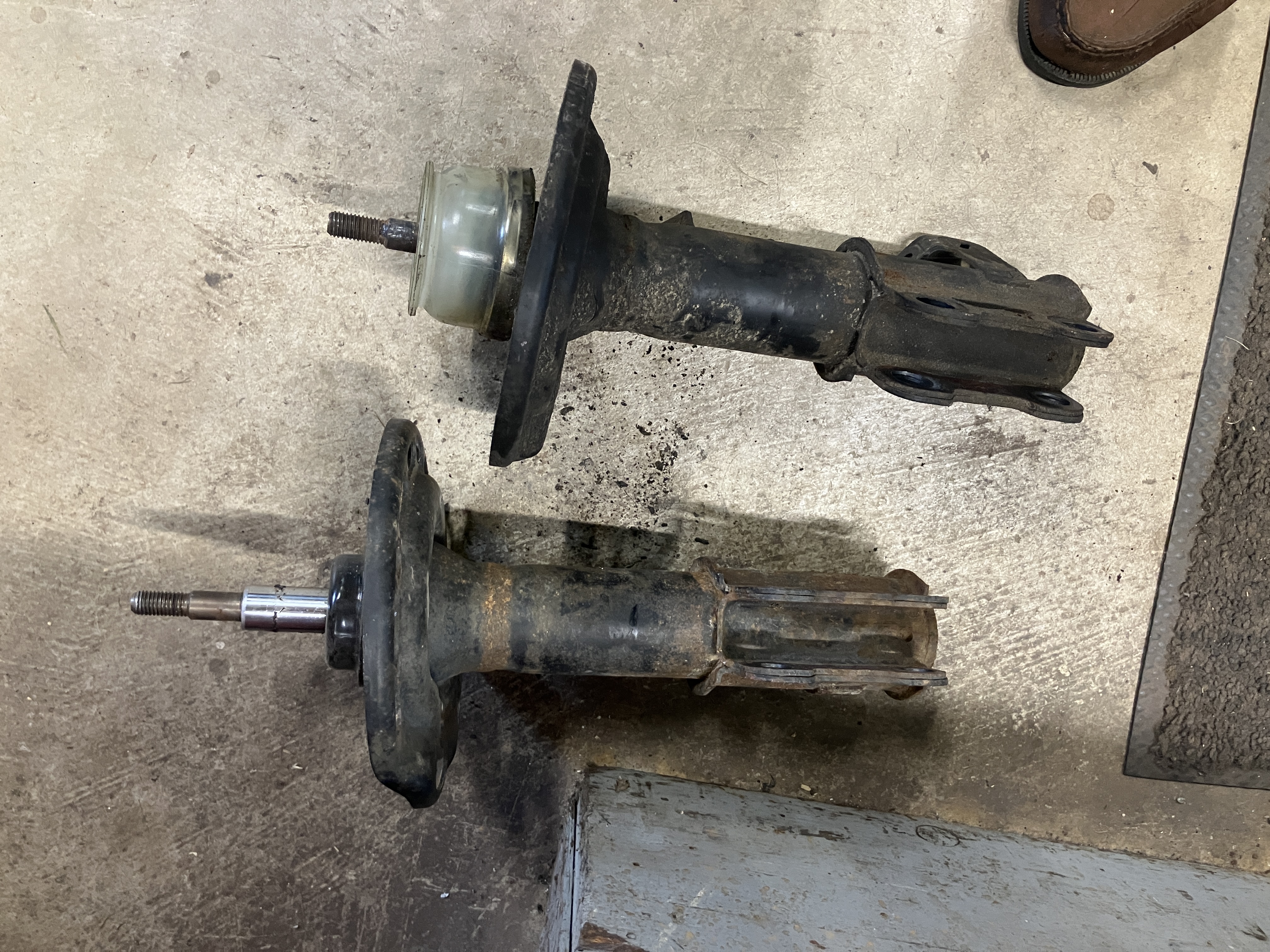

Upon disassembly I found the strut hat to be unlike anything I'd seen before. It had a little free play in it on both sides so I ordered replacements. The replacements had the exact same free play.

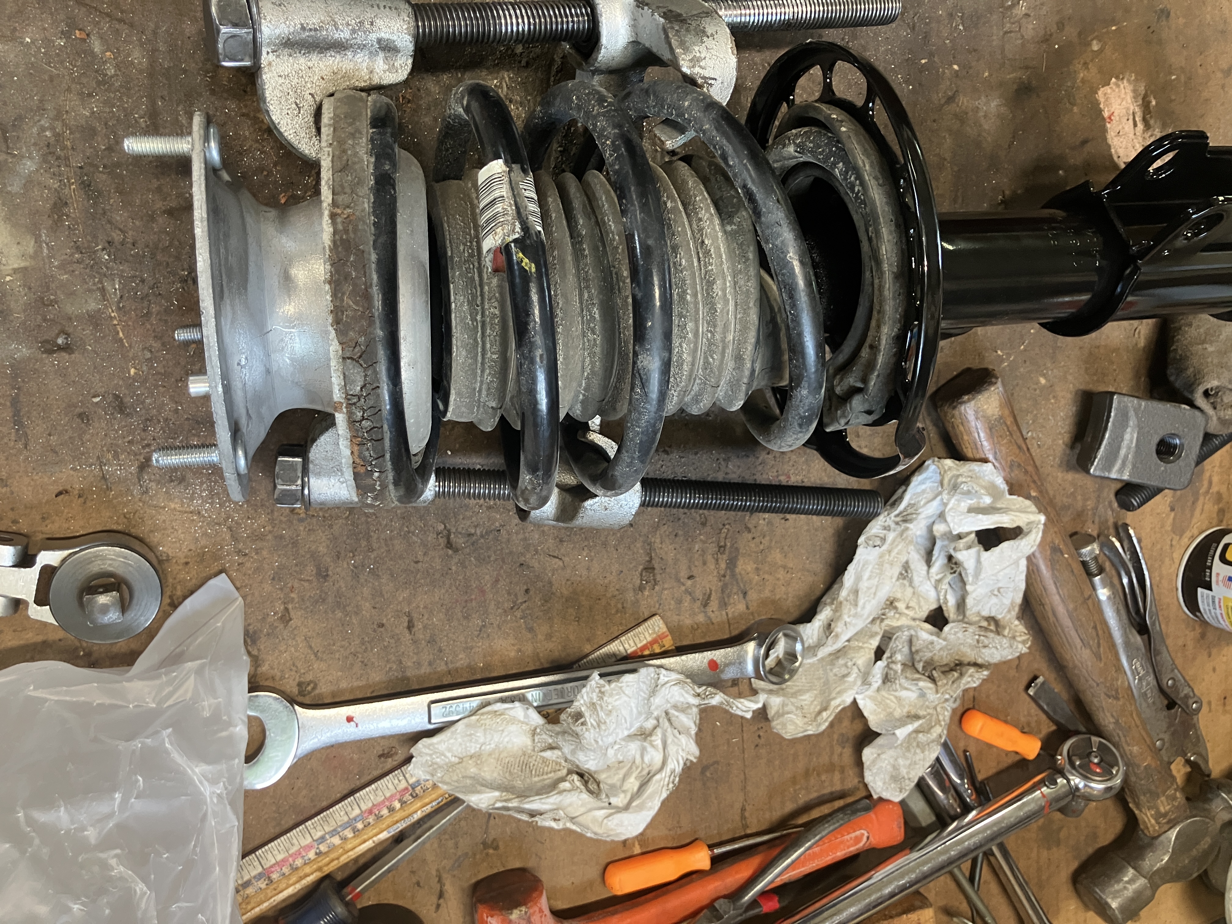

Removing and installing the spring turned out to be a pain until I figured it out. The sprint compressor did not have enough length to grab onto the top and bottom coil in order to compress the thing far enough to remove the nut without any spring tension. Turns out putting the top of the tool on the plate at the top of the spring worked, and the second one was a piece of cake. The old struts were quite shot.

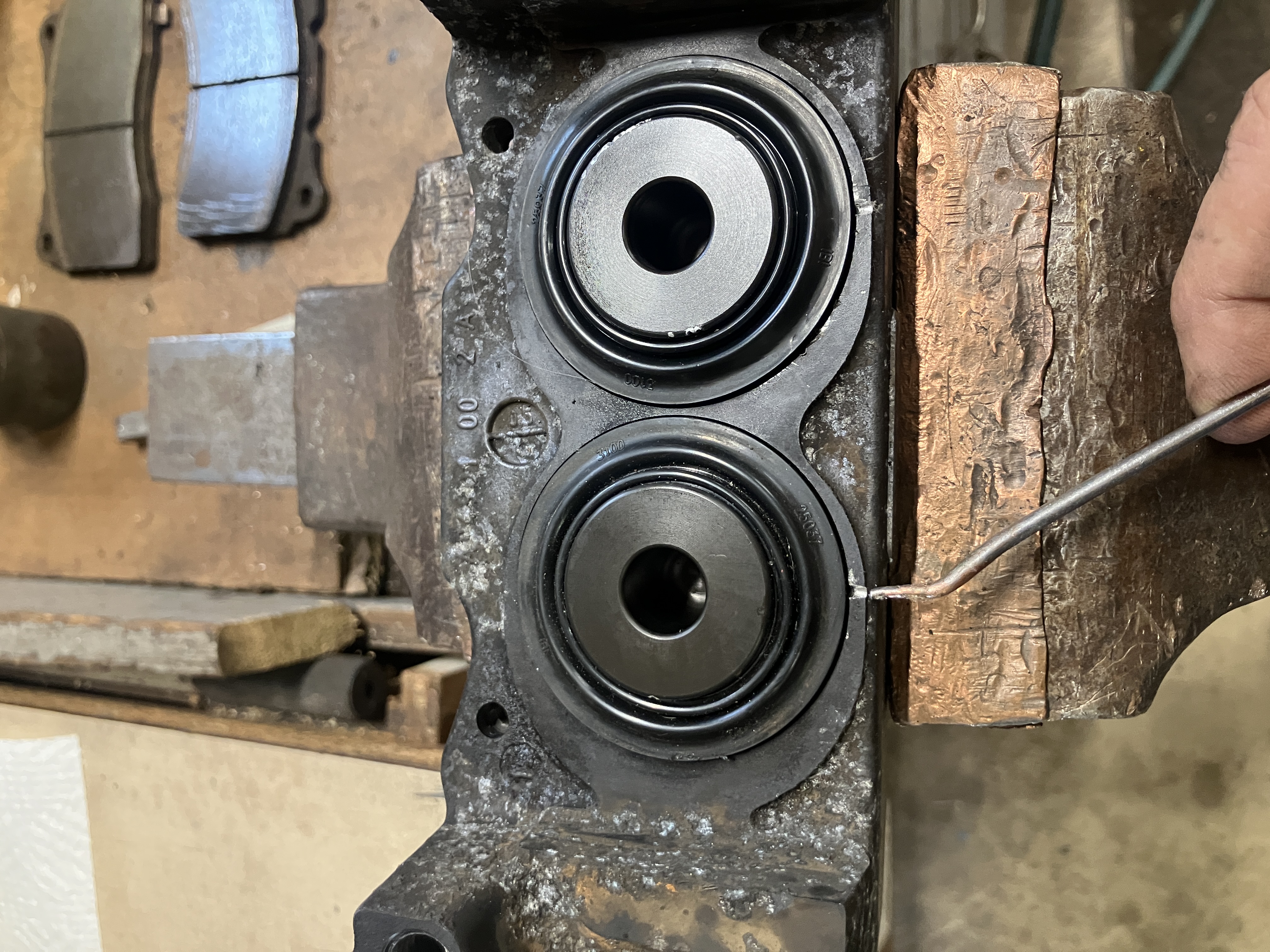

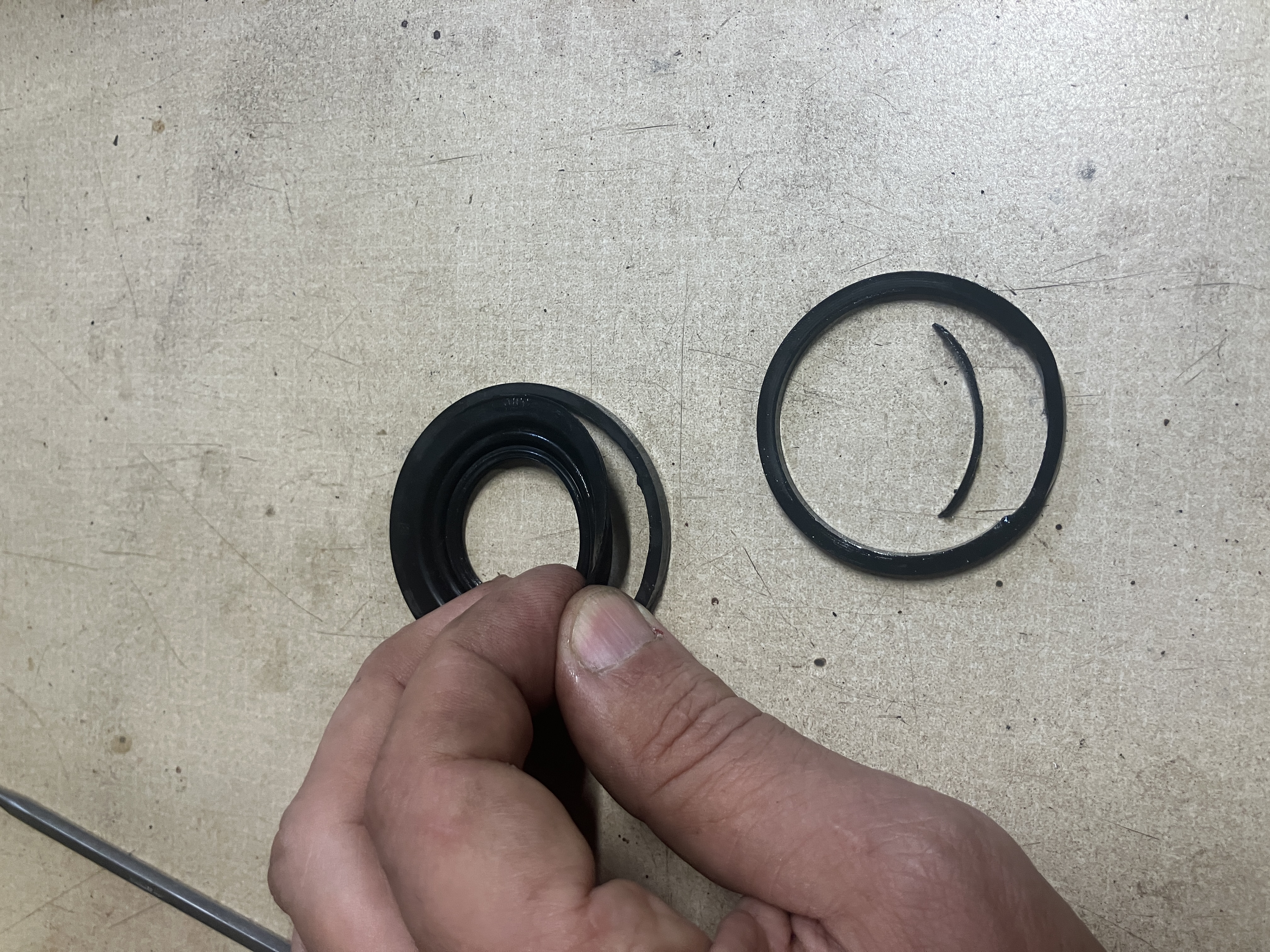

As far as the brakes sticking, I did some internet browsing and found people were reporting issues with the seals on the caliper pistons getting hard and causing extra drag. I decided to rebuild them rather than shell out $500 for a pair. There was a cost though in the amount of work it took. I watch a video and the thing came apart no problem. I had a very difficult time getting the dust seals off - ground out a small notch so I could get under them and force them out. When putting the pistons back in they would not just slide past the new seal. I tried vice pressure on one but didn't like that, so ended up using a small dead blow hammer to tap them in. That worked. After assembly and install I found one of the pistons to be leaking - presuming its the one I tried to force with the vice. Luckily it just damaged the seal and I was able to change it out fairly easily.

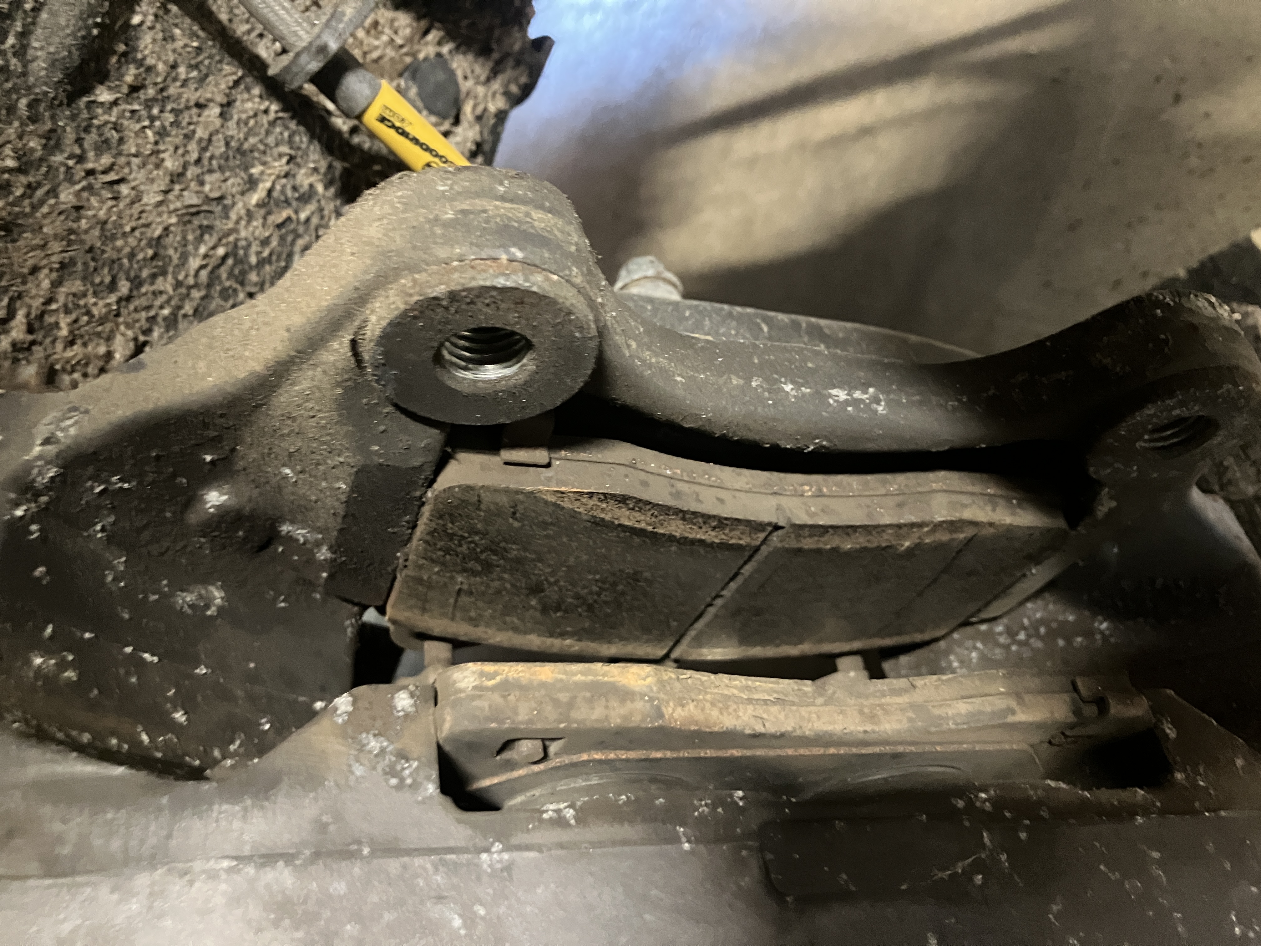

I did learn that this caliper design is also unique. There are no metal clips to hold the pads in place. The pad is basically square and the front and back edges are about 2" long and they just fit up close to the caliper. Well they seemed a little difficult to slide, so I cleaned the caliper surface and ground just a little off both ends of the pads. With this in mind I postponed the rebuild of the other caliper, and reassembled the front suspension.
