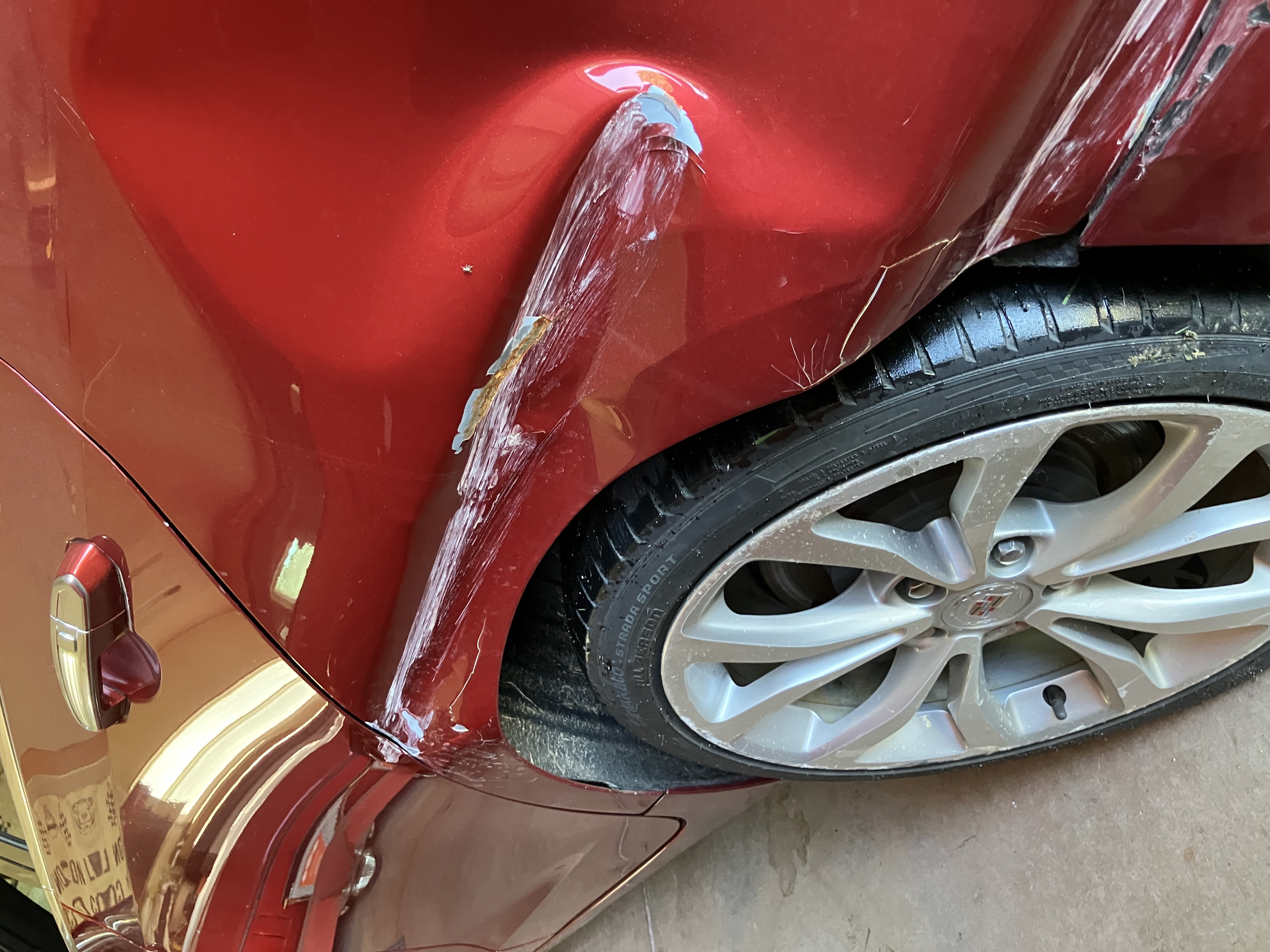

Well the black ATS ran into a roadblock with the dirt drags, and I eventually figured out the V6 version makes 50 more horsepower, so I bought one. I looked at regular retail vehicles but the V6 has a decent premium over the 4 cylinder, so I went looking at wrecks.
This one is from North Carolina, has some damage from an accident, and had a rebuilt title before that.
The auction came on Monday - all total I'm in for about $5600 including delivery to my house. By Wednesday it was here. Today it went to the BMV by trailer to get VIN inspection and get an Ohio salvage title
It has just over 121k miles, and the damage is pretty minor. Based on what I saw underneath, looks like the car slid backwards through wet grass. I speculate it slid backwards into whatever it hit.
Observations so far:
- the differential is leaking a little through the breather, and possibly through the rear diff cover. It also looks like it had been erased.
- the LR is a little toed out, but nothing looks bent and there looks to be plenty of adjustment left
- the car has 4 different brand tires on it - could be a factor in the crash?

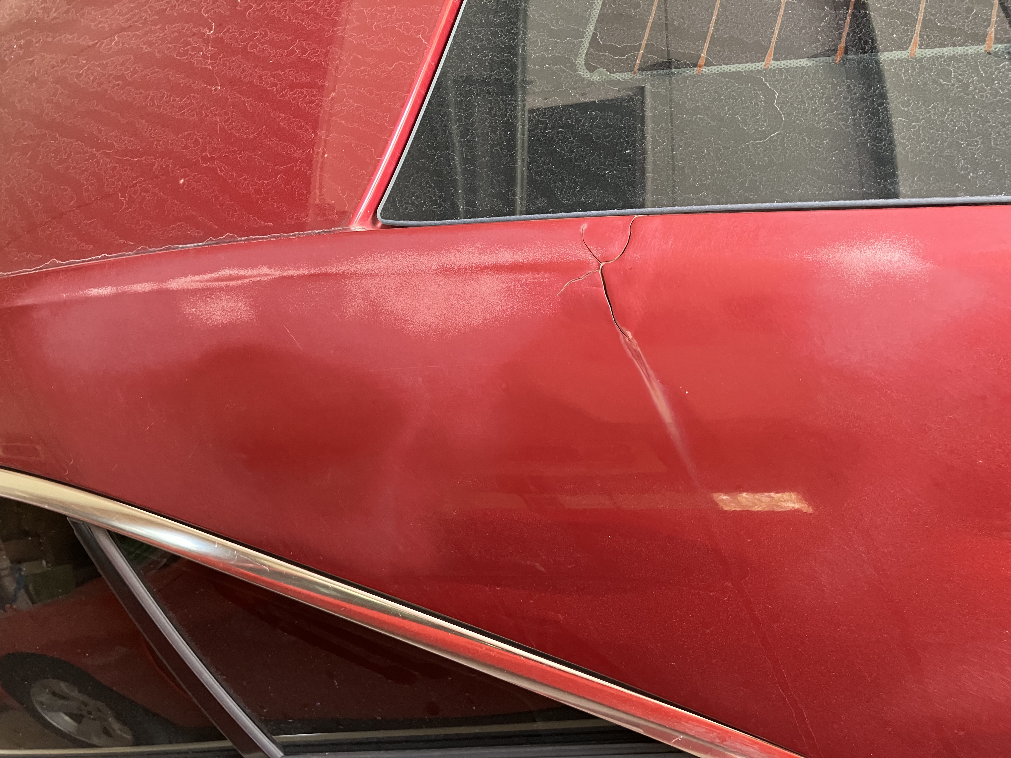

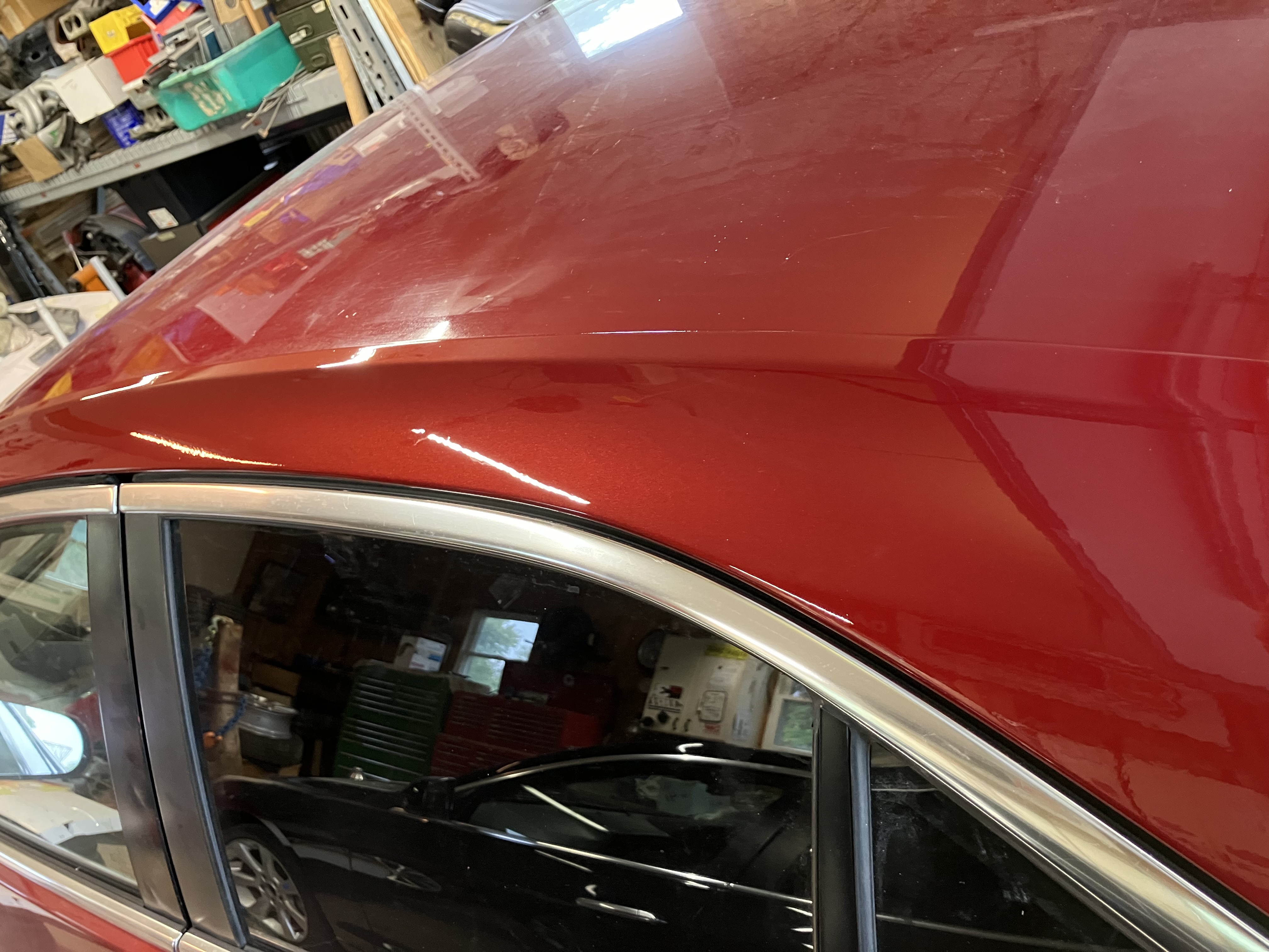

- looks like the LR quarter panel was repaired before - it has some fade on the C pillar, and there is evidence of bodywork where the fender was damaged

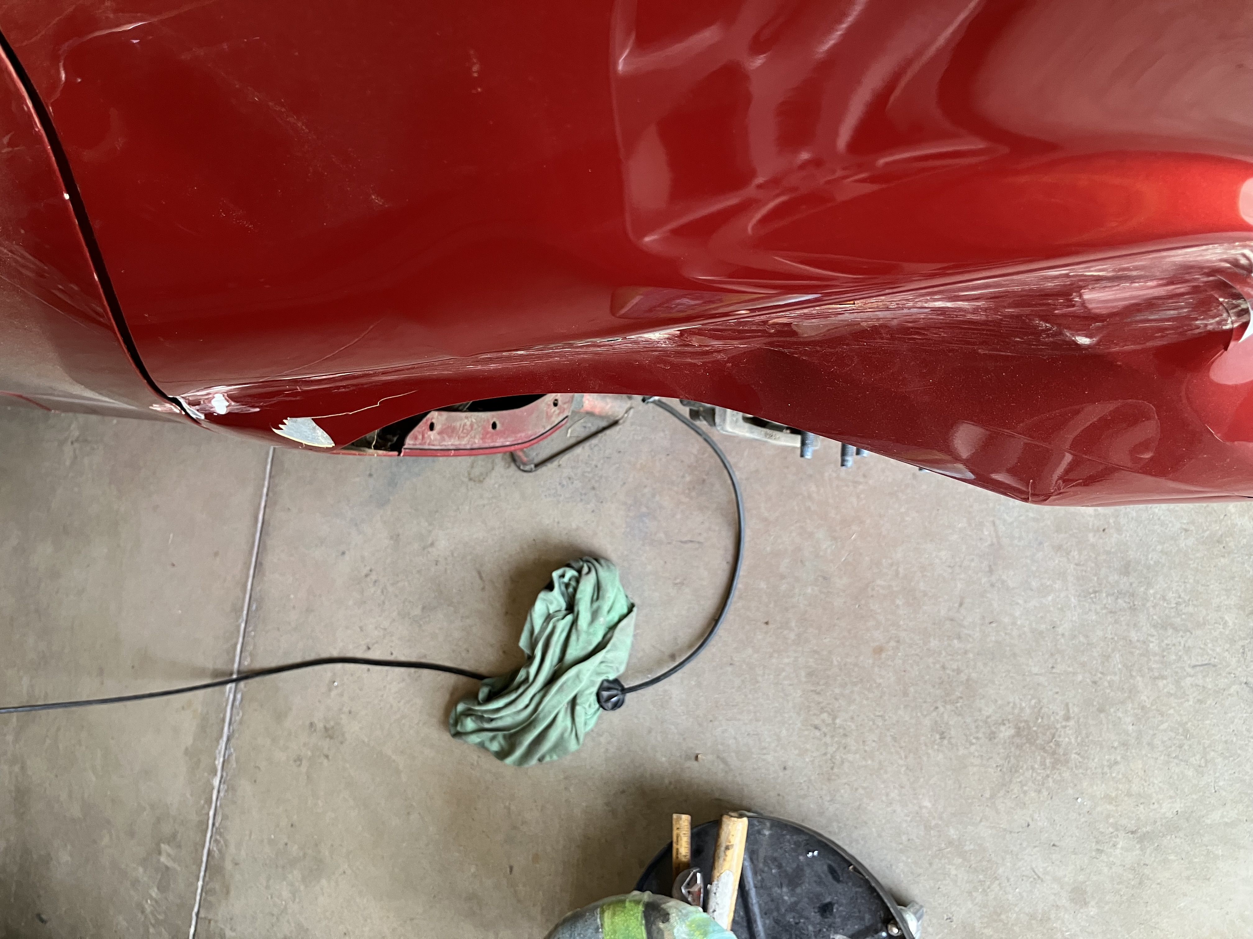

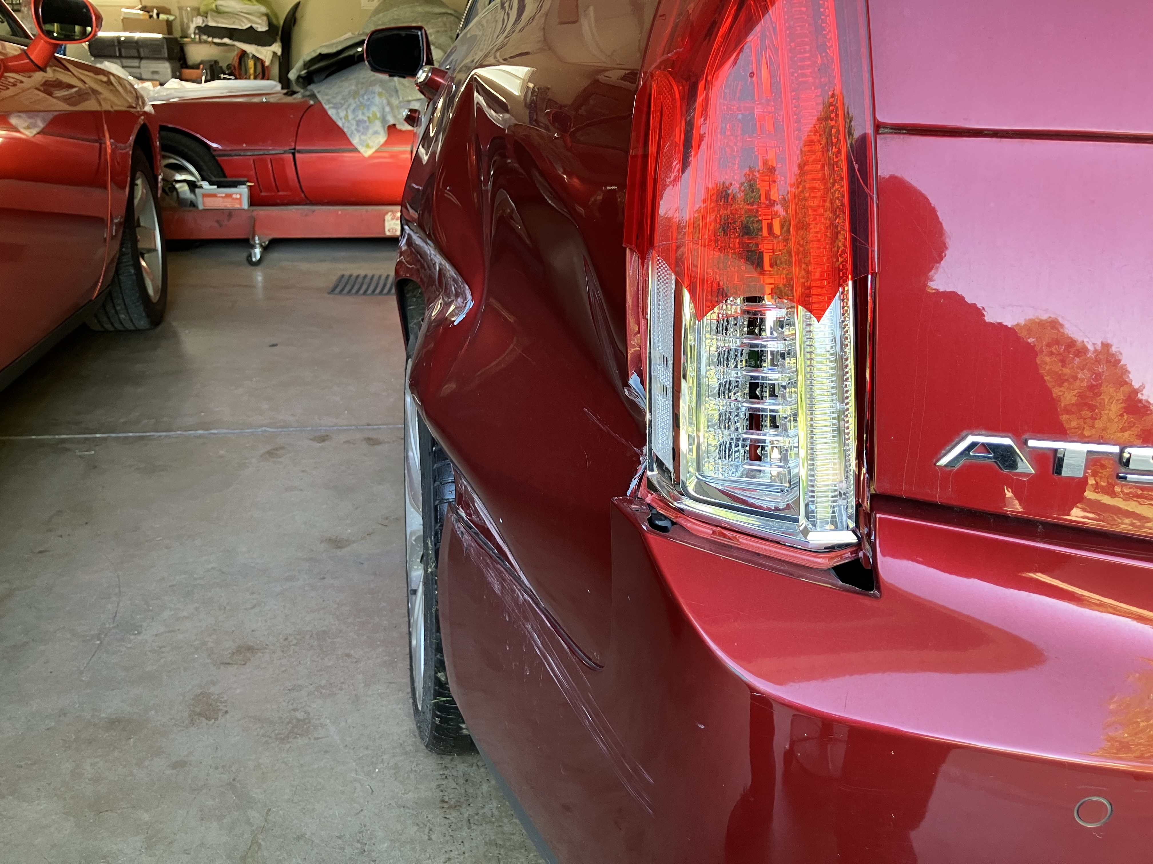

Bodywork:

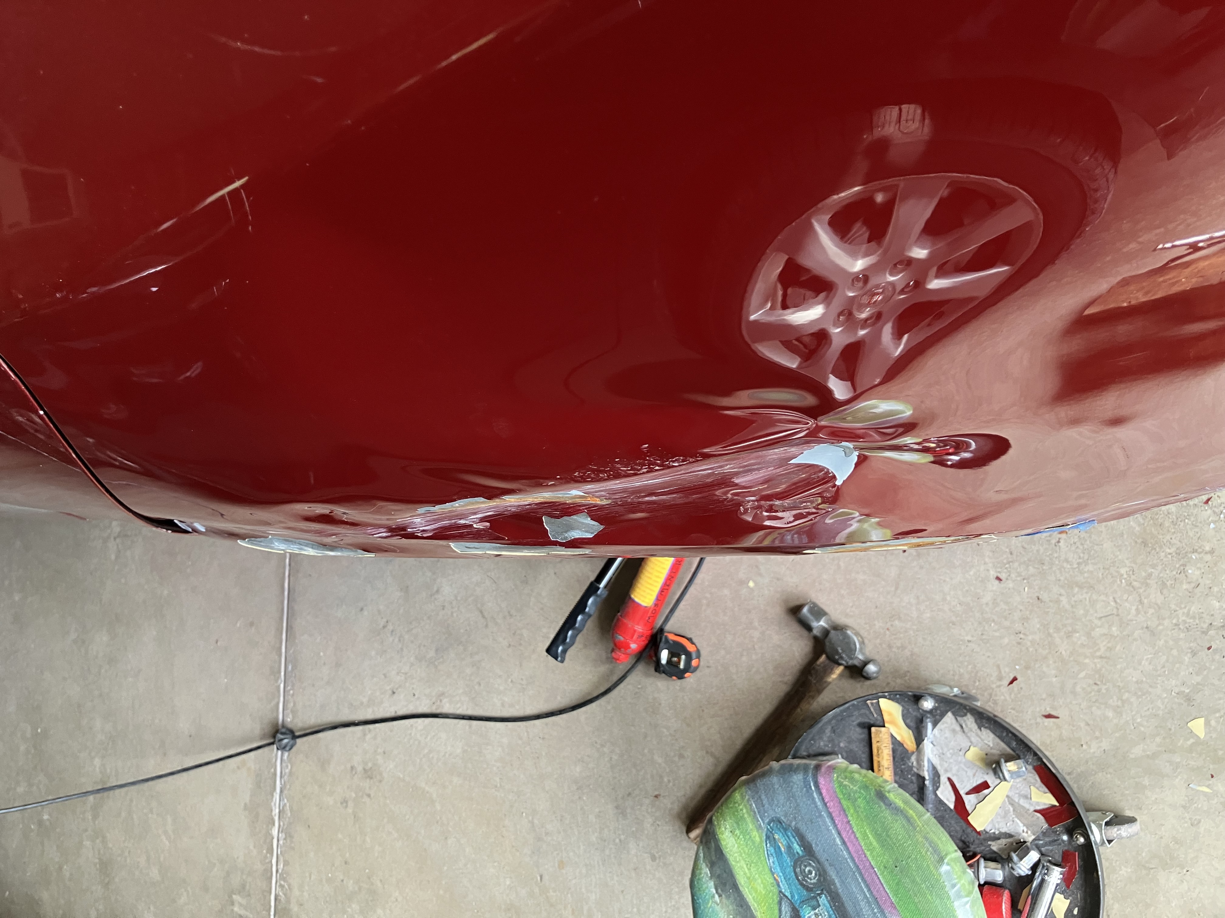

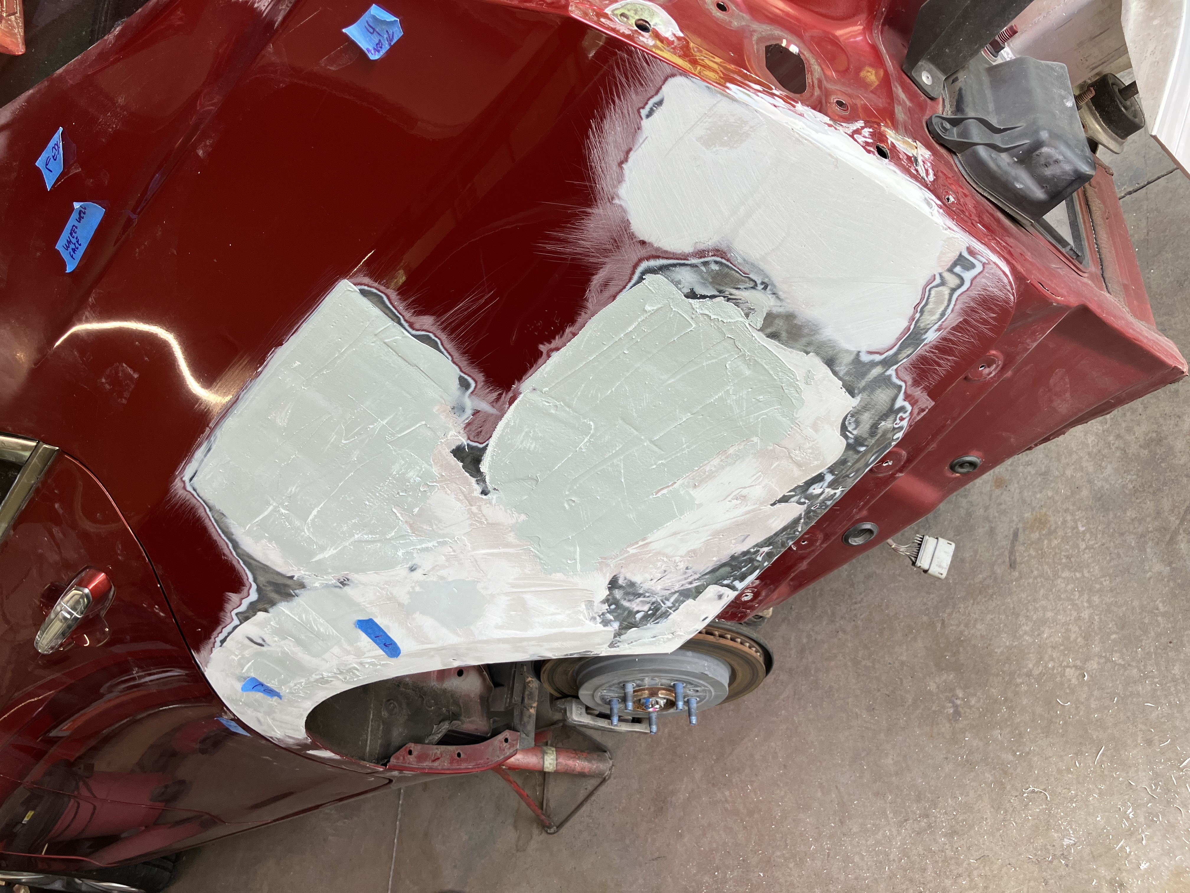

* Removed the LR taillight, rear bumper cover and LR inner fender

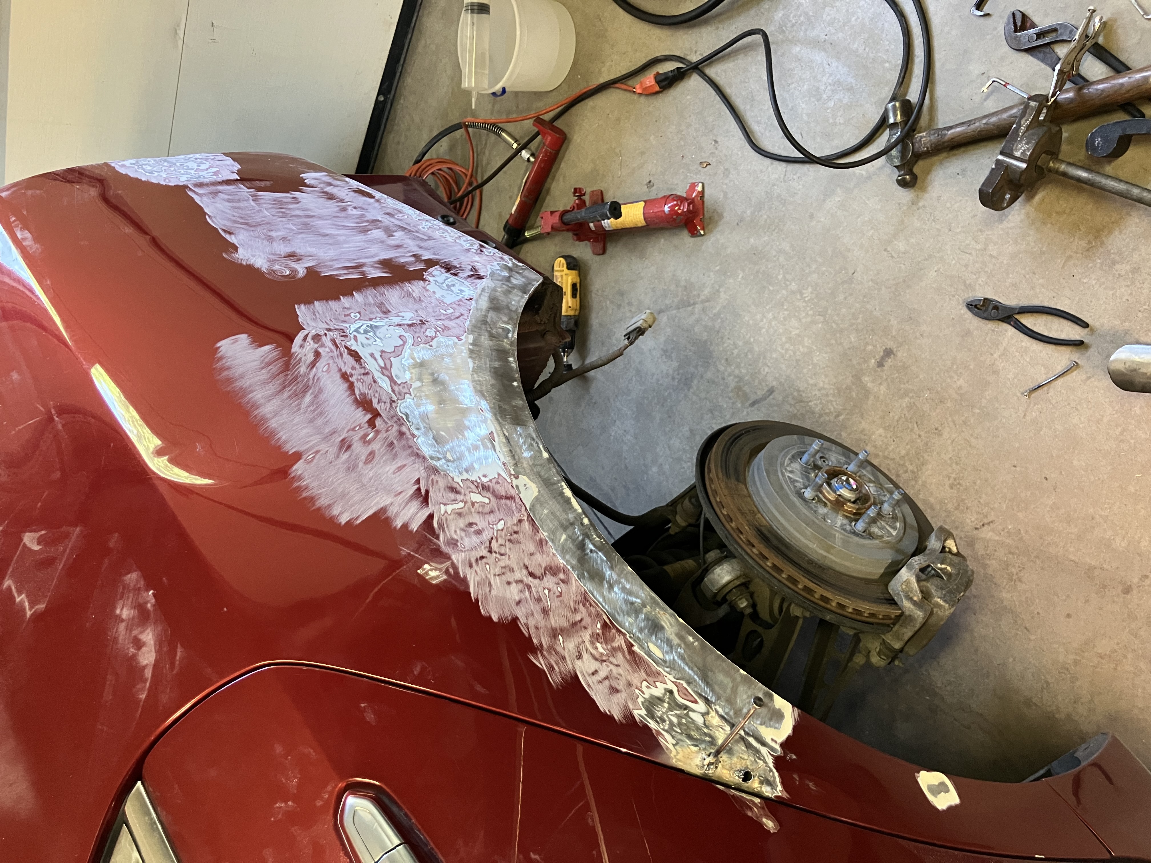

* Put the port-a-power, hammer & dolly, and some welded nails to straighten the LR quarter panel. It's not quite the way I want it but I'm at diminishing returns so it's time to put body filler on it and see how it looks
* Ground off prior body filler in the damaged areas

* Turns out the paint is WA132X Obsession Red which is a tri-coat paint: foundation base, intermediate base and clear. It's one of the hardest colors to blend and will be expensive. Great!
* I don't see any obvious bends in the LR suspension parts, but the toe in setting looks to be off the factory spec. The LR wheel also looks to be straight

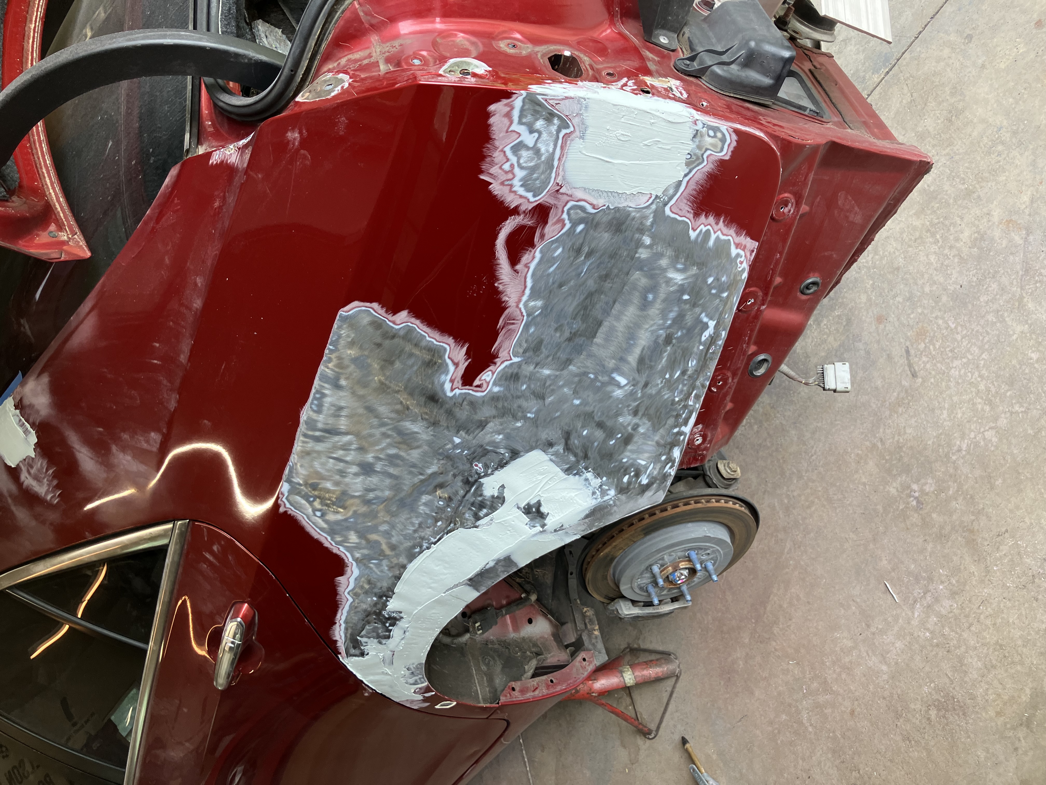

Before look at LR quarter
Child's play
Child's play
After some straightening

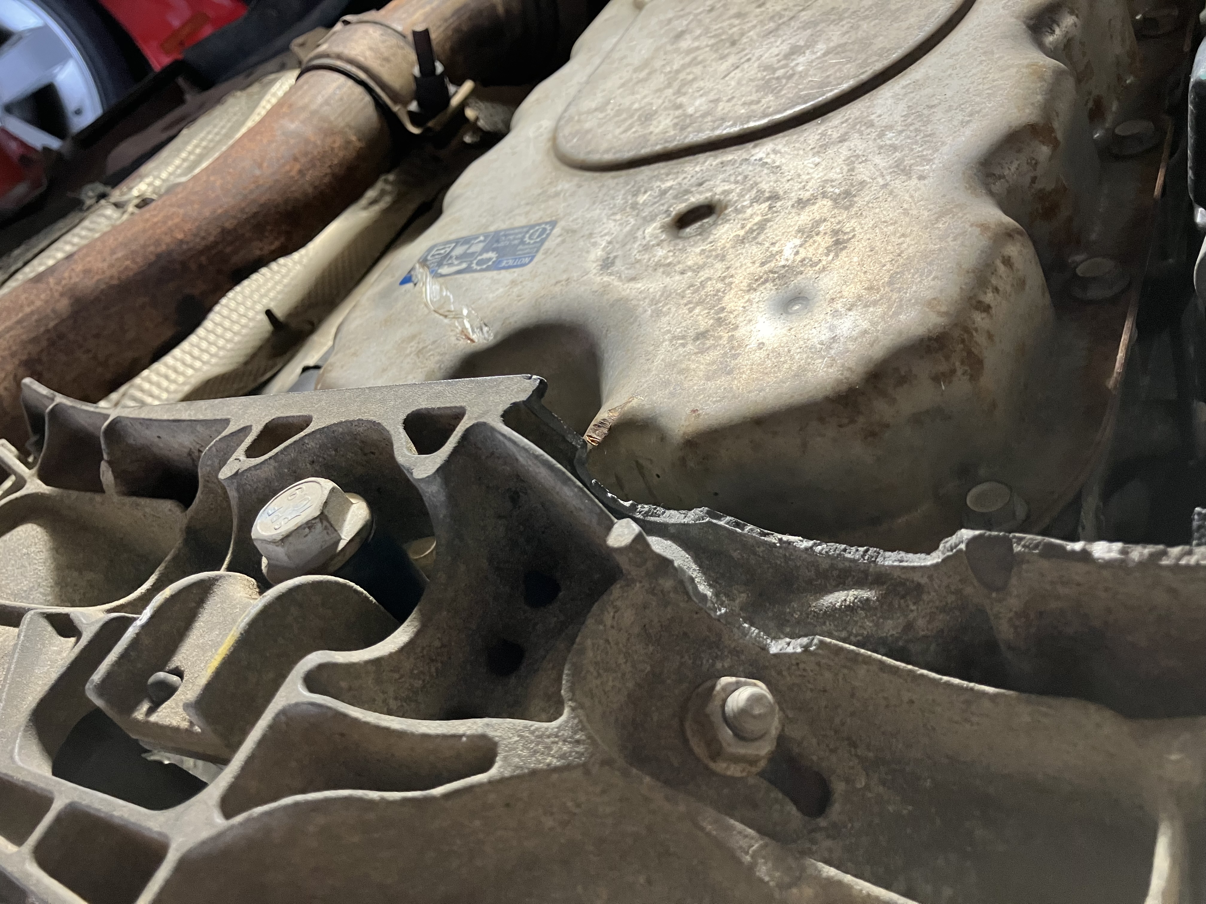

More evidence the LR quarter has already been replaced

Updates:

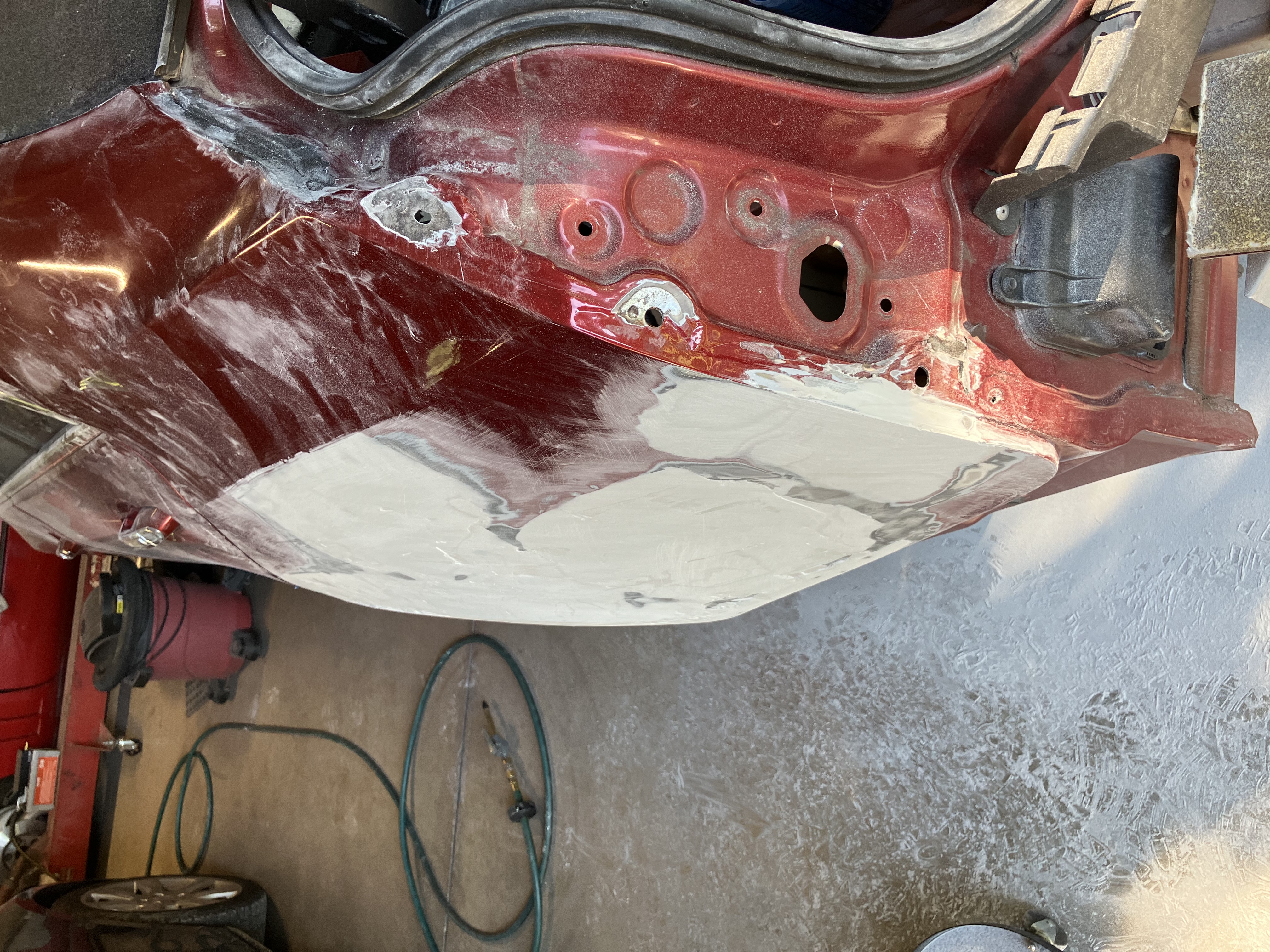

Bodywork:
- LR quarter is taking shape. Still some work to get the shape better but it's taking shape. I was tempted to get paint and just put it on but its just not ready forthat. I'm not looking for show car but there's too many imperfections.
- Put primer on it
- Reassembly in progress

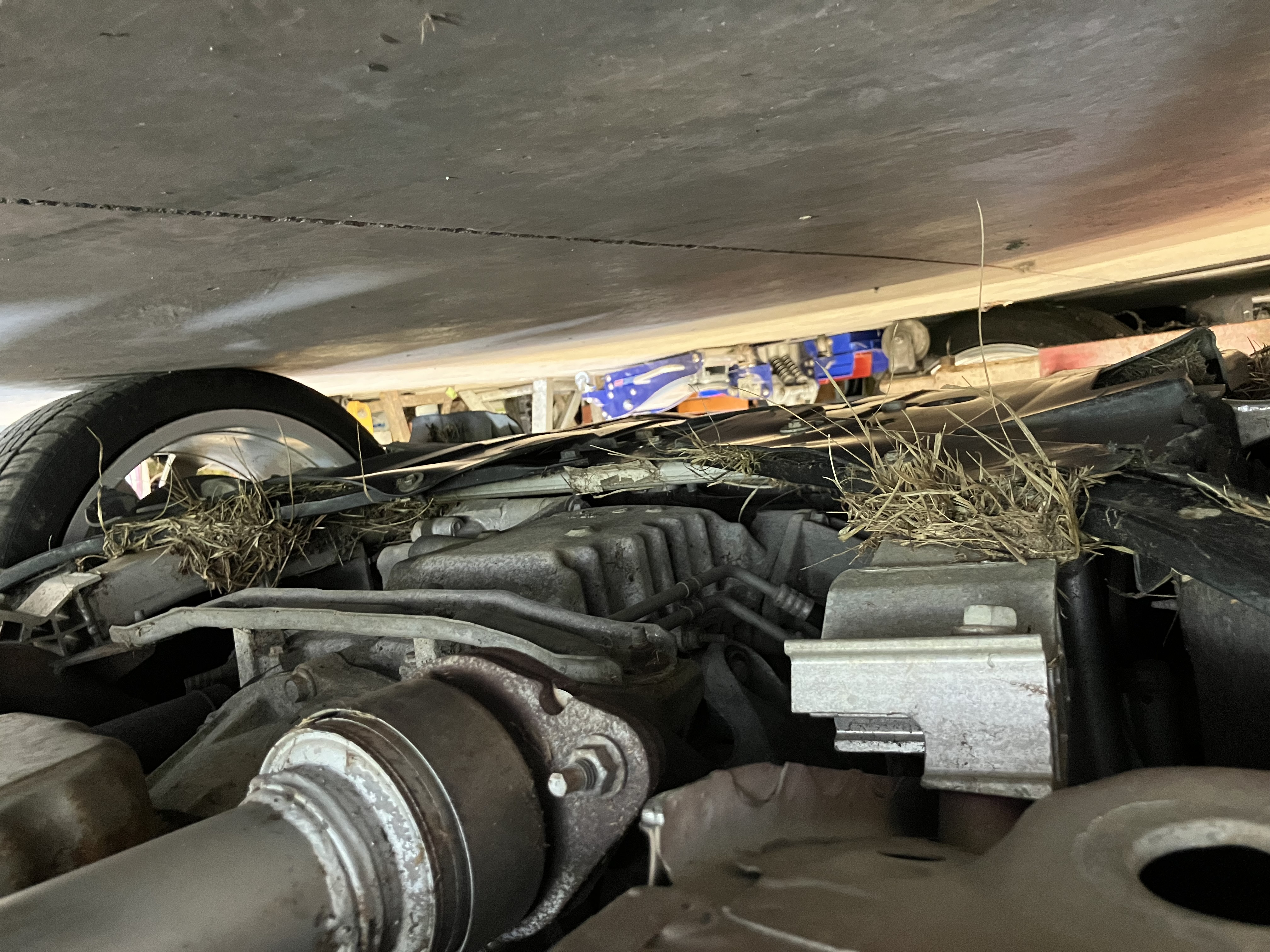

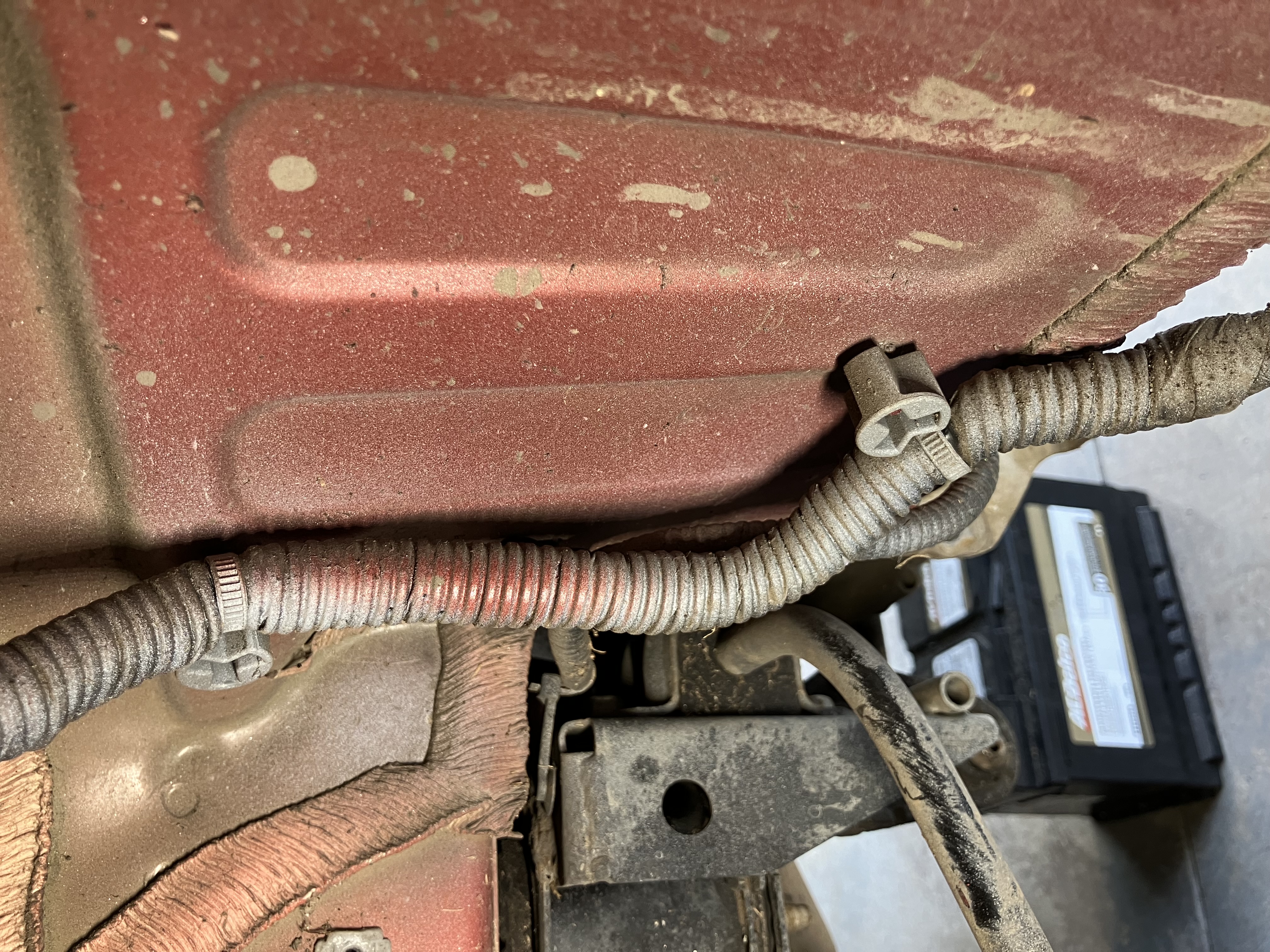

- Grass is in a lot of nooks and crannies underneath, in the wheel wells and brakes, on top of the underbody panels, on the exhaust. I have cleaned up several piles. Every time I think I'm done I find more, though I have inspected all around the exhaust to make sure I'm not going to have a fire once this thing gets completely up to temperature

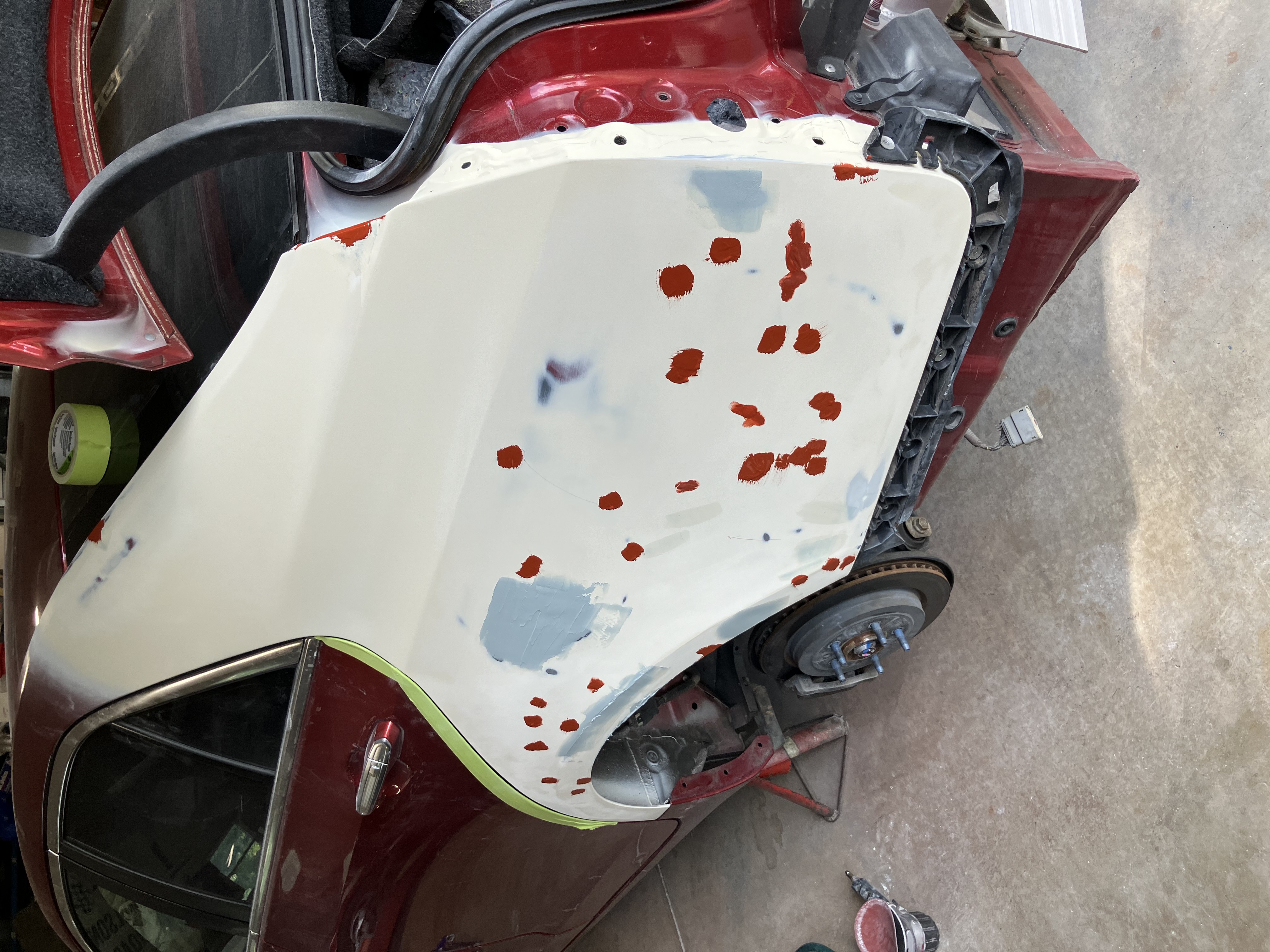

I ran out of time before Friday to get the paint on so I only got primer on the LR quarter panel. It's decent but not smooth enough for paint yet. After that I had some work getting the front end aligned as well as the LR. Toe in and steering wheel alignment are good.

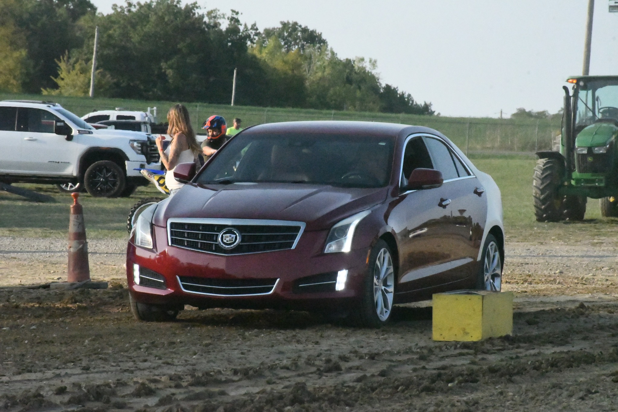

That evening the car made its debut at the dirt drags. Rachel also made her debut with the Charger. The red Caddy runs pretty consistent low 4.50's. It lacks the high RPM stall converter but it's easy to hold the car at 1500. Overall very happy with the performance of the car, and thinking there is a lot more potential with a tune up, better tires and basic performance modifications.

After that I put a little more time into the LR quarter panel. It's not ready for paint yet but hopefully will be in a few more sessions.
back to work on the finer bodywork

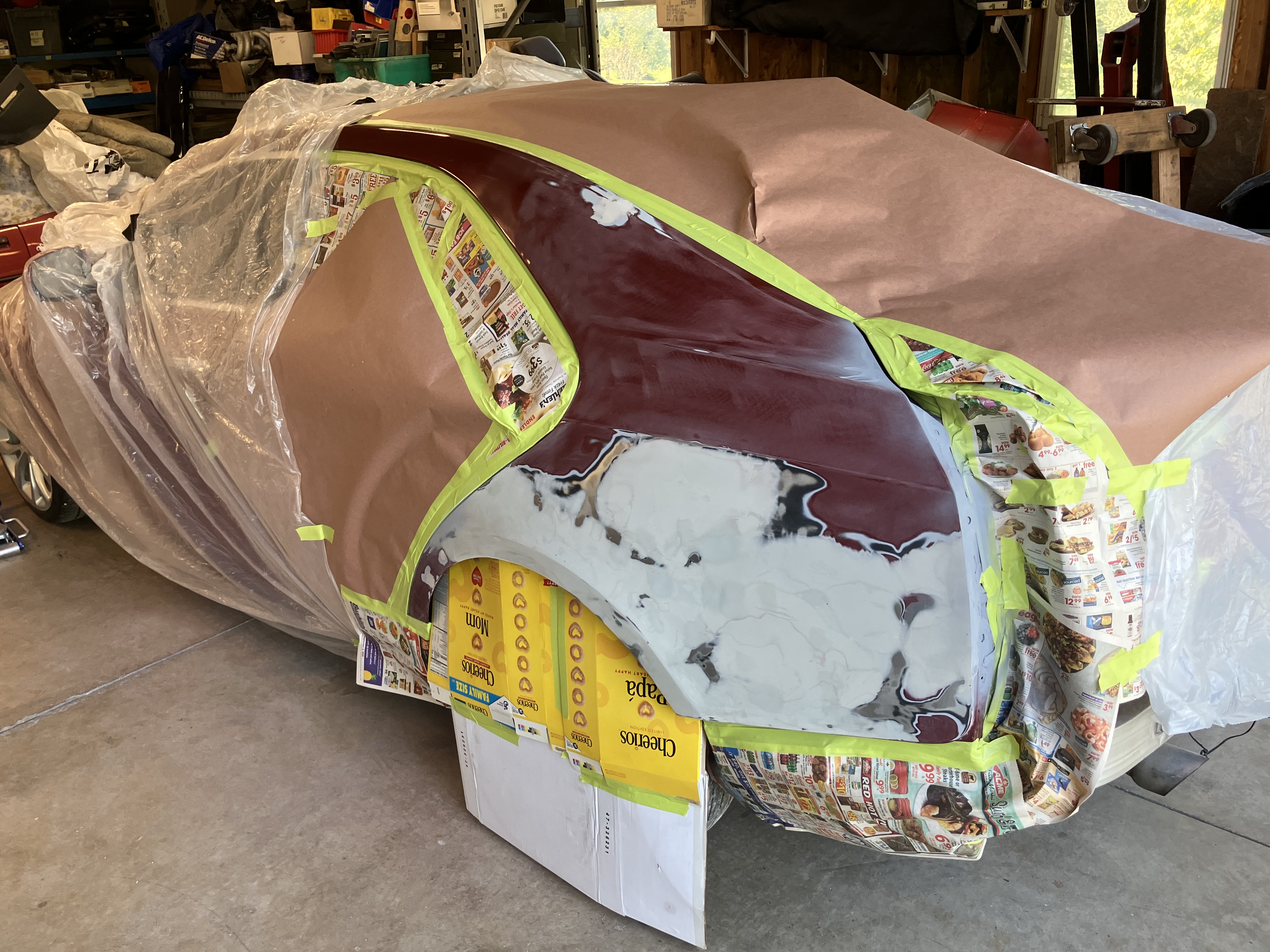

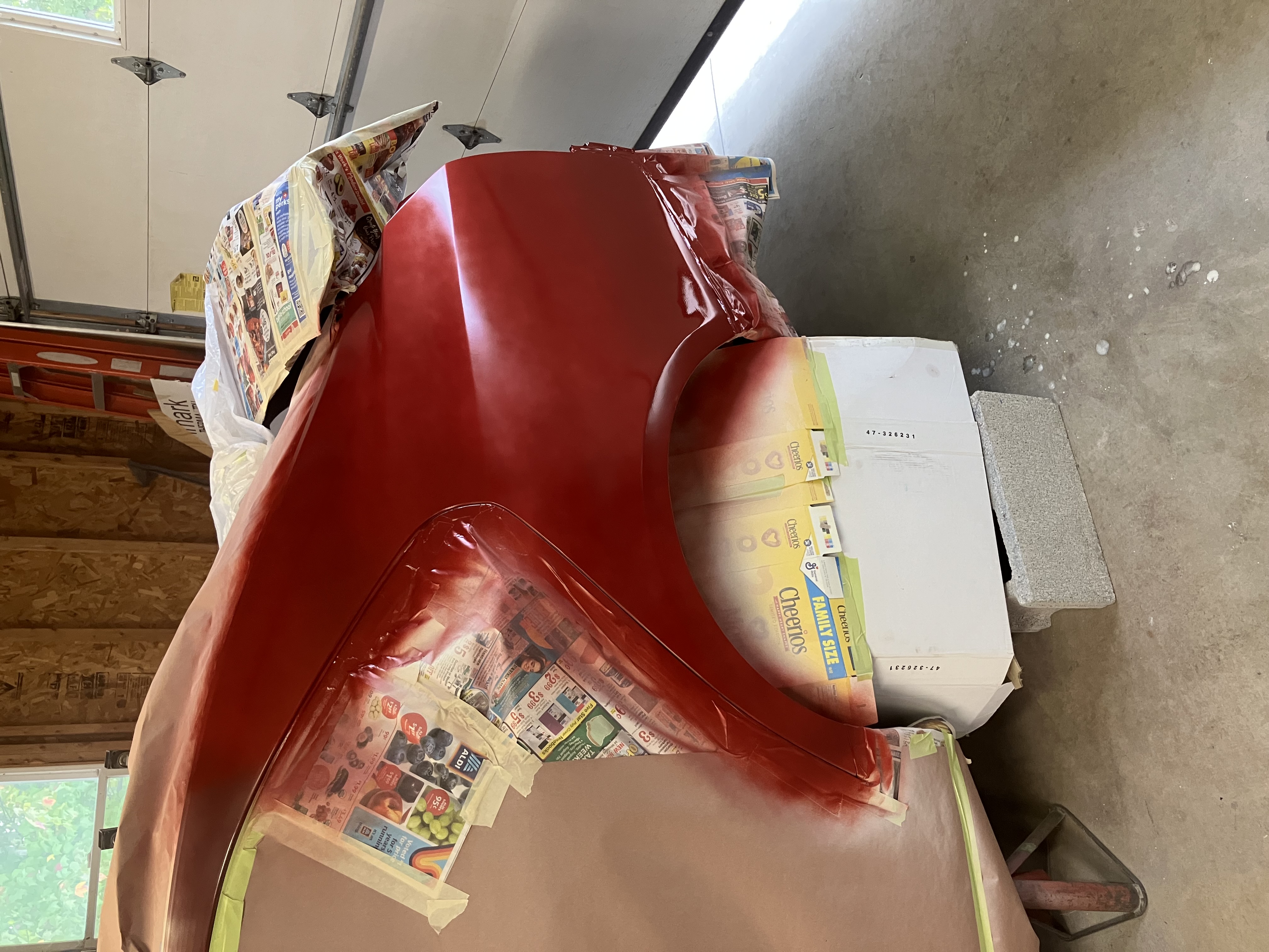

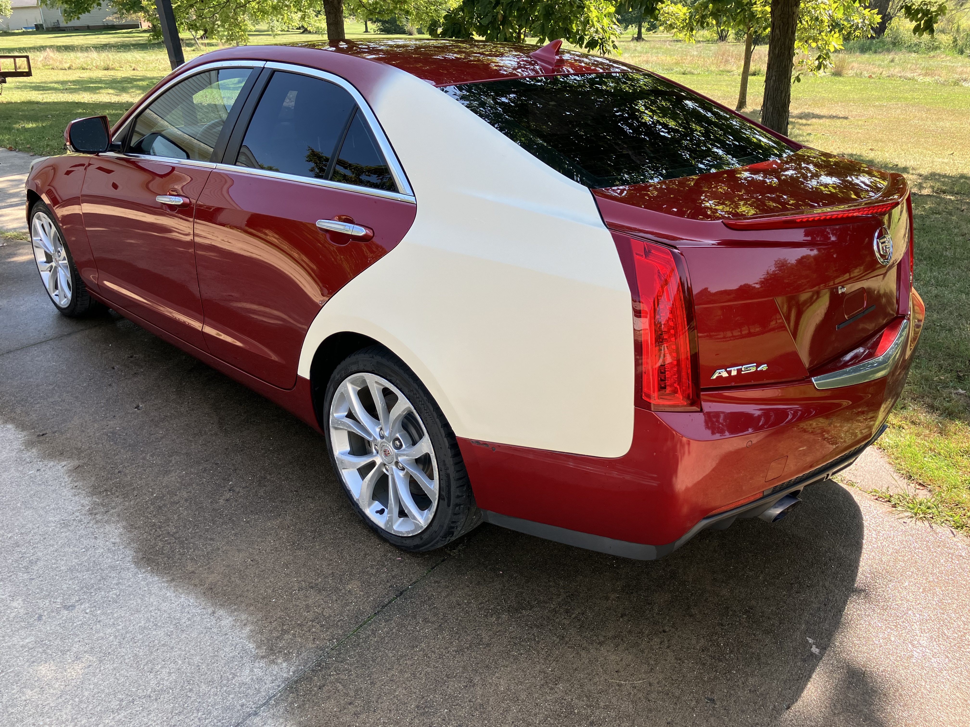

Finished up the bodywork and painted the LR quarter panel.
Took the buffer to the scuffed up areas on the bumper cover, and applied touch up to them and a few other nicks on the car - base, mid coat and clear. Also did a little straightening on the LF fender.
Cleaned up some of the overspray on the car. I covered every inch of the car I was not painting with paper or plastic but there were some gaps where it still got in. So confusing. Anyway the buffing compound I had to clean up imperfections took it off with relative ease. Still some spots to go but I have the technique.

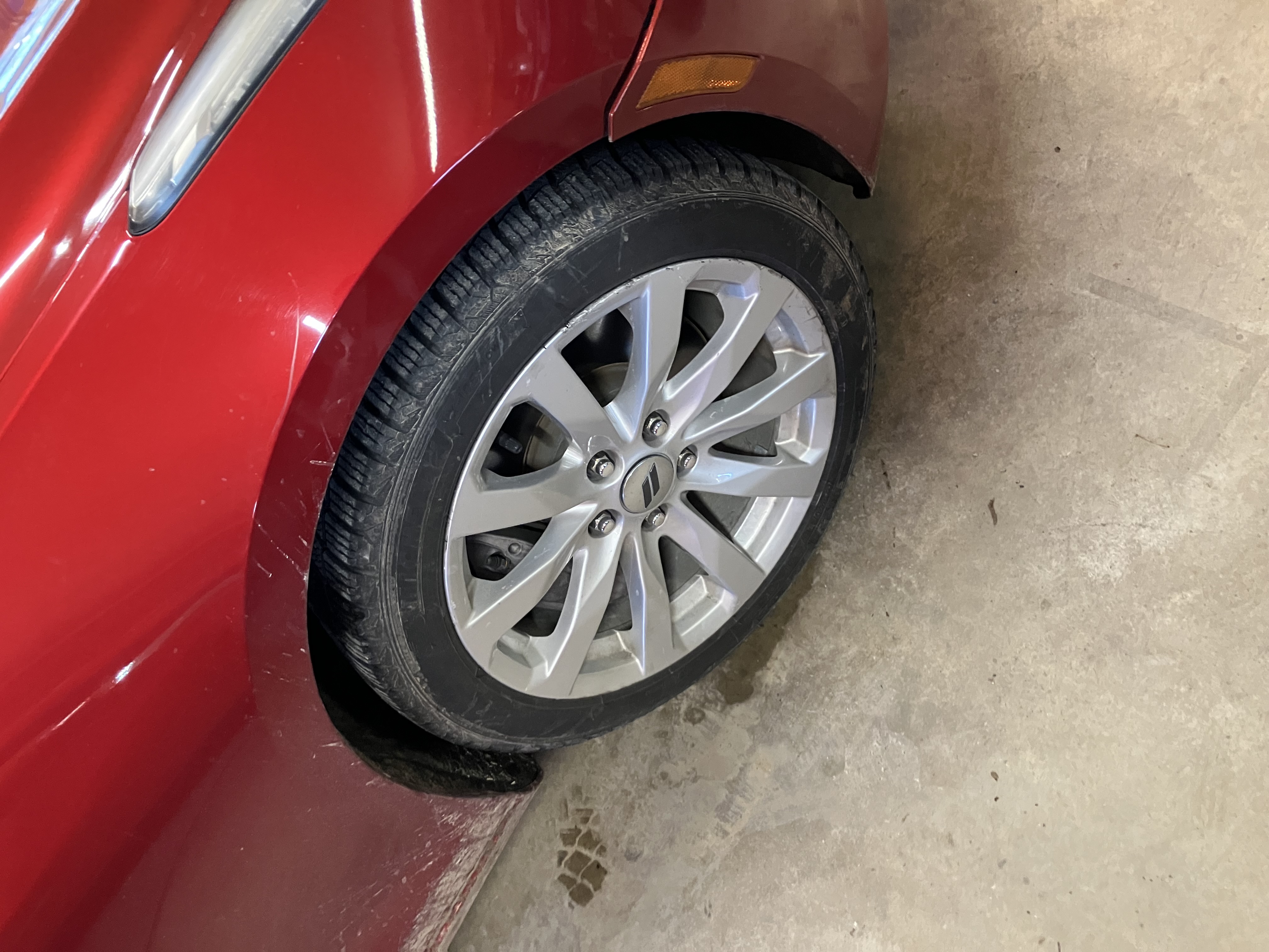

Obtained a set of Firehawk Indy 500's on sale and had them mounted and balanced.
Driving uncovered a failing LF hub, which I have subsequently replaced.

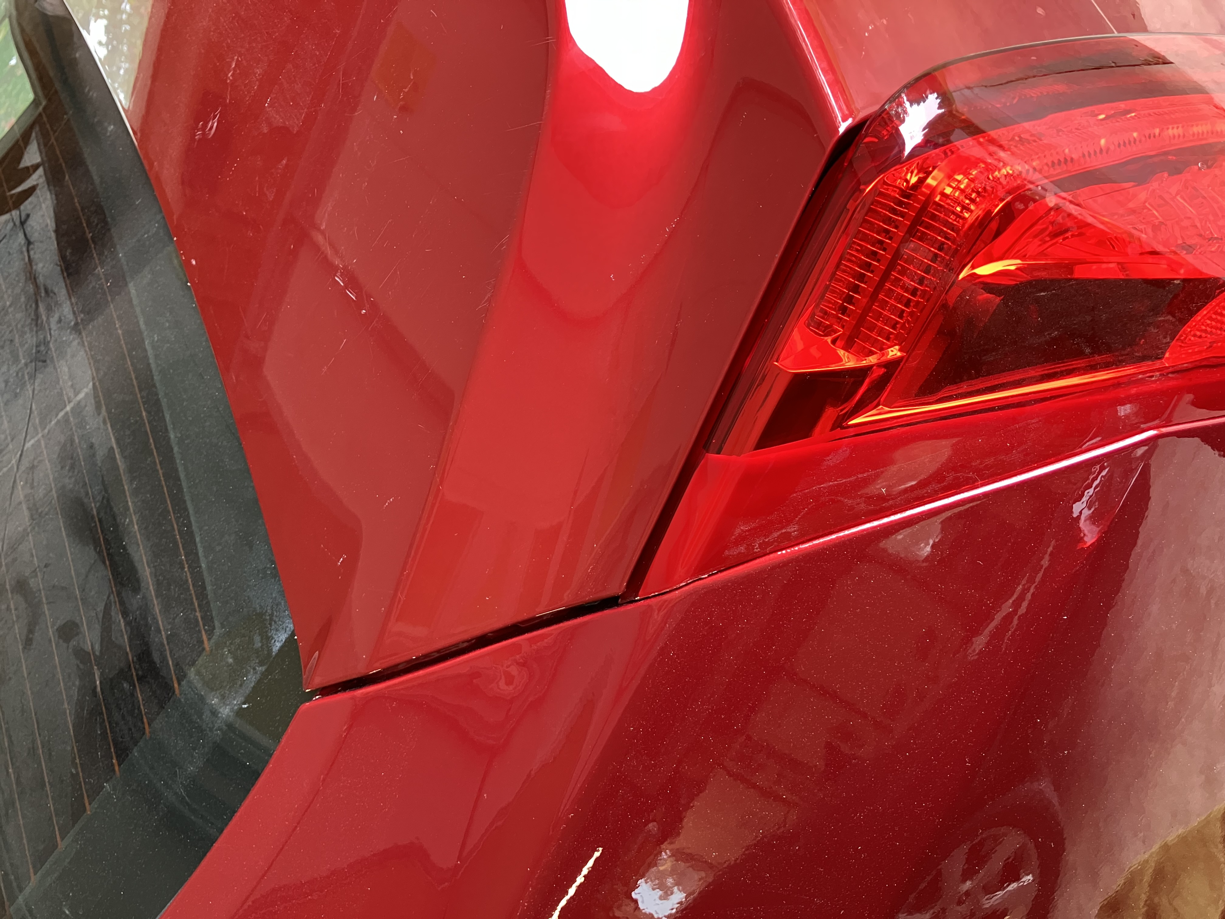

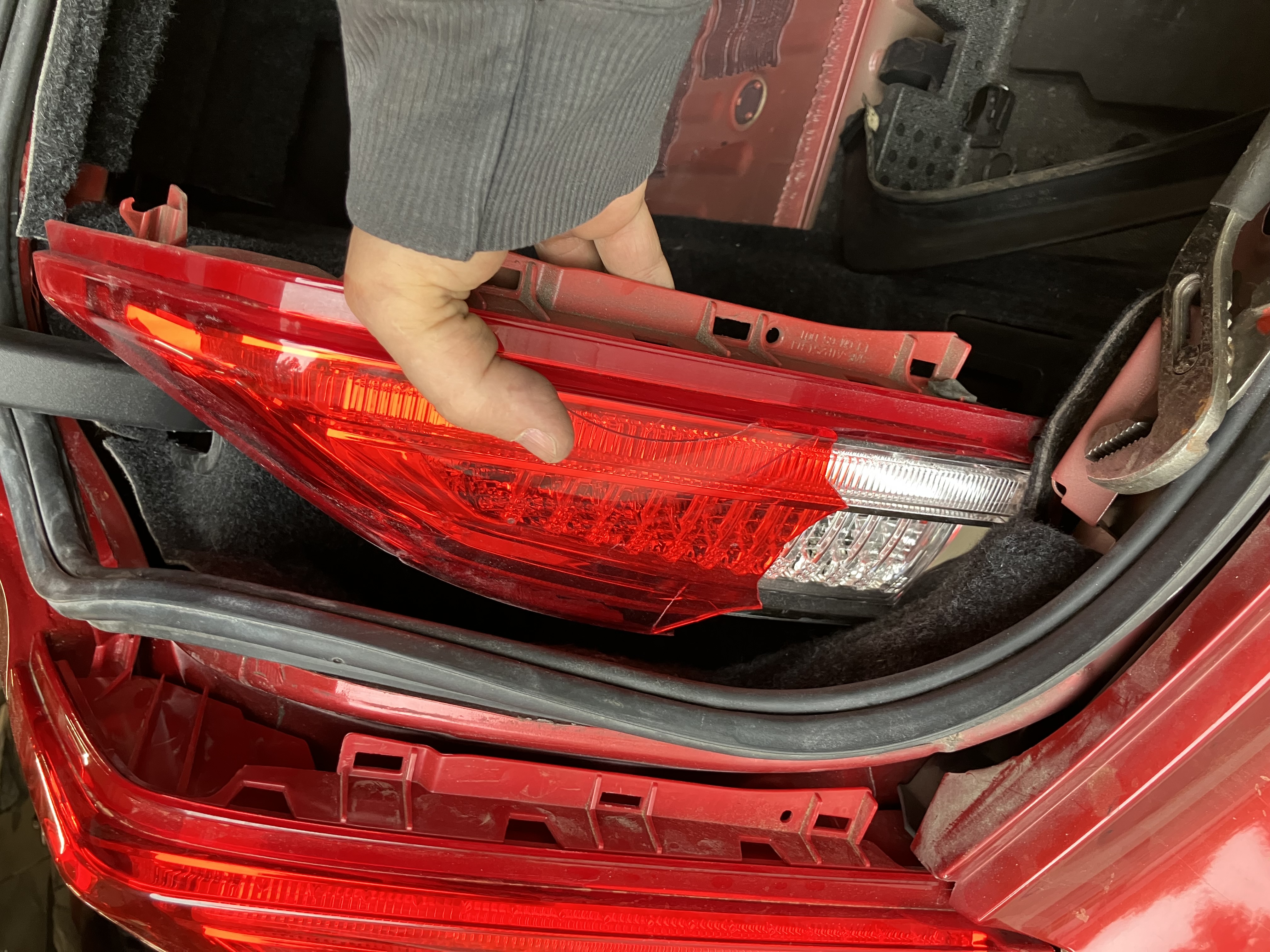

The taillight required a hole to be drilled to fit.  Must have changed the alignment pin location between model years
Trunk does not line up right with the quarter.  I think the trunk needs adjusted down

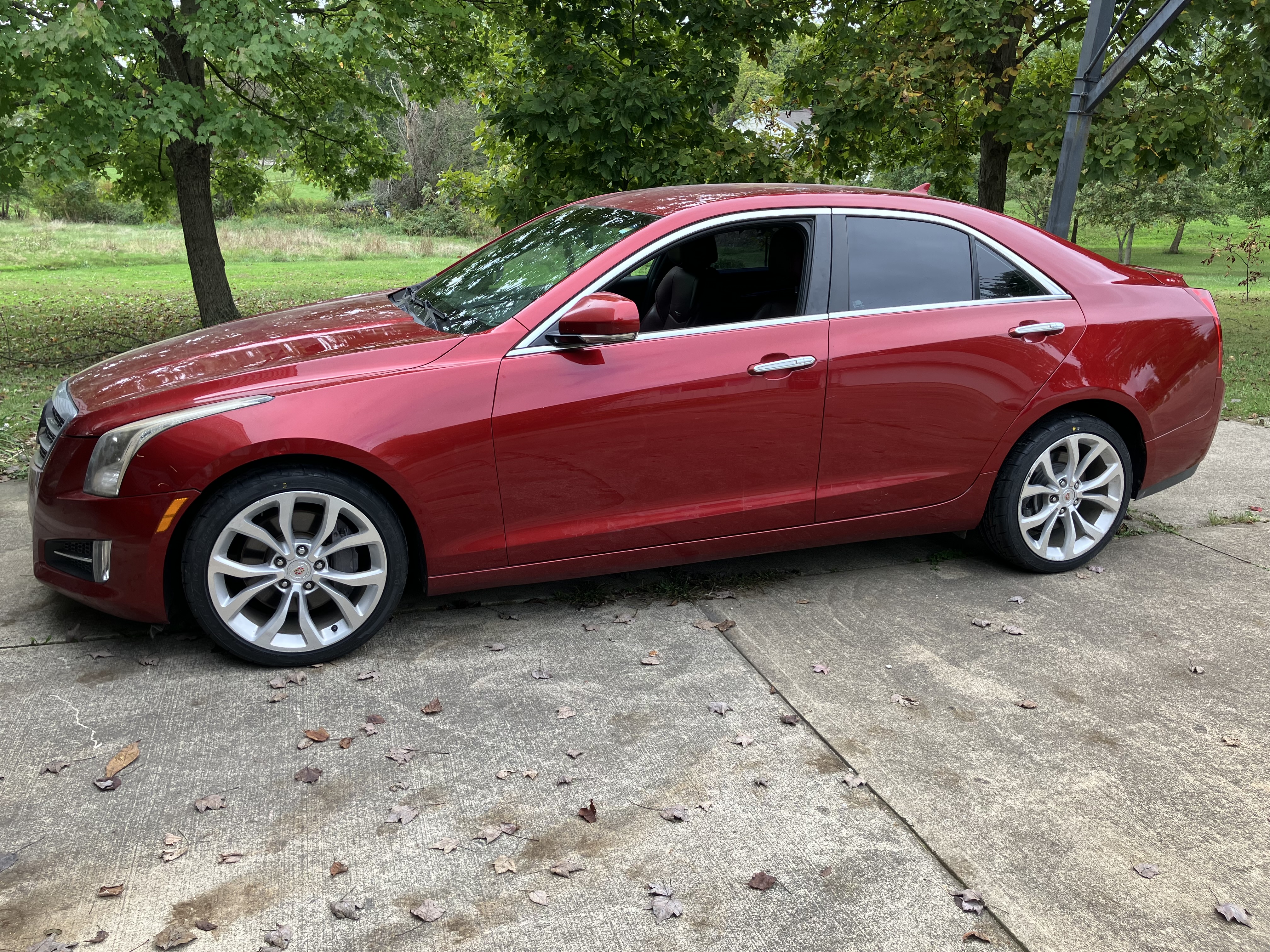

Here’s a little better after pic - compare to the pic in the first post

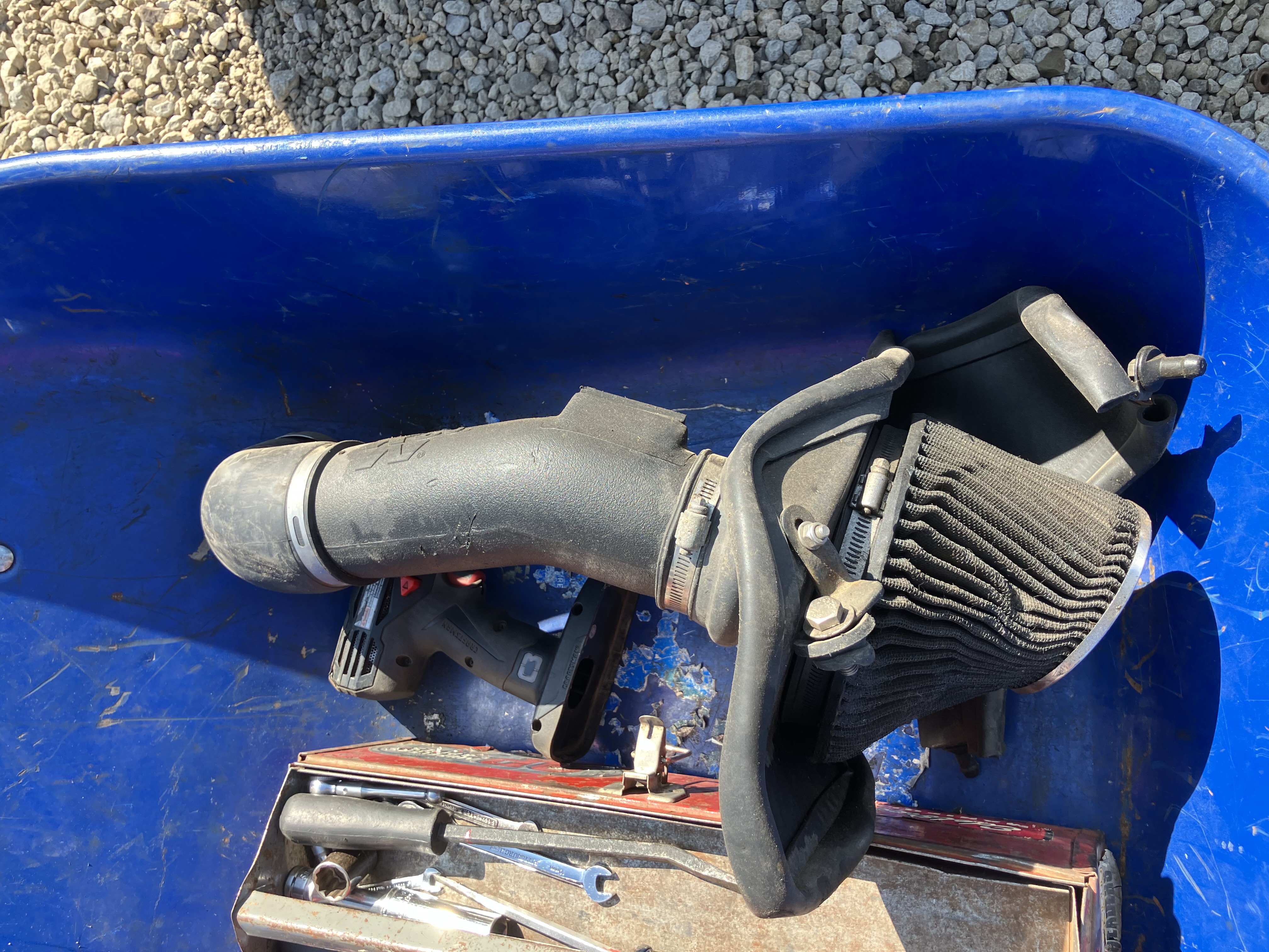

Installed my K&N before the second trip to the track. This required some straightening and the PCV vent hose needed some customization since the adapter that came with the kit was broken in the crash from the donor car. Immediately I noticed a slight shudder under light part throttle lower RPM conditions. I tried swapping the MAF with the black car but the effect was the same, and the MAF from this car behaved fine in the black car. I'm going to put the stock air filter back in and see if the problem persists.

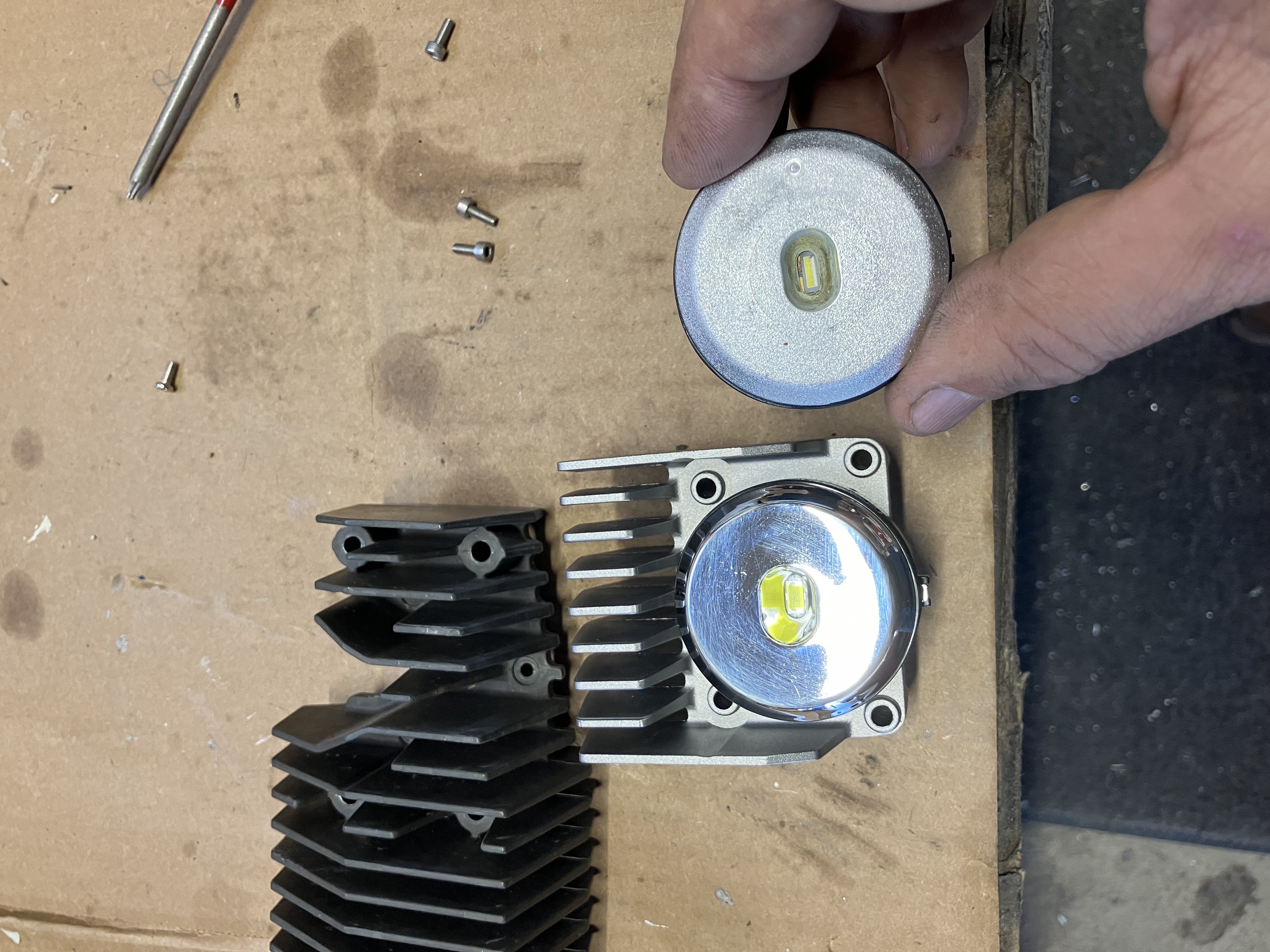

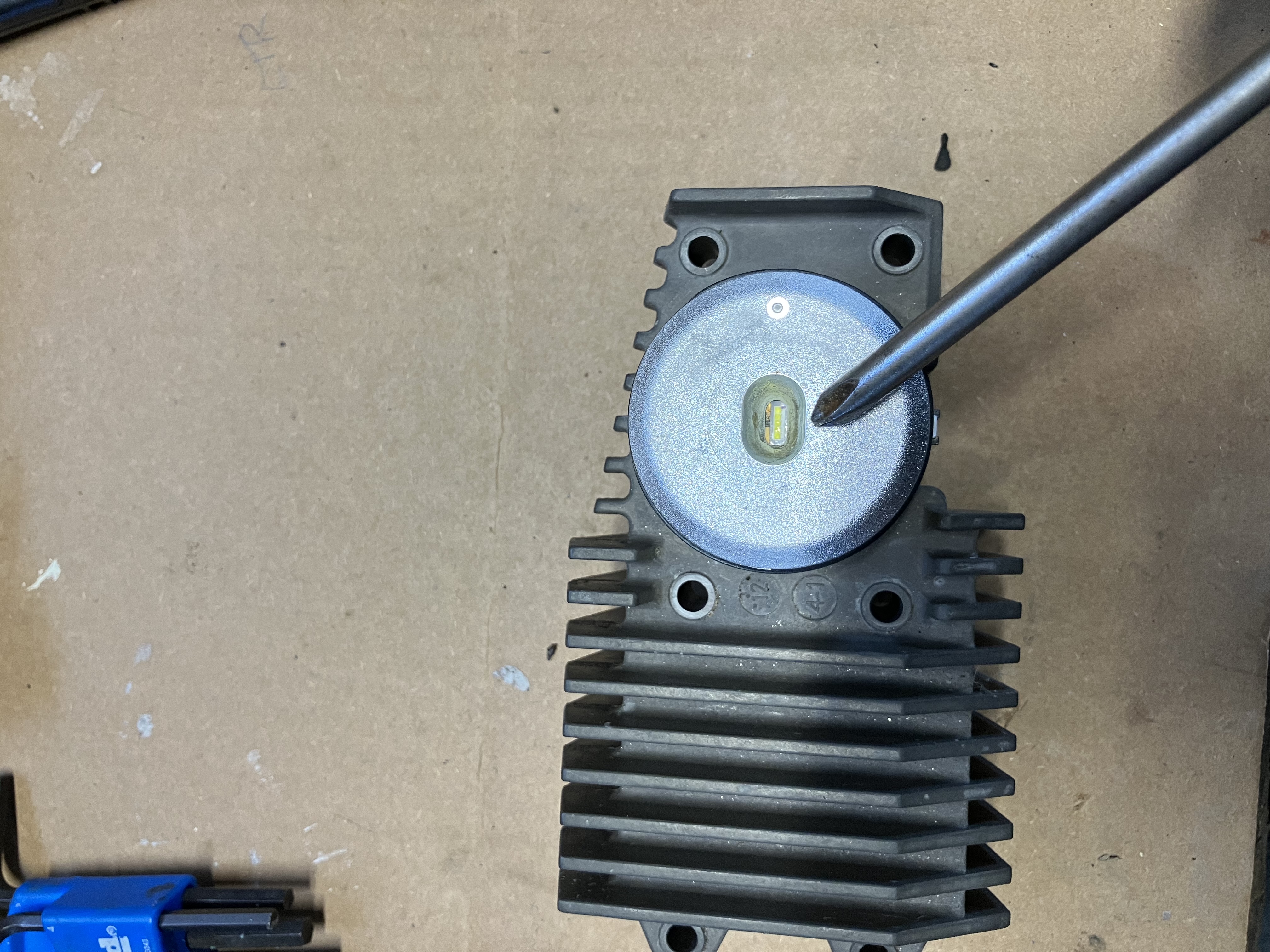

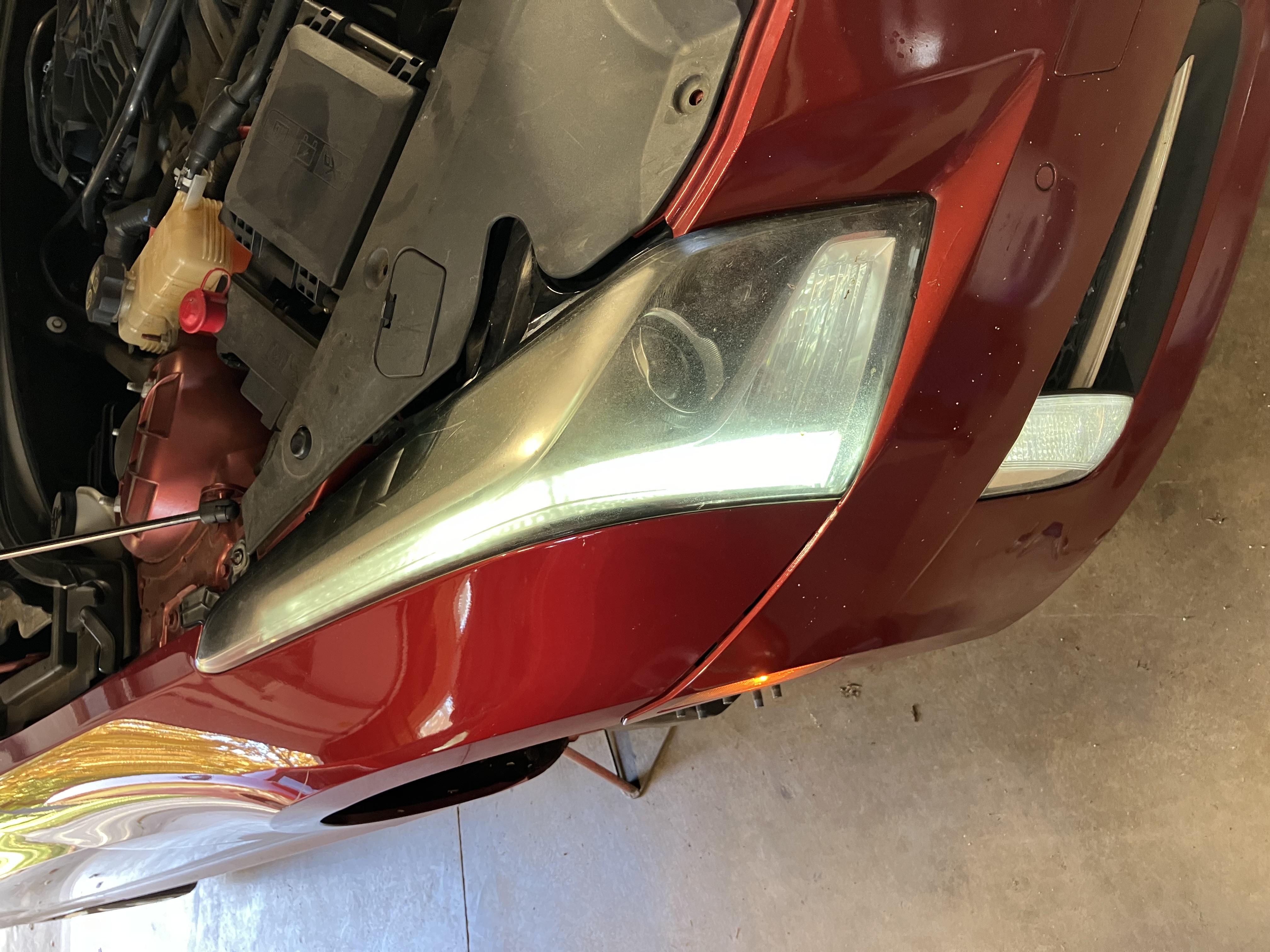

1) daytime running lamp inside the passenger side headlight was out
This is a long light that runs vertically inside the headlight. It's run by a single LED attached to a heat sync.
Removing it requires detaching the front half of the inner fender.
At first I thought the entire DRL assembly was required which was north of $200. After removing the unit I saw the LED itself had a separate part number, and that led me to a similar assembly for a Cadillac XTS. This part was about $25.

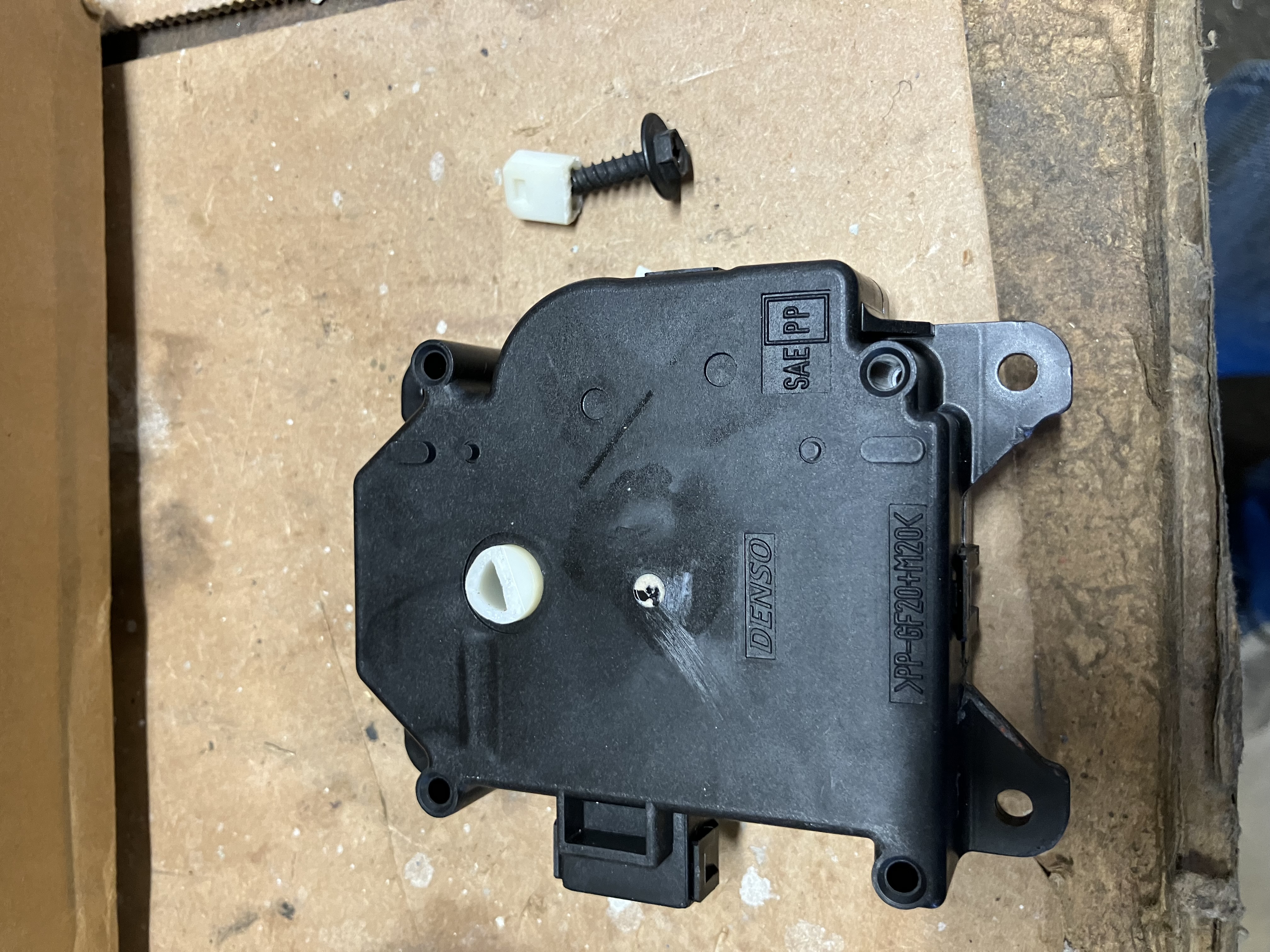

2) HVAC driver side door actuator was not working
This required some under dash disassembly, but with the help of YouTube it was pretty straightforward. The old actuator broke on the way out but I was able to extract the parts.

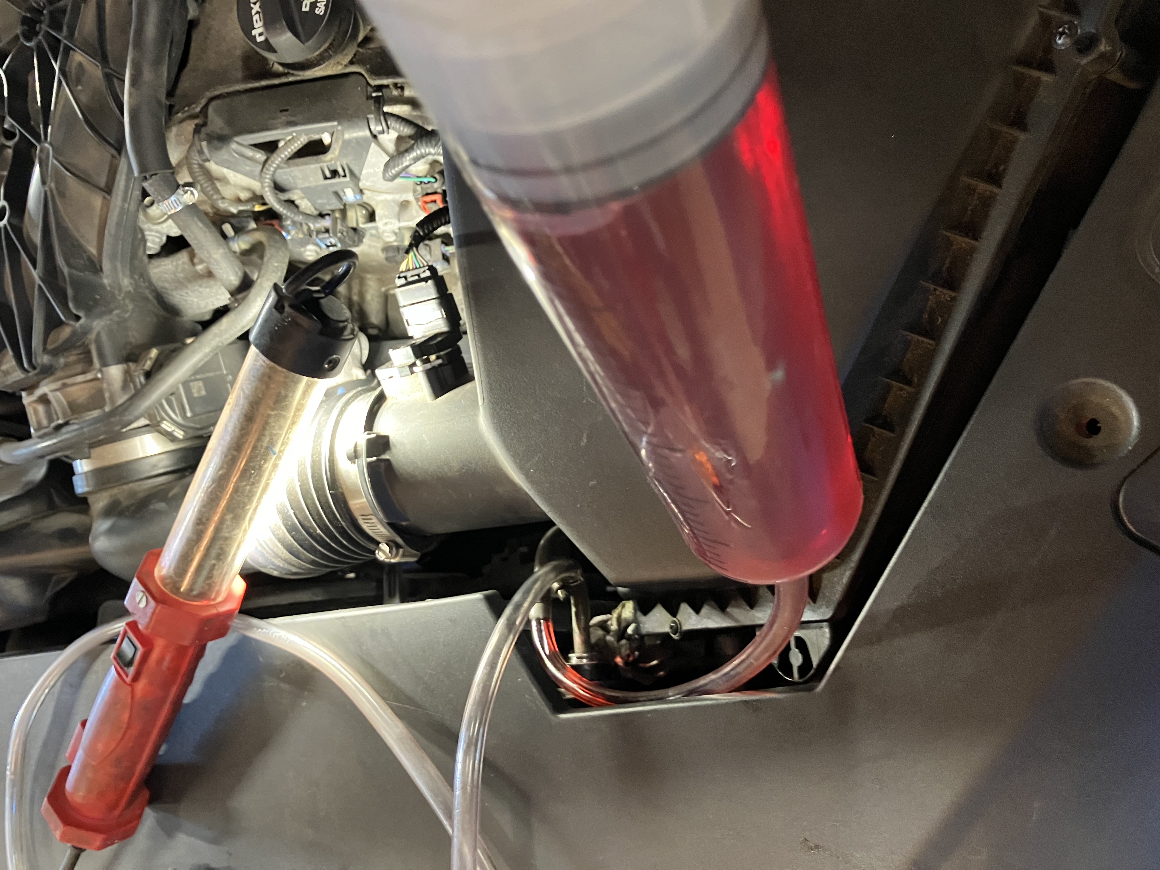

3) transmission fluid and filter change
Based on other owner experiences I'm fairly certain the shudder at low RPM low throttle conditions is caused by transmission fluid that needs changed. The maintenance interval on the transmission fluid is 100k, and this car has 120k.
The only big hassle in this process is the ATS has no dipstick, and the fill hole is on the driveshaft side of the transmission and there is very little room to access it. Filling this thing through that opening requires some kind of pump to push the fluid uphill into the transmission. In the process of draining I disconnected the transmission line from the top of the radiator, inserted a tube into the cooler and had the transmission pump out the first five quarts of fluid. The disconnected line is the return line to the transmission and this is what I used to put the fluid in. I used a big syringe and a tube connected to the return line to put almost 10 quarts of fluid into the transmission - would have been faster if I'd had a small pump. It took two sessions - about halfway in I stopped and ran the car to use the new fluid to push more of the old fluid out. To check fluid level the car has to be level (used a level on the bottom of the pan) and there is a bolt in the pan to remove while the car is running and trans fluid is 85-122 degrees.
Also - more evidence of damage from prior accident. It has part of an exhaust pipe replaced, dents in the oil pan and pieces of the transmission crossmember are broken off.

The transmission fluid change did not help the shudder that I think is from the transmission. More work to do to resolve this.
The vent actuator I changed on the driver side was the wrong one. The other one is showing signs of moving but the gears may be stripped out or I suppose it's possible someone changed it but didn't get it installed correctly. I have a replacement I just need time to install it.

The other HVAC controller motor has been installed, but it did not fix the problem. Changing the second one was a pain in the neck since it was on the inside of the main HVAC box. Luckily there is a side panel you can remove to access it, but then there are like 5 control points that need to be lined up to get these to work properly. It only took two tries.
I diagnosed this so poorly. Since the problem persisted after replacing both of these I had to go back to the drawing board. Well I tried put the temp up to "HI" instead of 75 or any specific temp and magically the driver side would produce heat like the passenger side. Turns out there is a temperature sensor (actually two of them I could see - one for floor and one for dash vents) that it uses to meter the amount of heat coming in. When it fails it must think the temp is max high so it puts out cold air. I'm still a bit confused as to when the A/C is on it was putting out warm air so maybe one of those controllers was bad after all. Anyway this part was like $6 and quite easy to change. Wish I had started there.

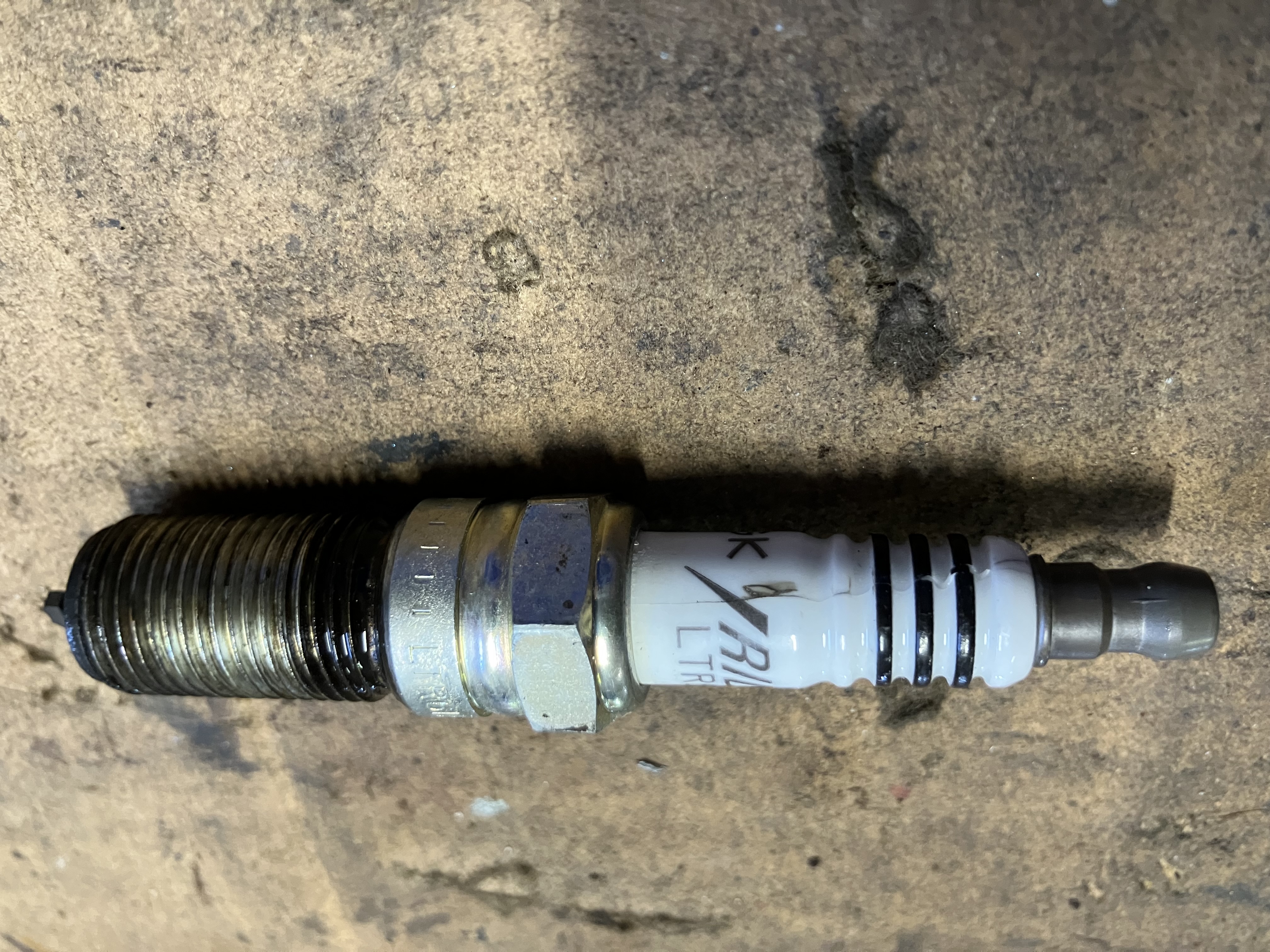

Started driving the red car regular and it rewarded me with a stumble and a flashing check engine light.
After some research on the P0300 (engine misfire) I started pulling spark plugs. The very first one had serious cracks in the porcelain. I swapped in a used leftover from the 2.0.
When I started work on the plugs I noticed the PCV line to the air cleaner was separated in the back. When I put in the K&N I am sure I knocked this hose off. The fit of the tube in the hose is not very snug - but the test drive confirmed that this fixed the shudder during shifting. Also the misfire seems to be resolved.

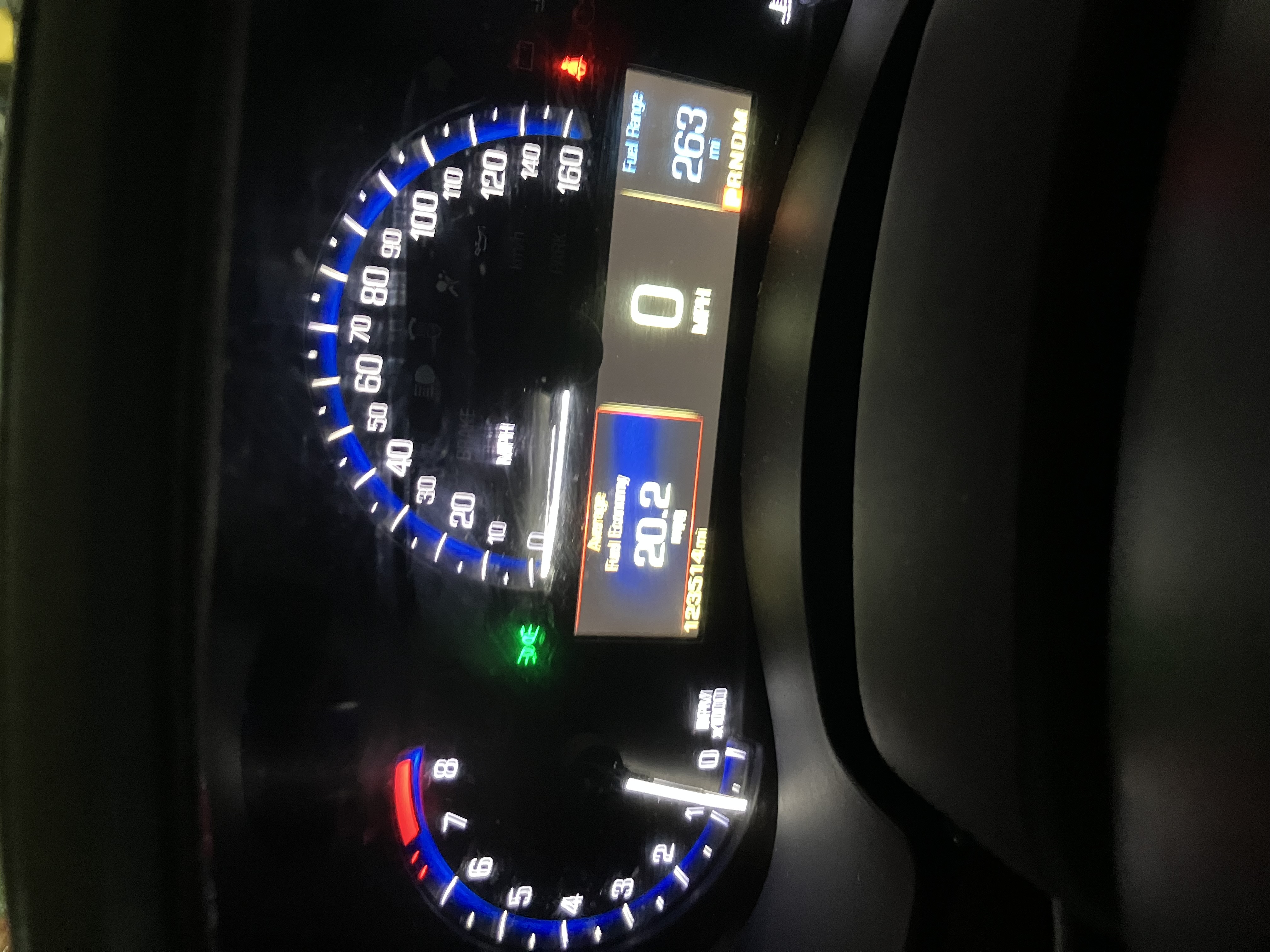

One thing I noticed recently is that the average MPG on the Challenger is 21.9 and average mileage on this car is 20.2. The average speed on this car is 21.7 mph. I noticed this a few weeks back and the numbers are not changing. Admittedly I don't drive that much, but my average speed in the Corolla was mid 30's mph. My guess is the ATS has a long memory and this car did a lot of city driving or sitting and idling with its prior owner so it's going to be a while before those numbers increase. I've put 1500 miles on this car but can't recall what the numbers were when it showed up. I had disconnected the battery during repairs so that does not reset these counters.
Also the one 2018 rim I have did not have a center cap, so I improvised.
Posts: 3610
Re: 2014 Cadillac ATS Premium 3.6 AWD - Mostmint #47
I would be pretty certain that buried in one of those menus is a reset for these things. I don't have a Cadillac, but every other car I've had with it had it with relatively easy access with only one or two buttons to get to that function.
I kinda like the Mopar hashes more than the Crest.
