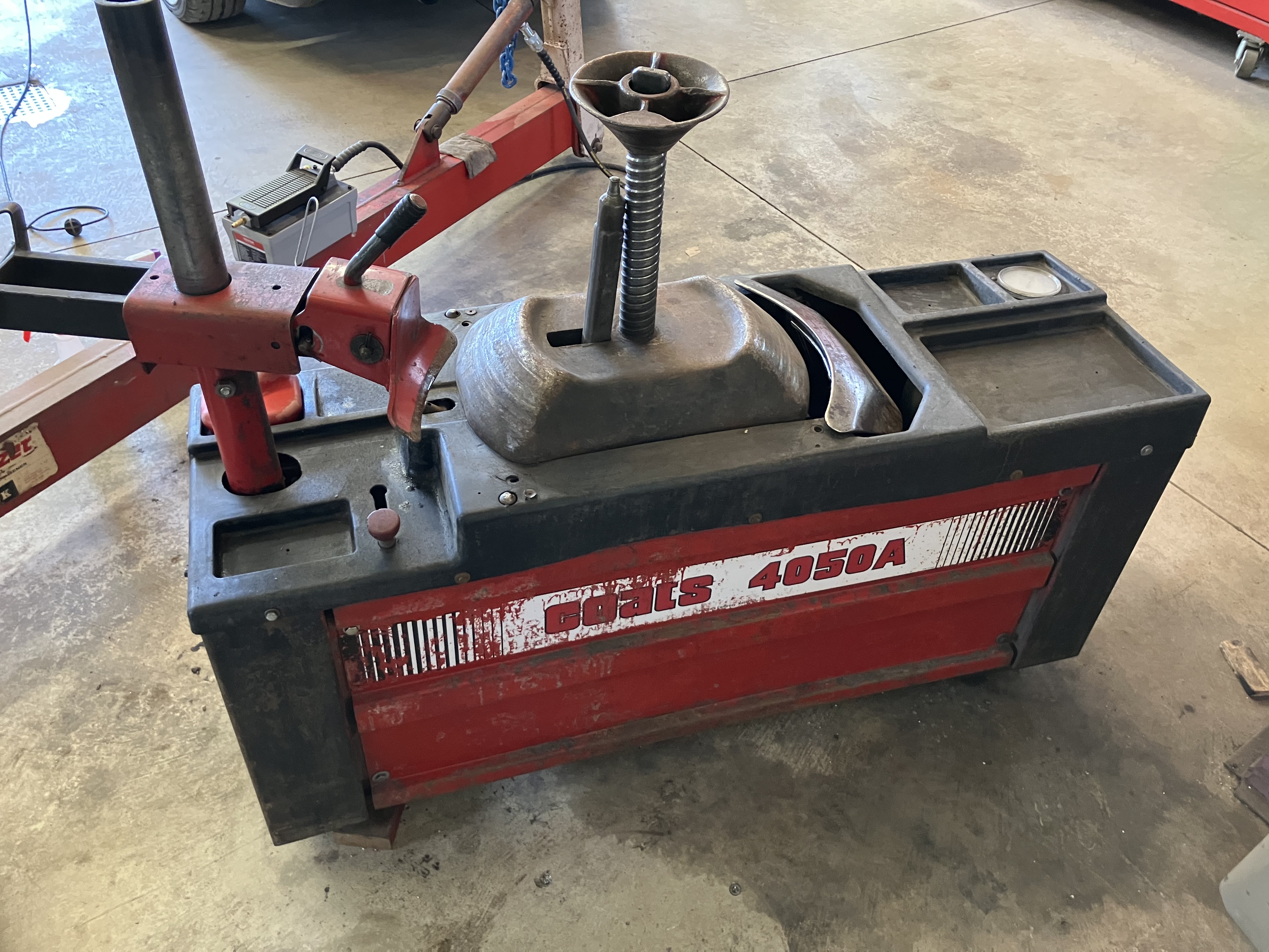

The machine is a Coats 4050A. Best I can tell it was made in 1995. I’m not sure where I got this information but I’ve been under the impression the max rim size is 17”. It has never had any issues with rims up to 9.5” width.
I was only in this latest project that I learned the model number, and acquired owner manual. To my surprise it does not specify the range of rims that can fit on this machine. It did provide a lot of very helpful info – more on that coming up.
In practice I’ve used it for 15-17” rims. It works well on steel wheels. To work well on aluminum rims it needs plastic guards on the bead/debead lever or count on scratches, or in some cases, gouges in the outside edge of the rim.

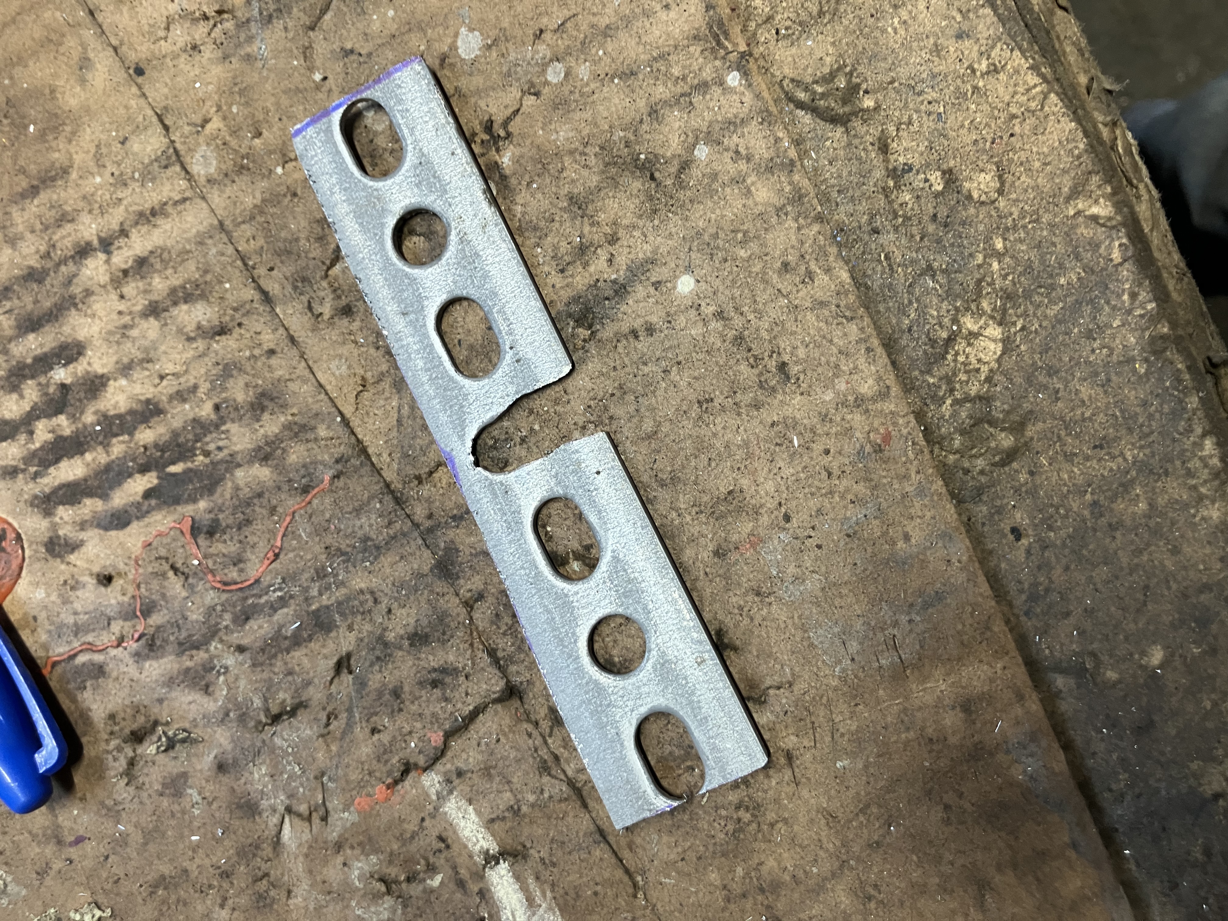

The damage to the machine was on the brace that helps break the lower bead. It’s a two part and the lower part got caught on the rim and bent down a corner. To fix it I had to remove the side covers, remove this part from the machine, and do some straightening on the vice. I tried putting heat to it but still managed to crack the metal. A quick trip to Kurt’s shop and that was welded up and back in business.

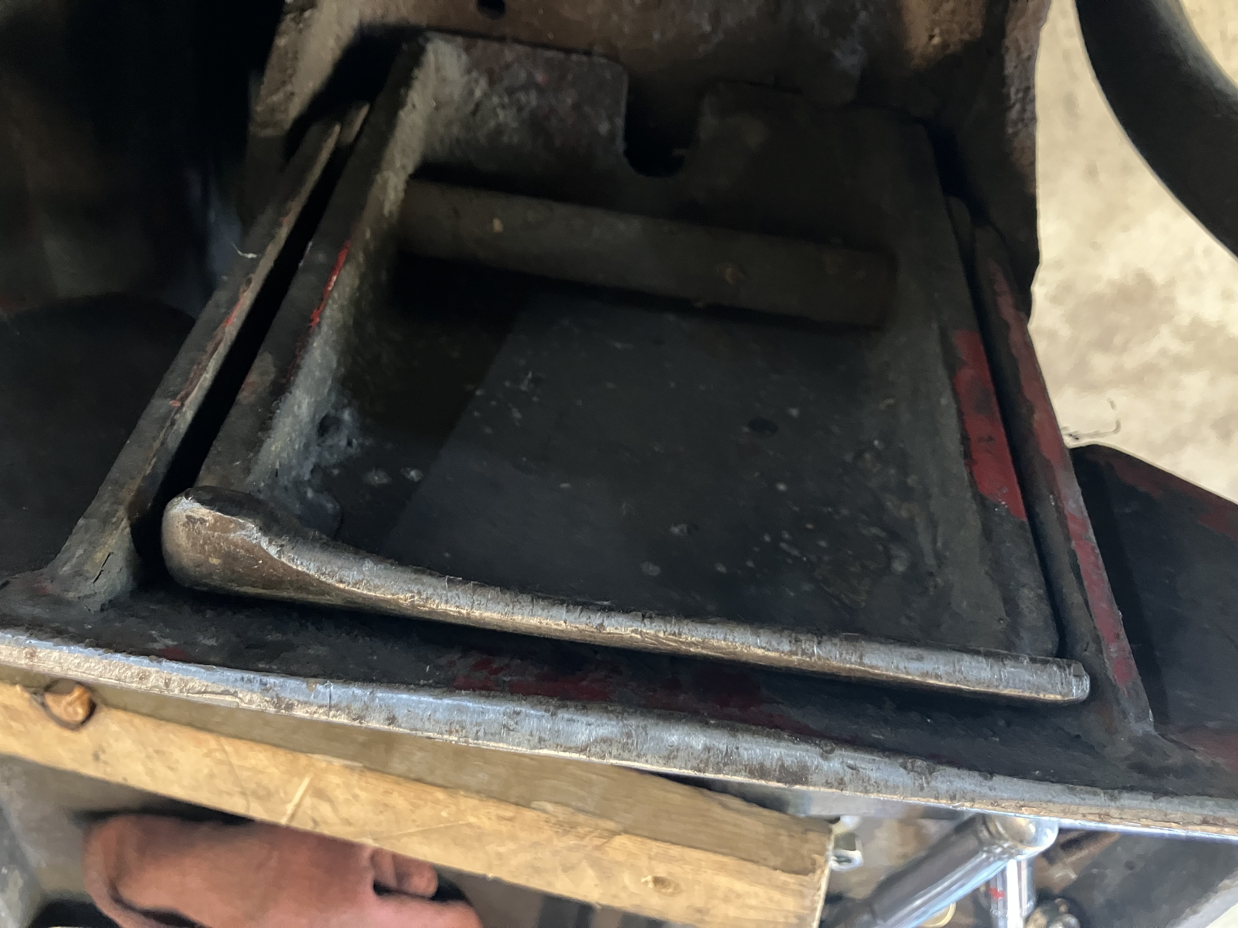

One big tidbit from the owner manual was how to adjust the lower debeader. Turns out that all those years of garage service it was out of adjustment. I was able to fabricate and add a shim to the mechanism to make the debeader clear the rim. The instructions said put a 15” rim on the machine and set it up with 1/8” clearance to the rim. It needed a 1/8” thick shim to meet this clearance.

At this point I’m probably way too invested in this project, but the entire time I can see this machine is filthy. Spent some time cleaning heavy caked on crap off the frame, hoses, tank and other internal parts. I’m not pressure washing or degreasing internals just cleaning them off with a scraper.
I also wanted to straighten the operators side panel, as it was interfering with the pedal operation. As I was working on that panel I decided to clean the side panels. These I tried some Windex but the grime just laughed more or less so I upgraded to Purple Power. With that stuff and a brush I cleaned a LOT of grime off the side panels. The other side panel had been painted, and it turns out the Purple Power was able to remove most of that paint as well, uncovering the original Coats decal.
Now that I’ve gotten this far into the rabbit hole, I cleaned up the end panels and the top with the same cleaning treatment.

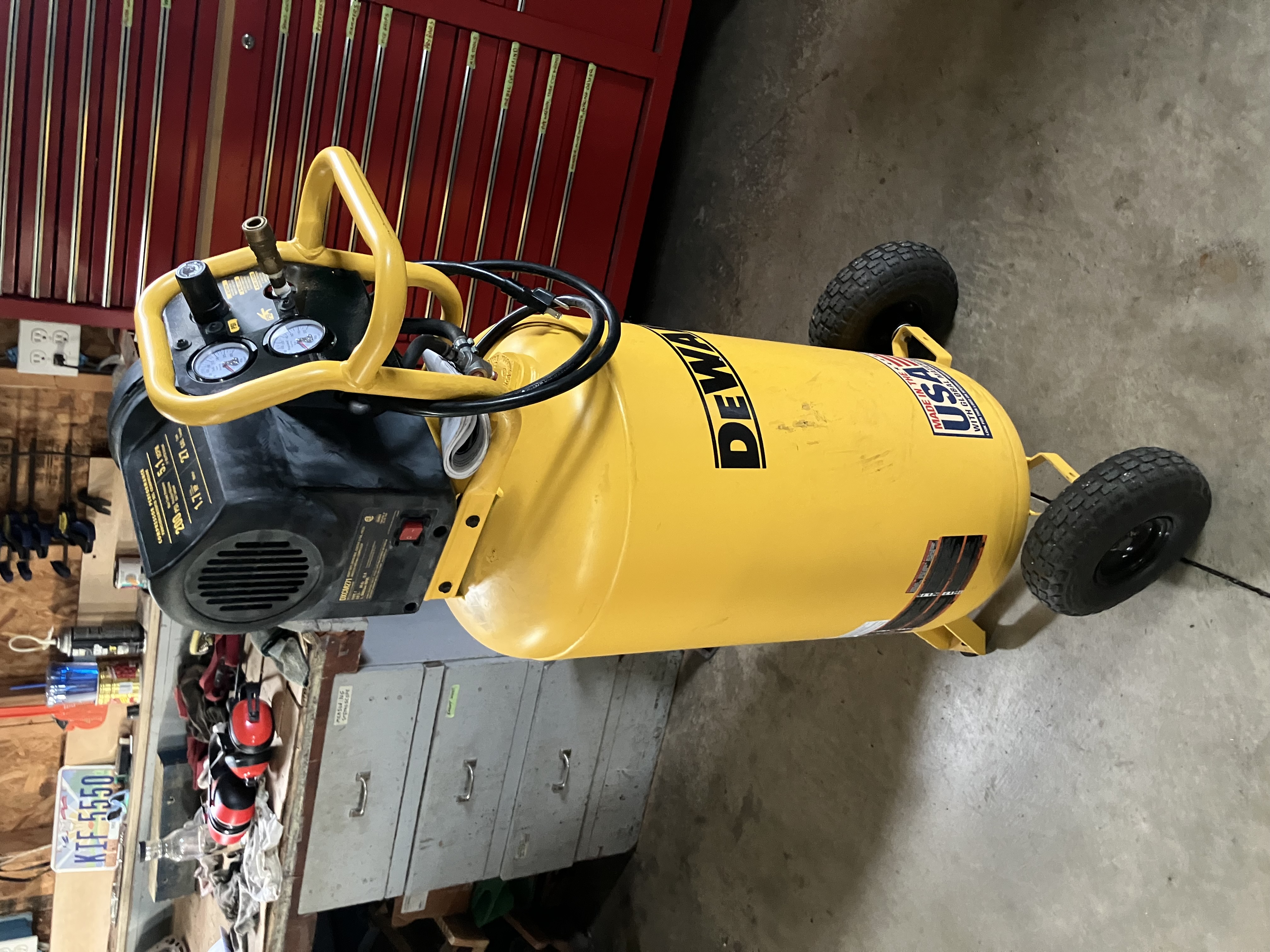

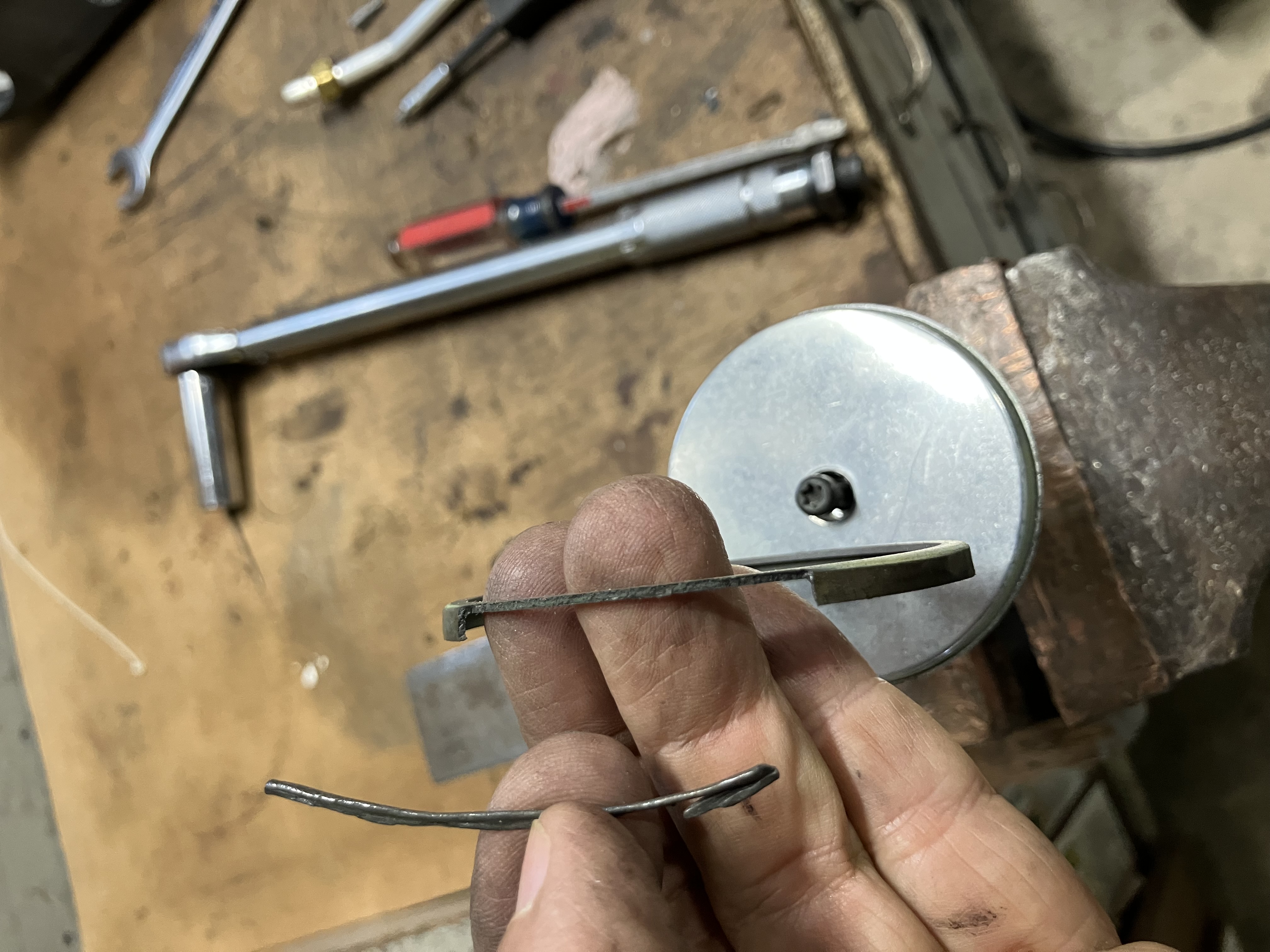

Here is what will be my first attempt at more air pressure

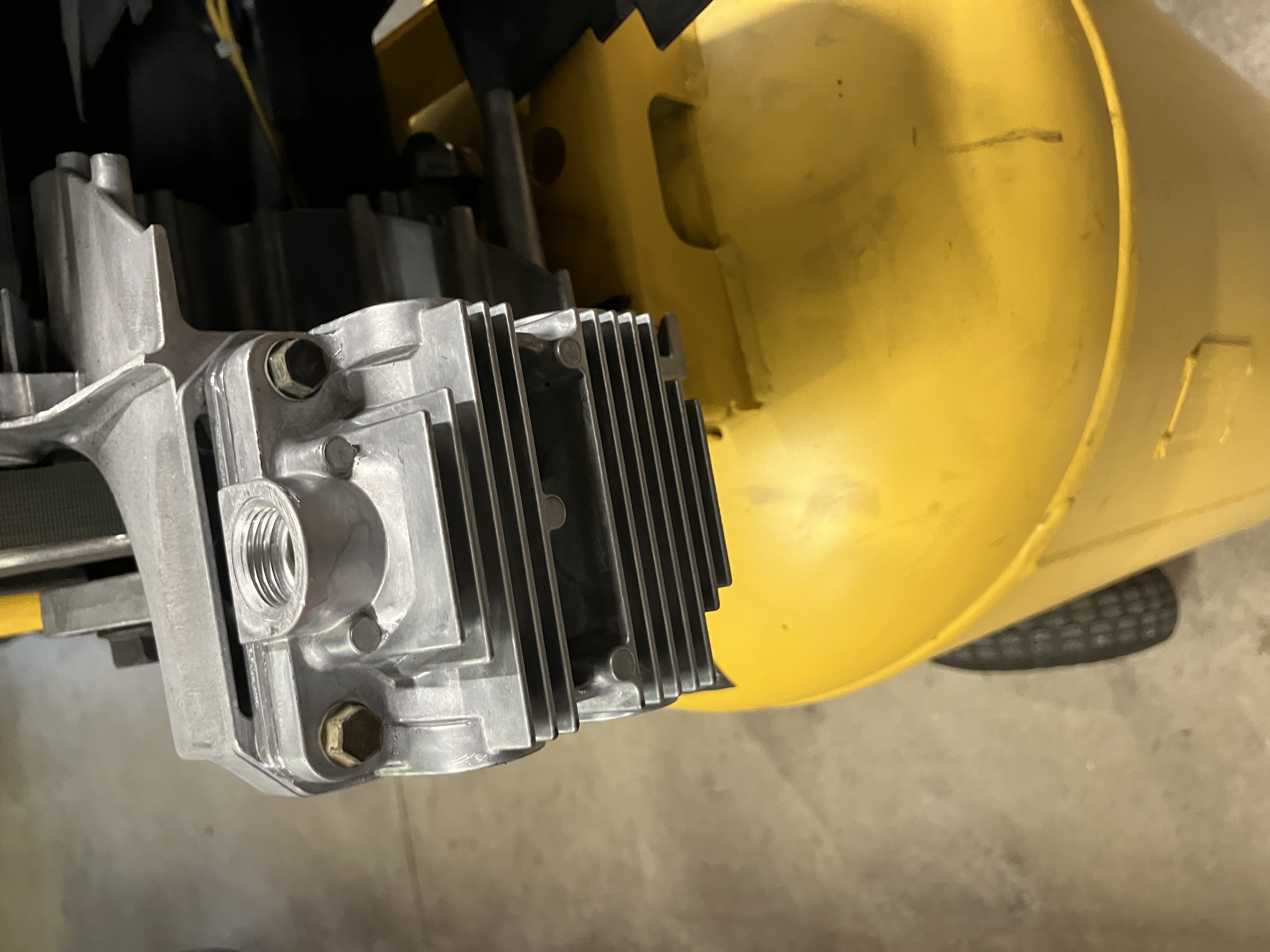

It's a DeWalt DXCM271 - made in 2021. Got it cheap since it would only build limited air pressure. New this is around $700 I paid $90. I was hoping pressure regulator was the problem, but turns out it has a bad seal in the compressor part. It's an oil-less machine and the "ring" is not metal its some type of flexible material and part of it just came off. Dewalt does not sell replacement components for the compressor part - it's all one unit. There is a kit with the rod, cylinder, piston and ring for about $60. I'm looking for a cheaper alternative to do this test so I have some replacement parts on the way.

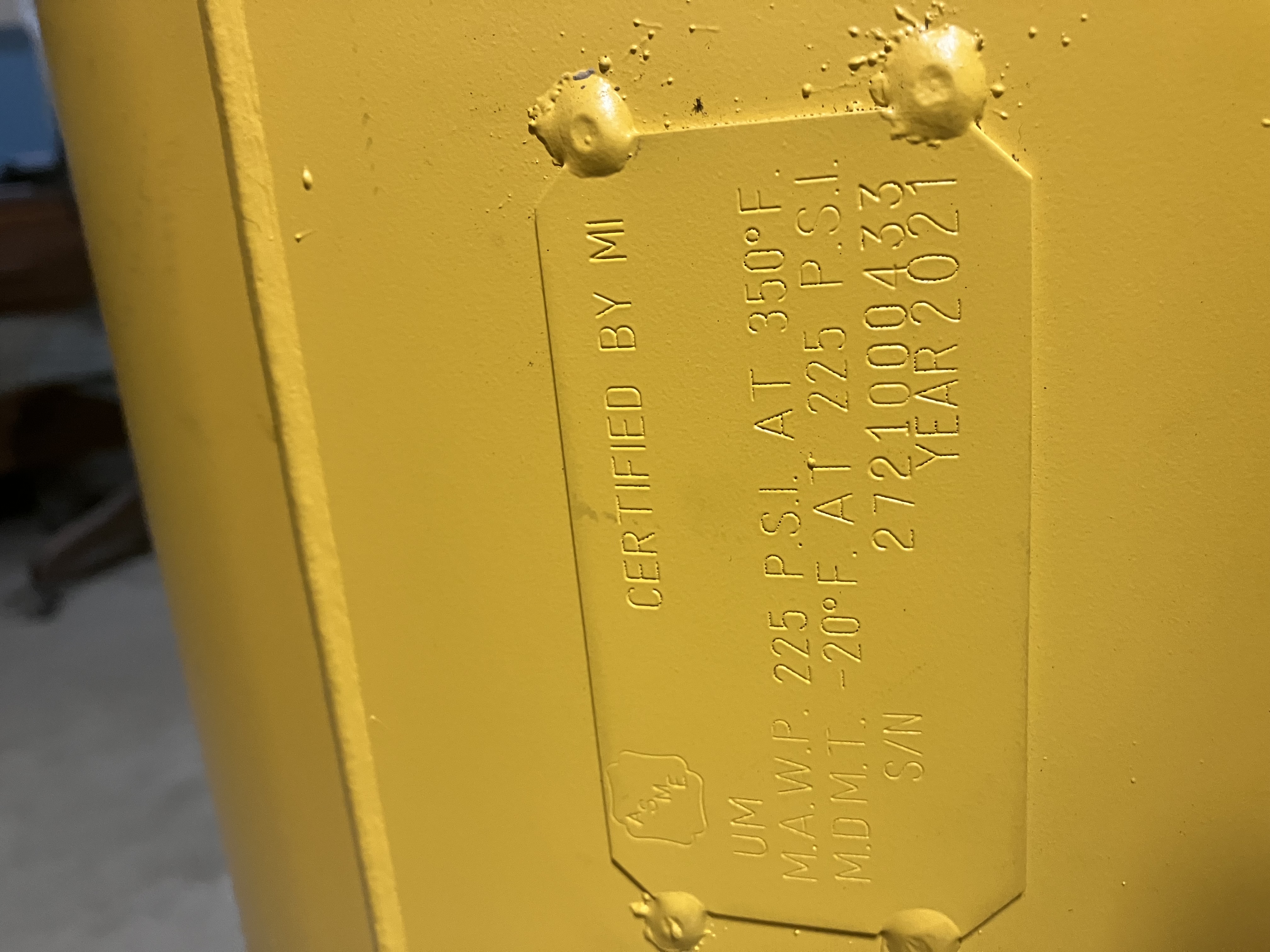

The unit says 200 PSI on it, but the tank is rated for 225 PSI. The regulator looks to be limited to 150 PSI - will cross that bridge once the bad ring is replaced. I can replace the regulator easy enough.
The Coats wants more volume than this compressor is capable of making. I suspect this is to support the air blaster function. Either way this will be an inexpensive way to find out. If the pressure really helps and I just need more horsepower I will look into upgrading the compressor/motor later.

For the high pressure DeWalt, I mixed up part #s somehow and the first ring was too small. The next attempt is a kit for a D55146 and D55167 - its a very similar style unit to what I have. It has 2 7/8" bore similar to this unit. This one has the ring, the bore and the gaskets.

Recently had a chance to use the Dewalt compressor with the tire machine. It does max out the output pressure at about 145 PSI. This helped give the machine more power, but I still want to get closer to the max pressure for the machine. I'll probably add another regulator out a side port so I can get up to 175 PSI.
