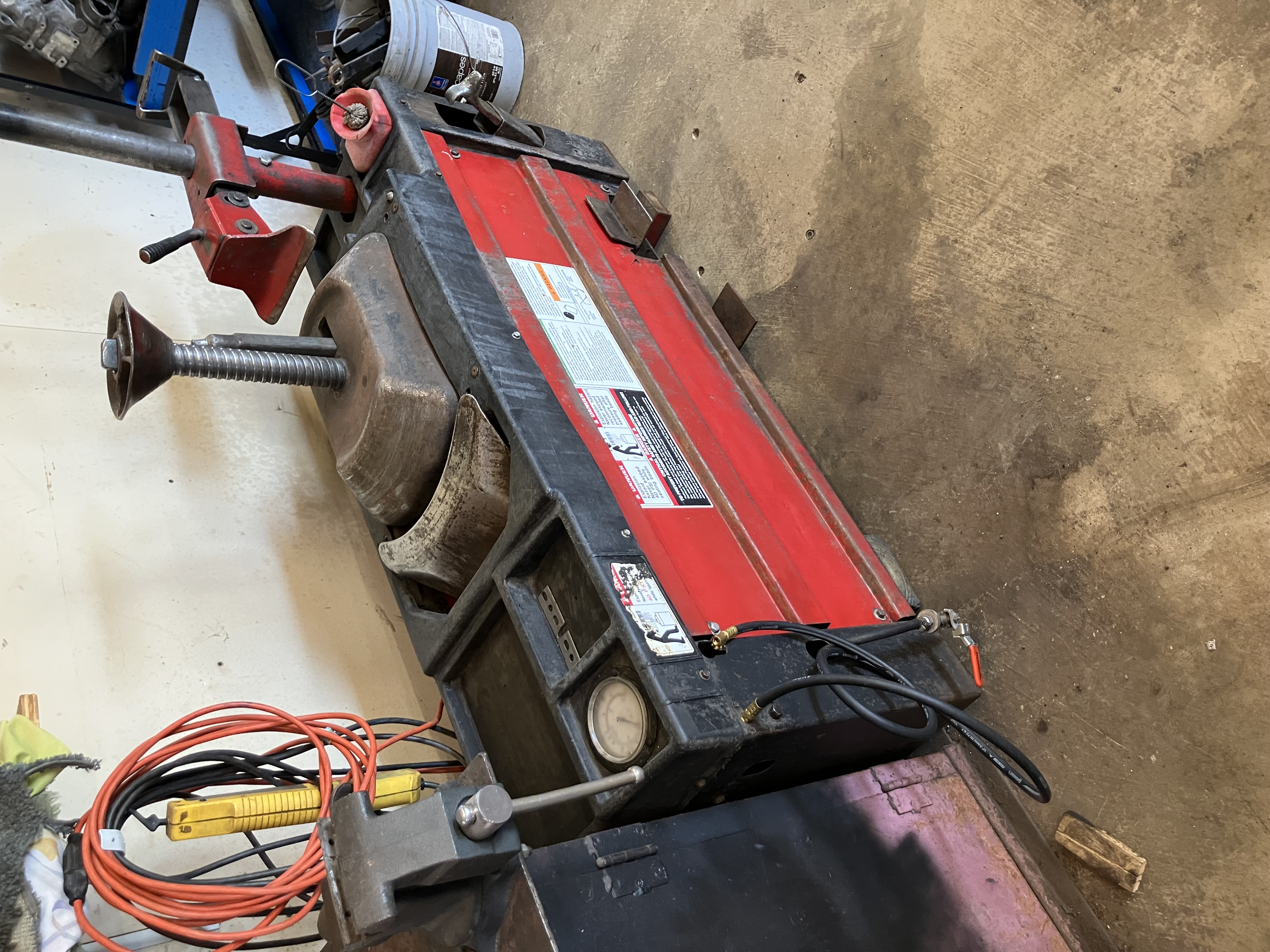

The machine is a Coats 4050A. Best I can tell it was made in 1995. I’m not sure where I got this information but I’ve been under the impression the max rim size is 17”. It has never had any issues with rims up to 9.5” width.
I was only in this latest project that I learned the model number, and acquired owner manual. To my surprise it does not specify the range of rims that can fit on this machine. It did provide a lot of very helpful info – more on that coming up.
In practice I’ve used it for 15-17” rims. It works well on steel wheels. To work well on aluminum rims it needs plastic guards on the bead/debead lever or count on scratches, or in some cases, gouges in the outside edge of the rim.

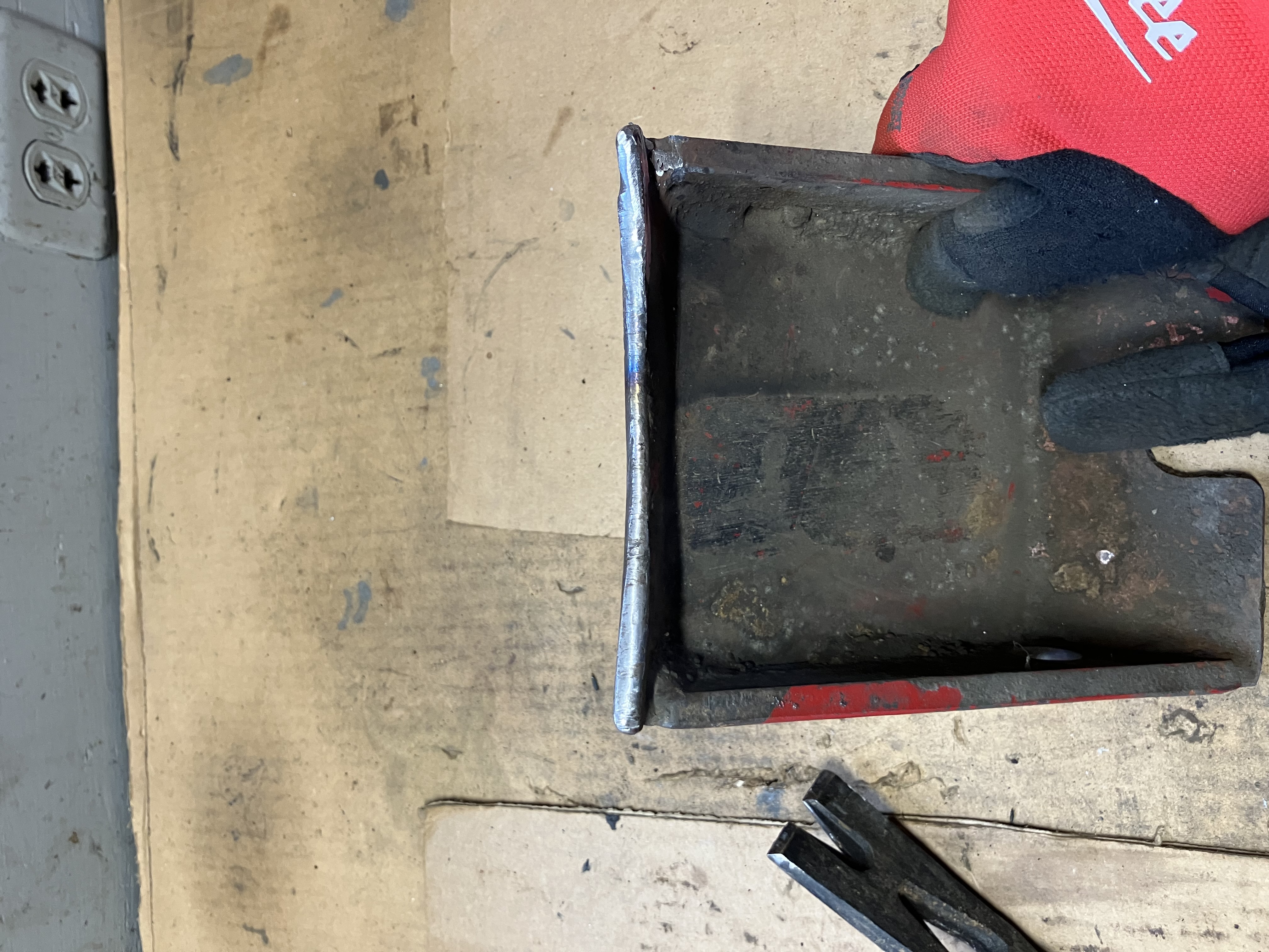

The damage to the machine was on the brace that helps break the lower bead. It’s a two part and the lower part got caught on the rim and bent down a corner. To fix it I had to remove the side covers, remove this part from the machine, and do some straightening on the vice. I tried putting heat to it but still managed to crack the metal. A quick trip to Kurt’s shop and that was welded up and back in business.

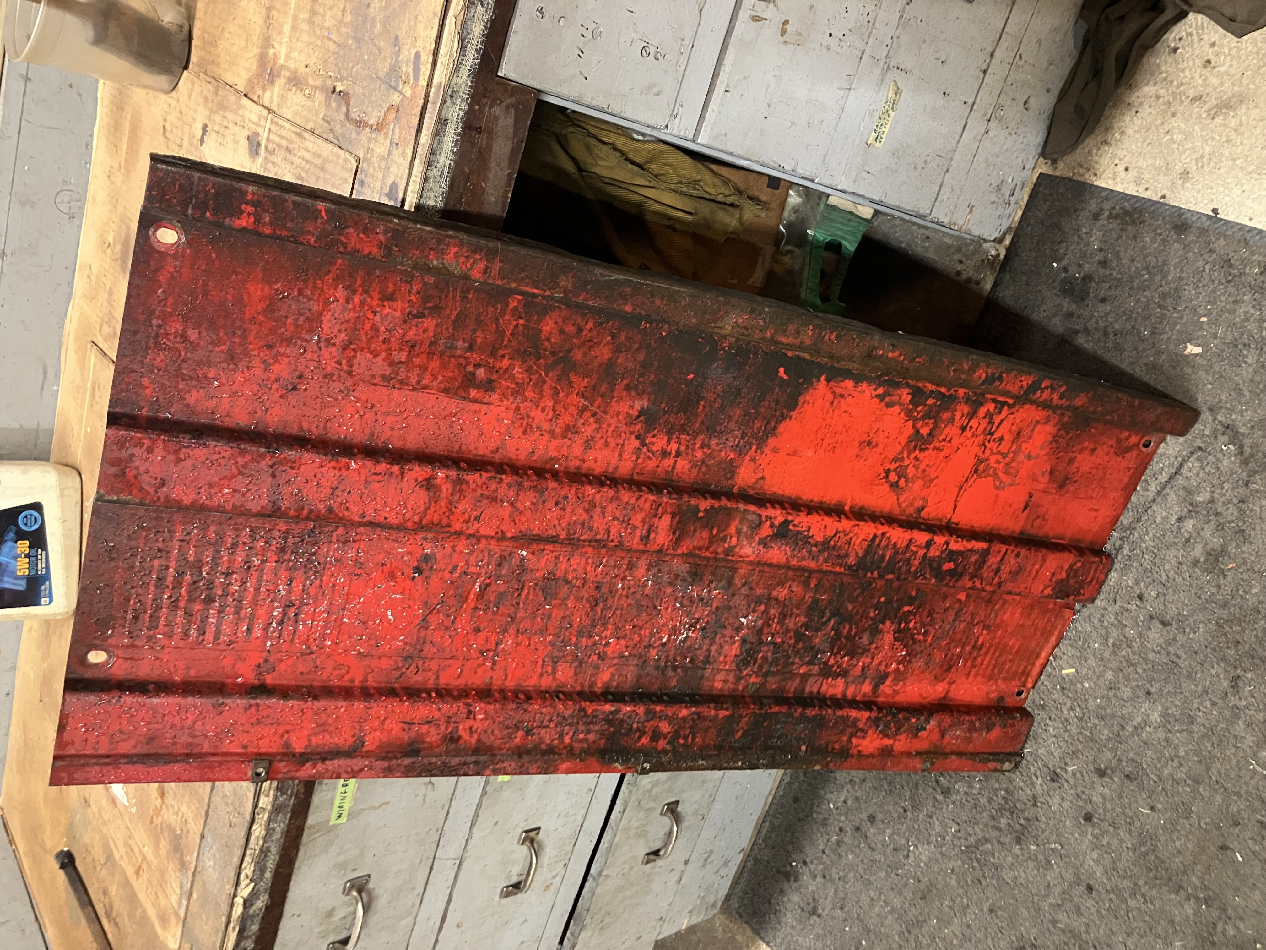

As it turns out all four exterior side panels were bent. They all got some attention, working to straighten them so they would fit on the machine correctly. Most of it was hammer and dolly, some vice grips, some work in the vise. I don’t know what they did to this machine but at least one of the supporting brackets also required straightening. About 1/3 of the attaching hardware was wrong or missing so I fixed that as well.

I also wanted to straighten the operators side panel, as it was interfering with the pedal operation. As I was working on that panel I decided to clean the side panels. These I tried some Windex but the grime just laughed more or less so I upgraded to Purple Power. With that stuff and a brush I cleaned a LOT of grime off the side panels. The other side panel had been painted, and it turns out the Purple Power was able to remove most of that paint as well, uncovering the original Coats decal.
Now that I’ve gotten this far into the rabbit hole, I cleaned up the end panels and the top with the same cleaning treatment.

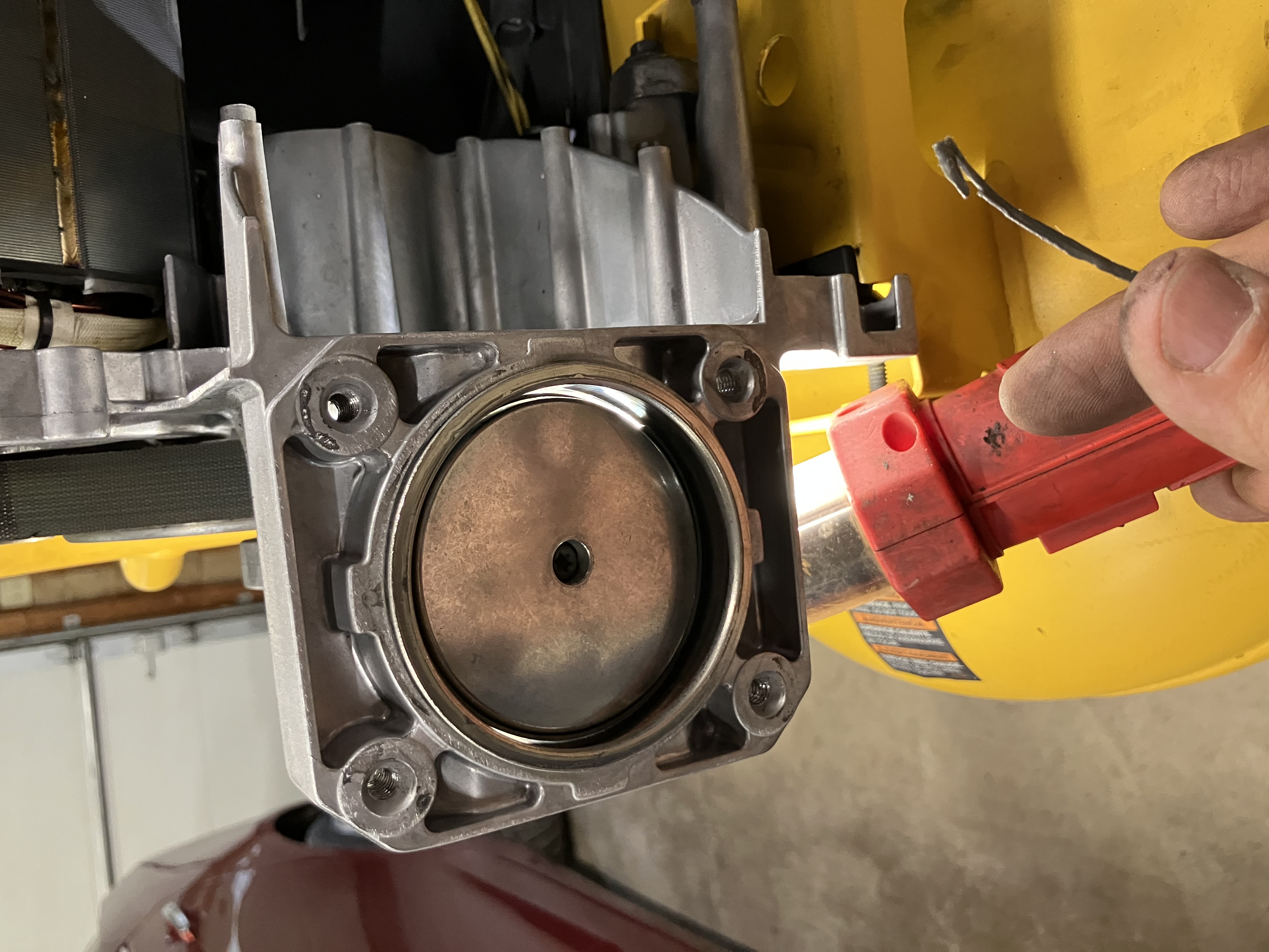

It's a DeWalt DXCM271 - made in 2021. Got it cheap since it would only build limited air pressure. New this is around $700 I paid $90. I was hoping pressure regulator was the problem, but turns out it has a bad seal in the compressor part. It's an oil-less machine and the "ring" is not metal its some type of flexible material and part of it just came off. Dewalt does not sell replacement components for the compressor part - it's all one unit. There is a kit with the rod, cylinder, piston and ring for about $60. I'm looking for a cheaper alternative to do this test so I have some replacement parts on the way.
The unit says 200 PSI on it, but the tank is rated for 225 PSI. The regulator looks to be limited to 150 PSI - will cross that bridge once the bad ring is replaced. I can replace the regulator easy enough.
