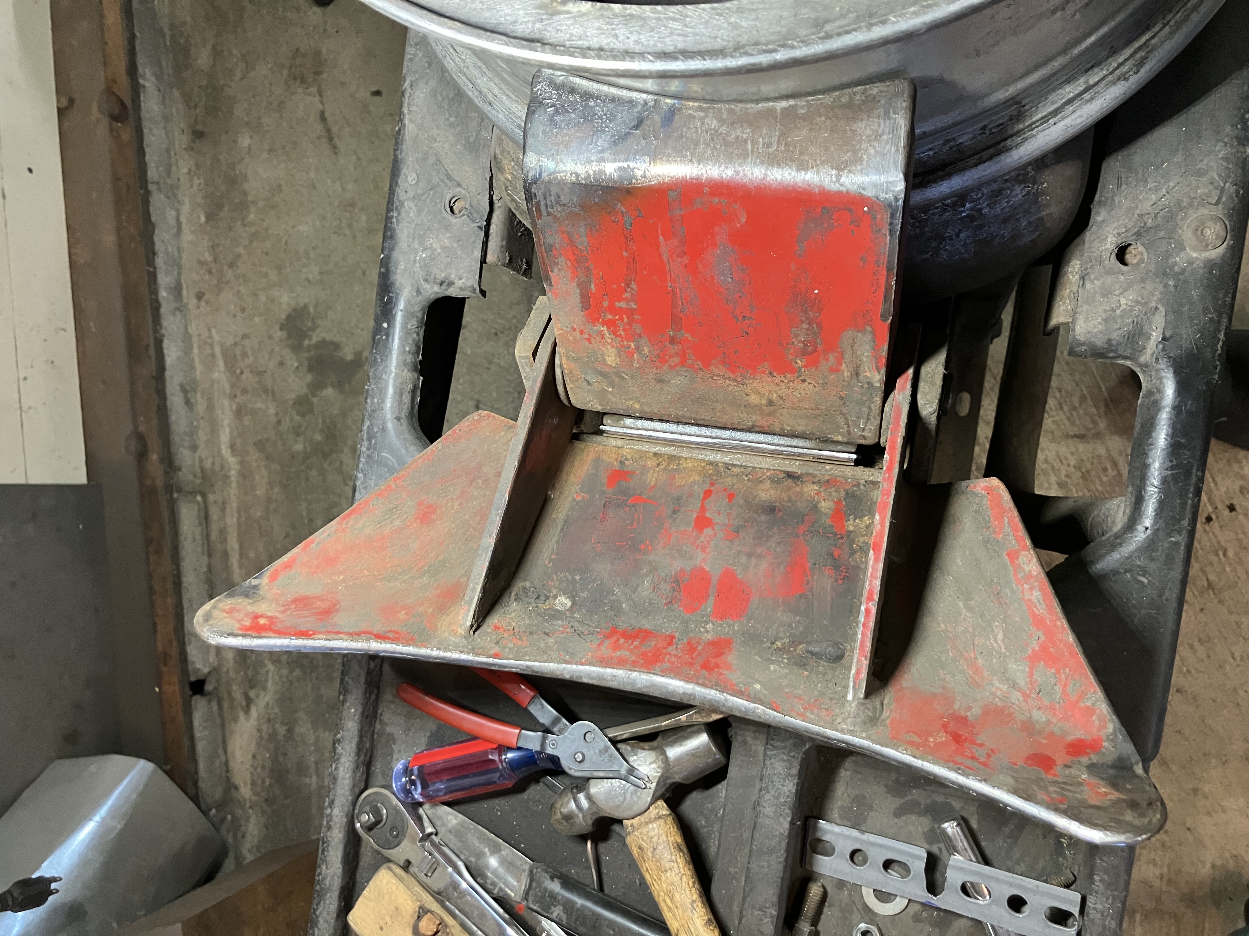

The damage to the machine was on the brace that helps break the lower bead. It’s a two part and the lower part got caught on the rim and bent down a corner. To fix it I had to remove the side covers, remove this part from the machine, and do some straightening on the vice. I tried putting heat to it but still managed to crack the metal. A quick trip to Kurt’s shop and that was welded up and back in business.
One big tidbit from the owner manual was how to adjust the lower debeader. Turns out that all those years of garage service it was out of adjustment. I was able to fabricate and add a shim to the mechanism to make the debeader clear the rim. The instructions said put a 15” rim on the machine and set it up with 1/8” clearance to the rim. It needed a 1/8” thick shim to meet this clearance.
