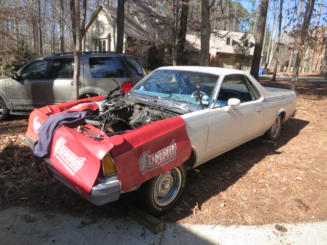

Finally got at it today, pulling stuff off the engine getting it ready to come out. WXO is coming Monday to get the engine out and apart and see what I've got.
This GM car is going to take some getting used to. Think I have it in my head now -- left side odd, right side even. I bet I spent a half hour looking for the last two header bolts till I noticed there are only six on a side.
I think the engine will come out without opening the AC or power steering if we leave the trans in place. Looks to be enough room to leave the radiator and condenser also in place. Have a new cross member that has a hump on the left side to accommodate duals. Expect we can remove the old cross member, lower the trans to get at the bell top housing bolts, then put the new cross member in when the engine goes back in. Its gotta be a lot easier to change that cross member with the exhaust loose and trans unattached from the engine.
Cyl #8 header bolts are a bear!! I see why guys remove the HVAC unit for some hot rods.

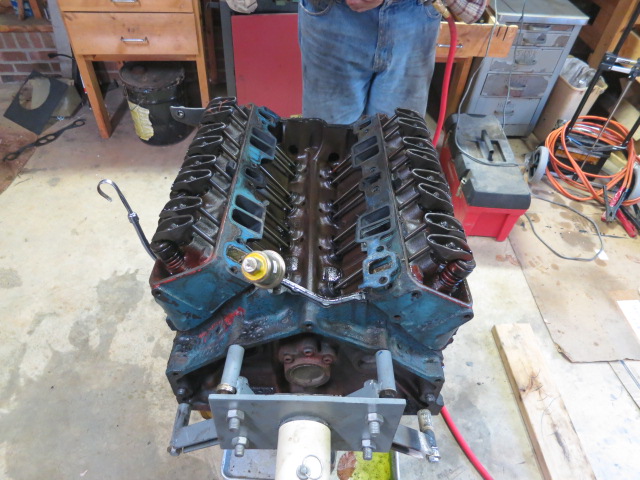

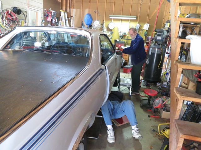

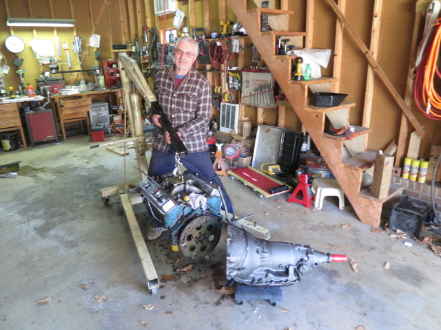

WXO and another friend, Jim, came over yesterday and we got the engine and trans out. The under side of the car is pretty nasty due to the leaking oil. Power washed the engine and trans so its not SO filthy. FYI BP, with the dirt removed and a clear view of the casting number the first digit clearly IS a "3" like I said.
We pulled the intake, heads and pan. It a very clean, flat tappet, two-piece rear seal, 4-bolt main engine. No bosses for a roller-tappet spider. Haven't measured bore and stroke to confirm its a 350 but I expect it is. Cylinders showed a little remaining cross-hatch, some vertical scoring and very little, if any, ridges. Didn't see any overbore, e.g. "030", stamped on the pistons. Maybe that's not common practice any more. Pulled the rear main. Some copper was showing on the bearing and very minor scoring was evident on the crank. Didn't pull the (Edelbrock aluminum) front cover to check the timing chain or pull the cam to inspect it for damage. Assuming the cam is OK, the engine could be resealed, reassembled with new oil pump and timing chain and used as is if boring were the objective.
