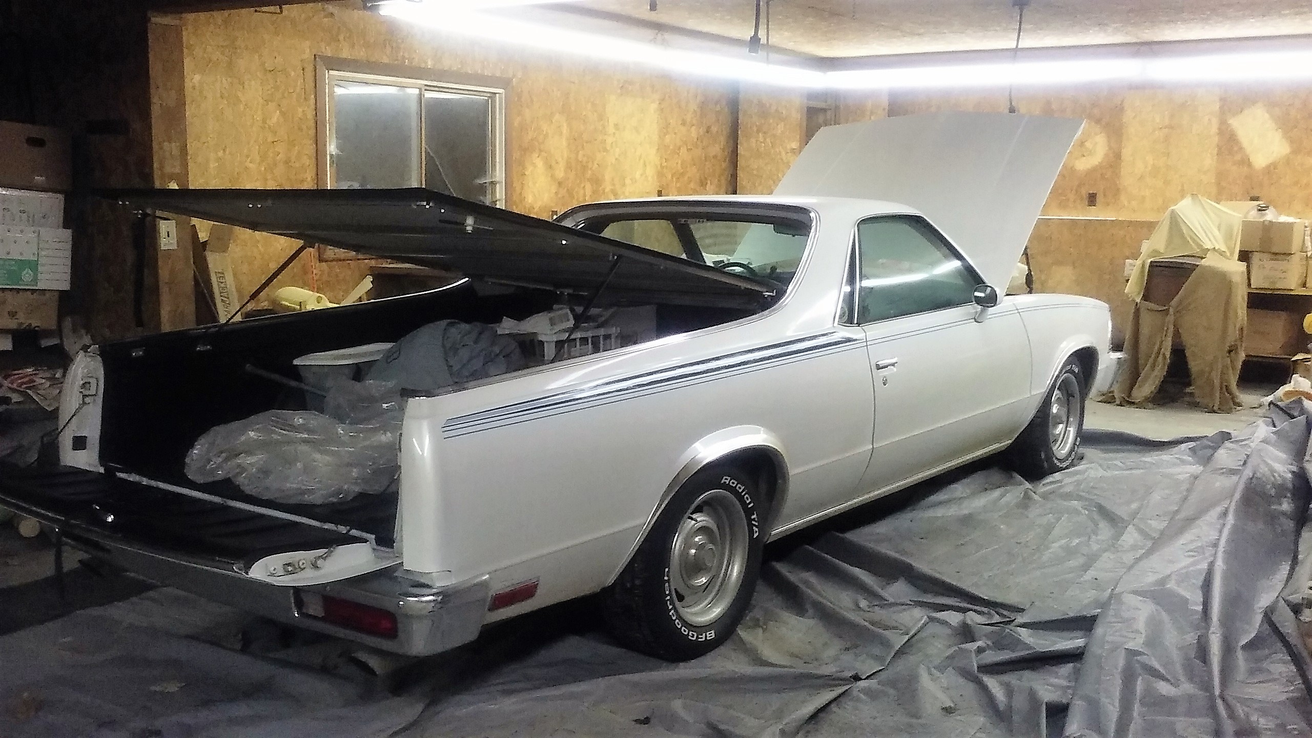

Dan took this picture of the El Camino in it's storage place while we were waiting for the key to arrive.

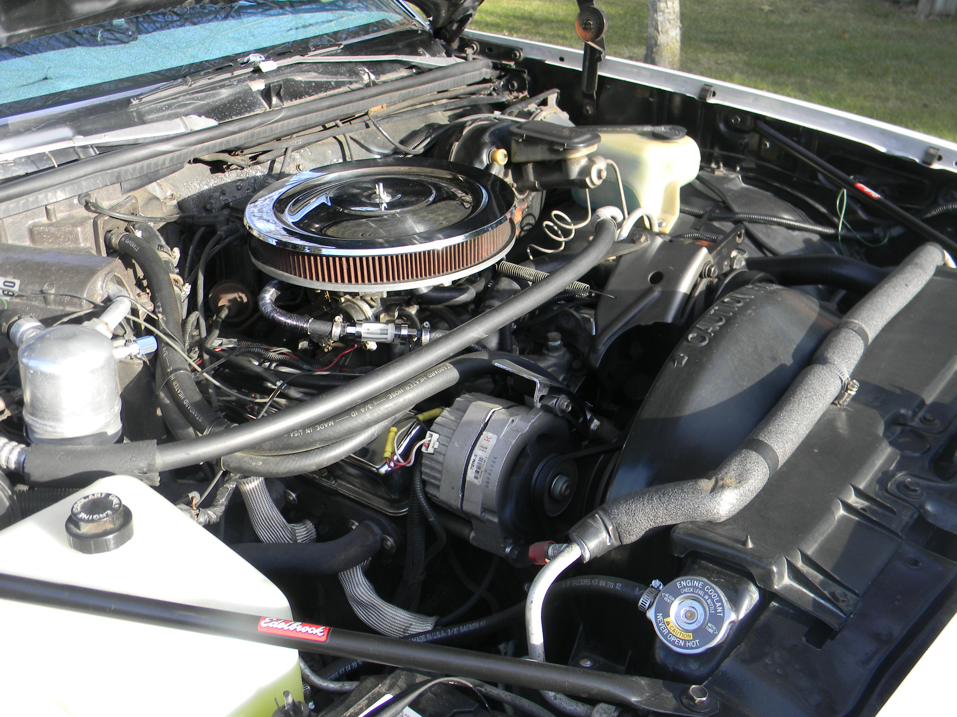

Not much energy today but I did get out to have a look at the Elky. Got the block casting number (8970010) but couldn't see all of the codes on the right front of the block. First four characters are V042 but couldn't see the rest of the code. Think the block casting number means its either a 327 or a 350. Was advertised as a 350 and I expect it is.
I'll do the compression and lead down tests but expect the engine is worn out. So, I've begun to think about "refresh" options. Called Prestige Motorsports, the guys that built the 347 for the Maverick, and talked about this crate engine but with aftermarket TB EFI. https://prestigemoto.com/383-chevy-stro ... e-420.html
If the current engine is a roller cam block, I'd consider rebuilding it with stroker and top end kits.
Somehow I got the idea that the Elky weighed 4000 lbs but looking around on the Internet it appears its probably 3500-3600. A 383 stroker should move it pretty good.

That block casting number is more likely 3970010, not 8970010. Very common, but not a roller cam block.
