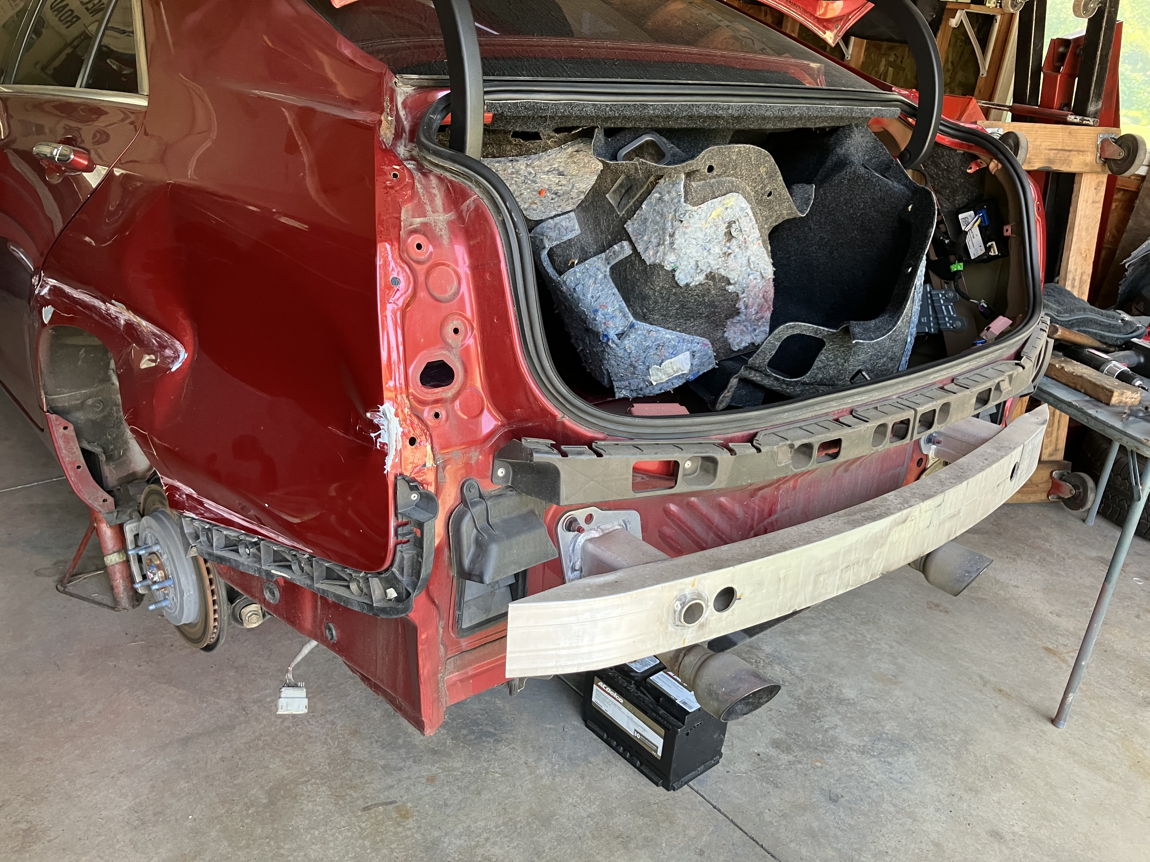

Bodywork:
* Removed the LR taillight, rear bumper cover and LR inner fender
* Put the port-a-power, hammer & dolly, and some welded nails to straighten the LR quarter panel. It's not quite the way I want it but I'm at diminishing returns so it's time to put body filler on it and see how it looks
* Ground off prior body filler in the damaged areas
Other:
* Purchased a replacement LR taillight.
* Turns out the paint is WA132X Obsession Red which is a tri-coat paint: foundation base, intermediate base and clear. It's one of the hardest colors to blend and will be expensive. Great!
* I don't see any obvious bends in the LR suspension parts, but the toe in setting looks to be off the factory spec. The LR wheel also looks to be straight
* Found the cause of the accident: There was a tow receipt in the glove box which had info I needed to look it up. On 6/4 at 6:04 PM the car was exiting I-40W to US-321N in Hickory NC when driver lost control and spun backwards into the inside barrier.

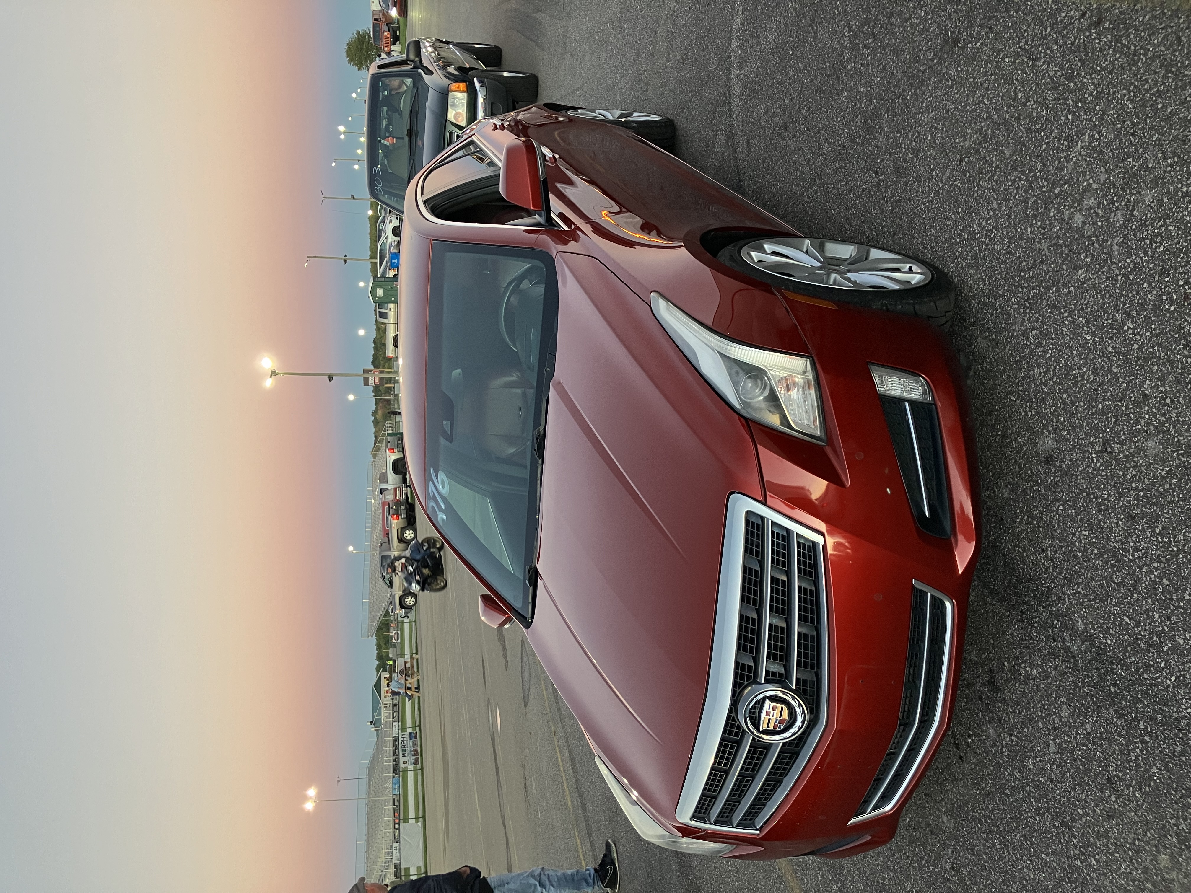

That evening the car made its debut at the dirt drags. Rachel also made her debut with the Charger. The red Caddy runs pretty consistent low 4.50's. It lacks the high RPM stall converter but it's easy to hold the car at 1500. Overall very happy with the performance of the car, and thinking there is a lot more potential with a tune up, better tires and basic performance modifications.

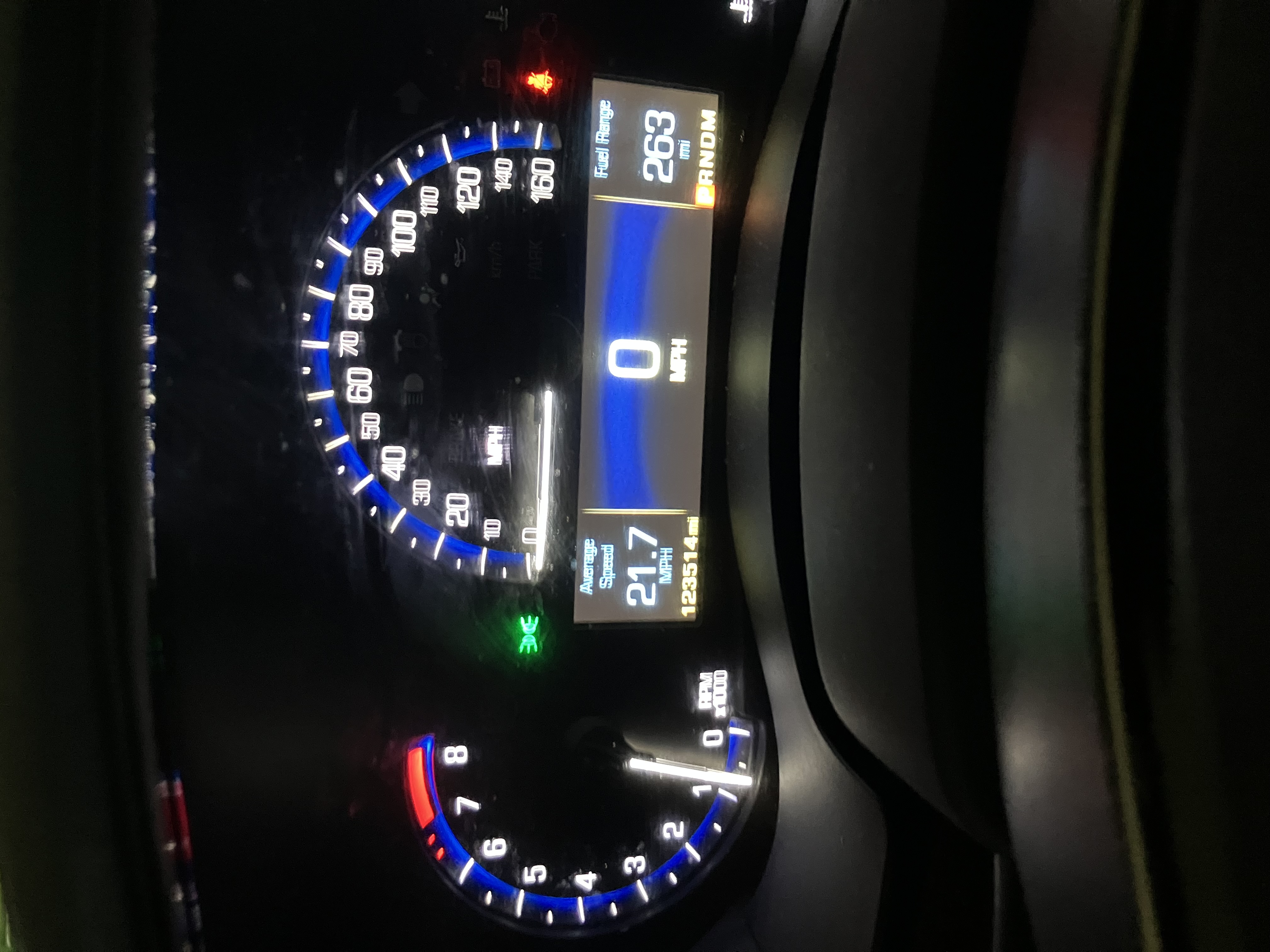

One thing I noticed recently is that the average MPG on the Challenger is 21.9 and average mileage on this car is 20.2. The average speed on this car is 21.7 mph. I noticed this a few weeks back and the numbers are not changing. Admittedly I don't drive that much, but my average speed in the Corolla was mid 30's mph. My guess is the ATS has a long memory and this car did a lot of city driving or sitting and idling with its prior owner so it's going to be a while before those numbers increase. I've put 1500 miles on this car but can't recall what the numbers were when it showed up. I had disconnected the battery during repairs so that does not reset these counters.
Also the one 2018 rim I have did not have a center cap, so I improvised.
