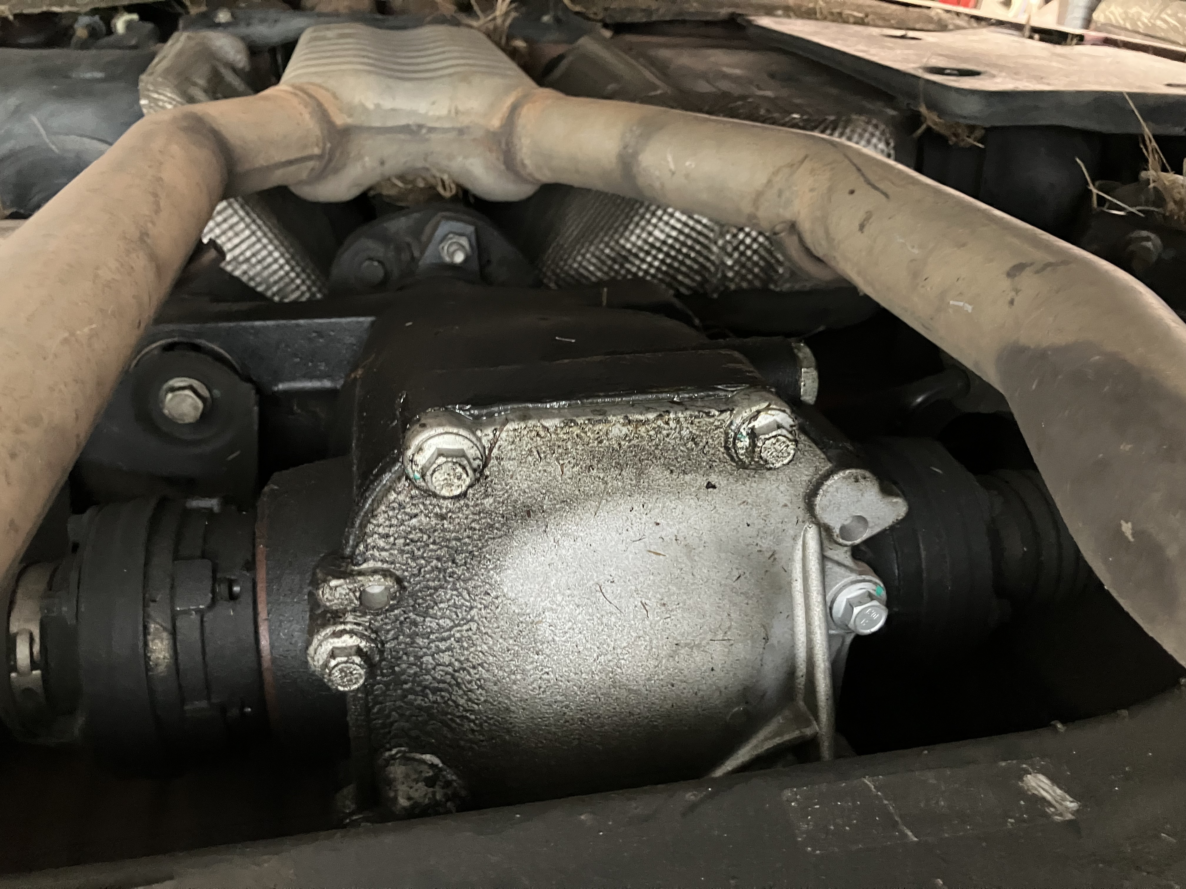

- the differential is leaking a little through the breather, and possibly through the rear diff cover. It also looks like it had been erased.

Differential:
* Replaced the stock breather with a low restriction breather just like I installed on the black Cadillac. I did spot check the breather on the black car and it was in place and looked good.
* The fluid level is up
* The fill/drain plugs on this car are 15/16" and those on the stock diff are torx which to me confirms this is a replacement diff

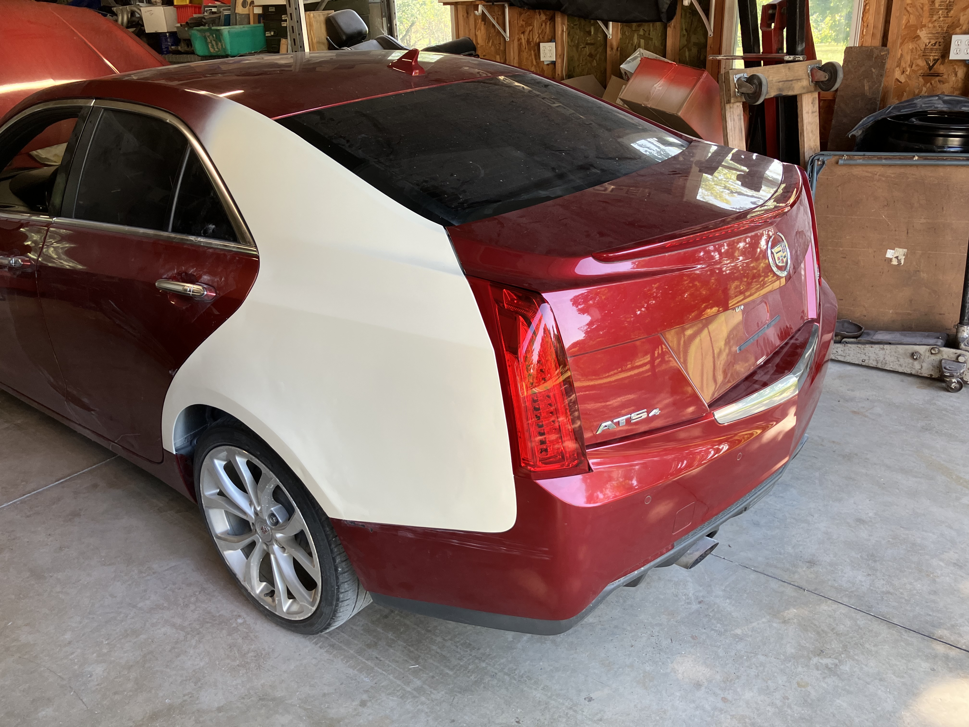

* Removed the LR taillight, rear bumper cover and LR inner fender
* Put the port-a-power, hammer & dolly, and some welded nails to straighten the LR quarter panel. It's not quite the way I want it but I'm at diminishing returns so it's time to put body filler on it and see how it looks
* Ground off prior body filler in the damaged areas
Bodywork:

- LR quarter is taking shape. Still some work to get the shape better but it's taking shape. I was tempted to get paint and just put it on but its just not ready forthat. I'm not looking for show car but there's too many imperfections.
- Put primer on it

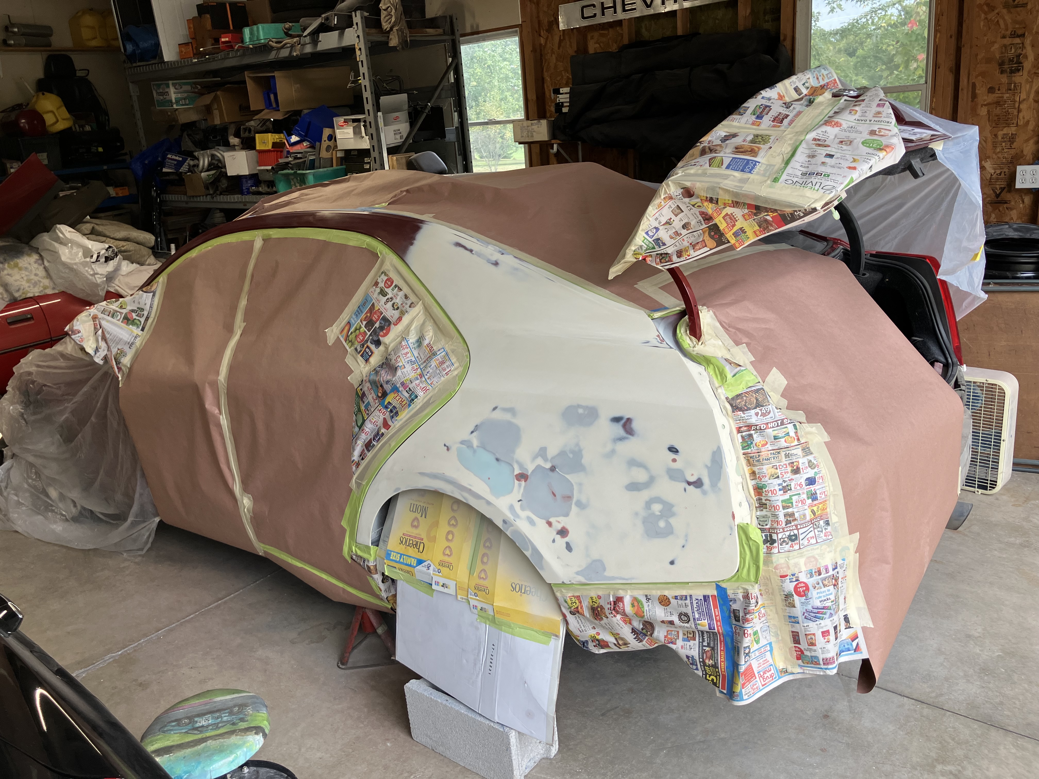

Bodywork:
- Put primer on it

I ran out of time before Friday to get the paint on so I only got primer on the LR quarter panel. It's decent but not smooth enough for paint yet. After that I had some work getting the front end aligned as well as the LR. Toe in and steering wheel alignment are good.

After that I put a little more time into the LR quarter panel. It's not ready for paint yet but hopefully will be in a few more sessions. I also made a trip to pull a part to get a rim and maybe a couple tires to help sell the black car and I came across a wrecked ATS that had an aftermarket K&N filter on it and some floor mats - for $33 they are mine.

Finished up the bodywork and painted the LR quarter panel.
Took the buffer to the scuffed up areas on the bumper cover, and applied touch up to them and a few other nicks on the car - base, mid coat and clear. Also did a little straightening on the LF fender.
Cleaned up some of the overspray on the car. I covered every inch of the car I was not painting with paper or plastic but there were some gaps where it still got in. So confusing. Anyway the buffing compound I had to clean up imperfections took it off with relative ease. Still some spots to go but I have the technique.

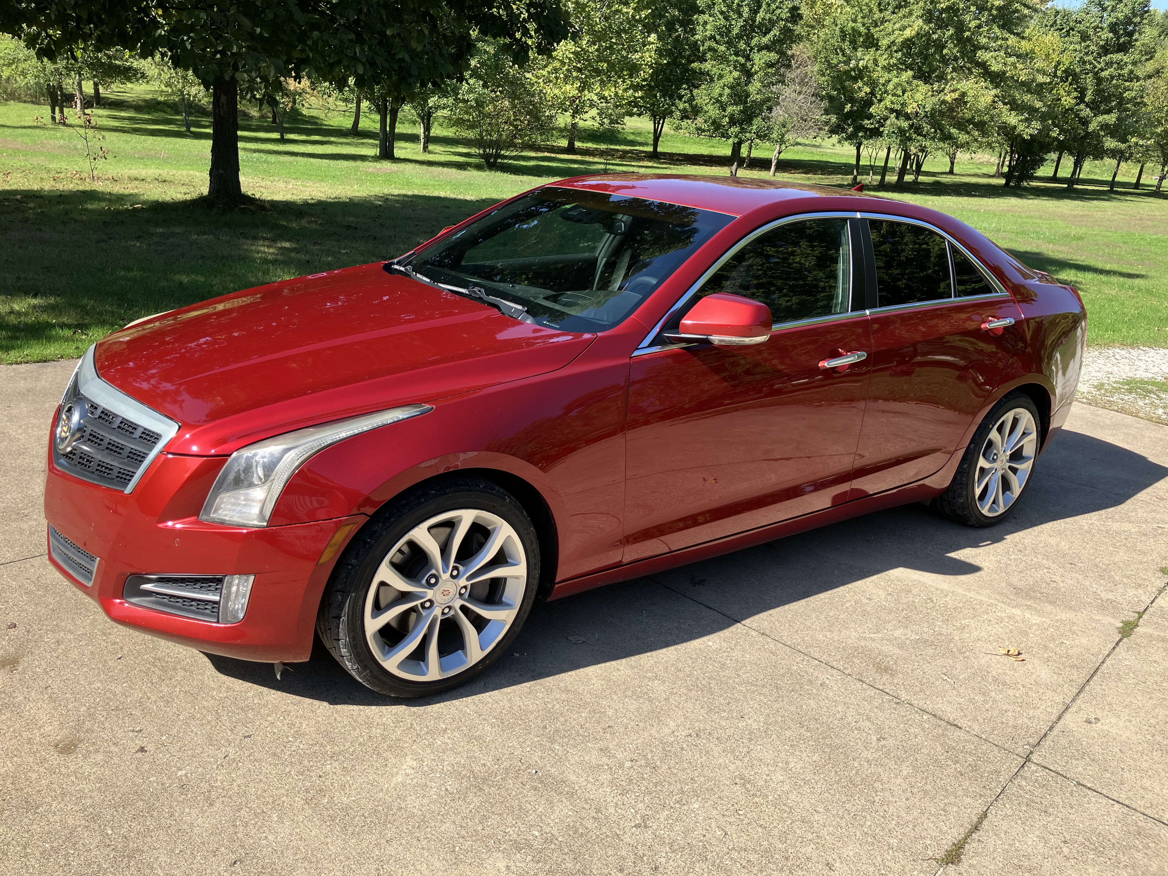

Here’s a little better after pic - compare to the pic in the first post

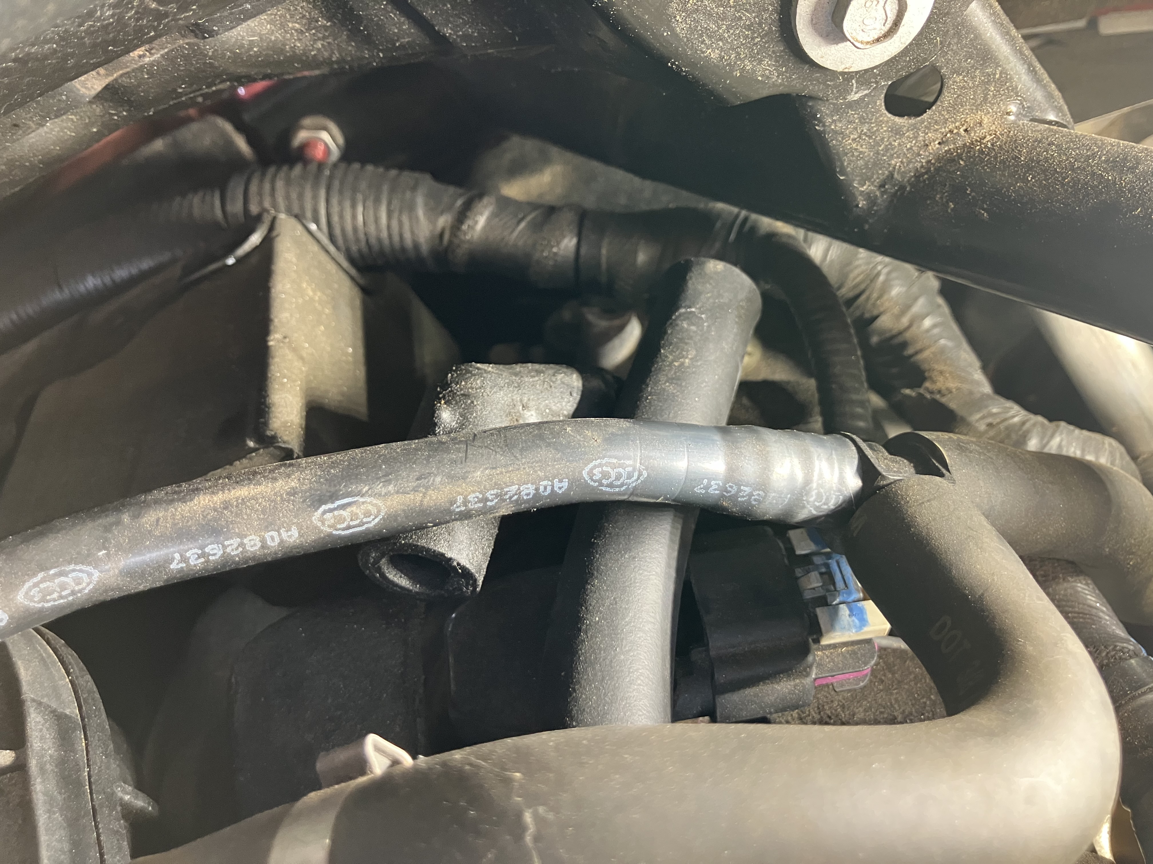

When I started work on the plugs I noticed the PCV line to the air cleaner was separated in the back. When I put in the K&N I am sure I knocked this hose off. The fit of the tube in the hose is not very snug - but the test drive confirmed that this fixed the shudder during shifting. Also the misfire seems to be resolved.
