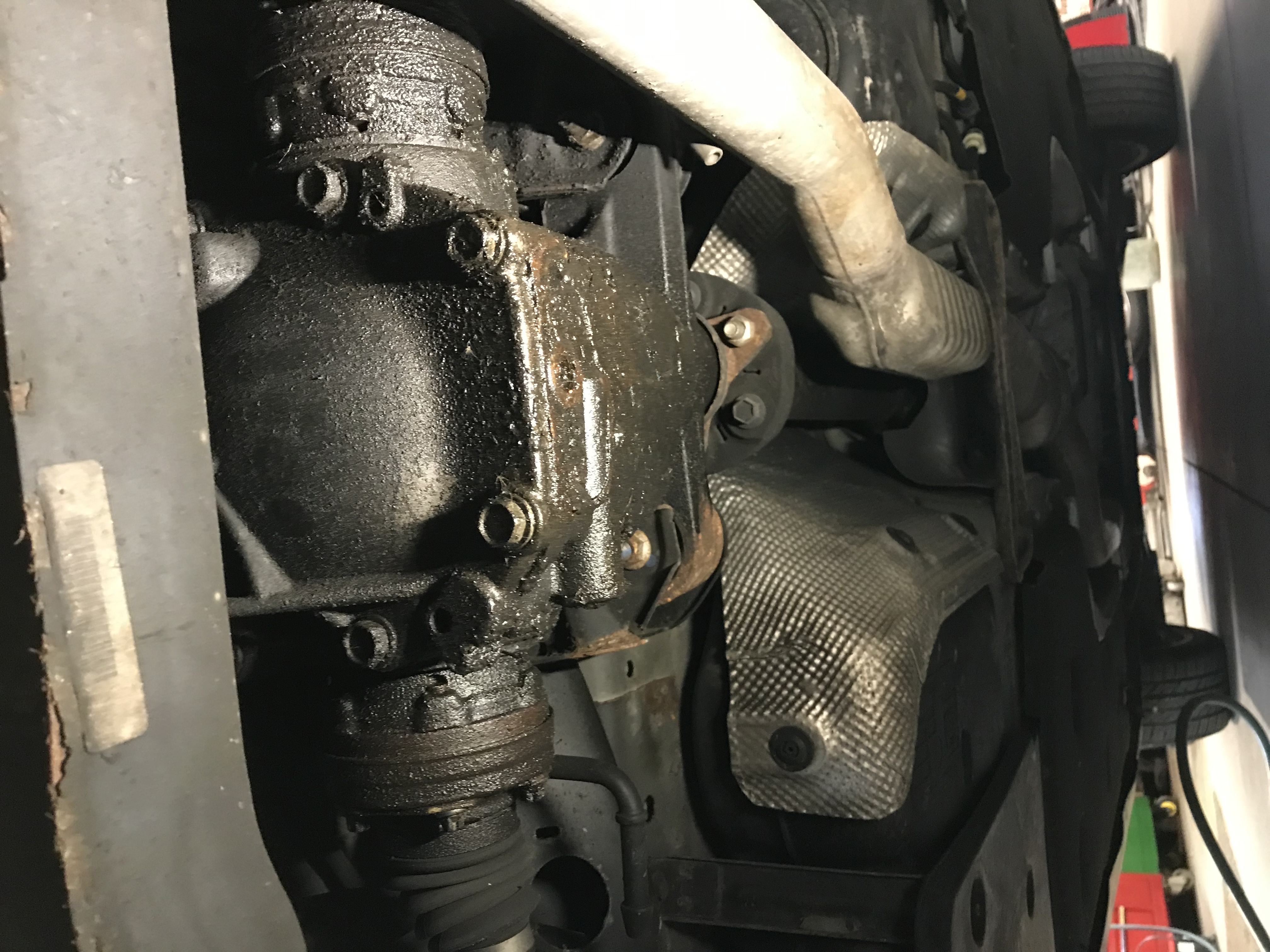

I found an ATS at local pull a part and it still has the diff in it. The car is wrecked in the front and the diff shows no sign of leaking.
The halfshafts and driveshaft all bolt to the diff so you can remove it without removing the halfshafts or even the tires

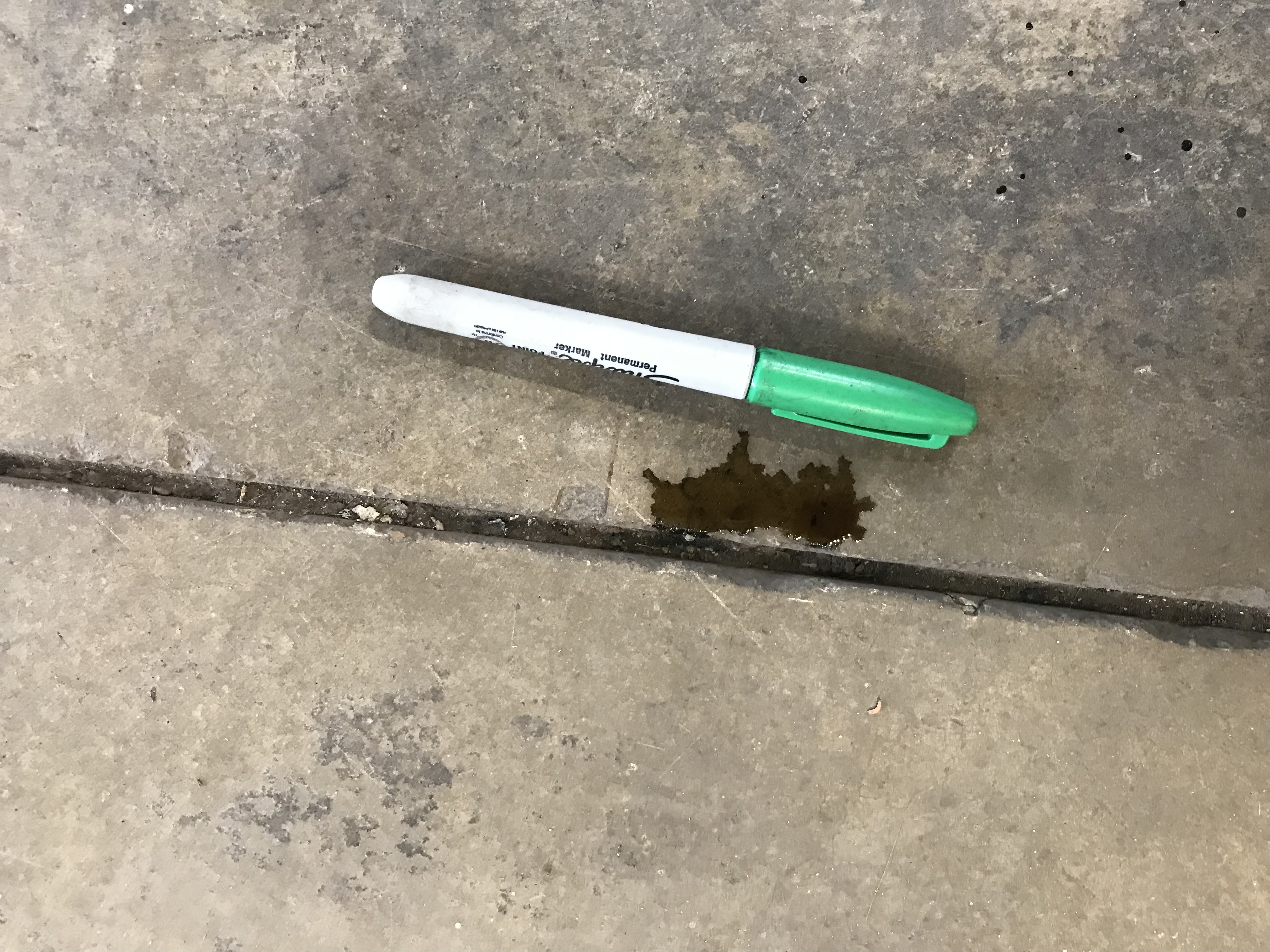

is leaking oil - it appears to be the valve cover - still some work to diagnose 3) left rear is toed out

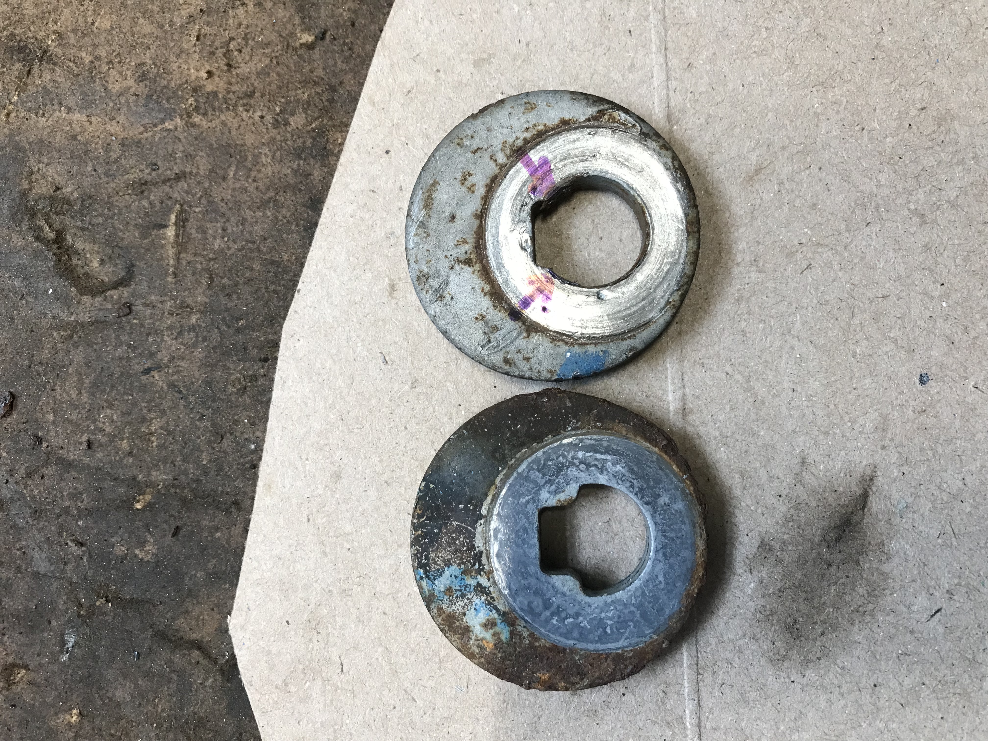

best guess is it had a minor incident in the LR and damaged a toe link. you can see a little damage on the quarter panel

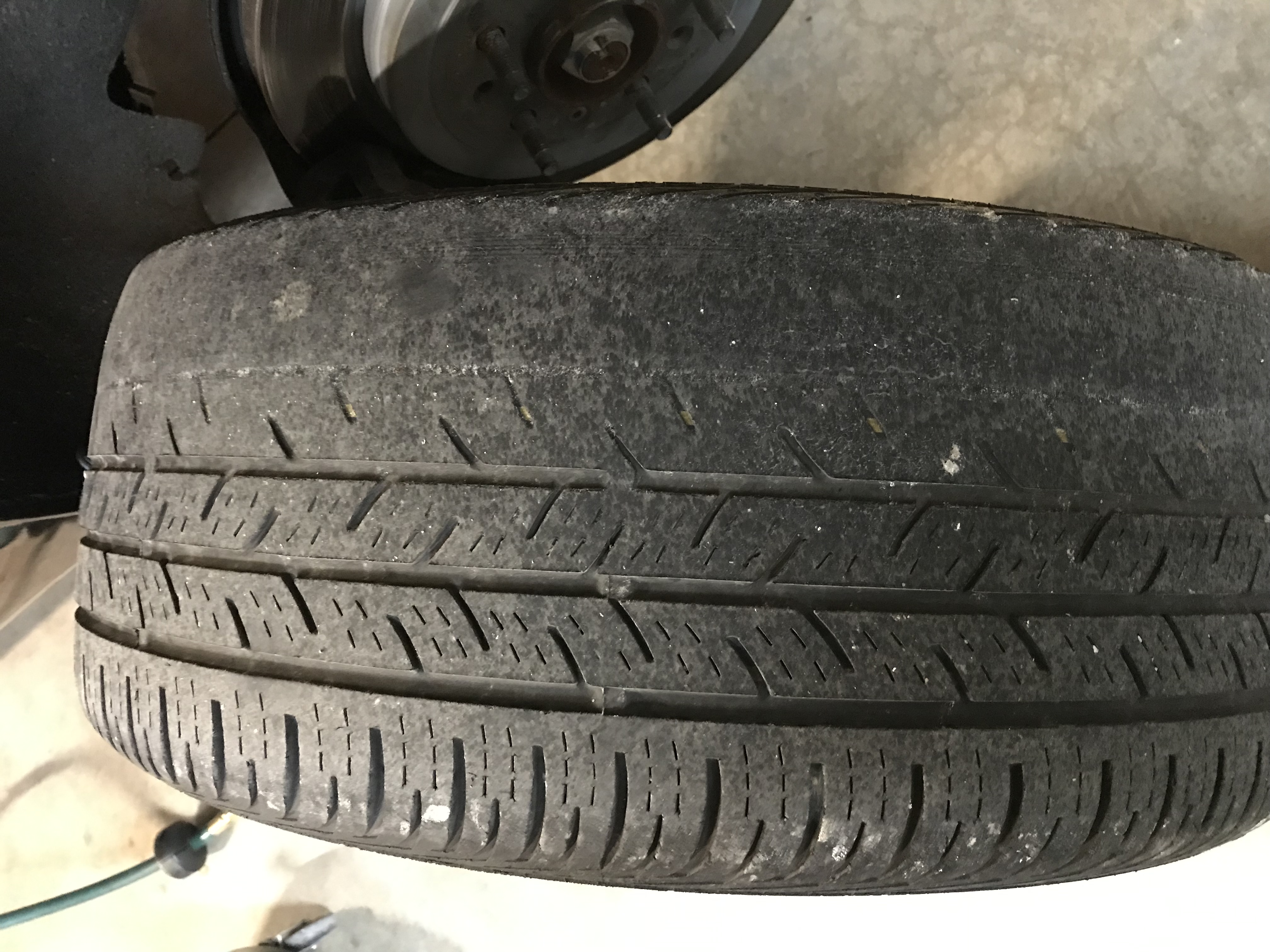

the tires I planned to replace, but it has 1 generic brand and three Continentals. They all have different manufacture dates.

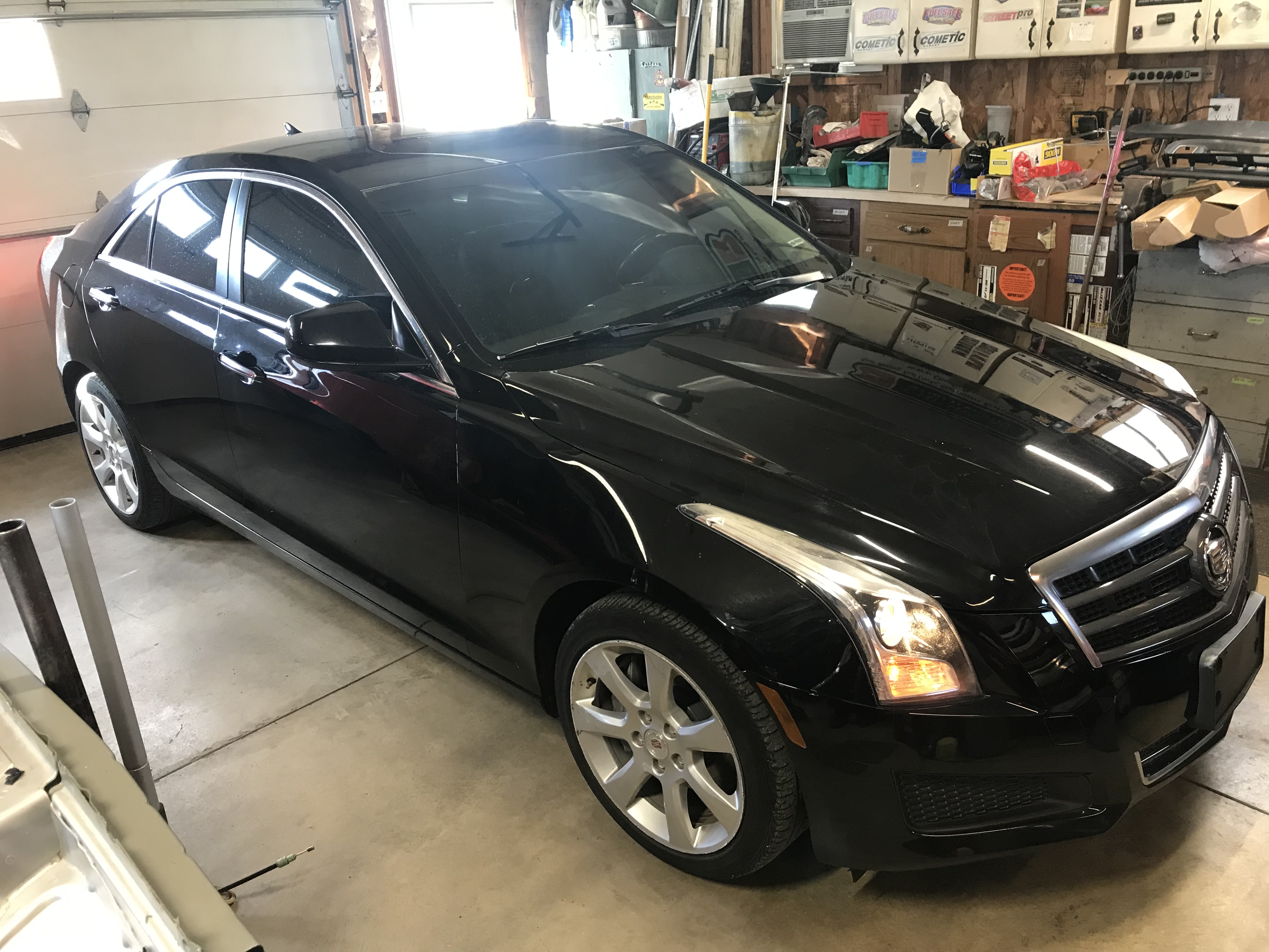

Re: 2014 Cadillac ATS Luxury 2.0T AWD - Mostmint #46

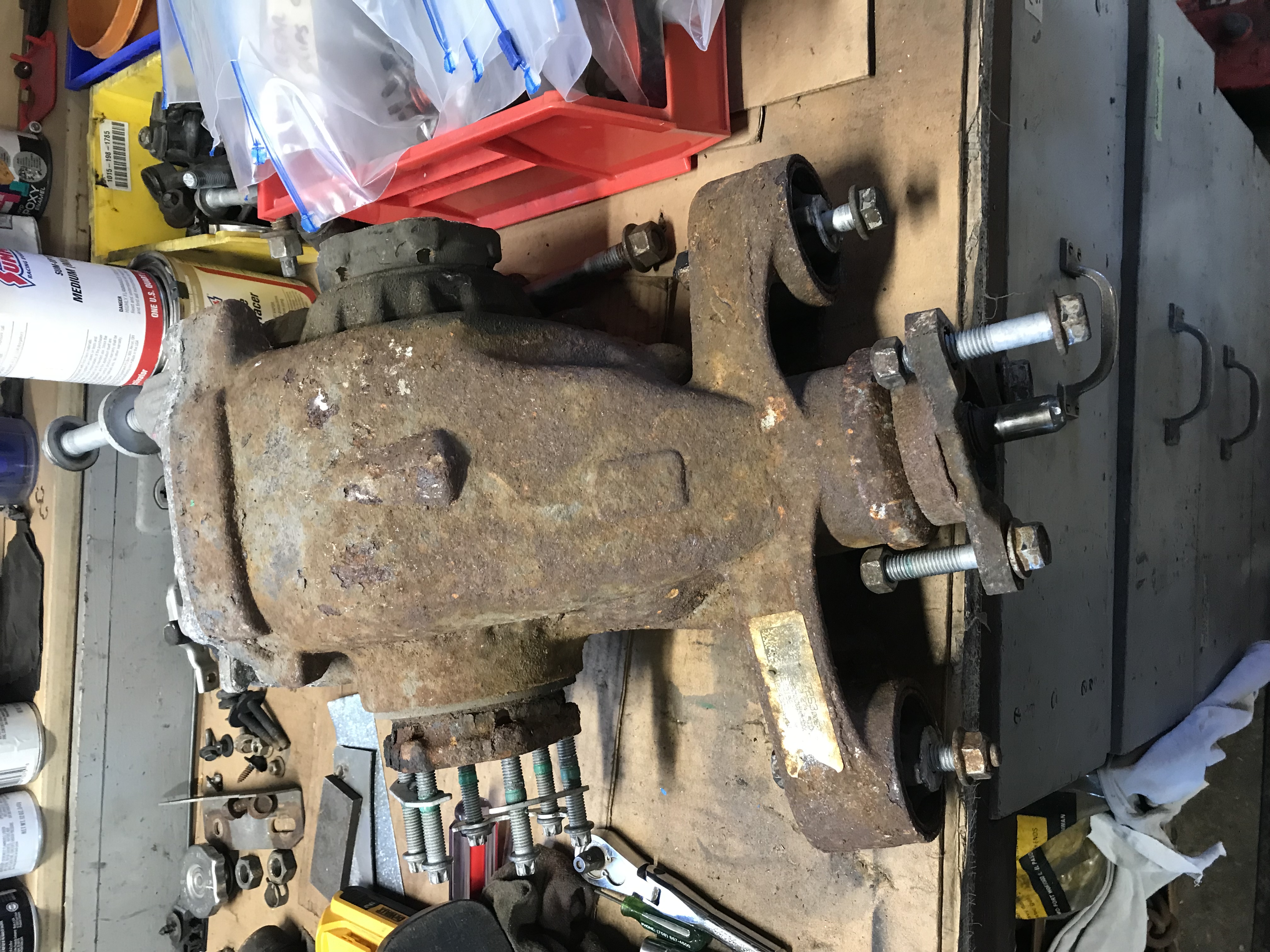

Had to learn how to jack up this car to pull the diff.
Differential is out - literally just unbolt the halfshafts and six bolts. I wasted some time because the rubber u-joint had metal sleeves that were slightly pressed in and I didn't understand this. After reviewing some videos I applied a few hammer taps and they came out. The thing is coated with fluid - kinda disappointed I didn't see when I was inspecting this car to buy it though the sounds on test drive saved me. It's just not a problem I was expecting on a Cadillac built in this century. Cam cover is off. Online research tells me that somewhere around 100k they start leaking. Mine is leaking pretty much all the way around the top but it really looks like the worst offender is the vacuum pump gasket. The hardest part of this job is reaching the bolts that hold the vacuum pump which is driven off the exhaust cam since the bolts face the firewall. Another oddity is the cooling line that runs over the cam cover and connect with the block through a hole in the cam cover. Had to drain some water out of the block so that wouldn't flow into the crankcase. Signs of a 10 year old car were prevalent: The gasket on the exhaust side got real crisp, under the hood I found some of the vacuum lines have already been replaced, and the suspect Y fitting in the cooling system has already be replaced, plastic tubes on the engine for PCV are very brittle so there is some work there, and a heat shield/sound deadener at the back of the engine is missing. Cam cover gaskets are on order. I pulled the plugs out. They are a bit black but this is likely due to the last half dozen times I moved it in and out of the garage without warming it up at all. They were AC 41-125 iridium plugs. The car is a bit sluggish when you first engage the throttle. On the assumption these are the original plugs I ordered another set. The rear tires had way too much negative camber and the LR was toed out quite a bit. I looked under there and played with the adjustments a bit - however one of the offset washers for the lower control arm on driver side was stripped so it wasn't moving with the bolt. I'll grab one from the car at pull a part. When the car is back on the ground I'll get to taking measurements and fine tuning it. This car has the same basic 5 link suspension configuration as the Challenger. New tires are on order. I was debating what combo of tires to get (summer/winter/racing) until I came across Michelin X-Ice tires for over half off at Tire Rack. If I'm doing dirt drags I can't see how snow tires can hurt, and with AWD I'm going to try them on the paved drag strip also. They are new old stock and I only drive like 5k miles per year. In time maybe I'll get another set of rims and summer tires.

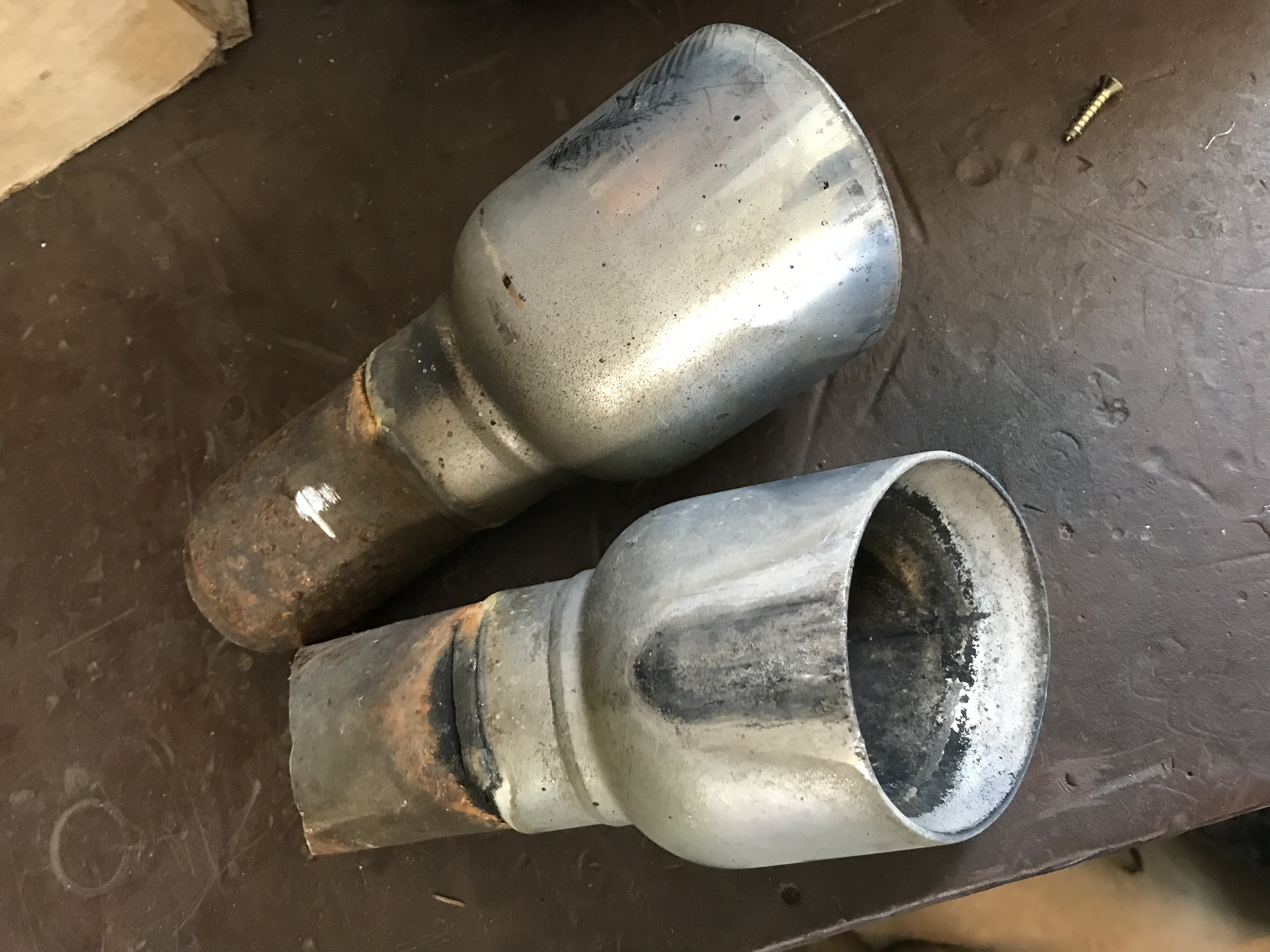

* Went to pull a part to fetch the differential. Also secured a wheel center cap, exhaust tips, special washers for the rear suspension camber adjustment, and three the door handle trim pieces. The rear bolt was gorilla tight I had to use leg power on the pipe extension on the ratchet to get it free. Otherwise it was a fairly straightforward procedure. * Went shopping for tires online and found Michelin X-Ice snow tires clearance priced for about $90 a piece. At this price I'll start with these - should help racing on dirt drags and will try them on the pavement also.

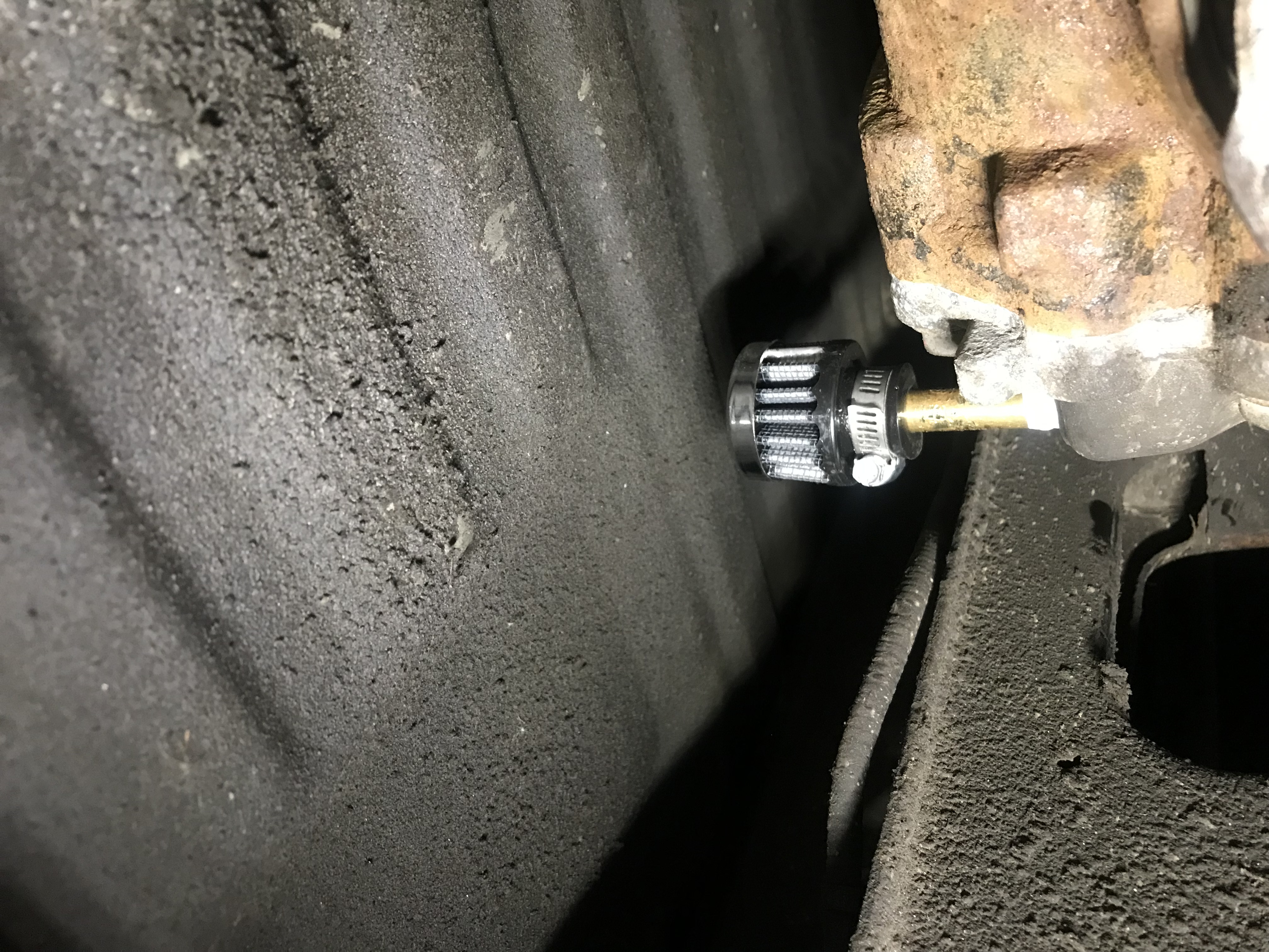

* Ordered a breather for the differential and obtained some plumbing to support it. Took some doing but I found a breather for a go kart engine that should do the job nicely.

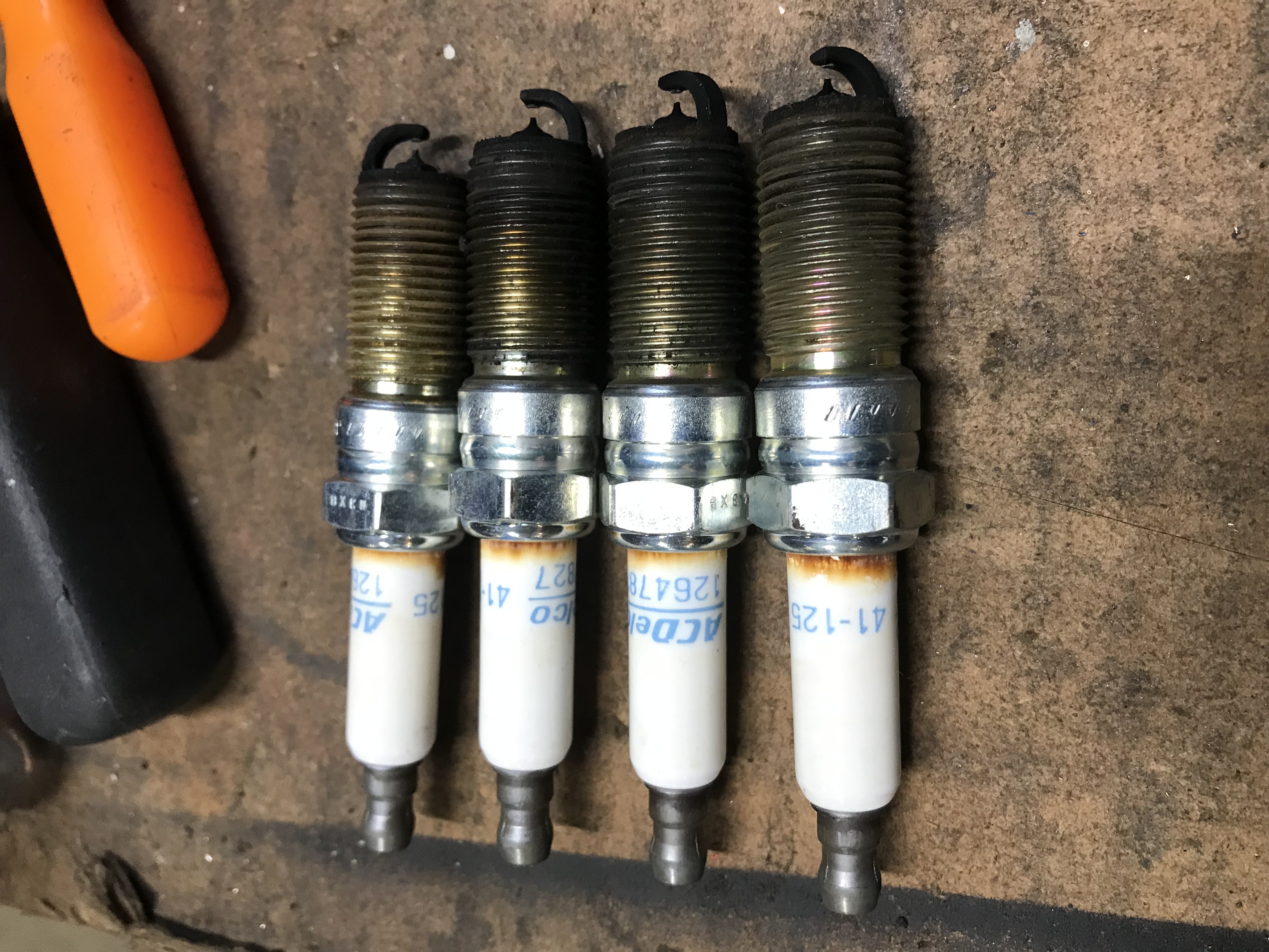

* Acquired spark plugs

* Cleaned up the differential and installed it in the car. Still need to connect the halfshafts to the diff.

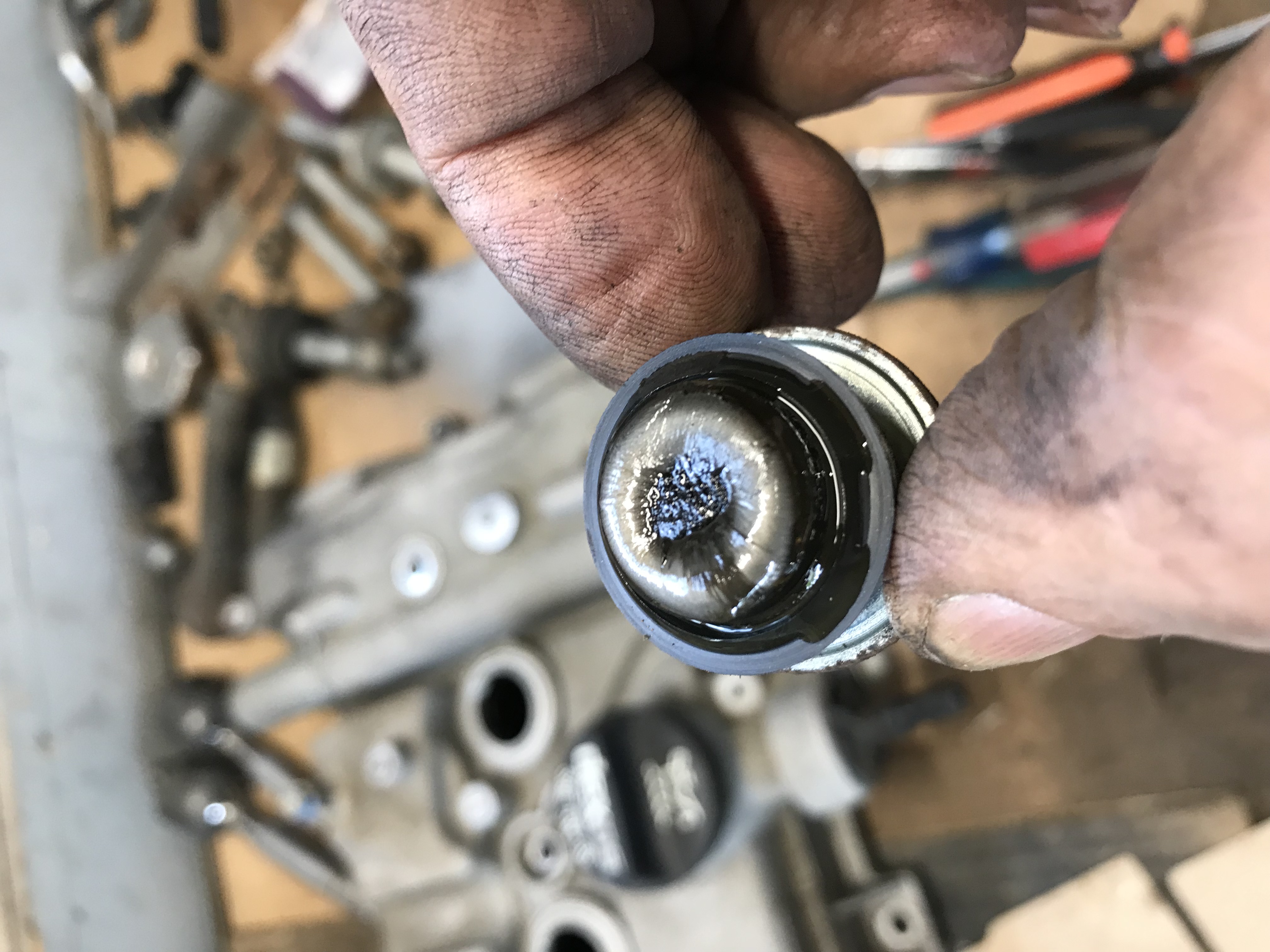

* Cleaned up the cam cover and all the bolts. The main gasket surface is clean and prepped. This cover has one seal and many small gaskets - I will remove these when replacements are here so I put the new on in the same configuration as outgoing

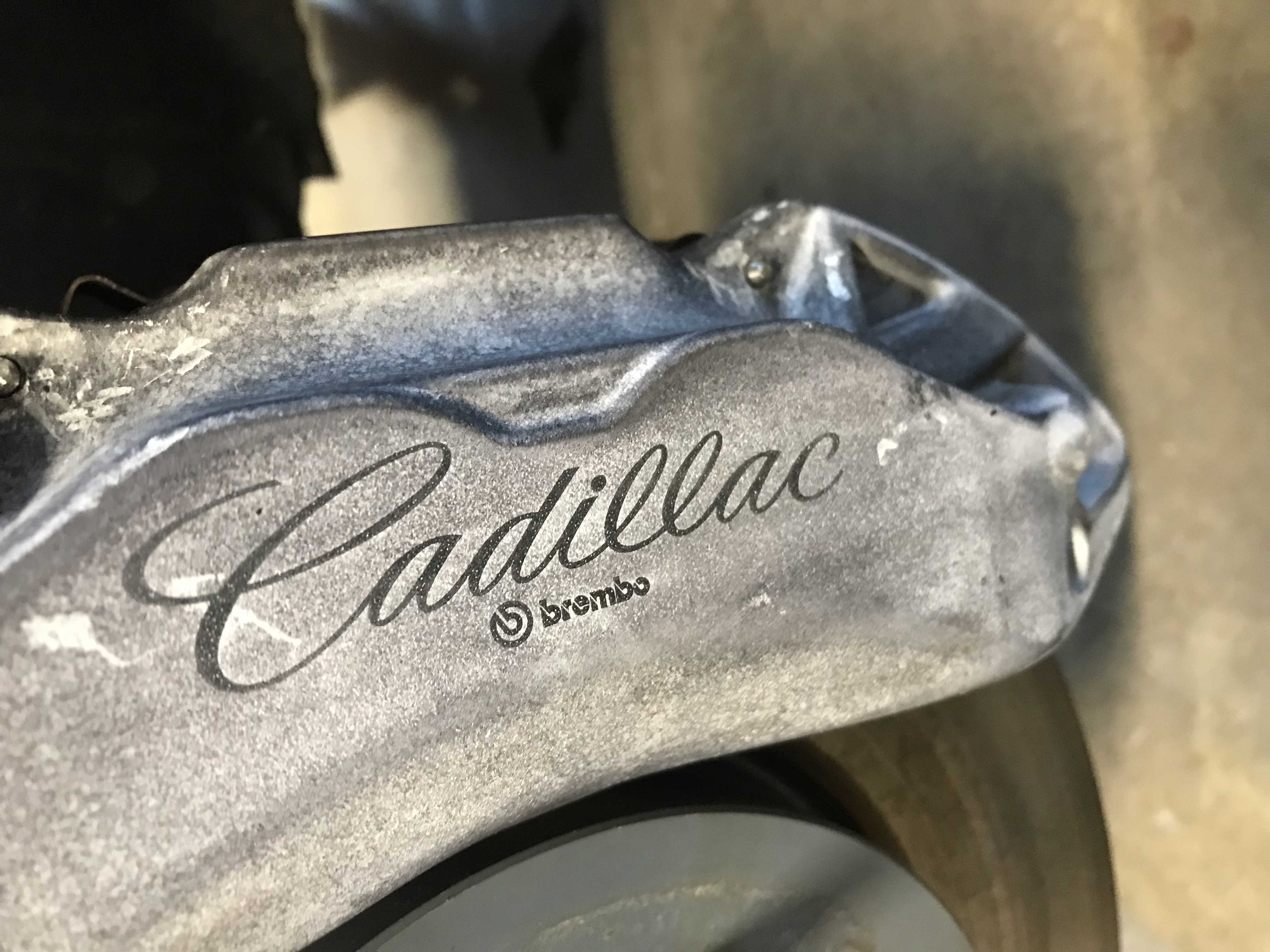

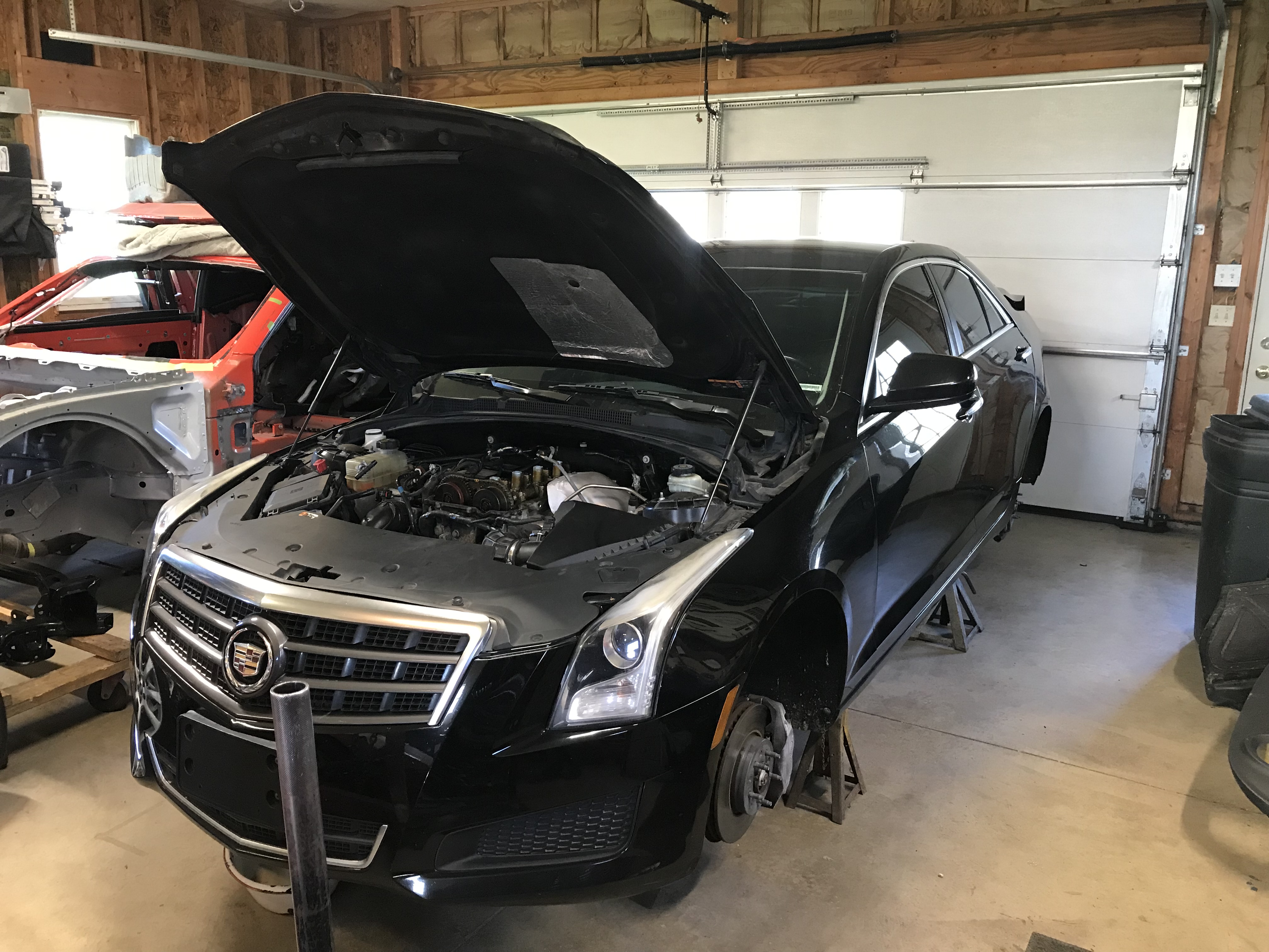

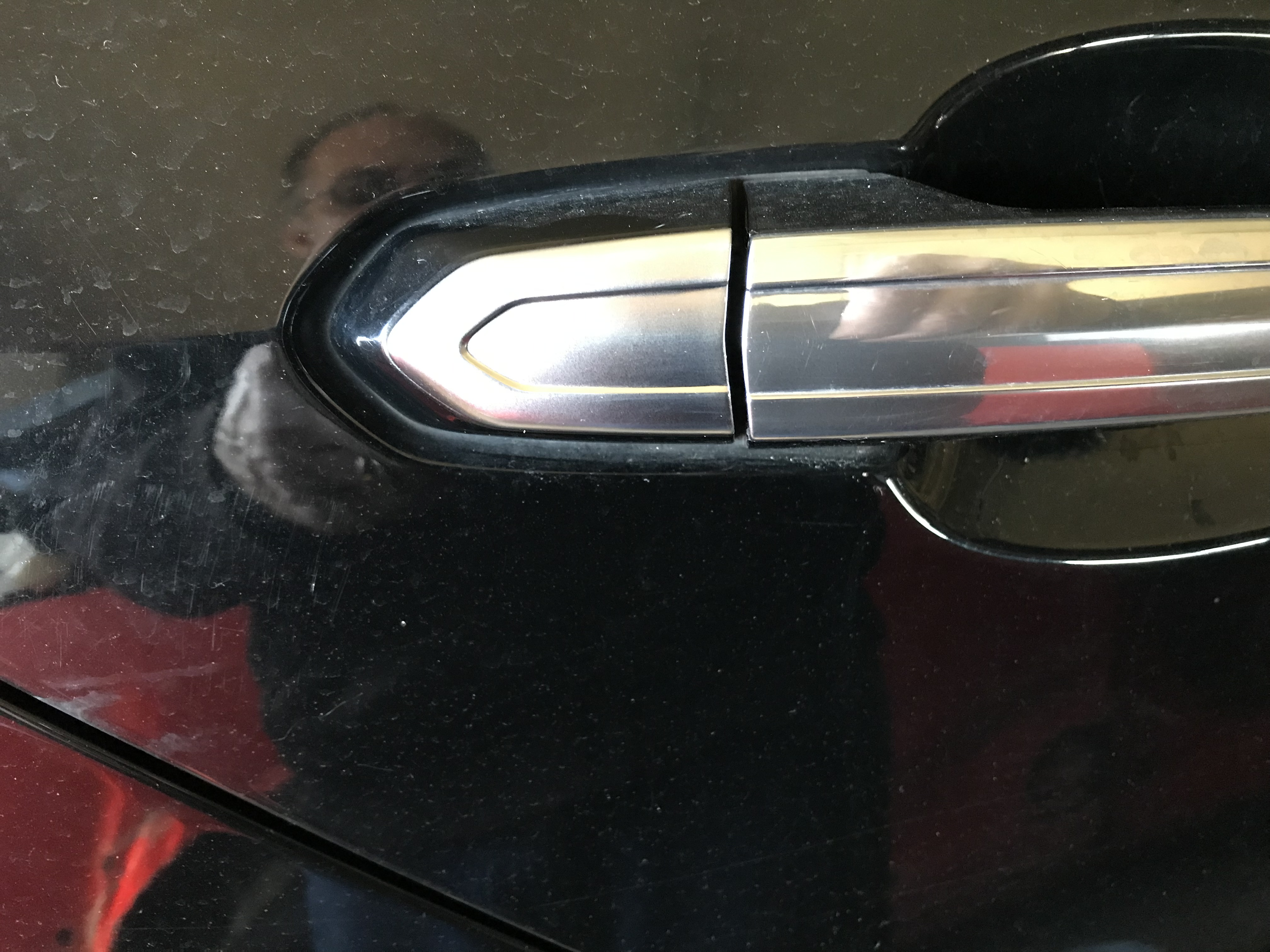

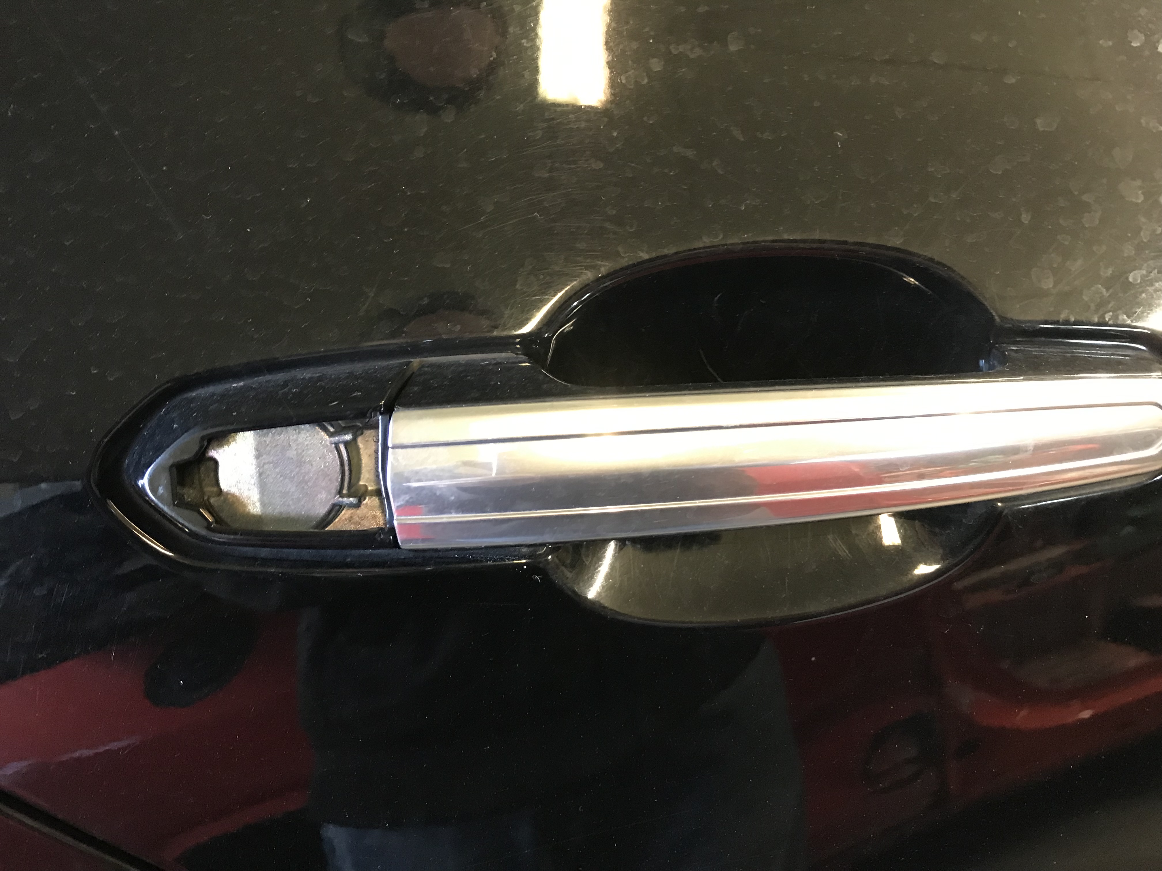

Up on jackstands and work in progress The car has factory Brembo brakes! The door handle trim pieces - before and after

* differential breather is in place. I ordered one for a 5/16" fitting but it ended up 3/8". Quickly overcame that with a change of attachments.

* installed the good offset washer and took some big swings at adjusting the rear toe and camber. It's a lot better but still need a good 4 wheel alignment for the last bit. I need to be able to move the car to get the suspension to settle after adjustments and it's not running. Also IDK yet how to easily get this car in neutral without starting it which I'm not doing with the engine apart * I've gone as far as I can with the cam cover - some of the gaskets still are not here yet. I took time to replace the brittle plastic tubing in the PCV system

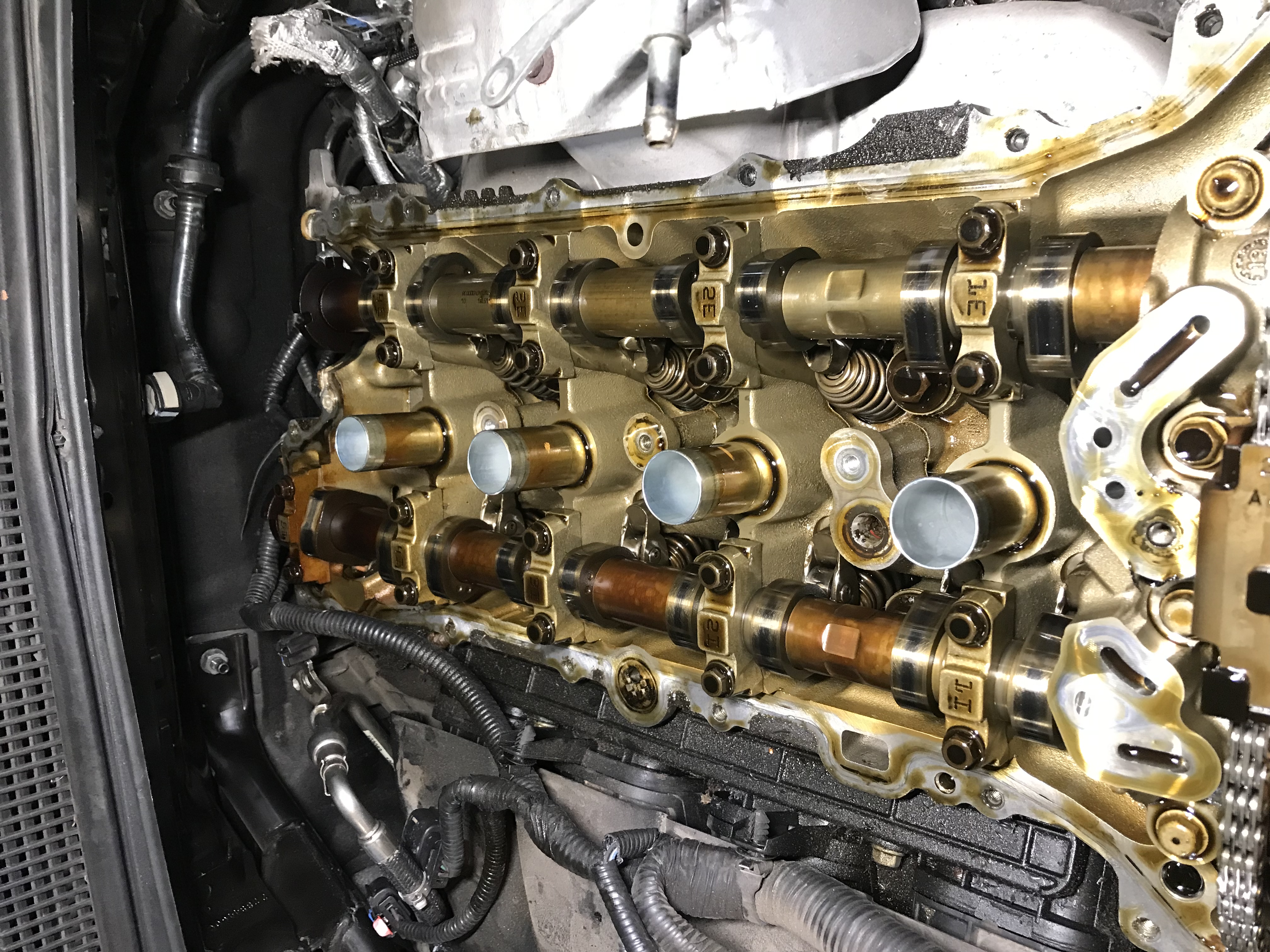

* The cam cover has been off this car before. Some of the pieces in back for insulation and holding on the engine cover are missing. I also notice oil leaking where the lines connect to two of the PCV valves. These observations make me wonder if there is a problem with the PCV system not operating properly. I understand how the air is supposed to flow, and some things to check in the system to make sure its working.

3) No oil left on the floor overnight after almost 3 hrs of driving and half a dozen dragstrip passes.
4) As the differential is warming up I swear I can smell a bit of fluid. My breather is apparently doing its job but its odd that the smell can work its way back into the car if the window is open. I'm going to keep an eye on it to make sure it not leaking but otherwise this is not really a problem.
