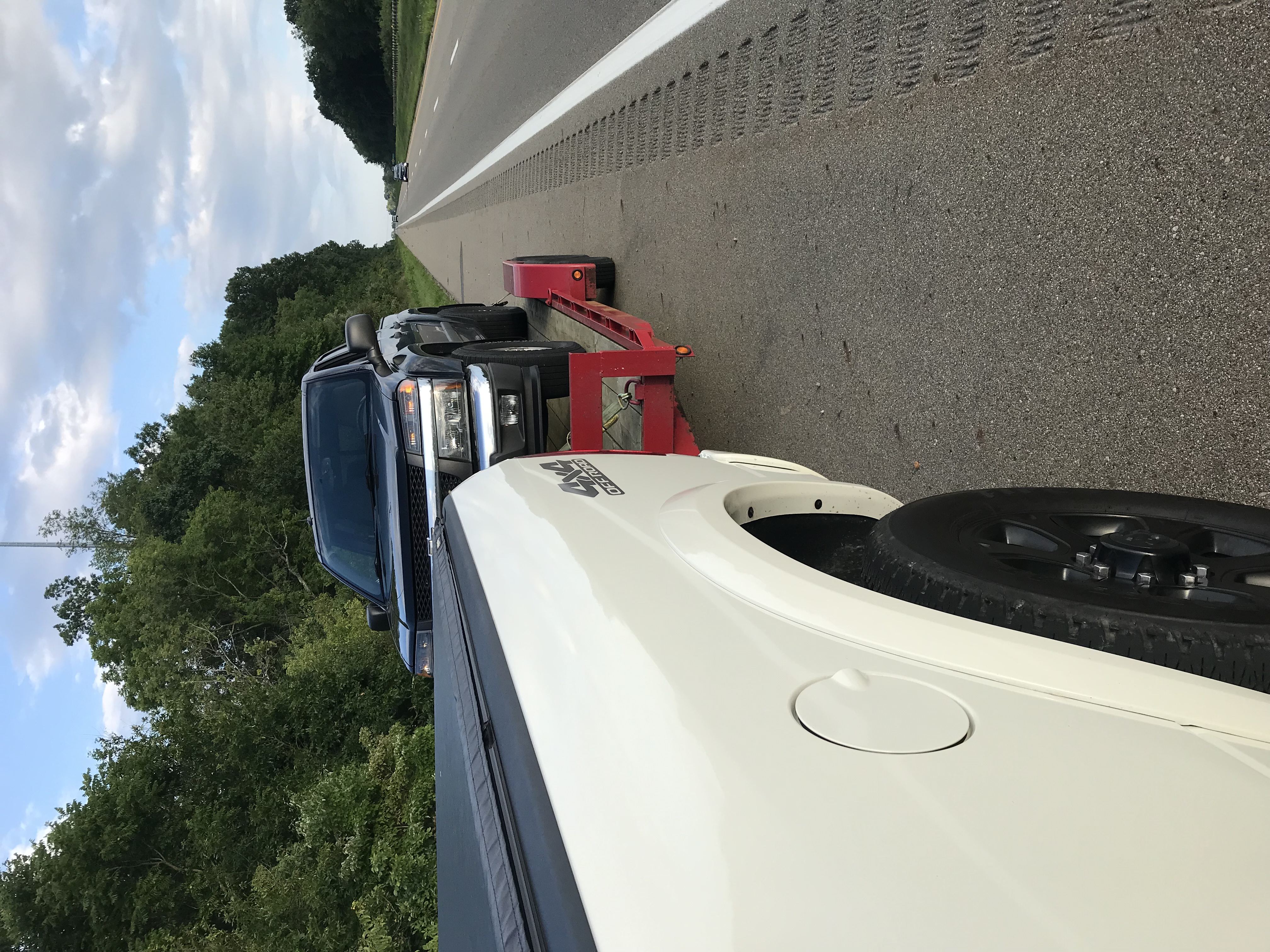

Yesterday though after 90k miles it had its first significant problem - suffering catastrophic water pump failure. The pump literally seized up and the belt was dragging down the power so she pulled over. This was about 30 minutes from home so I borrowed a truck and trailer and fetched it. To load it I just cut the belt and it started right up and drove up on the trailer.

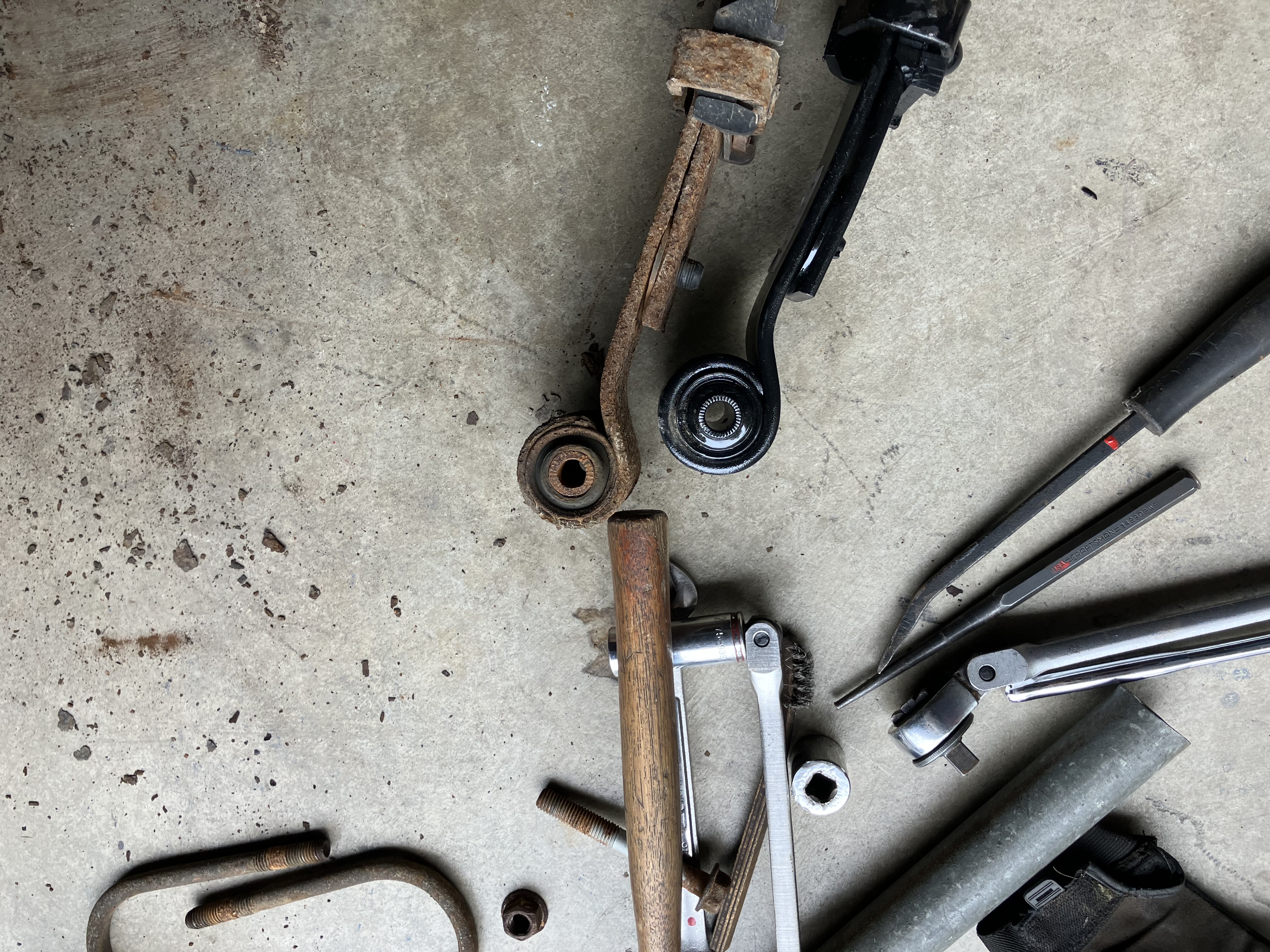

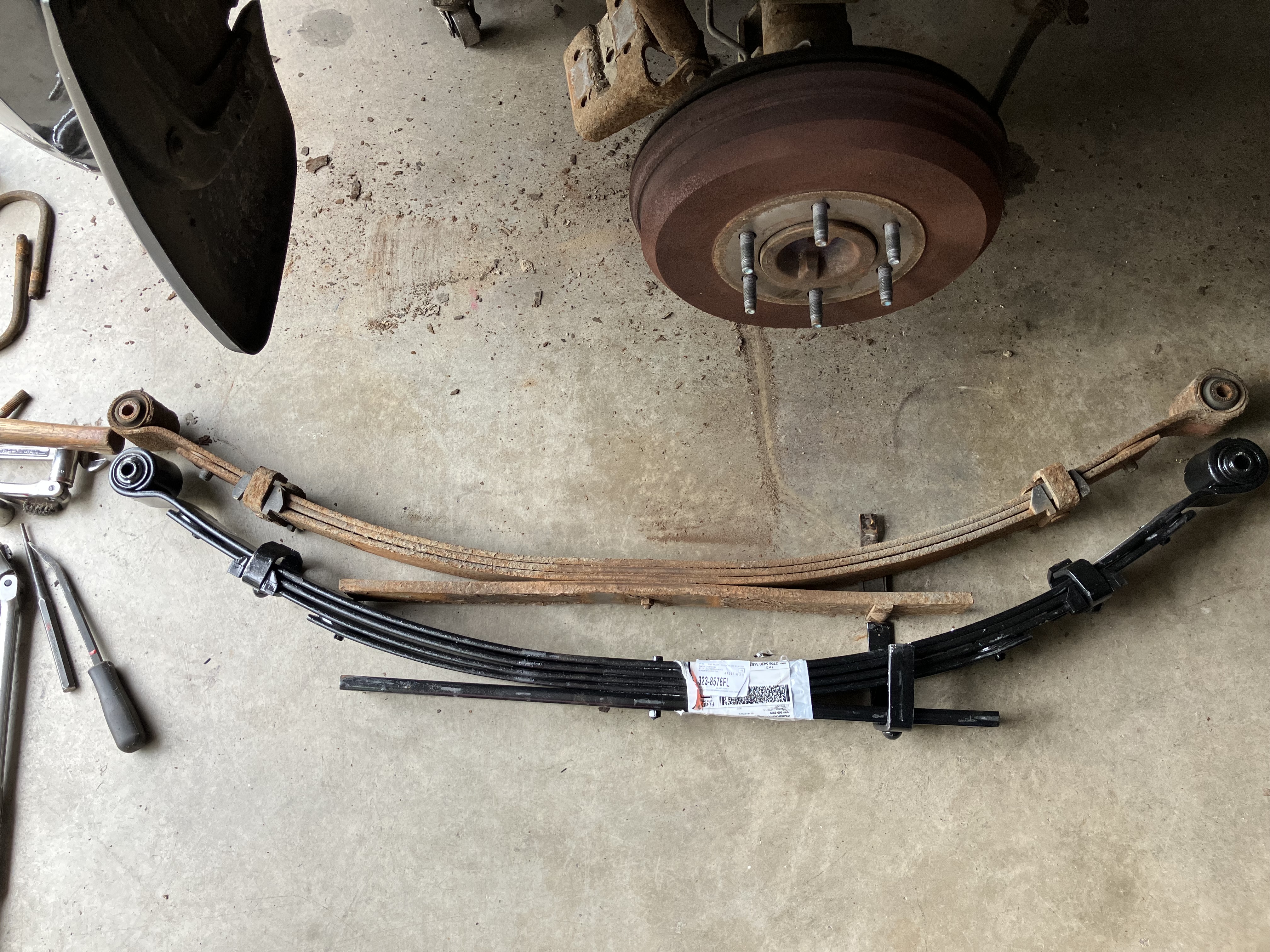

Recently I noticed the right rear of the truck sagging under load which got me thinking there is a broken leaf. Since this truck is occasionally carrying heavy loads I decided to get some heavy duty springs - these are stock replacements for some heavier setup than this truck was originally equipped. These have one extra leaf spring.
The change was relatively straightforward except for removing the rear bolt from the shackle. On the passenger side I loosened the top shackle bolt and was able to swing the spring up above the exhaust pipe to get the bolt out. On the driver side the spare tire was in the way. Unfortunately the spare would not lower more than two inches. I was with some effort able to get the top shackle bolt out in that small gap though this cost a bunch of extra time. Upon reassembly I put the bolts in the other way so those items won't be in the way if this ever needs to be done again.
Being in NE Ohio winters I expected the worst from rust, but all the bolts came out, with just a bit of trouble getting a couple bolts out of the leaf spring.

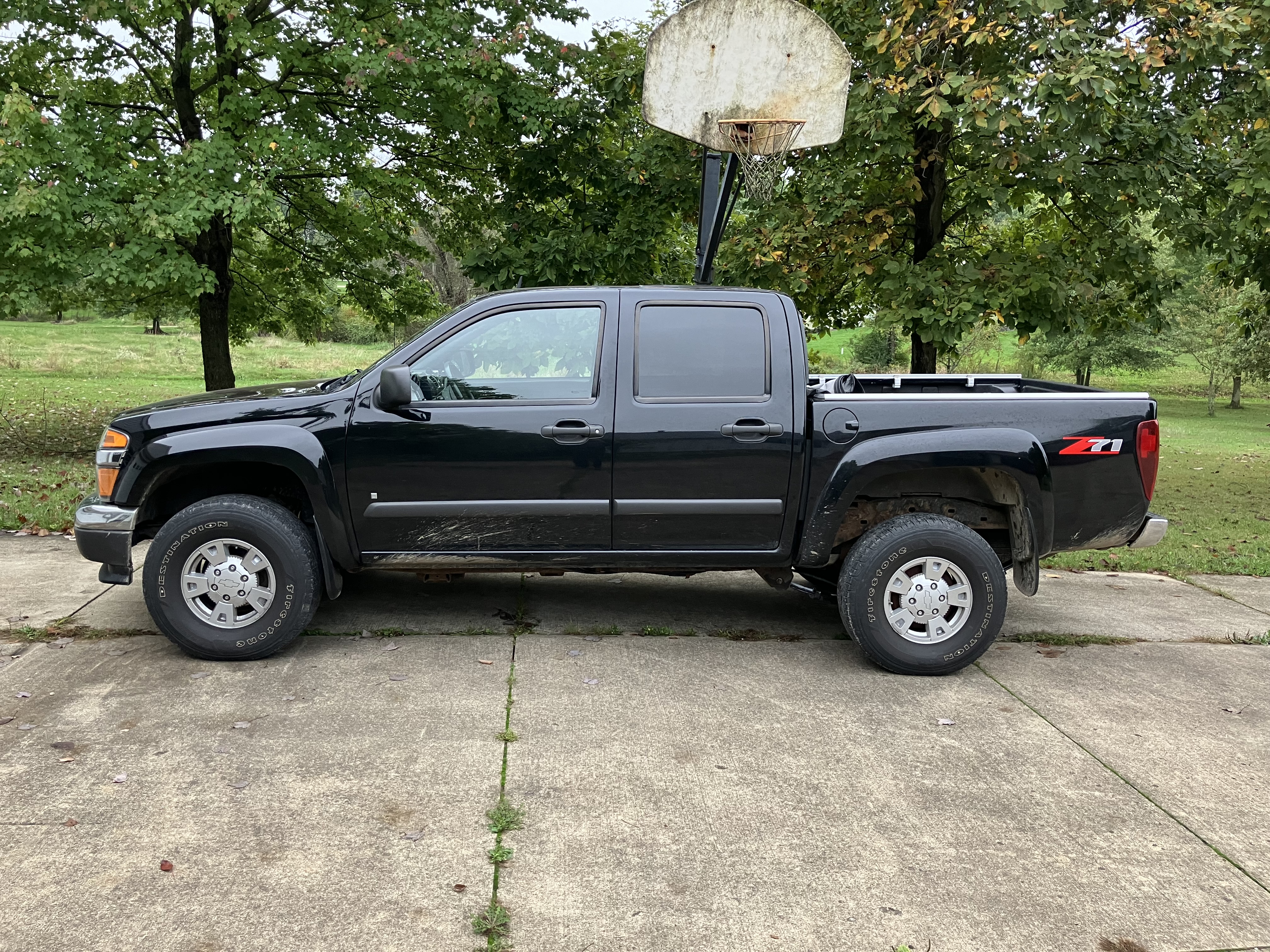

The net result now puts the rear wheel well about 3" higher than the front. If you look at the pictures at the start of this thread you'll see the gaps to be similar when it was new. I'm not surprised its higher just didn't see it being that much. Gonna drive it a bit and see if it settles. If it doesn't or if she doesn't like it I can get some longer ubolts and blocks to lower it back down a bit.

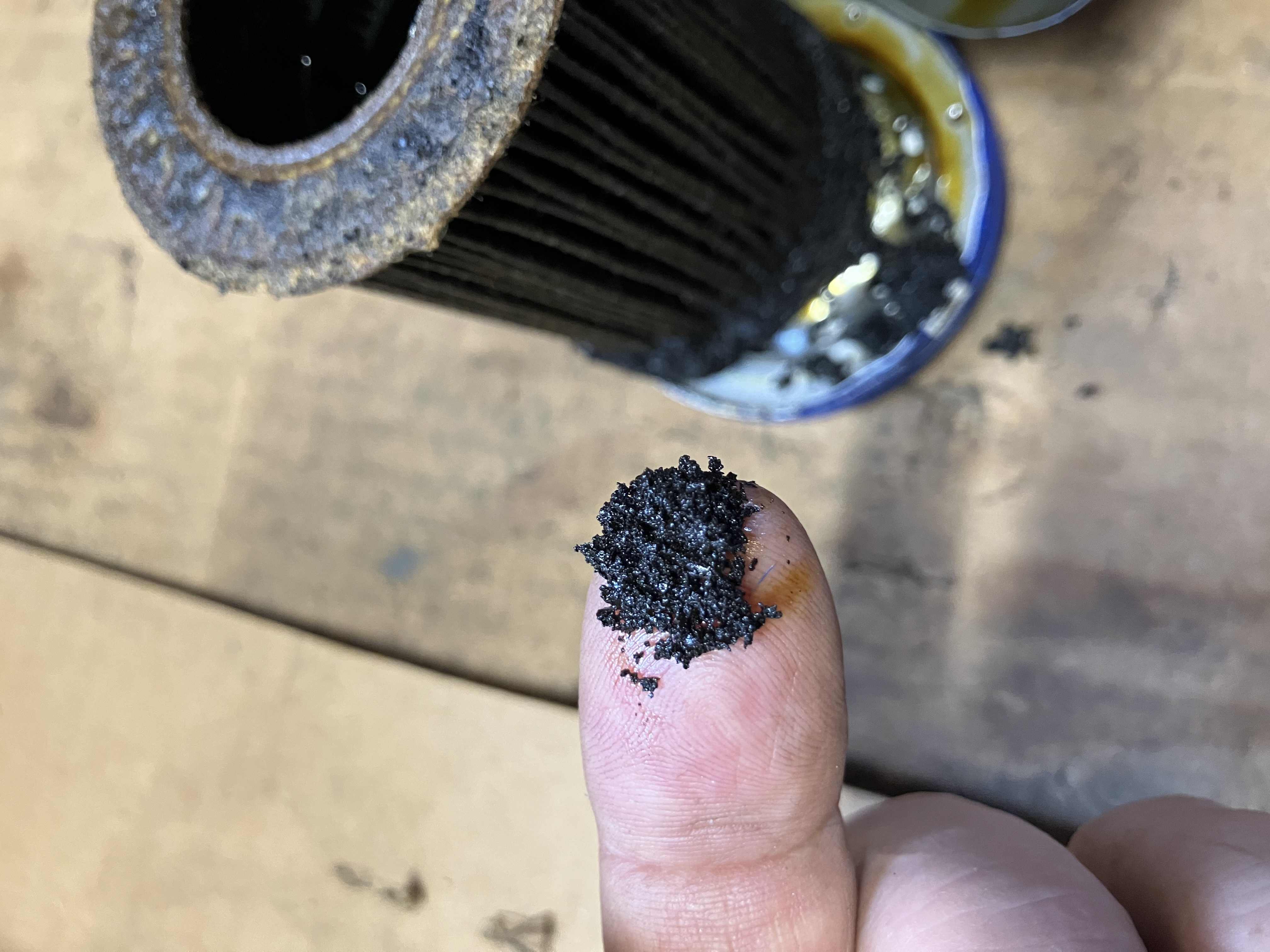

1) Routine oil change. Only reason I bring it up here is there is quite a bit of carbon showing up in the oil filter. I noticed it last time also and decided it was time for full synthetic in the truck. Don't really know if this is more or less than prior change, bit it's quite a bit.

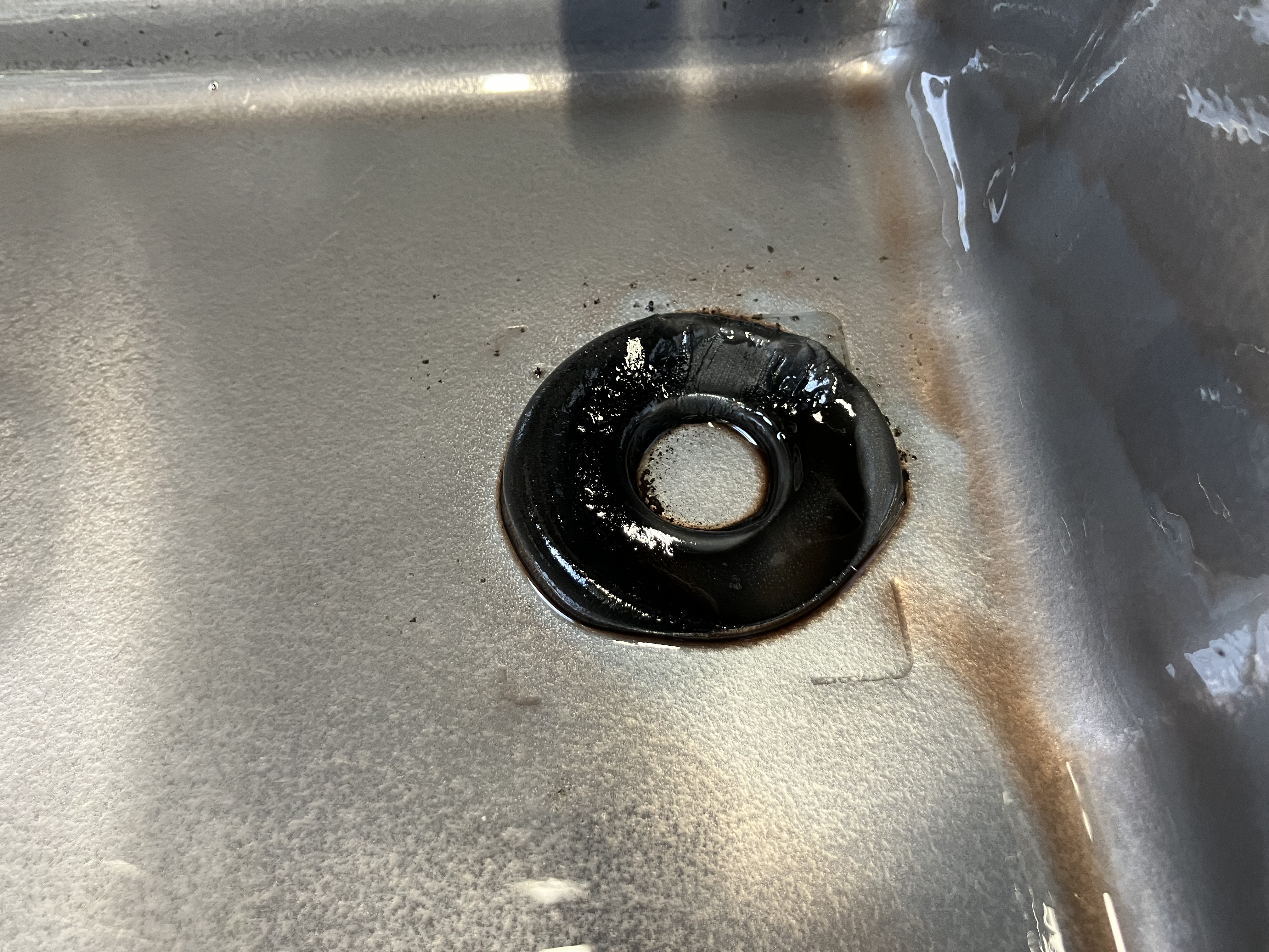

2) Transmission fluid change. At 95k and 17 years old it's time for this and a bunch of other maintenance. I tapped into the transmission line and ran it to drain out most of the fluid. The fluid looked good and I just cleaned up routine fine metal off the magnet and the pan.

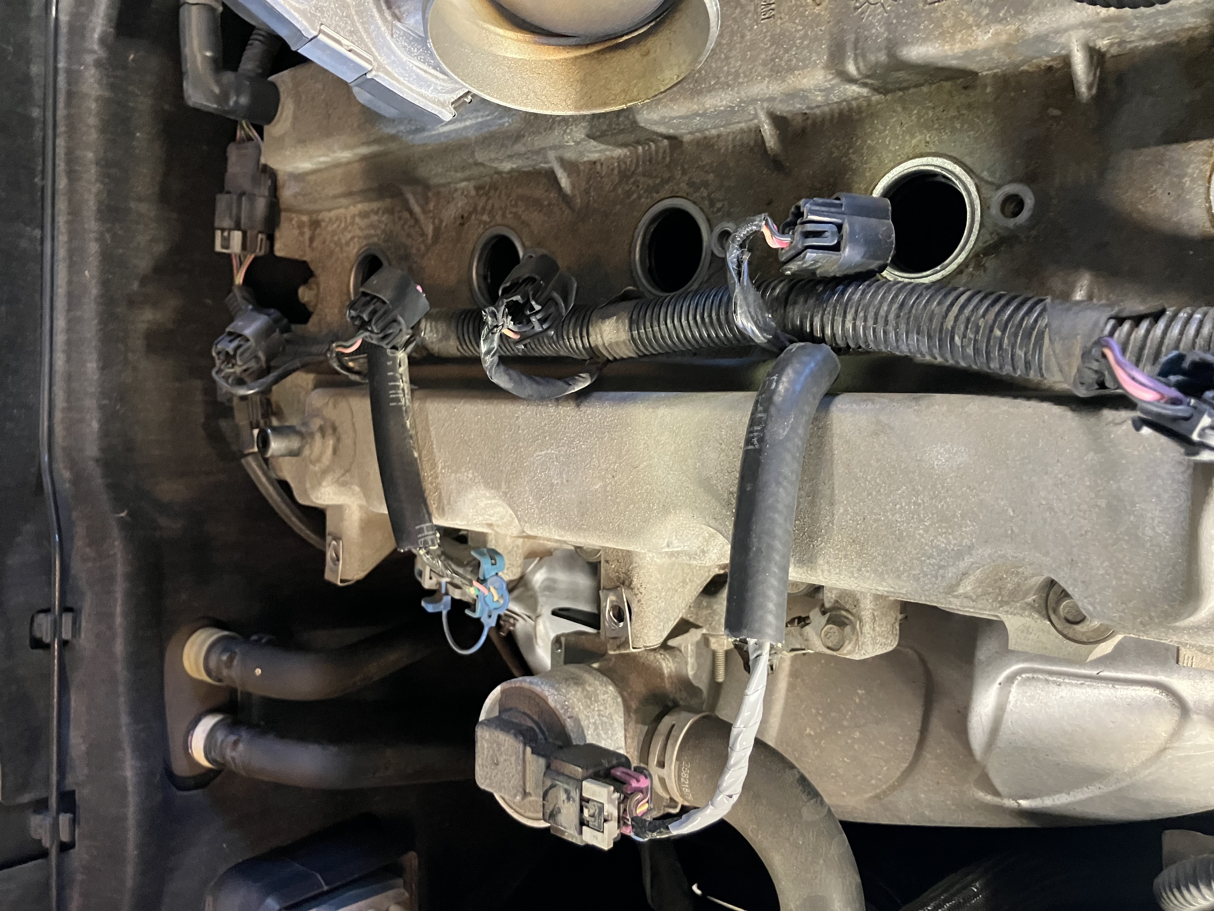

5) New spark plugs. Found a little mouse nest on the cam cover. Found a problem with some wires that had their insulation rubbed off from part of the air intake assembly. This part sits on top of the cam cover and the wires got pinched. Such a dumb design. Anyway I taped up the wires, protected them with a piece of 3/8 hose, and put some washers under the intake part to make a bit more clearance.

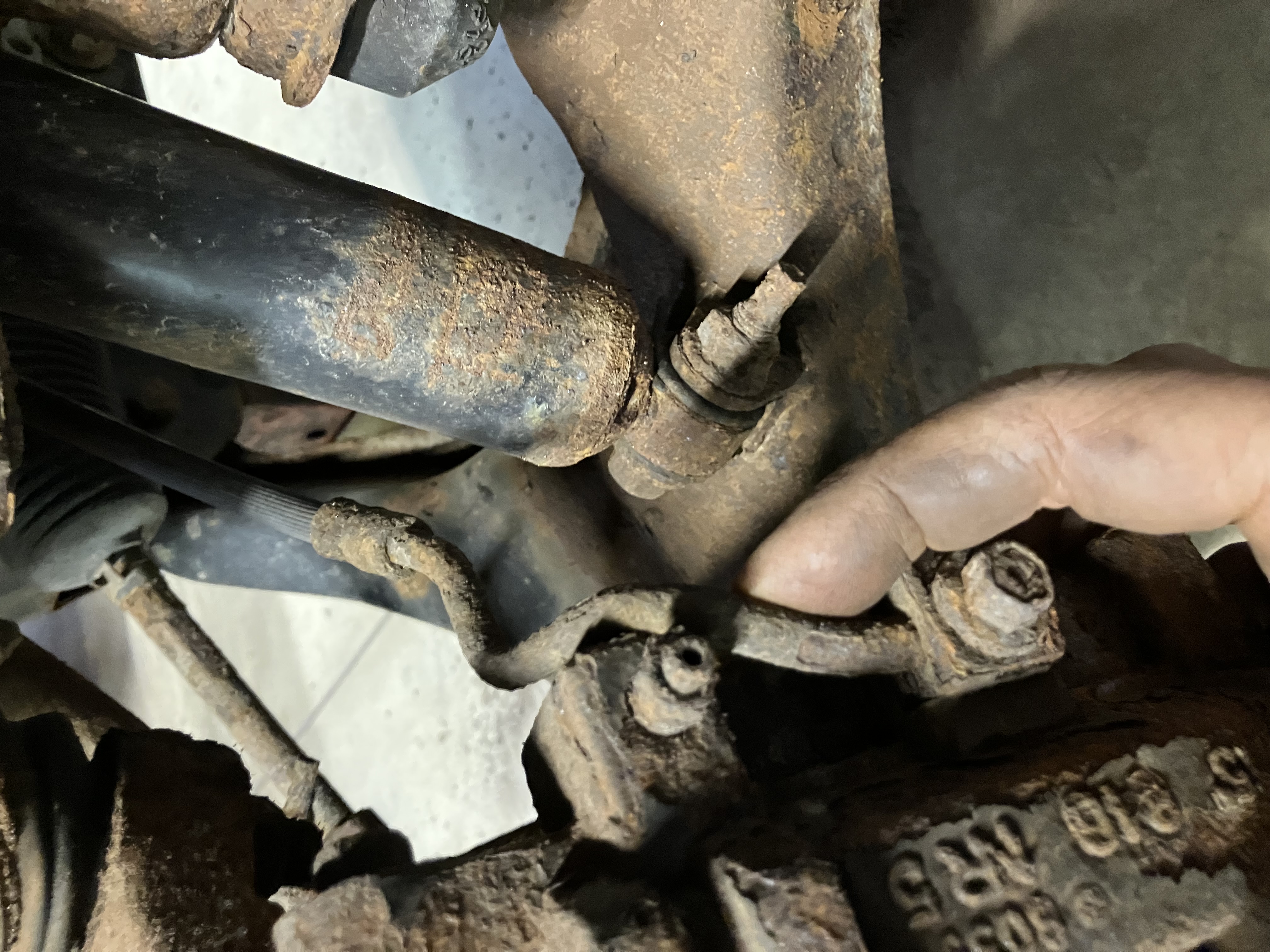

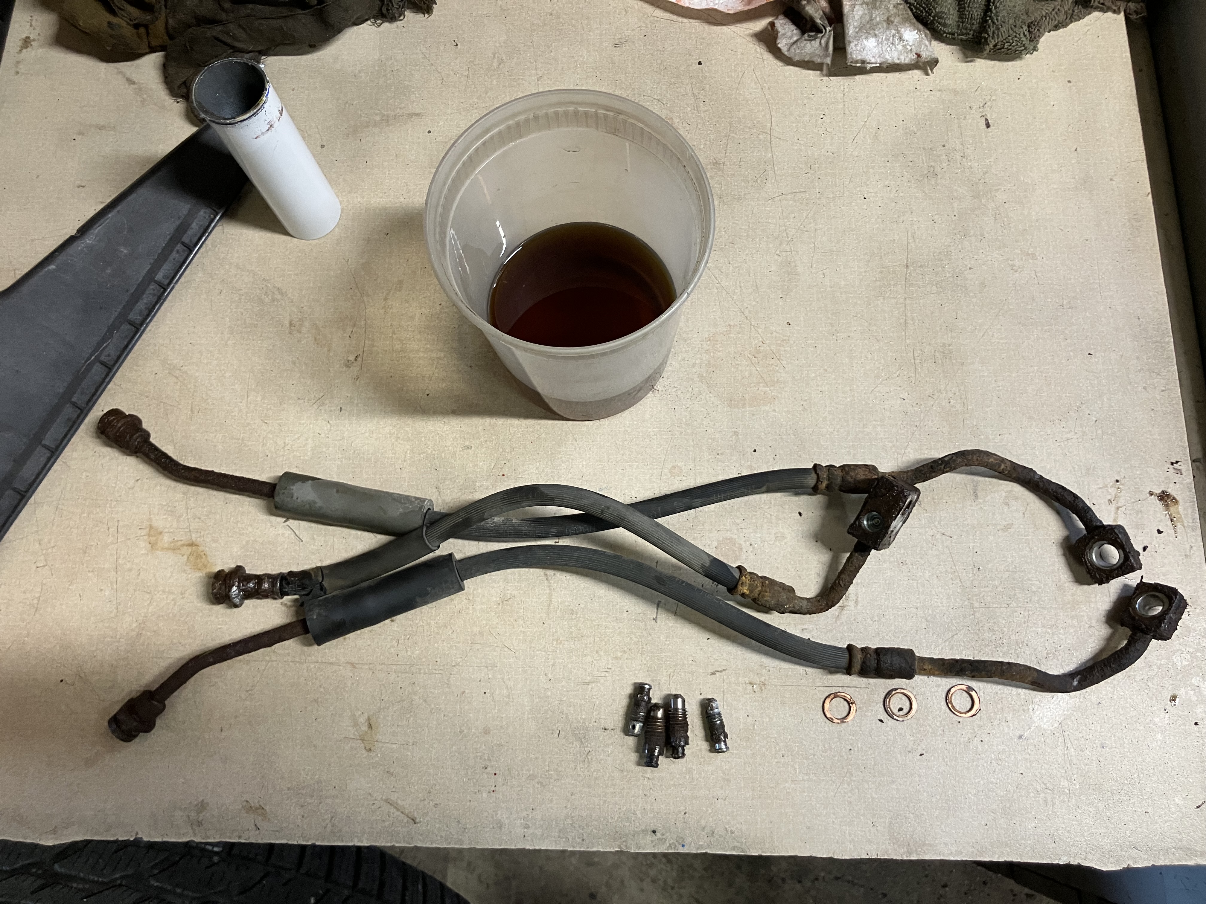

Not a fan of 17 year old brake hoses, so I replaced them
The truck has been out every winter but I was still able to remove all the brake bleeders, and was also able to remove the brake hoses from the calipers, and in the rear all the lines. There was rust on the bleeders, the flare nuts, and eye bolts. one flare nut I had to work to fit a 3/8 line wrench on what used to be a 10 mm, but it worked. I also changed out most of the fluid and adjusted the rear brake shoes.
