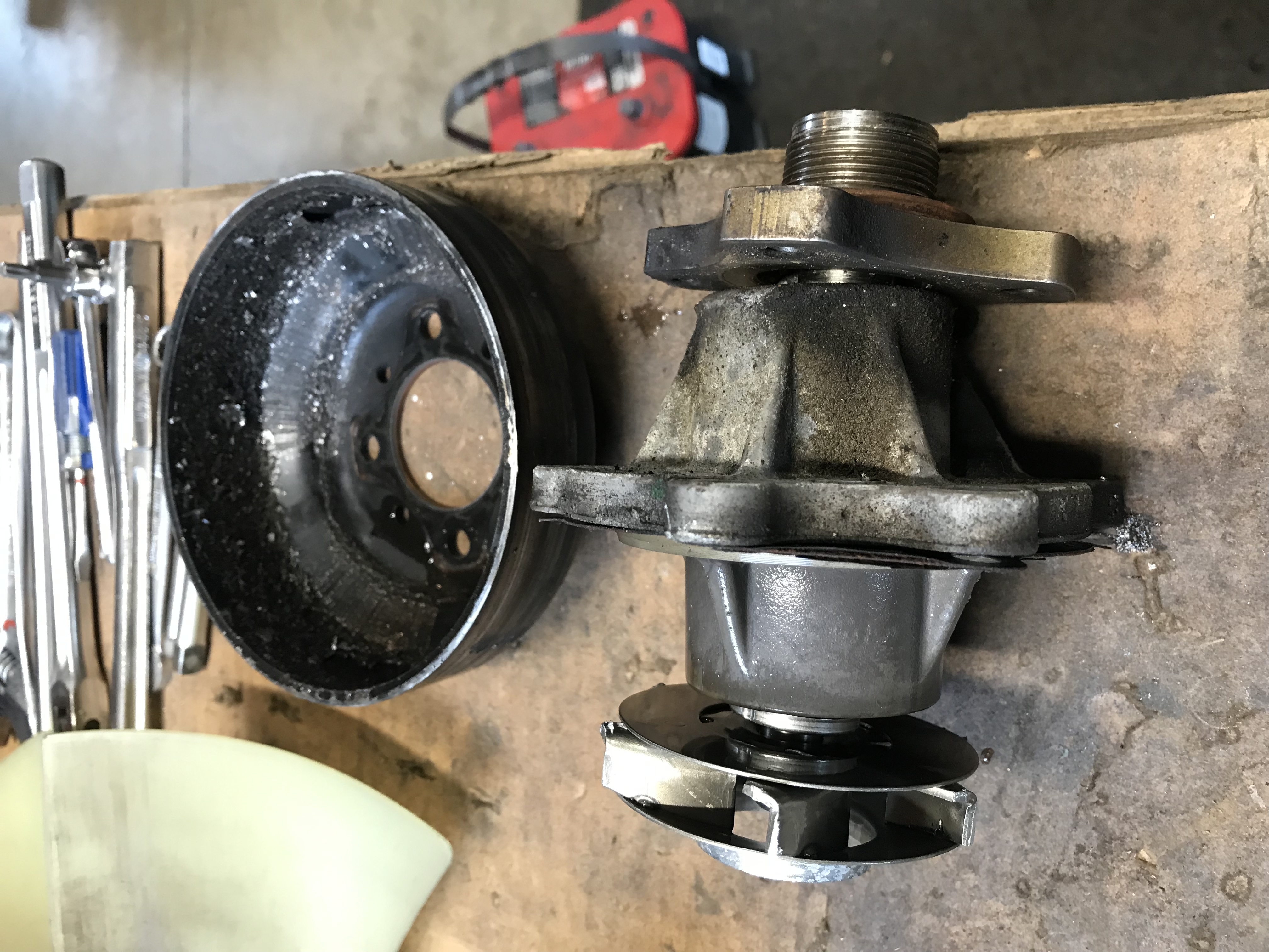

Yesterday though after 90k miles it had its first significant problem - suffering catastrophic water pump failure. The pump literally seized up and the belt was dragging down the power so she pulled over. This was about 30 minutes from home so I borrowed a truck and trailer and fetched it. To load it I just cut the belt and it started right up and drove up on the trailer.
After a couple quick video searches I had a plan ("Tank - I need a program to change a 2008 Colorado water pump").
The process was pretty straightforward. instructions called for a 36 mm wrench to remove the fan from the pump, but I used a giant 18" crescent wrench instead. It was not very tight and could probably be removed with good channel locks. The pump was so locked up I didn't need to secure it from rotating while removing the bolts and the fan.
Ordered a Melling water pump and Continental belt which will be here on Wednesday. Radiator fluid I got locally.

These parts are installed. Upon opening the water pump box the first thing I saw was a note on a yellow piece of paper that said to flush the cooling system since leftover debris from the old pump is the top reason replacement pumps fail. With this info I removed the lower radiator hose to drain out the rest of the system, flushed out the radiator, carefully cleaned inside the block in the cavity for the water pump. After install I filled the system with water and after it got up to temp I took the top hose off the radiator and let it pump a bunch of water out that way. Then drain the whole thing and fill with radiator fluid.
