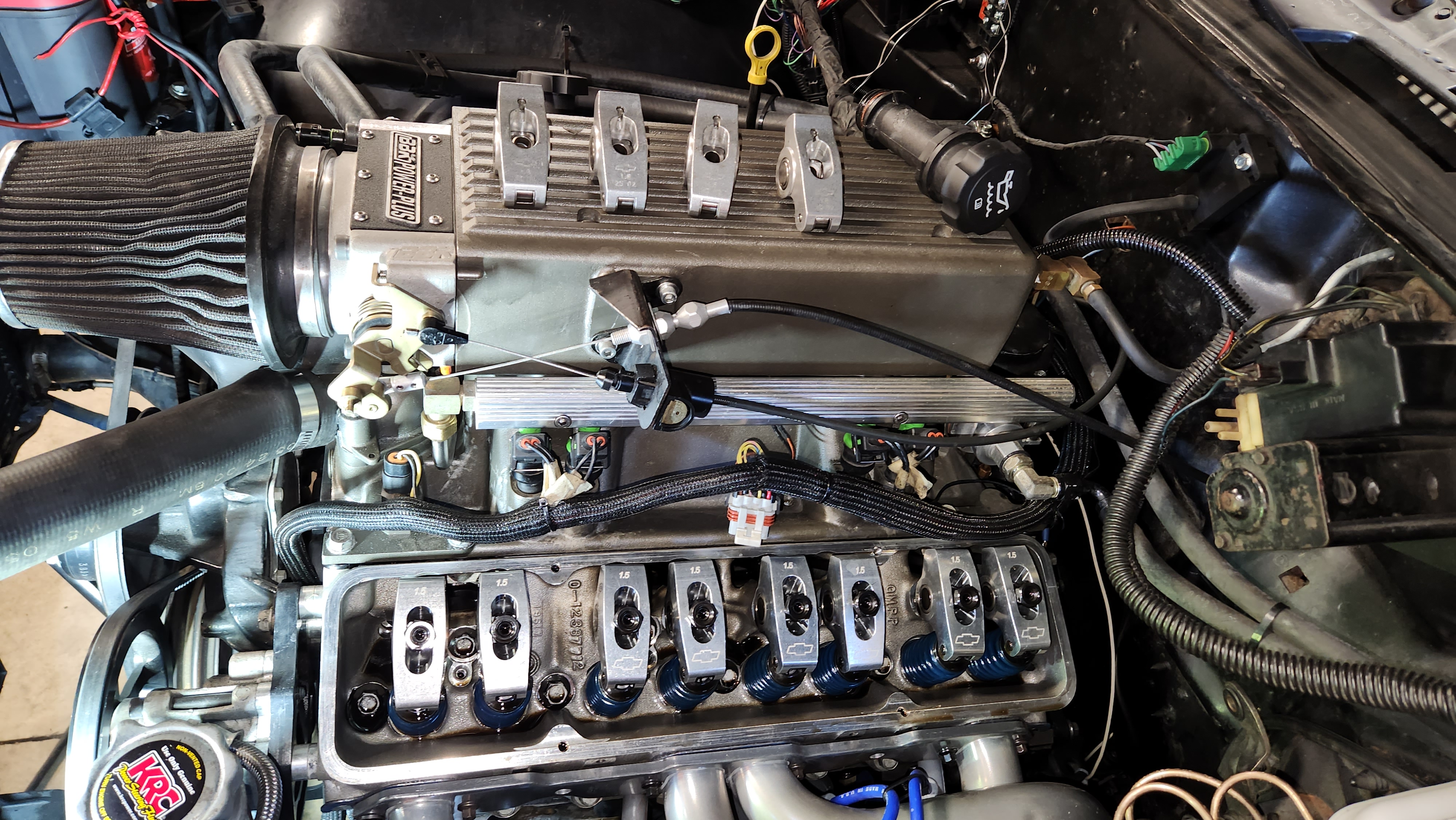

After going through my parts stash, I found a set of GM 1.6 roller rockers from a ZZ383 cam/lifters/valvetrain setup I bought a long time ago (before I bought my ZZ383 engine). Not sure why it had 1.6 rockers, my engine only has 1.5s. So tonight, I swapped the intakes for the 1.6s.
The cam is 222/230 @ .050, with .509/.528 lift. With 1.6's, I now have .542 intake lift. I purposely didn't do the exhausts. 1.6s would taken the lift to .563, and I didnt wanna push the springs past .550.

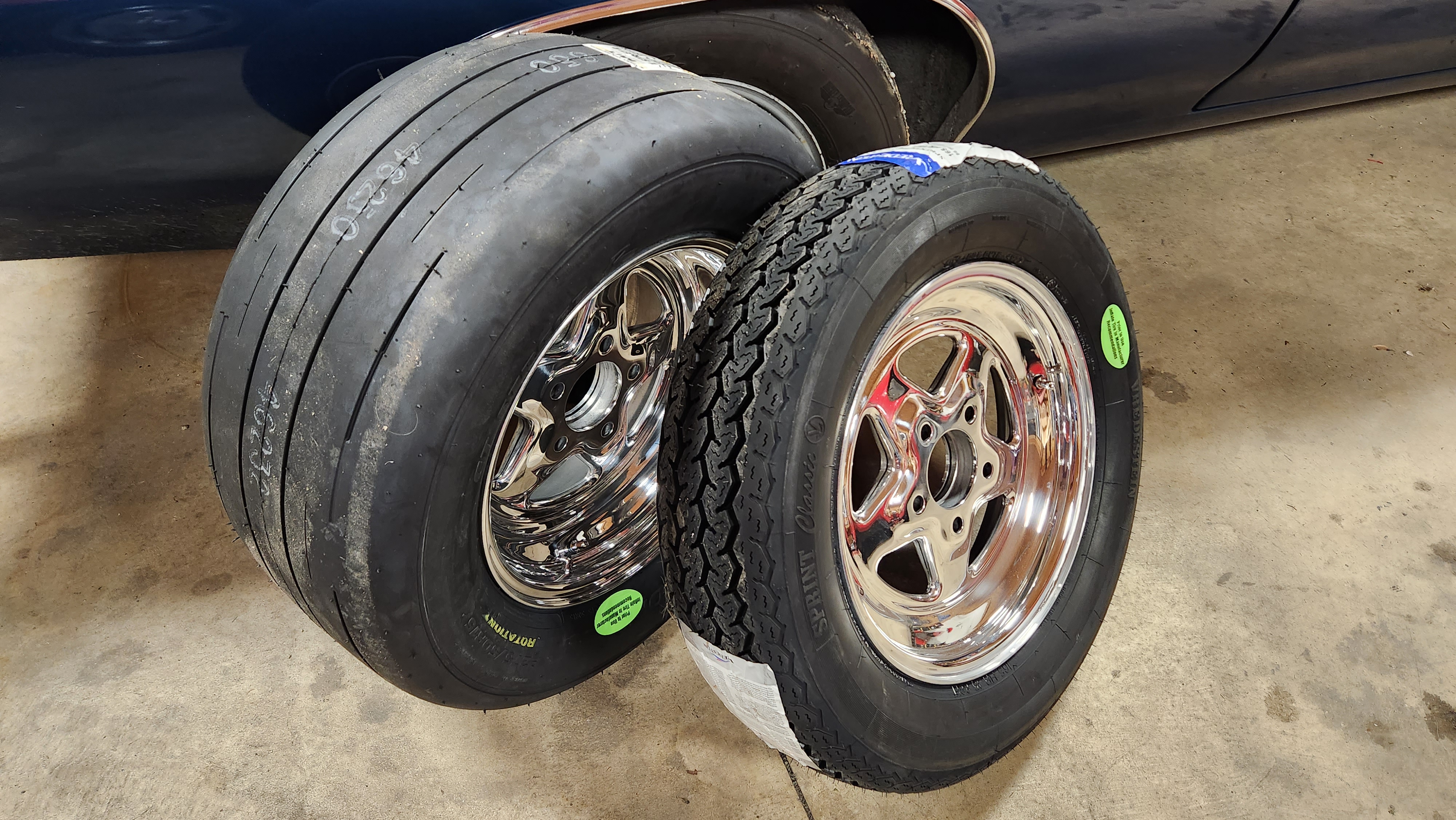

Top is the old setup. Bottom is new rears. I dont have the new fronts on yet. They are metric studs ('90 Camaro 1LE rotors) and I bought 7/16-20 lugs. I'll convert the studs to SAE in the near future, but BP has a set of metric I can use for tonight. I'll get them from him later today.

Looks good - I trust the old tires were near the end of their useful life
Posts: 2624
Re: Chevelle Projects 2023
I drove to Paul's this afternoon, and we mounted up my skinnies with his metric lugs. The car really looks great with the matching drag radials and skinnies, I love it!!
