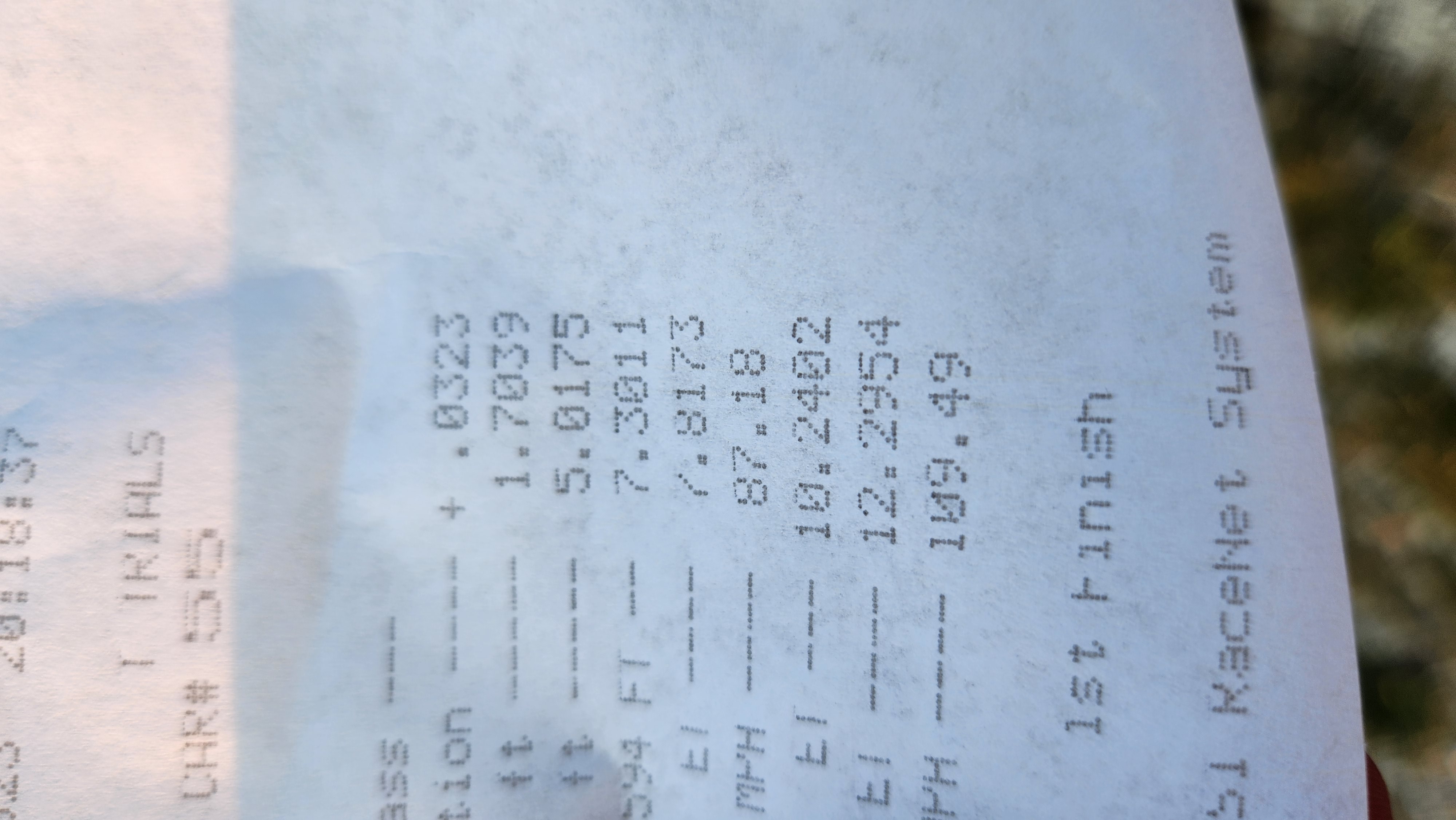

After the successful outing last Wednesday at Thompson, which saw me hitting 108 & 109 (I've only hit 109 once before, in that crazy cold day in November of '16) I figured it has to be due to the Edge Racing converter. Last time this car went down the track with this engine was Nov '20 with the Summit 10" converter. I ordered the Edge converter in Sep '20, but didnt install it right away. It first got installed in Feb '21 with the ill-fated Vortec 408. It was then behind my Dart400. But when I ordered it, I gave them all the details for the ZZ383.

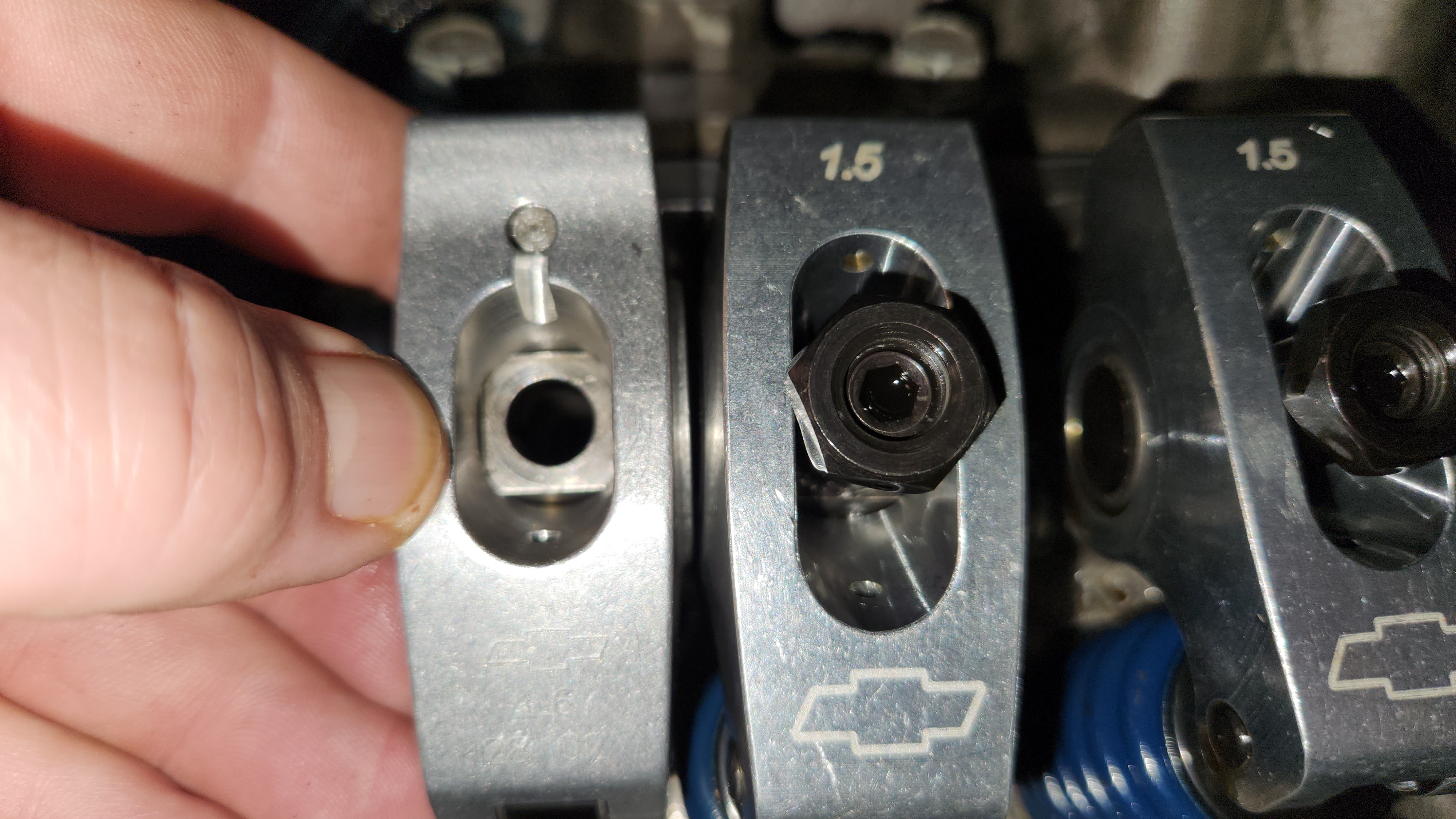

After going through my parts stash, I found a set of GM 1.6 roller rockers from a ZZ383 cam/lifters/valvetrain setup I bought a long time ago (before I bought my ZZ383 engine). Not sure why it had 1.6 rockers, my engine only has 1.5s. So tonight, I swapped the intakes for the 1.6s.
The cam is 222/230 @ .050, with .509/.528 lift. With 1.6's, I now have .542 intake lift. I purposely didn't do the exhausts. 1.6s would taken the lift to .563, and I didnt wanna push the springs past .550.
I manually adjusted my fuel table where the launch issue was happening. I took a drive over to Tony's with the auto-tune running while I drove there and back. It felt strong!
Will I hit 110 on Wed???? *fingers crossed*

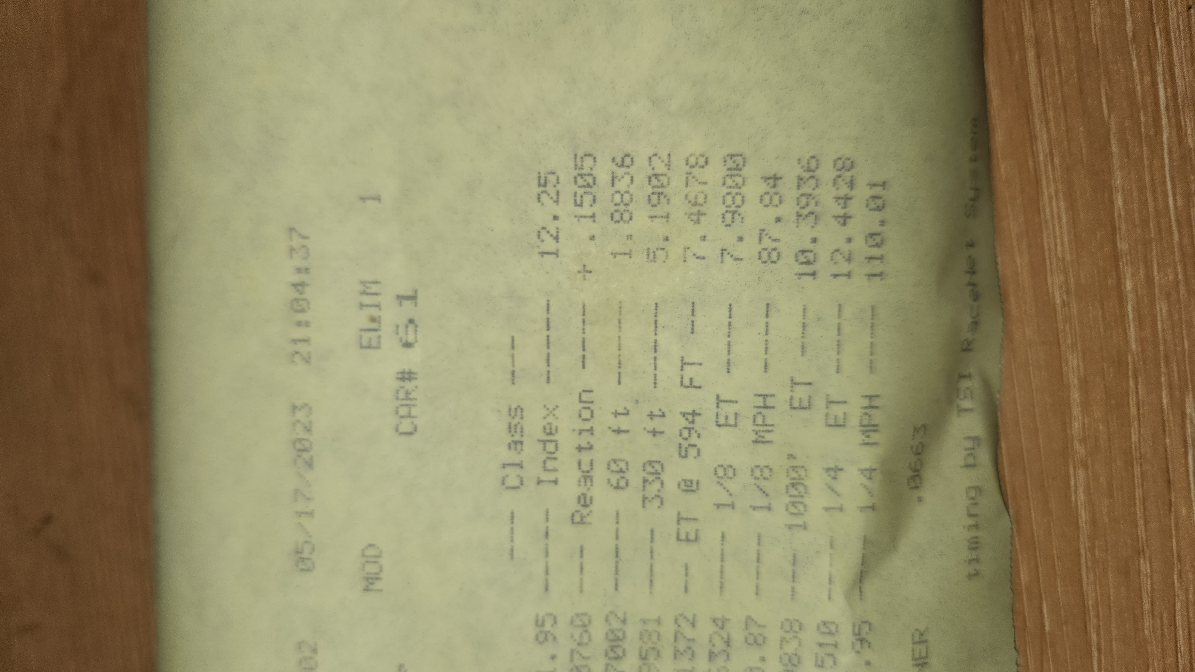

WOOHOO, I made it! It was my final round loss, but I hit 110!!

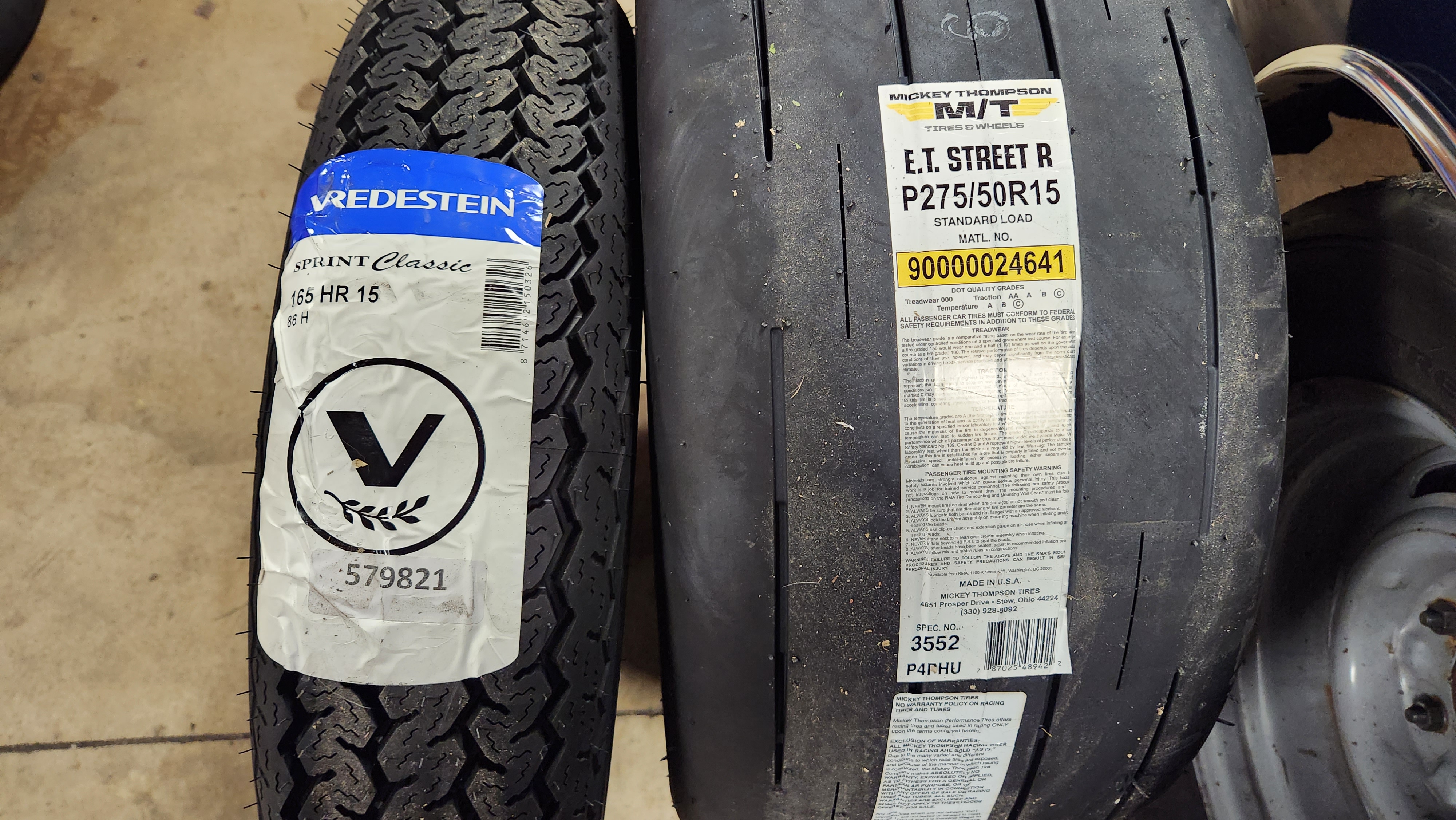

More pics...

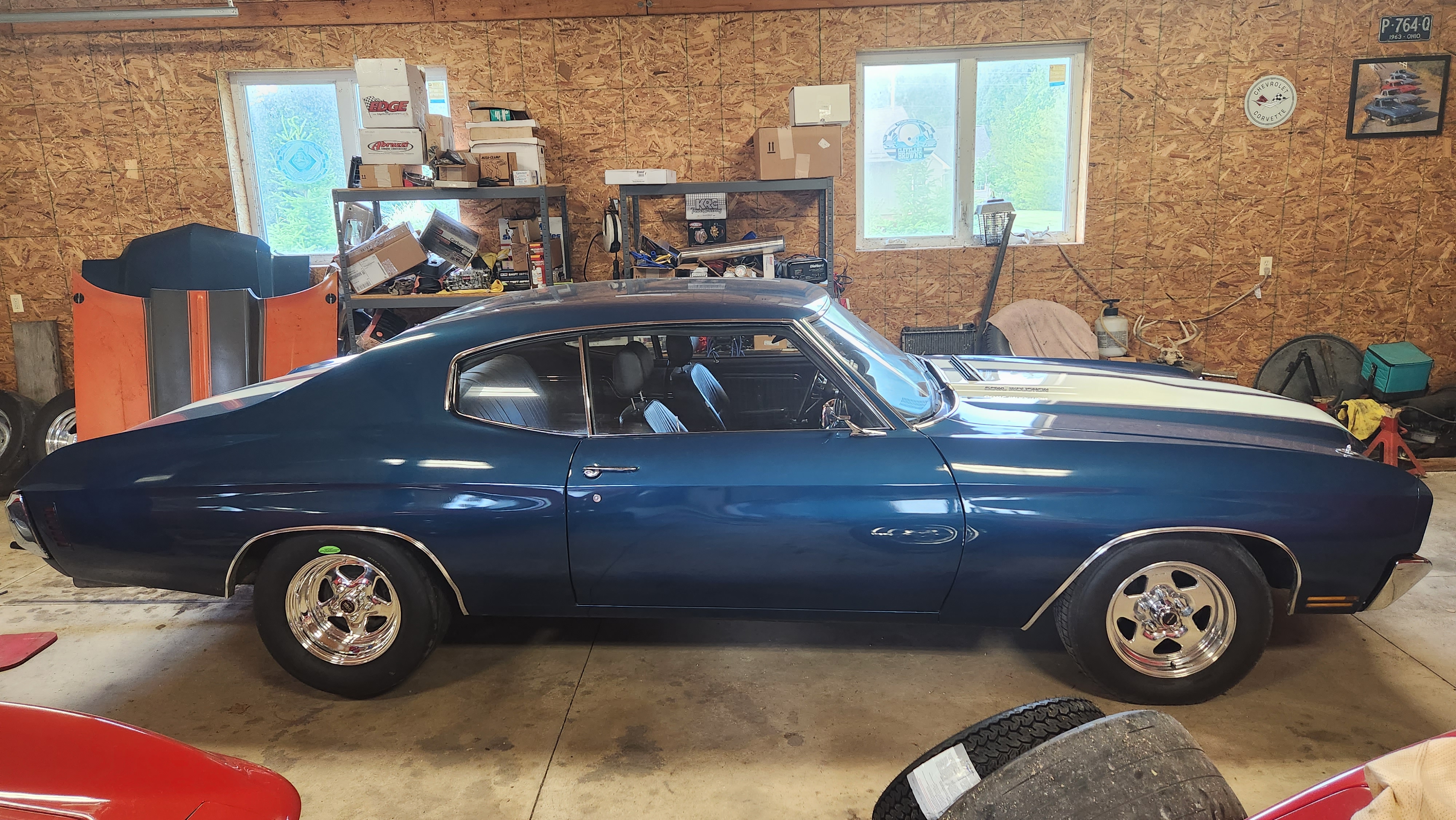

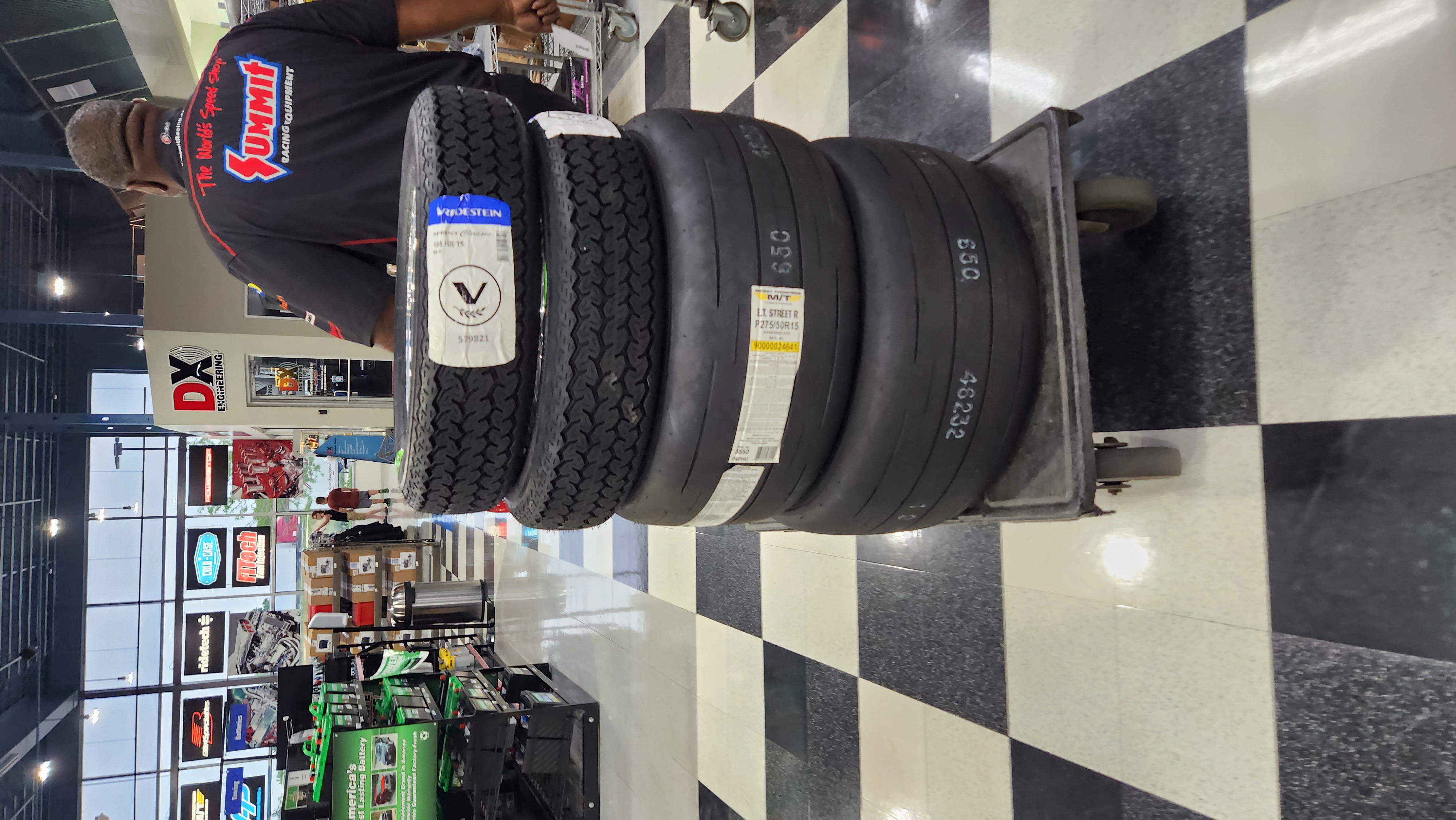

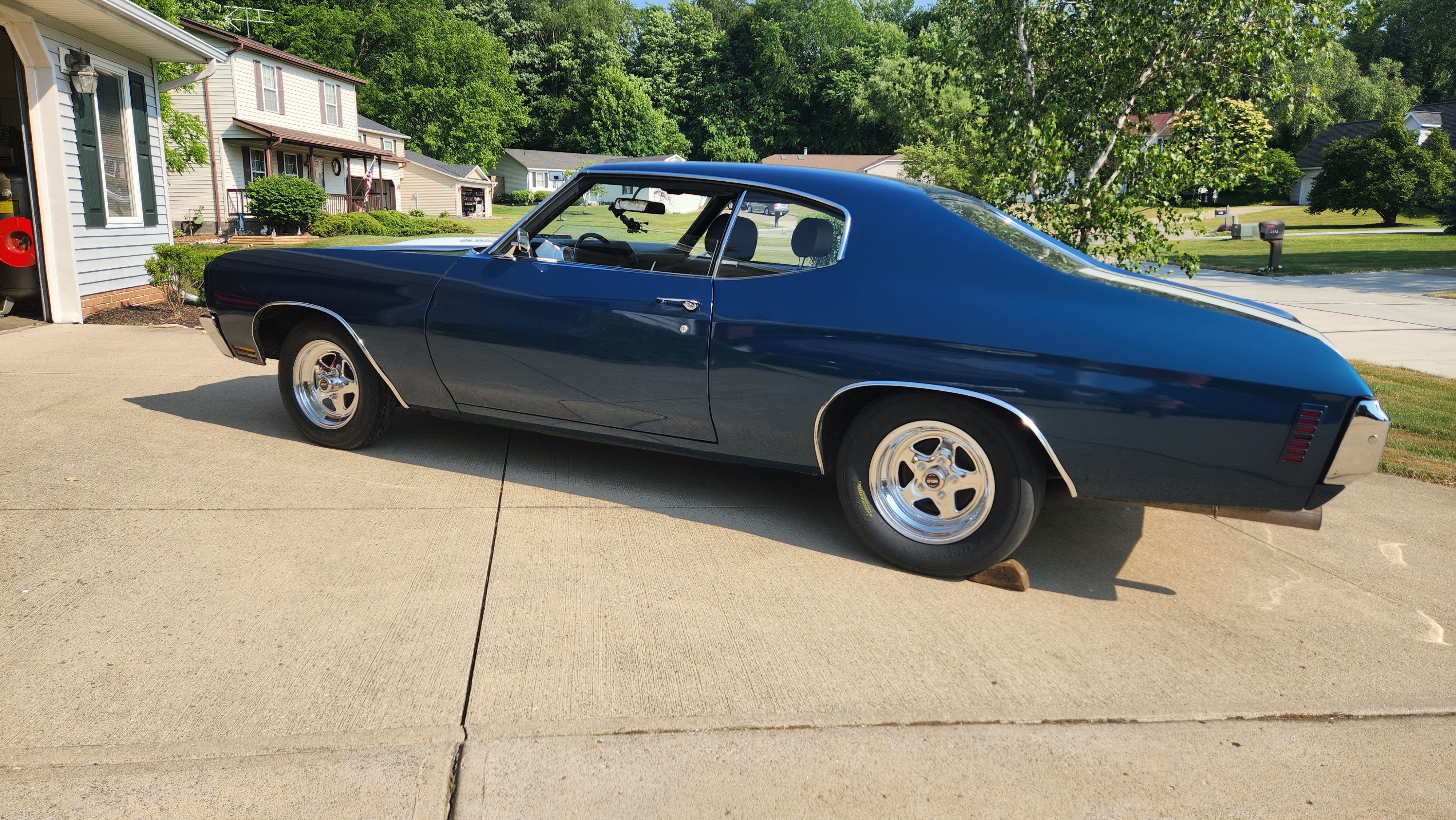

Top is the old setup. Bottom is new rears. I dont have the new fronts on yet. They are metric studs ('90 Camaro 1LE rotors) and I bought 7/16-20 lugs. I'll convert the studs to SAE in the near future, but BP has a set of metric I can use for tonight. I'll get them from him later today.

Looks good - I trust the old tires were near the end of their useful life
- Posts: 2641
Re: Chevelle Projects 2023

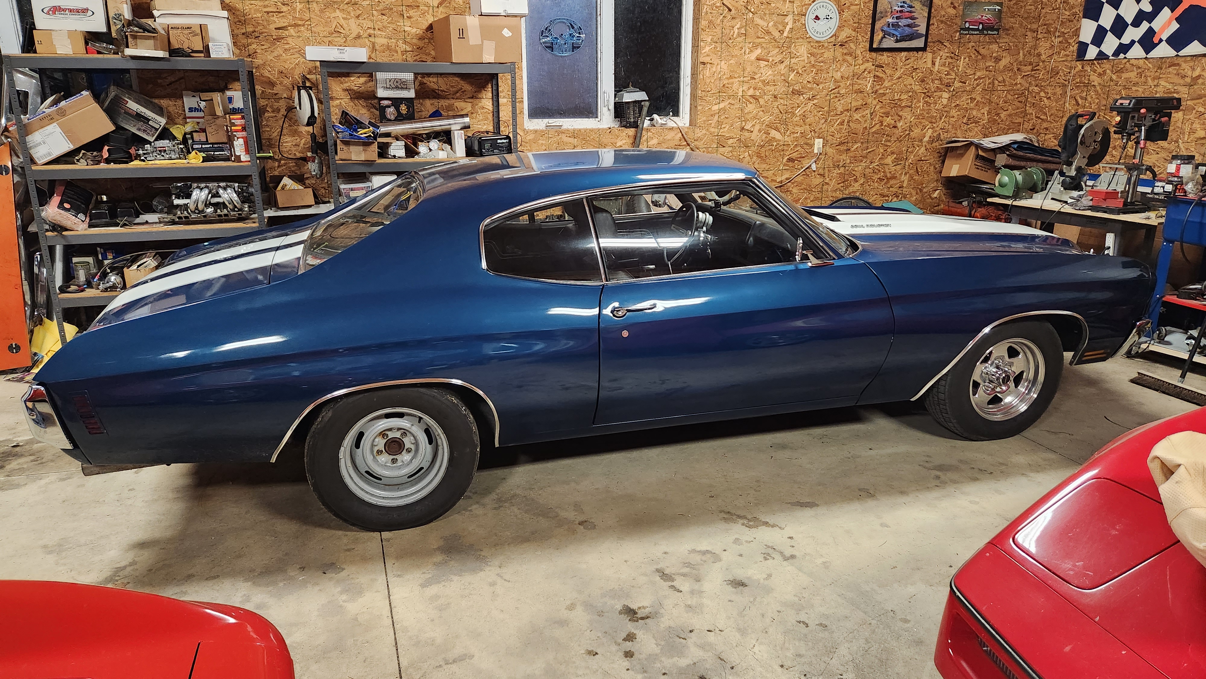

I drove to Paul's this afternoon, and we mounted up my skinnies with his metric lugs. The car really looks great with the matching drag radials and skinnies, I love it!!

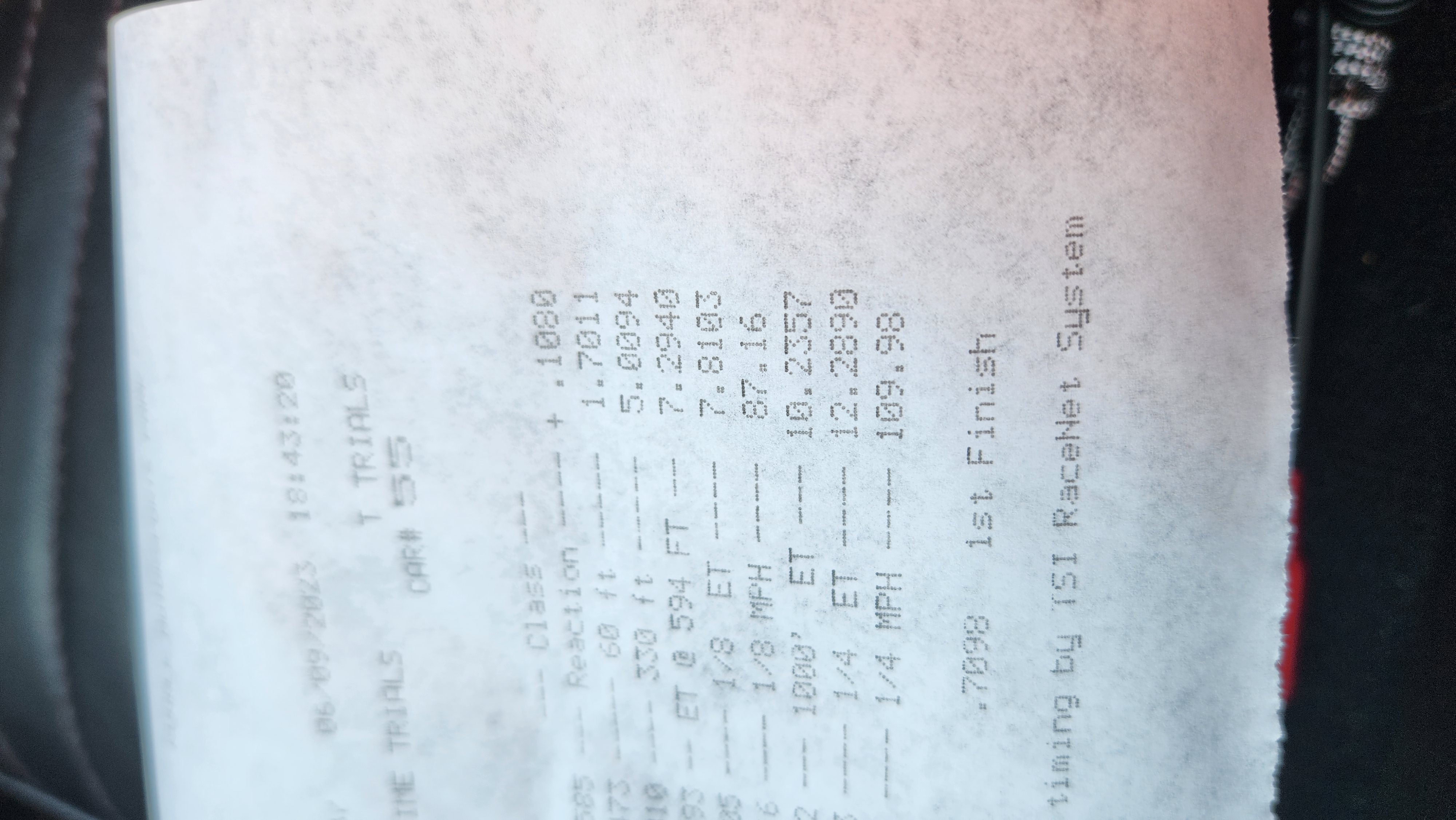

I left Paul's and went out to the dragstrip tonight for their Friday night Test n Tune and boy, was it worthwhile. I was solidly in the 12.20s @ 109. First pass I went 109.98 MPH and it was the closest I'd get to 110 tonight.
I made seven passes between 6:45pm and 9:20pm, and they were all within .04 -- 12.26 was best, 12.30 was worst. All were 1109 mph. And I had several .0x lights
I took a bunch of Accel Enrichment out of my tune. I cut in in half, then cut it some more. And that has more or less cured my off-the-line stumble. Best 60 foot tonight was a 1.67. 60-foots were pretty much between 1.67 and 1.70. I can reliably mash the pedal off the line now. I feel like it could do better down there, I'm still going way rich first 3/4 second after I leave the line. But it's VERY raceable as it is, and I'm really looking forward to Wednesday.
Driving on the street with the skinnies up front -- I didn't hardly notice them at all. I sometimes push it a bit through the curves on Wilson Mills and such. I was worried that it was going to be a little sketchy, but it was just fine.
