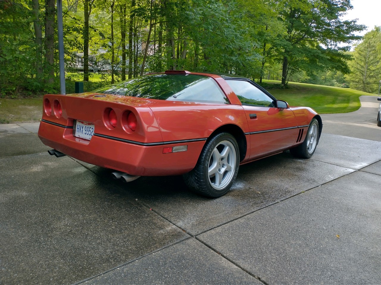

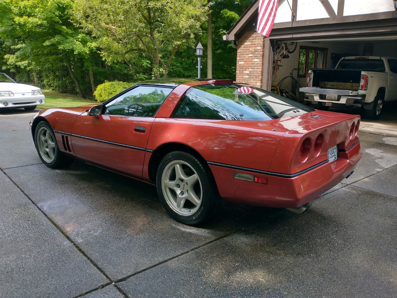

Today we got the Camaro SS / 1996 Corvette 17" wheels installed. While doing this we greased up all the fittings we could find on the front and rear (they NEEDED it) and gave the car a real solid safety inspection. As of right now I think it would easily handle the dragstrip and probably an autocross. But we're going to check the timing before we drag it, and at least put new performance pads on before we autocross it.
Then it got a much needed bath. It looks pretty good, and will like being buffed out and waxed next week. But the car is titled, insured, and plated, so we can drive it anywhere we want.
We also made a big list of things that we want to do to it as we move on and start thinking about road racing. That list is much longer and will require quite a bit of time and some expense. It was good to find NO drops of anything on the floor when we moved it out of the garage. Not too many 35 year old small blocks can say that. How long that will last after the abuse is tough to say...

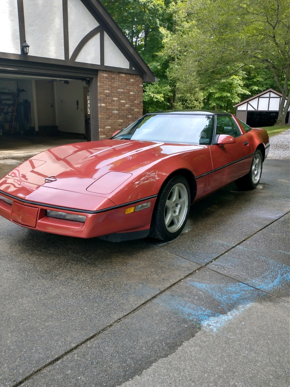

Your new Vette appears in the pictures to be a watermelon color. Is that accurate? I like those wheels, too. Same as the ones on Silvia.

The factory color is code 74 - dark red metallic. The car was repainted recently to what I believe is the same color. There is so much green around it might be affecting the perception, or who knows if the guy got the right paint. Doorjambs were not repainted and it seems to match reasonably well there.

I think the color is pretty accurate despite it's quality. Dark red metallic is just a terrible description of it. In person its more copper / orange as I see it at least. Pretty unique if nothing else, and puts up a nice appearance.
The wheels are the same as yours WXO, except mine are from a Camaro and have SS centers. They were leftovers from the TrackBird era.

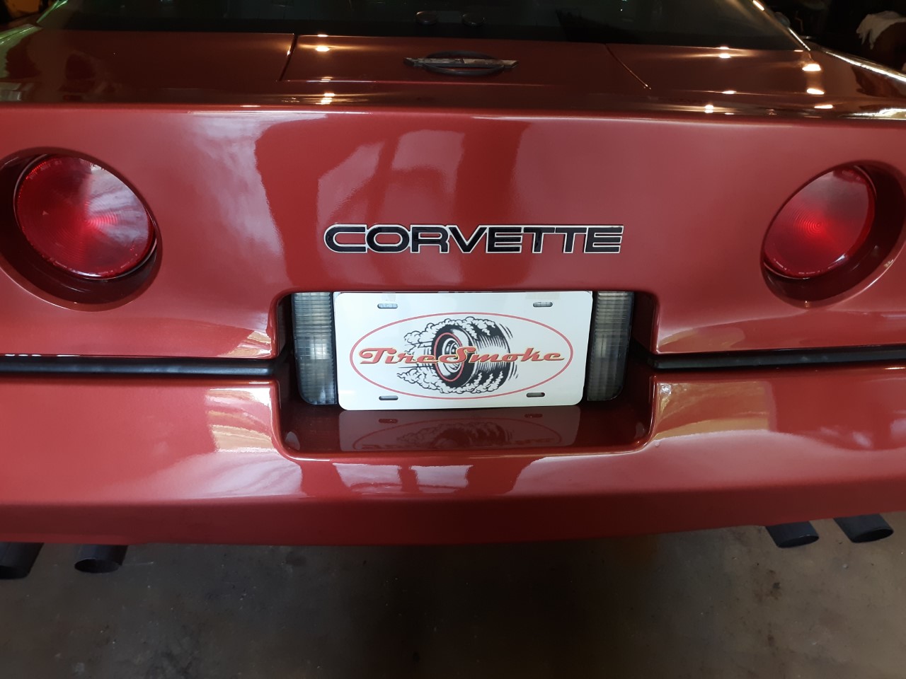

Also, I found on FB a NOS rear Corvette badge about 10 min from my house. I picked it up for $30 and we put in on yesterday. No pics.

"Also, I found on FB a NOS rear Corvette badge about 10 min from my house. I picked it up for $30 and we put in on yesterday. No pics."
