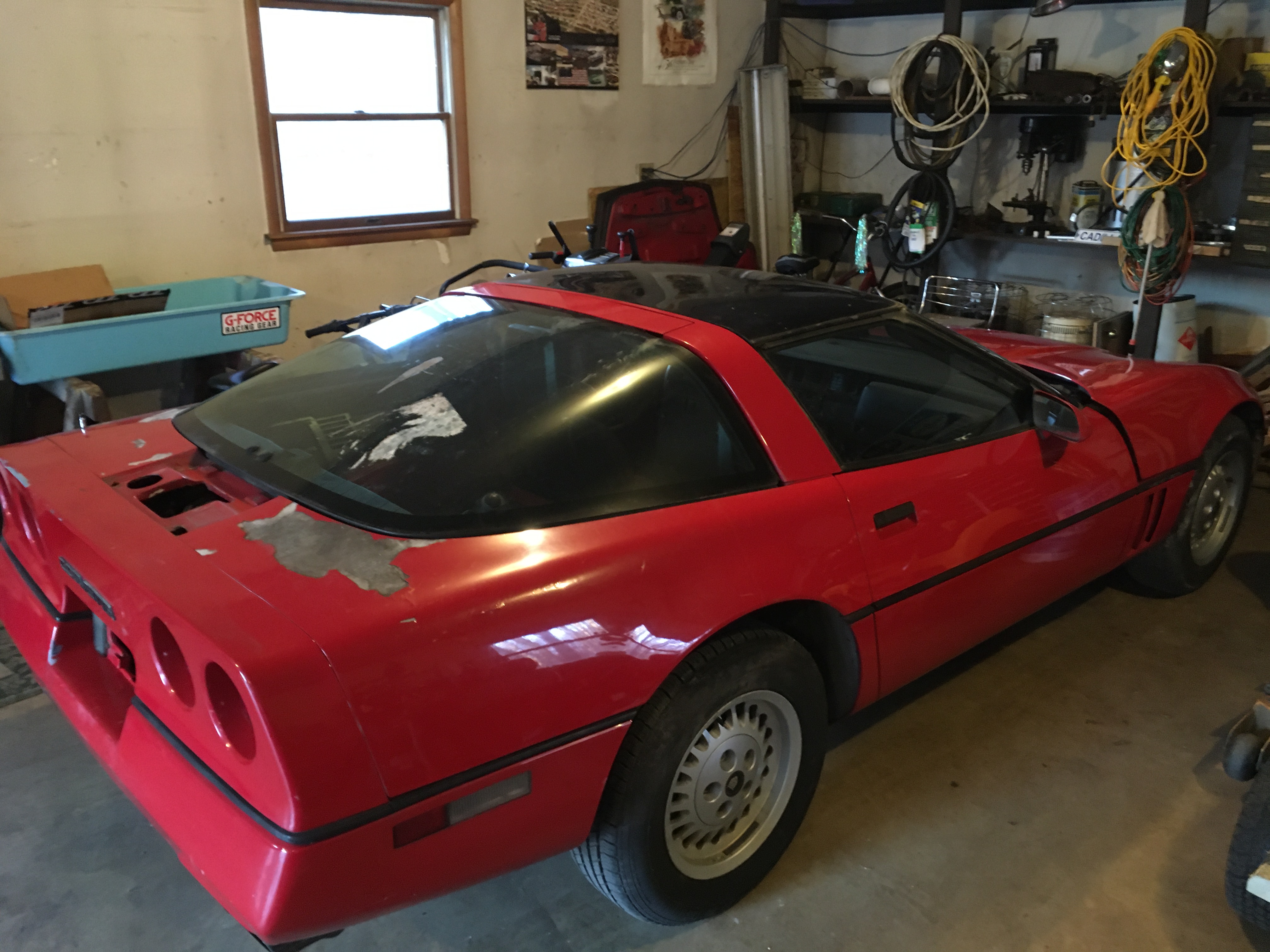

Today I added a backup/parts car to the collection.
It's an 89 with just over 100k miles. It has Jaguar wheels and 205/70/15 tires! Seller said prior owner could not afford the bigger tires and he heard that others were running them.
Quick check shows it does not have the power steering cooler, or the Z51 suspension, but it does have the KC4 factory oil cooler.
The interior carpet is out, probably some other parts missing, but the dash all intact. Seats are red but they are shot like the other one.
It had no battery and the rotors are quite rusted it did not move easily.
Under hood looks remarkably busy

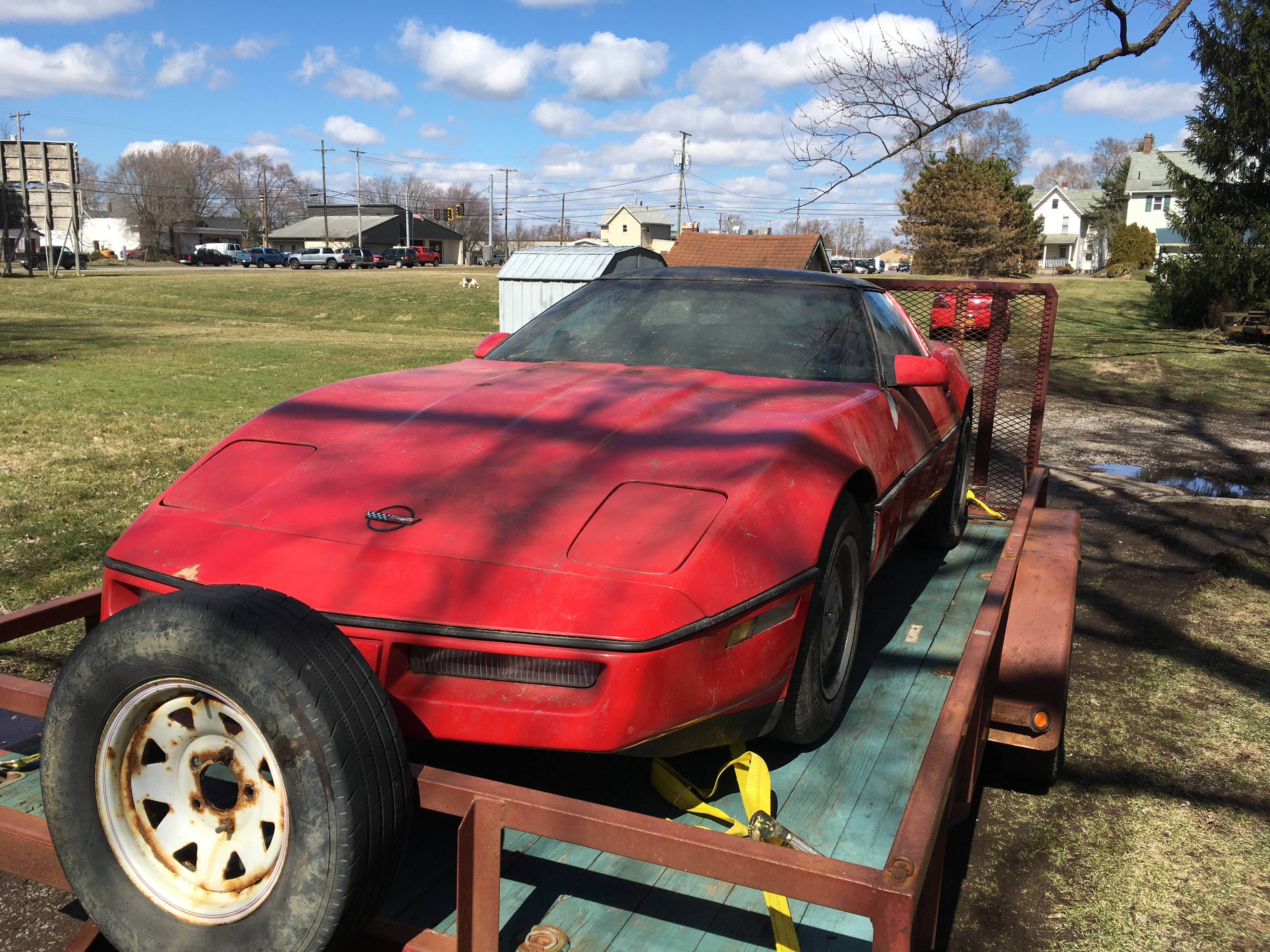

Today managed to get the car off the trailer. Just backed the trailer up to the door, jacked up the front of the trailer and it basically rolled off.

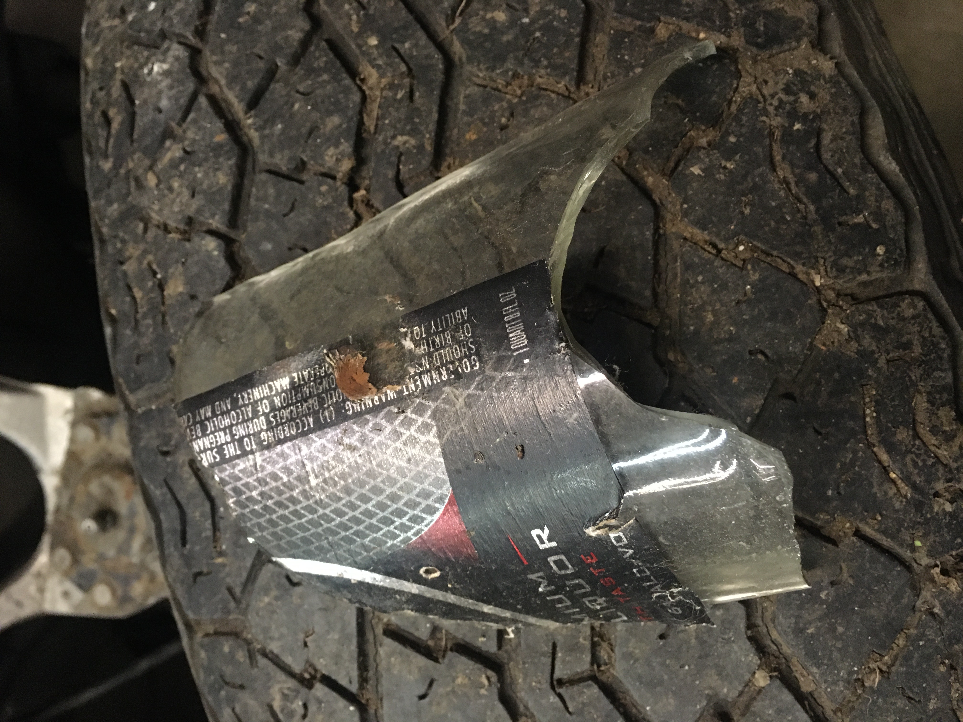

Also found this stuck between the frame and the exhaust pipe ahead of the pre-cat.

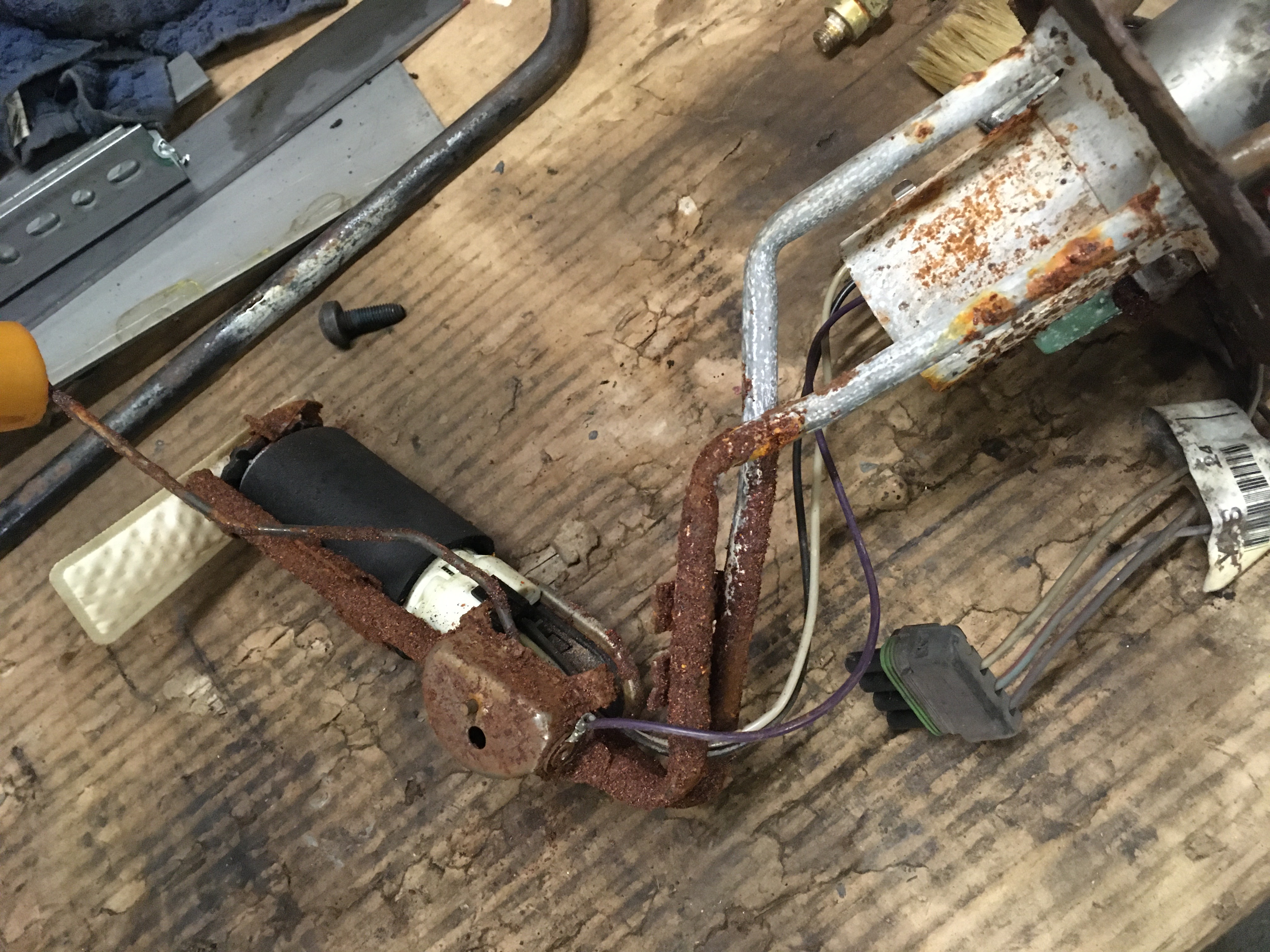

Then I started in on the fuel system. 4 of the 9 bolts holding the fuel sending unit to the tank broke, so I will have to drill \/tap The gasket was glued/rusted to the tank I couldn't save it so I'll have to do something to replace that also.
There was no gas in the tank, only a few ounces of water which I attribute to condensation that got caught in there. This made the rust cleanup easy at the top of the tank as sparks cant cause fires. It did rust the sending unit so I'll have to clean that off. I took some time to clean out the inside of the tank - it was like deja vu from the last one.

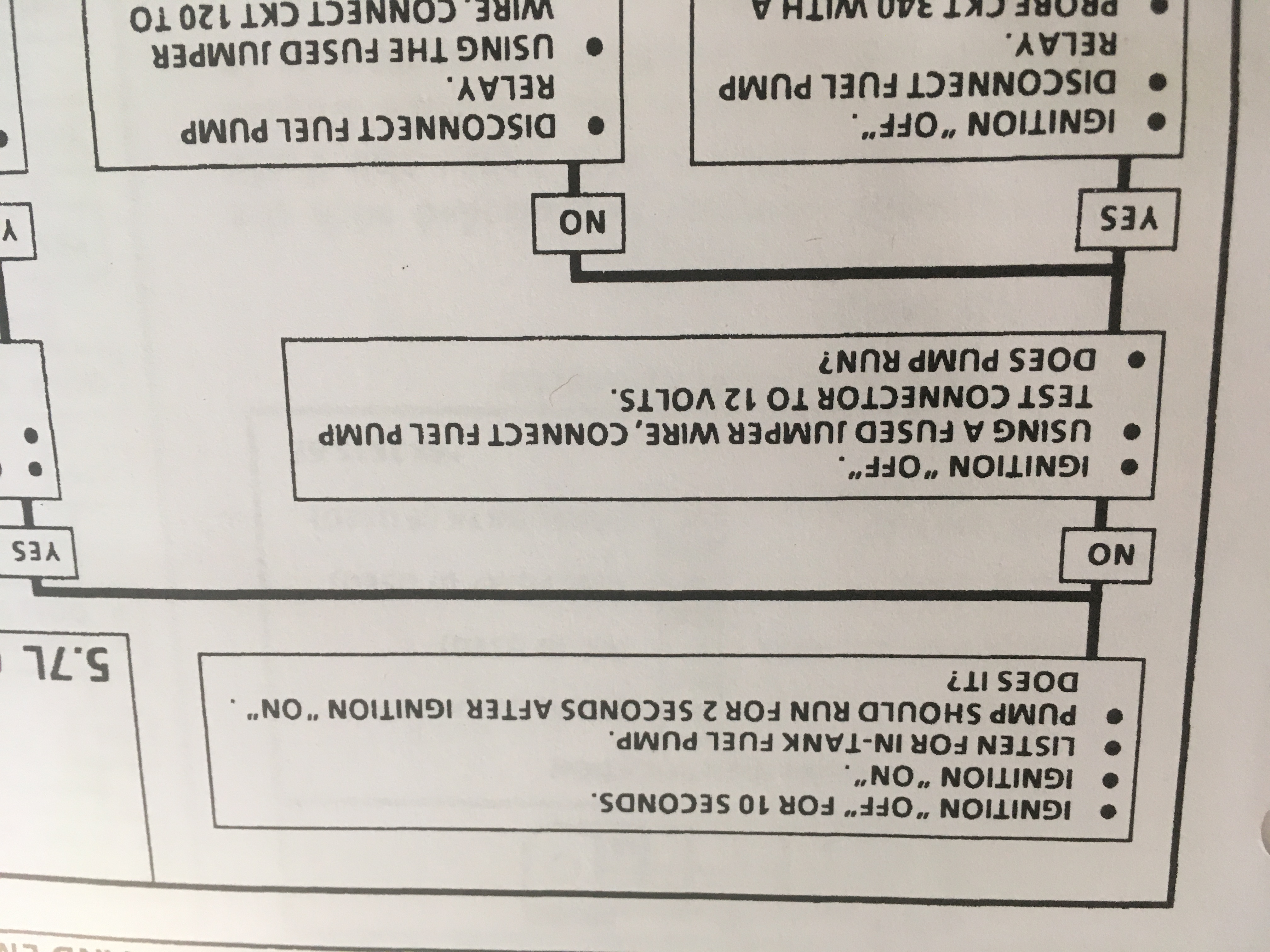

I also put power to the fuel pump and it cycles, meaning I should be able to use it for a real start up test.

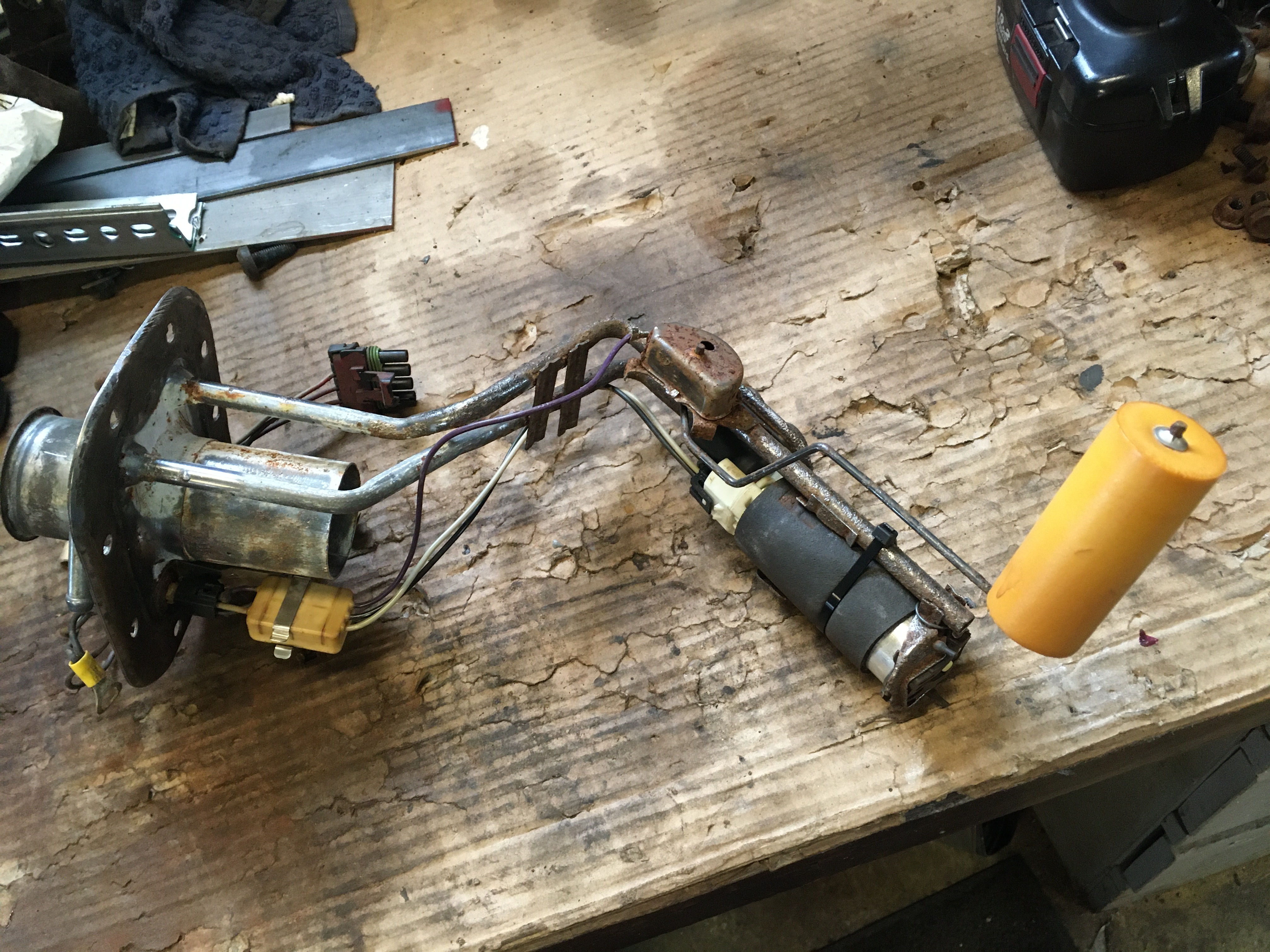

tonight I managed to drill out and retap the four broken bolts that hold the sending unit in place. Tomorrow will have the chance to start it.

Yesterday I cleaned all the rust off the sending unit, cleaned up the connections and did a little more cleaning on the inside of the tank. Also had to clean the glue off and flatten the sending unit - the metal around the bolt holes was beveled in from bolts that were tightened too far.
the "new" fuel sock was rusted on the ring where it connects to the pump so I had to replace it. Had to correct the bend in the tubes they were bent over a bit too far. The fuel pump that was in the car did cycle once before I did all that work - but then it died. Took me a while to figure this out - eventually I put it in the other Vette and lo and behold it did not work there either. I took the fuel sending unit from the other Vette and put it into this one, and added a couple gallons of gas. I left the fuel return line off and connected a hose to it and into a bucket, then used the diagnostic port to run the pump and push gas through the system til clean gas was coming through. At this point I dumped a can of fuel injector cleaner into the tank.

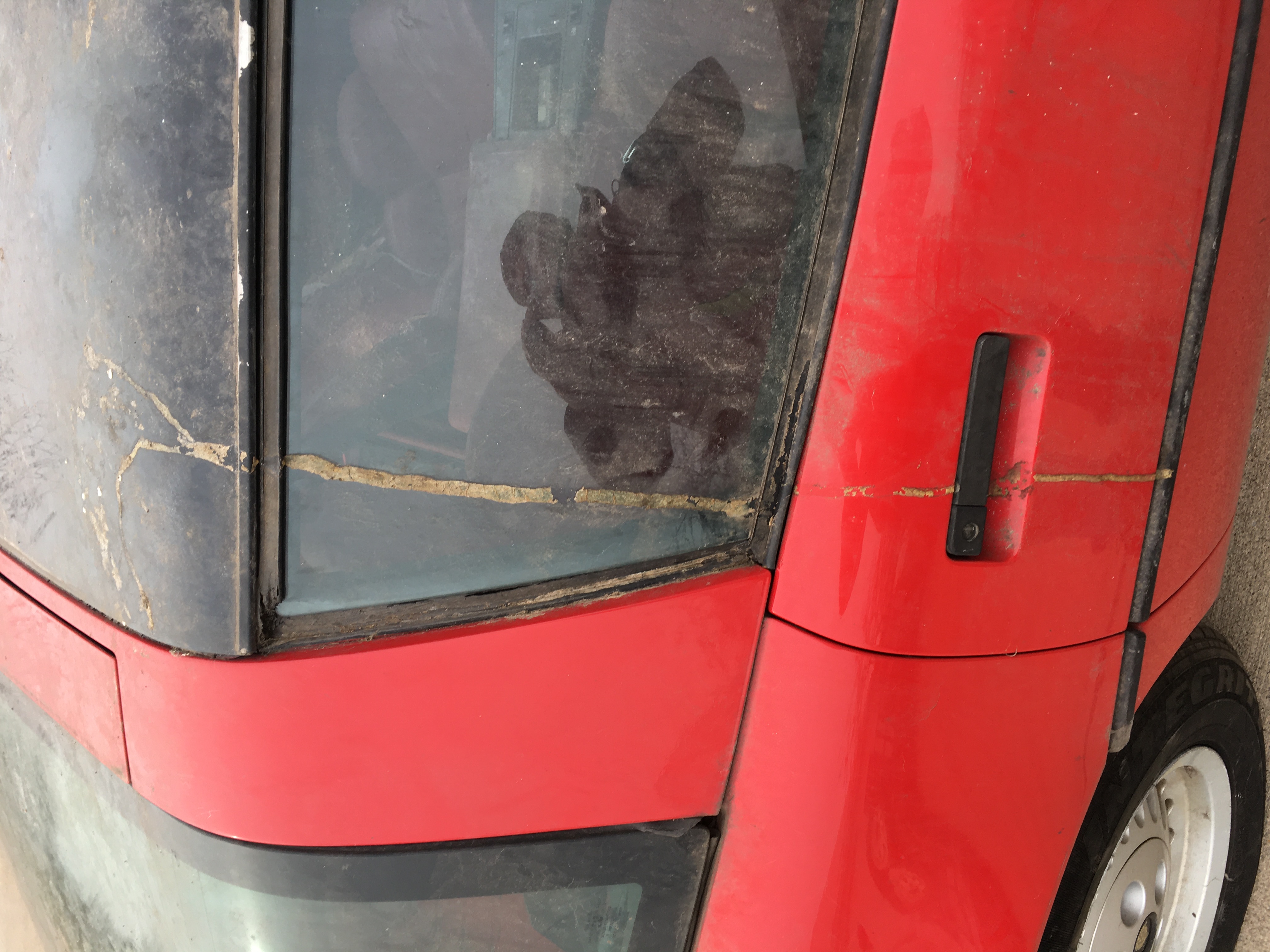

During all this work I realized I don't have the door key. This made me want to check the lock/unlock mechanism in the door. When I pushed it to lock it would not unlock. Fortunately the door was open at the time, but I ended up having to take the door apart to fix. The door lock mechanism requires the power lock motor to be connected and the plastic clip that held it had broken - so I replaced it with a metal clip I had to hold the rod in place.

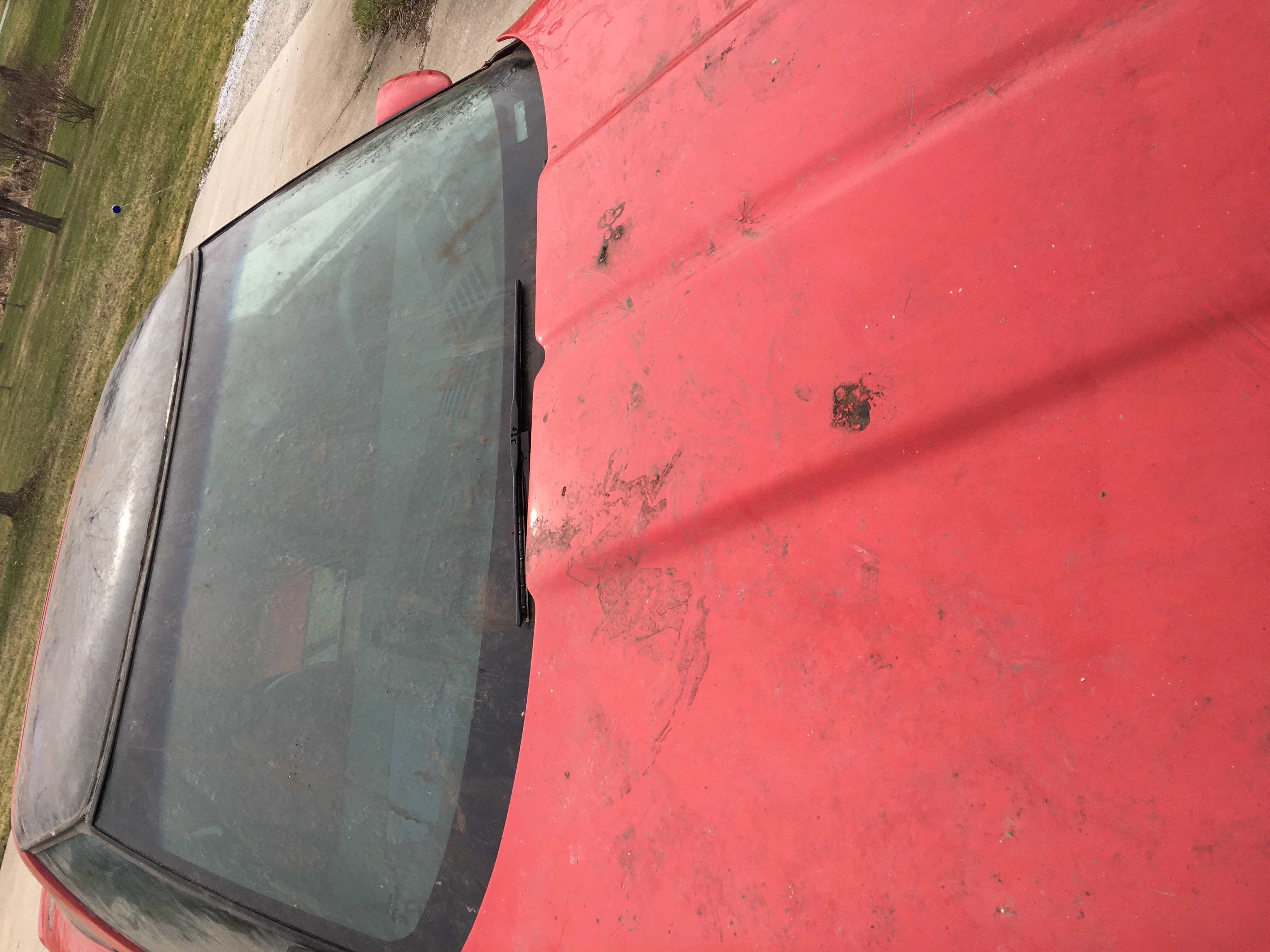

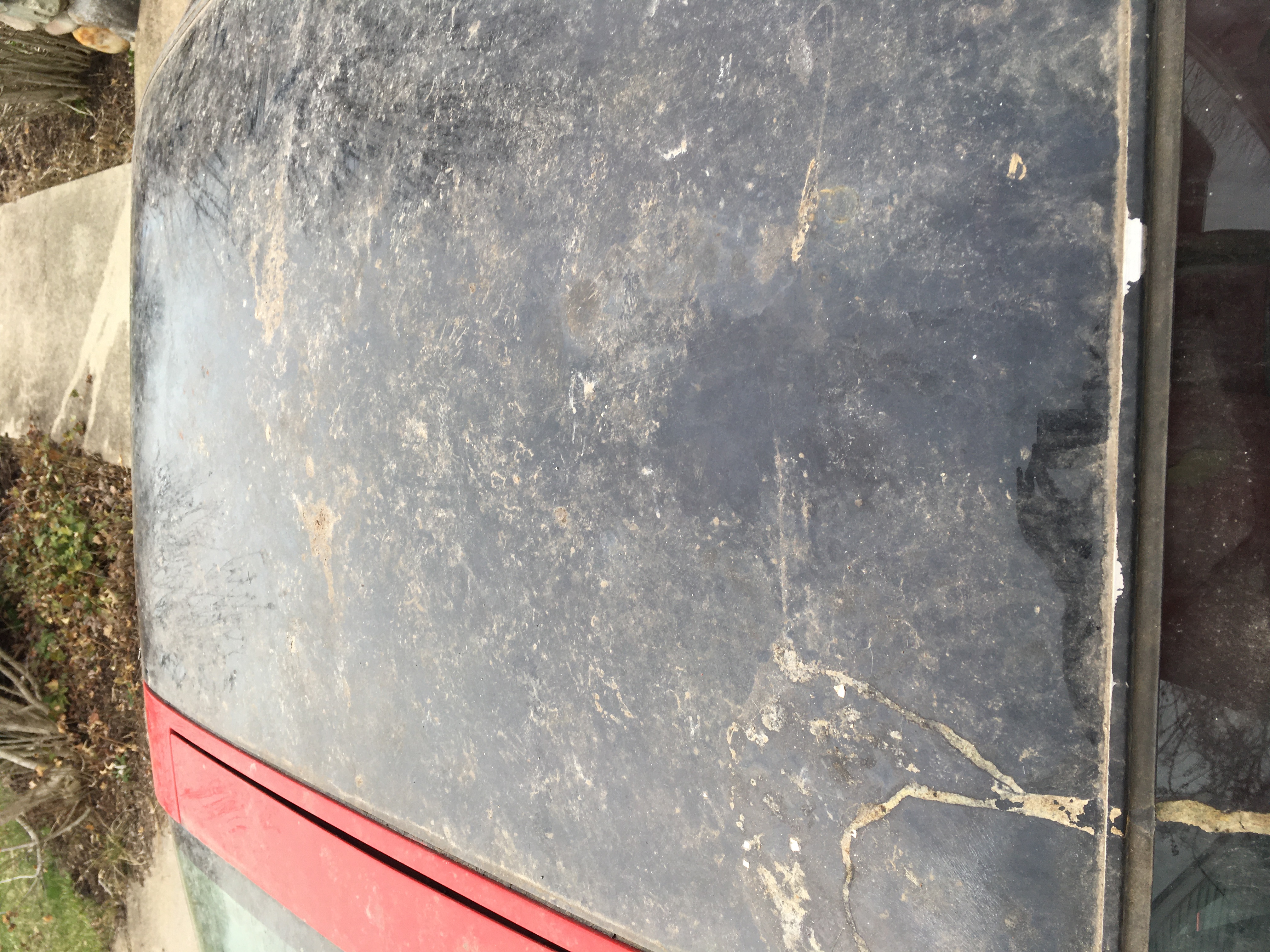

Then I decided to wash it. This poor car was quite dirty. Lots of dirt in the crevices, it had throw up on it. It was nice to get the heavy stuff off. After that I decided to clean up the interior a bit and reinstall the seats.

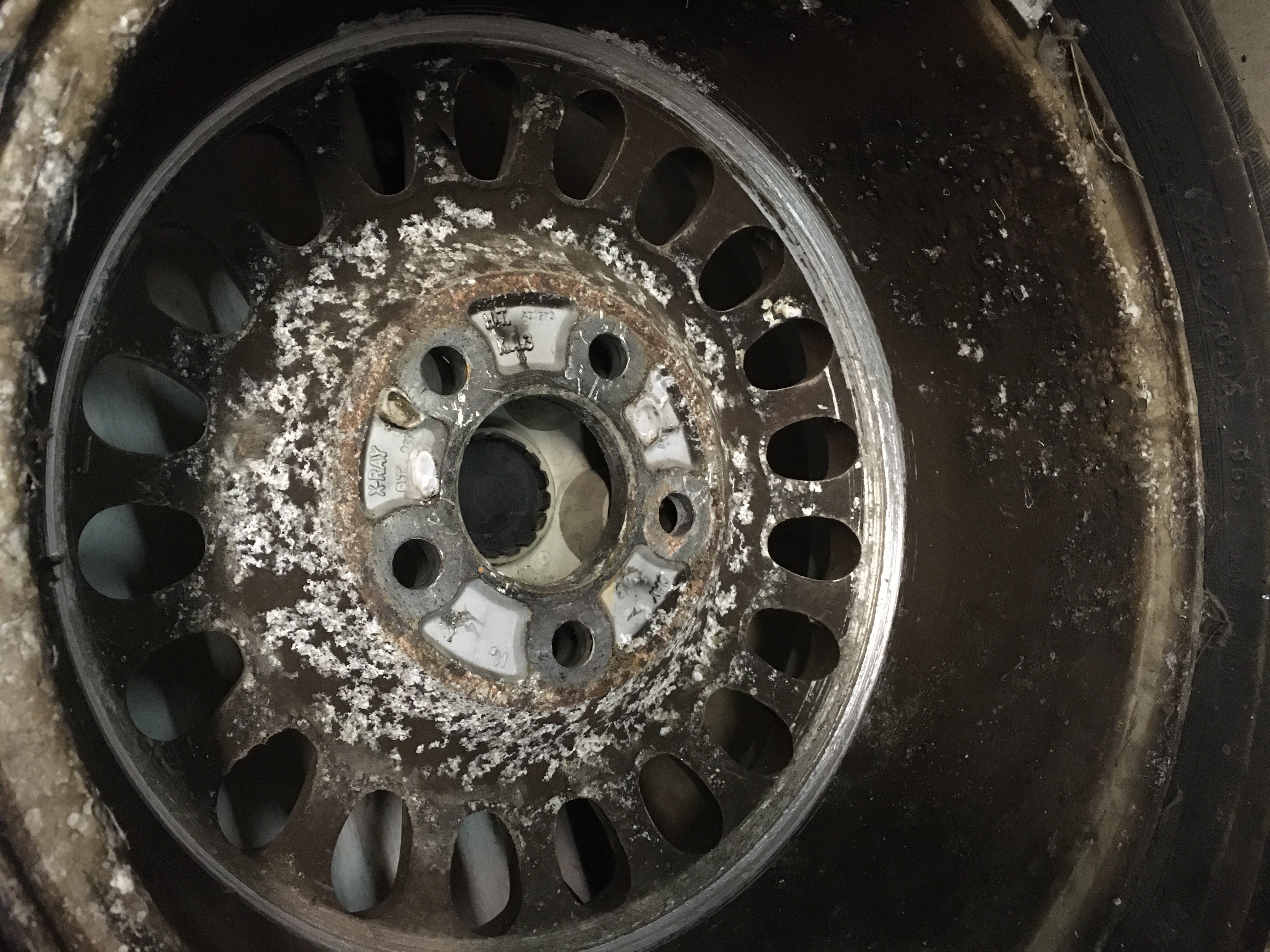

In the short moves I did in the driveway the rear wheels were grinding badly. As it turns out the Jaguar wheels rub on the rear calipers. For a temporary remedy I added some washers to move the wheels out a bit and clear the calipers. I still need to get a battery, a replacement fuel pump, and try running the car with water in it to see if it goes into the oil.

I finally picked up the fuel pump and gasket and installed them.

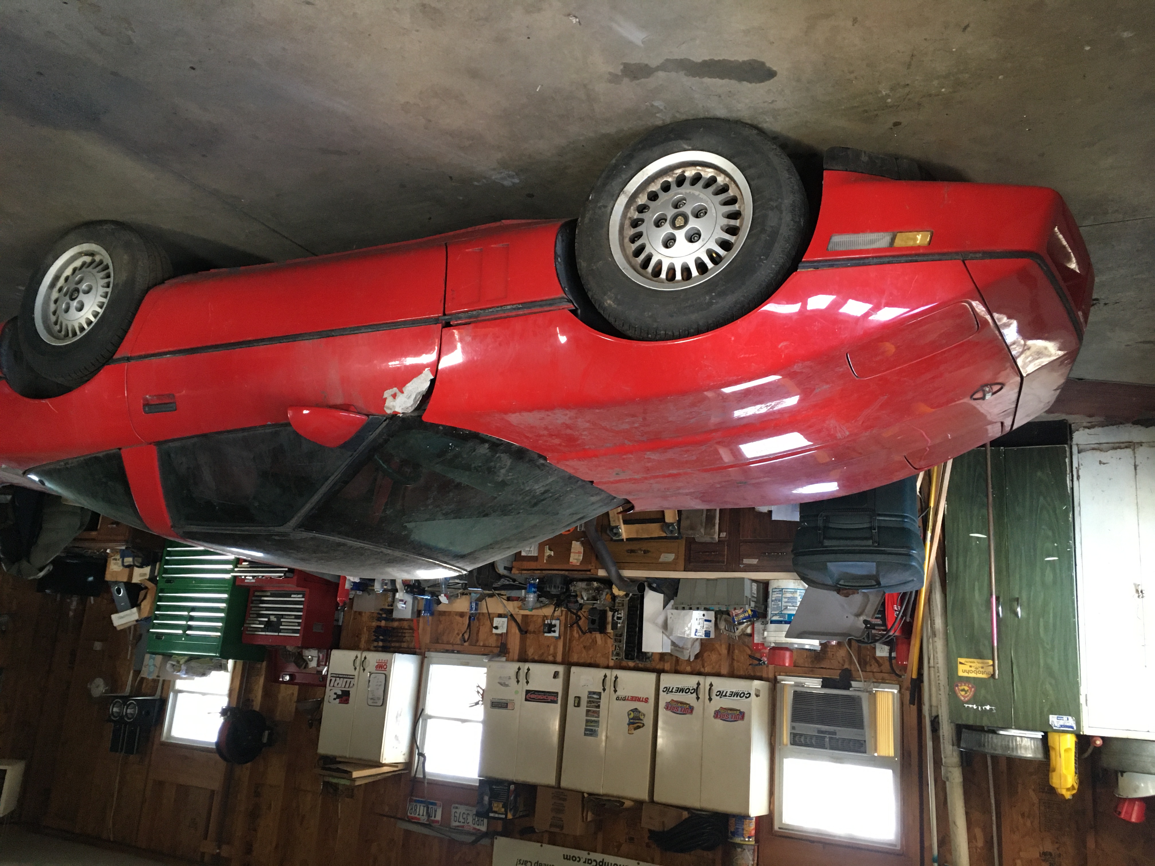

Last week the car made it to its new dwelling.
Also, based on chat with BP it seems the difference in exhaust is the car was wrecked in back and exhaust replaced with newer model. On those same lines it is likely the rear hatch was also replaced with later model, which explains why there is no third brake light. Later model C4s had that in the rear bumper cover not up top.
Before the move New home. No cats or throw up likely

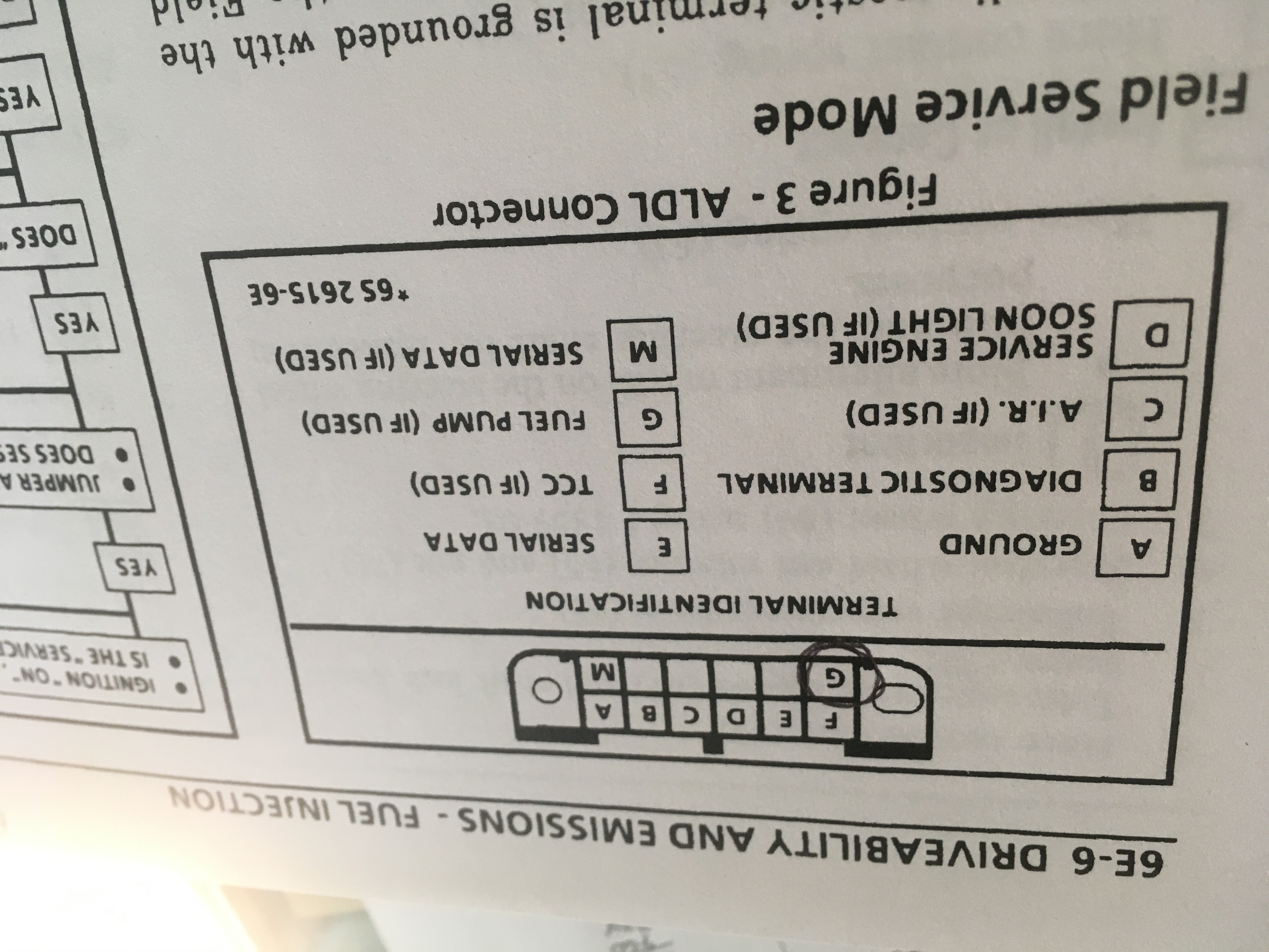

Unclear why it will not start now. Some troubleshooting ideas
1) give it some ether (open it up at the front of the MAF) and see if it starts
2) check fuel pressure (port is on passenger side intake between 5 and 7 cylinders)
3) There is a way to run the fuel pump through the diagnostic port. Connect 12v to the G terminal in the diagnostic port (see attached)
4) check for spark - pull a plug wire and connect an old plug that you can ground against something - or maybe use a timing light

Today I checked the fuel sending unit by connecting to the Vette here. The pump had no sign of life. I have a spare from a lot of 86 car parts I bought. That pump is good so I migrated to the 89 sending unit and we'll have something to put in the car to get it started. The pump that was in there I bought in March of 2020 so I'll be testing the warranty on that one.
