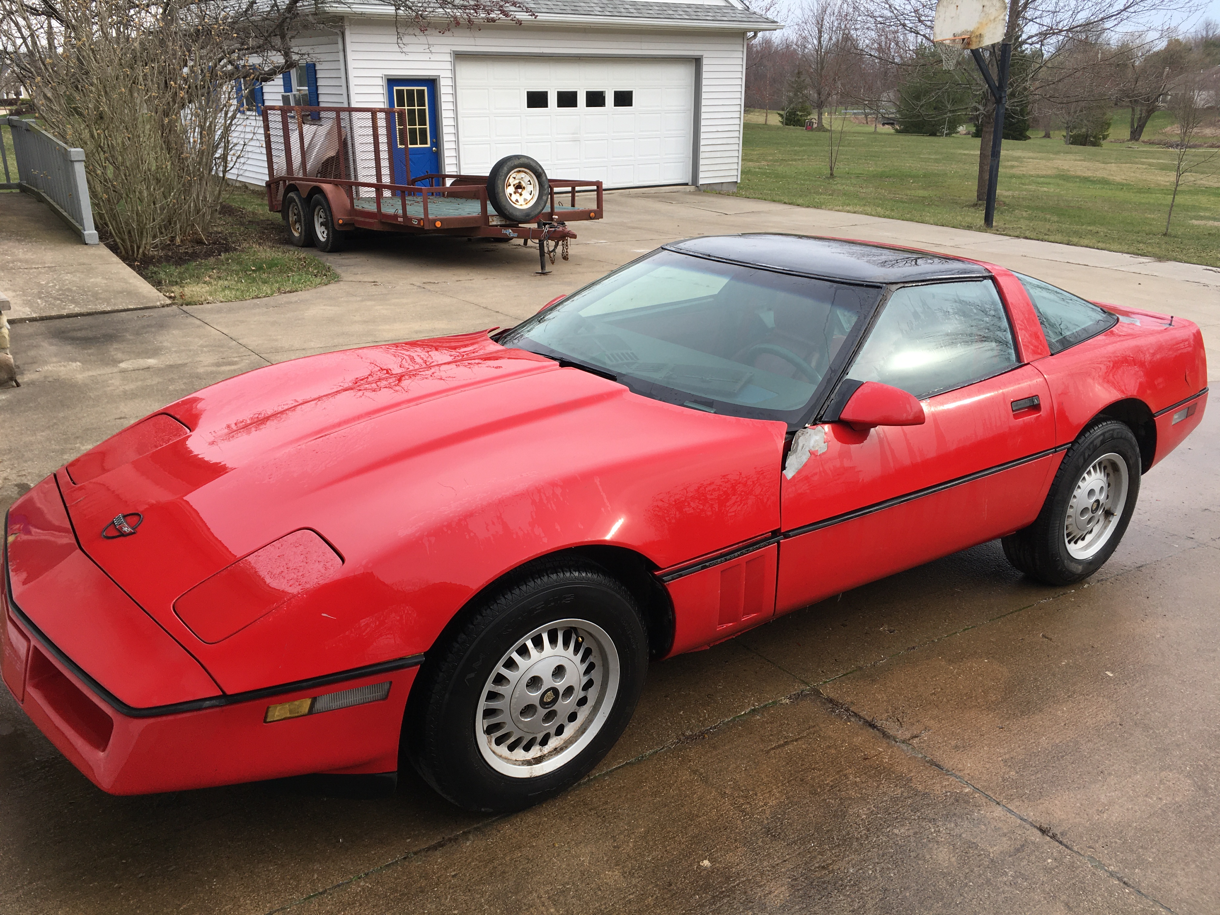

Today I added a backup/parts car to the collection.
It's an 89 with just over 100k miles. It has Jaguar wheels and 205/70/15 tires! Seller said prior owner could not afford the bigger tires and he heard that others were running them.
Quick check shows it does not have the power steering cooler, or the Z51 suspension, but it does have the KC4 factory oil cooler.
The interior carpet is out, probably some other parts missing, but the dash all intact. Seats are red but they are shot like the other one.
It had no battery and the rotors are quite rusted it did not move easily.

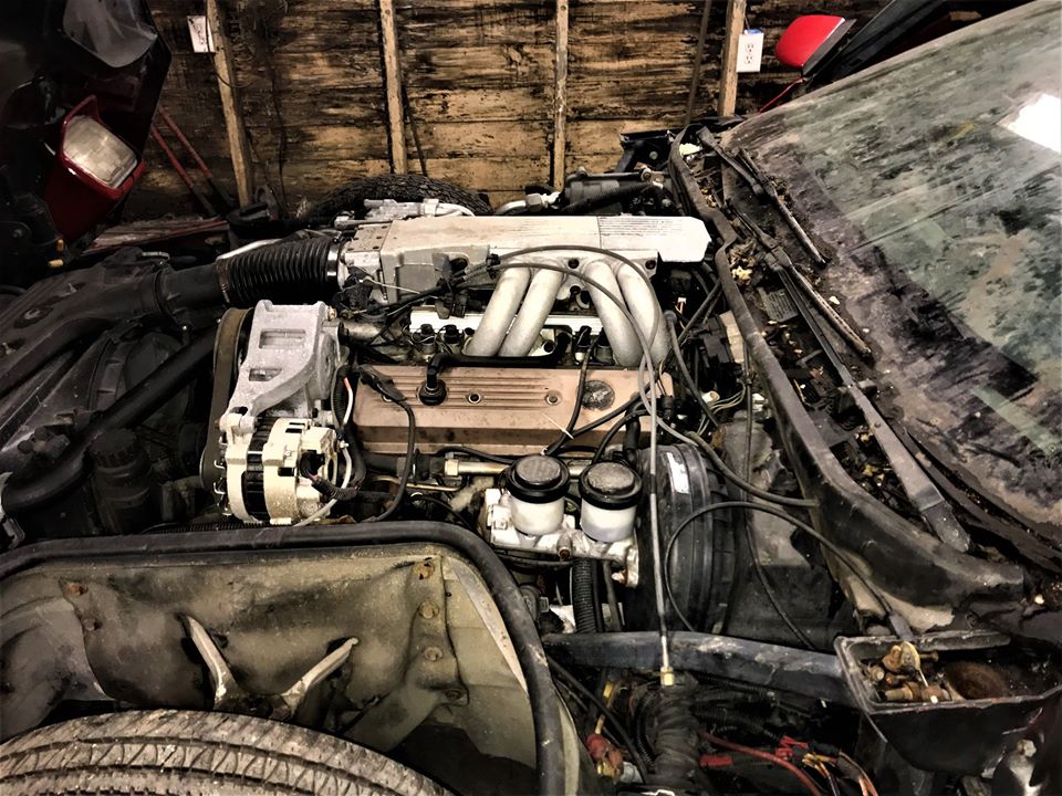

Under hood looks remarkably busy
