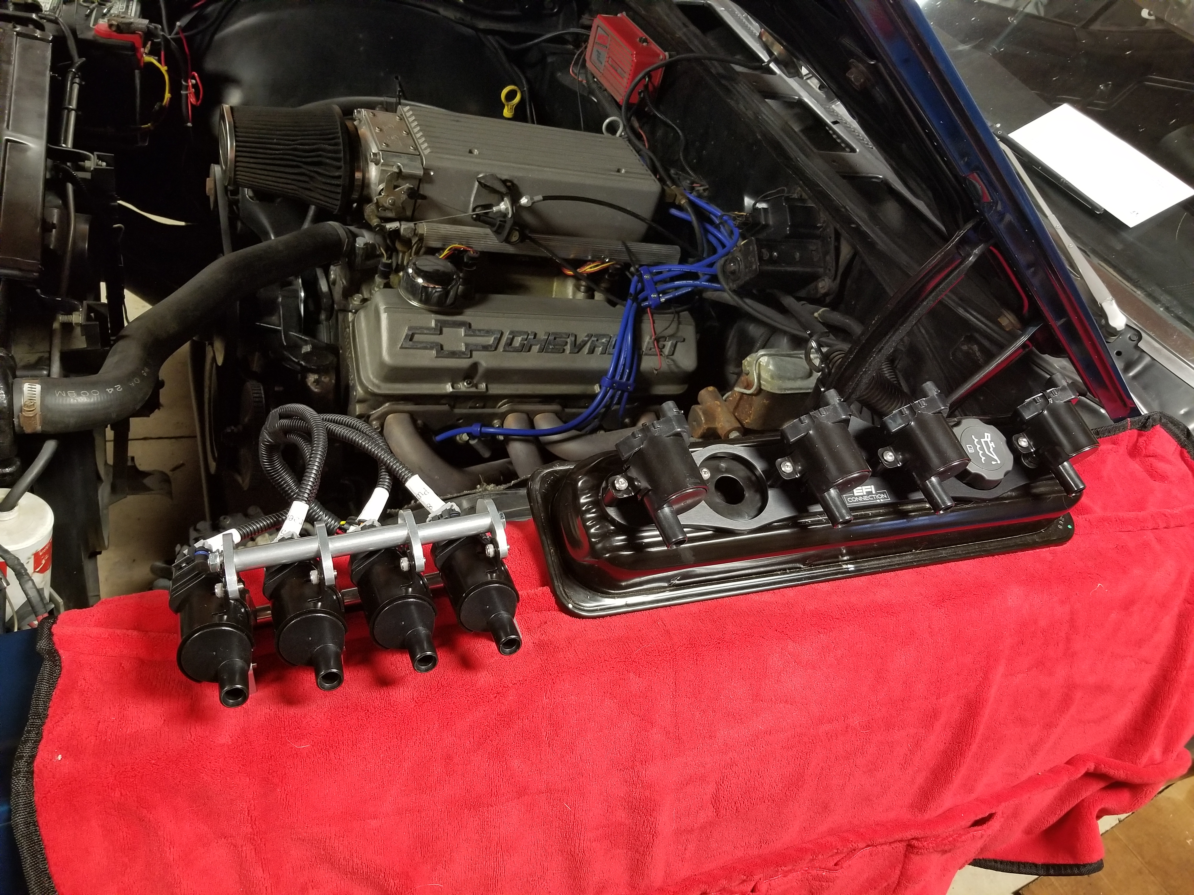

I've been gathering my pieces parts and soon will be decision time on where to mount the coils. I bought some brackets that will allow me to mount them on centerbolt valve covers. They are really nice pieces, and provide a super-clean install, but I have some sweet perimeter bolt covers that I don't really want to hide or get rid of. The other bracket style could be mounted anywhere, but most likely the firewall. I think they'd look weird on the inner fenders.

The only thing I can say about having them on the valve covers is that the wires are SO easy to run, and you'll never have a burnt one. From a practicality standpoint, that's your winner. BUT, I get what you're saying with the nice valve covers...

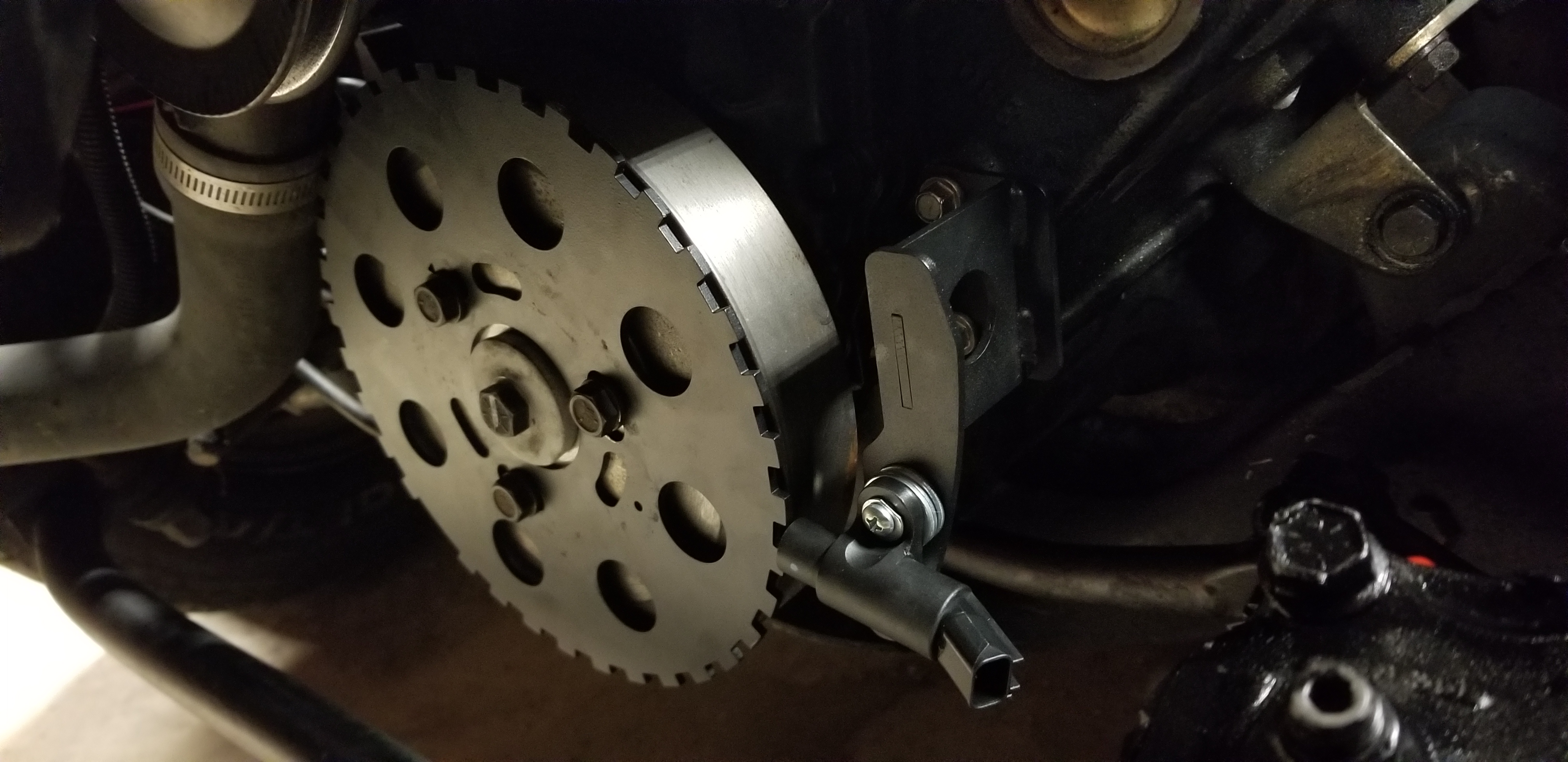

I ended up not using the EFI Connection 24x reluctor wheel that would've sat under the timing cover. The 24x LS1 pattern is a somewhat more complex tooth pattern compared to a simple missing-tooth setup like a 36-1 or 60-2 (aka 58x). There were some references on msextra.com that the EFI connection 24x wheel wasn't quiiite right compared to what was expected. Since I didn't want to deal with potentially troubleshooting this stuff, I decided to just use an external wheel, a 36-1. The wheel and the mounting bracket were purchased on ebay for like $55. I think it's just some guy who makes them in his basement, but so far it works great. The bracket is designed to use the crank position sensor from a '91 Escort 1.9L. It's a simple 2-wire VR sensor. I set the air gap at .9mm
To do true sequential, you need crank + cam position. For the cam sensor, was able to buy a complete distributor from ebay for a 96-00 Vortec truck that has a cam sensor -- <$25. I removed the rotor and will probably buy a dust cover that replaces the cap. This just came yesterday. For the coils themselves, I used D585 LS Coils -- the round ones with a heat sink on one end. They came on early 2000s LS trucks, they're supposed to be a proven setup. I bought a set of replacements for $70 for all 8. Seems cheap. They're mounted on some nice brackets from EFI connection. They were $90/each, as well as some EFI connection coil harnesses, $50/each.

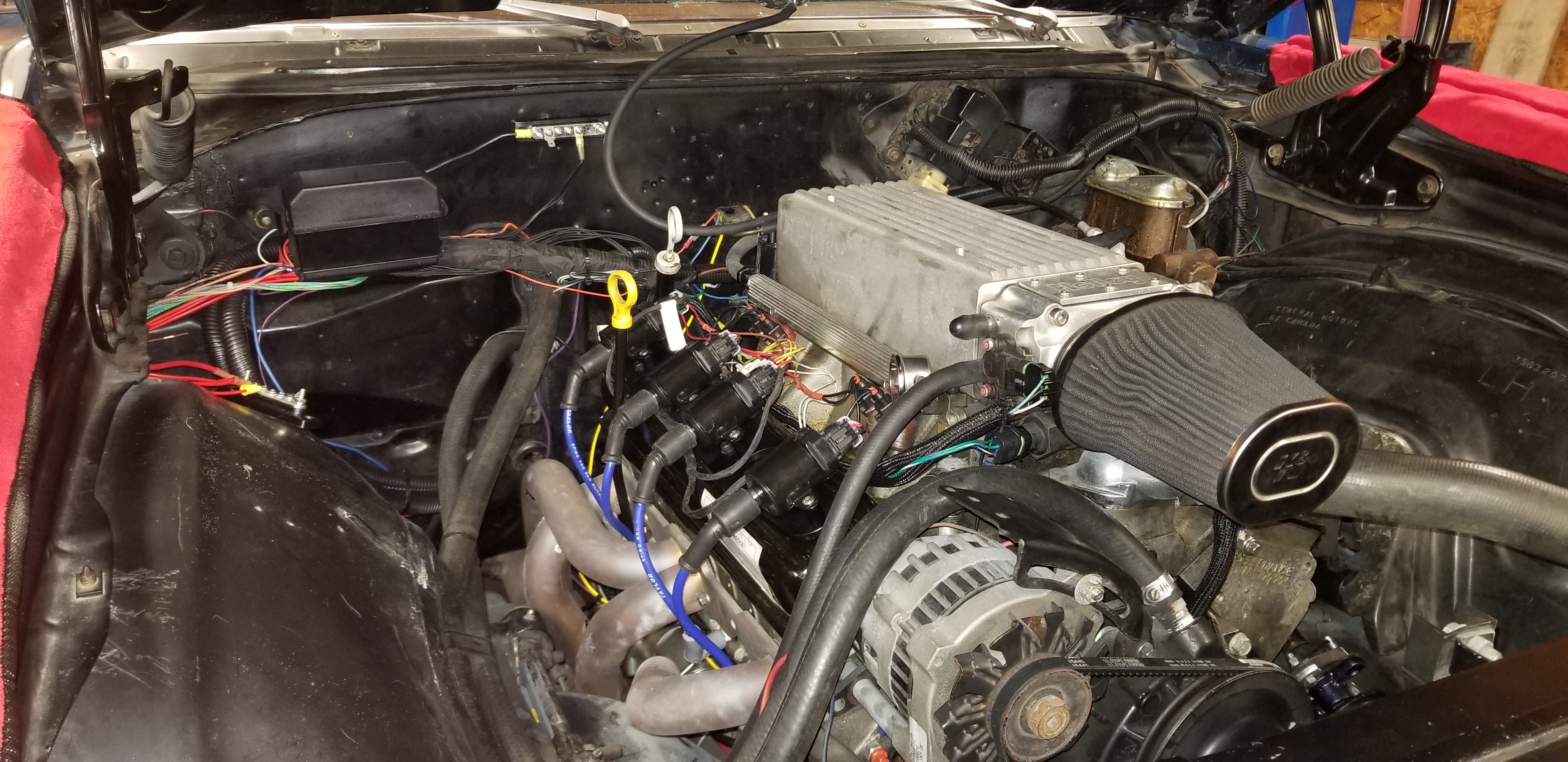

Just getting started. Bye bye sweet valve covers & MSD 6AL. A lot of wires to manage.. It's still not done, but it does run! (no cam sensor, yet)
More to come..
