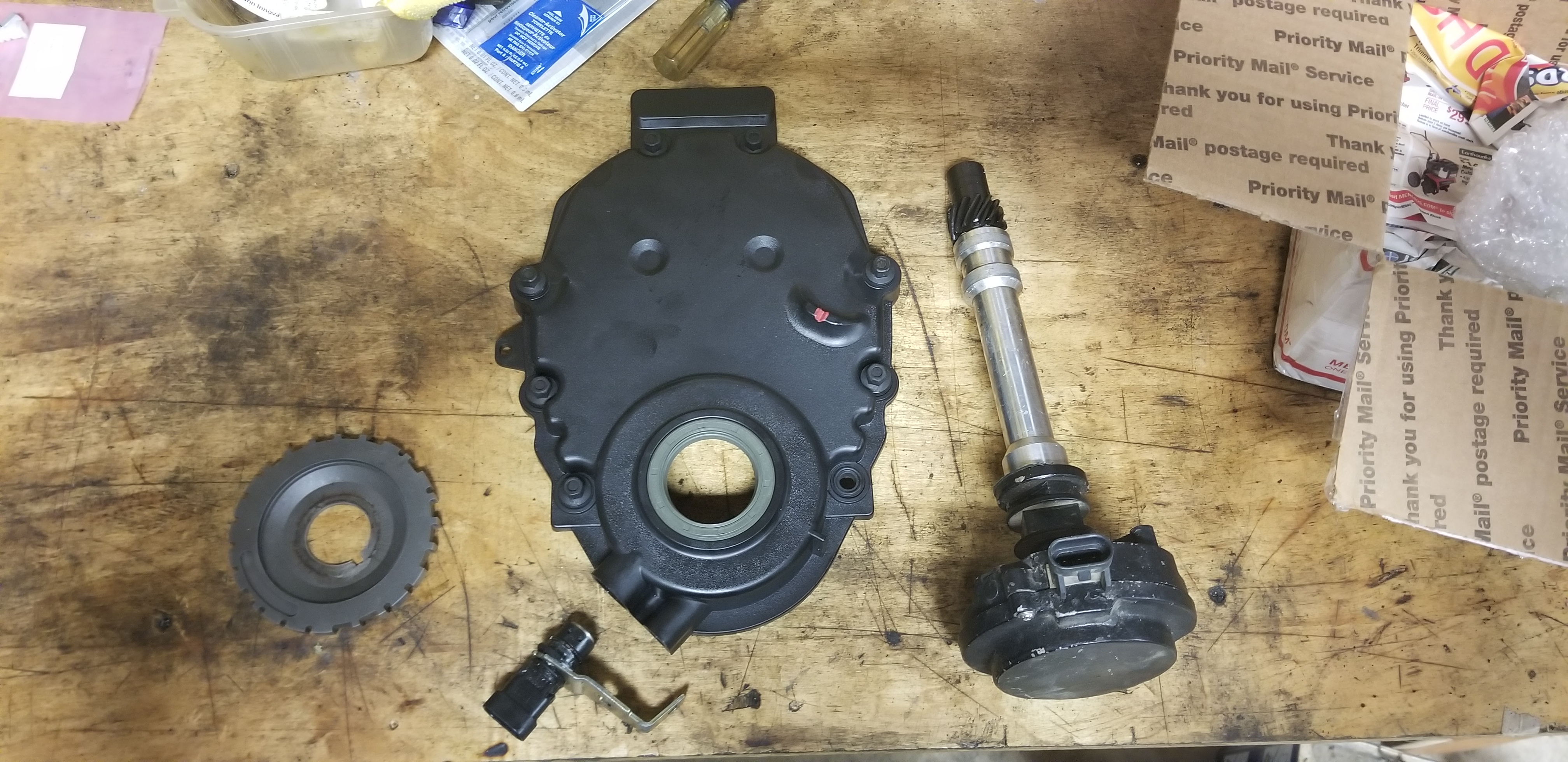

This is my new crank trigger setup. The timing cover and Crank Position sensor are stock GM pieces. The trigger wheel itself is made by eficonnection.com and is the same pattern as a 24x LS1. The distributor is also a stock GM piece, from a very late SBC. (99-01?) It is now just a cam position sensor. Using the crank + cam inputs to the MS3X will allow full sequential fuel injection + COP ignition.
Still trying to decide what I want to do for coils.

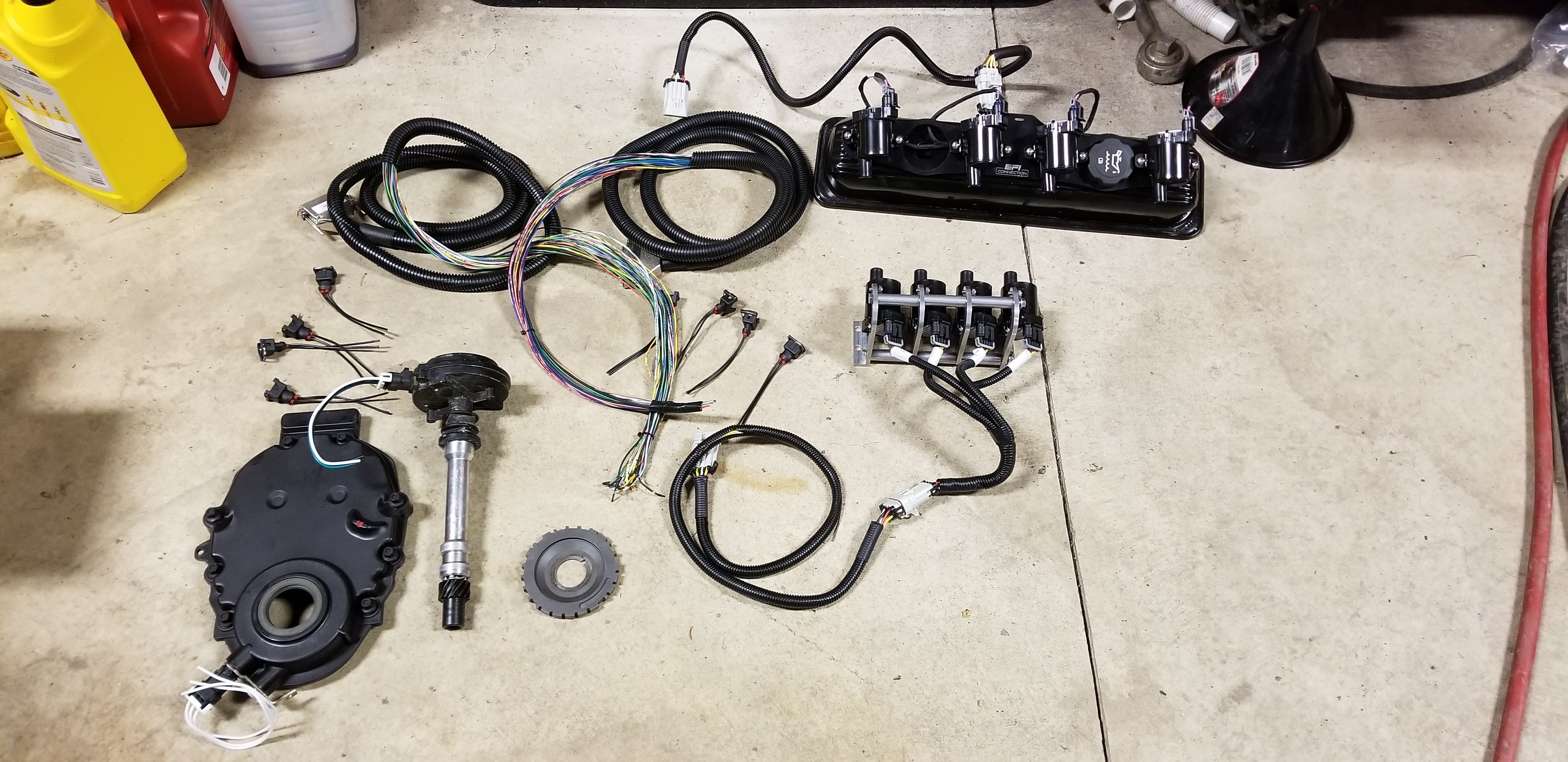

I've been gathering my pieces parts and soon will be decision time on where to mount the coils. I bought some brackets that will allow me to mount them on centerbolt valve covers. They are really nice pieces, and provide a super-clean install, but I have some sweet perimeter bolt covers that I don't really want to hide or get rid of. The other bracket style could be mounted anywhere, but most likely the firewall. I think they'd look weird on the inner fenders.

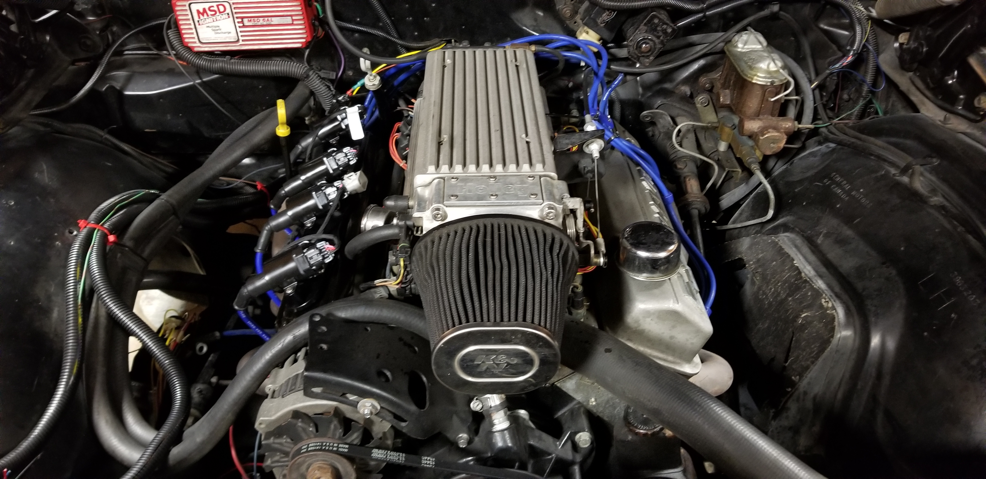

Here's a more complete picture of the project.

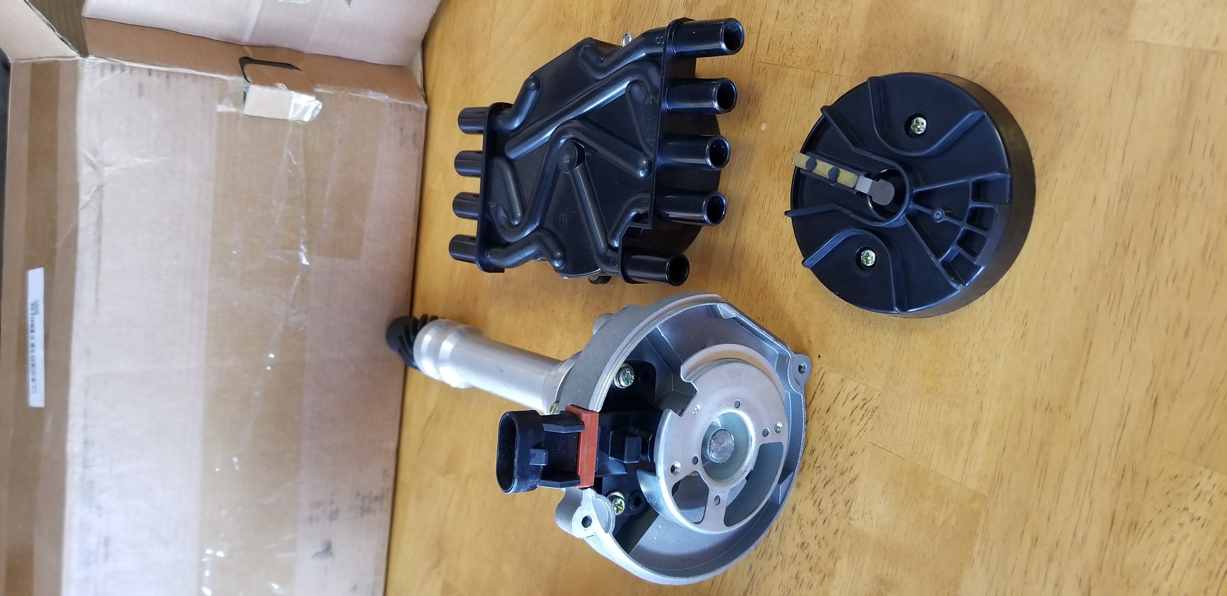

To do true sequential, you need crank + cam position. For the cam sensor, was able to buy a complete distributor from ebay for a 96-00 Vortec truck that has a cam sensor -- <$25. I removed the rotor and will probably buy a dust cover that replaces the cap. This just came yesterday.
For the coils themselves, I used D585 LS Coils -- the round ones with a heat sink on one end. They came on early 2000s LS trucks, they're supposed to be a proven setup. I bought a set of replacements for $70 for all 8. Seems cheap. They're mounted on some nice brackets from EFI connection. They were $90/each, as well as some EFI connection coil harnesses, $50/each.

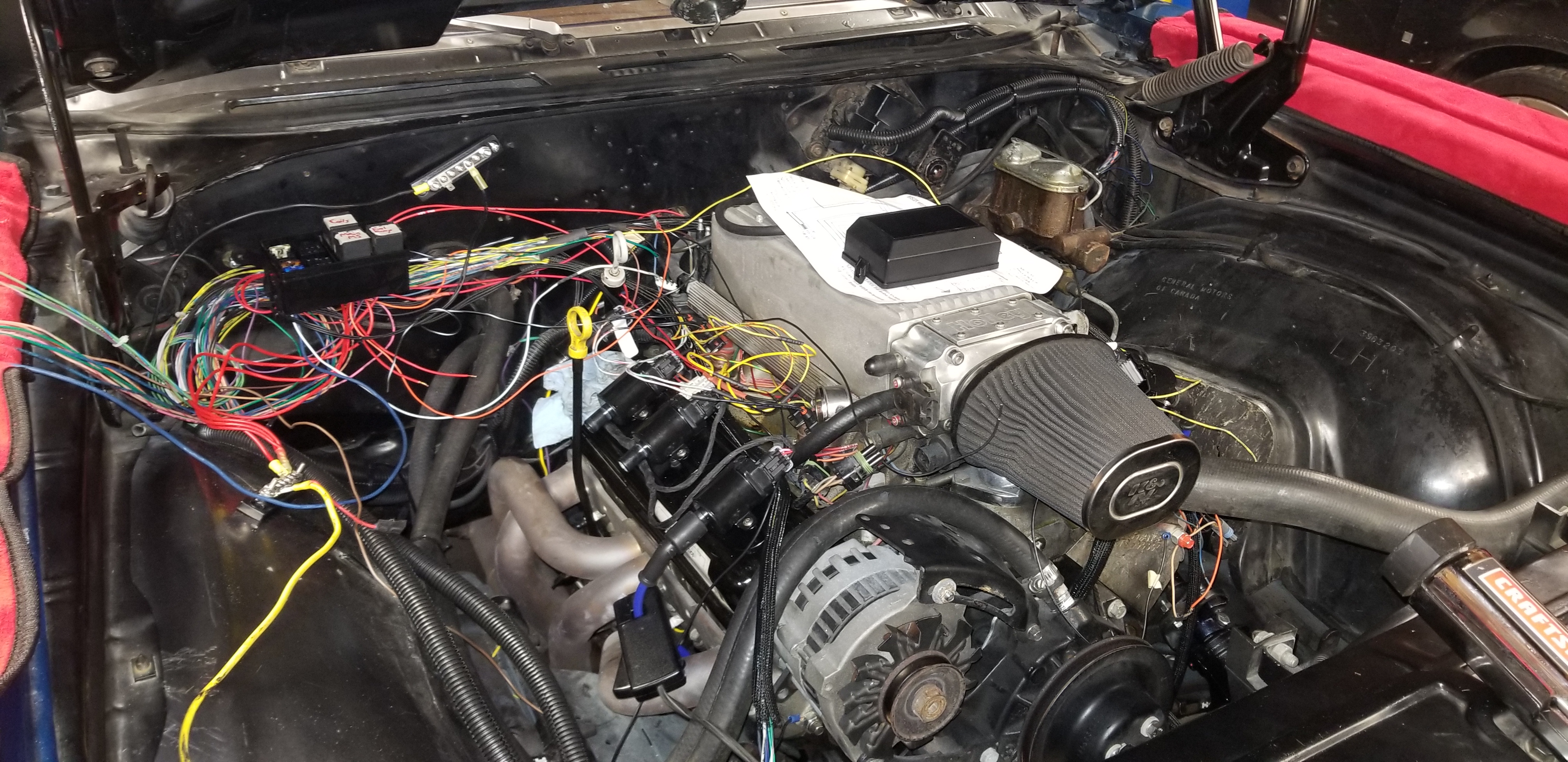

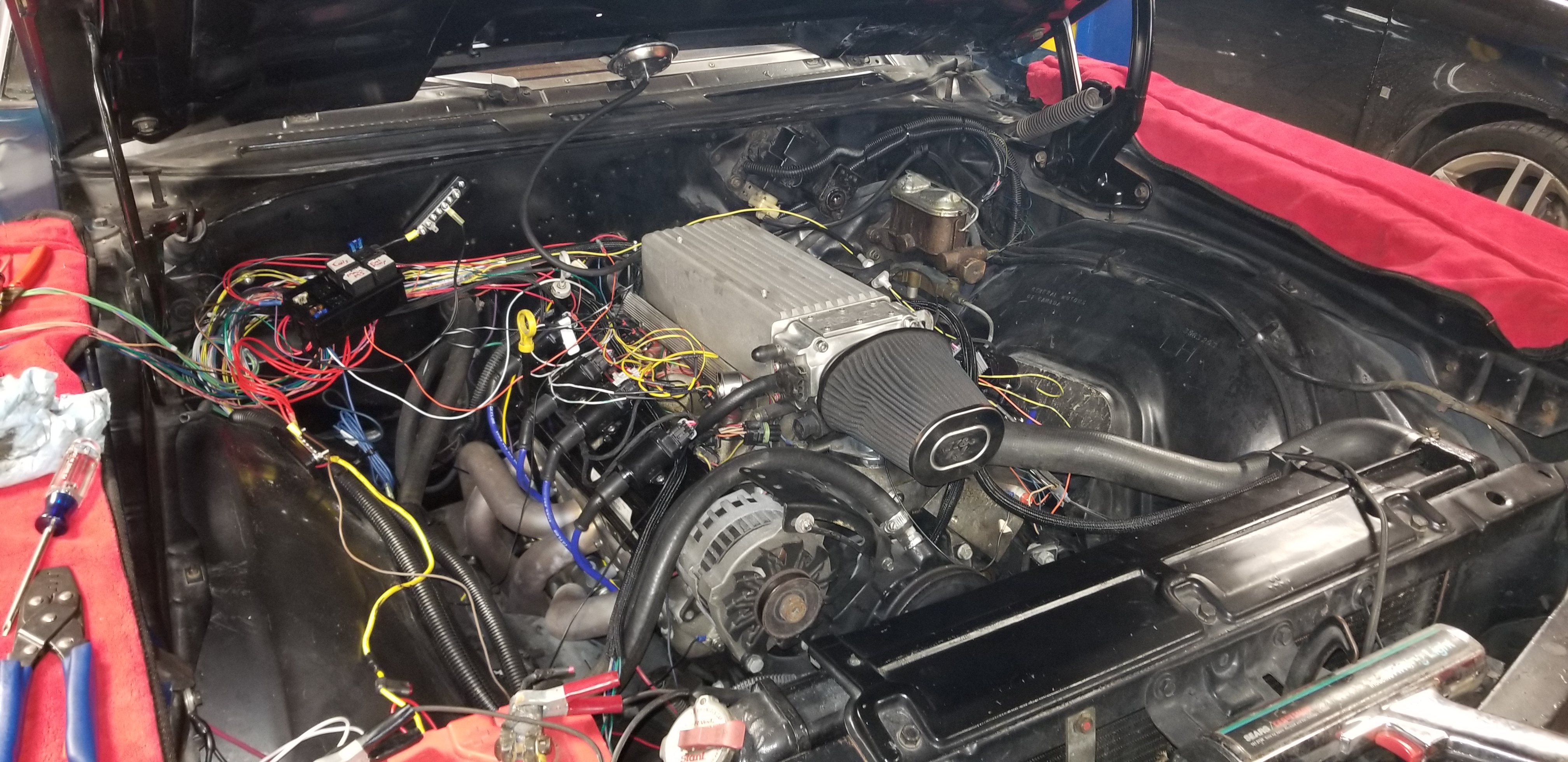

A lot of wires to manage..
It's still not done, but it does run! (no cam sensor, yet)
More to come..
