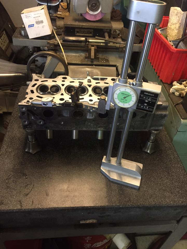

So when I FINALLY got the head removed I was able to measure .005" out of flat - the spec limit is .002" - after being quoted $250 to pressure test the head and take a skim cut - I said No WAY!!!
So what's a Cheap Bastage to do?? Well I was eyeing up my 1940s bandsaw table thinking I BET that sucker is flat. Well being unable to see any light under a straight edge I decided it was close enough for this guy!
I took some trim adhesive and glued two sheets of sand paper to the table. 150grit if I remember correctly. After getting the entire surface to show signs of being sanded I switched over to some 13Micron paper I had (I used what I had - I am not saying you have to use this) and after several paper swaps I eventually got the fine paper to show a cut across the entire head again.
To later qualify it I stuck it on my granite table and checked the entire surface with a height gage and indicator. It was flat within .001" - that's well within the spec and since this wasn't a race motor I called it good enough. Total cost a few sheets of sandpaper and some time.

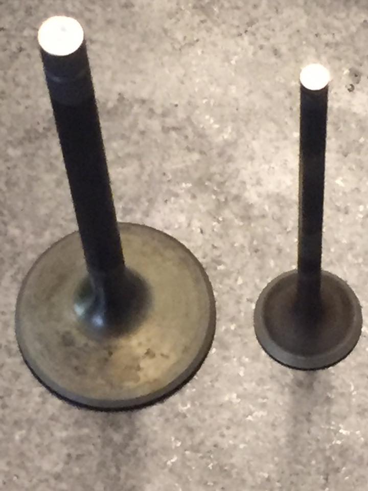

Next I inspected the valves - they looked good except the exhausts just barely showed some pitting. So those got to meet my 1950's Black and Decker valve grinder. A few thou removed and they were deemed suitable to reinstall. I lapped all of them for good measure. These are a bitch to hand lap because they are so tiny!

So trying to figure out what happened to end up with a couple tight valves got me to remembering the old timers smacking the valves with a hammer to ensure they were seated properly. I just pushed these by hand because the springs are so small, but obviously that was NOT effective. Lesson learned.
