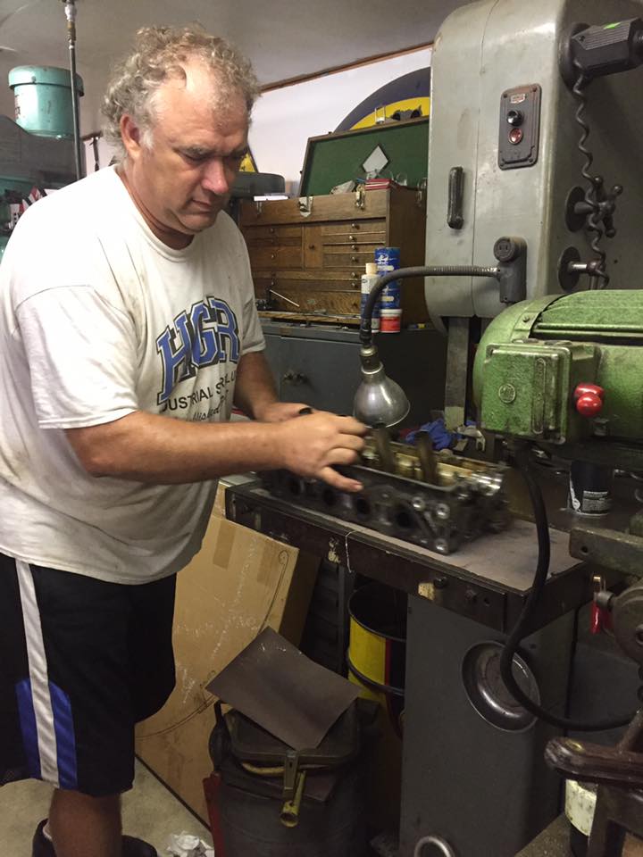

So when I FINALLY got the head removed I was able to measure .005" out of flat - the spec limit is .002" - after being quoted $250 to pressure test the head and take a skim cut - I said No WAY!!!
So what's a Cheap Bastage to do?? Well I was eyeing up my 1940s bandsaw table thinking I BET that sucker is flat. Well being unable to see any light under a straight edge I decided it was close enough for this guy!
I took some trim adhesive and glued two sheets of sand paper to the table. 150grit if I remember correctly. After getting the entire surface to show signs of being sanded I switched over to some 13Micron paper I had (I used what I had - I am not saying you have to use this) and after several paper swaps I eventually got the fine paper to show a cut across the entire head again.
To later qualify it I stuck it on my granite table and checked the entire surface with a height gage and indicator. It was flat within .001" - that's well within the spec and since this wasn't a race motor I called it good enough. Total cost a few sheets of sandpaper and some time.

Cheap bastage strikes again. Working in a free HGR shirt too! Nice. Maybe you could make a 16 valve head for the Hemi?
