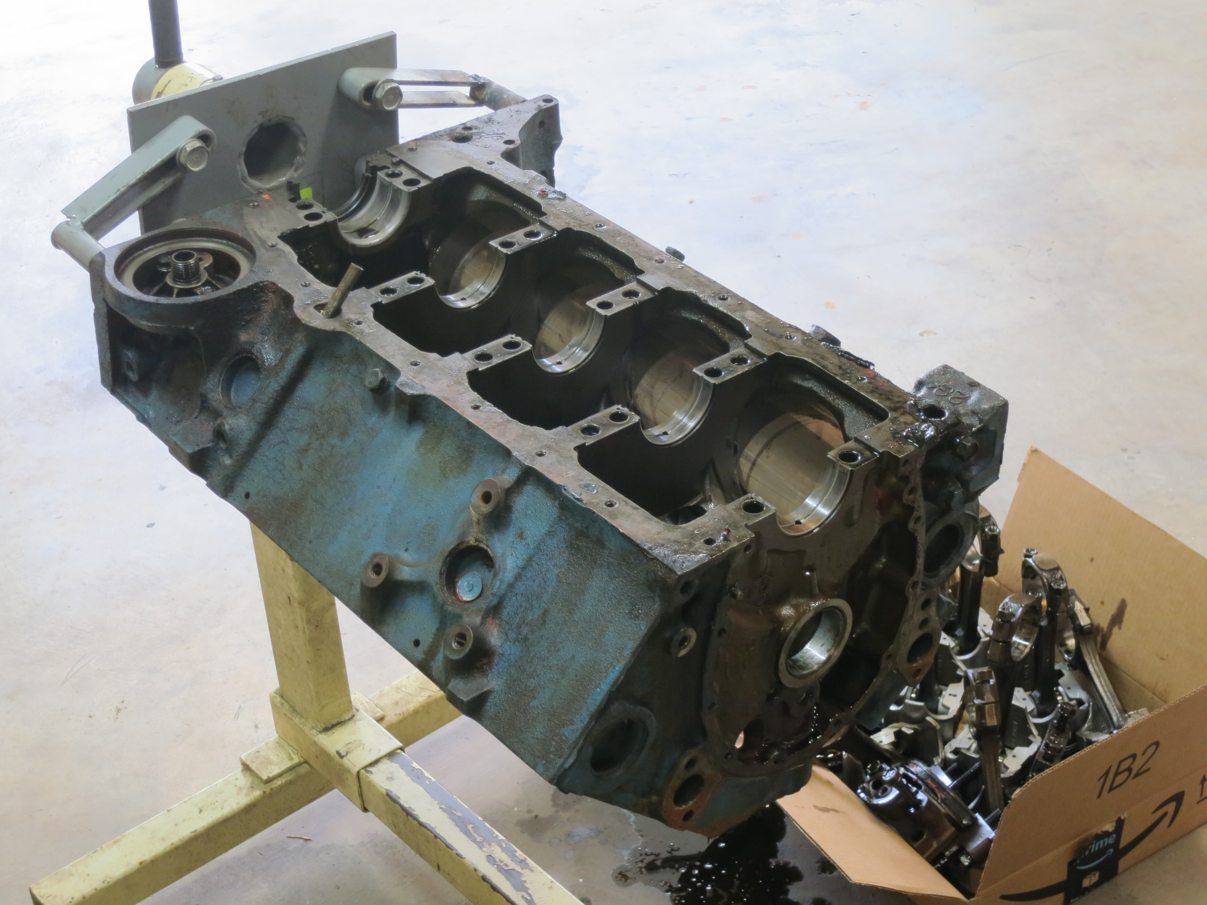

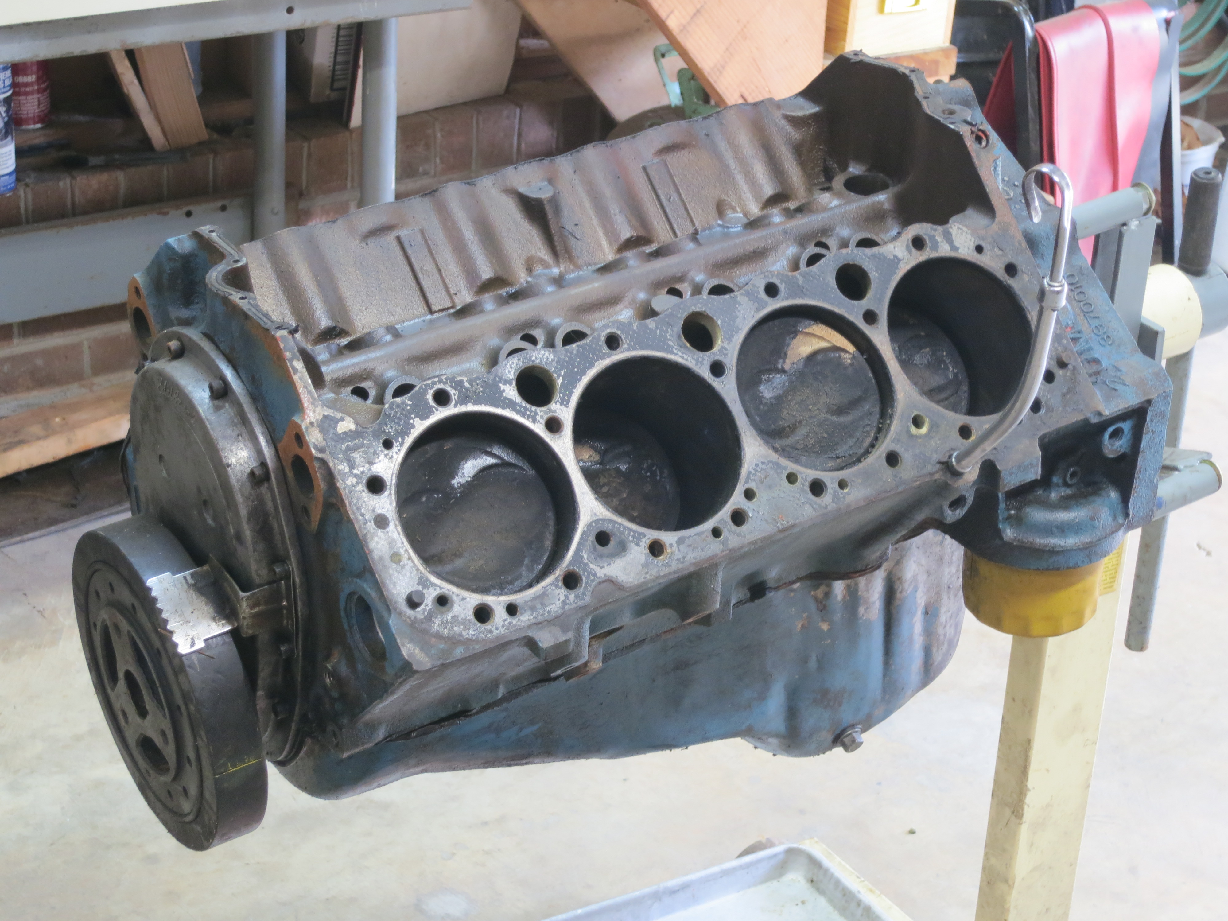

We started the process today. Tore it down. Bore is 4" so it IS a 350. I ASSUMED it was a 350 based on what the seller told me. He was relying on the word of the previous seller. Four bolt mains. Two piece rear seal. Need to determine if the crank is a "big journal" crank. No indication of overbore or undersized bearings but we'll mic everything out before we order parts. Bearings look good. No noticeable ridge on the cylinders. Some cross-hatch is still there but there is very minor scoring. Hone should put it in good shape. Cam and lifters don't show wear so we'll reuse them. Timing chain is a little loose so we'll replace it.

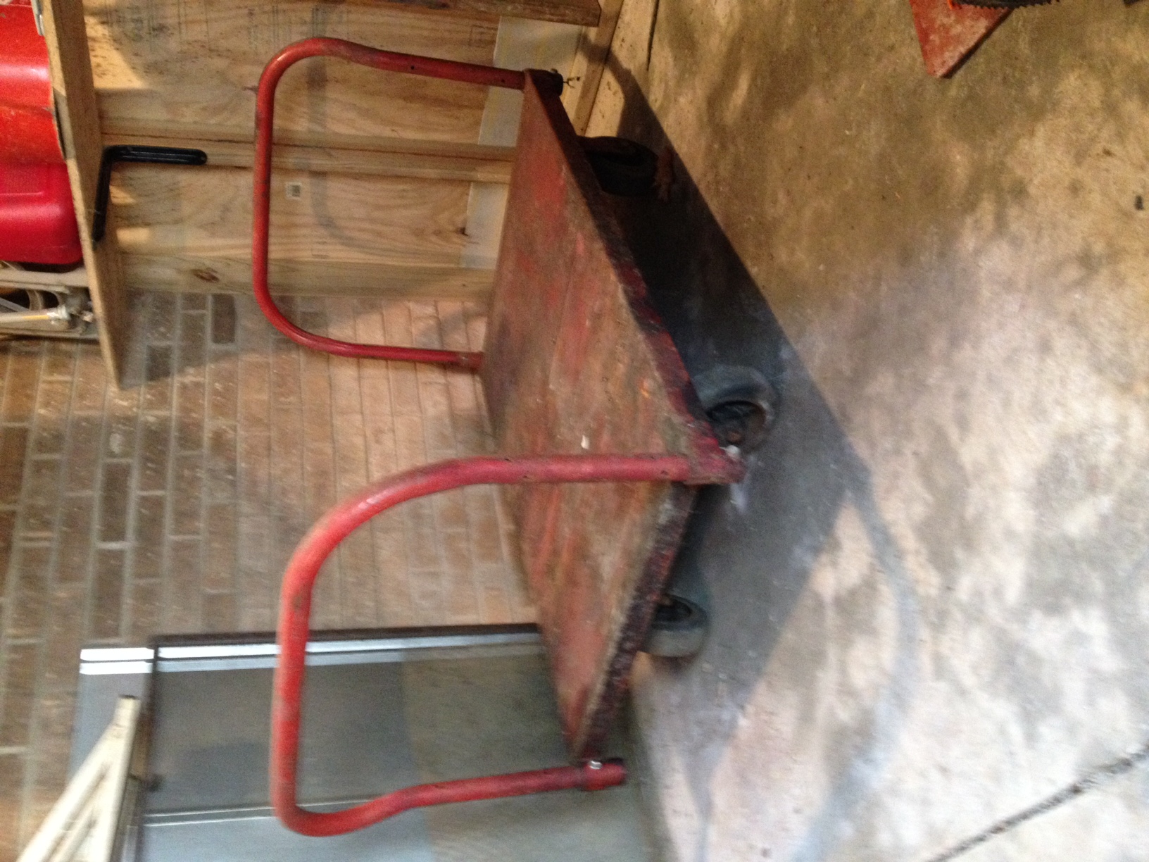

WXO has an old steel industrial cart that will make a good base for the run stand. I have a SBC engine stand that should fit nicely on the cart. The cart has high handles on each end that should serve well as structure for the radiator mount and, on the opposite end, a control panel. WXO took the oil pan, intake and carb home to clean up. Oil pan is dented on the bottom so will need a little massaging before paint. I'll power wash the block and maybe clean up the distributor and starter.

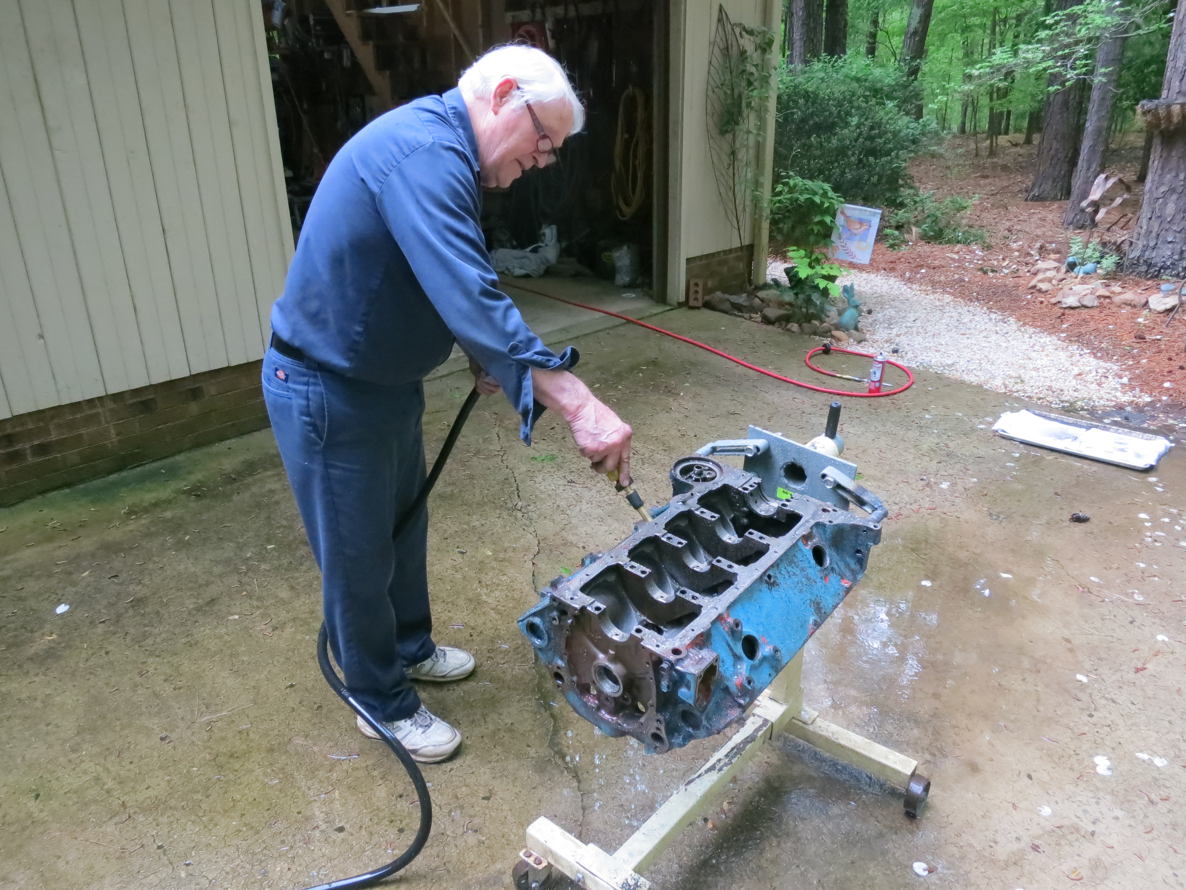

Yesterday I power washed the block, starter and distributor and today took some measurements, with WXO's help and his set of 1" to 6"" mics (from Carlisle). Main and rod bearings are all stamped .010. Pistons are stamped .060.

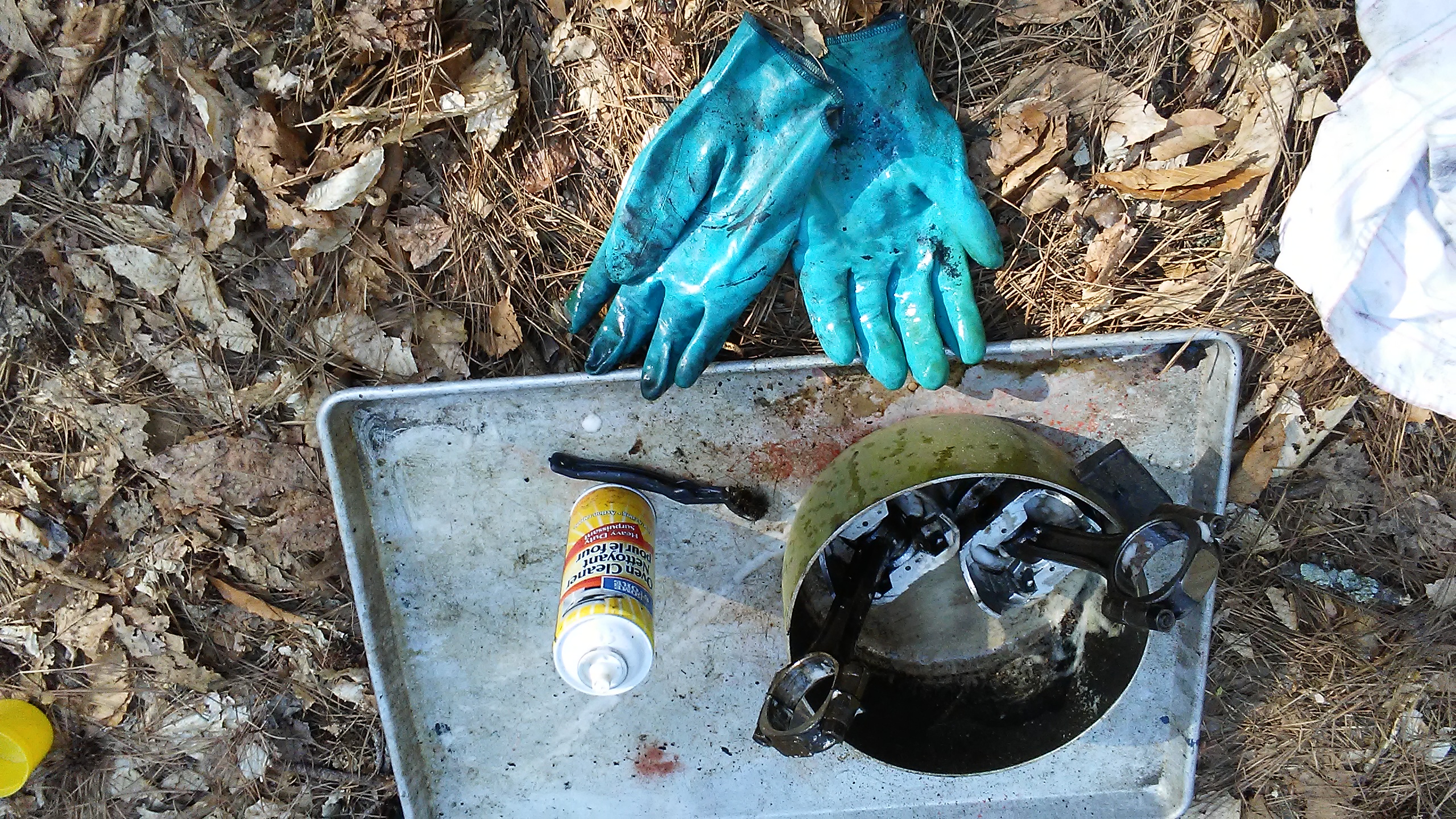

I'm using oven cleaner to clean the rods & pistons.
Ordered a fan pulley off ebay. https://www.ebay.com/itm/271428797171
Rings thickness measured .078", .078, and .180 so that makes them 5/64" (.0781), 5/64" (.0781), and 3/16" (.1875).
Ordered Summit re-ring kit RRKIT1-611 with .060 over rings, correct ring thicknesses, .010 under bearings, and 2-piece rear seal.

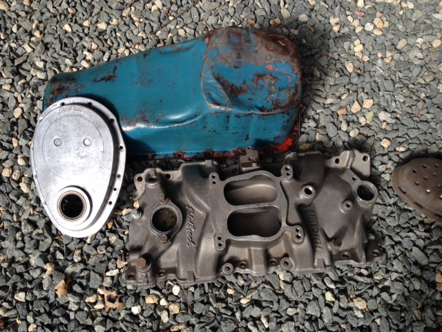

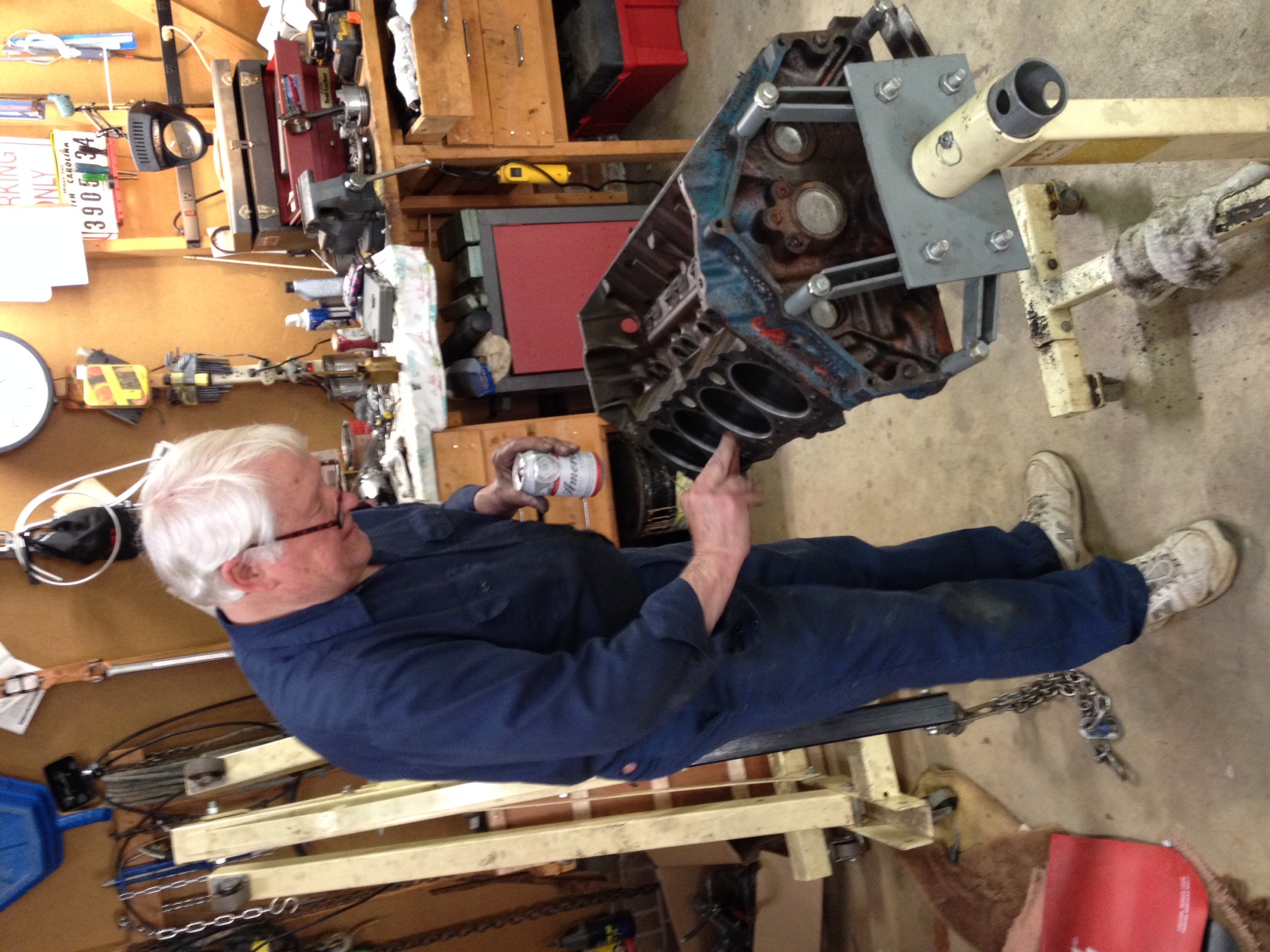

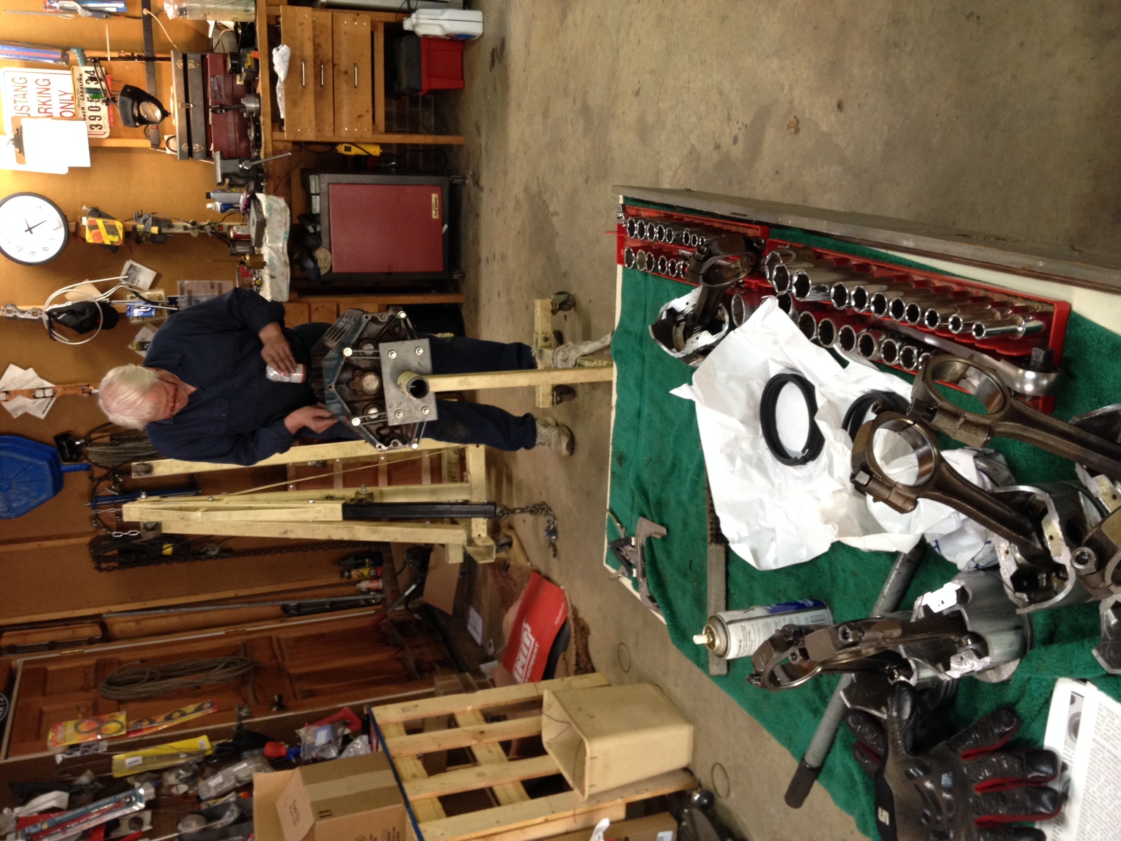

This week the fan pulley, rings, bearings, plastigage, assembly lube, and gaskets all arrived. Picked up a loaner cylinder hone at Autozone. Reamed the minor ridges. WXO got the Performer intake and Edelbrock cast aluminum timing chain cover looking good.
We had a work day yesterday. We had a pretty nice work space. Moved the Lincoln out of the garage and had the block on the engine stand and a sturdy table in the center.
We did some checking on casting numbers and found that the heads are large chamber (good for regular gas in a 350, now 360) replacement heads. Got a start at honing the cylinders but found the stones on the hone were worn out. Autozone has another in stock so this week I'll exchange the worn-out one. We checked piston-to-cylinder clearances and found them to be about .004". We'll be able to hone out the minor scoring and still be OK.
We got the pistons cleaned. I got the VERY heavy carbon off the tops and WXO got the ring grooves sparkling! We're still debating what to do with the heads -- get them rebuilt or replace them. We're doing a little looking to see if anyone has a pair of fresh, large chamber heads they don't need.
Emailed the generous guy that is donating a '55 Chevy radiator, crank pulley, and maybe some more parts. He'll round the stuff up on a few days. We'll follow the procedure in the "How to Rebuild Your SBC" book to see if the oil pump should be replaced.
Another joint work day is scheduled for Wednesday next week.

Re: SBC 350 + Test Stand
Last week I returned the worn-out cyl hone to AutoZone. Conscientious counter lady pulled another loaner hone, examined it and found a broken stone. She replaced the worn-out hone with a new one off the shelf. AutoZone tool rental is great.

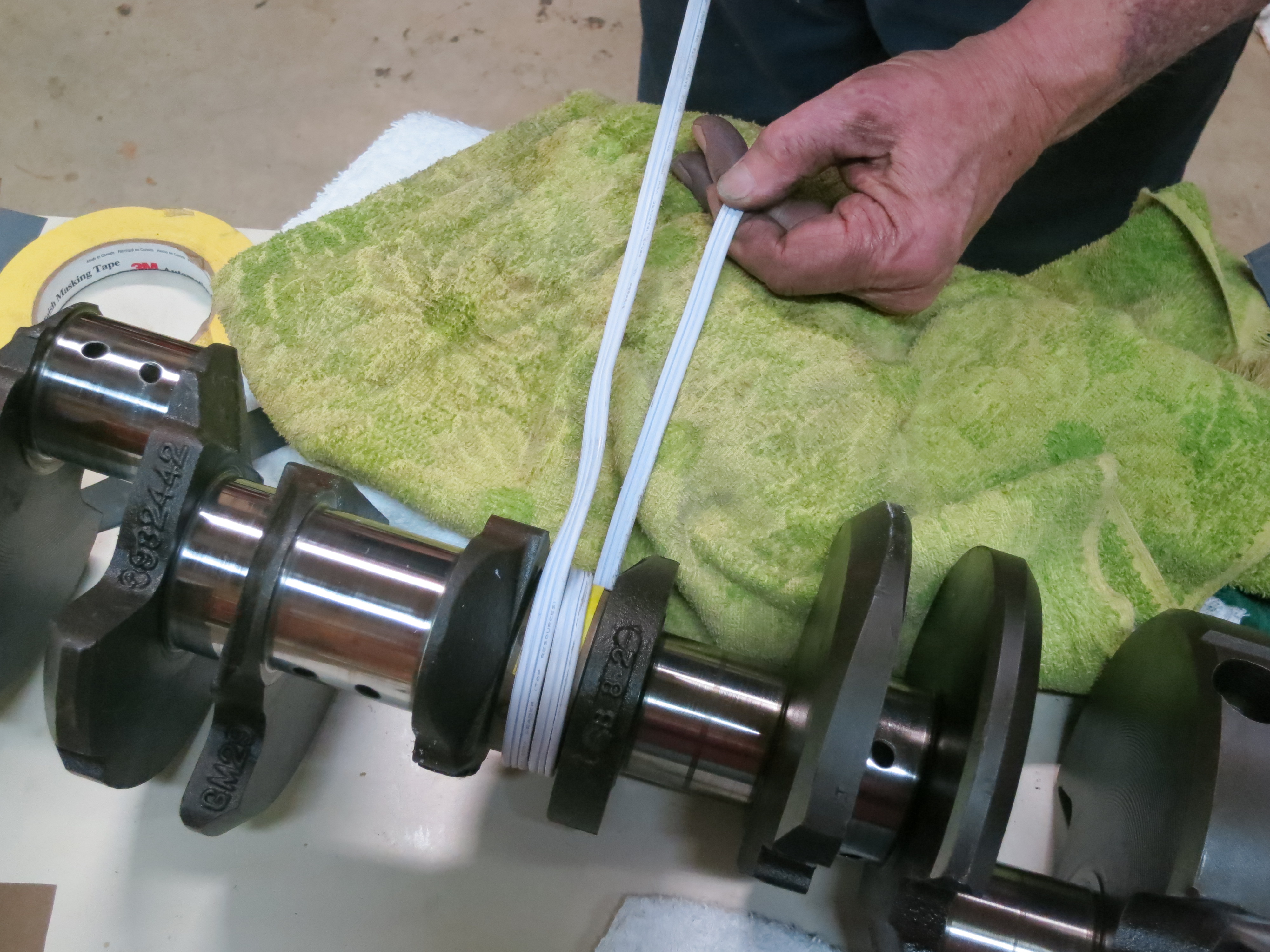

We did our work day yesterday. Finished honing the cylinders, polished the crank journals with a NEAT technique described in the SBC rebuild book, chamfered the cylinders to ease piston/ring installation, flushed out the water jacket, chased all the threaded holes in the block and cleaned the block of metal and abrasive dust. The polishing really worked well and gave a very nice result with 1000 grit paper.

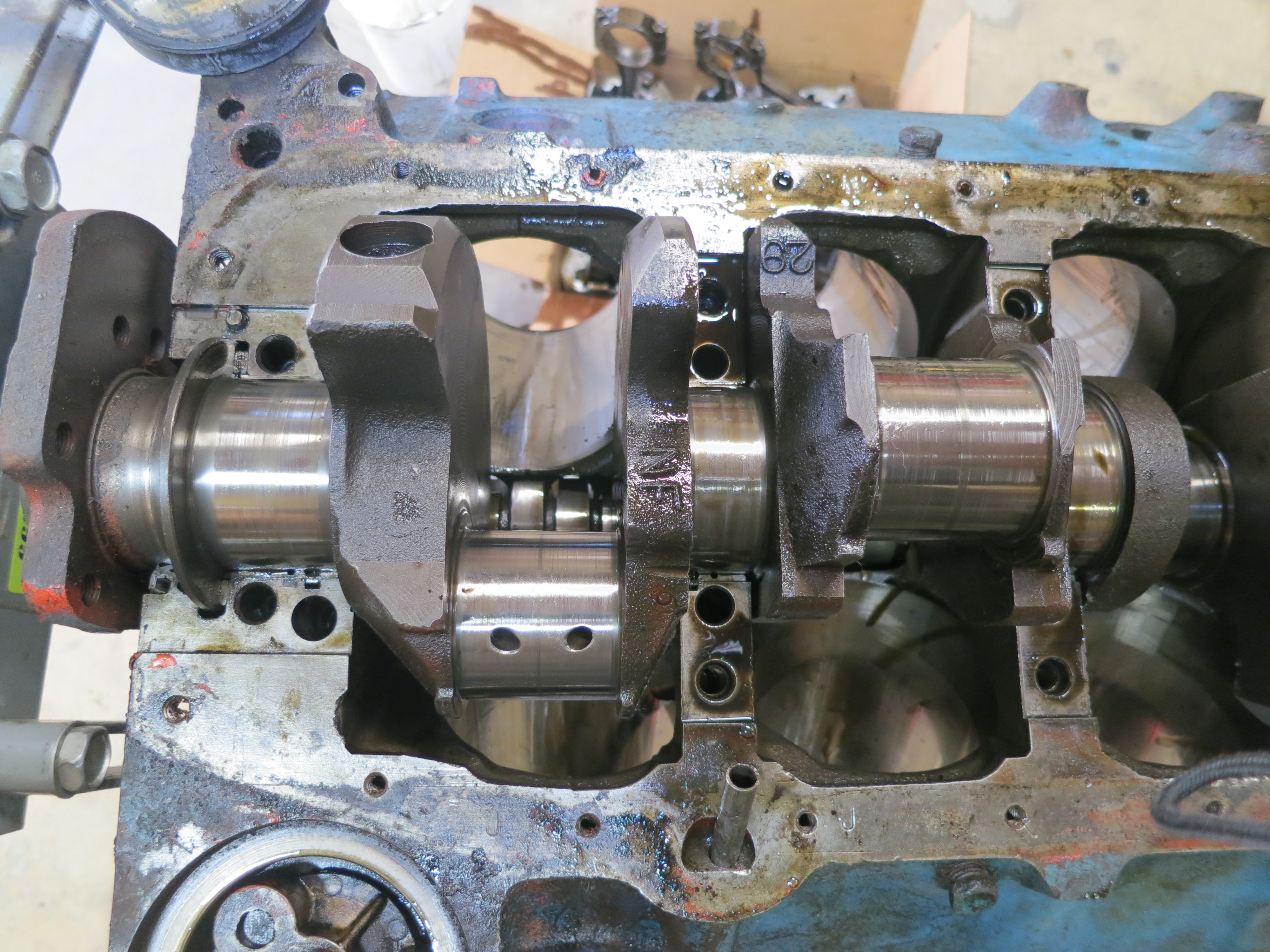

We had a pleasant day in the garage. Mid to high 80s here today so had the AC on for part of the time.
Got the freeze plugs and front cam bearing installed. Cam turns very smoothly with the new bearing.
Installed the main and rod bearings and plastigaged all. All are within spec. Installed the crank, with two-piece rear seal and torqued the main bearings. Next we'll put the rings on the pistons, install the pistons/rods and torque the rod bearings.
