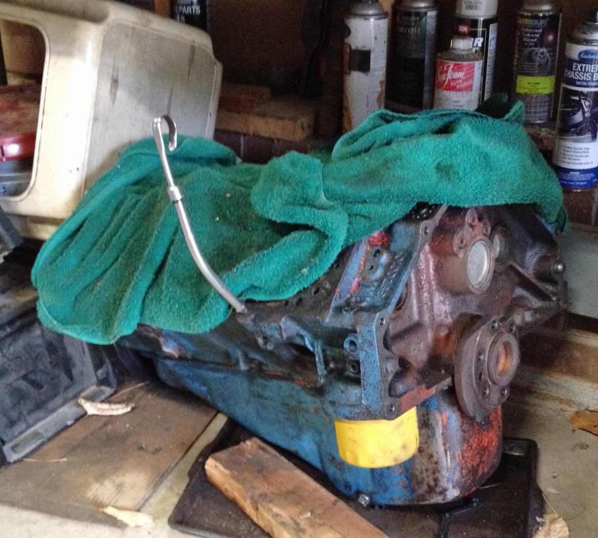

After selling his '81 El Camino, Maverick has an extra SBC engine left, so we decide to turn it into a project.
We are planning to rebuild it for resale and build an engine test stand to show buyers how well it runs.Re: SBC 350 + Test Stand
