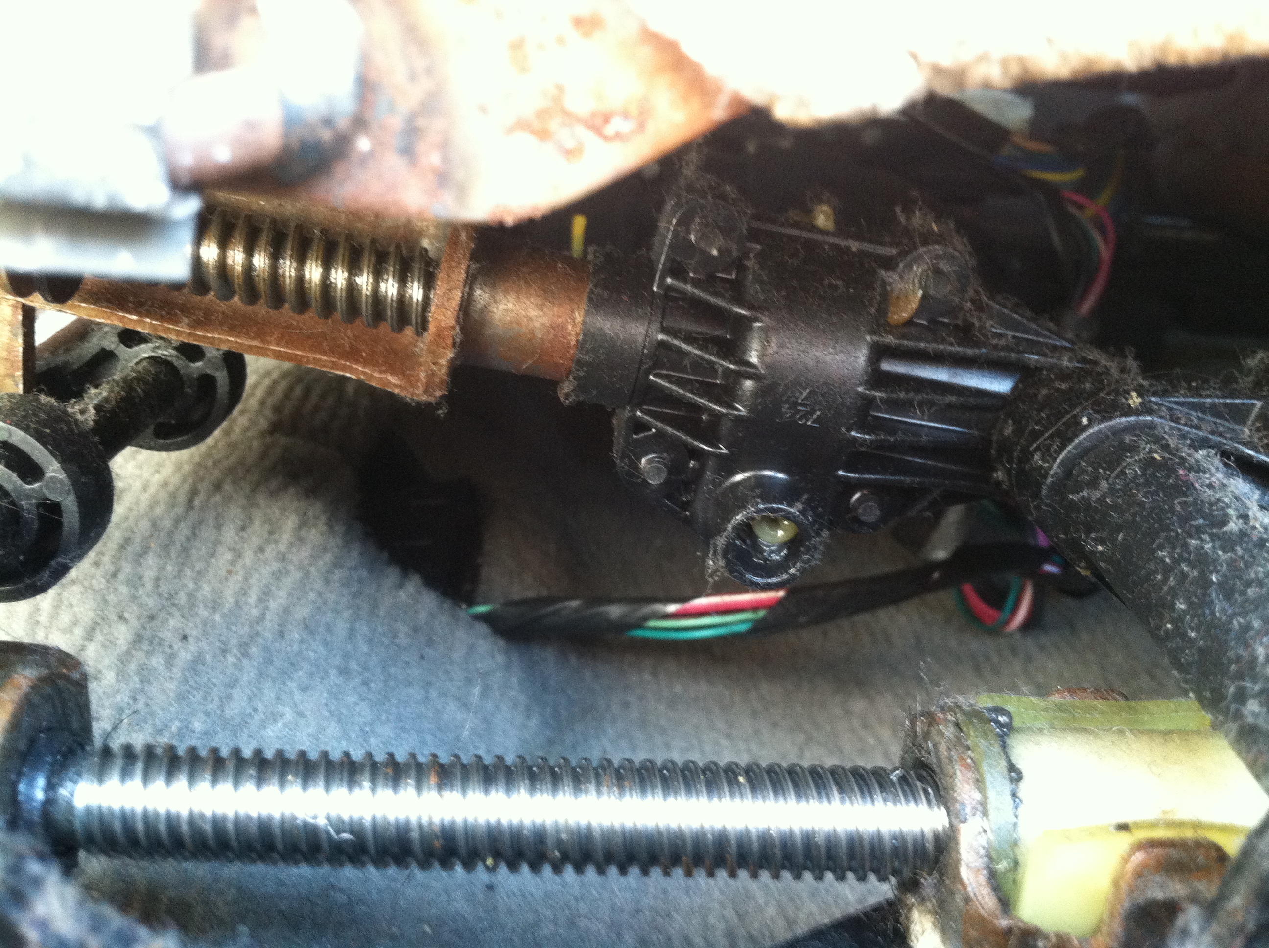

The seat is 6 way power when new. This part was seized up. Turns out it was not the electric motor but the gears. This part raises and lowers the front part of the seat. I had Kurt weld a nut to the end (off camera left) and now I can adjust it with a socket

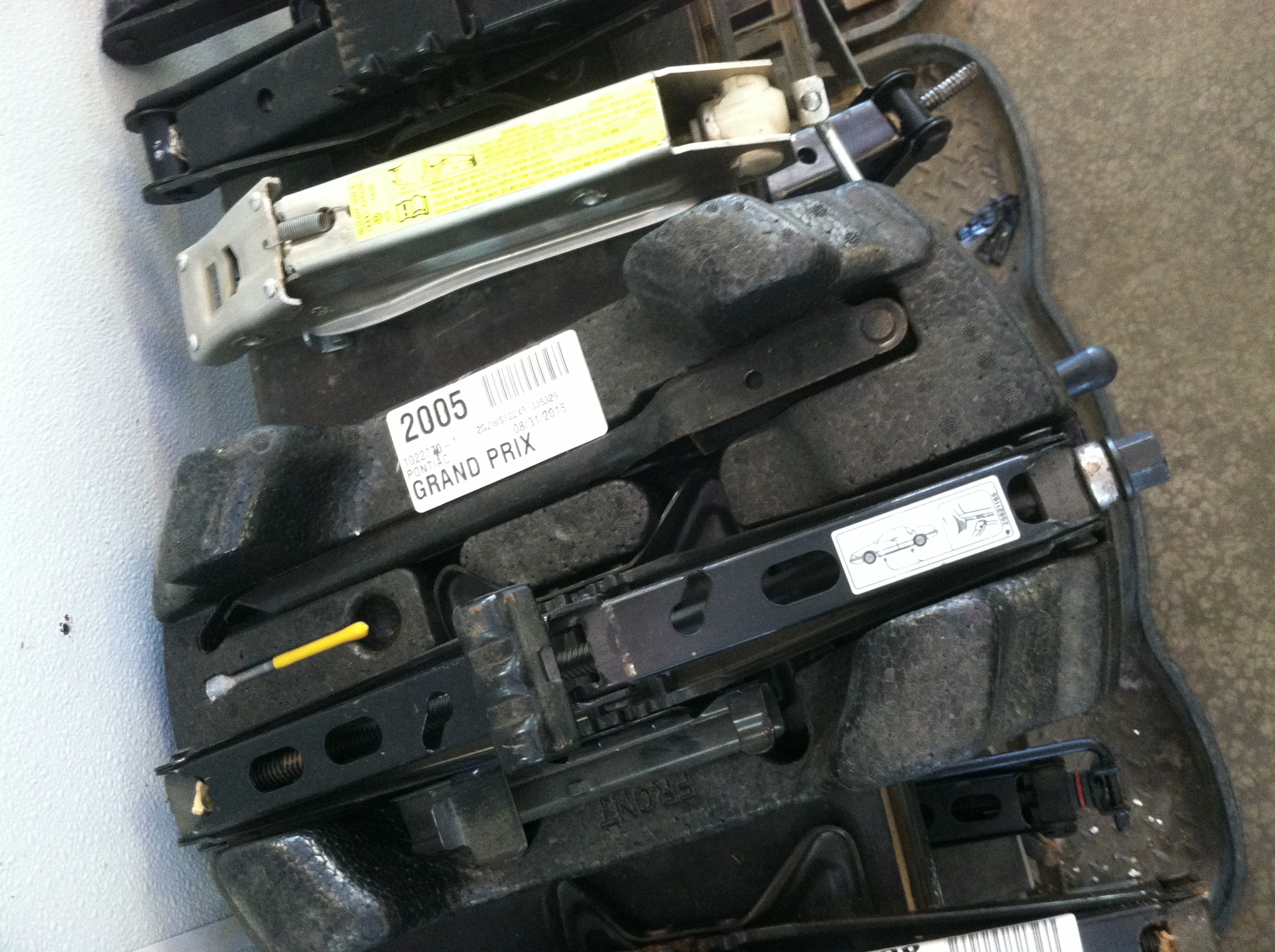

The jack I bought for $5 - came with the styrofoam which I needed:

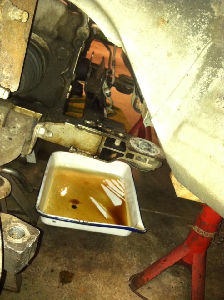

You have to lower the subframe to get the rack out.

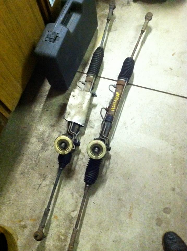

The replacement rack was $60 shipped to the house. It is off an 01 Monte Carlo with 117k and came from Illinois. Pullapart was at $55 + tax and u have to remove. No thanks.
