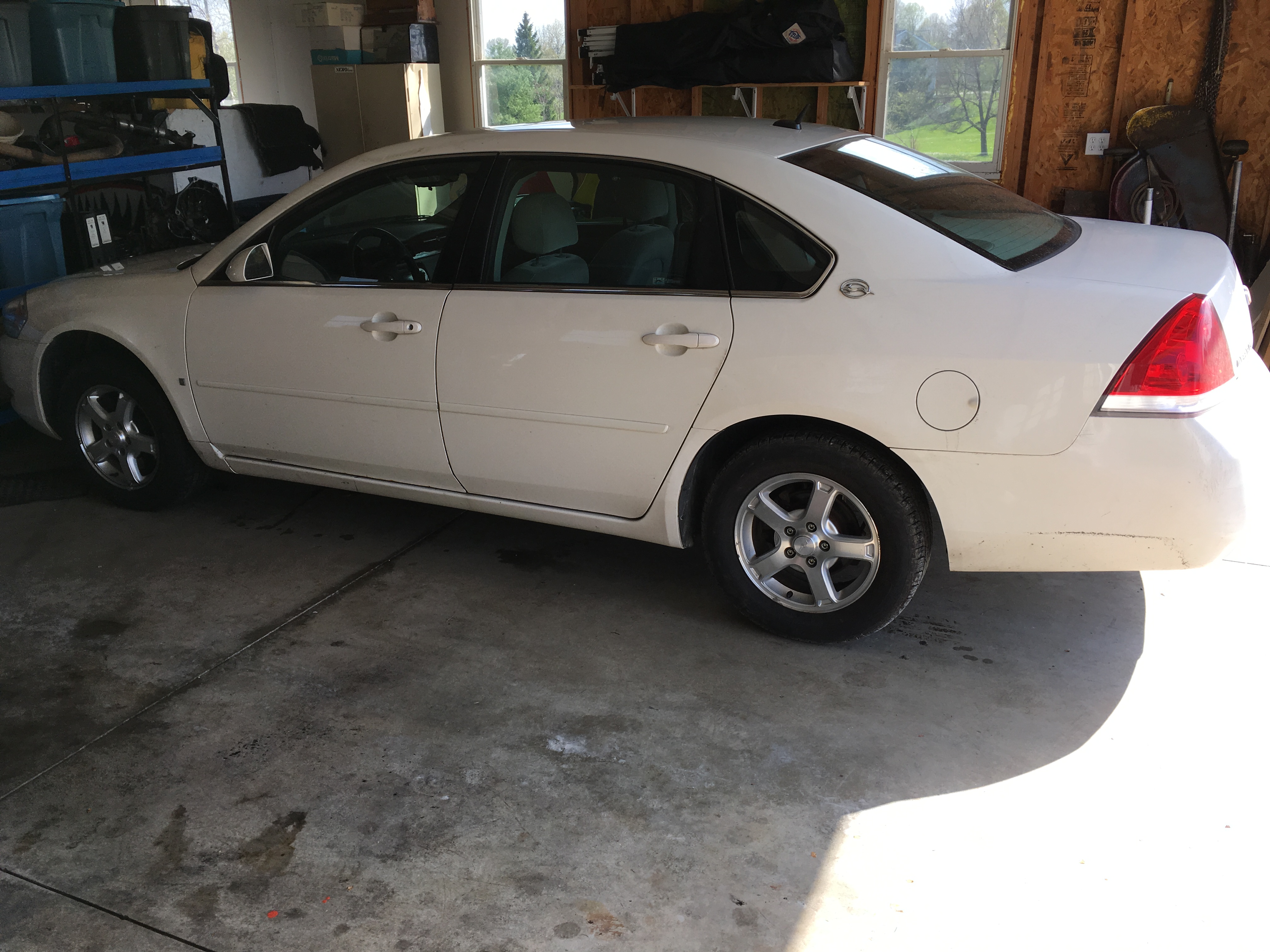

So faced with driving the SS over the winter, and the future prospect of two teenage drivers, I bought another car. It's a 2006 Impala LS. High miles - 181k but looks pretty clean underneath. For $1800 it feels like a low risk investment.
Posts: 3040
Re: 06 Impala - Mostmint #37
The car - the day I brought it home:

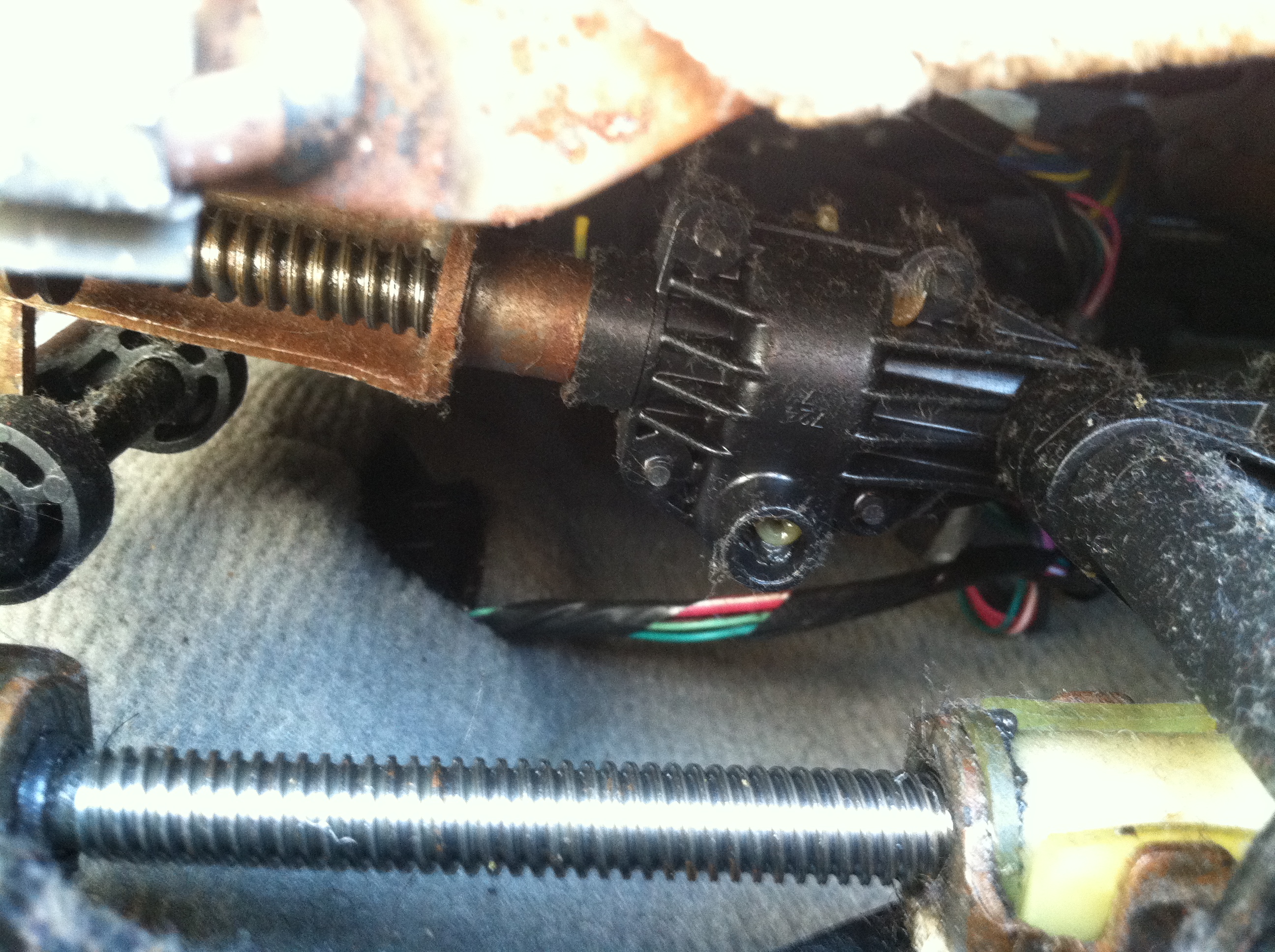

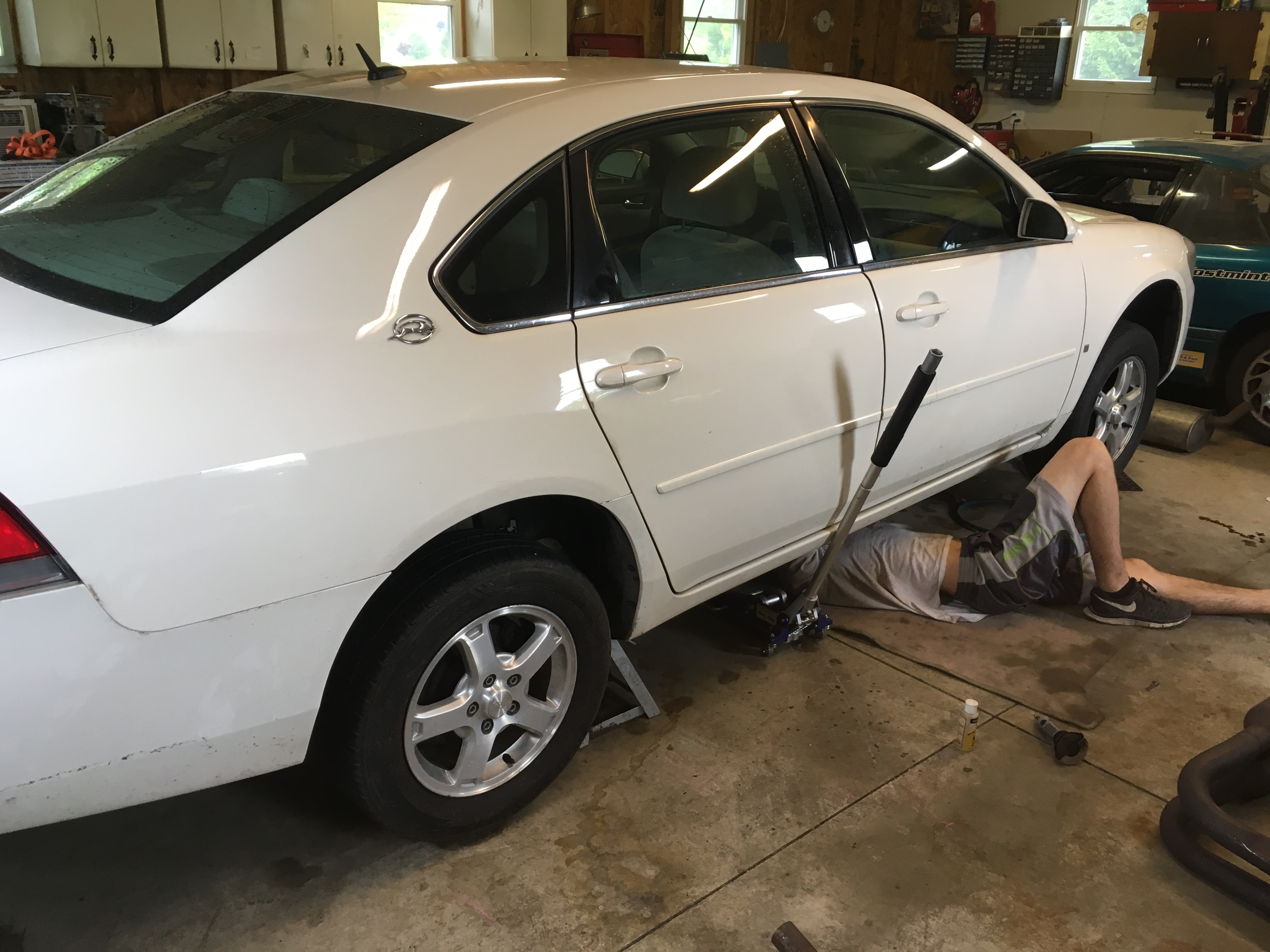

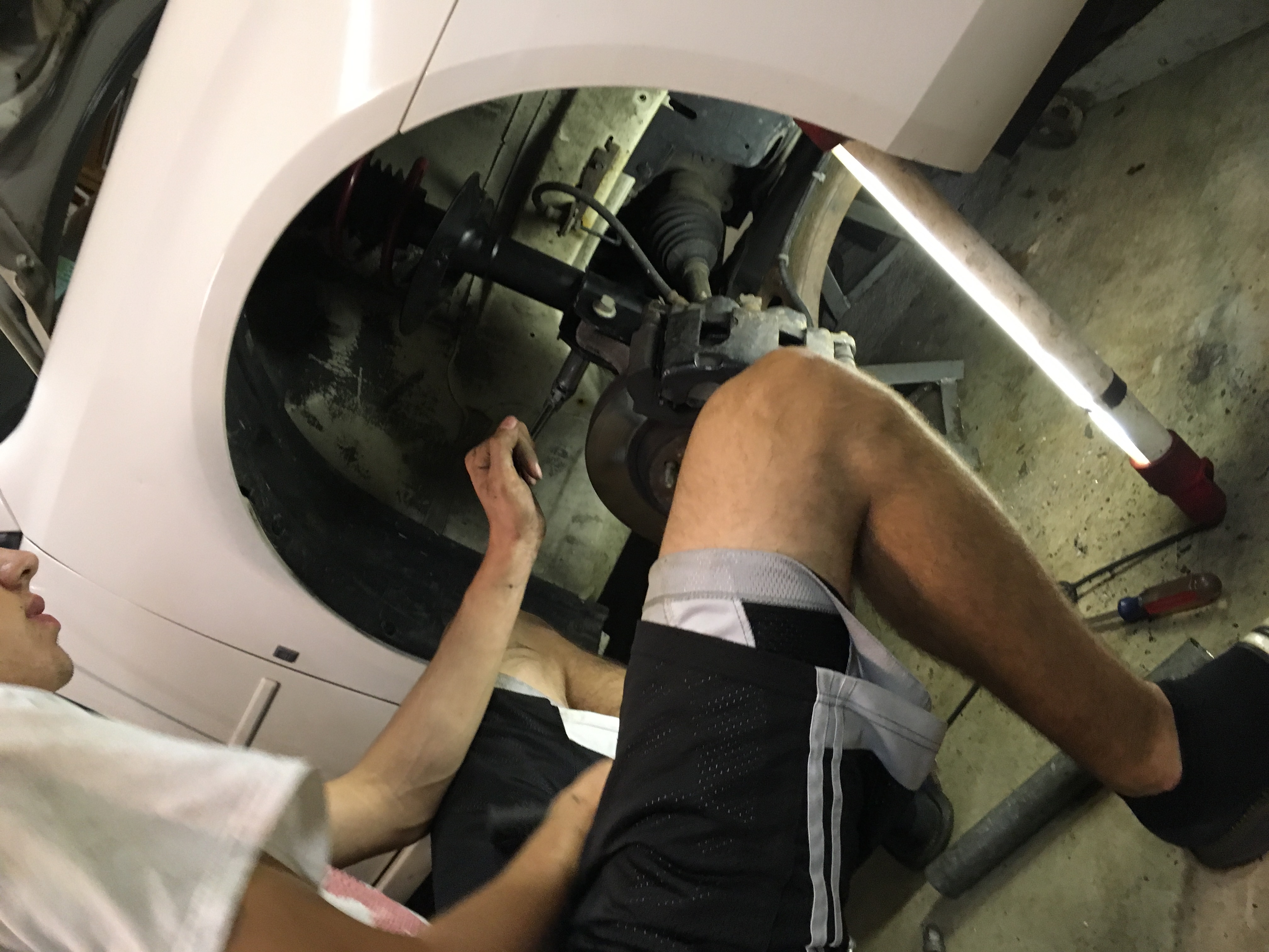

So far I did a front toe alignment, put Blizzaks on it, added a hubcap, fabricated a hinge for the center console, got some floor mats and a jack, and changed out the rack.
The seat is 6 way power when new. This part was seized up. Turns out it was not the electric motor but the gears. This part raises and lowers the front part of the seat. I had Kurt weld a nut to the end (off camera left) and now I can adjust it with a socket

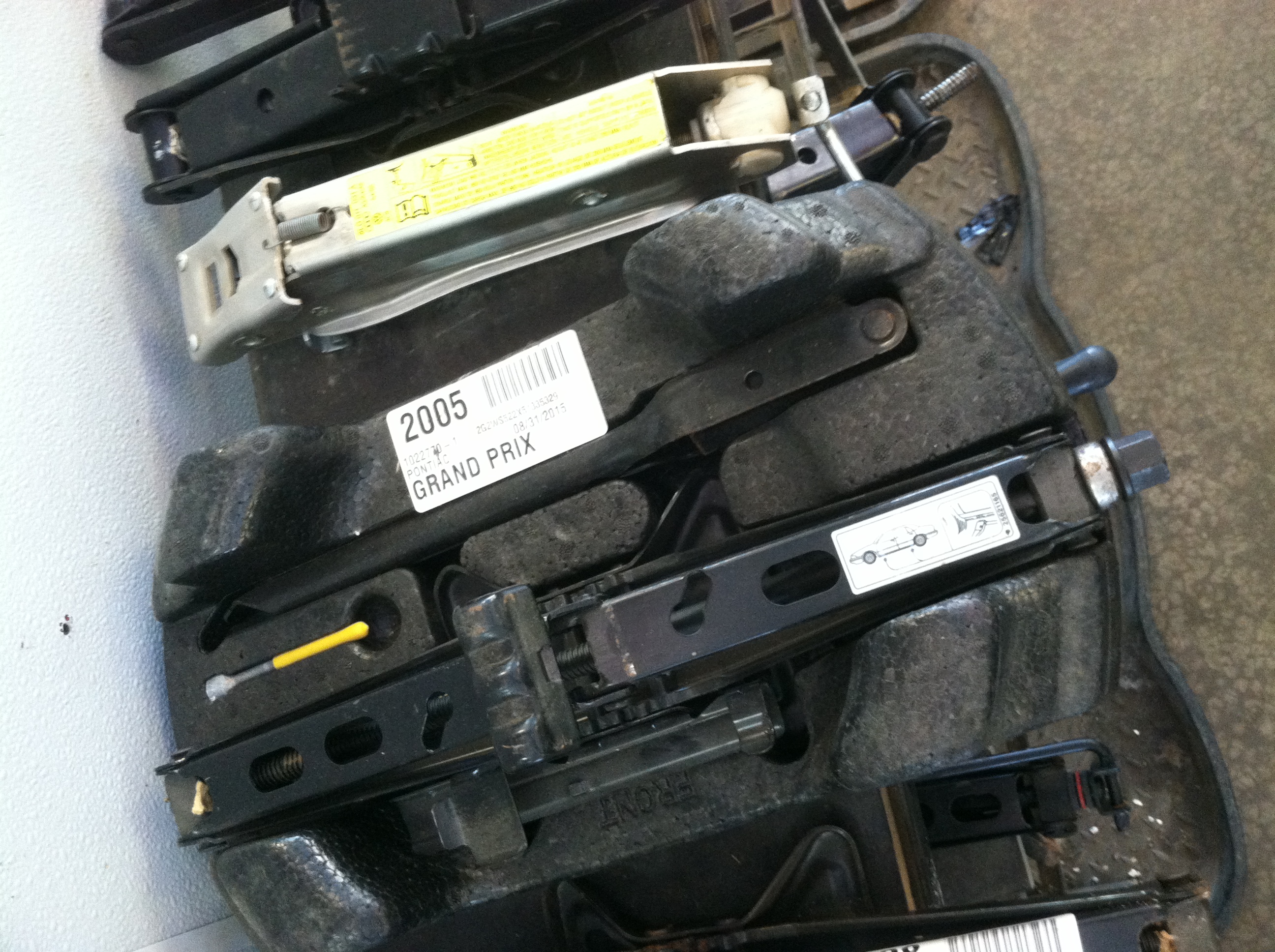

The jack I bought for $5 - came with the styrofoam which I needed:

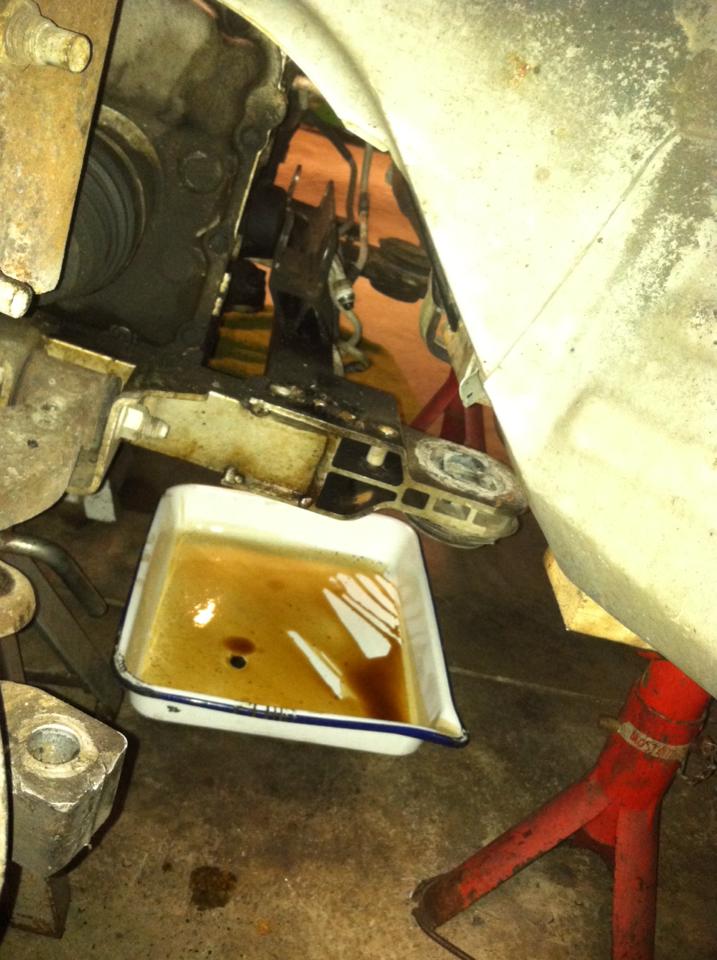

You have to lower the subframe to get the rack out.
06 steering rack swap 2.jpg (89.97 KiB) Viewed 17753 times

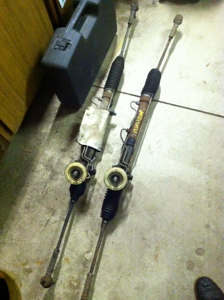

The replacement rack was $60 shipped to the house. It is off an 01 Monte Carlo with 117k and came from Illinois. Pullapart was at $55 + tax and u have to remove. No thanks.

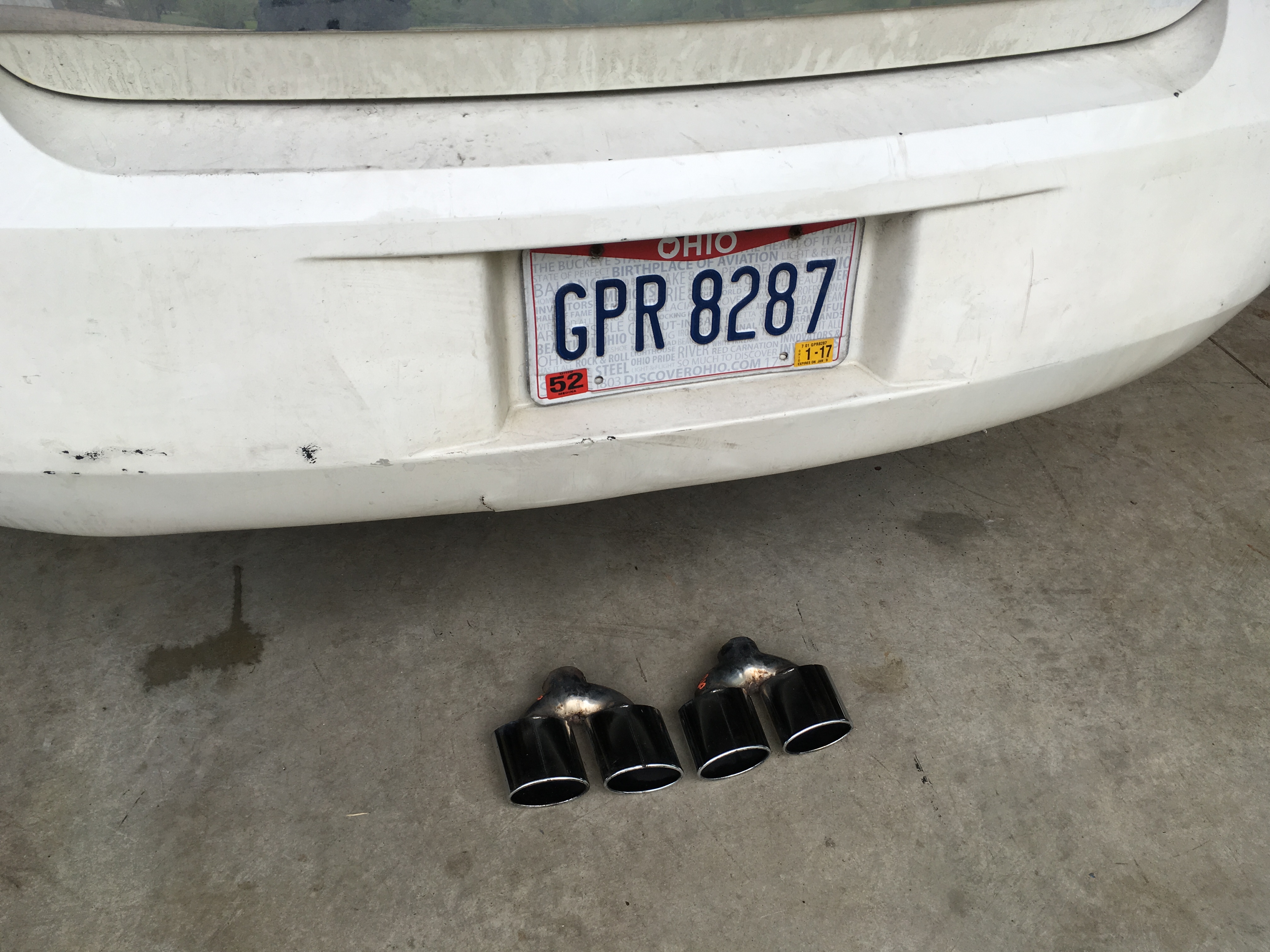

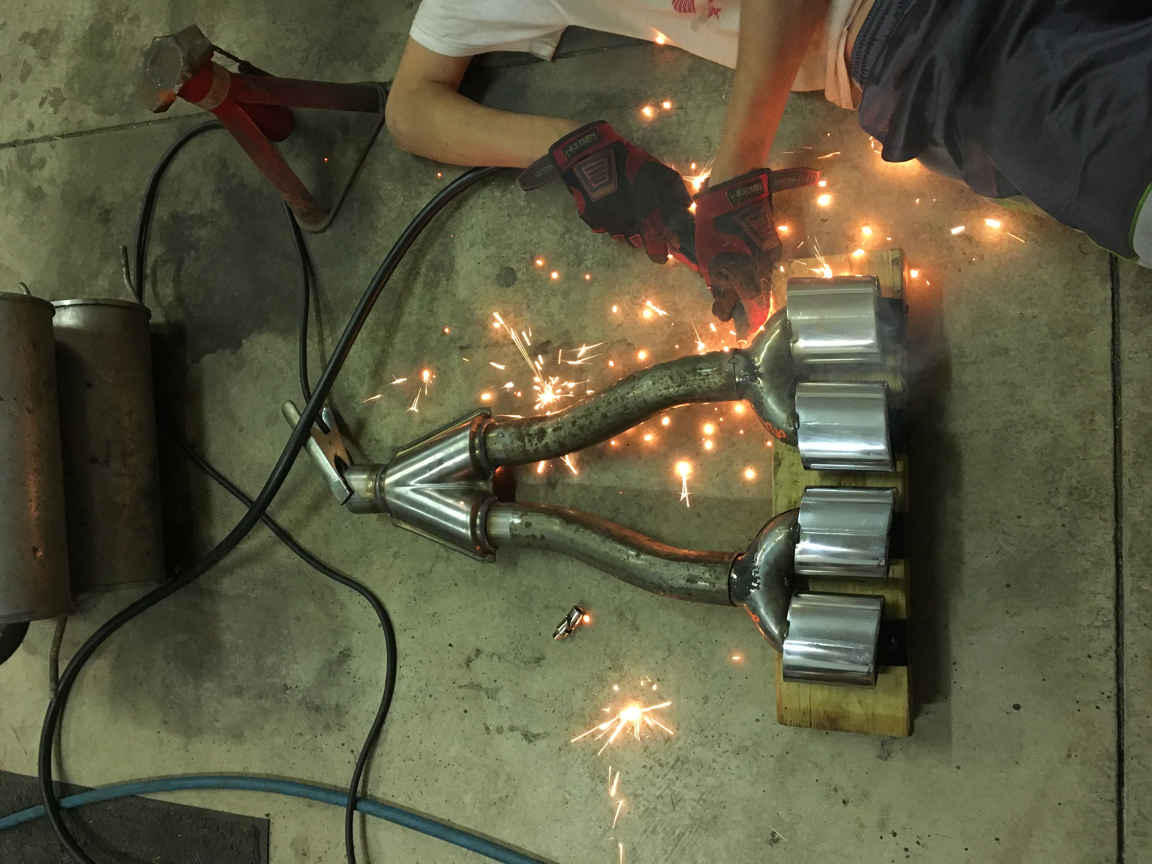

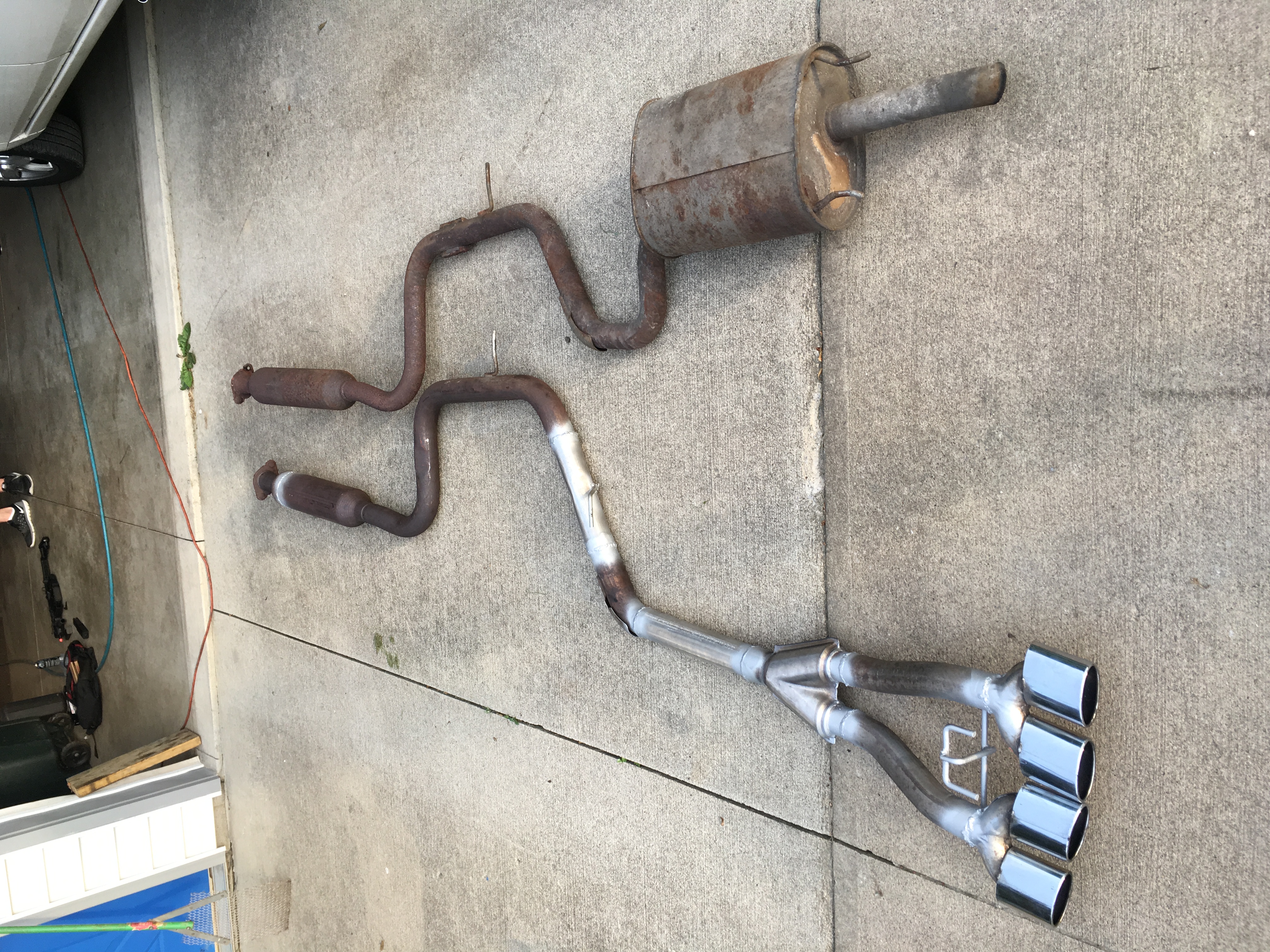

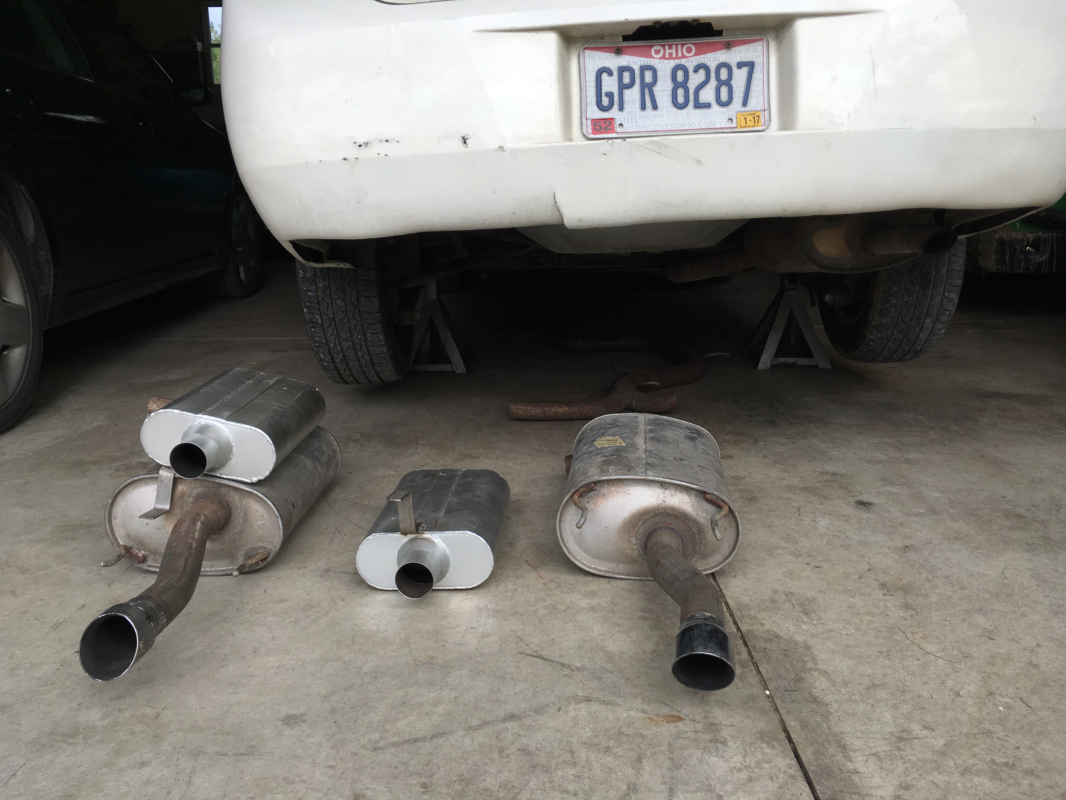

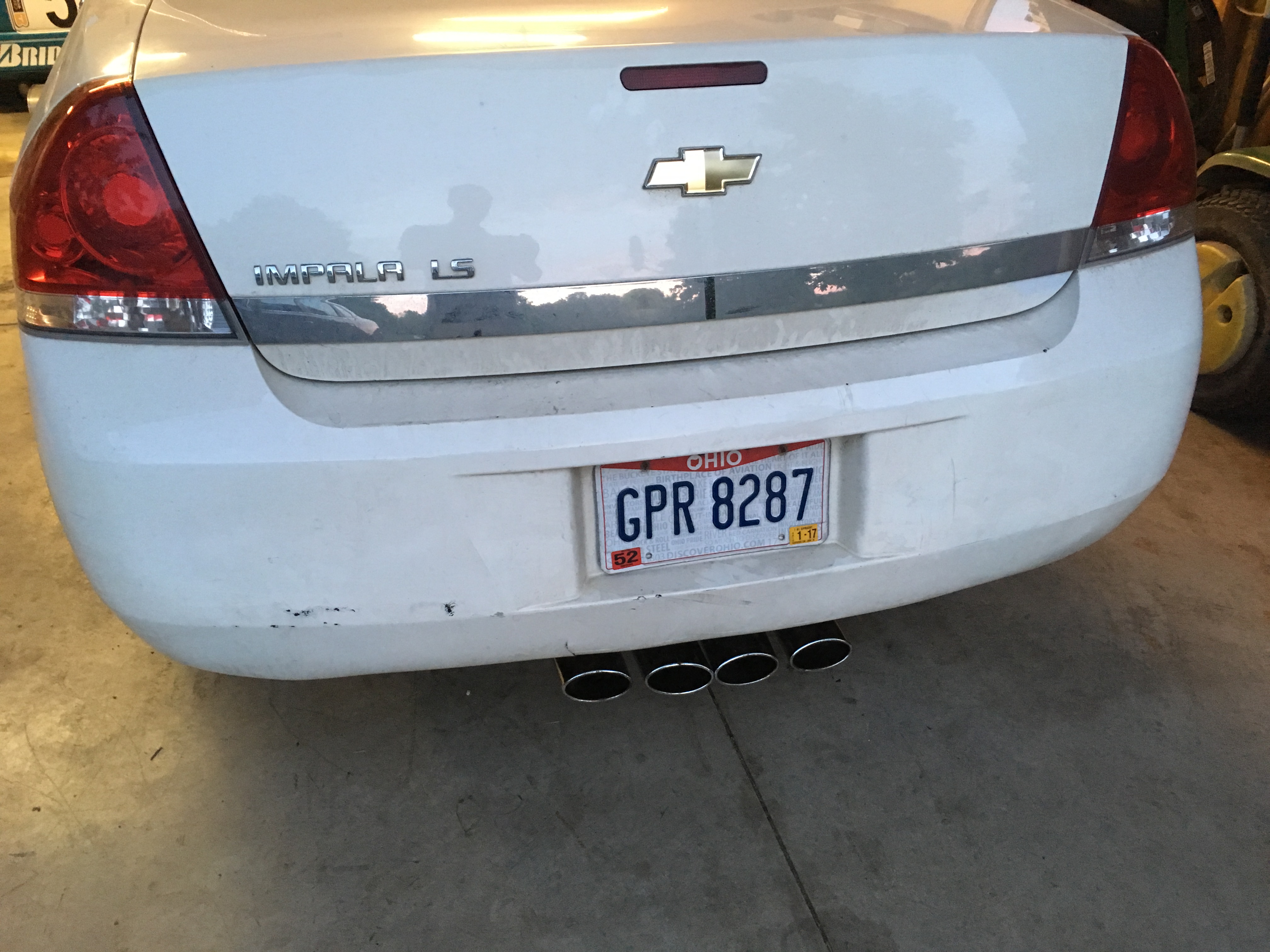

He also wanted the car to sound like a car. I got a set of mufflers from a co-worker:

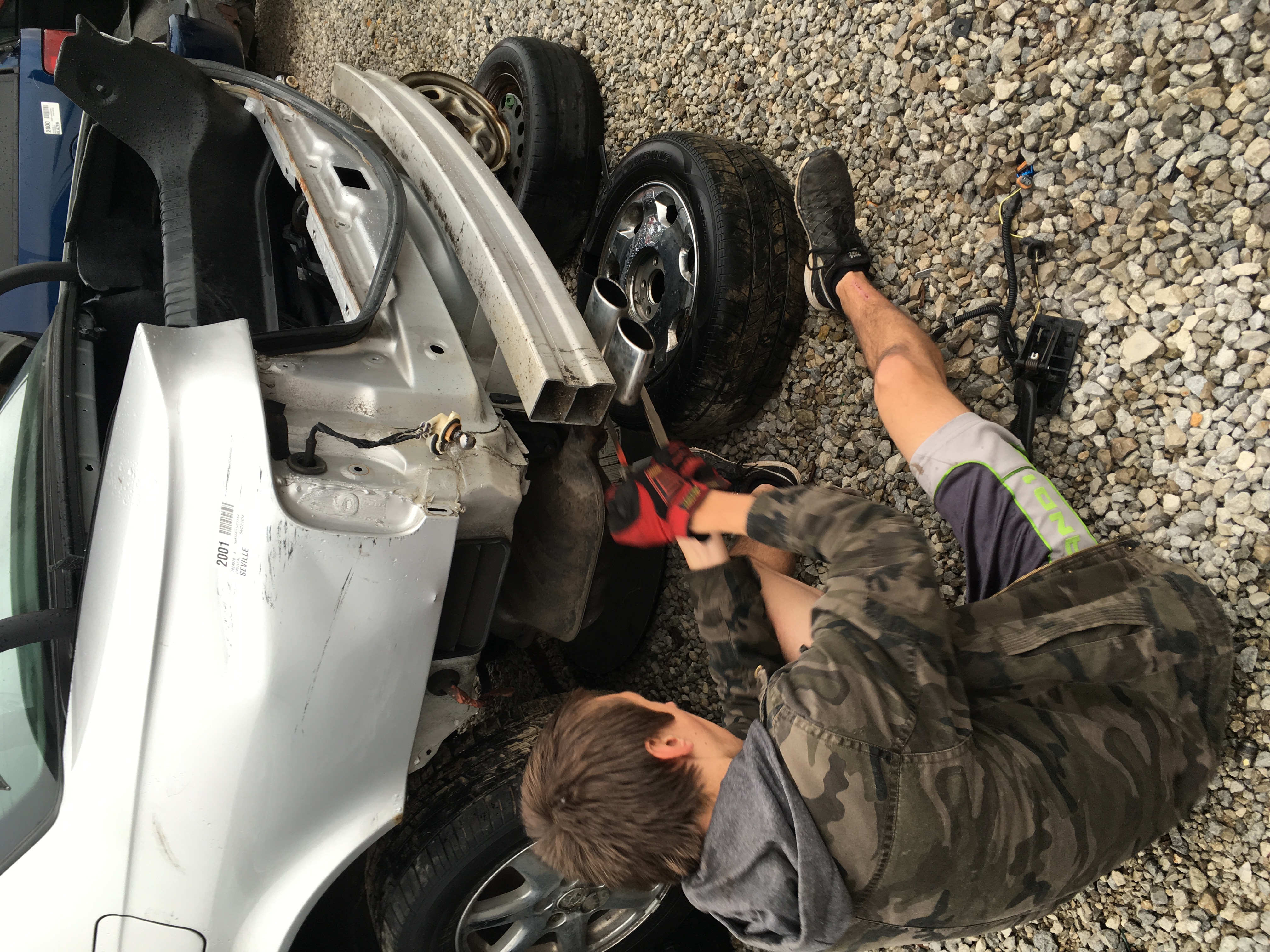

Found some exhaust tips at the junkyard

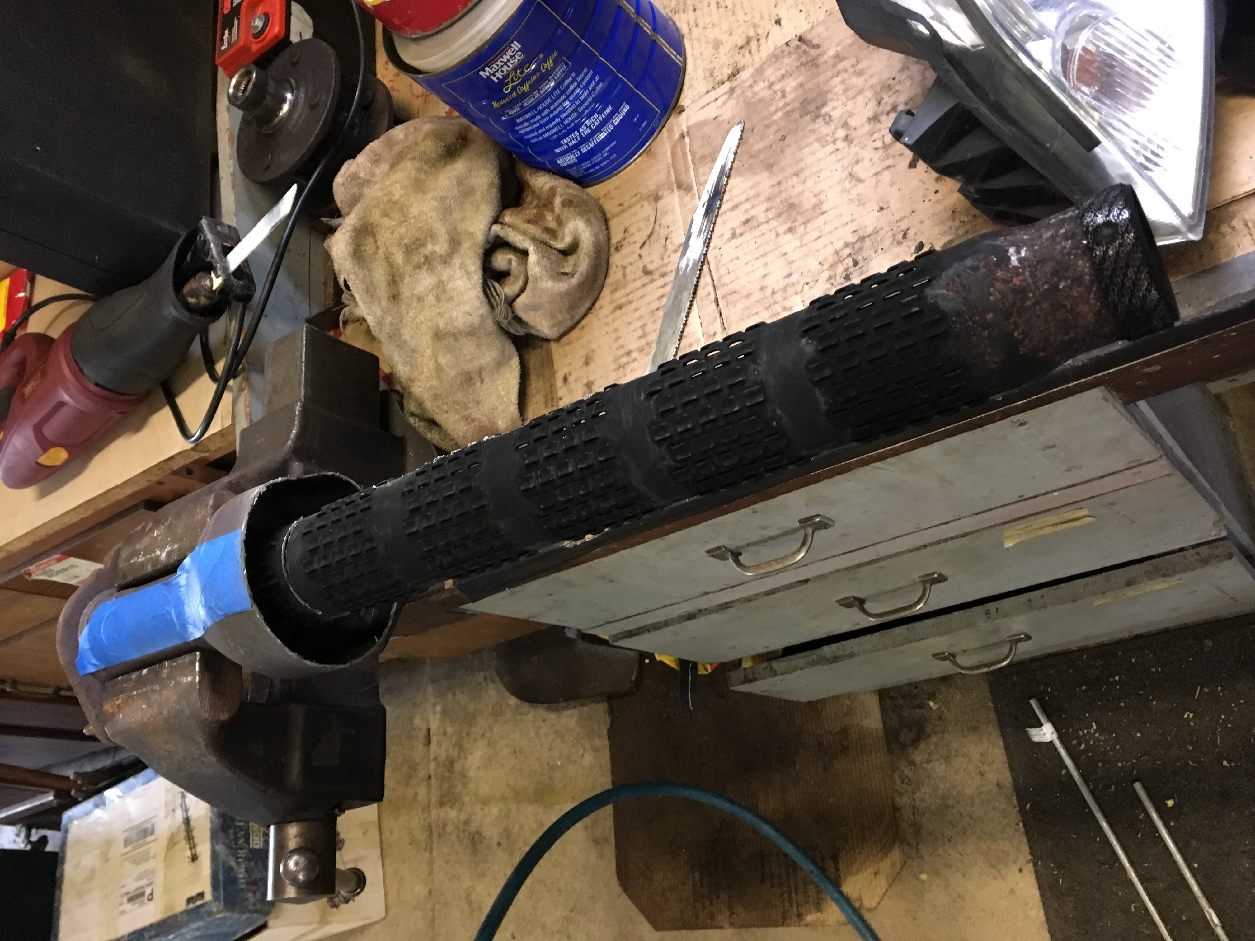

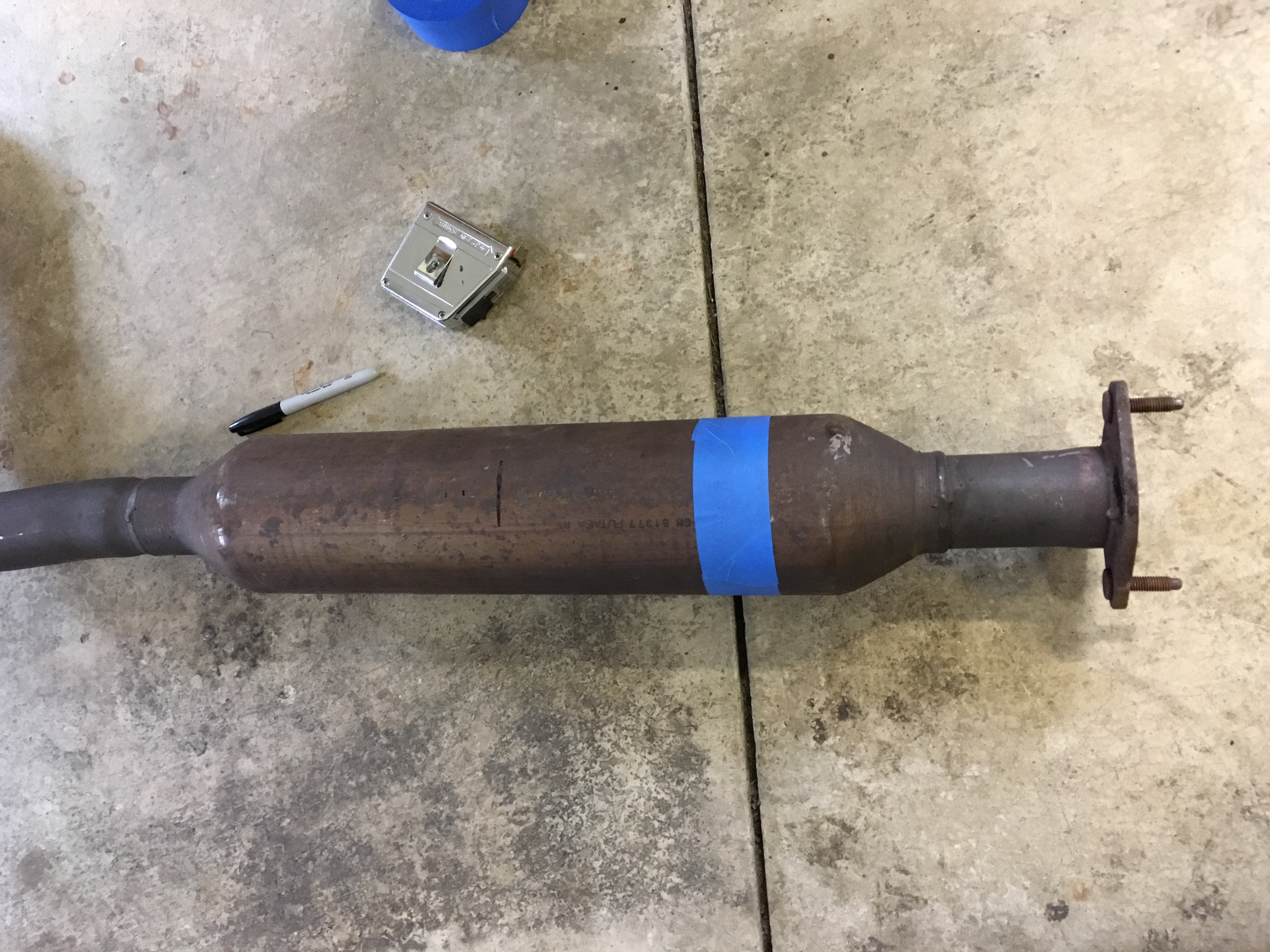

We figured out we could cut open the resonator and tune the tone with that. It took a few tries so we taped the resonator back together for the short tests
Looks like these Seville exhaust tips can look like Corvette exhaust. No mufflers is going to allow this to work

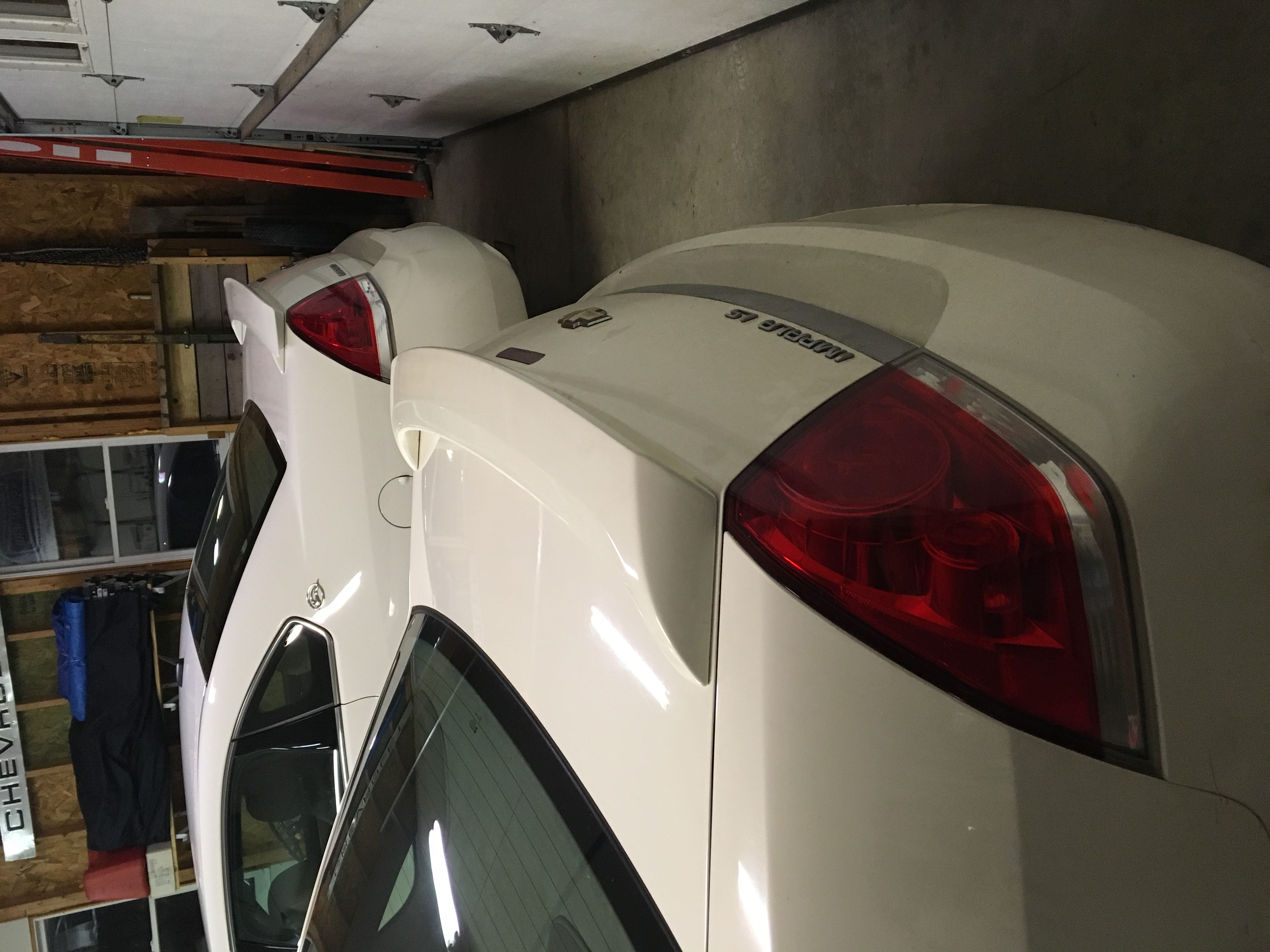

I would clean up that trunk by pulling the IMPALA LS badges off. Would look cooler with that badass exhaust. Maybe black out the bowtie too. Didn't you put the lowering springs on it also? I love that Kurt is into hot rodding his Impala.

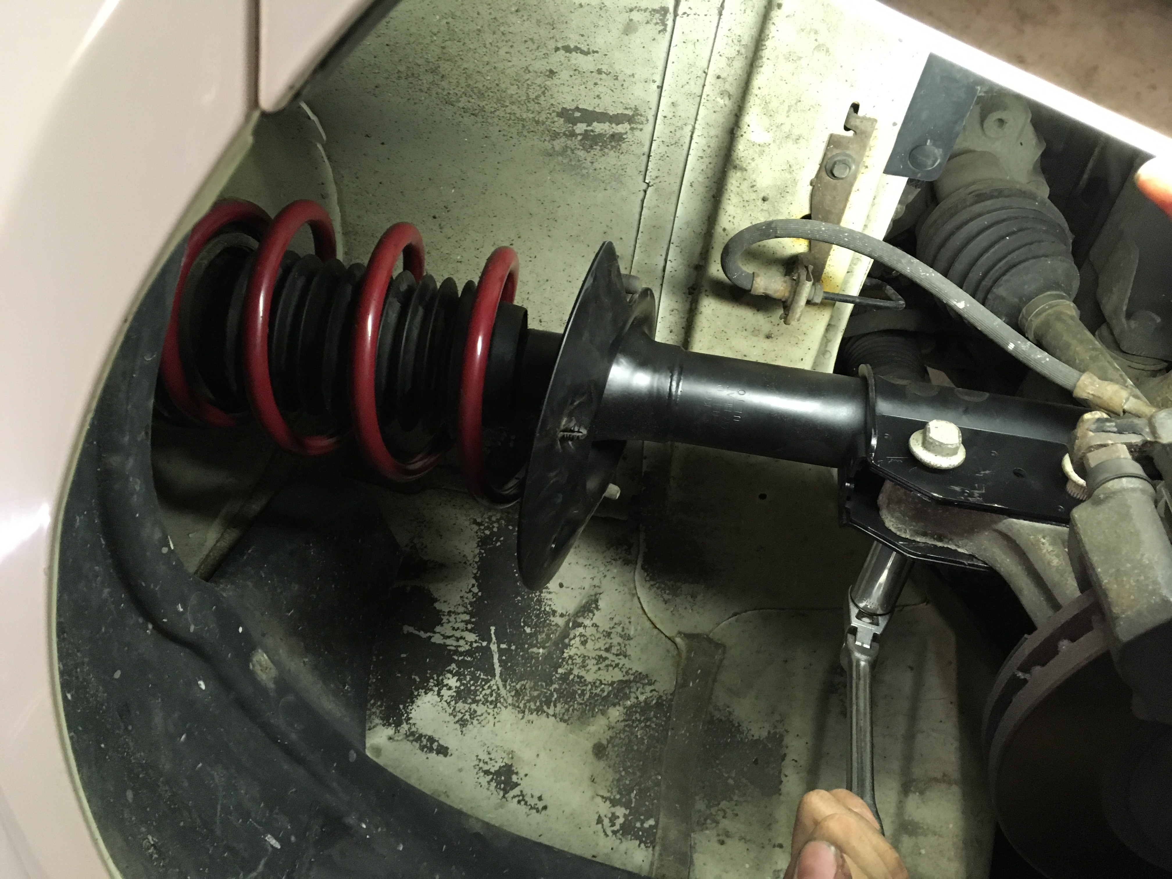

Since the car has over 180k and it looked/rode like the original struts, I told him I would buy him the struts if he put them in the car. Earlier this year when we went to MN I took the SS and decided I did not want to ride in a buckboard for 16 hours each way, so I put other springs in it. This created the opportunity to put my lowering springs in the car.

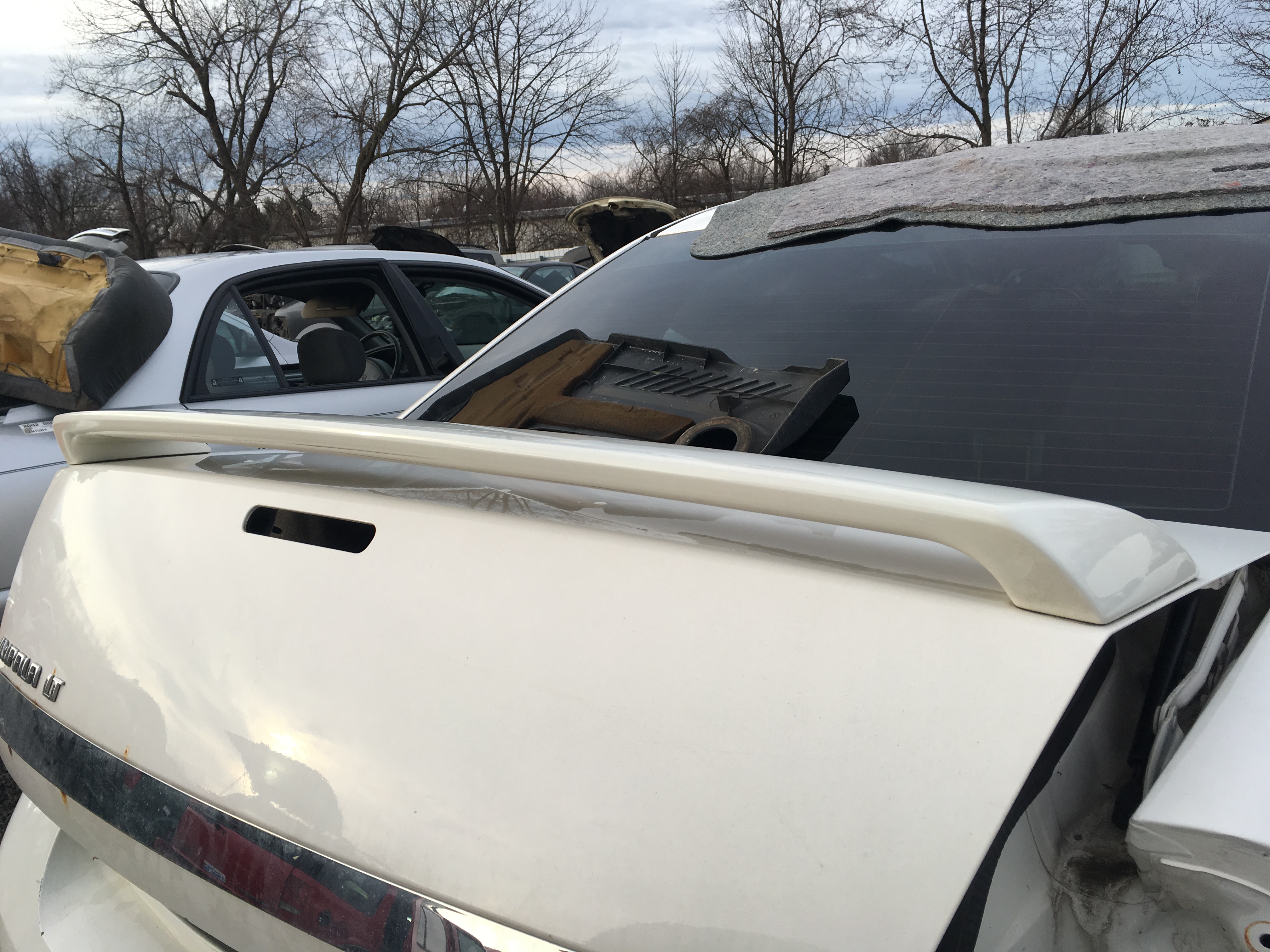

Found this at pull-a-part a couple weeks back
Now it is on Kurt's car. Got to love finding color matching parts at the junkyard.

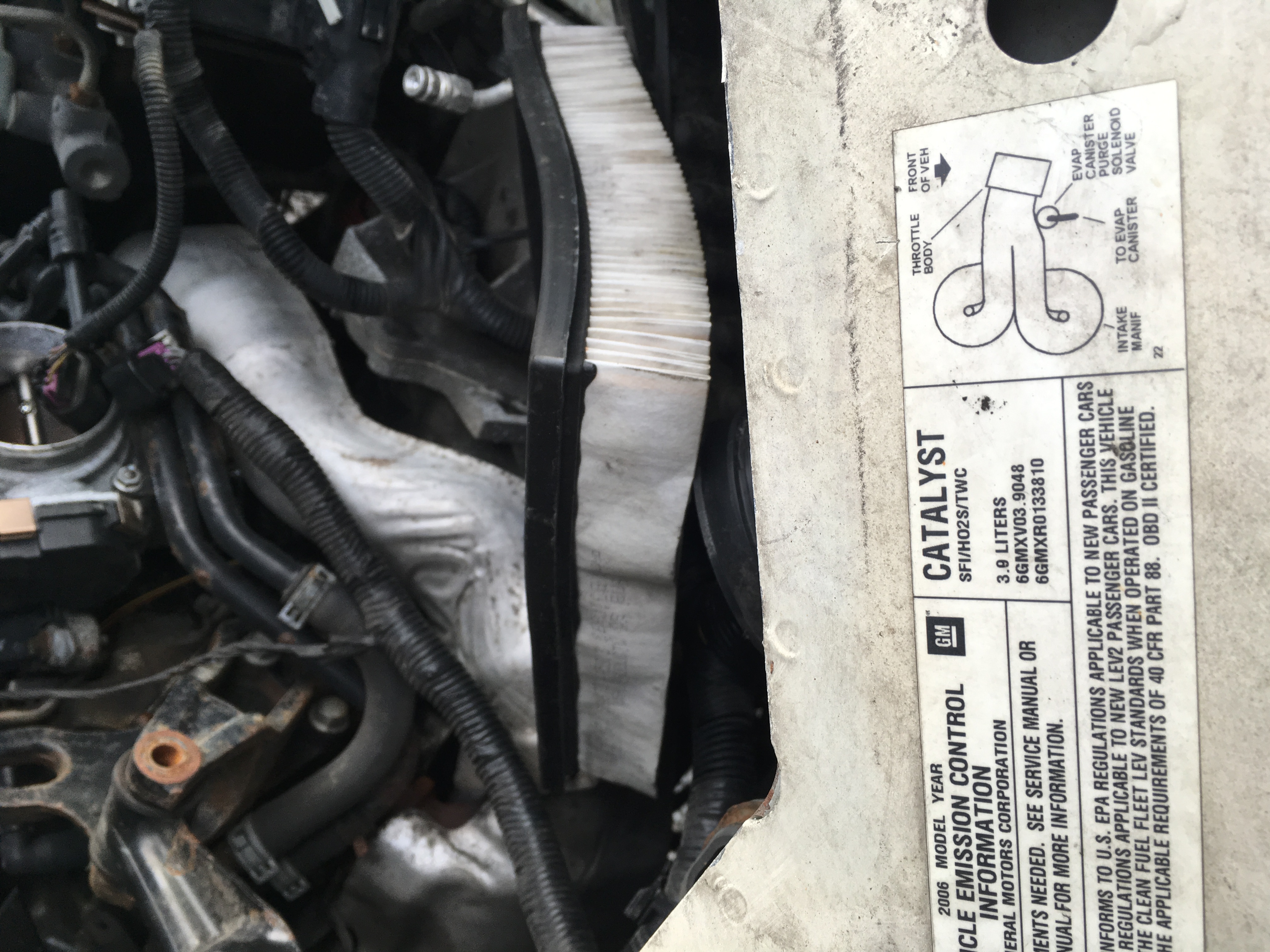

This parts car had a 3.9 we'll see if he wants to go get the trans for his:

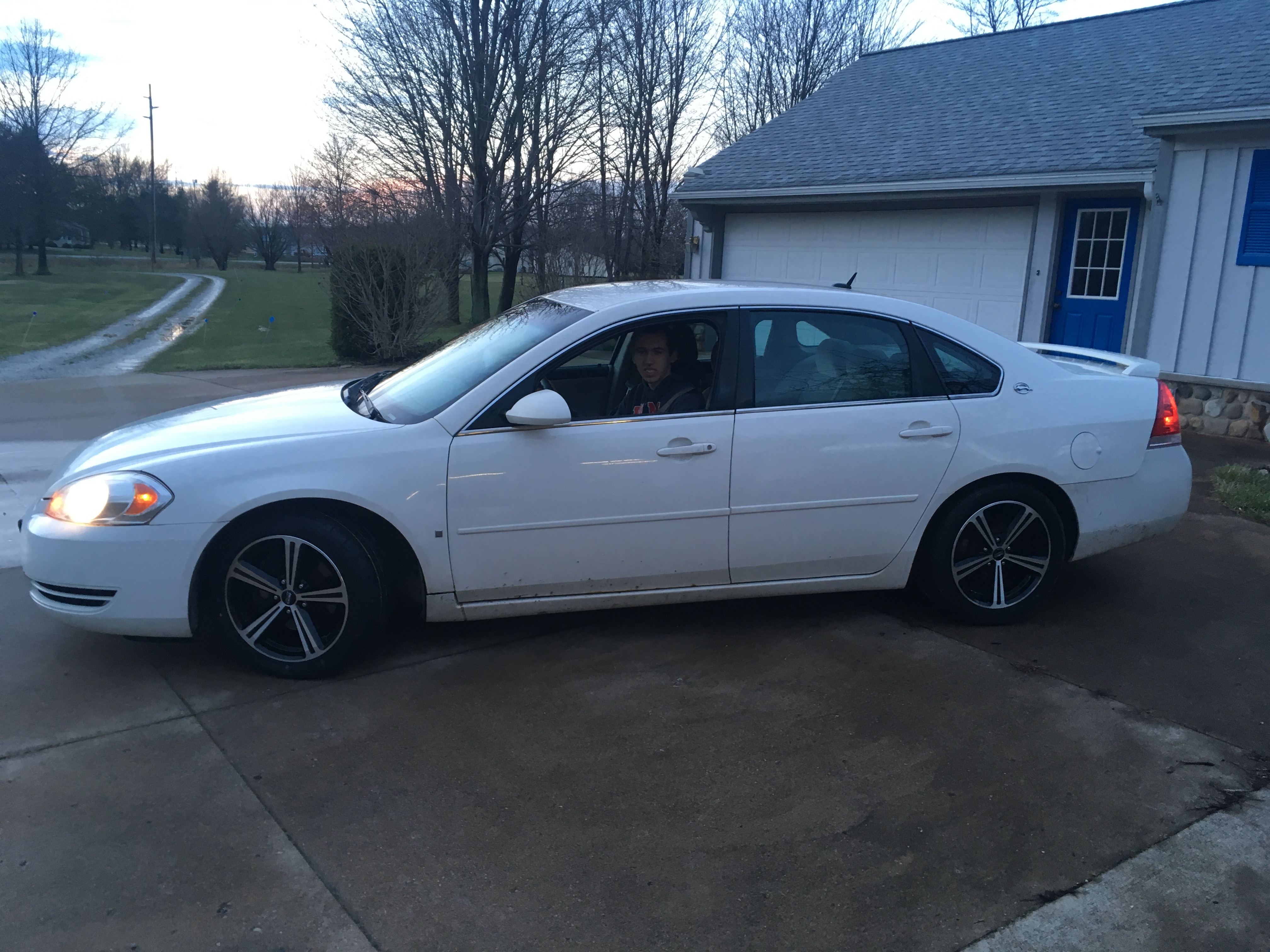

Kurt's Christmas and birthday presents are on his car:
Posts: 3682
With the lowered suspension, those look sweet. Way better than I thought. Nice!

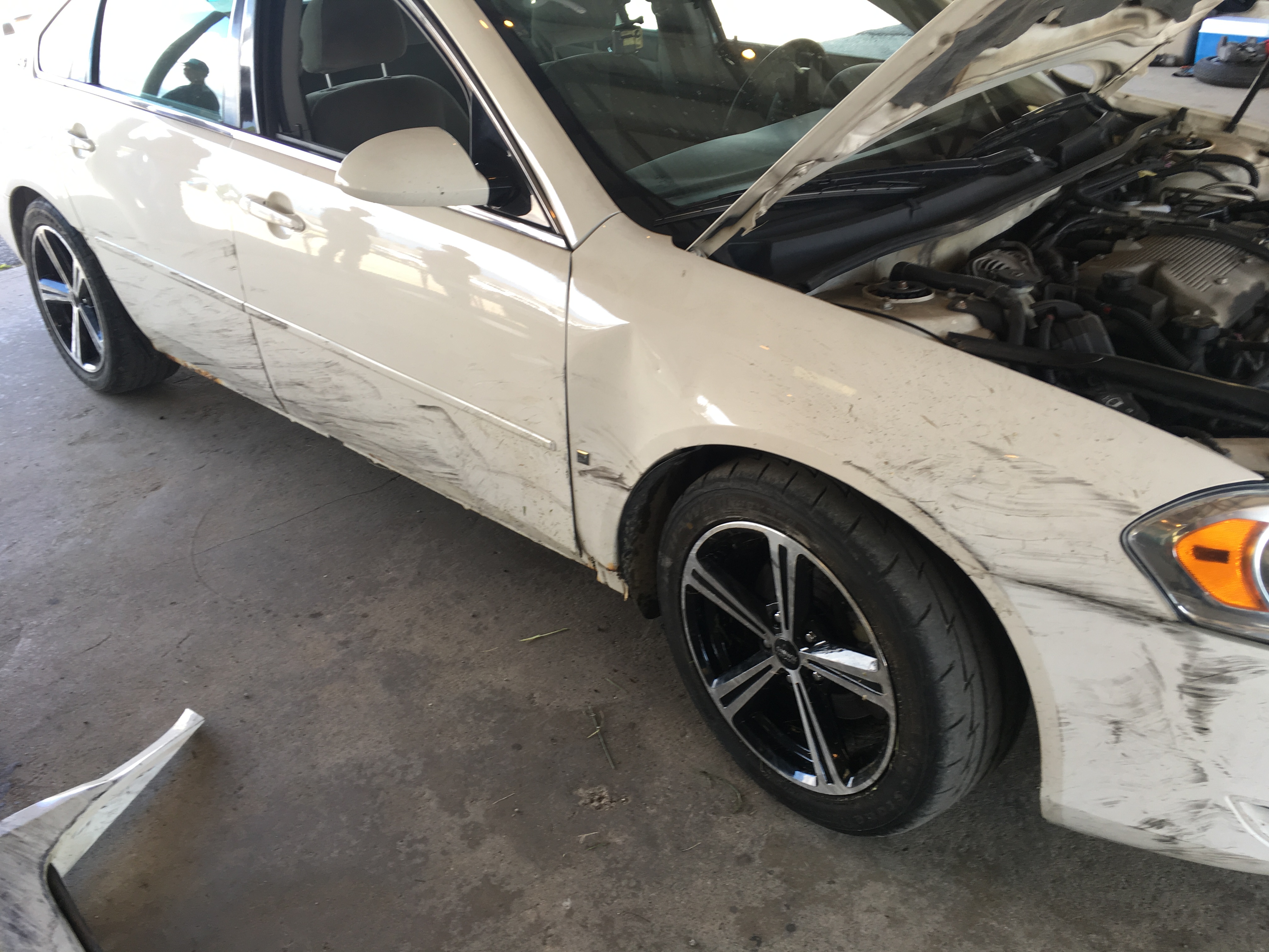

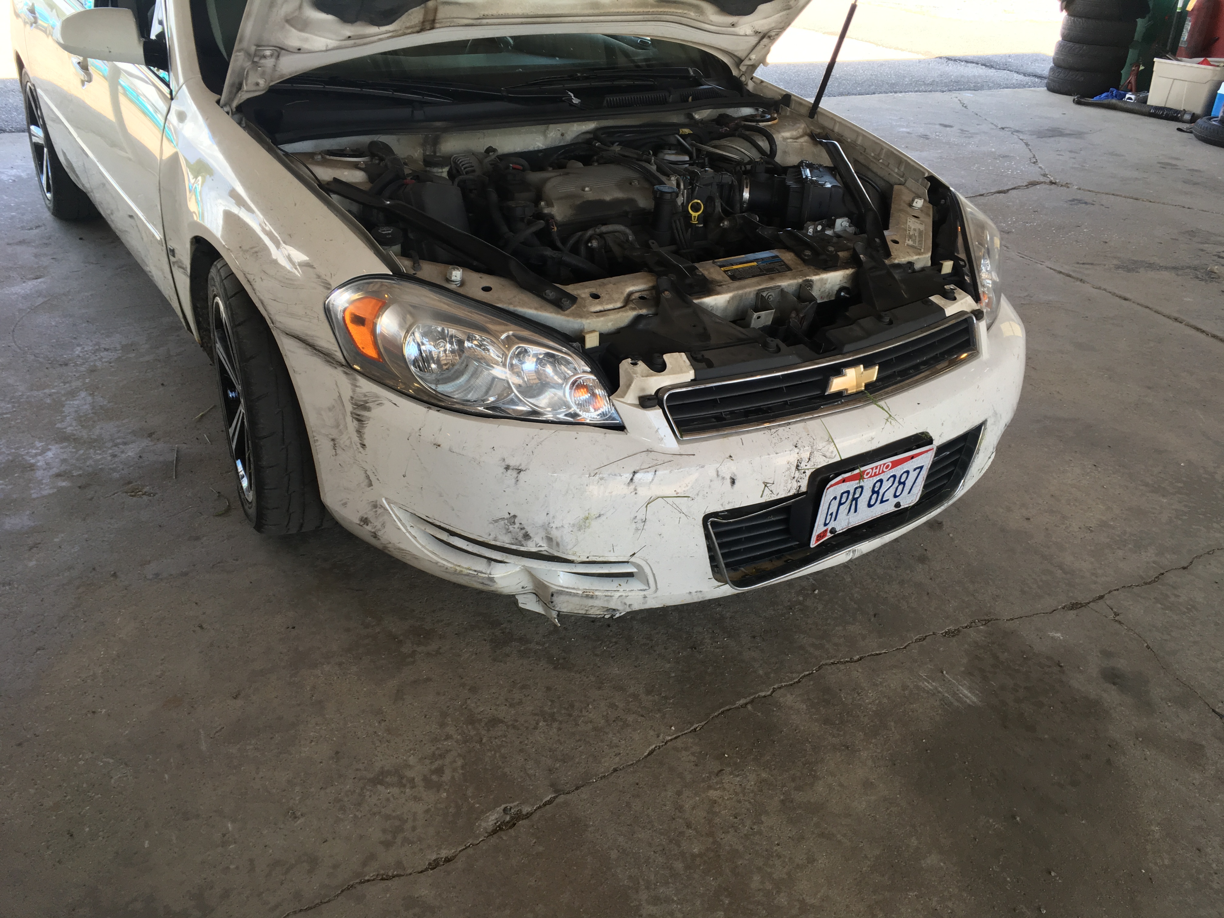

The Impala and Kurt went out for track day. Everything went pretty well except the car had an encounter with the tire barrier. It was all cosmetic
I don't have good update pics but the black marks from the tires all came out with buffing compound - it really could use a new RF fender but we'll wait for a white one to show up at pull-a-part

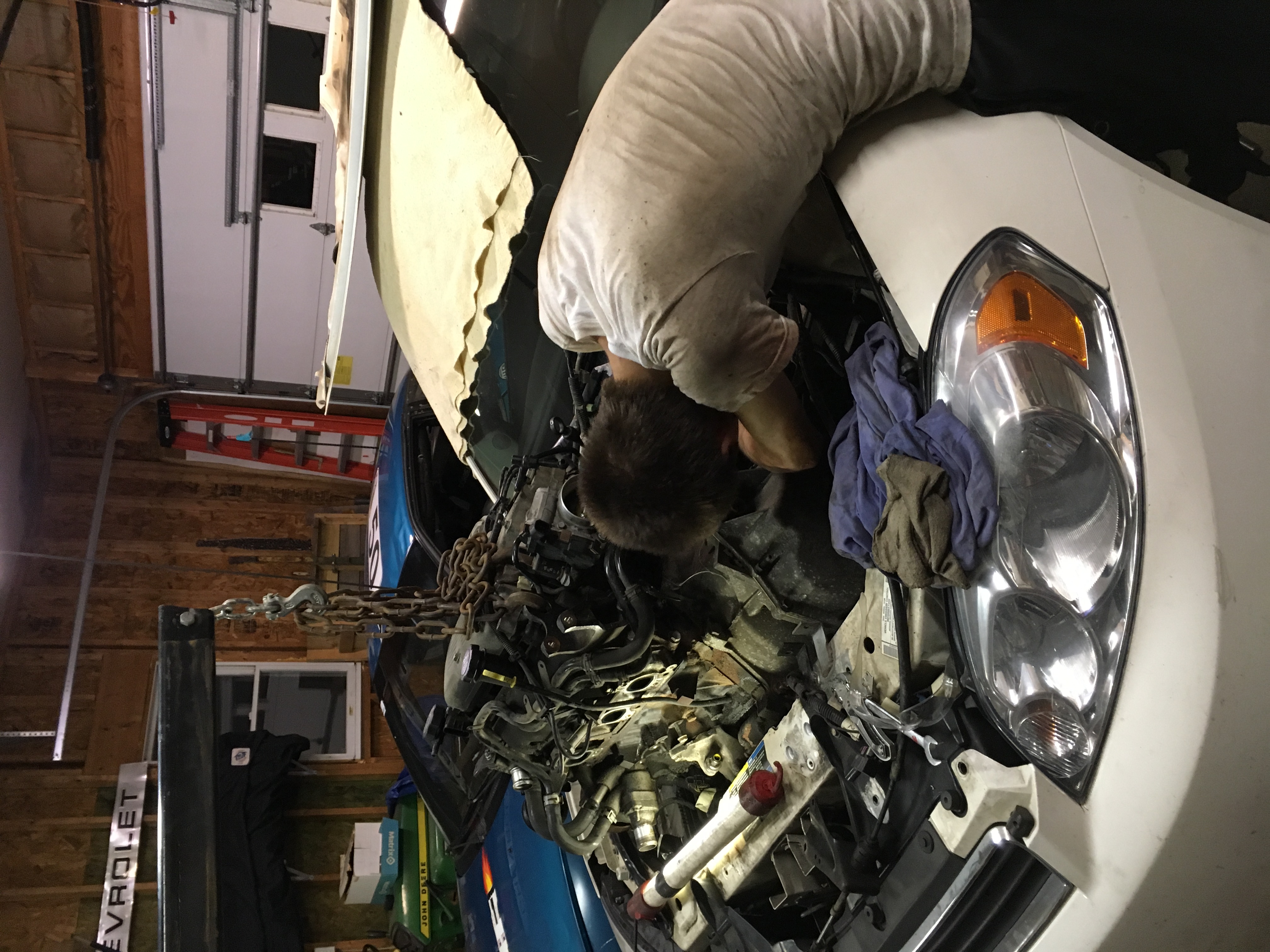

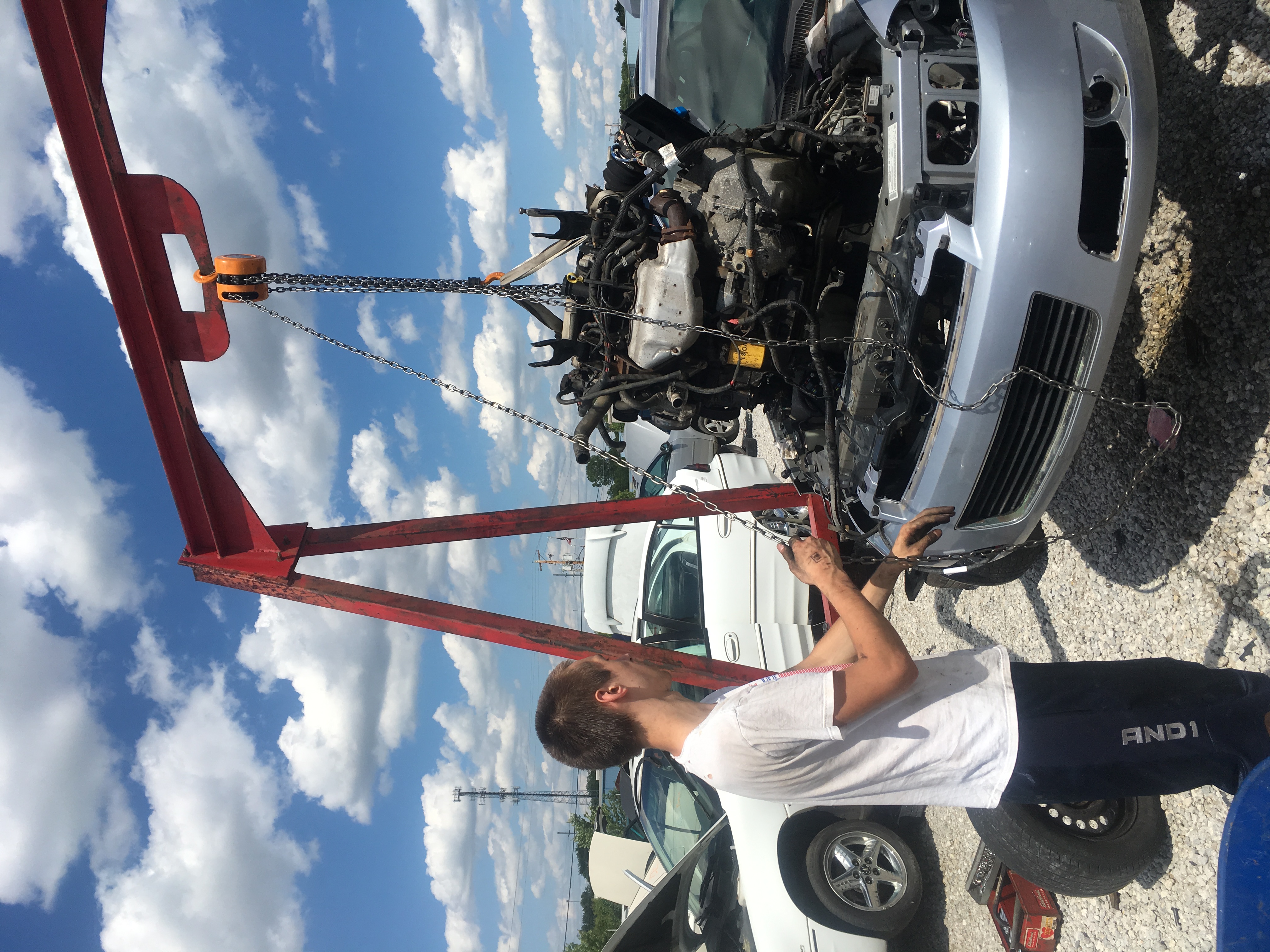

Then Kurt started the engine swap process. The LS has a 3.5 and well the 3.9 has more displacement and the trans has better gearing.

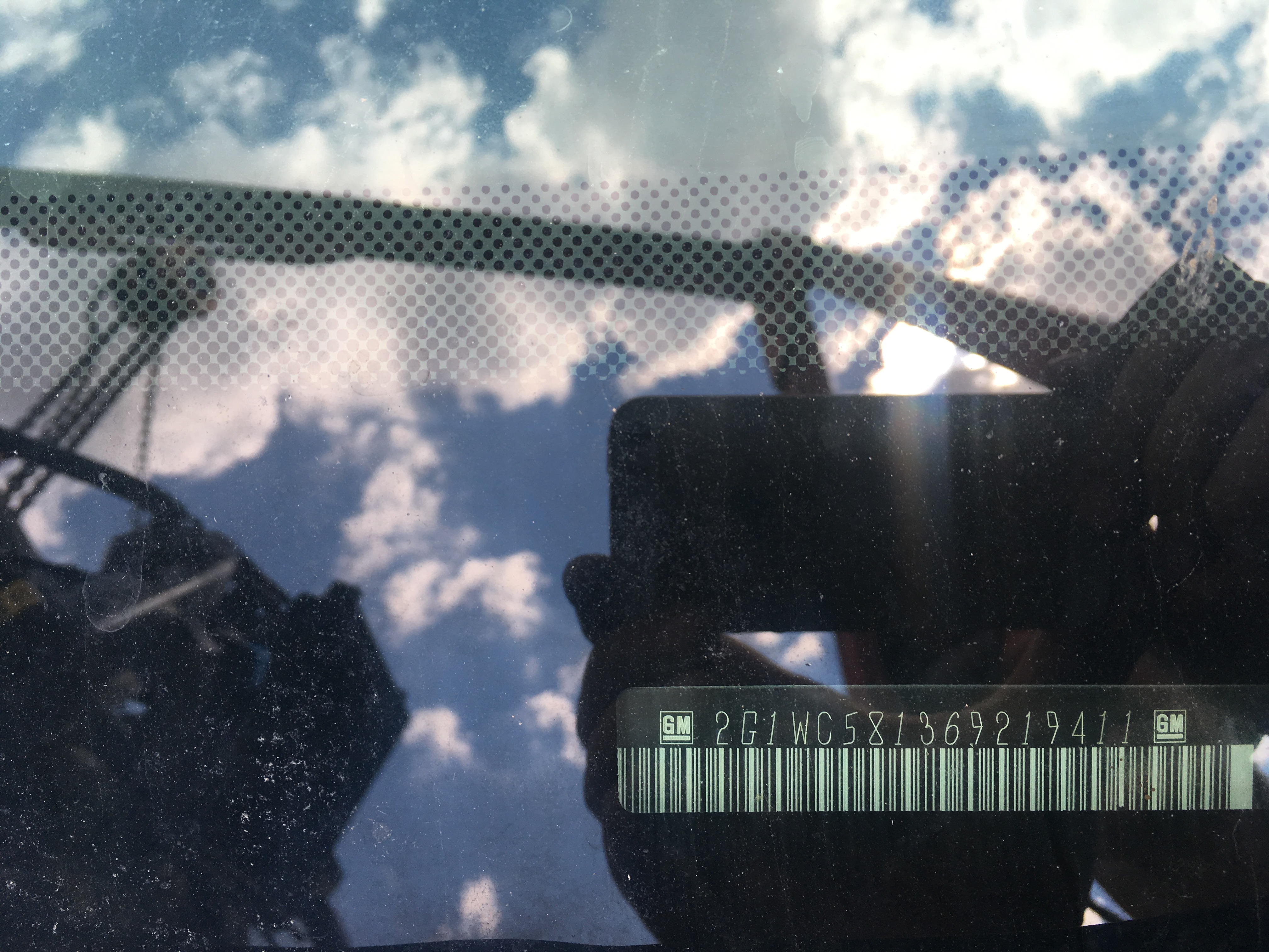

3.9 coming out at pull-a-part
I like this one you can see the reflection of the engine/hoist in the windshield while I was capturing the VIN
3.5 coming out at home
Last night the swap was completed far enough for a test drive. So far so good! I would like a carfax on the donor car to get a guess how many miles were on it but so far I'm not willing to pony up the $40
